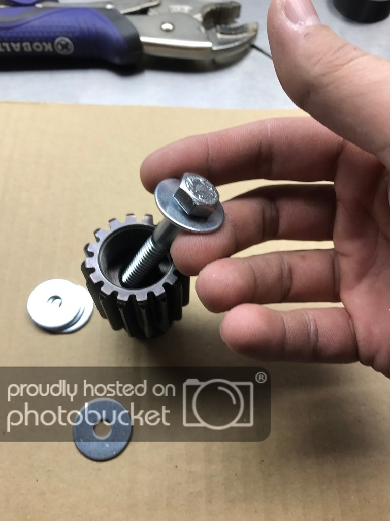

I dont know if this is the right place to post this but i converted my static romans to except this crystal chamber. i had to get
1 booster washer (go to hardware store with booster and try and find one that fits snug, i had no problem finding one)
1 3/8-16 x2" bolt
1 3/8-16 x2-1/4" bolt

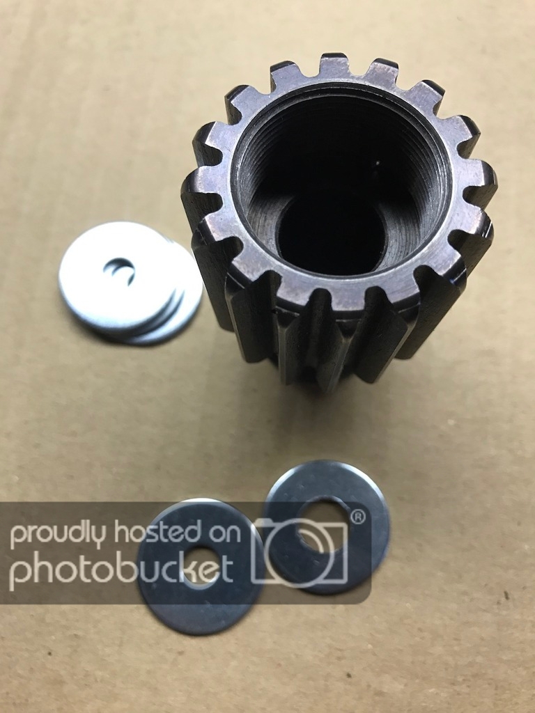

take it all apart, and gather your pieces
grab you washers and bore them out to except the 2 bolts
before boring on left, after boring on right
slide 2" bolt into washer, and insert into booster
here it is sticking out, just enough
heres what it looks like bolted to the sink knob
