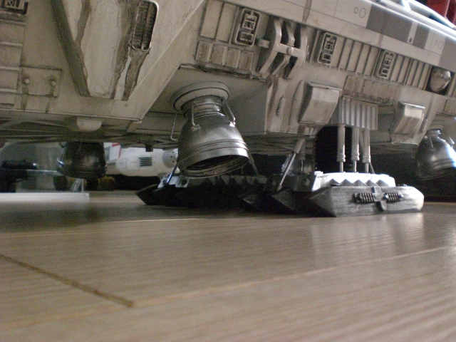

Looking very good...as for the elastics (I've used those over the years for various models), it will fail after a few years:oops::((n)
I'm already experiencing the replacement of a few on my model (the engine bells on my 2001 Moonbus). The mix of glue + the paint is not a good combo for the rubber. It looks good, for sure; but it's ephemeral :confused:
How did the material fail? Between the glue, stain, and not over stretching the material, it seems to be very solid. You've got me interested.
As Joberg says above “elastics” (many rubber products, not all) will deteriorate over time. The standard reasons are usually due to moisture, heat and sunlight. Other things that significantly accelerate this are “fumes” from paint, glue and solvents. As an example is rubber bands used in your model building. They last a very long time when used to hold things together in a room. Use them with your paint, glue, thinner, brushes stored in a cabinet or desk draw they start crumbling after a few months.
My remote control warship ship models use elastic thread for rigging to permit disassembly for easy access. Has lasted 10 years. Looks terrific, but I know in time replacement is likely.
What Searun said exactly. I'm sure some of the models built by pros are also using the "Elastic trick" to put some easy- to- do-details in a fast way.
These elastics, around the bells, have been replaced twice already. No biggie; removing the old and affixing the new + Molotow paint.
That's about a half hour...top! But I know; it's going to be ephemeral:(;)

Just an add-on; I've also tried hair ties (a mix of fabric + elastic) I placed the tie on the bell and soaked it with crazy glue. While the fabric + elastic became hard with the glue, it suffered the same fate over time...albeit not as fast as a simple elastic:(

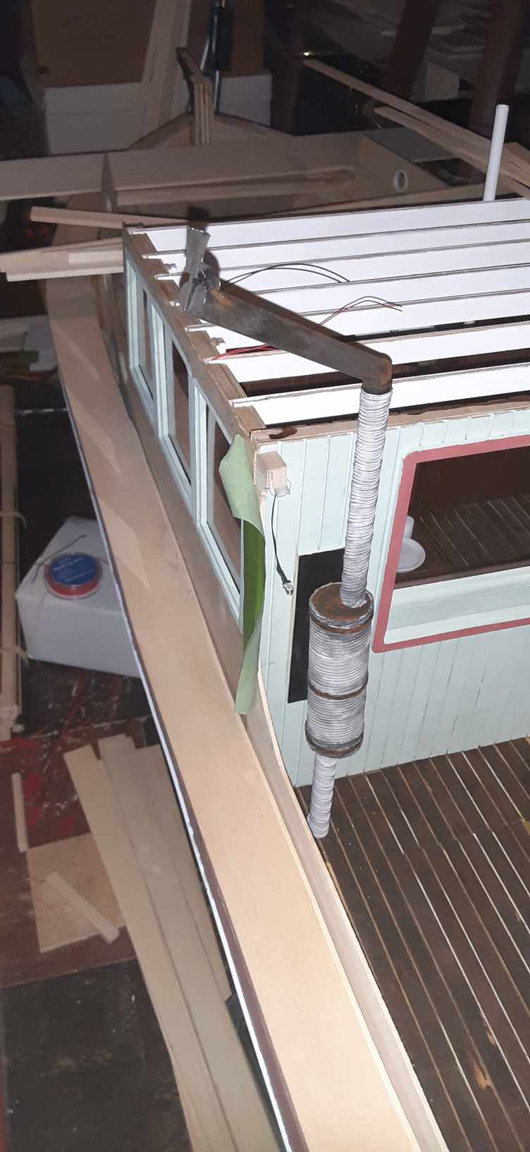

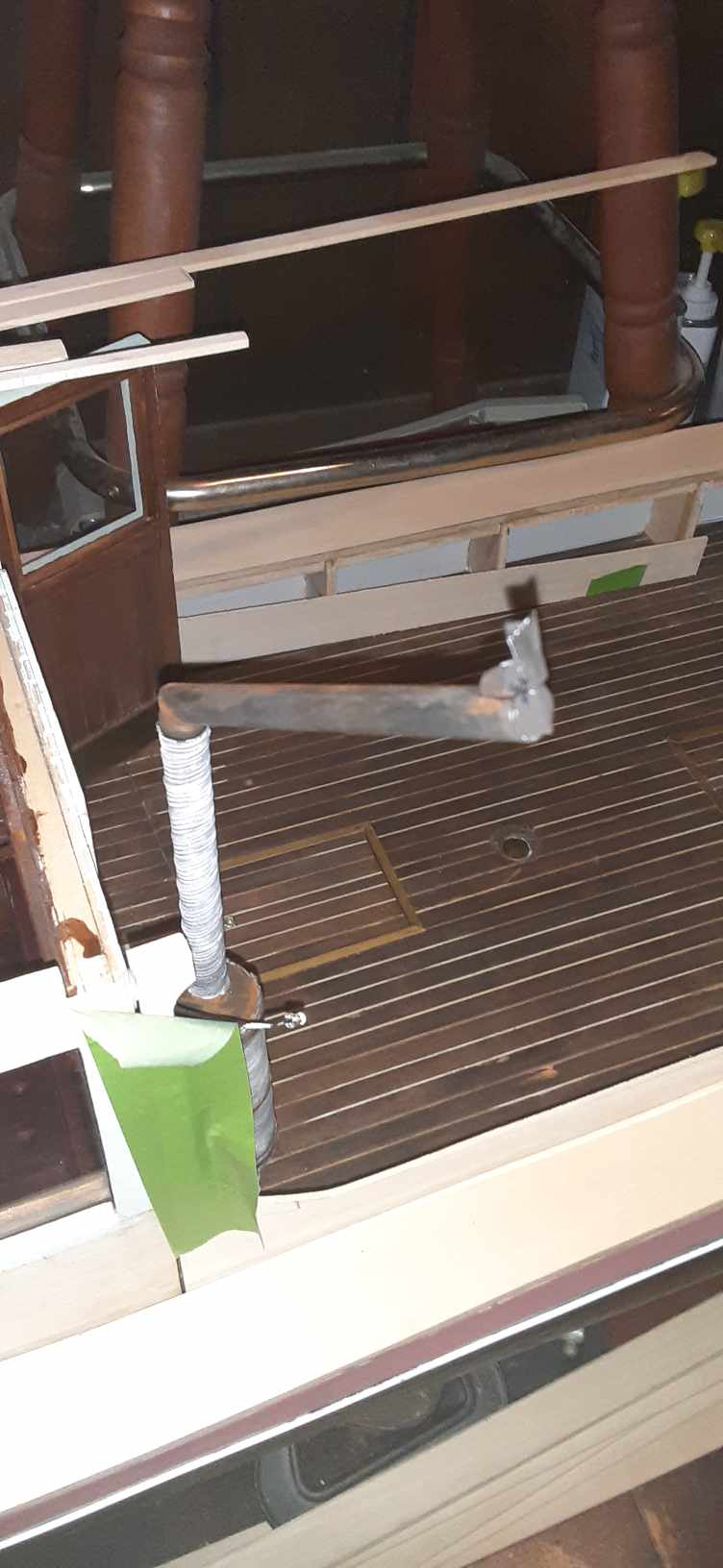

The exhaust stack is done. yes the exhaust flapper works. Now I have to find the mast hole location in the deck. All this to get the wiring done. It's like A + B = X. If Jonny is traveling at 40kph to get home 140km away, and Jonny's bath tub is filling 5L a minute, How far away from home will Jonny be when his tub overflows?
looking great I hope your smoke works better than mine, it works but I think I over filled it on the trip to the lake so it need burning off.
On my next build I'm going to do a self-build Vape unit like on the spinner it's much easier to service an has a higher out put.
As for your exhaust wrap I think you will be fine as you are. I used
it scales perfectly for heat tape. but it's probably too late to change.
the wiring was my biggest headache it slowed down my build be weeks while I worked out what to do. If you never need to dismantle the boat
it would be easy. I ended up with 2 connectors, one for the mast and one for the cabin roof( spot light) 3.5 mm stereo jacks work I think I might do the same again.
