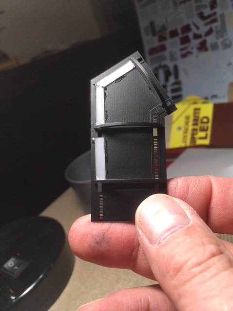

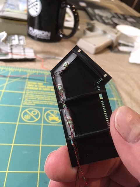

BTW...I've found that the FO I ran to the ceiling panel is pretty much a useless gesture. you can't really see them too well unless your view angle is just right. if it proves to be too much FO to tuck in there, I'm just going to rip it all out.
oh yeah...I'm waiting on some "side glow" FO in hopes that the light bars in the cockpit rear and up the sides will give a more appropriate and realistic glow. Never used it before and the smallest is 2mm, may need to shave it some to stuff it into where it need to go. I'm also going to attempt to use it for the corridor floor lighting on either side. I now, lots to stuff into the cockpit tube, may not all work like I'm hoping, but I'm sure going to give a go!

Really? interesting. I watched to You Tube on it, looked like it worked in relatively short lengths at least. I only got 2 feet of it along with another roll of .25, so I guess if it doesn't I only lost a couple bucks. But I will most certainly post the results and pics. (y)

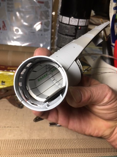

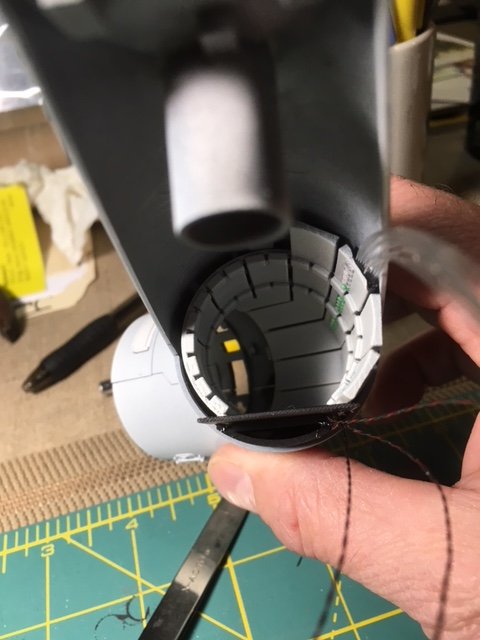

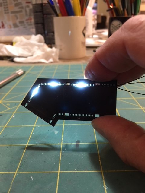

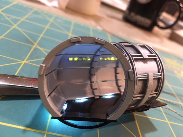

Don't have it yet but I hope at least it works good enough for the cockpit wall light bars, only in like inch lengths I would think. I'm planning to either stick flat tip 1.8mm LED's on the ends or just using chip, nano or pico's . I just finished toiling away on the corridor lights and the floor lights. Was just going to post some pics. Didn't turn out as well as I would have liked but it'll do.
I got a Deago too, in the closet...6 big boxes. That one should be a breeze to light up compared to this one. Trudging along on this one gives me a lot of ideas for the Deago and I'm looking forward to doing that one(y)

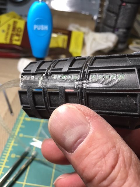

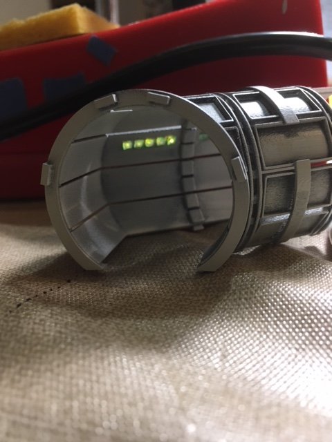

So what I did here was .50 FO in the drilled through light fixtures, only did 10 of the 15, and ran them to a yellow/white LED. The floor piece I put several coats of black on the underside, and clear coat on the top. I used more of the thin acrylic strips over the line of holes on the back edge only because I think viewing in that's all that will be visible anyway. I took 3 cool white chip LED's and stuck them to the center of each strip and tucked the tiny wires to the sides so as not to be in the way of the gobs of FO that will run under the floor going to the cockpit. I'm pretty sure it will all fit without a problem, including the wires for the red and white chips I stuck to the cockpit side panel that will be covered by the PE strip. The final assembly for all this is sure the be a cumbersome sweat-fest! By the way, this phase of the operation was all done with Laser Bond. The stuff is awesome. If you don't have any or never used it...get some(y)

I found it necessary to bevel the floor panel edges where it meets the inside of the tube and the last image is where I had to hog out the tube for the floor support bow. but so far, it looks like it's gonna go ok. Have to wait for this mythical side glow FO for the cockpit light bars, to finish this part of the build off. I'll need to lay the wires for the small outer side panel with the red and white LED's, leave the panel just outside where it goes, set everything else, then snap it in. Yes, this will be extremely cumbersome :eek:

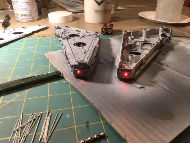

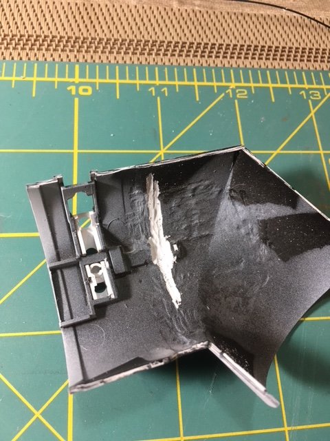

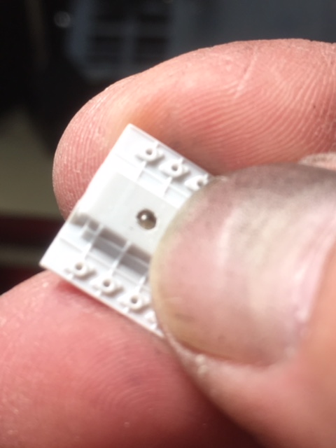

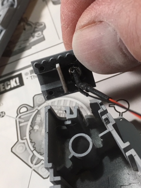

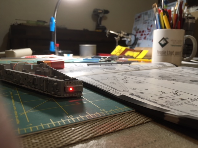

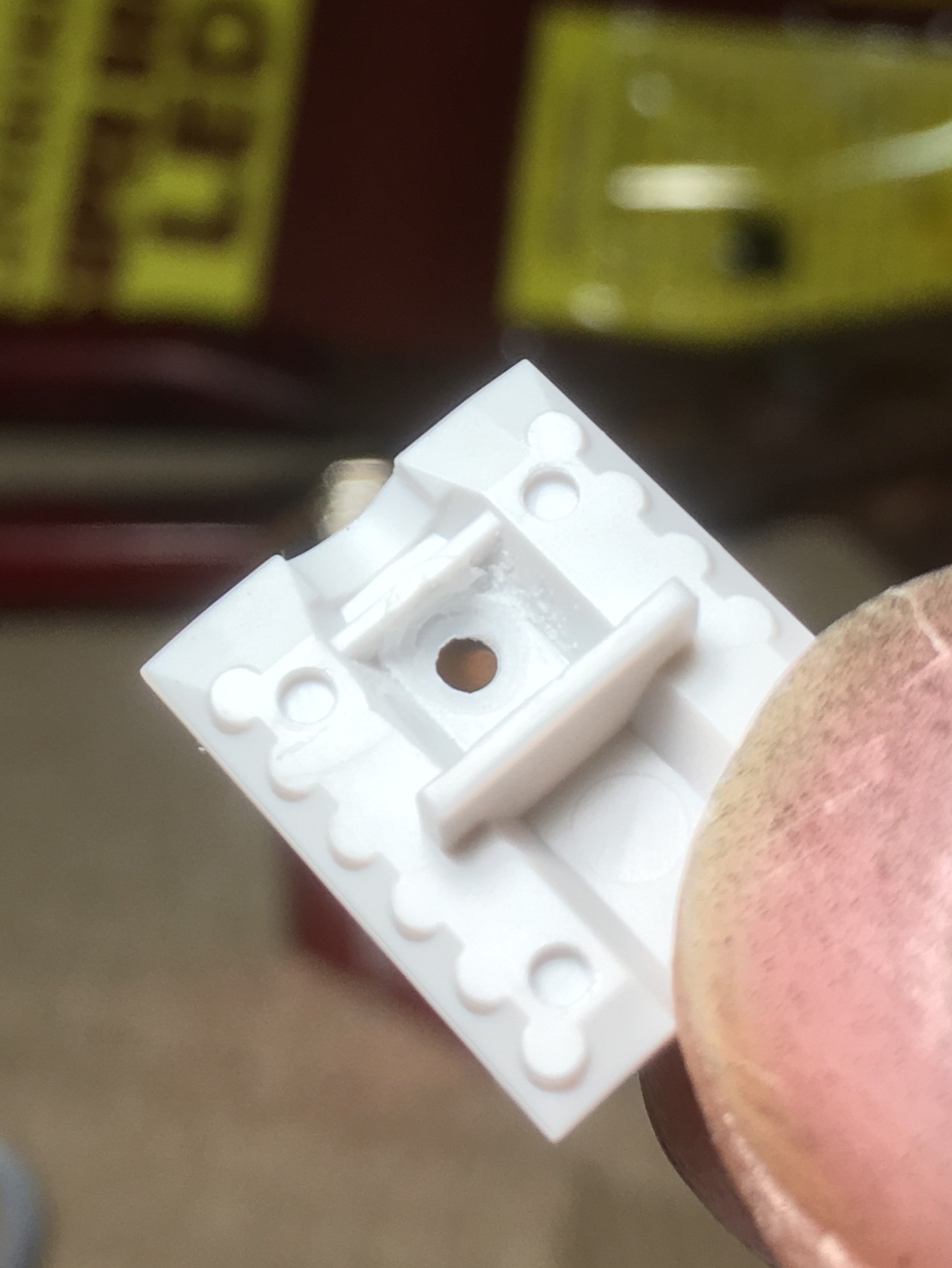

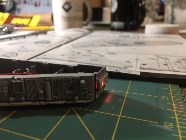

Shifting to another step while I wait for pieces to arrive. I built the maint pits for this mandible a few weeks ago, but the rest of it today. I don't suppose my approach to this is much different than others. I cut off the locator pin for the HL panel, ad drilled where the inboard of the two small spots are. I drilled slightly smaller than the 1.8mm red LED and beveled the hole from the back. I had always before had the LED protruding as much as it could but this time I wanted no more poking out than necessary. In this case it wouldn't have anyway. I had to cut the main piece to allow the LED and I measured it so I didn't remove too much as to have the back of the LED resting directly on the inner panel as well. In the last image you can see that the LED just barely protrudes the HL panel. Yep, light leak...I was tired and punchy, thought the panel was goofy and was about to putty it, so I asked Korban if he'd had the same trouble..."dab some black paint in there, all good" and sure enough, fixed.

not much to report except that I screwed up the red lamp placement. pretty sure they're supposed to be inboard on the mandibles. Then i went to try to fix it and i didn't want to rip the assembled one apart for fear of damage. So...it is what it is. So the extra holes will get some evergreen rod, snipped off flush and a dab of white or silver...or a mix of the two.
oh well
That sucks when stuff like that happens
One of my worst mistakes was mistaking the black spray paint for the matte varnish since they were similar can styles and colors
I had just finished painting a figure and was quite happy with it, then the horror as I notice the figure is all of a sudden getting blacker as I am spraying :lol:
As nkg suggested, you could try flipping the parts. IIRC correctly, they are interchangeble detail wise and if you rotated them and put swapped sides, you would have the lights on the inner sides then. You might have to cut off the snap pins etc.. on the back and glue instead, but it could work
yeah, I suppose I could, but it's a minor gaff I think i can live with. I already glued one in there and would hate to ruin it in an attempt to fix it. The casual observer won't know the difference anyway. But, going forward...no more goofs on this one.
Thanks for the support fellas (y)
