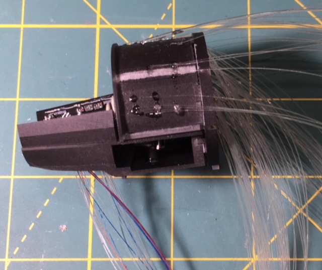

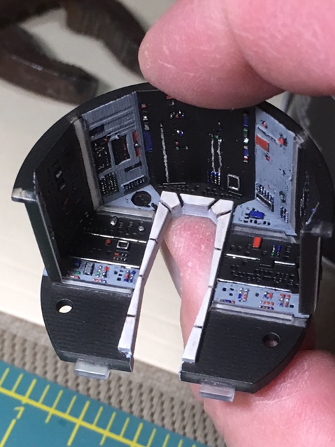

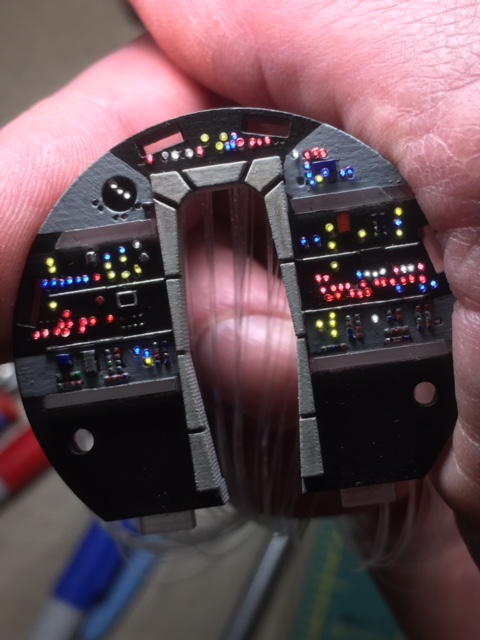

Rather than start another thread, I'm going to continue with this one for my PG Falcon. After taking a break to assemble my Storm Trooper Armor for Halloween, I'm back to "the table".

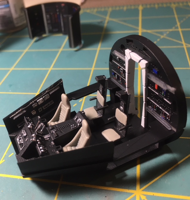

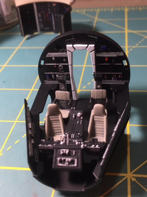

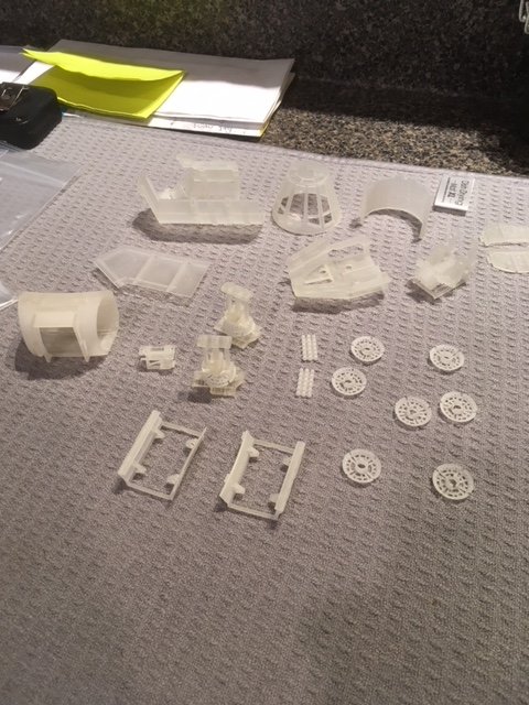

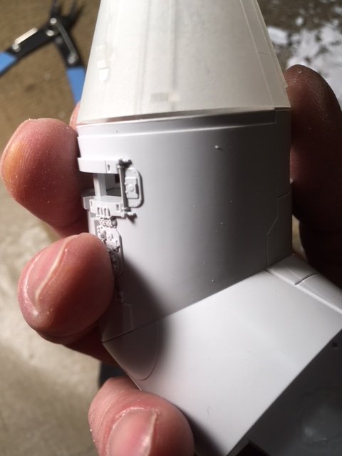

I haven't done a whole lot just yet but at least I finally got started. Was waiting for Shapeways pieces to arrive. So I skipped to the first mandible maint. wells, still needs some tuning as I went back to the cockpit assembly once the 3D stuff showed up.

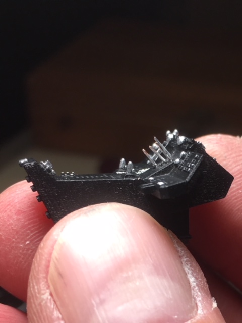

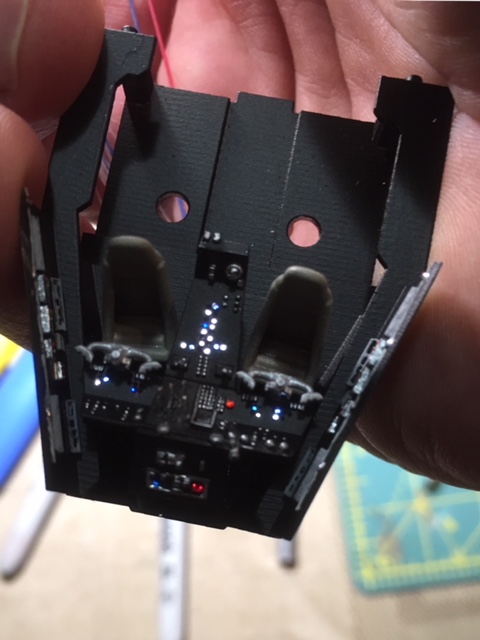

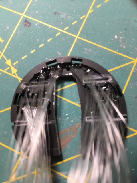

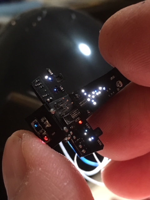

I cut off the nubs from the Shapeways console that are meant to represent the hyperdrive levers and replaced them with some stripped 28w wire, though I think they'll need to be repositioned to the same center point at their base and jus have random angles for a more accurate look. I elected to "attempt" lighting the back wall with FO, even thought the space to run them back into the main hull will certainly be challenging, but I think I can pull it off. I intend on having a handful, maybe 8 or 10 of the FO in the wall, as well as one or two from the console go to at least two blinking LED's which will have a random blink so the blinking will appear at least to alternate. It would look stupid and cheap to have all of them blinking at the same time from only one LED. otherwise, I'm following Korban's brilliant lead on this build (y)

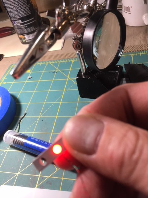

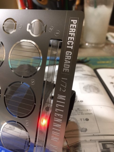

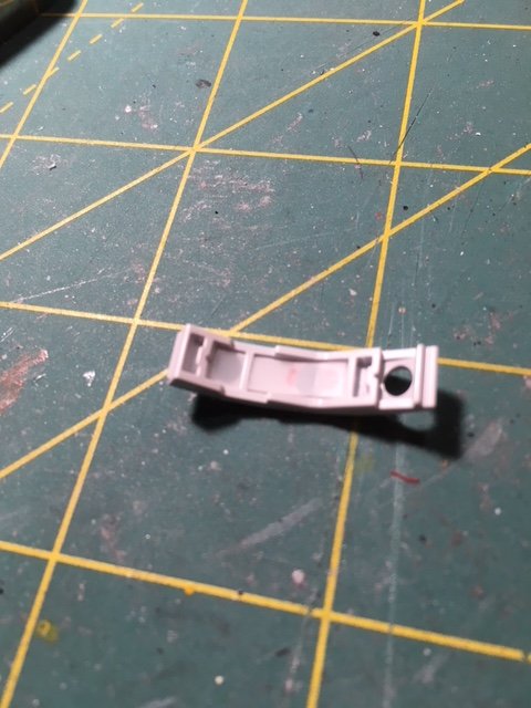

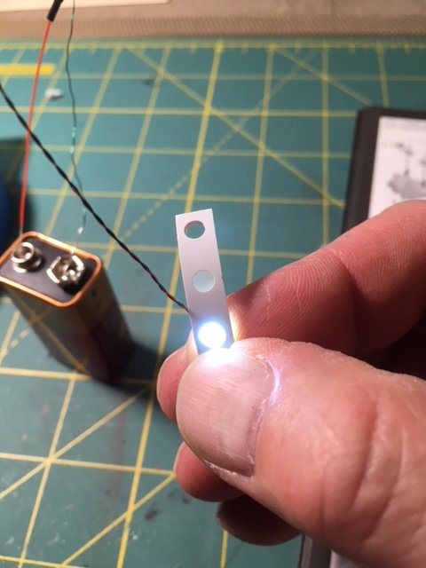

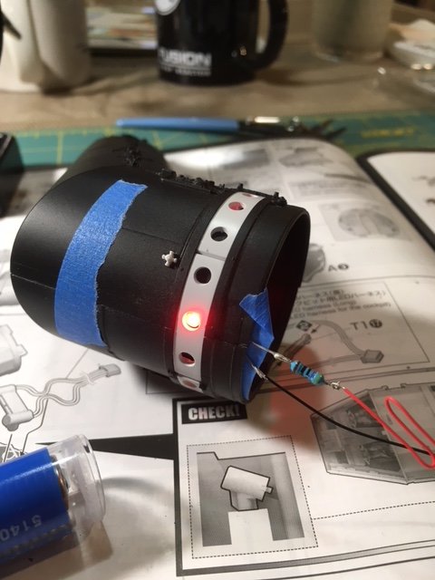

some random stuff from the last few days. I decided I wanted the cockpit tunnel lights just to the rear of the cone under the PE screen. Some very thin acrylic sheet designed for light diffusion did the trick with a red and a white chip LED. ultra small wires and the resistor on the end should allow the wires to pass behind the corridor easily. I'm following Korban's method of a .50 FO going to the corridor wall lighting, greenish LED of course, plus I have some electric green testors enamel I used some time ago for a Kawasaki logo. Painted lightly on the wall fixtures should enhance the effect...I hope.
