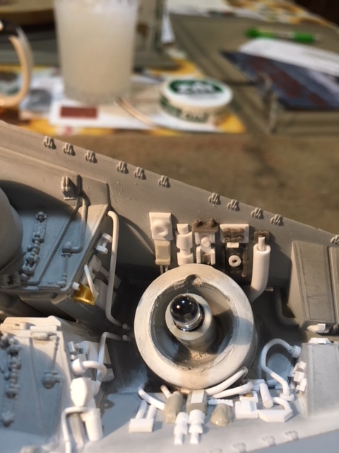

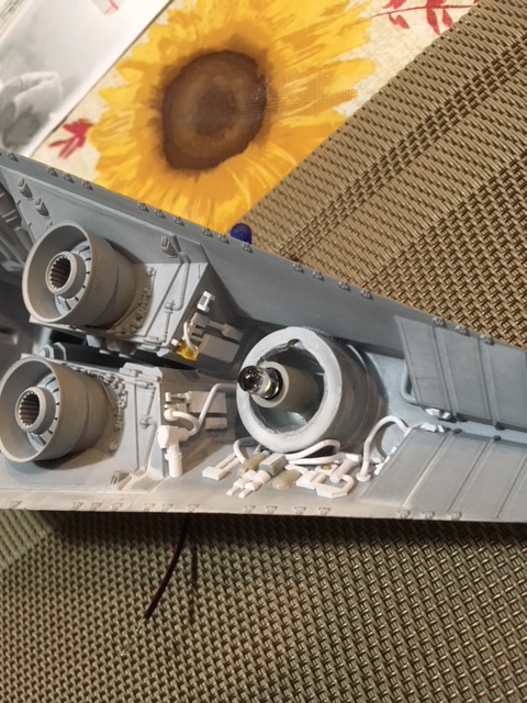

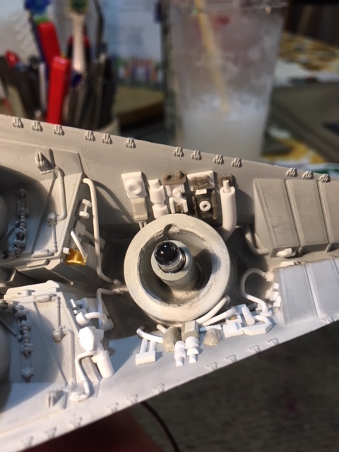

engine panel1.jpegengine panel2.jpegFunniest thing, I ordered another set of bells, just knowing I'd destroy them getting them off. So went to just rip them out...and they came off in one piece...all of 'em. So after I stripped the paint off, which by the way didn't go as planned...Citadel is extremely resistant to easy off. I tried the first round and let it sit for 5-10 minutes, scrubbed with the old tooth brush and all I got off was the wash. tried again and let it sit for a half hour...thinned it a bit more but that stuff wasn't coming off like paints in the past. anyway, I decided to just light scrape with the exacto where I need to stick stuff. and here is my progress so far. As stated earlier, there was no way I was going to even get close to what Invar has done with his, but this is better than if I had done nothing. It's really time consuming but it'll look good at the end. Have to admit my greeblie stash is due for refreshing. Thanks again Invar for the inspiration :thumbsup
That looks really damn good to me. Achieves the effect without the ridiculous amount of time, eye-straining and styrene-carving that I put myself through.

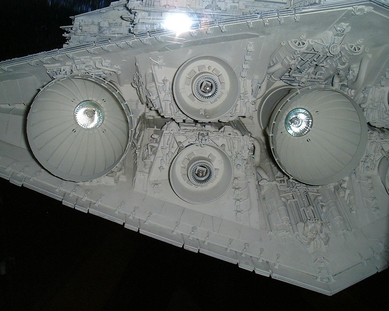

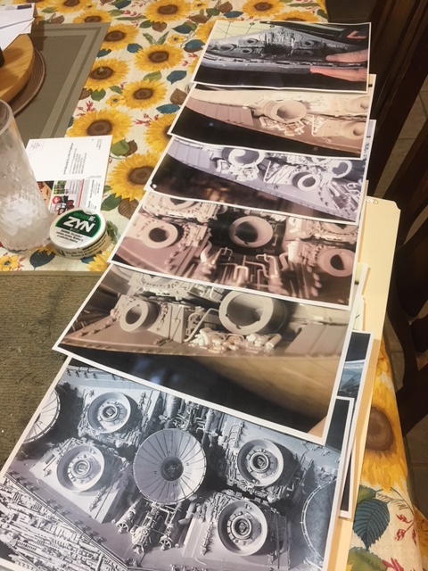

But then, I'm a stupid perfectionist when it comes to trying to make this thing look like the ILM ESB model... because well....when you stare at these ILM reference photos long enough - you lie to yourself and say "no problem!".
Then you spend the next 3 months attempting to make the engine section of your model look just like that!
Hey thanks my friend! This was about 4 hours Saturday, and about that on Sunday. I think I could have done better had I more appropriate greeblies available. But in all, it's good for who it's for right? I'd forgotten I have a stash of 1/72 WWII armor in the closet, so I'll be bashing a couple of those. They were the 6 to 8 dollar ones and some I have multiple of.
Nothing wrong with striving for perfection, and since this is a grail kit for you, you'd expect no less from yourself, right? I know what you mean about looking at something and going' "I can do that", then later asking myself what I had gotten myself into. But at that point it's follow through. I'm thoroughly impressed with what you've done, and thankful that you posted it for the rest of us to work off of. Between you and Escape, there's a lot I otherwise would not have done to this and I'm glad I saw your work before I got to the point where I couldn't go back and do more :thumbsup

Great work on the engines. You lucked out that you weren't too far along and was able to add all that detail to them. Sometimes going slow and taking your time gives you the opportunity for all these great upgrades.

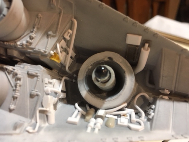

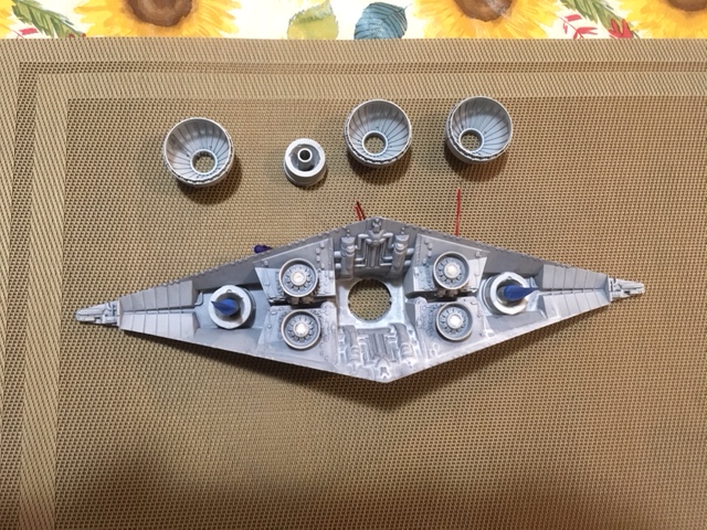

engine panel5.jpegengine panel6.jpeg a whittle moe progress on the starboard upper section, still a couple plates and piping to do. No where near the same zip code as Invar's. much of my troubles here are lack of good and appropriate greebs...but, I'm doing what I can with what I have to work with. And lets be quite clear, if I hadn't seen Invar's months of very impressive hard work, heck I'd never taken this step. He's made this relatively easy to follow his work. Raise a glass for Invar! :cheers:thumbsup
I'm anxious to do the center section actually, mostly piping so it should go much easier

hey there man, thanks...not as good looking as Invar's to be sure, but like he said, the effect is there. the trench LED's are just more of the 2mm whit I used for the main hangar and the tie hangars, that's all I have and when I bought the 2mm I got like 40 of them so I'd have extra. I've only done the tie hangars so far, so I have to examine some images to determine where to place the other trench LED's.
As far as Evergreen rod, I think I bought everything from .35mm up, the tube and rod assortment pack and pretty much .35mm and up of half round, at 3.50 a pack I just grabbed whatever I thought I needed and took a color phot of Invar's posted pics with me to the hobby shop for reference. Then just scrounging through scraps and bashing a few low dollar 1/72 armor kits for greeblies. I gotta tell you, Invar has some fantastic looking greebs, and I knew I wasn't going to be able to get in the same ball park so I'm doing the best I can without breaking the bank on it. :lol

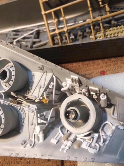

I be blushing... thank you for the compliments. But don't go cheering yet because I haven't gotten to the painting or electronic stage yet. I have plenty of time to screw this up. Those stages of adding the fiber and electric and painting is months away yet in all probability with work and babysitting the grandkids twice a week. I do have the forward trench sections done on both the port and starboard sides. I now have the larger back hull halves trenches to greeblie before I can start on the wedding cake sections of the superstructure. That may be easier because the hard part of creating the hangar bays and all the trench work and engine sections will be done.
What size rods, tubes and anything else you are using for this? I need to buy some if I'm going to attempt this upgrade.
I got a variety pack of Evergreen rods, then ordered .030 round rods, .020 square and also .020 round rods, 1.5MM square rods (used to raise the trench height) and also for greeblies. 1/16" hollow round rods and thin flat sheet styrene sheets.

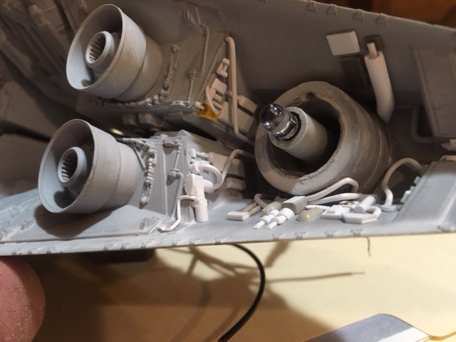

ISD greeblie starboard.jpegISD greeblie guide.JPGwith the exception of a tiny box greeb and a piece of round stock yet between the smaller bells, the starboard side is as good as I can get it. I mis-calculated...it took nearly a week to do just this much and I thought I'd have ALL of it in a week. So this is a testament to the time and effort Invar put in creating his. he says 3 months and I don't doubt that for two seconds. The other photo here is what I call, Invar's Guide to Great Greeblies :lol:thumbsup
