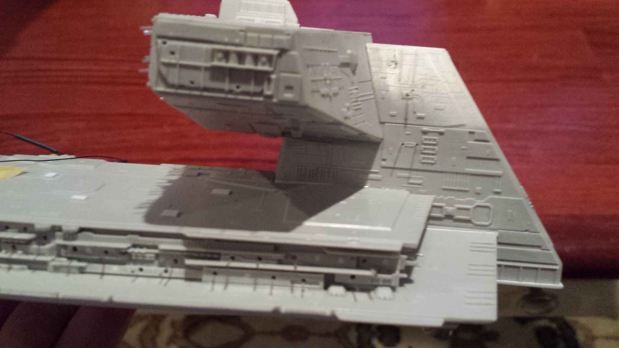

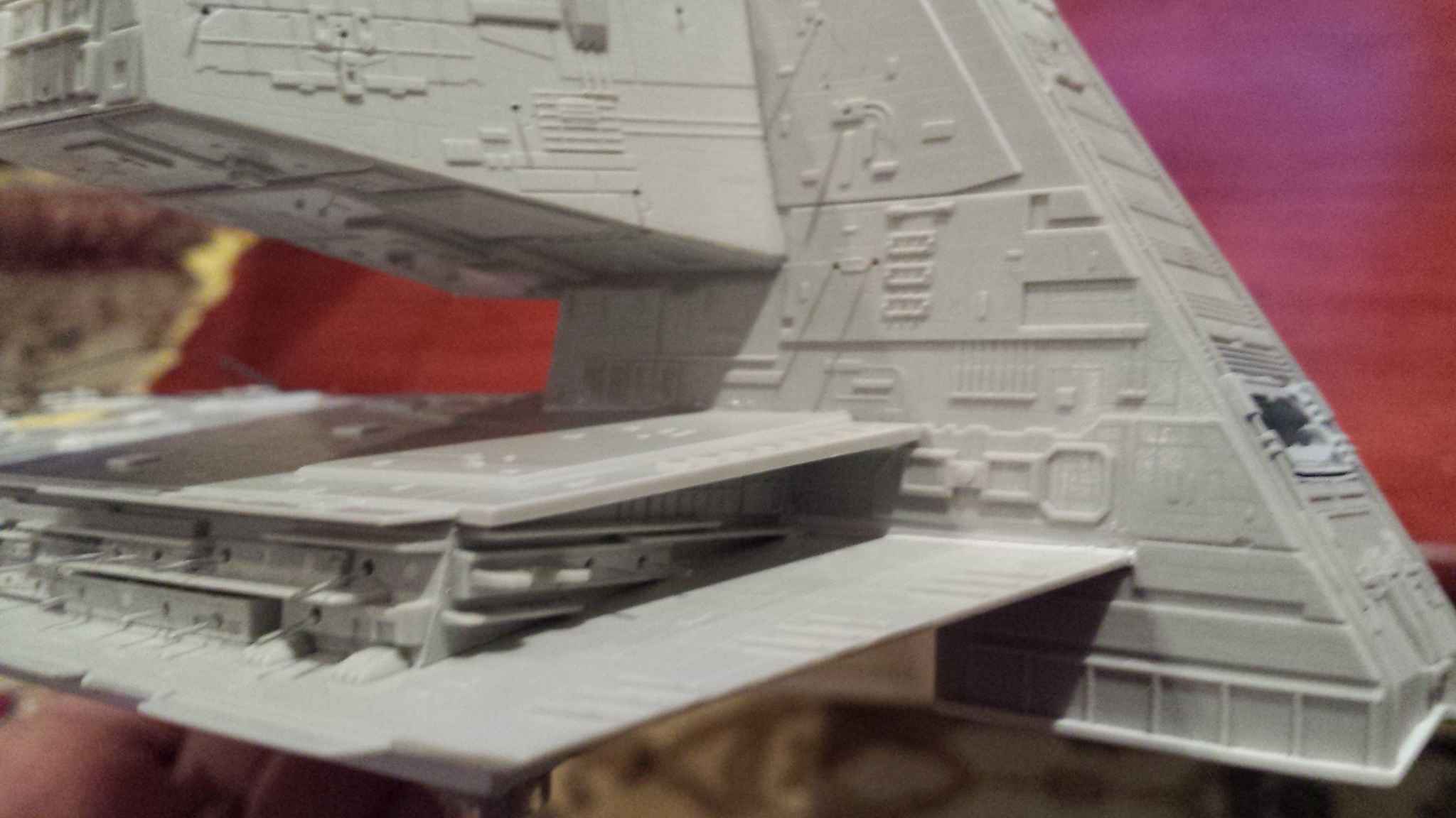

1/2700 Star Destoyer on the kitchen table
Still about two months away from finishing especially with all the engine block and bell work. I still have to build the base which I was thinking of a smaller triangle to shadow the SD along with perimeter lighting around the edges.

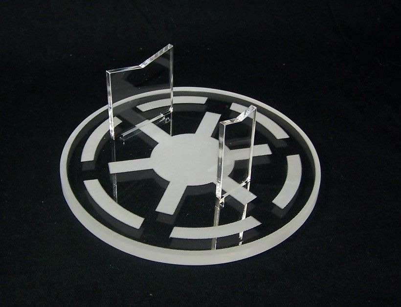

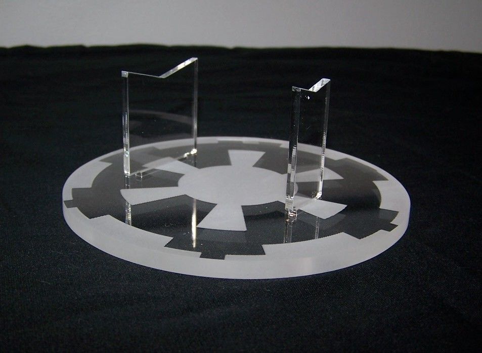

He has yours also but I want the round one.
https://www.ebay.com/itm/acrylic-di...297672?hash=item3af2b8c1c8:g:nO0AAOSwp0NZzVAw
I'm going to drill a 1/2 hole in the center of mine to accept the post.
I like them in the order listed
looks similar to mine, maybe same seller? mine is like a 7 inch long oval, the supports are spread out more
I'd still be wary of drilling it
I guess that might be the way to do it, tiny bit and work up to whatever size...
I'm leaning towards the second one because with a hole drilled in the center you will not be able to see through that spot. I messaged the seller and he said for a large hole it was better he drilled it......for something small you have to be careful but it can be done. He said he uses drill bits made for acrylic
Yeah, of the three, I like the first then second but not the third
so you're talking about the one that's clear in the center?

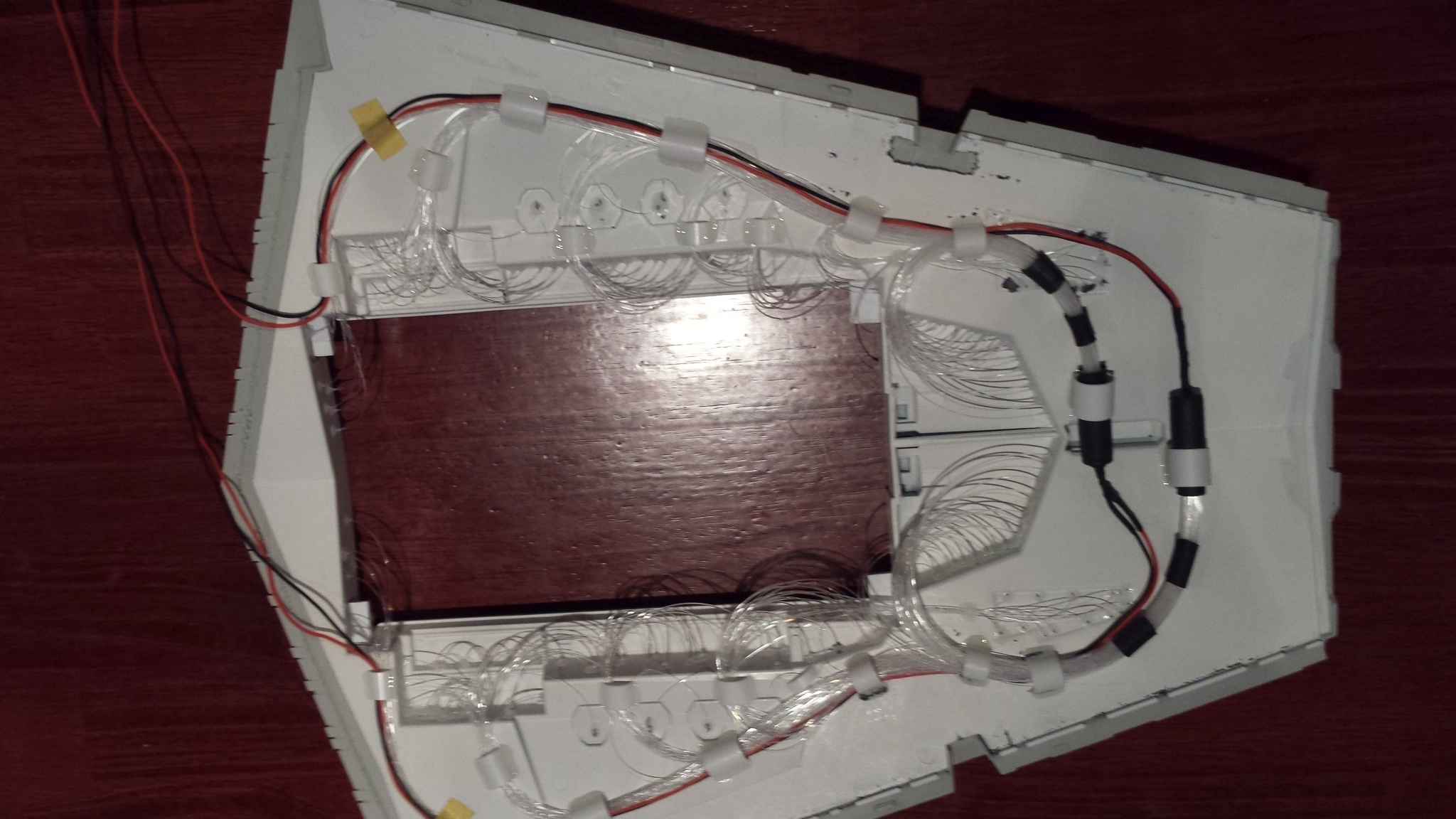

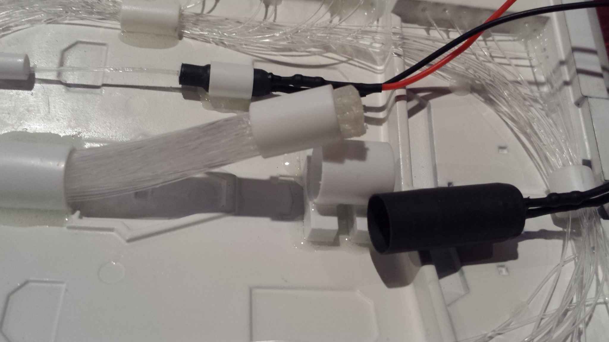

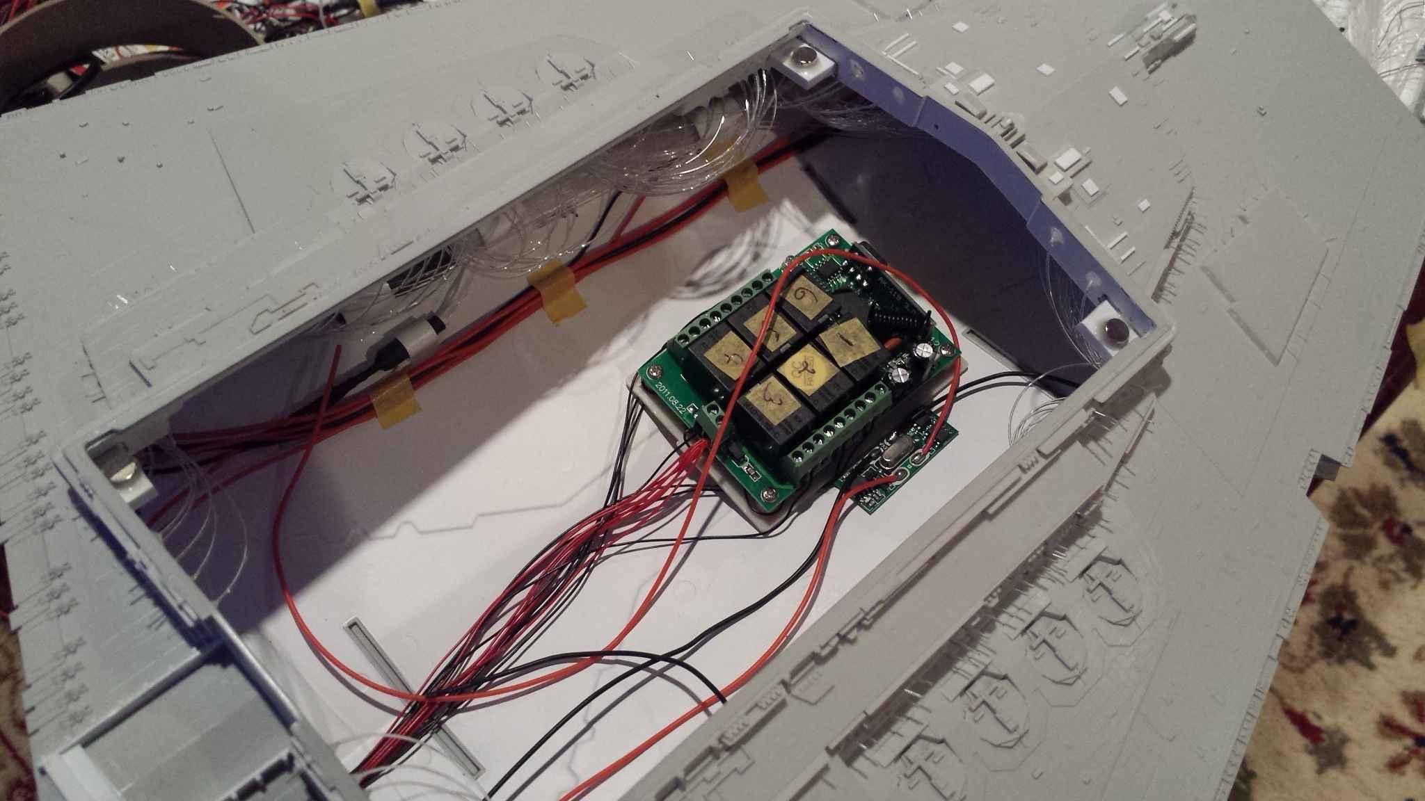

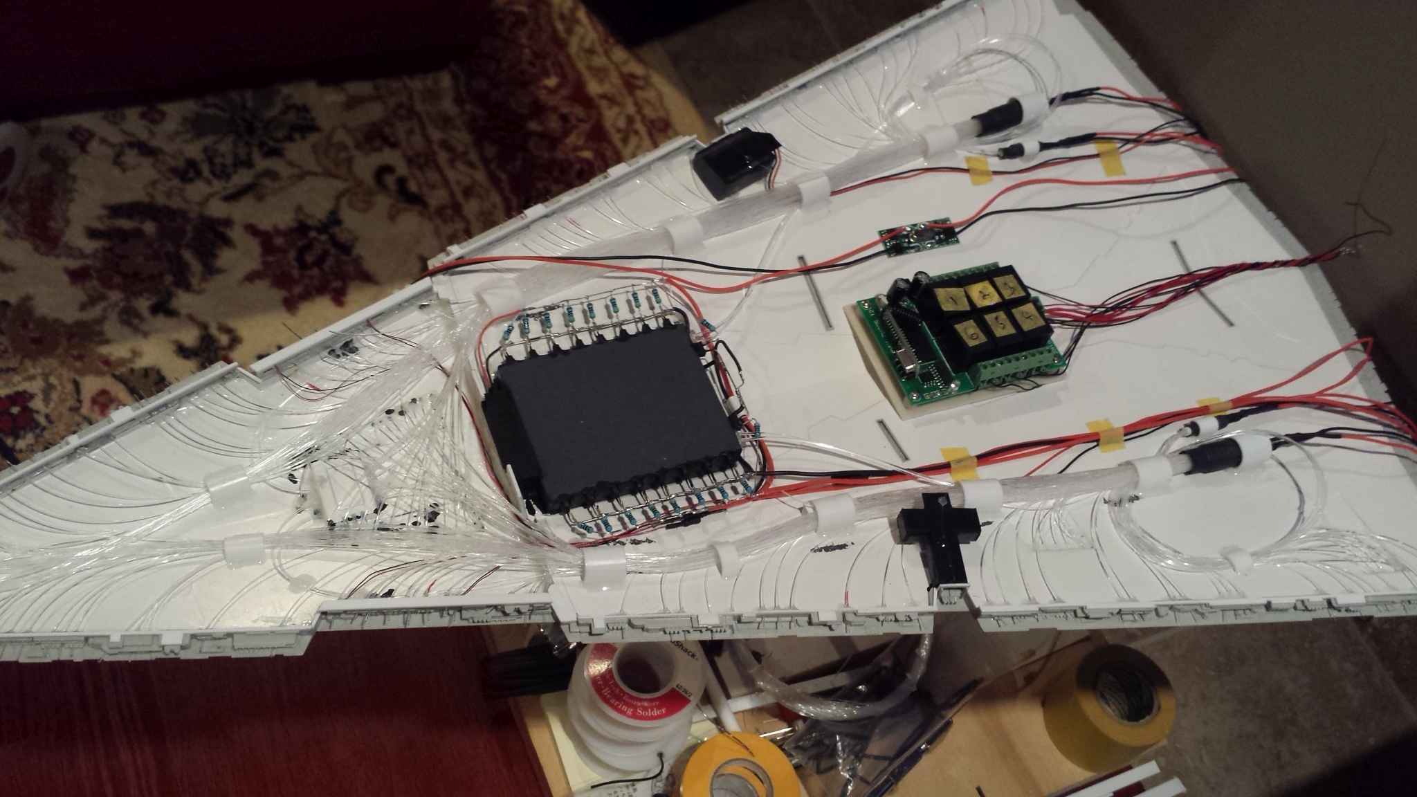

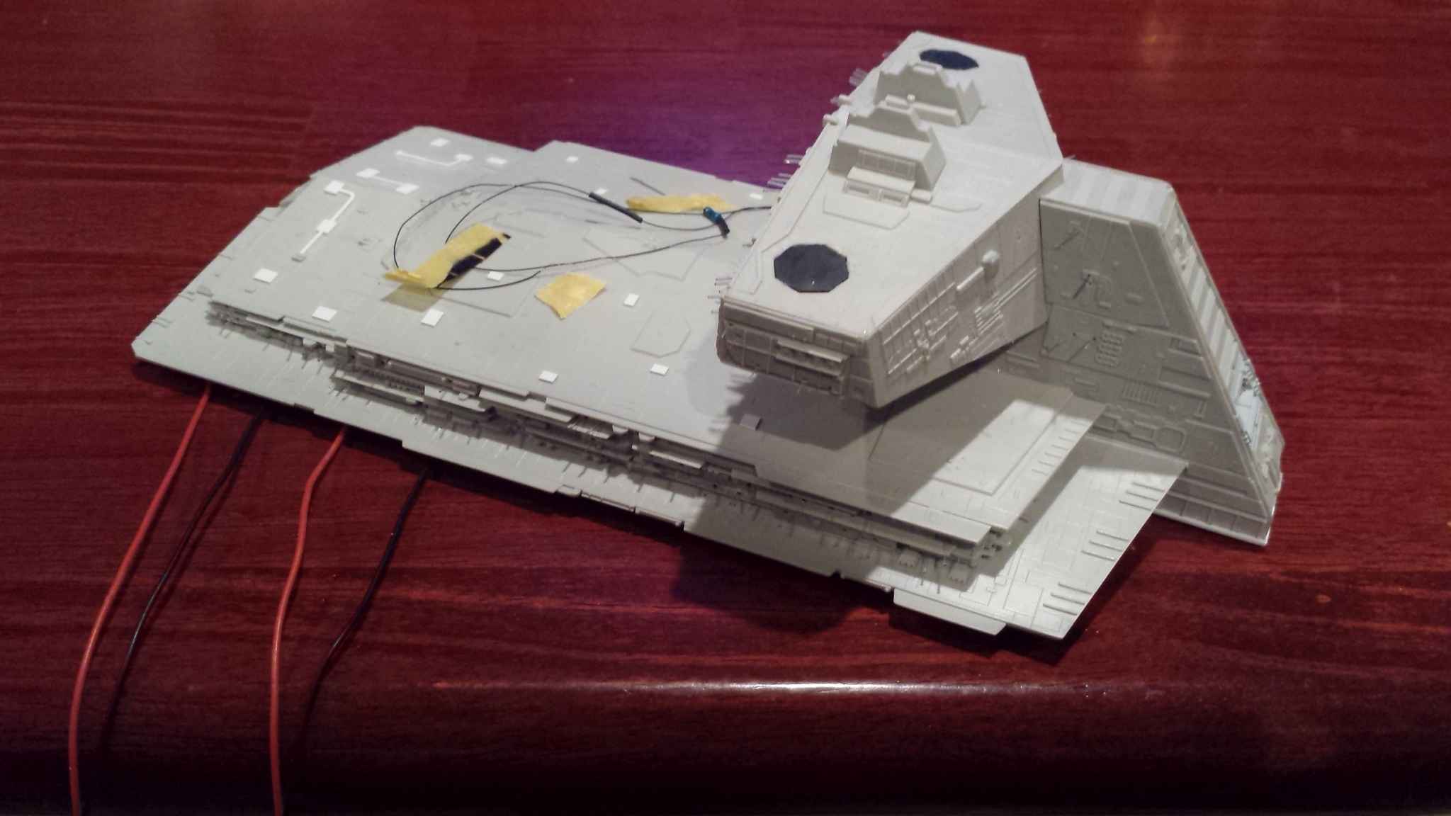

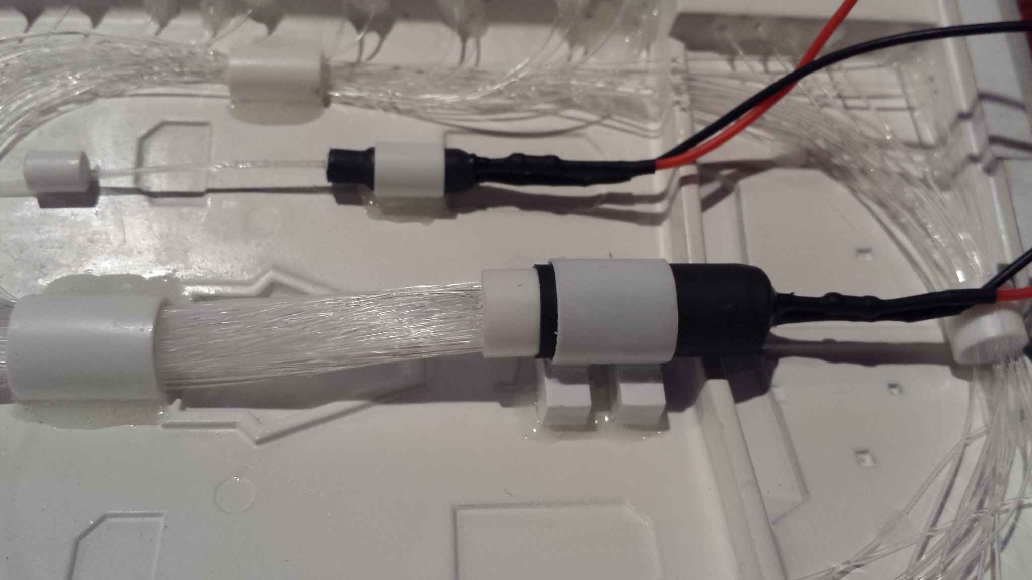

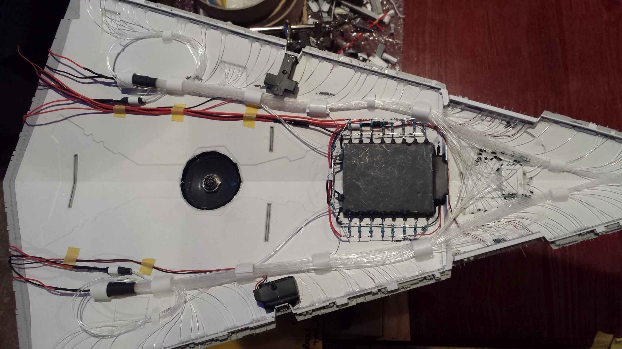

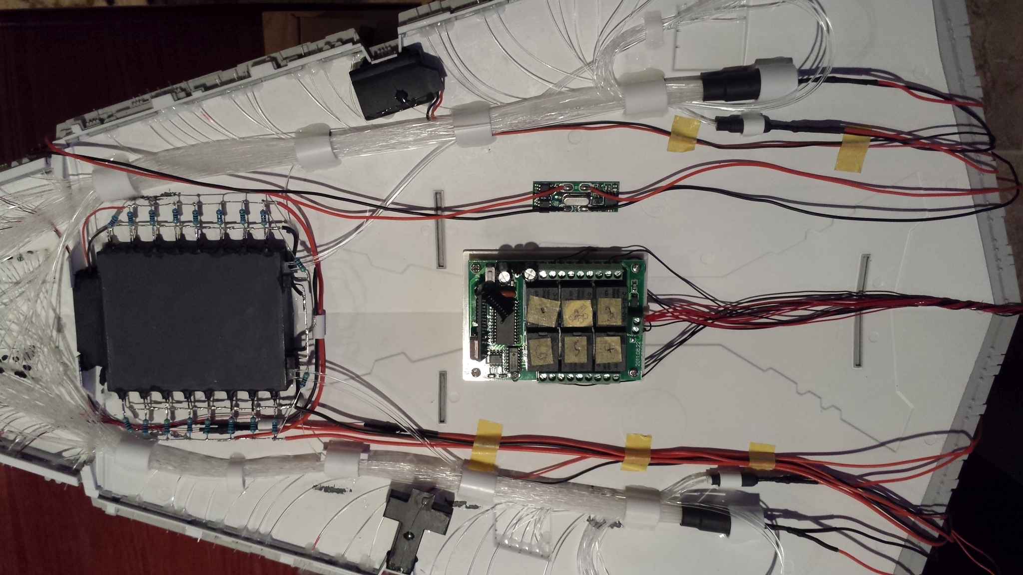

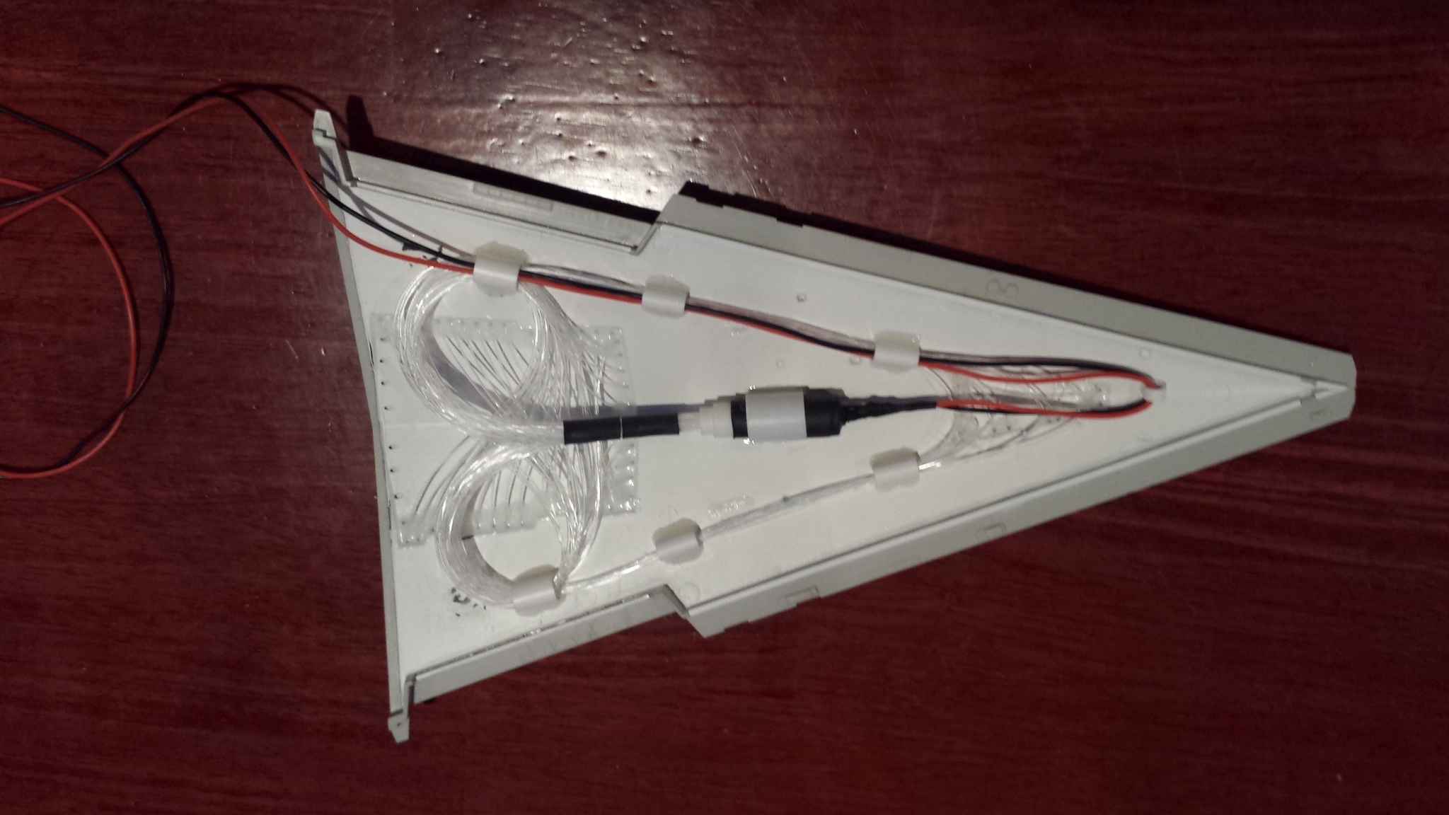

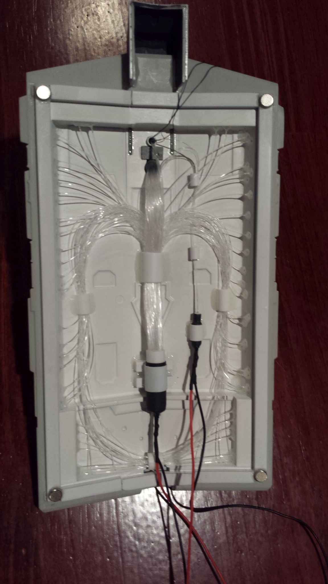

Some up to date progress pictures on the finished sub-assemblies. This will enable me to prime and basecoat them separately. I will then assemble and just have to paint the trench and front top seam. Still waiting for some items to arrive on Friday so I can set the electronics up in the center. Will be starting the engine block greeblie upgrades tonight.
20180117_073242smaller.jpg 20180117_073303smaller.jpg 20180117_073327smaller.jpg 20180117_073349smaller.jpg
20180117_073631smaller.jpg 20180117_073702smaller.jpg 20180117_073456smaller.jpg 20180117_073519smaller.jpg
20180117_074031smaller.jpg 20180117_073754smaller.jpg 20180117_073817smaller.jpg
Bravo! Very neat and tidy...unlike mine LOL, I like the FO and LED junctions...very clean. I think I figured out what the problem was with my dimmer. Both sensors were hooked into the same power line. I took and plugged the engines into a separate battery and that cured it, the foil did nothing. But the thing now is, to see if I can up stream the power on the same battery without it doing the same thing. I suppose a second battery wouldn't be bad but I'd have to install a second power cutoff button so the sensors don't drain the second battery. I'm off work today so I'm going to dive into it shortly. Keep those pics coming, sure is looking good :thumbsup
View attachment 787902 View attachment 787903 View attachment 787904 View attachment 787906
View attachment 787907 View attachment 787908 View attachment 787909 View attachment 787910
View attachment 787911 View attachment 787912 View attachment 787913
The clean is good. I like how it appears he has glued hollow styrene tubes holding the fiber to the inside hull. VERY industrious! I will likely give that a try myself whenever I get done trudging through these endless months of greeblie detailing.
The upstream connection worked, no more interference between sensors. Finished the stand, have upper and lower taped together looking for light leaks. Found a one place to the rear of the port tie hangar where there wasn't enough trench wall so I cut a sliver to fill it in. Just looking at the PE sheet, the parts that fit in the trench cut out and the tie hangar opening (the fork parts) are, obviously too short, so I think since the contact areas are more to the top, I'm going to cut the lower part of the PE pieces off, install the upper as the bigger item, then stick the lower on the leg where it would go. then try to slice small pieces of the PE sprue to fill in the gap. Anyone else had any thoughts on that?
