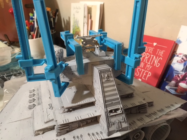

1/2700 Star Destoyer on the kitchen table

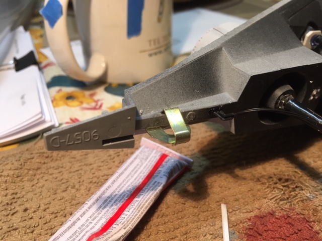

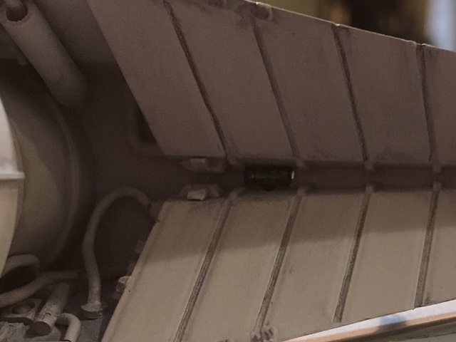

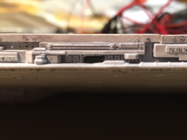

ISD sensor1.jpegISD sensor2.jpegISD bridge1.jpegISD bridge2.jpegI didn't think to get pics of the lighting on, but I did place the remote sensors and it works pretty good. Though it does do some funky stuff every now and again, probably from signal floating because the top isn't on it. I have to light the windows first, then the engines. other way, it engines come on and pulse bright to dim and back. Otherwise, I think it's going to be fine once the upper is secured. I set to bridge top and clamped it down. I also played around with the engine block and discovered that when placed in stock position, with out the 1.5mm, the top of it only needs 1.0mm more to mate good with the upper hull. So I think what I'm going to do is, get some .5mm and put a strip on the top and bottom so the gap is equal. I'm also going to notch the stock engine panel brace so there is a tab in the center, and use the .5mm to build a slide trench so when I install and remove the engine panel it will slide straight in and the brace will drop down into it's position in the lower hull. that's all just in my head at the moment, but I'll take pics if it works like I think it will. I'm going to install a 9V battery holder on the brace as well, just below the center main bell LED. Crossing my finger ;)
Coming really nice. I like the how you placed the IR sensors. That is a good idea to add .5mm to the top and bottom of the engine block. I have not tried mine yet but I added only 1mm so I wonder how much of a gap I will have. Getting close to doing all the engine block detail sometime this week. I will see how it fits when I start that. Priming and painting is getting close. I may prime the top and bottom panels separately before I put it all together and leave the trench priming for when I join the top and bottom......Then only have to paint entire ship with base coat and do the wash. Not exactly sure yet but that is the initial painting plan. I also have the top section removable so I will be able to prime and paint that separately which will make it easier.

View attachment 785795View attachment 785796View attachment 785797View attachment 785798I didn't think to get pics of the lighting on, but I did place the remote sensors and it works pretty good. Though it does do some funky stuff every now and again, probably from signal floating because the top isn't on it. I have to light the windows first, then the engines. other way, it engines come on and pulse bright to dim and back. Otherwise, I think it's going to be fine once the upper is secured. I set to bridge top and clamped it down. I also played around with the engine block and discovered that when placed in stock position, with out the 1.5mm, the top of it only needs 1.0mm more to mate good with the upper hull. So I think what I'm going to do is, get some .5mm and put a strip on the top and bottom so the gap is equal. I'm also going to notch the stock engine panel brace so there is a tab in the center, and use the .5mm to build a slide trench so when I install and remove the engine panel it will slide straight in and the brace will drop down into it's position in the lower hull. that's all just in my head at the moment, but I'll take pics if it works like I think it will. I'm going to install a 9V battery holder on the brace as well, just below the center main bell LED. Crossing my finger ;)
Ah, sounds great dude! I wish I had your know-how with that stuff. I went and got the .20 and some .30x80 for running around the engine panel. I guess because of the angles, the thickness doesn't work out the same. I got F's in that class anyway.:lol I'm still thinking about adding one of my sound modules but as its activated by a push button on the circuit board, I'm not sure I can re-do it to activate off another one of these sensors...unless I can remove the pushbutton and install the sensor wires in it's place. Or, if I can figure out how to make it play with the lights when they come on... I'll have to play around with that. the modules are only like 10-12 bucks so if I ruin it, no biggy. but it would be cool to have 20 seconds of the "Empire march" play by remote control! :thumbsup

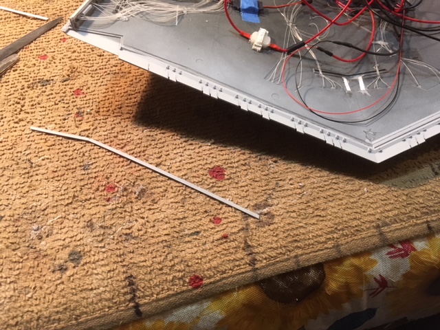

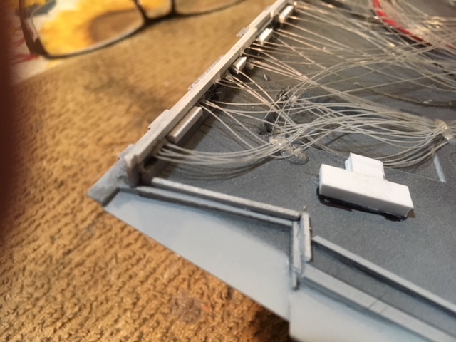

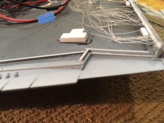

ISD eng fill strip.jpgI'm going to do back stops on the ends and build a magnet plate there as well as you suggested. I think it's all going to work out well. unfortunately for me, my mother-in-law is coming today for a two week stay...but that affords me more time at the table because they'll have me on ignore :lol
Looking good. The magnets will work out real nice. The backstop will keep it in the right position and block any light that might leak. For any of the LEDs in the back just make sure the tubes and the back of the LED are light blocked to minimize any chance of light leaking out of the engine block seams.

View attachment 786332I'm going to do back stops on the ends and build a magnet plate there as well as you suggested. I think it's all going to work out well. unfortunately for me, my mother-in-law is coming today for a two week stay...but that affords me more time at the table because they'll have me on ignore :lol
Thanks brother :thumbsup yes, tiny indeed. The ones I scratched were cumbersome to do, to say the least. Mine will probably be here today or tomorrow...I hope. As soon as I get my "shims" set in place I'm going to tape the upper and lower together to test fit the engines and I may have to scratch some braces to glue just past the engine panel to prevent sagging but it mat sit just fine on the stand with gravity, we'll see. I suppose attaching the magnets to said bracing would be a good idea. I think I'm getting pretty close to finishing this one, a couple more weeks I'd guess.

If the .5mm strips on the top and bottom give it a nice snug fit you should not have to worry about it sagging. That mid ship brace can also be adjusted to slightly raise or lower the top to fit nicely on the engine block. I noticed when I raised the walls 1mm that brace was still touching because the center had sagged slightly but not noticeable. You can also play with that to see if you can get the engine seam to a nice snug fit.

Well when I was fitting the back stop for the port side last night I noticed a little sagging and that's why I decided to do the light blocking strip just behind the engine panel, but then I don't want the noticeable gap either, light or no light. it'll work out though, kinda fun problem solving...sometimes :facepalm

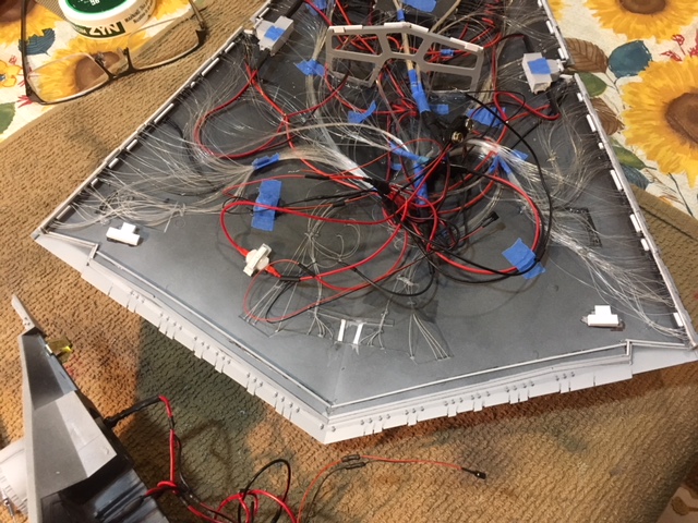

ISD ENG PNL1.jpegISD ENG PNL4.jpegISD ENG PNL5.jpegISD ENG PNL6.jpegnot much, but here are the back stops for the engine panel and the bases for the magnets (T shapes) and the light blocking "fence" just to the rear of where the engine panel goes. the last pic is some automotive door lock rod clips. I cut a small groove in the panel for the clip to hook to, bent what is the lower part to match the panel and super glued in place. I got some magnets mounted and it holds pretty good, but the magnets are kinda ugly. I suppose it doesn't matter what they look like as long as it works, and no one will see them anyway...but I'd hate for anyone to see them, certainly not you guys... so I think I'm off to Ace Hardware at lunch to see if I can't find pretty ones :lol
Thanks Buds, it looks a bit of a spaghetti mess on the inside...Escape does a better job on "neat and tidy", but at his suggestion of being more organized, mine looks better than it otherwise would have been :lol plus it makes working with it easier when going back to add or re-do something. but at the end of the day as long as it looks good on the outside and functions properly, that's the ultimate goal. I'm excited to see this one finished, and the other guys ISD's as well, though...it will be sad when this adventure comes to an end. This build has been more fun than I've had in a long time, all due to everyone's input and inspiring work they've done with theirs has made mine far better than it would have been. Cheers to all you guys!!! :cheers

View attachment 786536View attachment 786537View attachment 786538View attachment 786539not much, but here are the back stops for the engine panel and the bases for the magnets (T shapes) and the light blocking "fence" just to the rear of where the engine panel goes. the last pic is some automotive door lock rod clips. I cut a small groove in the panel for the clip to hook to, bent what is the lower part to match the panel and super glued in place. I got some magnets mounted and it holds pretty good, but the magnets are kinda ugly. I suppose it doesn't matter what they look like as long as it works, and no one will see them anyway...but I'd hate for anyone to see them, certainly not you guys... so I think I'm off to Ace Hardware at lunch to see if I can't find pretty ones :lol
I'm not sure about the magnets...I had a stack of 4 in the kitchen junk drawer, about as big as a quarter and about 1/4 to 3/8 thick. I tried to break one in half but it didn't break clean. but go two pieces out of it big enough. Like I said, ugly but functional. was going to go to Ace and see what they had.

Are you using the neodymium magnets for this? They are round cylinders and look pretty good. Can't do nothing about the glue because they need to stay in place and not pull out.
