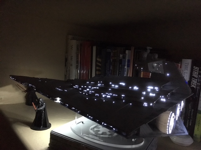

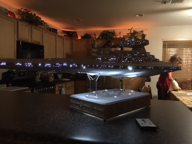

1/2700 Star Destoyer on the kitchen table

788440[/ATTACH]other than a few nick nacks like FO at the engine panel corners, this is pretty much it.
Such a beautiful job- base, light array, all of it. . Congrats on the finish! Though I'm going to miss seeing this thread bumped to the top.

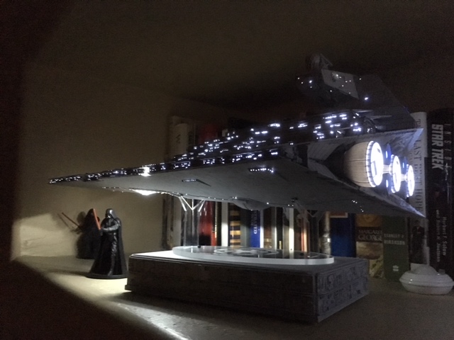

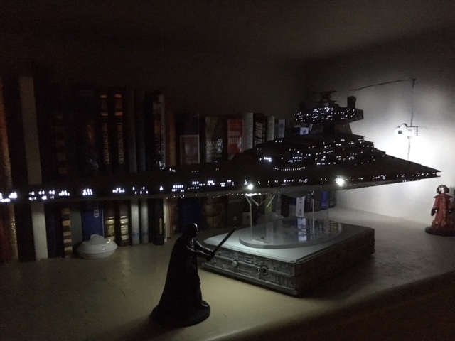

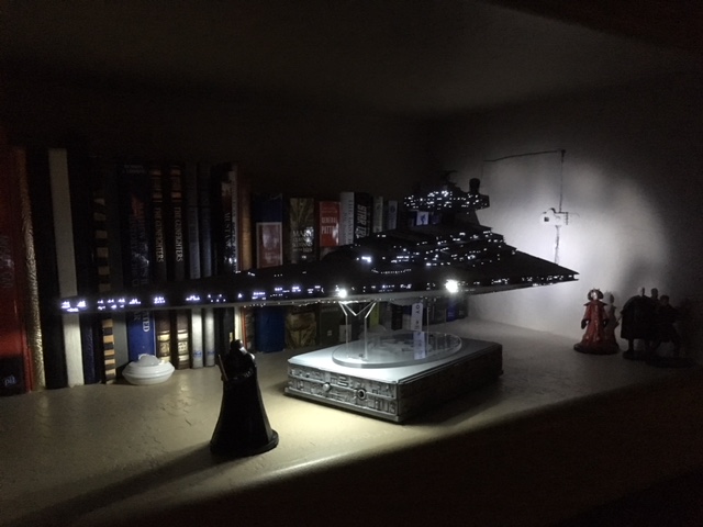

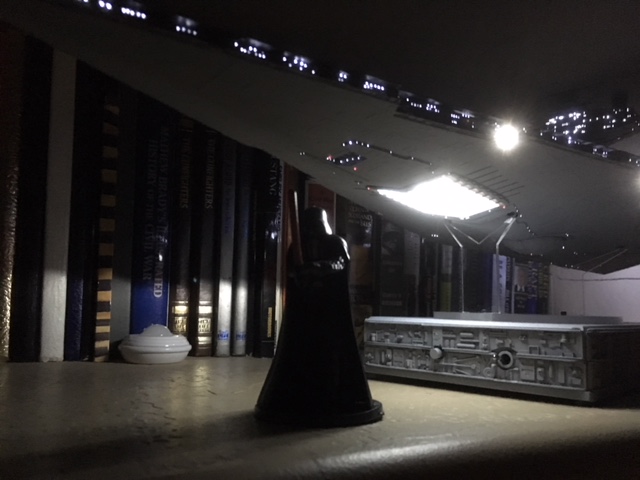

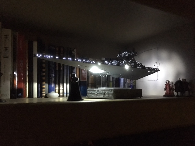

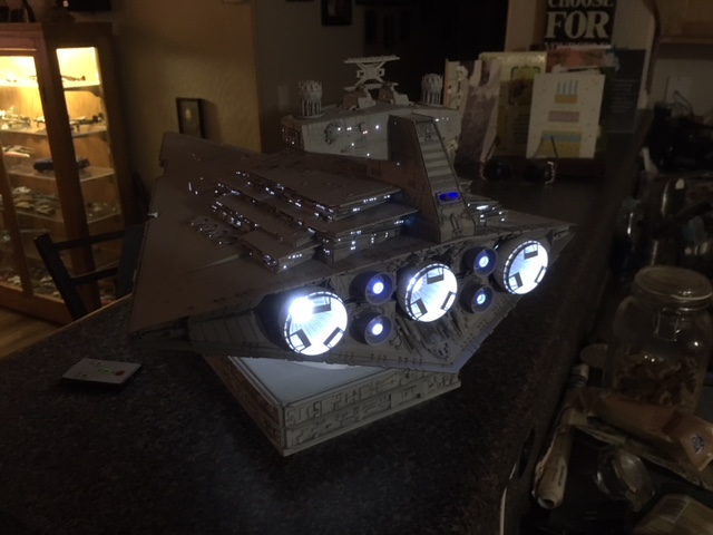

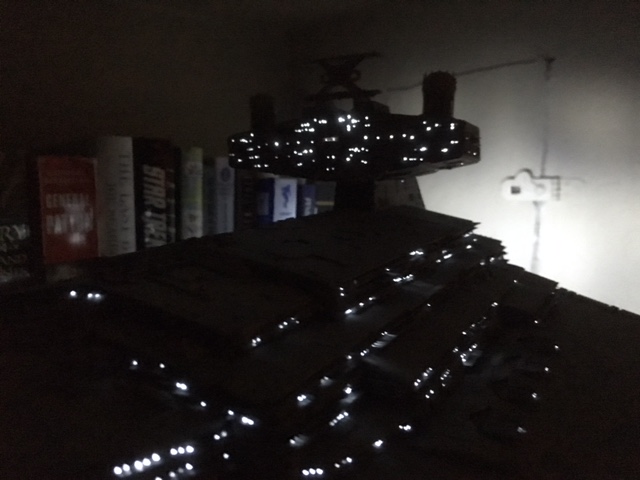

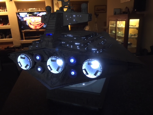

ISD VADER1.jpegISD VADER2.jpegISD VADER3.jpegISD VADER4.jpegISD VADER5.jpegISD VADER6.jpegISD VADER7.jpeg
View attachment isd vid1.MOVView attachment ISD VID3.MOV vids
Those pictures look really nice.....Keep them coming!
The engines look white....did you change them from blue or is that the way it looks in the picture.

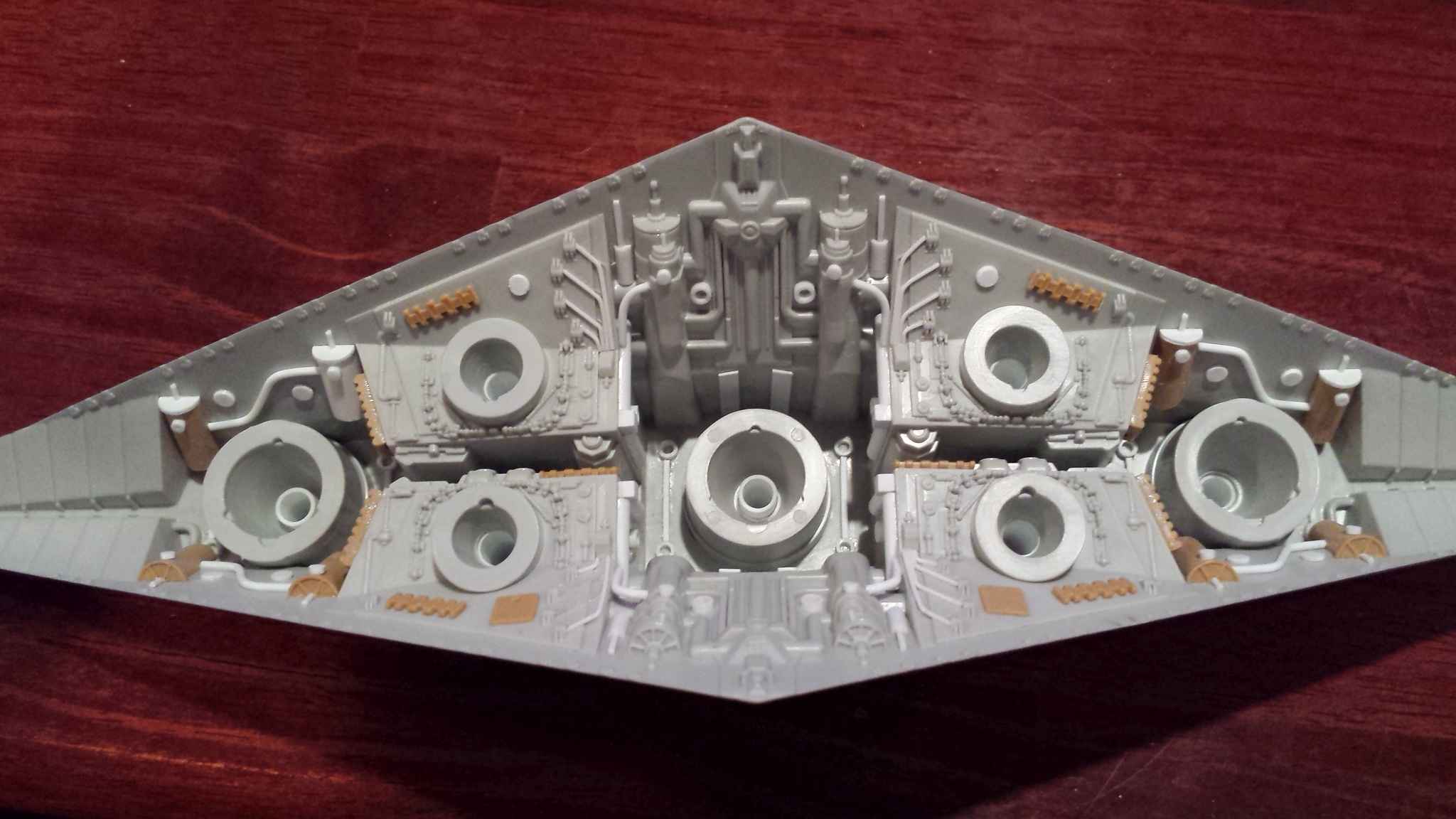

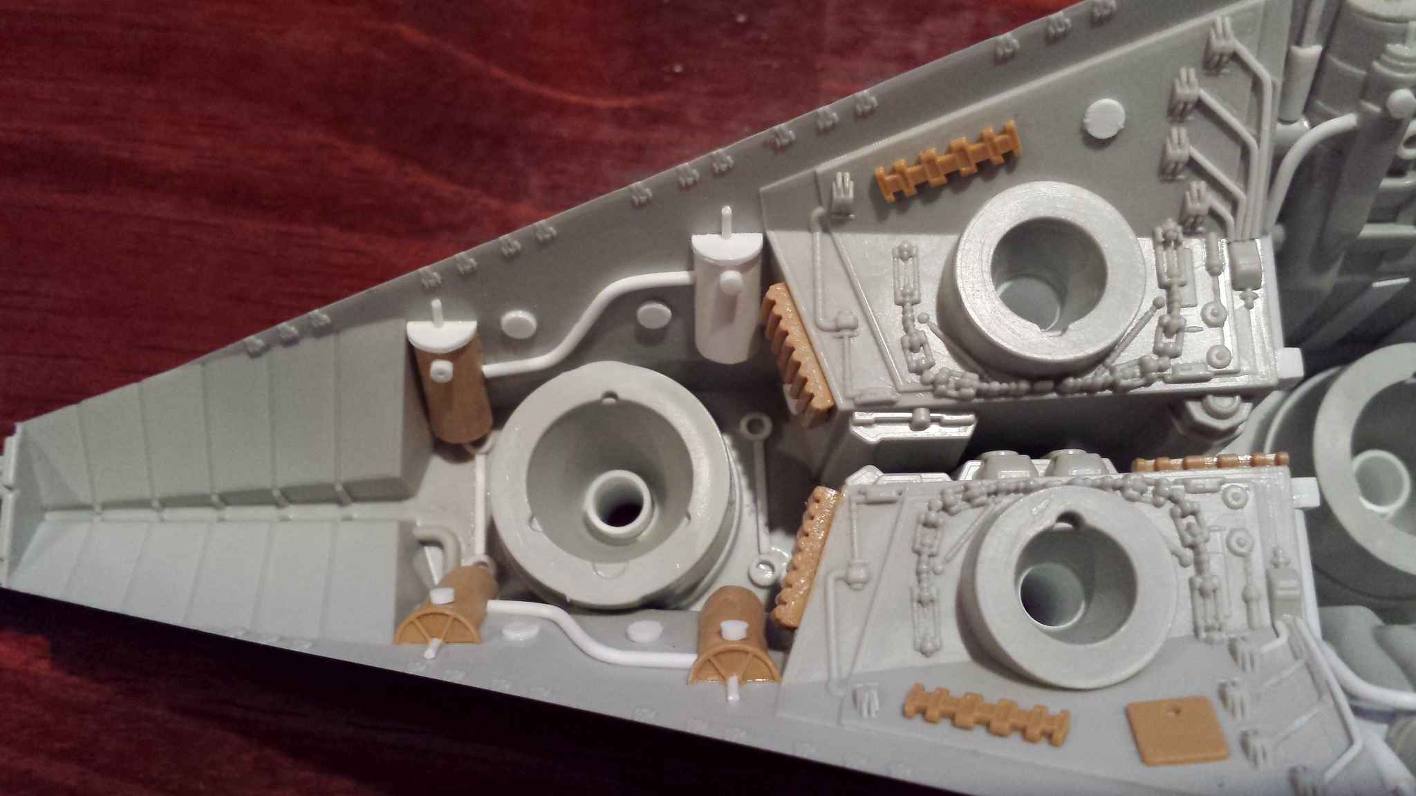

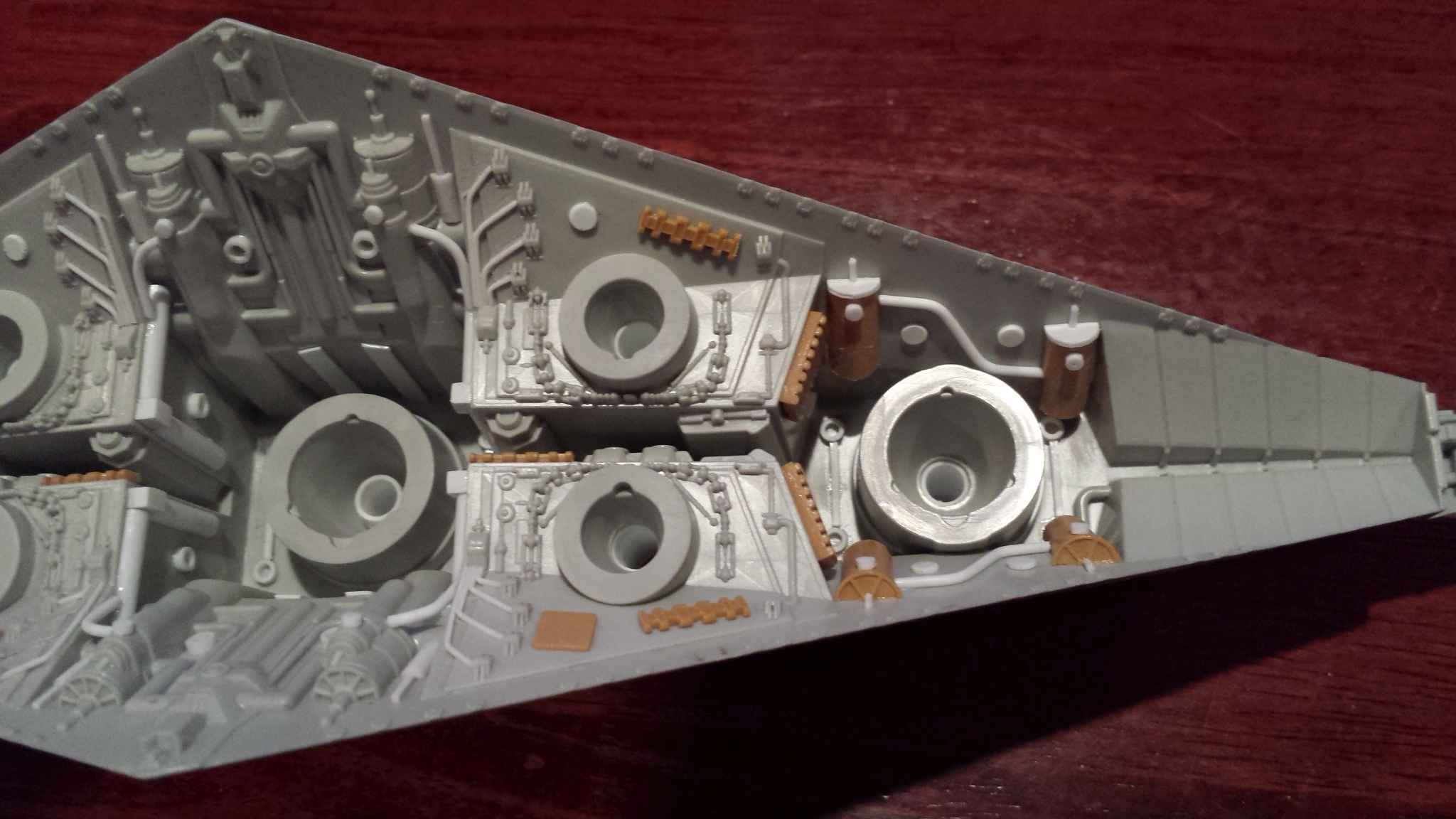

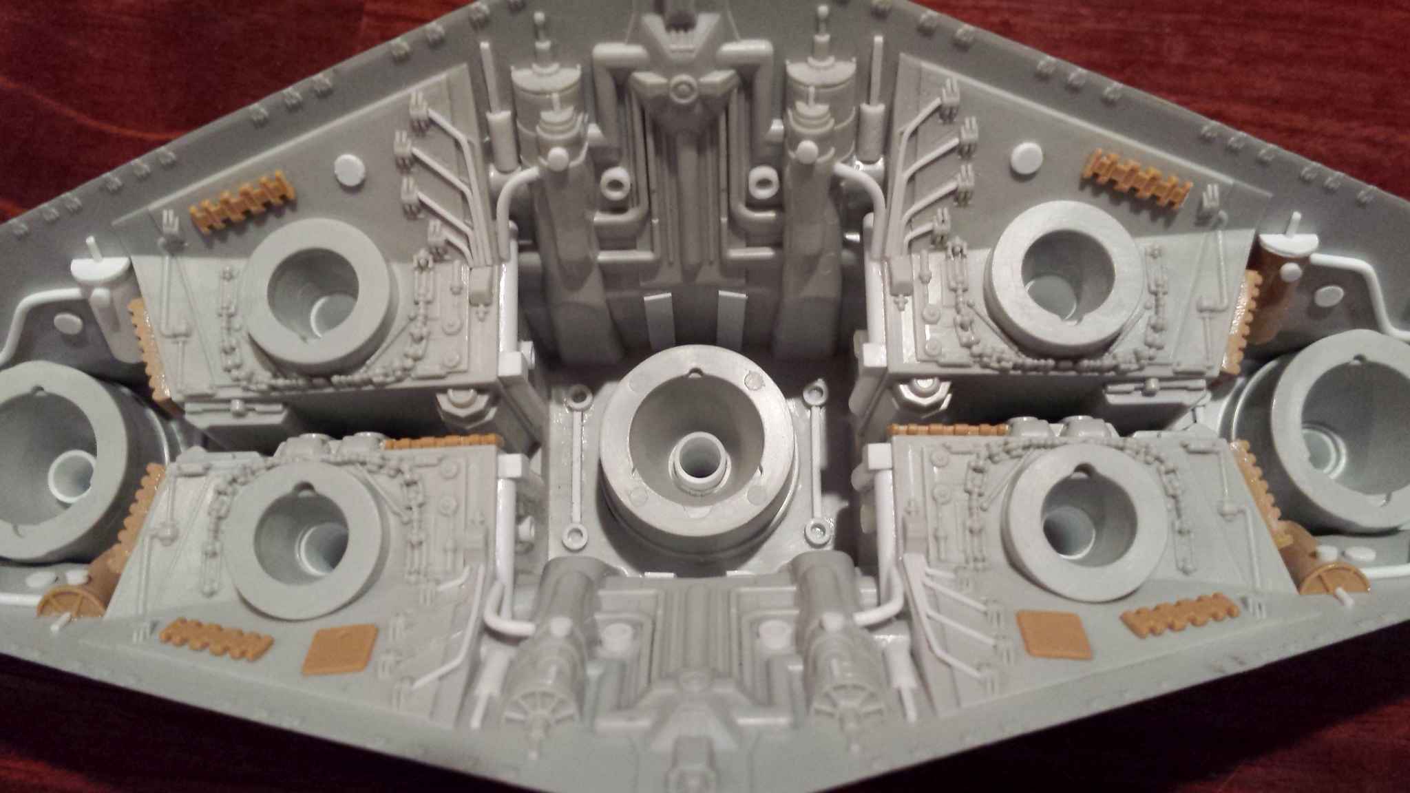

Finished engine block greeblie....did not go as extensive as you and Invar but I think I did enough to make those bare spots busy and worth a closer look. A lot is covered when the bells are installed but it's worth doing it.
20180121_214322smaller.jpg 20180121_214204smaller.jpg 20180121_214211smaller.jpg 20180121_214225smaller.jpg
Next is installing the electronics, cleaning up all the wiring, installing the LEDs for the engines and fitting the diffusing acrylic film in the engine bells.......
Hopefully priming the sub assemblies this weekend!!!
I agree, there's quite a lot of that you can barely see once the bells are in place. Those are some good greebs you got, what are they from? I think it looks just fine for not going full tilt on the greeblies. :thumbsup My 3 mains are white, but the 4 small ones are white that I sanded rough and put a light touch of blue Sharpie on, just for contrast. I see now that I didn't get enough paint on the mains...I neglected to prime them with the black so it wouldn't shine through :facepalm I suppose I'll have to separate the engine panel and carefully mask off the rest and airbrush some black or dark gray on the bells and reshoot the Corax, then wash again. oh well, there are worse things that could have happened :wacko

Those are from an Italeri 1/35 German halftrack with an antiaircraft gun on the back. The kit had these tanks the had 2 halves and were the same size as the kit ones in the center engine so I was able to make them for the other 2 engines. The ones from the kit are the tan ones and all the white ones I made.
Tank/Artillery kits have a lot of interesting parts that can be repurposed to create amazing detail.

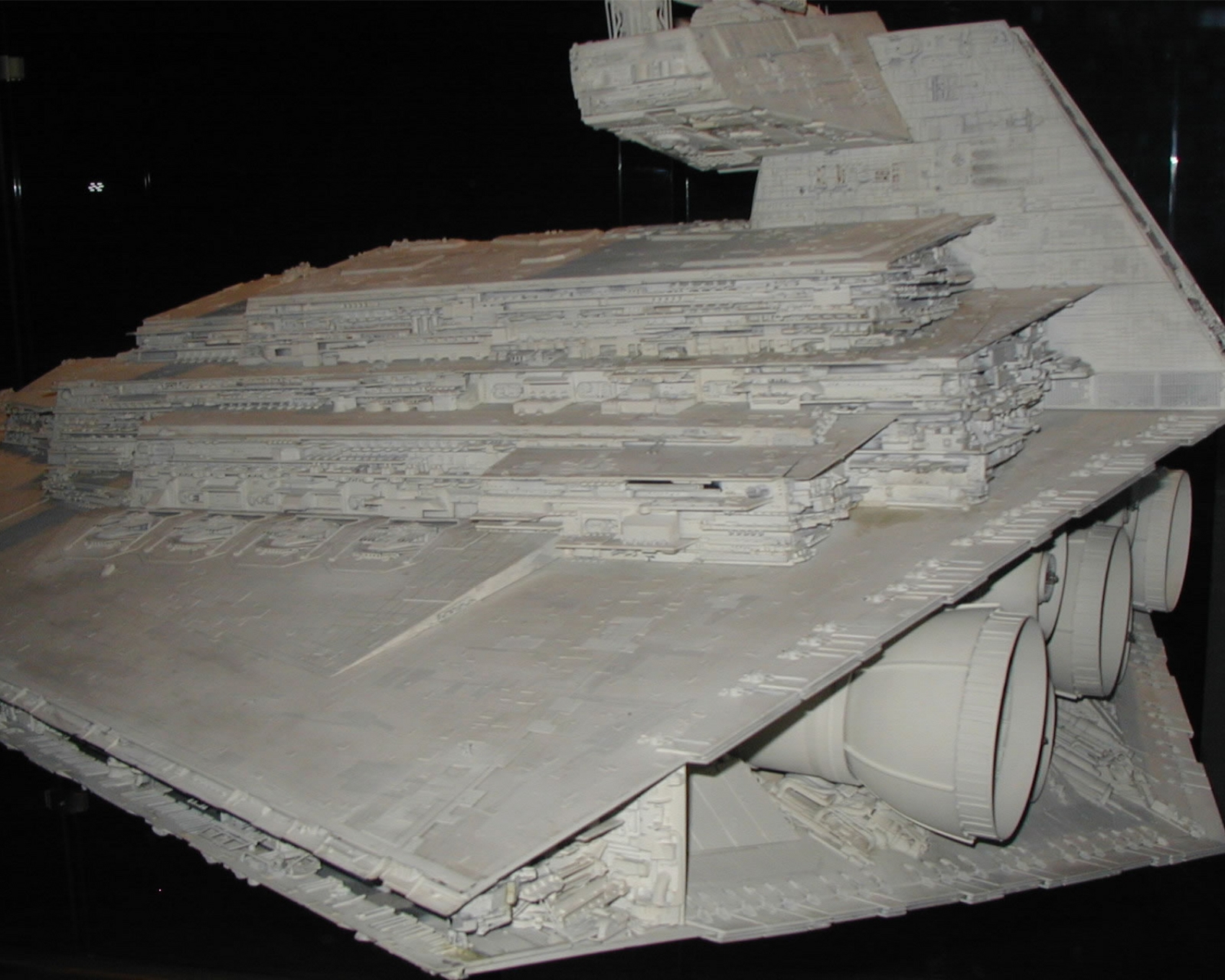

Yeah, the problem is not just that the bridge needs to be angled down, it's that the lines/angle of the neck are wrong. All the lines should be parallel with the top of the main hull, but instead the run parallel with the trench.
http://www.modelermagic.com/?p=19630
