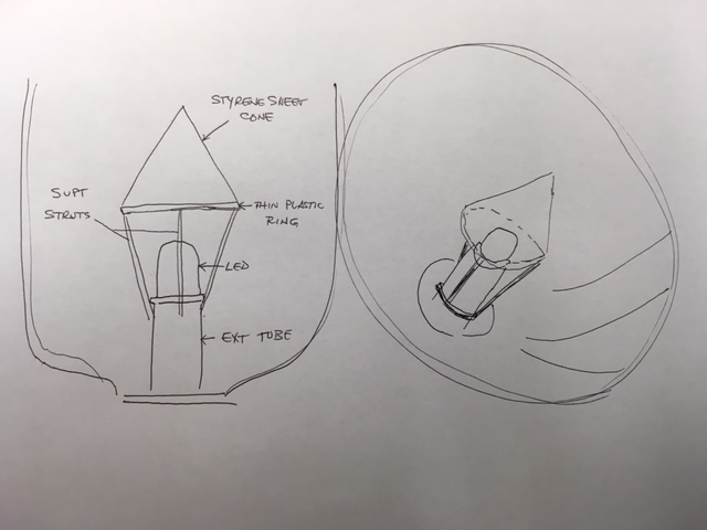

ISD bell lite.jpegI was thinking something like this...a styrene sheet cone that will still let the light through but conceal the LED, and reflect the light back into the bell illuminating it better...in theory of course. Sorry for the kinder-garden drawing...I did it on the quick but you get the idea, right? I'm going to give it a whirl this weekend and see what it does. perhaps a simple round cut piece of styrene bent to a slight convex would do it and not necessarily a cone shape?

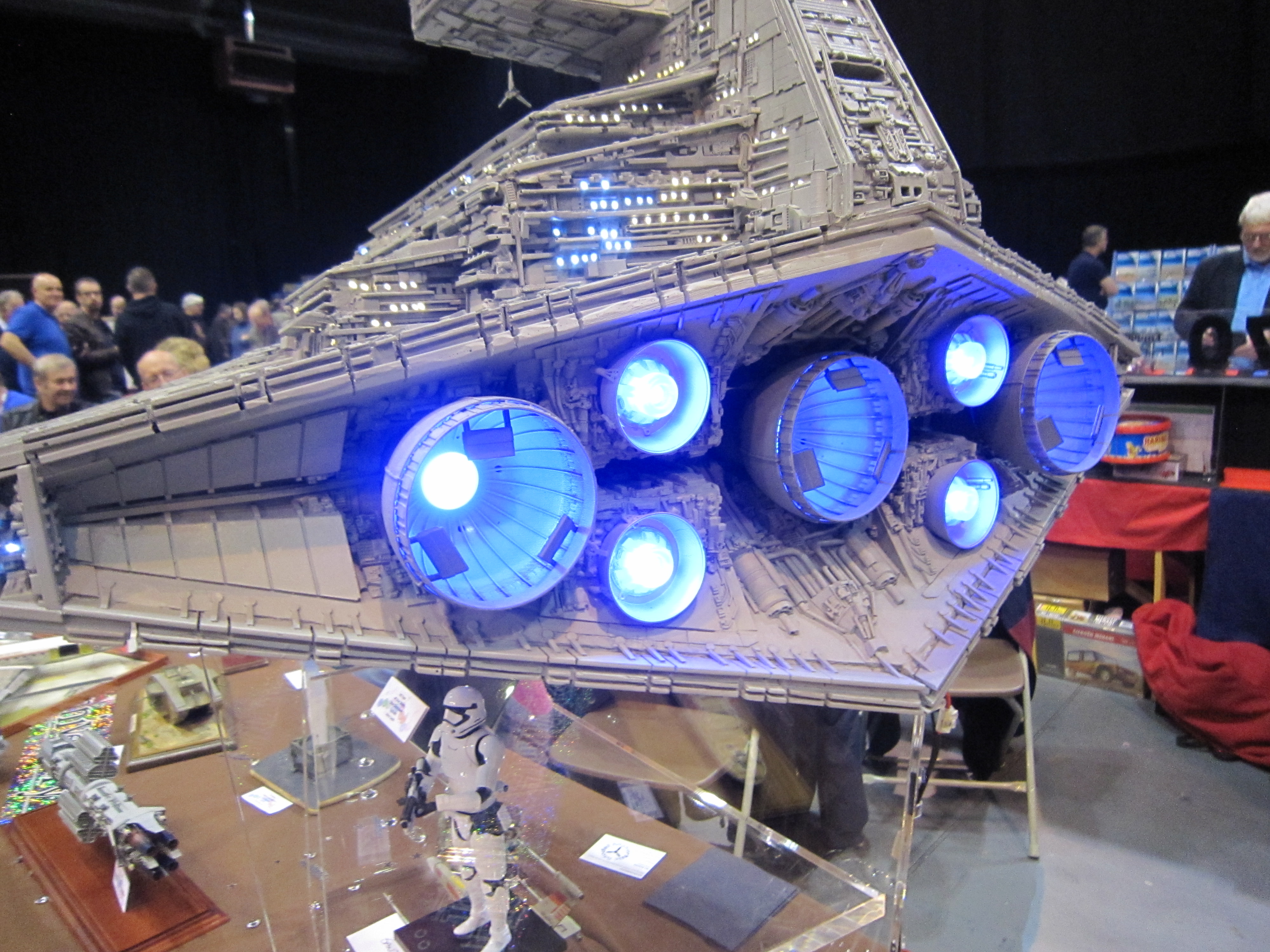

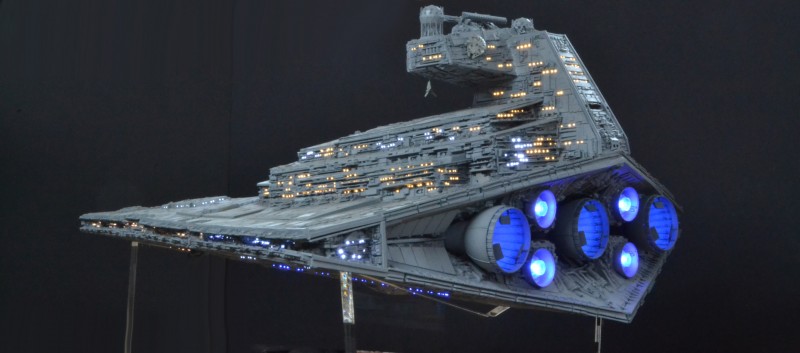

Really nice detailed work there mate ! Your second photo seems to show a combination of cool and warm white lighting !? Is that configuration taken from any screen shots or is it just what you wanted / liked ?

Hi Ged
Its actually an accident - I ran out of the original batch of 5mm white LED bulbs during the fibre optic set up stages and ordered a second batch of cool white LED bulbs. Unknown to me, I ended up building a kit with 2 shades of white LEDs. I tested each bulb before plumbing them in to the hull, and tested them once they were tubed up to the fibre tips but all this was done in daylight and did not show the difference in the 2 shades of bulbs that had got mixed up until I eventually lit the model up one night in the dark - to my horror, I had a multi-coloured destroyer !! - It actually worked to my advantage in the end; so many people have commented on the lighting shade variations saying it makes a difference and complimented me on working a way to make this big monster of a kit look different using alternative white shade bulbs - I've never confessed to it being a build oversight until now...

Hi mate
Always looking to help an Imperial flagship builder out so no problem and always happy to offer a tip - below are some pictures I took way back when I first got my 3D printed engines for my RC kit - I asked one of my model club members about the main engine bulbs and he told me to place them in the tube as far up inside as possible so that the illuminated bulb did not protrude and the light would emit equally - I confess to not knowing really how to best approach this but can offer you the pictures I took below as guidance - I know its a larger scale but the process worked. I also airbrushed the engine nacelles a shade of blue and eggshell yellow/white for when the lights were not on. The clear frosted diffusing material added the final touch to control the glare from the 10mm blue LEDs and the mirrored baffles that I scratch built have made it easier to look at and seem to add a tad more realism - hope this all helps.

without the clear frosted diffusing material

That looks cool like a car head light assembly!!
Gimme Shelter used a clear frosted cover over the LED to hide it. I will try that. It may let more light through while still hiding the bulb compared to the white cover I tested yesterday.
I think if you go with blue LEDs painting the inside of the bells blue and gray will enhance the blue glow look and if you go with white LEDs painting it white and gray will enhance the white glow look.
Of course painting it blue and gray with a white LED maybe cool also with a mixture of a white and blue glow.
One of those above combinations and the 3 baffles with a mirrored backing on each bell may be all that's needed to get the look we are all looking for......
[/QUOTE=gt350pony66;4373418]View attachment 781050I was thinking something like this...a styrene sheet cone that will still let the light through but conceal the LED, and reflect the light back into the bell illuminating it better...in theory of course. Sorry for the kinder-garden drawing...I did it on the quick but you get the idea, right? I'm going to give it a whirl this weekend and see what it does. perhaps a simple round cut piece of styrene bent to a slight convex would do it and not necessarily a cone shape?[/QUOTE]
Well, that's what I was thinking anyway, not sure if he extended the LED's like we have...I do have some light diffusing acrylic I use on the Falcon rear engine panel that works really well. Perhaps I'll cut a small circular and built a platform and support struts that will slide snuggly on the extensions that way I can move it in or out and see what it does. This is almost comical trying to get the desired effect for this, but I'm certain we'll get it where we want it...eventually:lol :wacko
