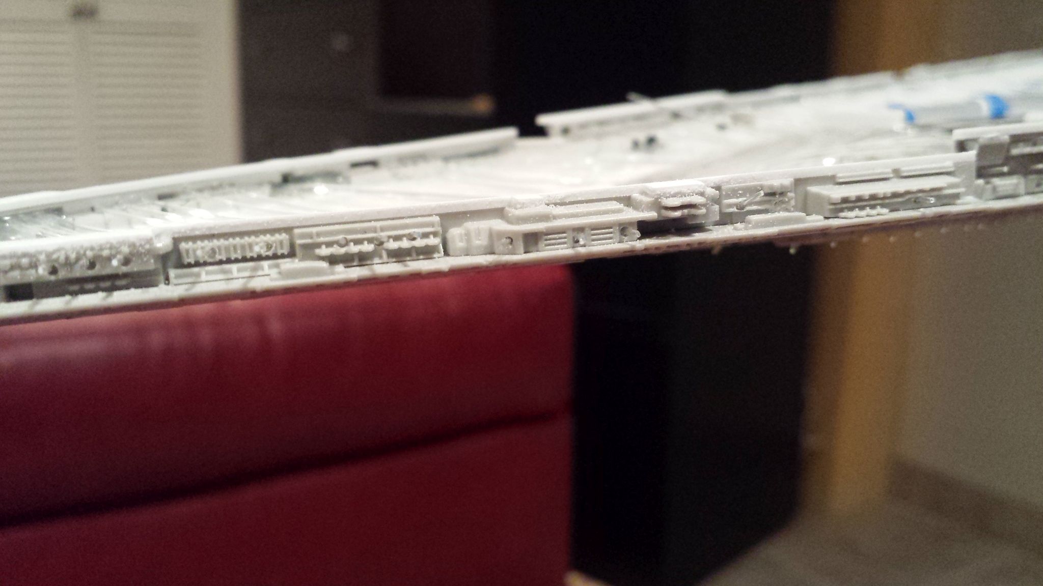

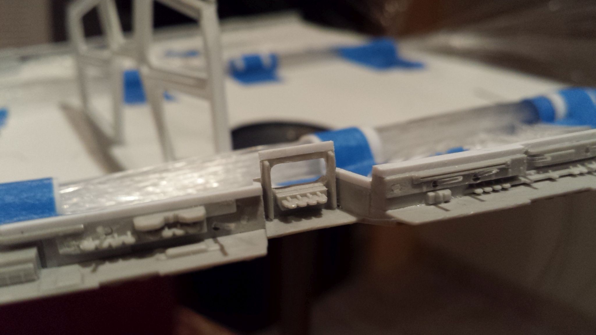

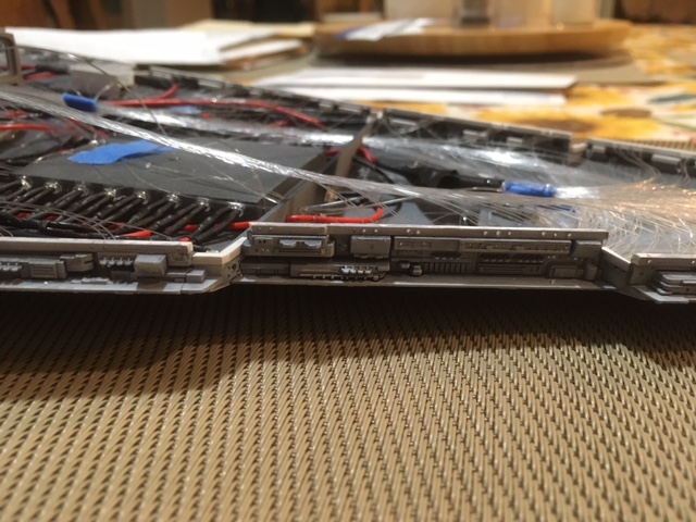

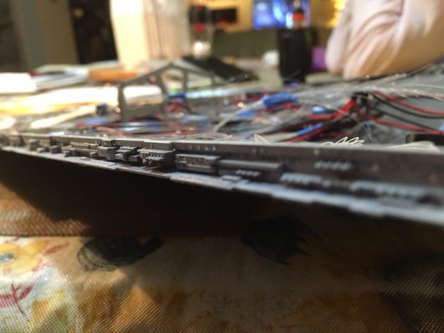

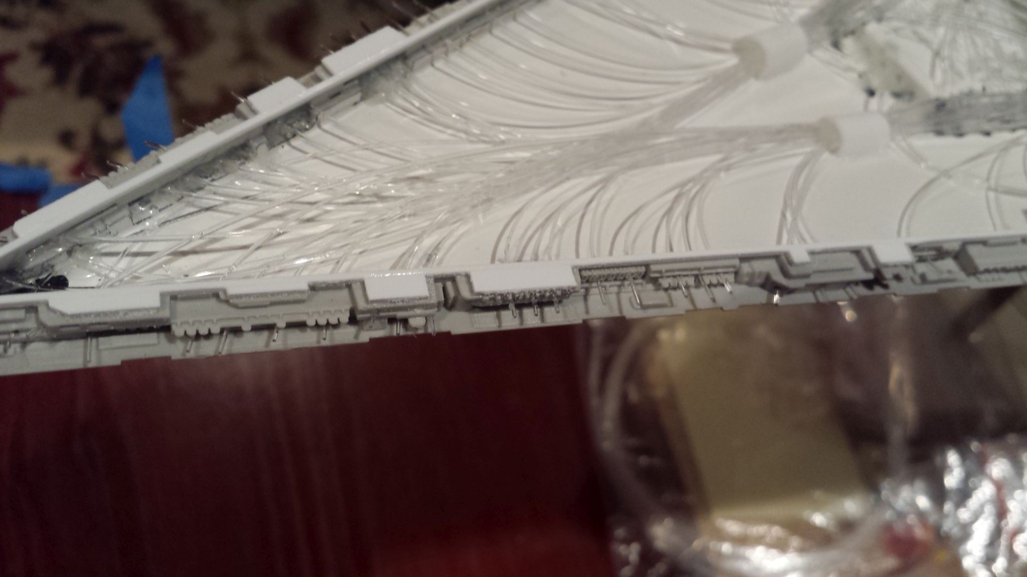

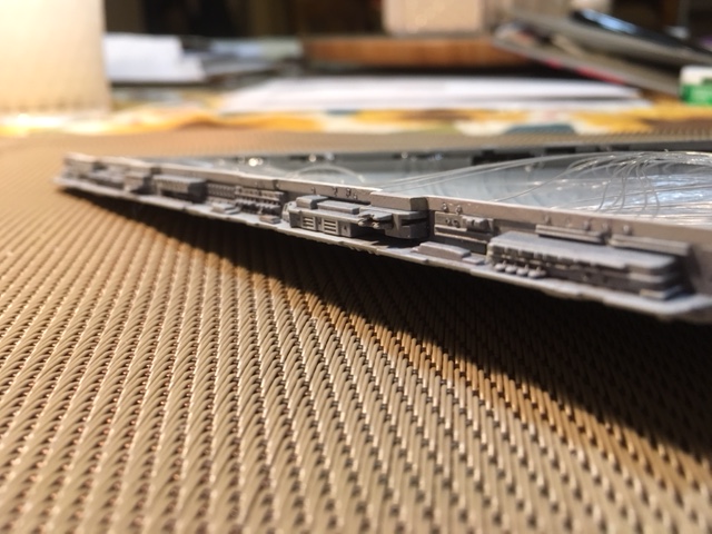

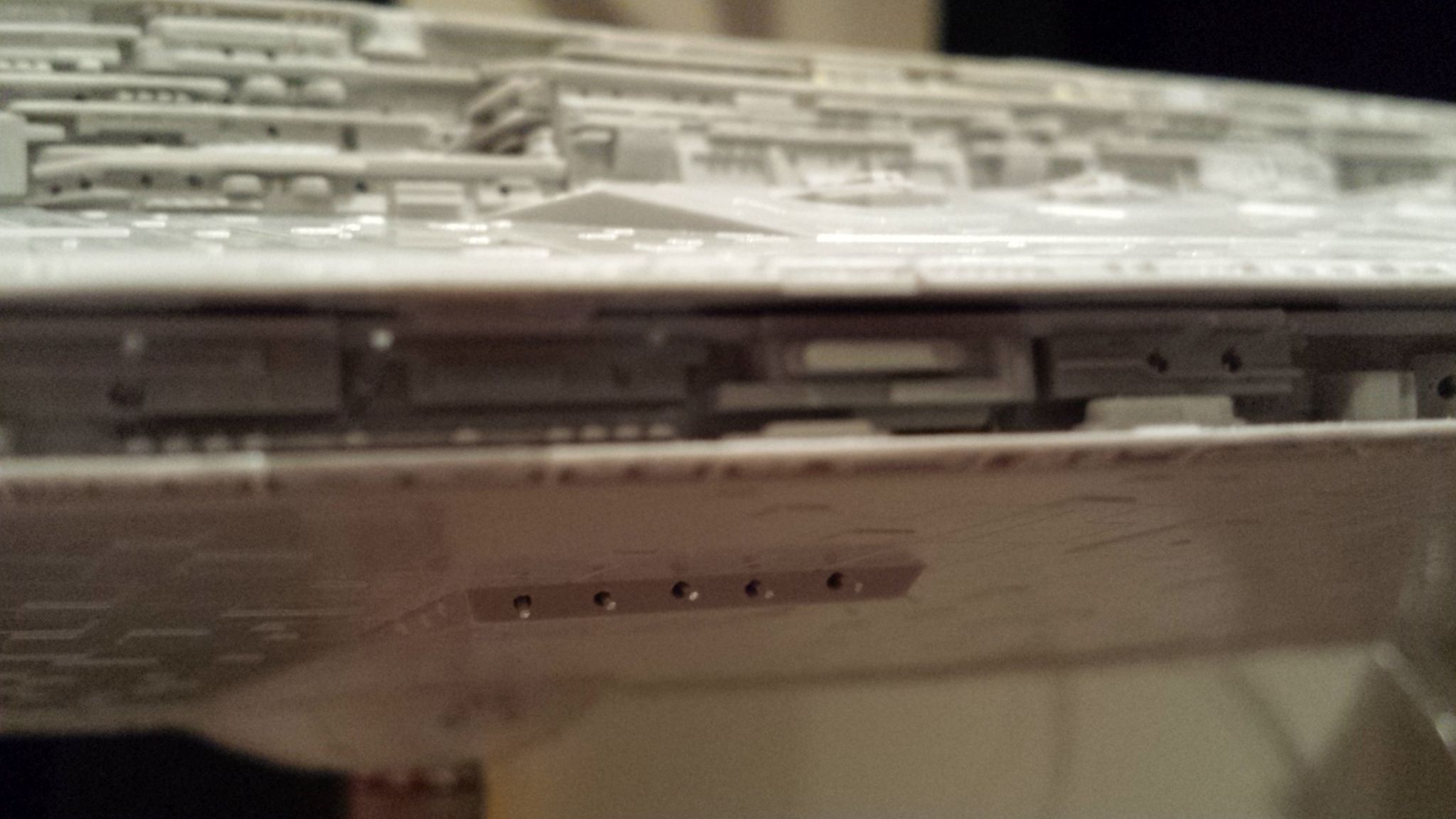

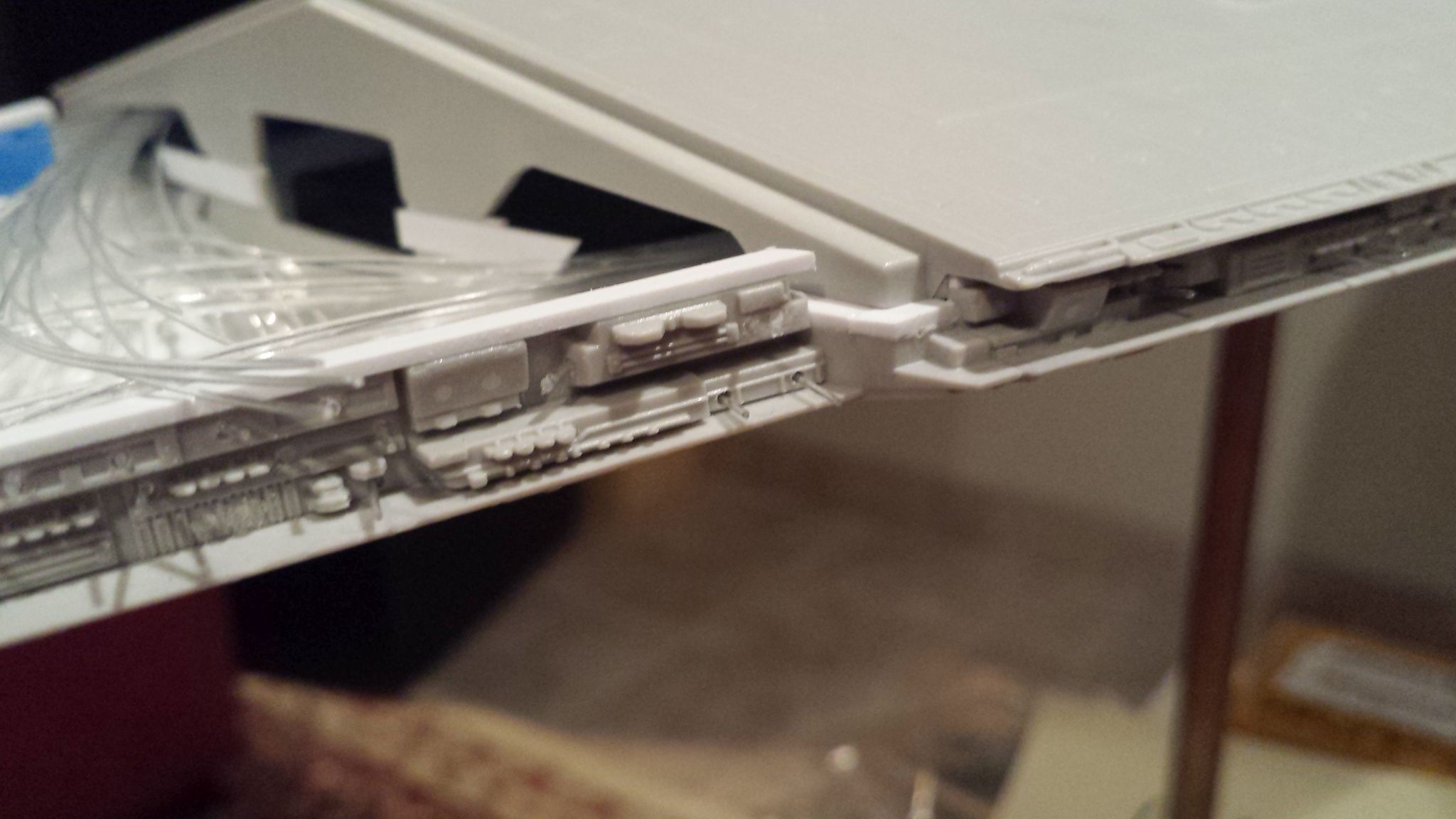

With only 1mm (.40) raised it's hard to notice any empty space on mine. Going to1.5mm and hanging in the air you would always be looking at that area when looking at the trenches so it would odd their is that empty space all along the top.
With mine in addition to adding a .40mm strip to the wall, I also added strips to the top of those areas that stick out past the wall which in turn breaks up any continuous line around the top.
I measured the new trench size from the inner top edge to the inner bottom edge on and it's almost 5.5mm
I thought about that when I began but when I raised the sides and placed the existing Zvezda trench pieces in place, the 1.5mm gap WAS noticeable to me. Especially since this model will hang from the ceiling just above eye-level (so the hangar bays can be appreciated) and the gap is much more noticeable. As I have been mimicking the 8 foot ILM Avenger, flat surface detail begs to be filled and broken up.

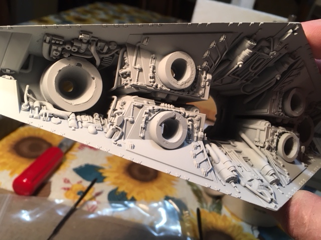

isd eng final1.jpegisd eng final2.jpegisd eng final3.jpegisd eng final4.jpeg for what it's worth, here it is. I had to fudge a lot so it only resembles Invar's a little, but overall to me it looks pretty good. Almost 2 weeks to do a slop copy of Invar's 3 months of research, greeblie gathering, scratch building, not to mention sizing things up so they appeared correct to scale...lots of work Invar, you are to be congratulated for your skill, tenacity and dedication to something you quite obviously put your whole heart into (y)cheers
I just noticed a few things I forgot...:facepalm:lol

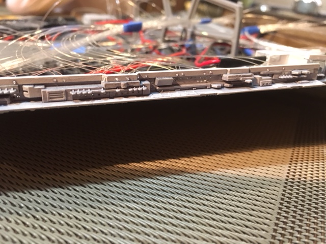

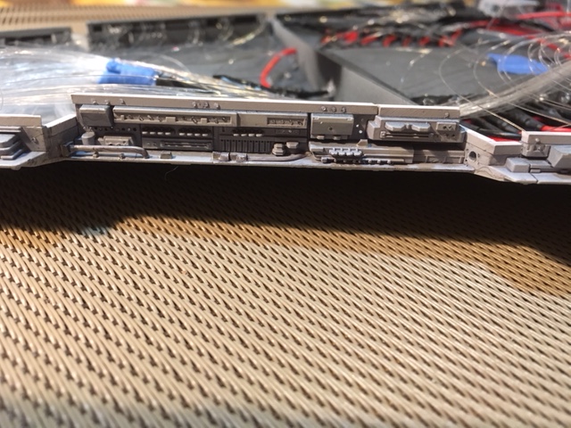

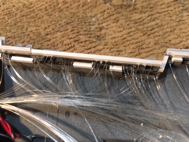

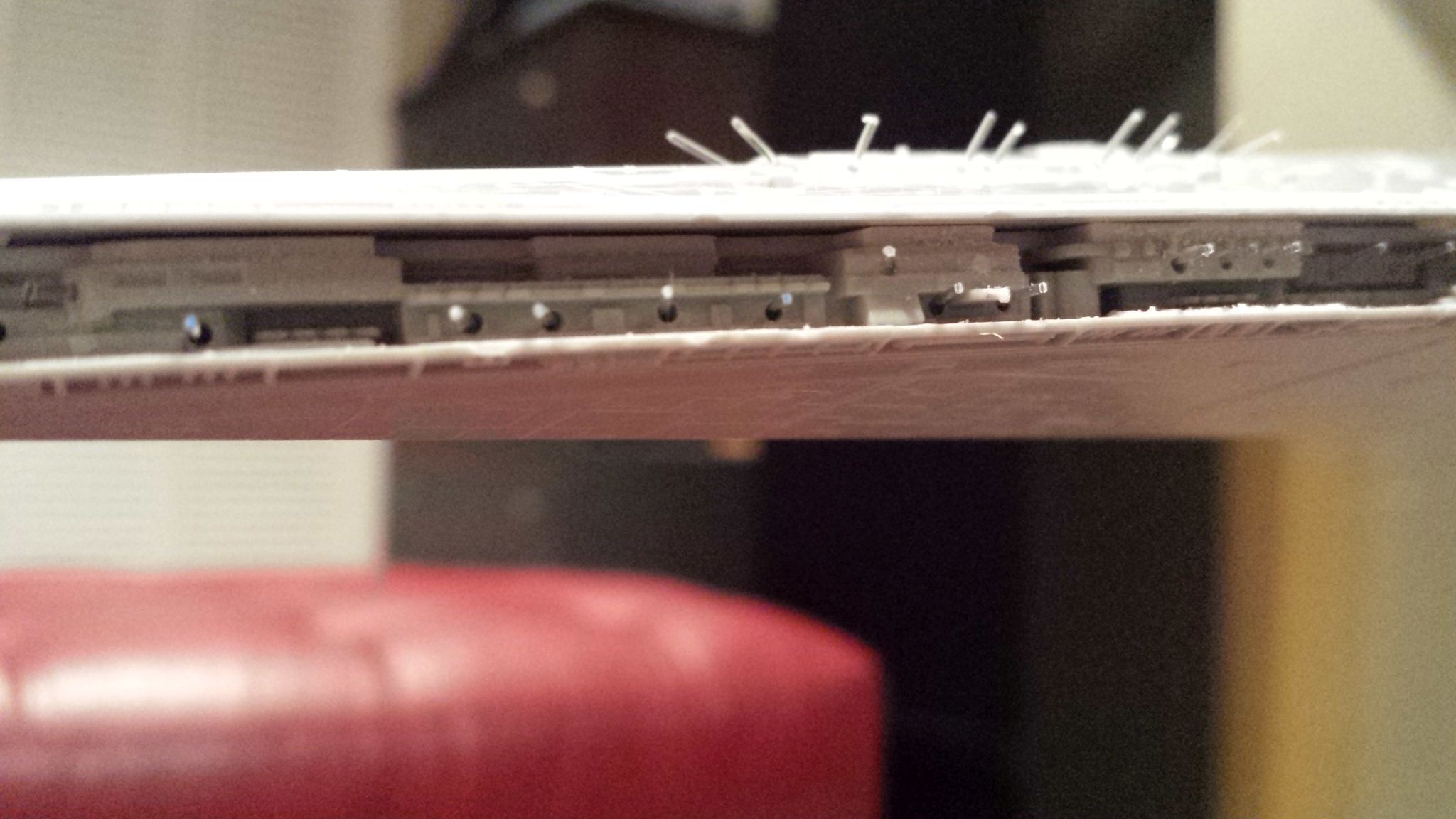

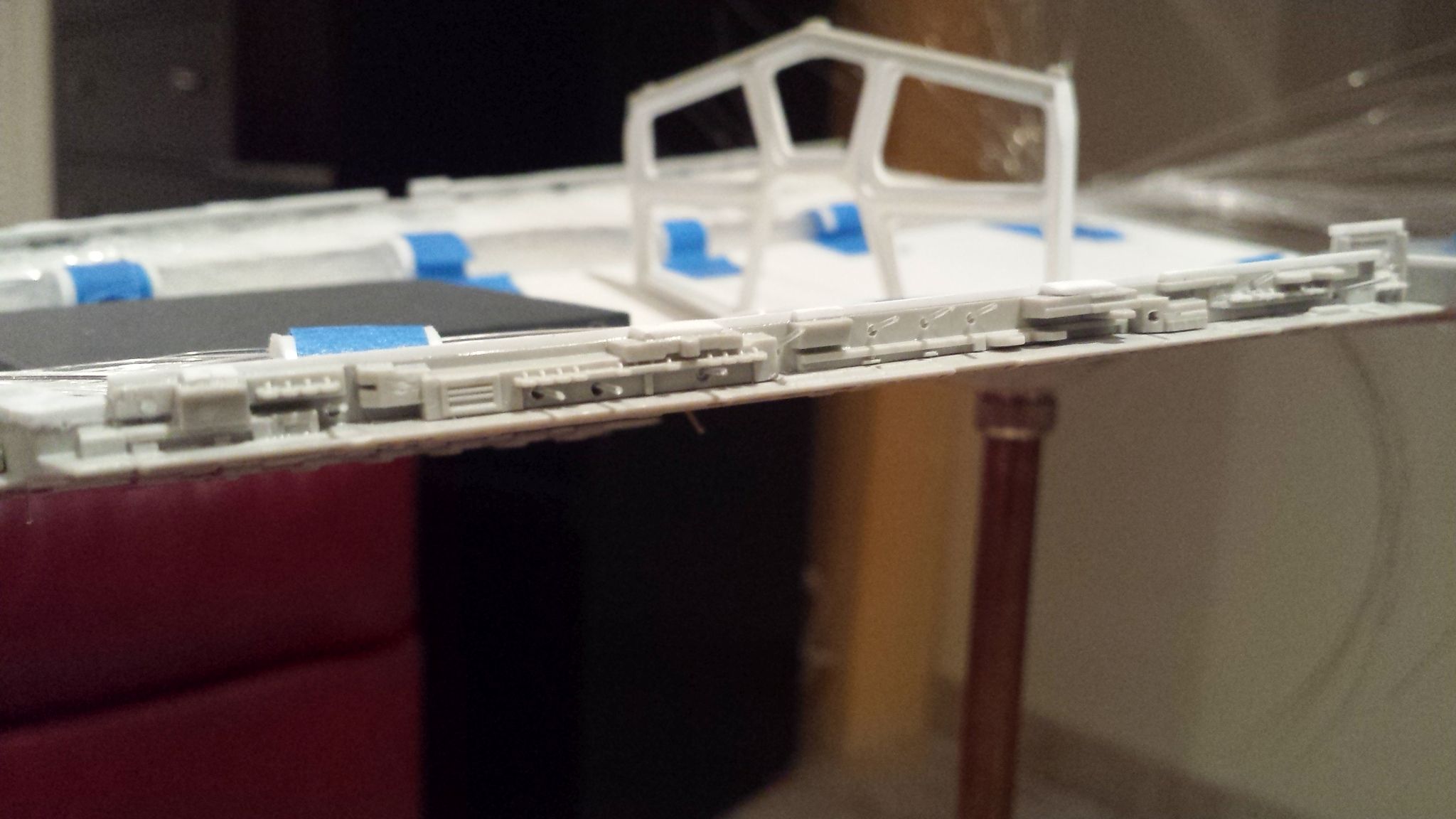

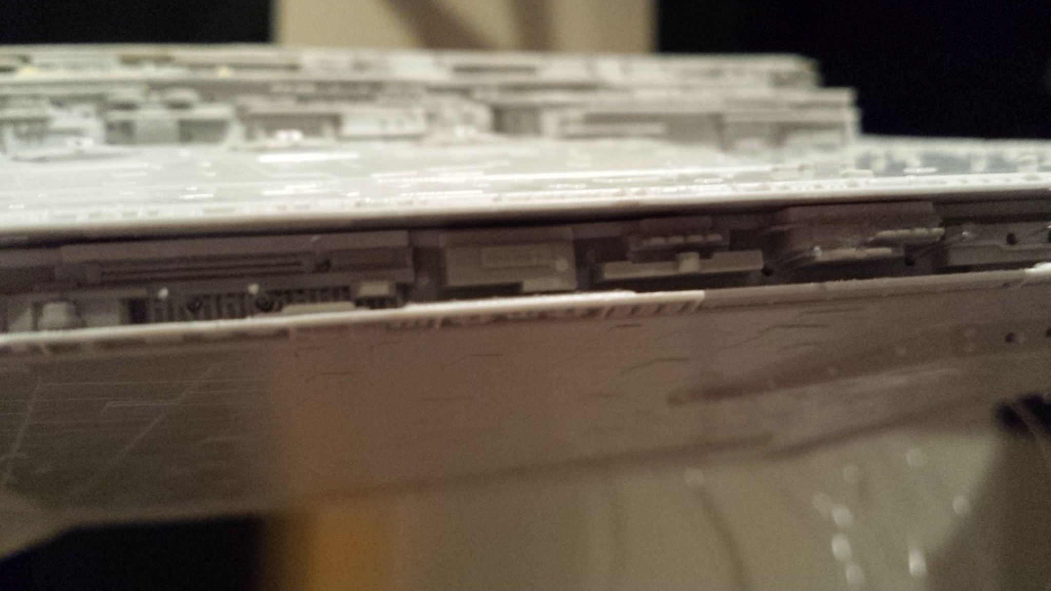

Pictures of the raised wall with .40 x .40 = 1mm
Some edges need to be sanded and when painted and washed it will all blend in and you will not be able to tell that it was raised.
I may also add some .10 pieces cut to shape on the side walls of the hangar bays and the other 2 areas on each side to cover the .40 pieces added that show up in the middle of the wall instead of puttying and sanding it to cover those seams.

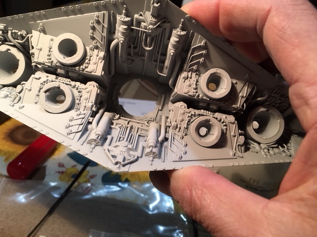

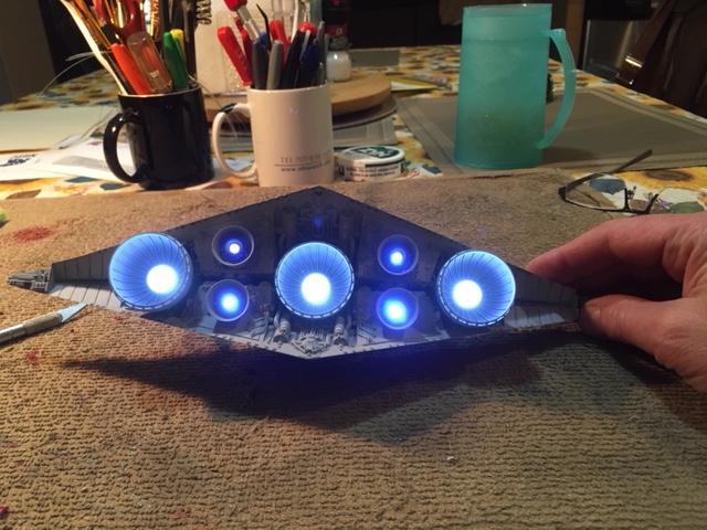

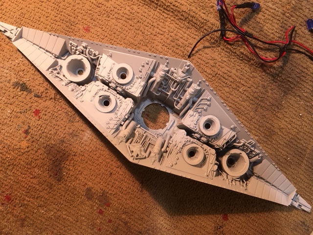

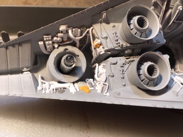

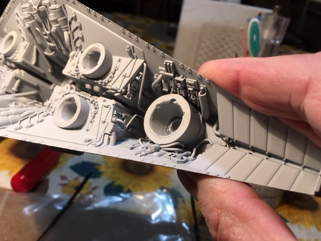

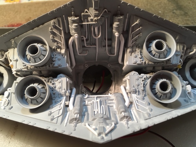

also, thanks on the engine panel, it's not as spectacular as Invar's by a long measure...but for what I managed to do I'm happy with it and glad I made the effort. if I ever do another one, knowing what I know now...it will be stellar :cool

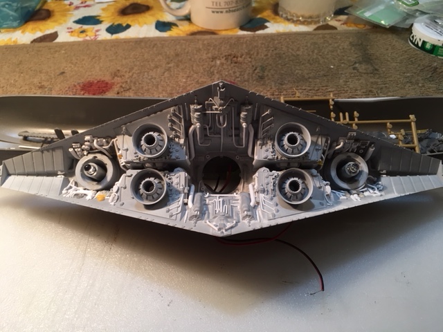

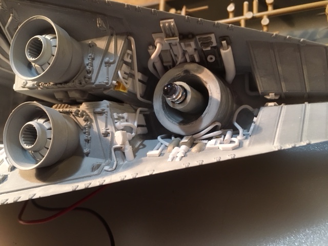

isdengpnl3.jpegisdengpnl4.jpegisdengpnl5.jpegisdengpnl6.jpeghere it is with color. I shot a light coat of Citadel black to even everything out, then hit it with 3 light coats of that Citadel dirty white I use. worked out ok, actually. I won't need to wash real heavy for the black coming through the dirty white. I did manage to pry the small bells off, why I used the kit parts I don't know. I probably set the 3D ones aside and forgot about them. So now it's on to the light testing Escape and I have been discussing. Then...it's on to the trenches:D have a Merry Christmas everyone :thumbsup

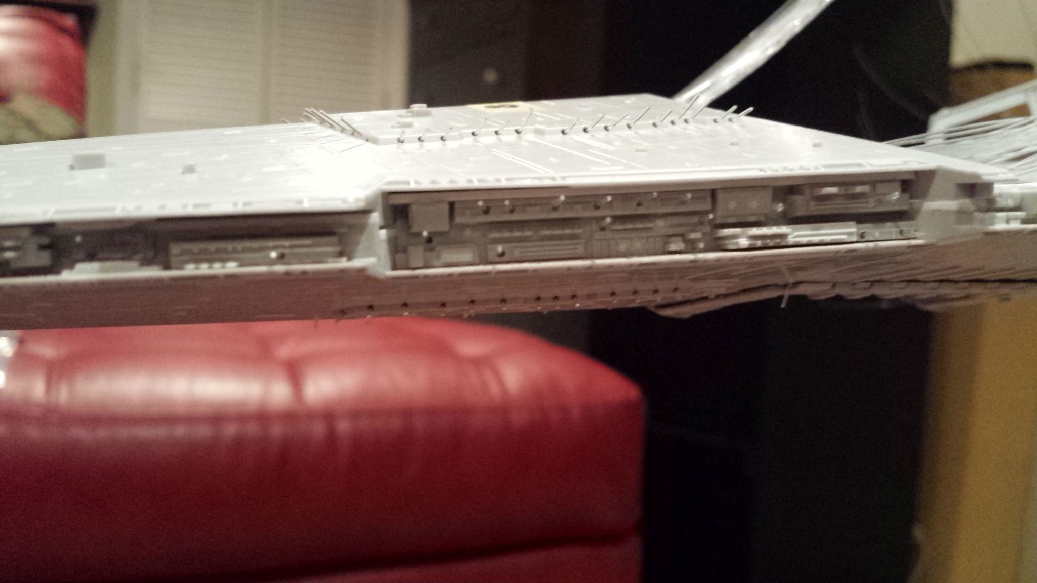

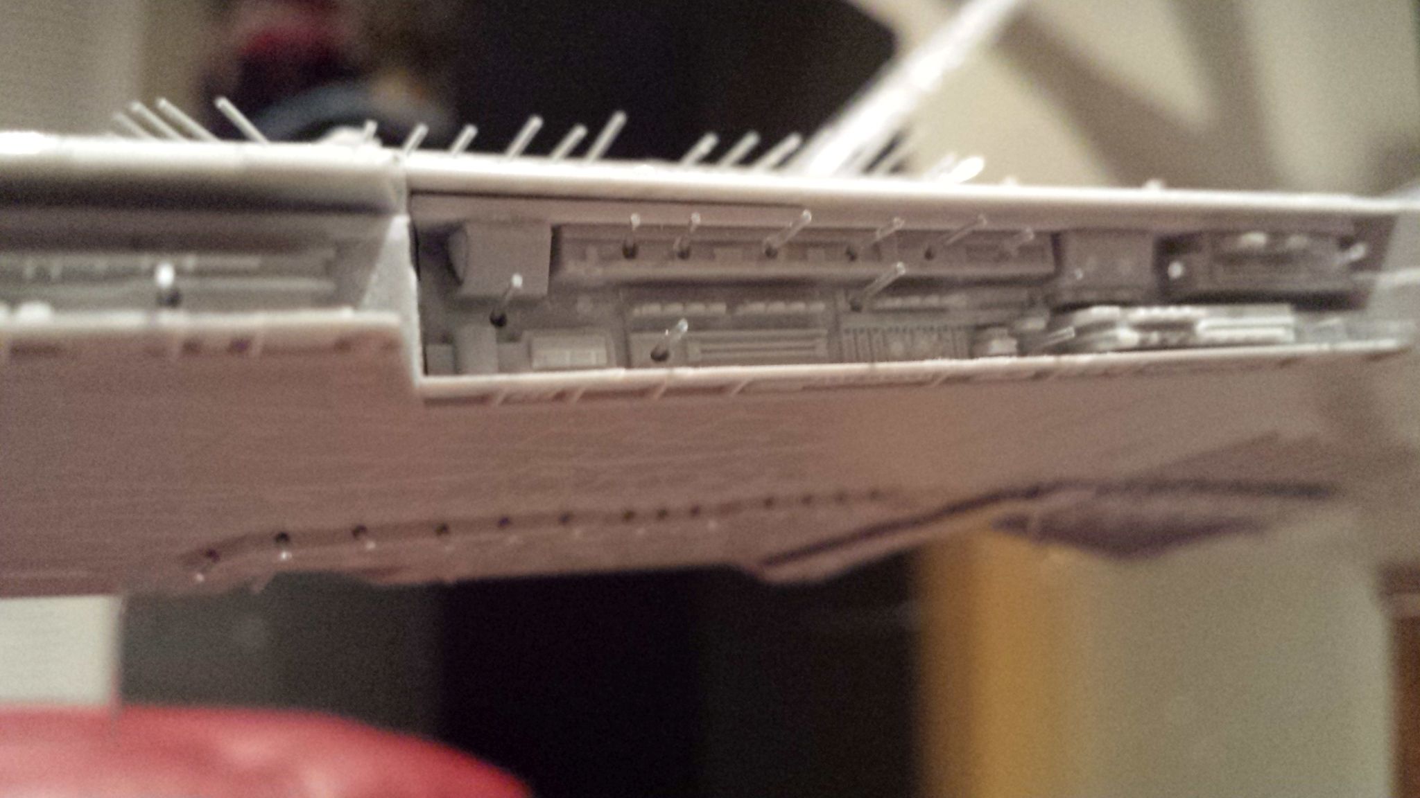

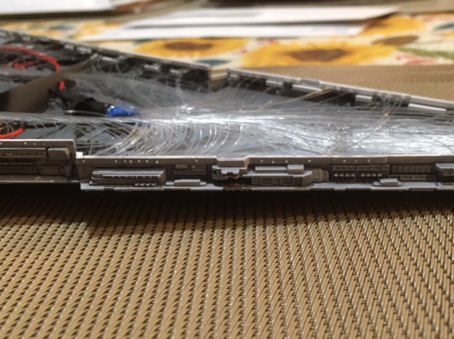

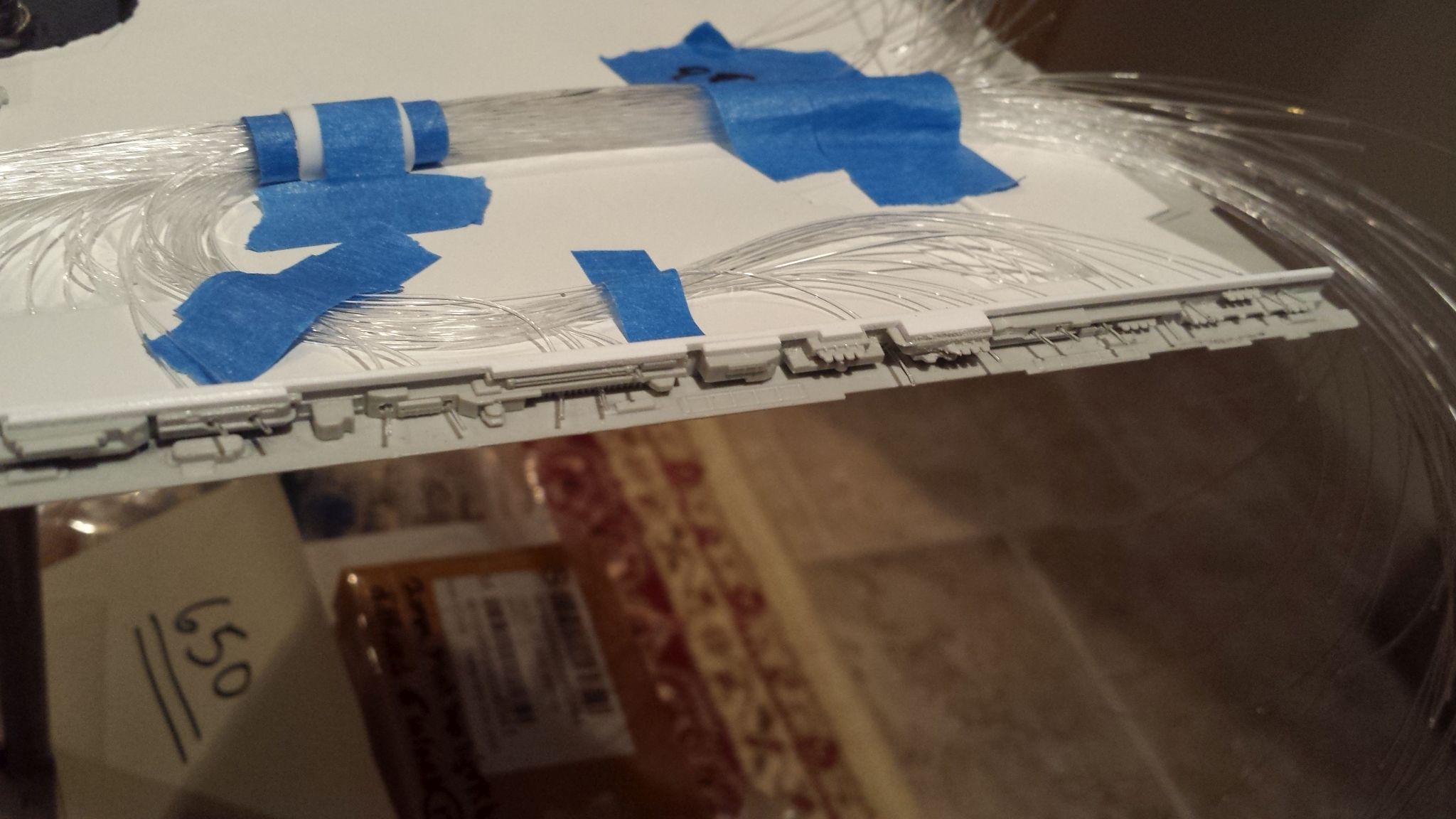

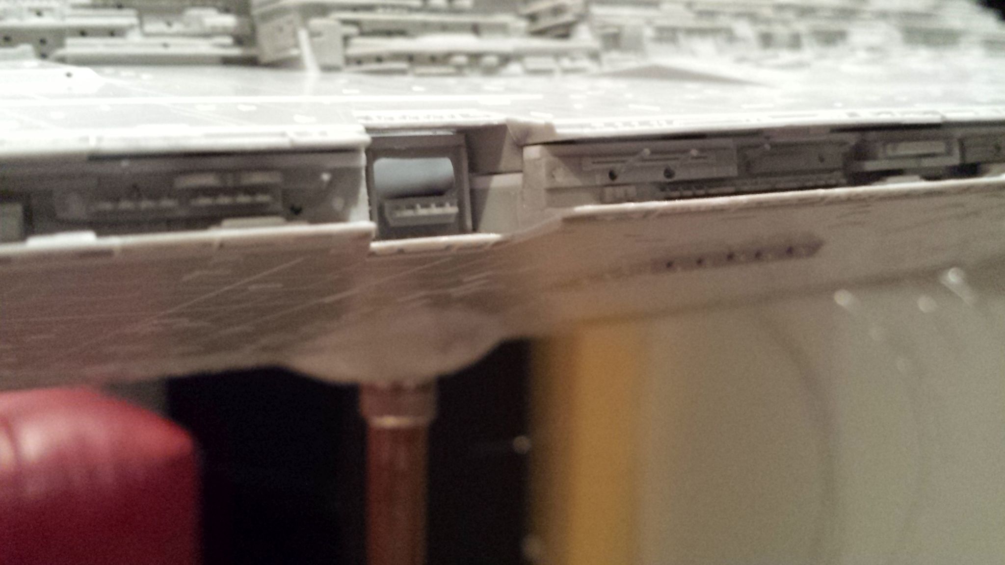

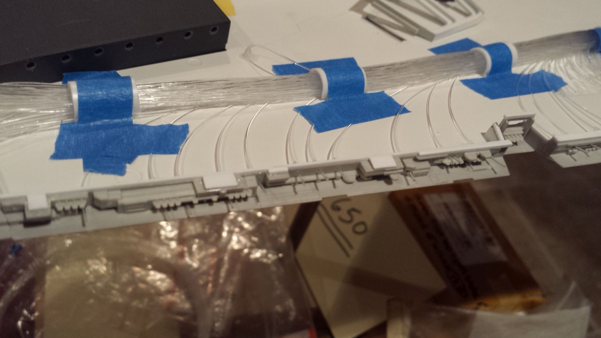

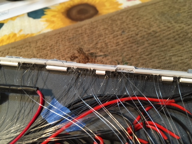

Then I started on the wall raising. I went with the 1.5mm because I really wanted to add more FO. I thought I was being sparse, but by the time I drilled one side, I had an additional 92 holes! I staggered the pieces and angle cut them so they'd look like something that belonged, or tried anyway. I first glued down short pieces of 1.5 where the upper hull "teeth" would have made glue contact, then I shot a few strips with my hull color. cut pieces to fit. Then I touched up the cut ends with some model master gull gray that matched pretty good. Then I watered down my wash, and applied with a small paint brush. It matches pretty good. The wall raising is a lot of extra work, but looking at it now, it's clearly a must do for this kit. Invar, you're the man for recognizing all these things that need to be done to this kit...and then tell us all how to do it :cheers:thumbsup
...you know, I wonder now...what would be terribly wrong with adding still, a 1mm strip to the top of the 1.5? leave it blank for the most part? maybe a pipe and a block of something here and there? Invar, since you started all this with the trenches, your thoughts on this? Heck, anyone? I was looking at my portside wall last night, then I set the upper hull on it and put a piece of tape here and there to hold it while I stared at it. Would it throw off the look that badly? Sure it's more work, and then there's the engine block gaps and the center support to consider. But I thought I could put some red flashing FO above the tie hangar doors so it wouldn't look like a vast gap there...am I going too far????
Invar stated that it was a matter of personal preference, but I get the feeling he wouldn't recommend it. So, as our foremost authority on ISD's I'll defer to Invar on this matter...which saves me a lot of work really. Anyway, here's some shots of my wall raising as seen from the backside. The white blocks of 1.5mm x 1.5mm is the glue contact points. The of course the other painted, is the actual trench wall. It still looks a bit bland on the outside, in between the FO so I've gotta greeb it up some, but something simple.ISD trench1.jpegISD trench2.jpeg
The bells look awesome & raising the wall came out perfect!!
Not sure if I would add another 1mm to the 1.5mm you already did.

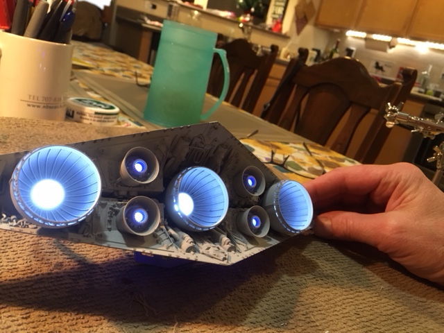

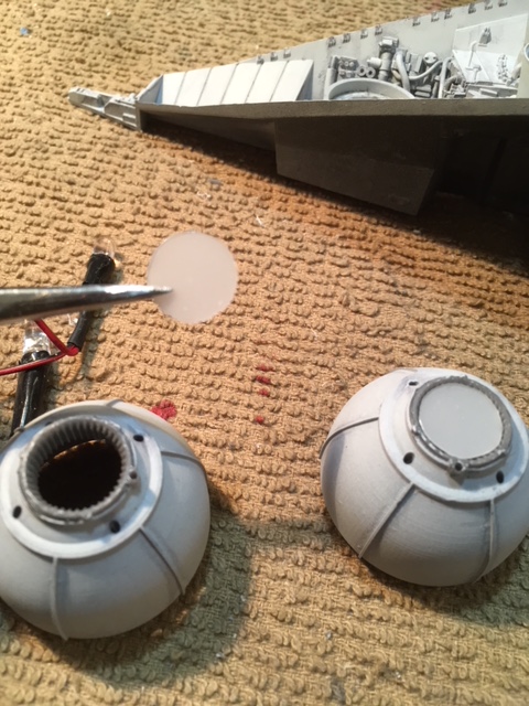

Where did you get the light diffusing acrylic?
The diffuser is the best option to hide the LED and spread out the light inside the bell.

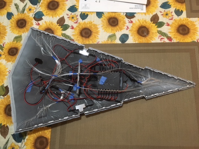

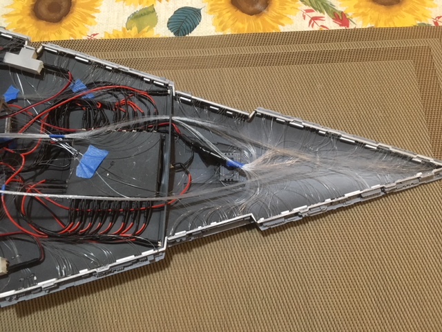

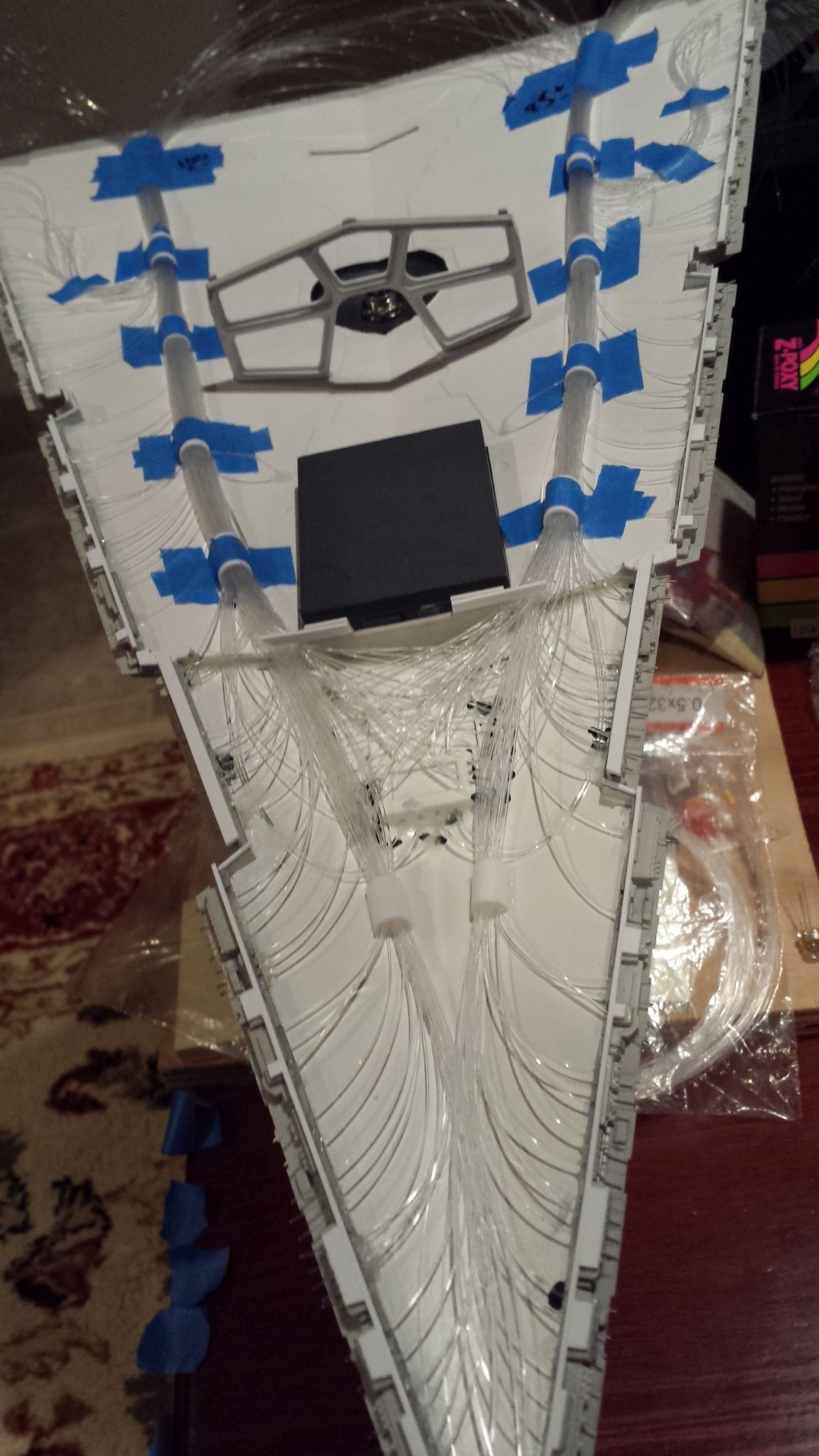

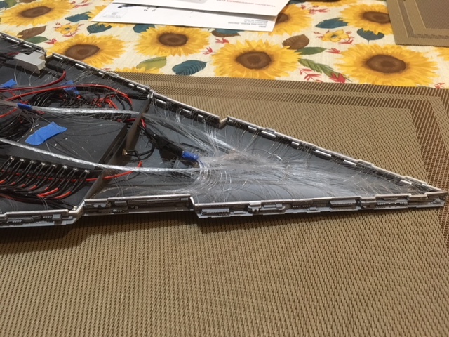

I just finished lighting the hangar bay and trench hangar. I have approx. 75 more FO to install and then onto the engine greeblie upgrades. Then assemble the ship and get ready for paint.
I ordered 2 cans of the Citadel Corax White. What primer did you use under the Citadel?

Thanks Escape! I'm happy with it. Well, I didn't use a primer coat, my hobby shop guy said it wouldn't be necessary with this paint, however I probably should have for a richer finish. yes, I sent Invar a PM asking his opinion. He said I could add if I wanted, but it sounded like he wasn't in favor of that, stating it would probably make it look too much like the disproportionate MPC ISD. I saw the logic and decided against it. I'm going to have to find some items that will busy up the longer blank areas between the FO anyway. The acrylic I got a sample pack from a place on-line but I'll have to see if I still have the USPS envelope they sent it in with the name on it. There's lots of it though. If I can't find the name, you could send me a PM with your address and I'll lop off a chunk and mail it to you, no problem. it did work out really well, don't know why I didn't think of it in the first place seeing as that's why I got it for the Falcon's :wacko

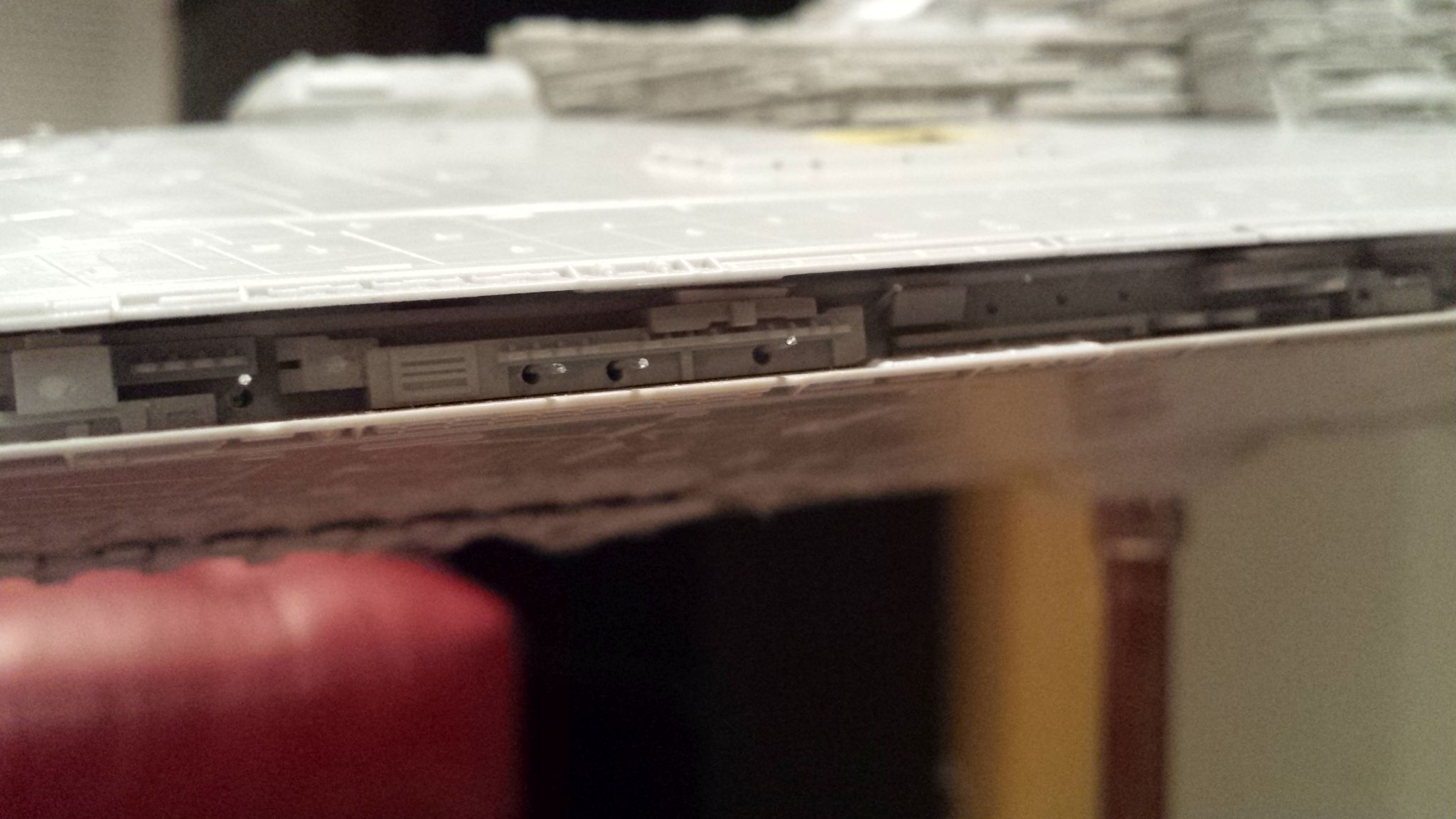

Here is a link to another SD that the walls were raised a little too high:
https://www.therpf.com/showthread.php?t=274245&page=2
Glad you left it a 1.5mm

If you cant find the acrylic diffuser address let me know and I will PM you......I like how you did it from the underside of the bells showing the gear type detail while still covering the LEDs. Did you mount the LEDs right behind the diffuser or further back?

Wow...I'm glad too. when you initially look at those pics, you think yeah that looks good, but as you scroll thru, you quickly realize it's not right. I guess I dodged a bullet there, but then that's why I asked you guys what you thought first.

and yeah, cutting the circles the right size lets the tooth area one the edges show, giving it a sort of burst effect, though you really have to look to see it when its on. but overall, it worked out well. all I did with the bell was a 45 degree whittle on the fins, or teeth enough for the discs to set barely below the edge and dabbed the lazerbond in 4 or 5 places to hold it. lazerbond won't melt it and it sets up clear so you can't see it

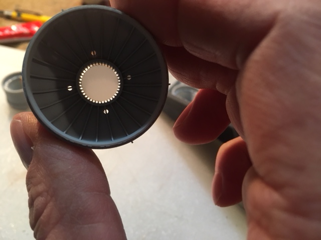

Did you put the diffuser acrylic on the smaller bells?
That is a neat idea to bevel the inside edge and set the acrylic into that!!
How close is the LED to the back of the diffuser acrylic?
you know, I didn't on the 4 smaller ones...should have though. it would have cut the glare by A LOT...the LED's are just stuffed in the back and not glued. I wonder if I could hog out the back, set some in there and then make new LED holders to fit the back? what am I saying...of course I can! Super idea man! :thumbsup
lets see...the LED is set at its base to the back of the engine panel...depth of the panel cone to the bell...half inch? maybe a tad more?
ISDWALLS1.jpegISDWALLS2.jpegISDWALLS3.jpegISDWALLS4.jpegISDWALLS5.jpegISDWALLS6.jpegISDWALLS7.jpegISDWALLS8.jpegalmost there, 90 to 95 more FO down each side, which now makes for this project between 1200 and 1300 strands of FO...boggles the mind. You sit there and drill these holes, even conservatively and you think, ehh, that's 40-50...then you count 'em and there's over 90! crazy. I'm glad I used .25mm FO, otherwise I don't think it all woulda fit in there :unsureAnyway, I've got like 50 left to do starboard side, then I'm back to the engine block, got to open up the rear of the 4 small ones and install some of that acrylic I used for the 3 big ones. This was Escape068's suggestion, and a correct one. btw, this light diffusing acrylic has a glossy side and a flat side. I've been putting the glossy side to face the FO. I think you get a more even light distribution with the non gloss side out.
I meant to say, glossy side to face the LED:facepalm
