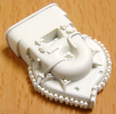

After investing more than a year and half on to make my own plans and a 3D model, and boring to some kind members of this forum with my questions about some parts id, I have finally begun real work.
This is only the first step:
Yes, we all know this part, and we all know that it comes from 1/24 Airfix Hurricane kit but, it really looks with other eyes when you've built it from scratch and have invested in it about 20-24 hours of work.
( I have the intimate hope that most of you haven't noticed that this image was not the original part :$).
The reason I chose this piece to start my project is because this is the part that I found most difficult and complicated to replicate due to its wide range of volumes, shapes and small details. I thought this piece would be a good test to see if my skills were sufficient to meet this challenge.

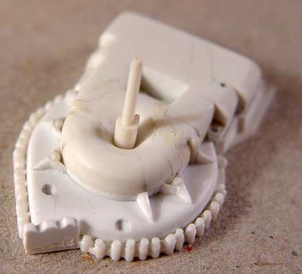

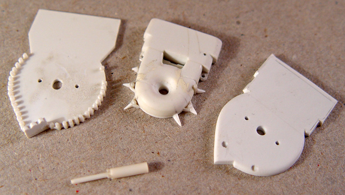

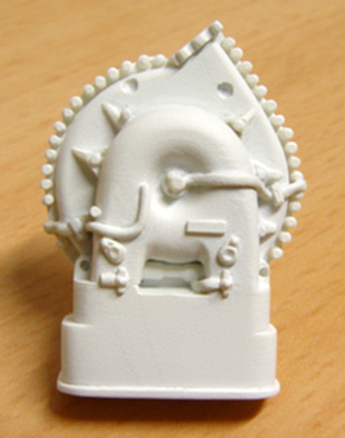

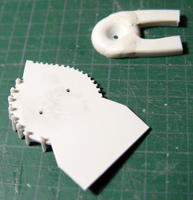

To end this first post, here are some pictures of the creation process on the Hurricane piece.
Thank you very much for visiting this thread, and many thanks in advanced for your contributions.
Rafa

This will be a cool one to watch, the hard work/economical approach. Looks like you have a great start :thumbsup
Muy bien trabajo Rafa!!!
La hurricane pieza esta perfecta, una construcion complicada.
And I agree it is very gratifying when you have scratch built it yourself. I look forward to watching your progress on this one.
Ozzy
Hi! Moska-san!:)
You have quite a technique that I never thought about.
What a man, you are.
Please tell me anytime if I can help you.
God speed!:thumbsup
That is real model building.
This will be an eye opening build thread.
Thats why I love this place.
We learn new stuff every day.
