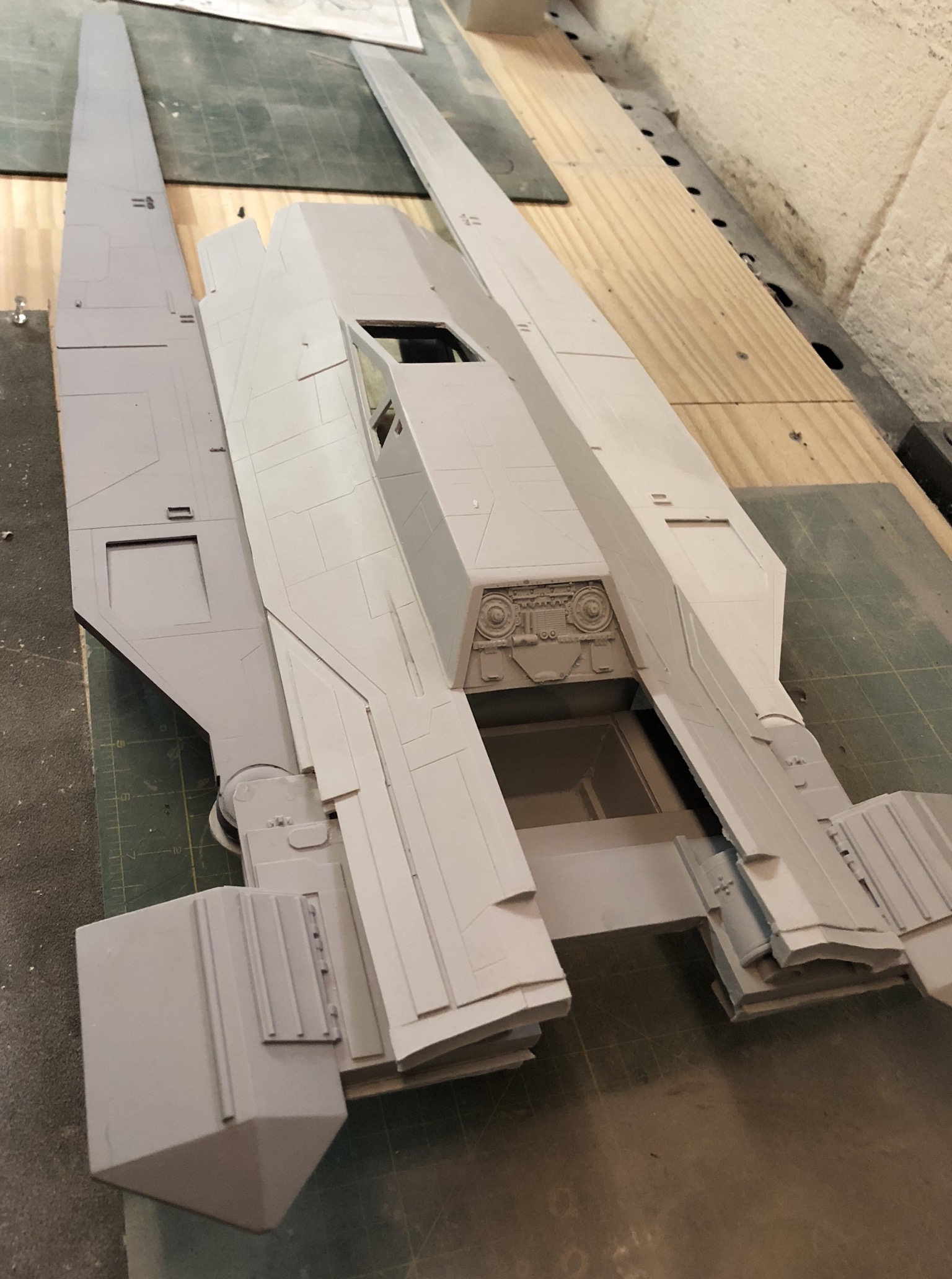

1/24 U-wing kit from Korbanth just arrived. 41” overall when complete. This model was designed by Alfred Wong.
The castings are ok overall, but this kit is going to need a lot of work to iron out some kinks. There are a few places that need serious cleanup. The engines in particular are going to need a good bit of Apoxie Sculpt and tweaking to make them fit together properly.
The wings pivot on a resin pin, I don’t think that will hold up long term. Will have to be replaced with a screw. No build guide is included (yet), so this will be interesting to figure out.
Landing gear, pilot/co-pilot seats, and a bench seat for troops is included, as well as some interior details.
Wings are reinforced with metal rods embedded in the resin, that will help keep the wings from sagging.
Overall, this looks like a decent starting place for a U-wing. I think it may require some re-engineering of the kit, but nothing horrible. Should be a fun project, and really expand my relative newby skills.
Now, if I can just finish the 2 studio scale x-wings I have in progress, I’ll be able to get busy figuring this one out.

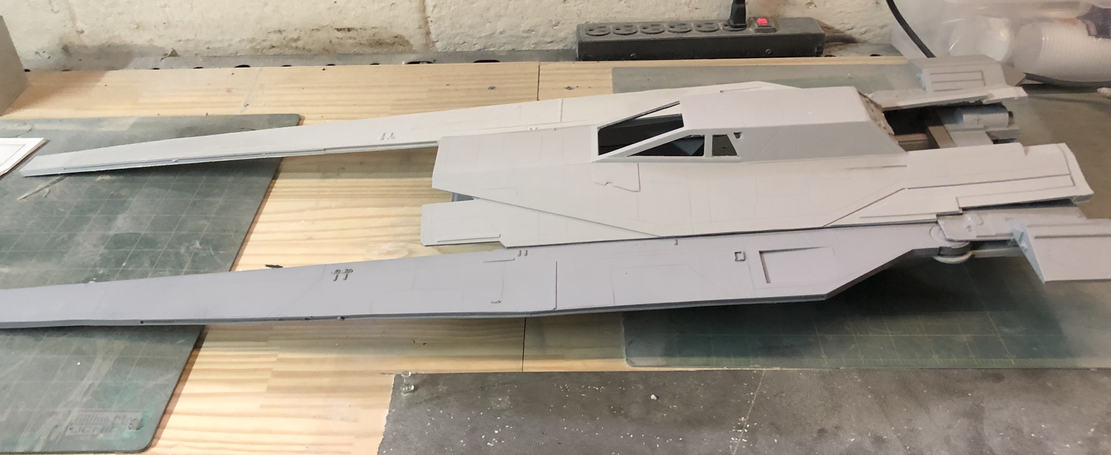

I’m off until after the Thanksgiving holiday, and I’m SUPPOSED to be working on my studio scale Red2 to get it ready for the paint shop, however....
I couldn’t stop looking at the U-wing. I was thinking about the pinholes and imperfections in the wings, and complaining to myself about how much work needs to be done to make them look decent. Maybe I bit off more than I can chew? Discouraging.
I started sanding one particular spot back a bit to maybe even out the surface of the resin a little, then start filling the pinholes. To my surprise, I realized a lot of the ‘mess’ was a REALLY bad primer job!
A couple of minutes with a sanding block revealed much smoother wings than I thought, once I got rid of the bulk of that crappy, heavy coat of primer.
This tells me a couple of things.
1) I may not have to fill the wings as much as I had originally thought (although there is still a fair bit of work to do).
2) At least the wings don’t seem to have primer adhesion problems, like I had been warned about.
Pic 1 shows one of the really nasty areas I was looking at. Full of pinholes.
Pic 2 and 3 show after a bit of sanding. Still not pretty, but not as bad as I originally feared.
I’ll be able to spread a little pinhole fillet on that area and be able to clean that off in short order.
akumazeto
Jeff that is still just as bad. This debacle is blowing up on facebook. 4 people have contacted me with pics like this and its not the primer. Its the crap casting. he claimed only one kit went out like this.
