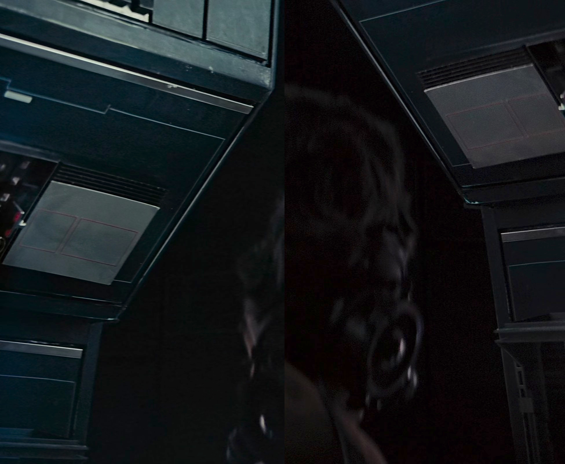

The metalic looking inserts in the side panels in the ESB build are possibly made of shiny sided bscking csrd.... thusly -

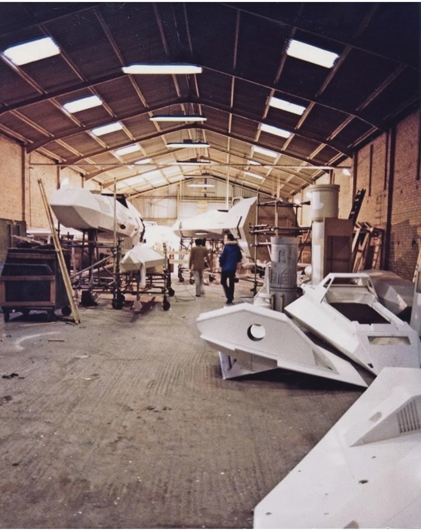

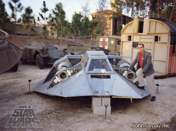

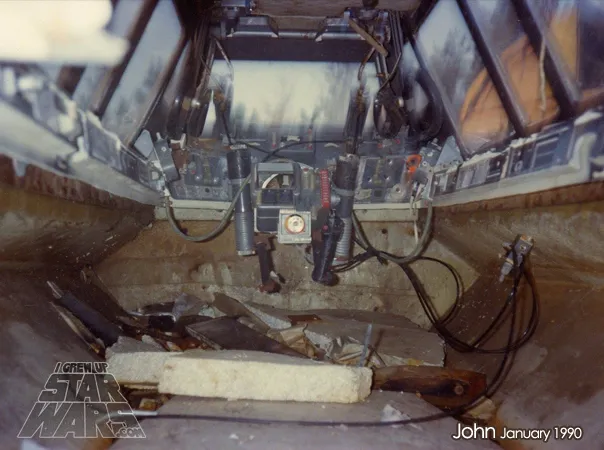

I wonder what happened to all the full size speeders? Do we know how many were made?
My guess is that only 2 or 3 were made, and only one survived. It was on display for years at the Disney-MGM Studios in Orlando, FL. It was out in the sun and heat and rain every day... at one point (? mid 200s?) I remember it was refurbished or at least repainted. But I haven't seen it in years.
Story and more pics here

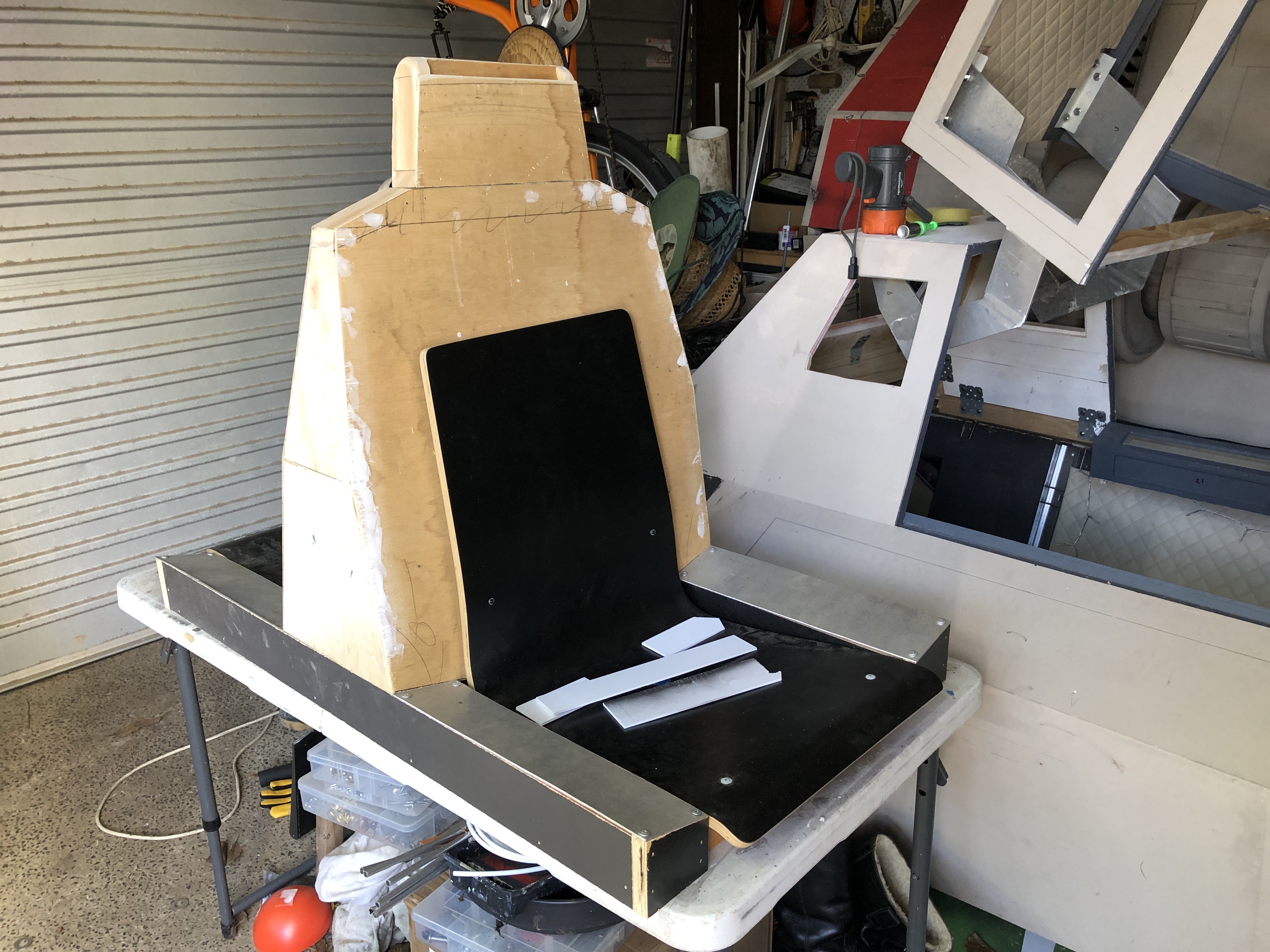

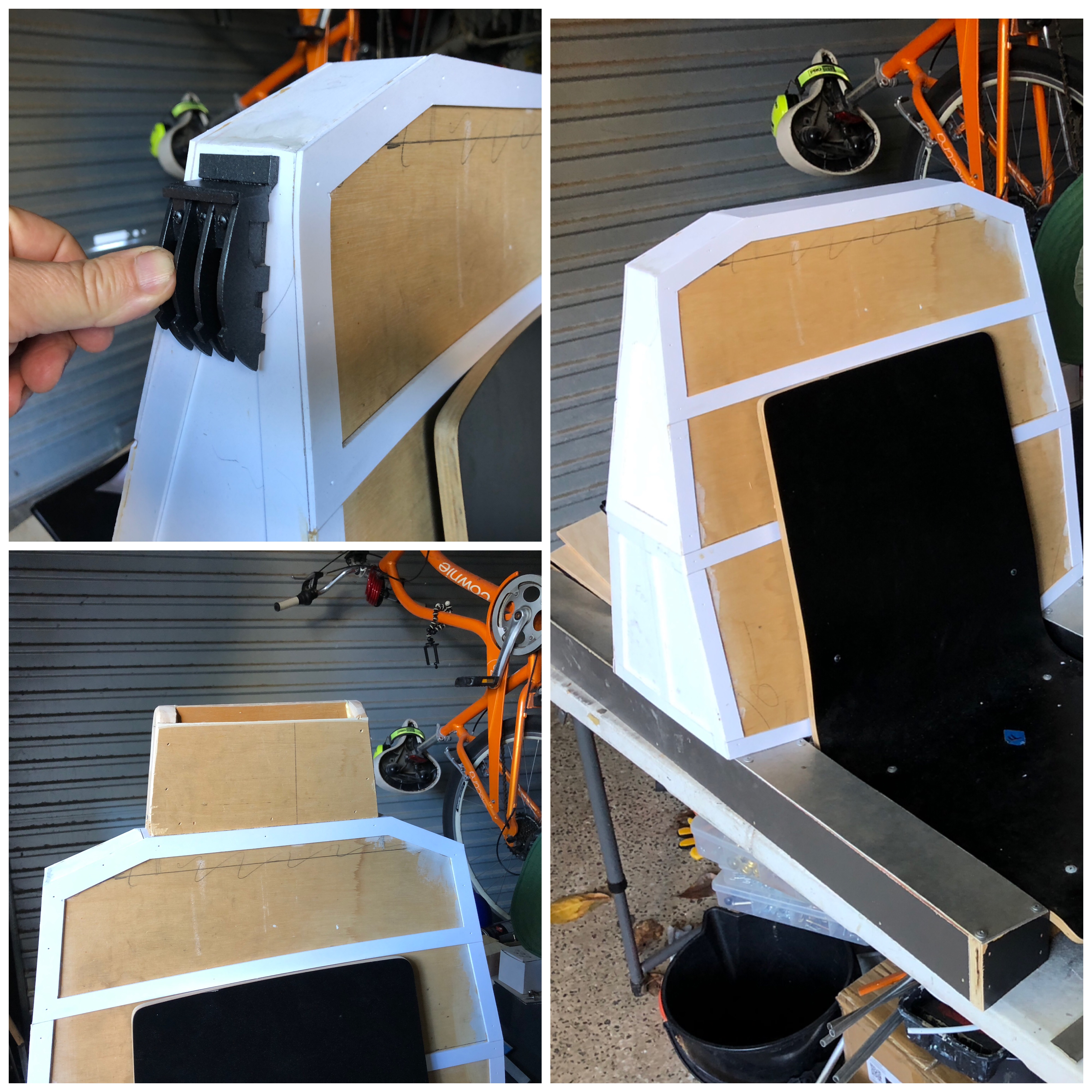

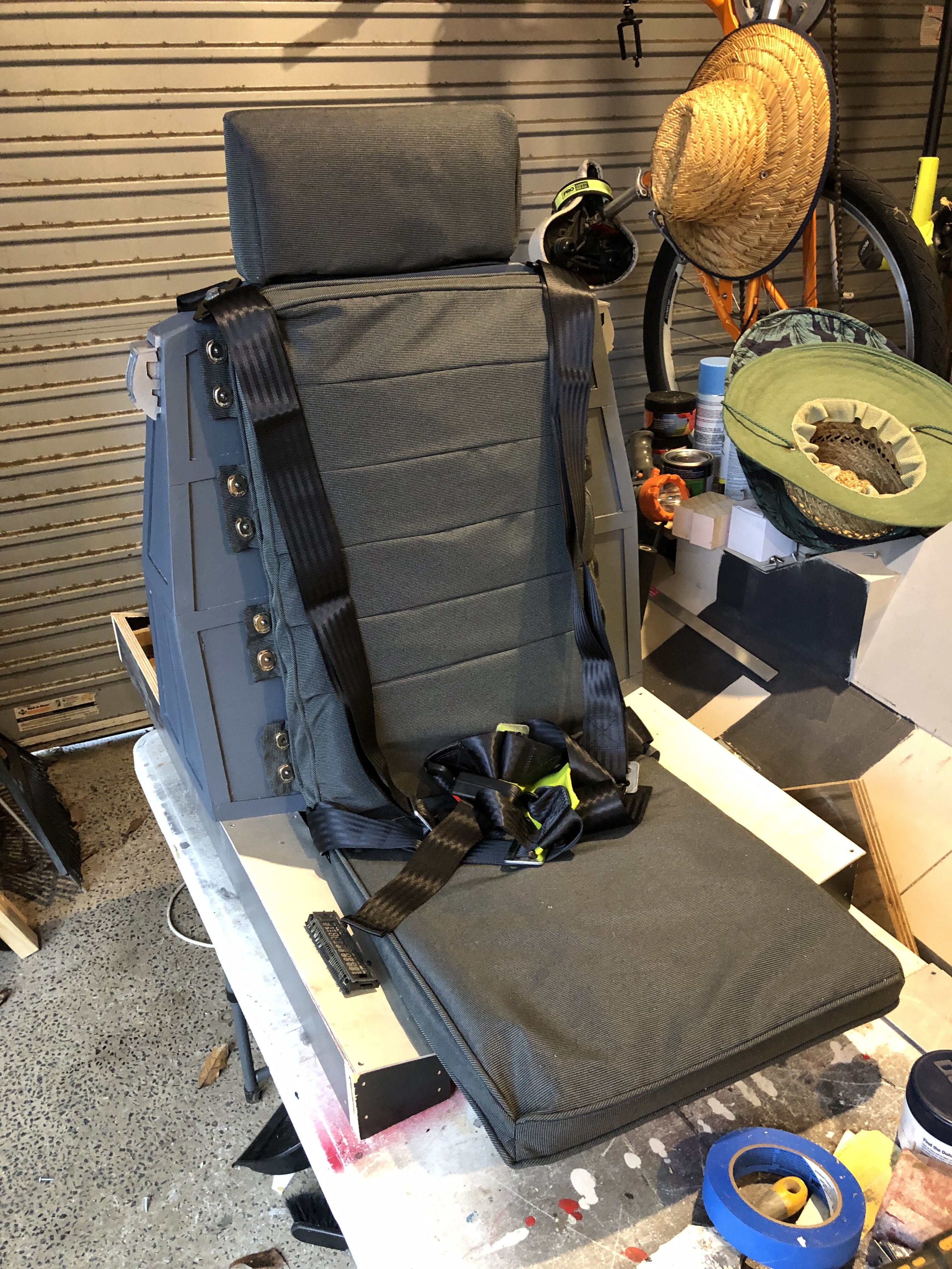

Working on the seats. Used some cheap Ikea seats as a base to make it comfortable. The backing section that joins the two seats is just a plywood section with some detailing. Yet more angles. Nothing on this thing is 90 degrees. greeblies to follow.

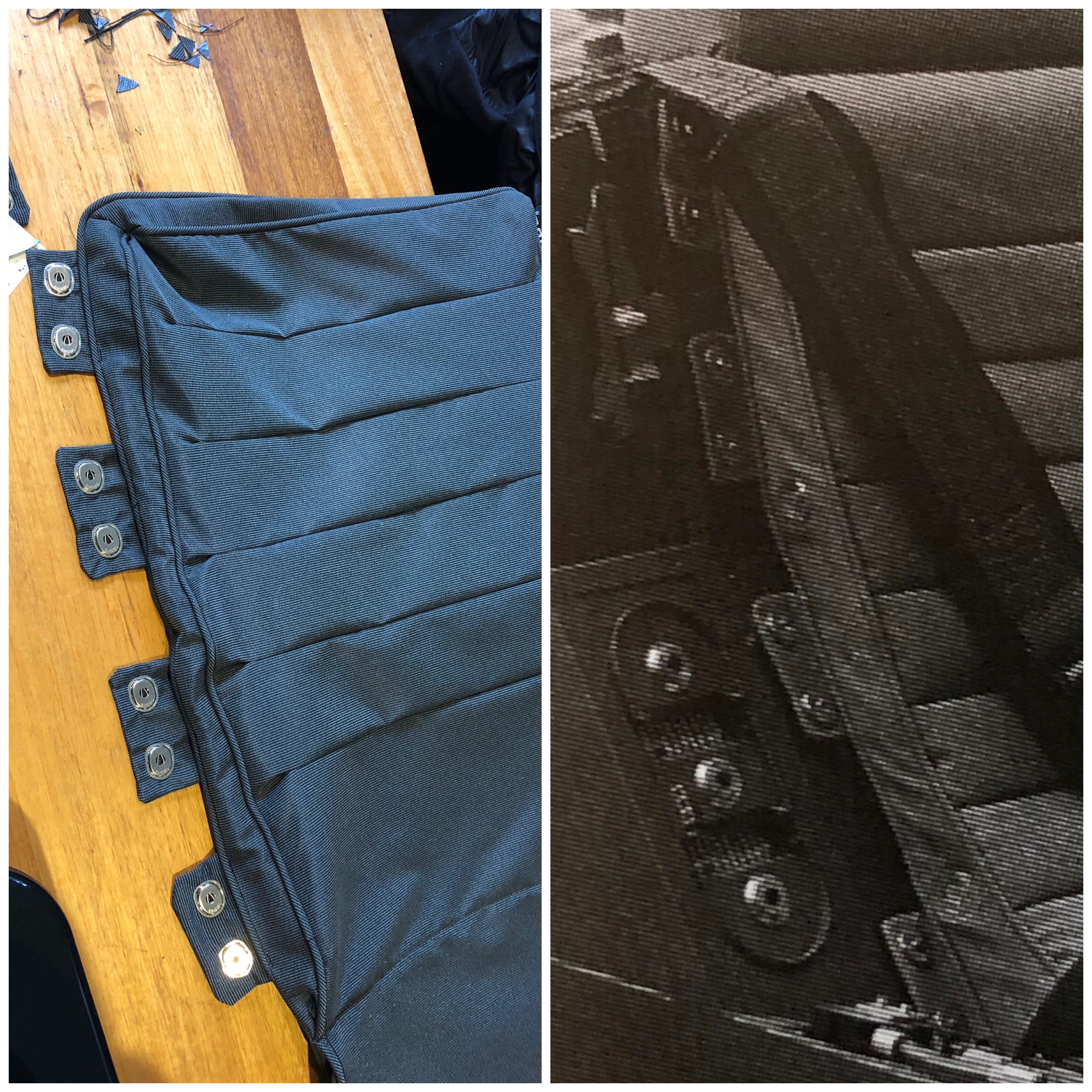

Flaps and snaps. Thats about it for the weekend. Took forever.....
Ill grey the seat belt down with some spray paint.
The central lock will need a 3D printed cover that looks a bit like an oven knob.
Obviously the all important bubble wrap also needs to be added.

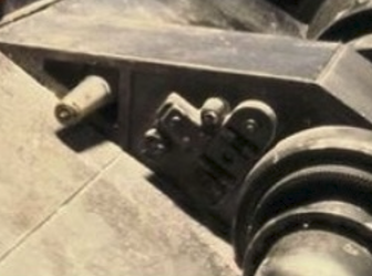

Maybe but they might be a bit big based on the size of the snaps. I think the same or similar greeblie is on the cannon bulkhead too. Hard to say.

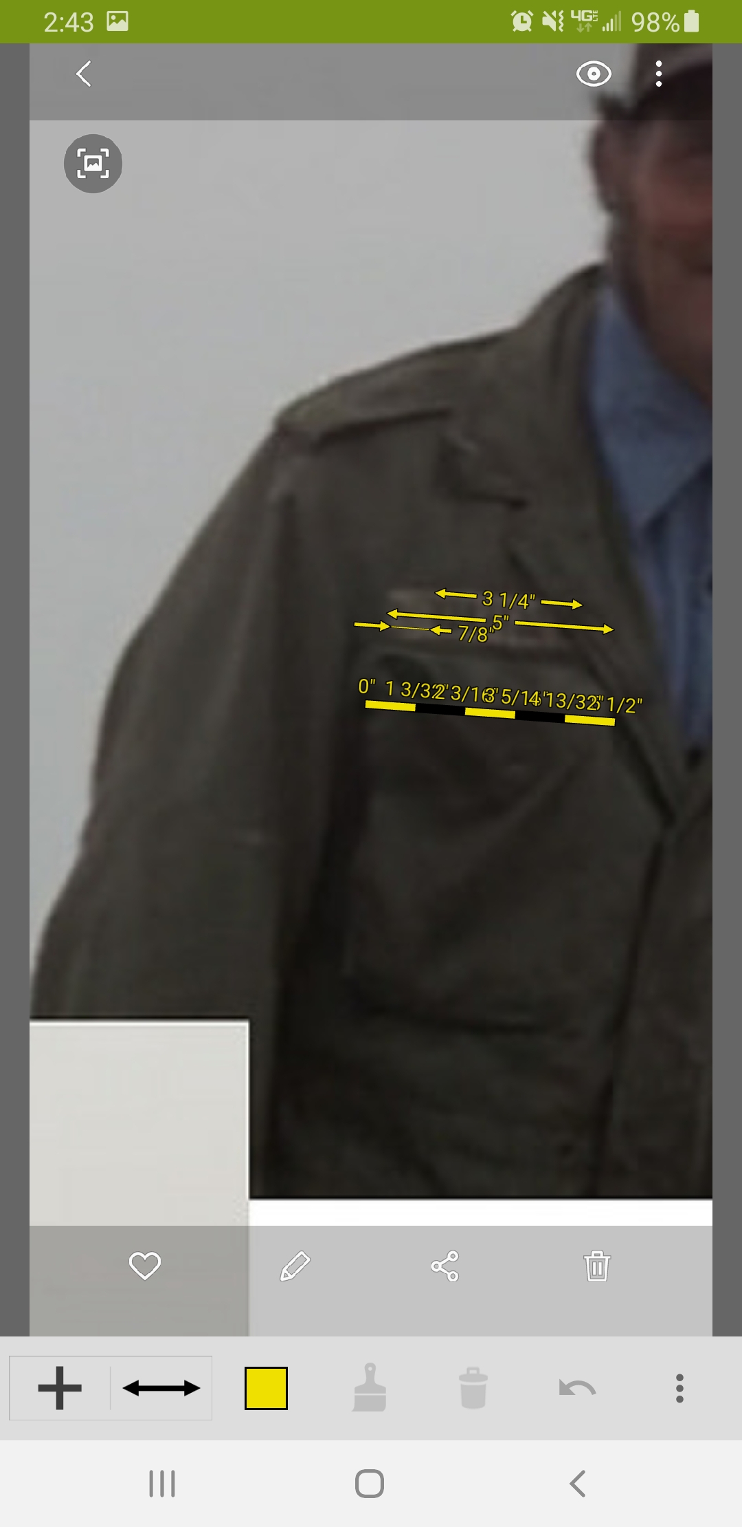

Do you use a scale/measurement app? Sorry if I asked already. I use an app that allows you to assign a known length to an item in the picture and then be able to use in app rulers to measure other items. As long as you are careful to only measure items in the same plane/angle, it is very accurate. Perspective is the killer when you switch planes from the known measurement. But with this view, a known length for that flat rectangle's edge would be in the same plane as the faces of all the parts facing toward the camera. You could get accurate radii on all of those round parts and lengths on the flats.
I dont. Can you recommend one? I have just discovered that Gus Lopez owns one of the original cannons! I reached out to him and he is going the get me a few measurements. This info will be too late but it will be an interesting exercise in see how close i am. He did confirm the use of the slide projector cartridge.

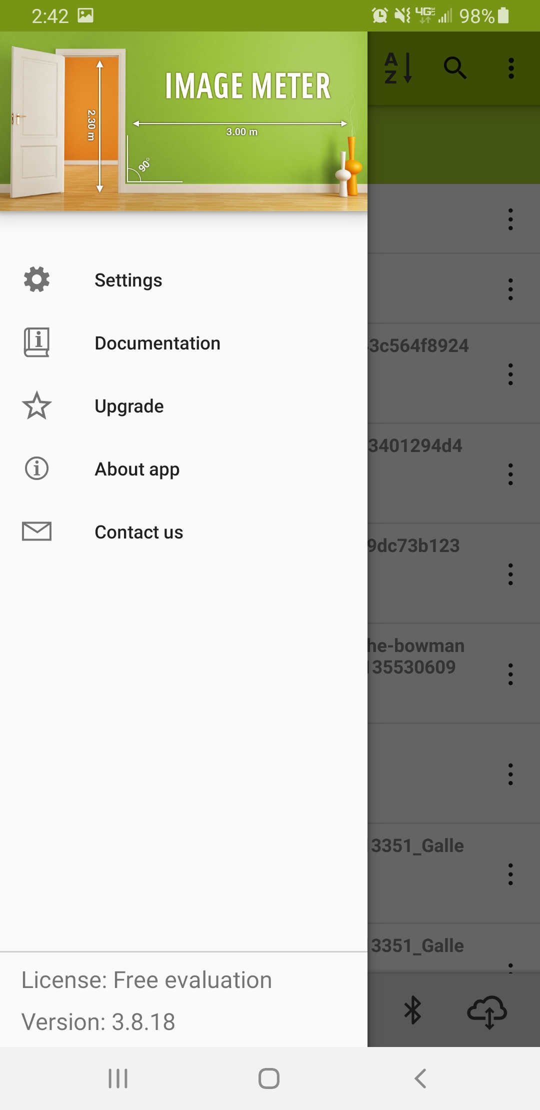

I use a free app called Imagemeter. I will try to get an app download link. Here are my info pics and one example of using it for the name tape and font sizes for Quint from jaws. I have the same military coat and provided my own base pocket measurement to start.

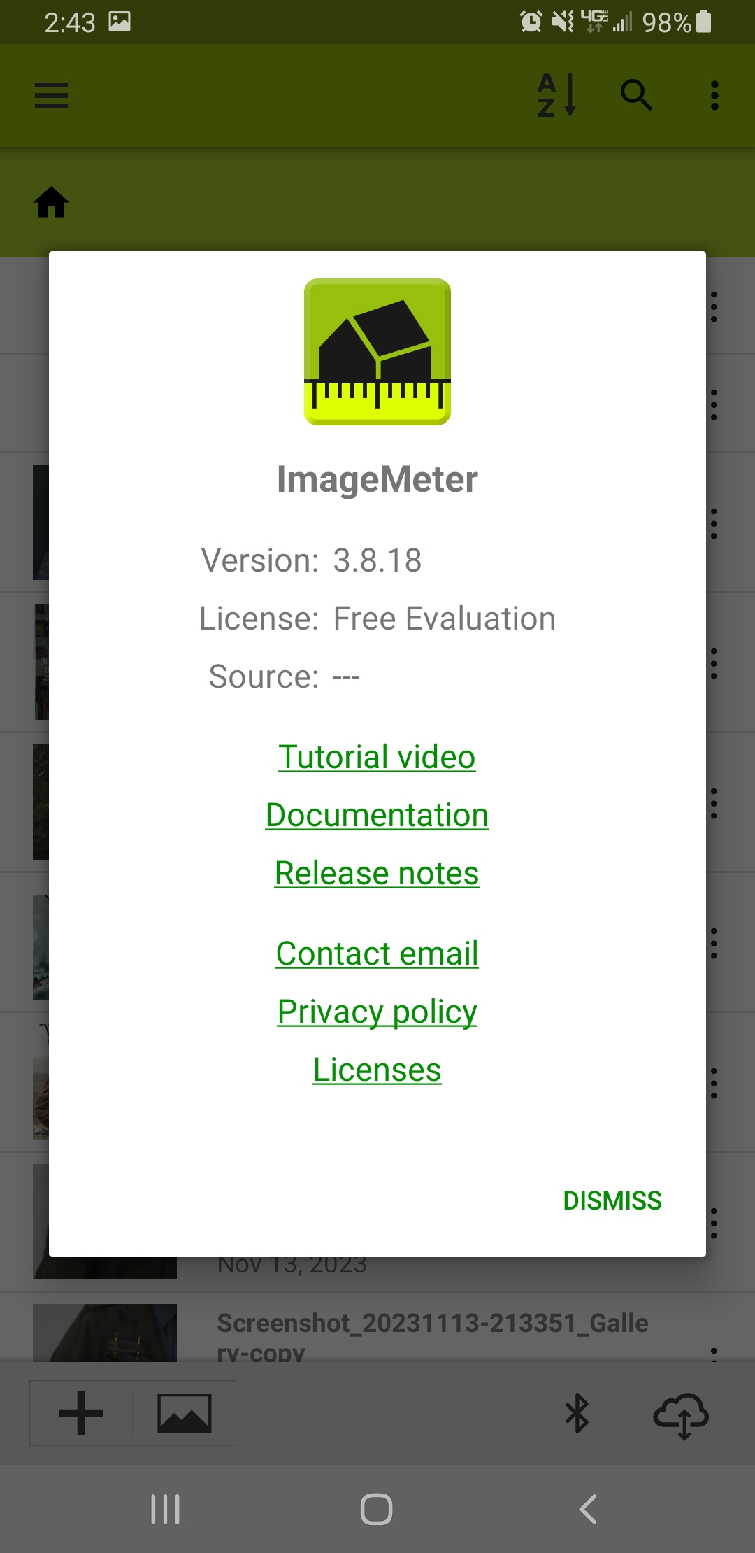

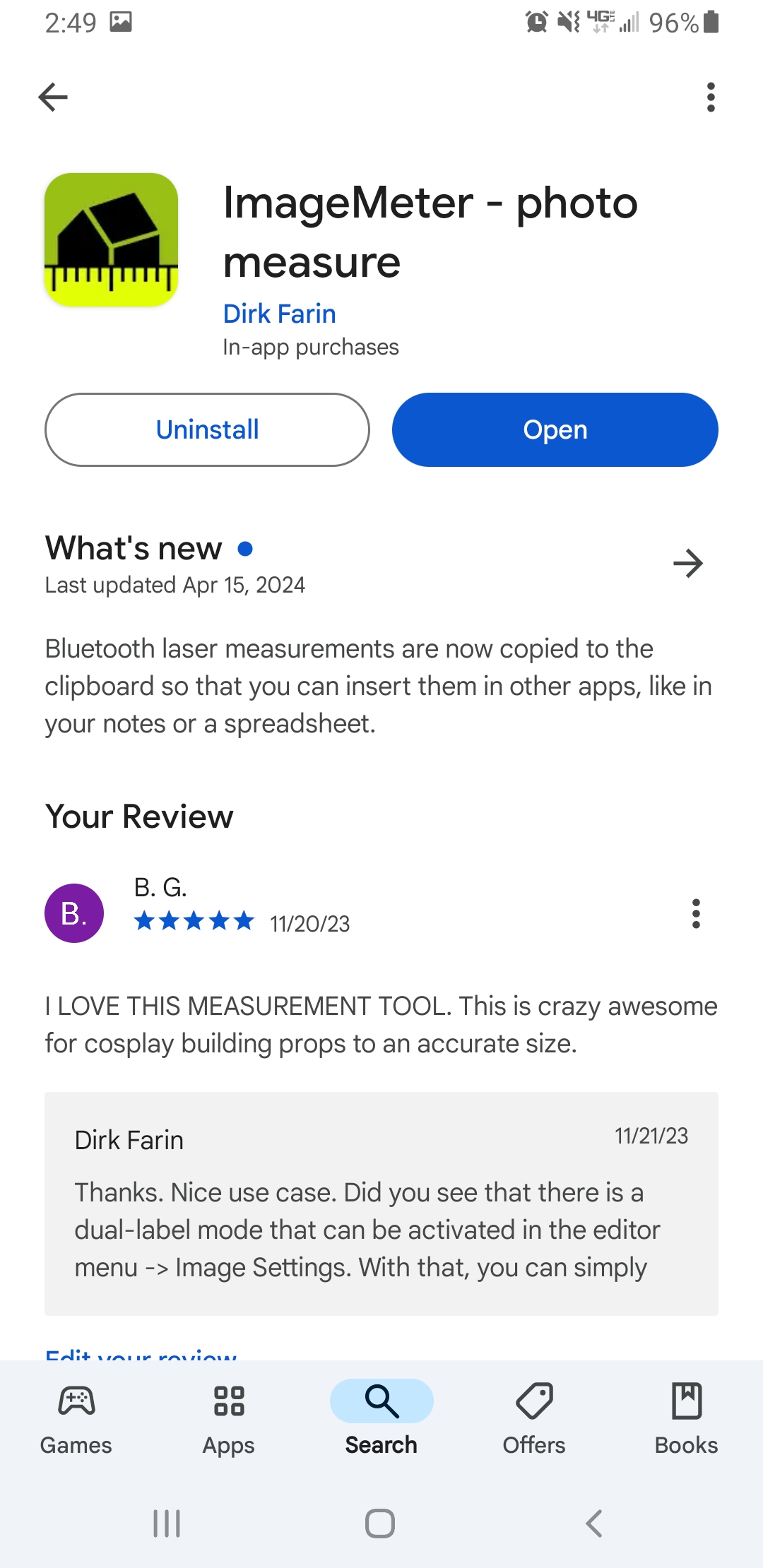

Google app store has this currently, ImageMeter uploaded by Dirk Farin. The funny part is that is my review that shows up. And I have never used its bluetooth actual laser measurement addition, so I guess it does a lot more than I use it for.
