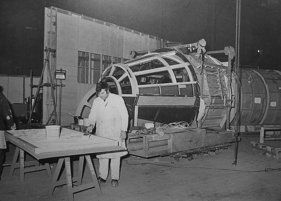

I just felt like posting this picture from "Star Wars Archives"...
Love that pic! That exact pic helped me get passed a couple of hurdles for the canopy. But I can't figure out what they're working on... it looks like some kind of panel...
I think Greg needs a couple of those saw horses lol
LOL! They would definately help...
It's a preview of Han Solo in Episode 7, making repairs.
It looks to me like it's the exterior skin, made from something thin and flexible enough that it can just be wrapped onto the curved surface after all the detailing has been done (the detail does seem to be the same sort of paneling texture that we see on the outside of the cockpit). Could be a nice easy method for doing the skin.
