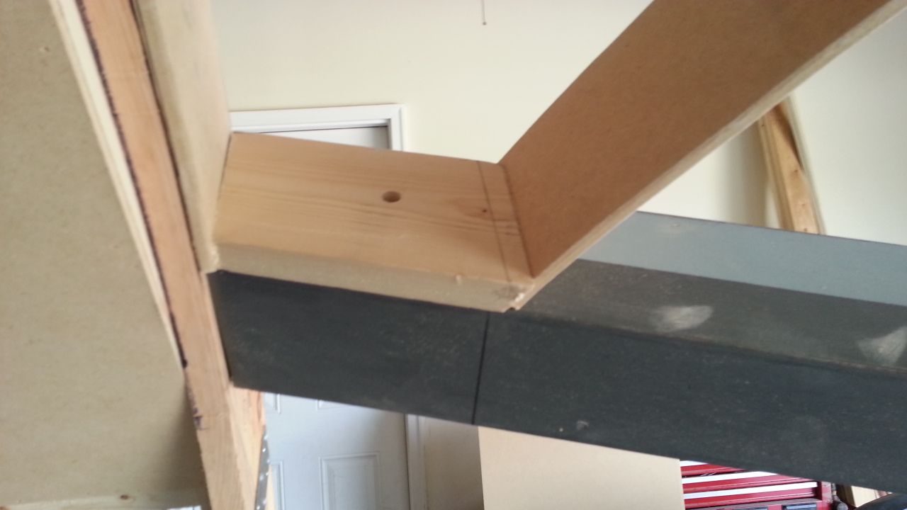

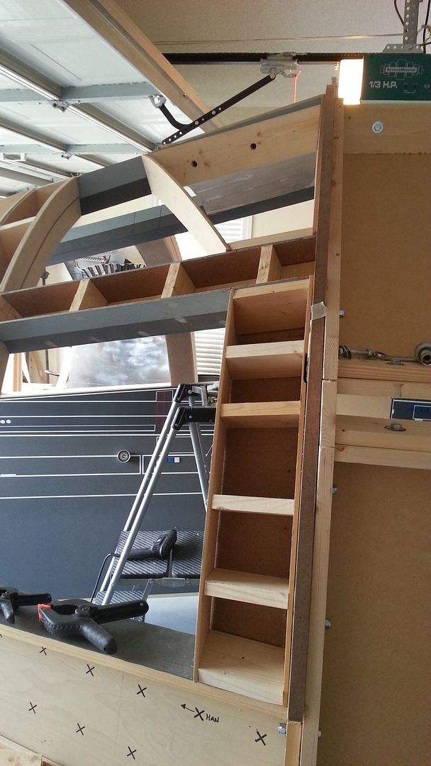

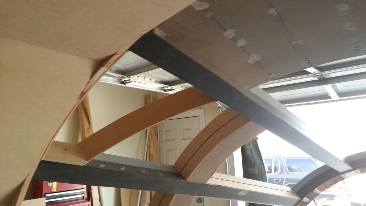

All the vertical beams are bolted to the horizontal beams with a single bolt at either end. The top canopy panel will then bolt to the two horizontal beams thus bolting all the beams together. As of now, the horizontal beams only rest on the rear arch and window arch (minus the beam that is warped). However, I am NOT enclosing the entire beam(s). I am leaving an opening where the bolts attach.
Note how the beams bolt together
Note where I stopped with the enclosure

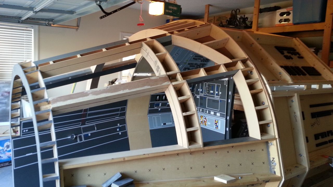

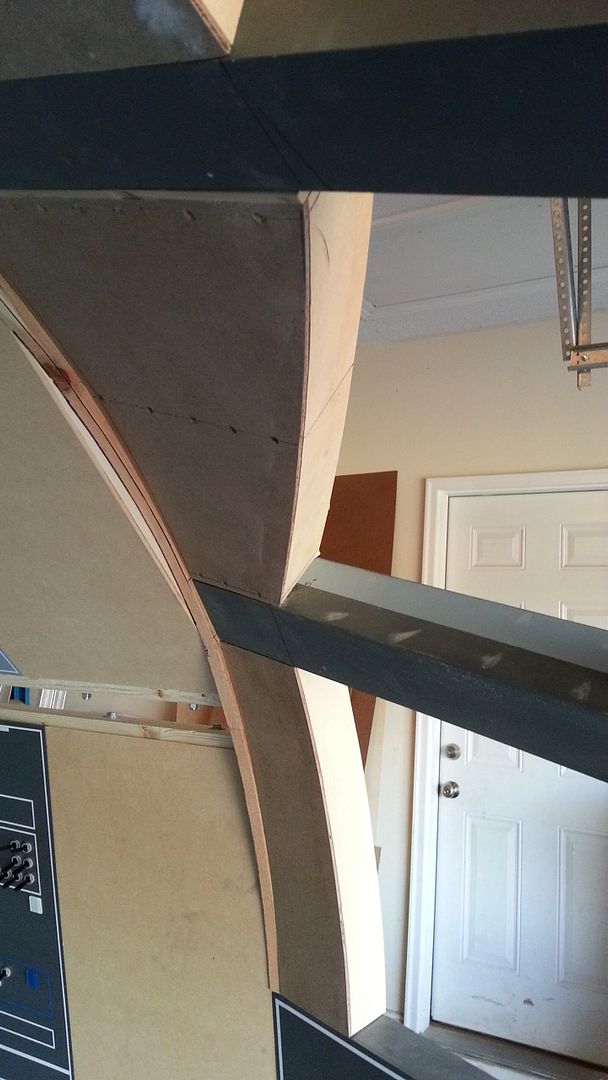

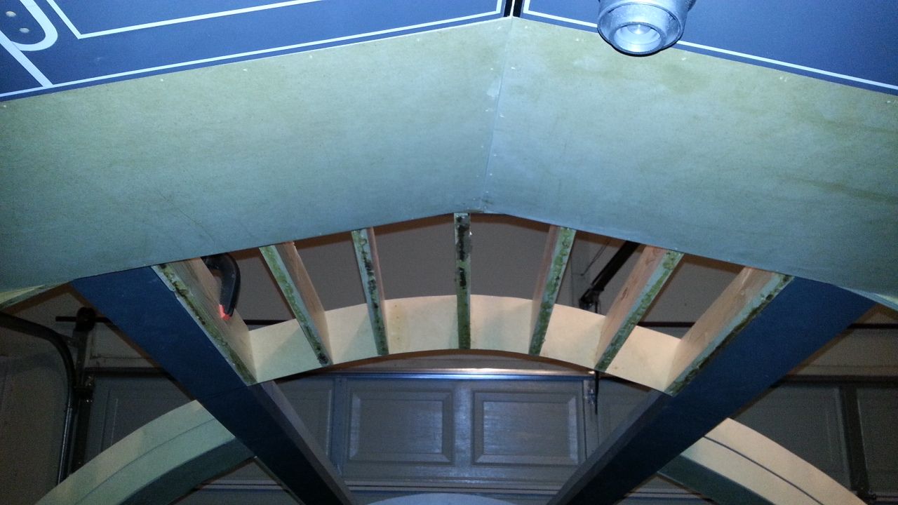

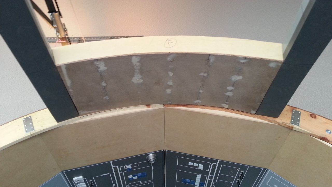

Well... The beams on Han's side are FINALLY finished - minus the window channels. The upper panels were ALOT tougher than I thought they would be especially the oddly angled shape window/beam.
The very first thing I did this morning was fix that horrible center top panel... Much better

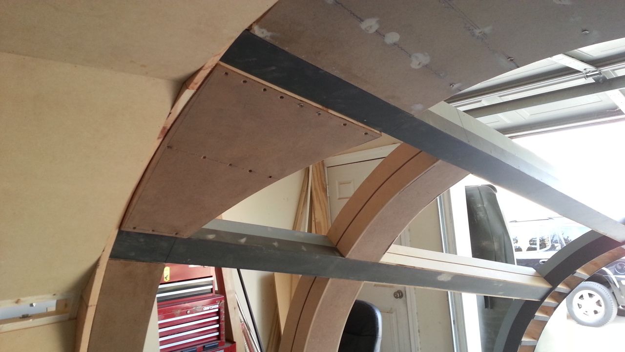

The panel required screws to adhere to the frame - it was NOT easy (this whole area is covered by a blanket so I'm not worried)
I then skinned the back beam
Then got started on the oddly shaped panel - another difficult job
Whew... tough one
Almost there...
Another view
I added a center support - the angles on this ARE CRAZY...
Another panel requiring screws - it was tough

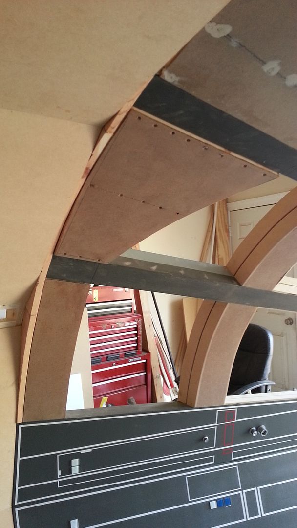

HMMMMMM... not quite fitting. Note the slight overhang on this side
Oh yeah... needs to be address
After fiddling with it for a few minutes... I added MDF to the overhang side and that tightened it up
MUCH Better
Nice clean lines
Still need to get to those window channels - IMO that really finishes off the look

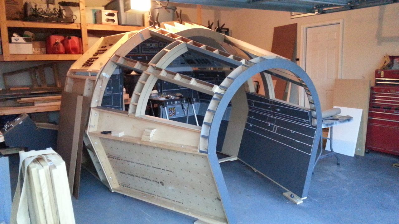

Lines up? Pretty good
There she sits... Chewie's side next (poor Chewie - no respect)
Whew... I'm beat...
