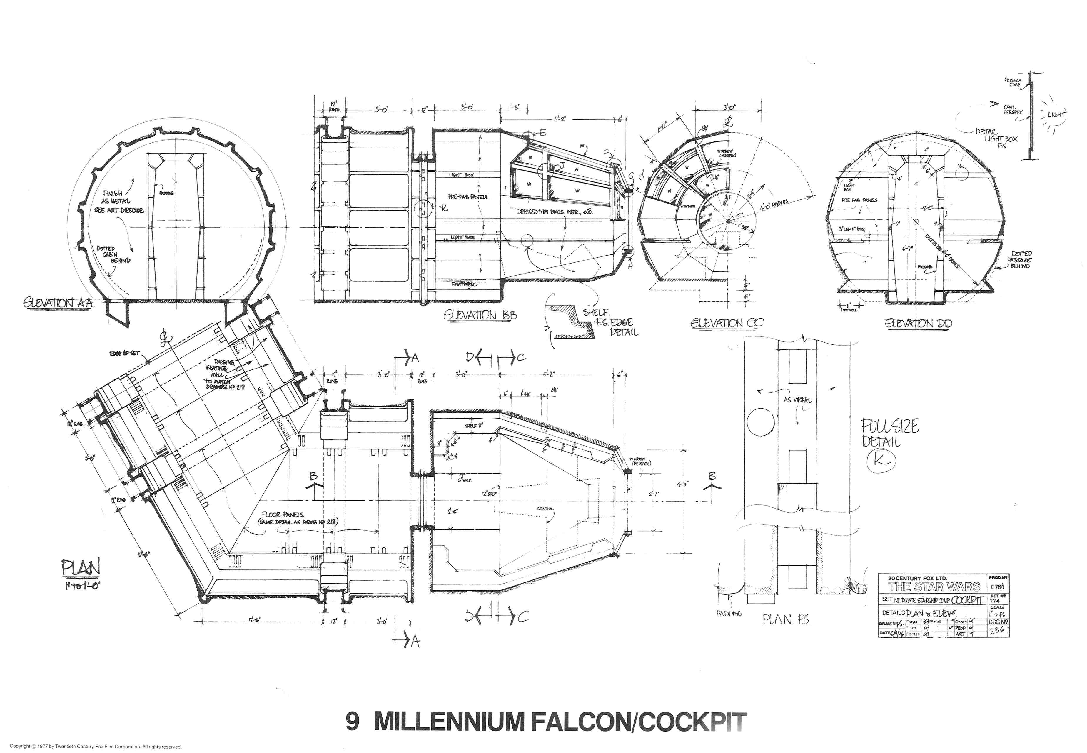

Here is a high resolution copy of that page. I hope it helps. It shows that the windows call for perspex and the light bars are opal perspex (held in with your nemesis; the evil Formica!) [upper right shows the technique]. I guess we can say you were on the right track with the Formica, it looks like the panels may have been skinned with it.

Hi Gang,
I wanted to repost this major concern to see if you guys can make sense of it all. I said in a previous post...
"The other larger and much more difficult question to answer is the transtion between the cockpit frame work (which is what I have built) and the outer skin. Starkiller estimated ~10" of space between the interior cockpit panels and the exterior skin (this might be because of the extensive work he's done to make the interior fit the exterior and vice versa). That's a HUGE space / gap to deal with. If that is the case... how do the 3.5" tall (not length) horizontal beams transition to the top of the cockpit / canopy without changing the outline of the nose cone?
For all intent and purposes - those same horizontal beams would HAVE to extend another 1-2 feet to reach the 10" needed for the space between the panels and skin. Even the blueprint above shows an inconsistency between the frame and skin. The nose / canopy is skinned but the angled cockpit panels to include beyond the door into the hallway are not skinned. You can see an outline of what appears to be the outer skin in Elevation AA (upper lft corner)...
Also, I JUST noticed that the overhead view (lower lft) shows the cockpit being smaller than the hallway frame. Yet, it appears that the canopy is skinned...
Once again... the Ship of Riddles... :)
I'll figure it out... but it does beg to ask all the question(s). It is VERY confusing.

Hi Gang,

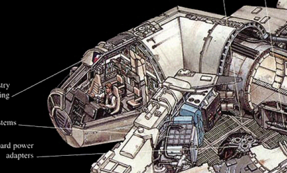

Not sure about how it would actually be built, but I can send some more reference images your way. Hopefully you can glean a bit of something from them.
I did notice that in one of the cutaways (the first), you can see the body of the cockpit is full-depth (~10-12 inches like you said), but the top of the cone section is shown much thinner - just the thickness of the beams. Now, what that translates to in the real-world, I'm not sure; sorry, but that's your problem. :wacko
Sorry the pictures aren't any bigger. That's the best I got. :(
Click to embiggen.

I just checked the hi-res blueprint again... does the "dotted- passage behind" and "dotted- cabin behind" have any bearing on the orientation/thickness of the cabin "roof"? It looks as if they shifted the cockpit up in relation to the passageway, perhaps allowing for a thinner roof diameter. Maybe. Or I'm talking out my butt...
I don't know; I'm gettin' a headache...
That actually makes the most sense! Brilliant - GOOD EYE. It would be easier to have more space UNDER the cockpit than to try to fiddle with the canopy beam(s) orientation. There is nothing that says the circular "outline" of the cockpit MUST be evenly spaced with the circular outline of the skin.
Now... How am I going to address the issue? I would have alot of trimming to do around the edges of the panels and beams. Still a long way off but it's definately something that is always bouncing around in my head.
