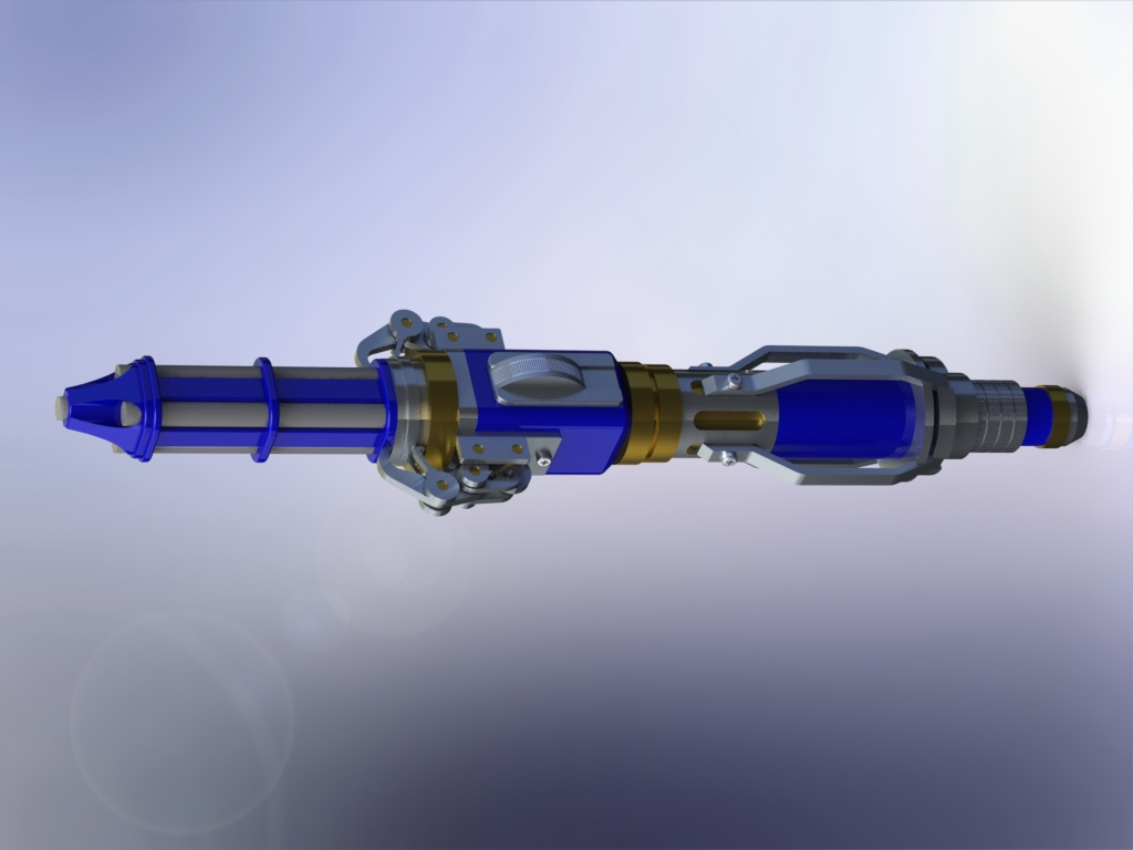

Made some of the edits needed and did a quick render to show off the details.

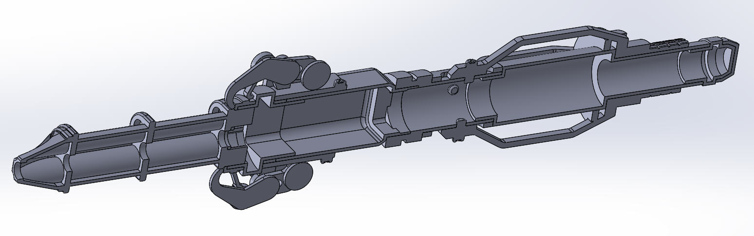

I also worked out how all the parts fit together, which you can see in this section cut view.

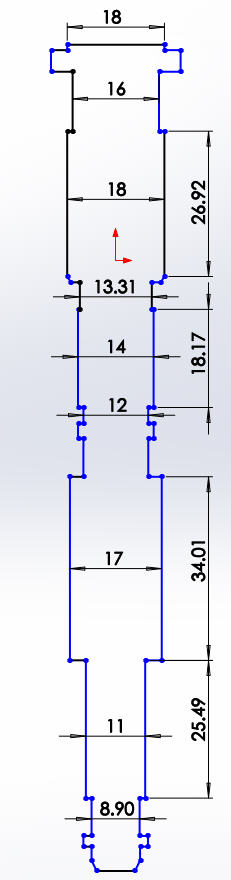

Finally, a sonic screwdriver with enough space to fit a tvbgone and light display, any chance anyone has a high res pic of the designs measurements, I can't make them out.
You can sort of tell what they are once you get into a program to build it, in relation to the measurements that you can read. I scoured the Internet to find a better image but came up empty-handed. They don't all match up as it is though, the length of the two longest dimensions don't fit into the full length when all the shorter ones are added up. I just started with a screen grab of the one he holds up in the interview and worked out the dimensions as close to the prototype images as I could.

Ah, ok, what program do you you for the rendering?

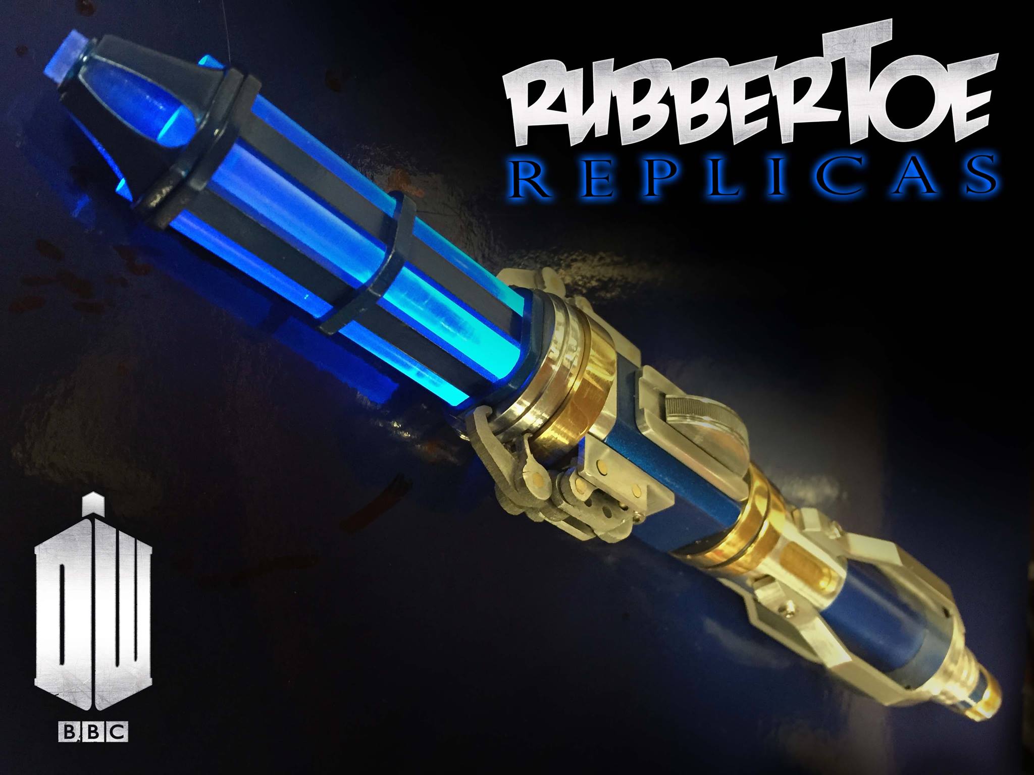

The concept art always varies from the finished prop. I'm sure Nick suggested changes as he was building it from the concept art. Things like changing the slots from square ends to rounded because it's easier to mill out round holes. I can't wait to add one of these to my collection.
That's precisely why I was liberal with the measurements on the diagrams in lieu of matching the screen shots of the actual prop more closely. In the interview, Capaldi says he made some suggestions after seeing the prototypes and obviously during the build, Robatto makes changes on account of work-ability.

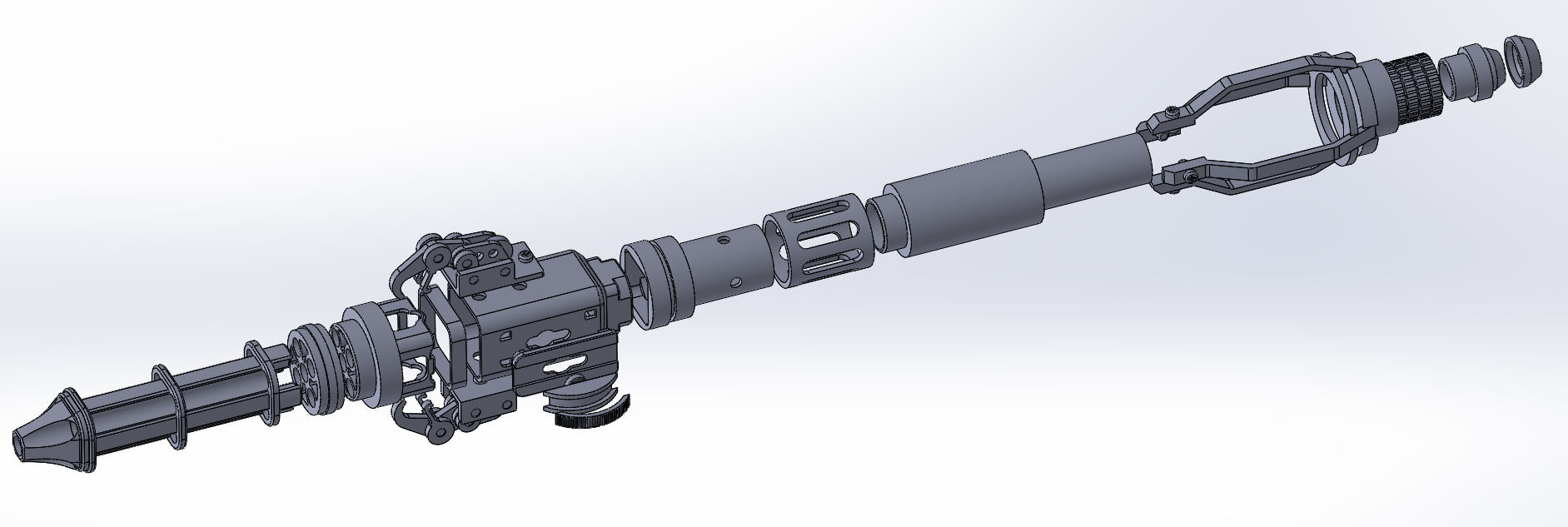

That can be arranged, in time haha. I just finished up all the joints between parts as well as the way the LED's will be incorporated into the base of the emitter section. There are 16 parts all together, not including the acrylic rods.
Here's the exploded view of all the separate parts.

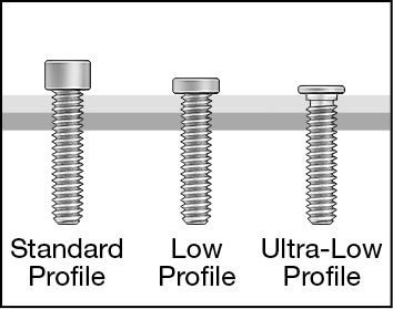

I went back to look at the reference photos, and now I'm not certain if they are button head allen screws or low profile allen heads. Here's reference for both:
Low profile Allens.
Button Head Allen.
The button head is a low dome shape from the side.
I first thought they were button head screws; which would be more comfortable on the hand because of their rounded dome shape, but there looks to be a bit more rim showing on the screws than a button head would have. That's why I changed my mind to the Low Profile Allen screw.
Here's the photo that I noticed it on. (I wish the resolution was a bit better)
You can zoom in on the screws and see what I mean.
