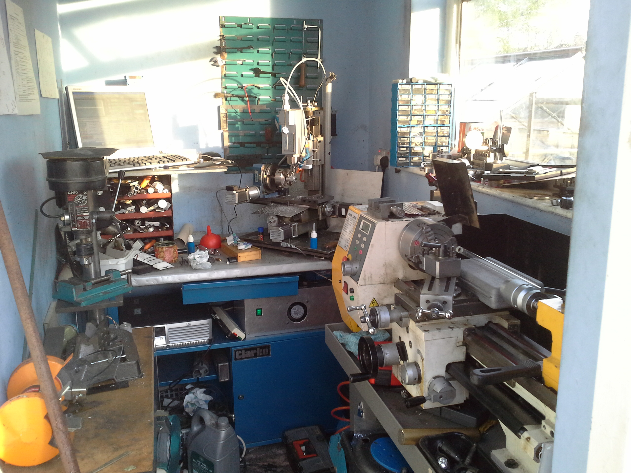

A picture of my entire workshop, well, the machine shop. I do almost all of the metalwork in here. Very small parts are made on the Peatol/Taig lathe which is fairly portable.
There is a work area where the electronics tomfoolery takes place. Up in the attic. There is an old oscilloscope, a power supply. An oldish DiHydrogen Oxide gas torch, soldering iron and various other tools. Also up there, stashed away are two real robots, Cybots and the magazines, and other robots, nearly all of the Star Trek magazines, a modest collection of ...
Science fiction books, bet you thought I was going to say something else. And a gathering of old models waiting to be built.
And here is a picture of the metal shop. It really is that small. If Ihiccup I impale myself on one of the handles on the Lathe. :)

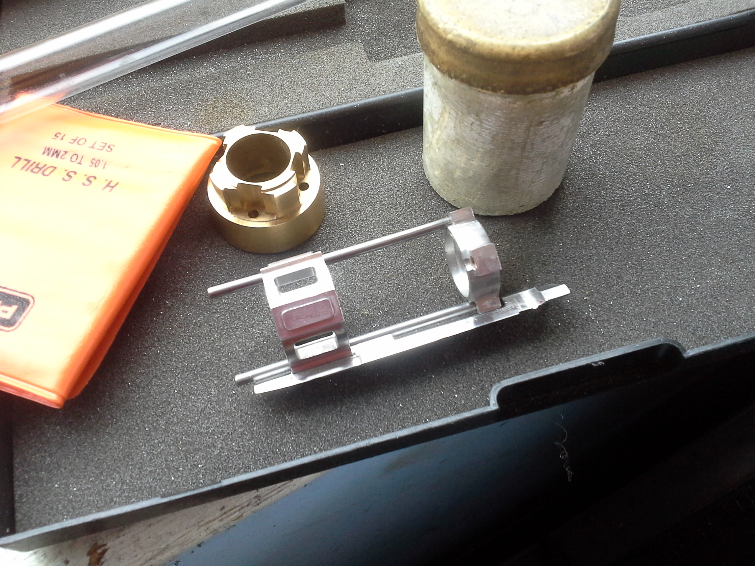

So where to begin. A couple of months ago I wanted to start moving forward on the extending mechanism. Part of this was the electronics and motor. Part was the support column. I knew I had a problem with the support column, the guide holes and the threaded holes had been drilled out of position. In order to rectify this a couple of ideas were considered. The first was to plug the holes and re drill them. Well I tried this, but the results were not encouraging. So I decided on a more drastic plan.
The first part was to make a new support ring. Originally this was to be the same arrangement as the original with the arms at 45 degrees to the the guide holes. So I embarked upon the machining of this part. Part of the way through the process of fabrication the part, I changed the layout. Now the guide holes were to be located behind the support arms. Unfortunately the holes were to be drilled after the locating pins were machined. This wouldn't be a problem with the original design. However with the redesign, the slots allowed the drill to wander, resulting in the holes not being straight. Although the holes were in the right place on one side of the part, on the other they were so out of place they were no better than the original.

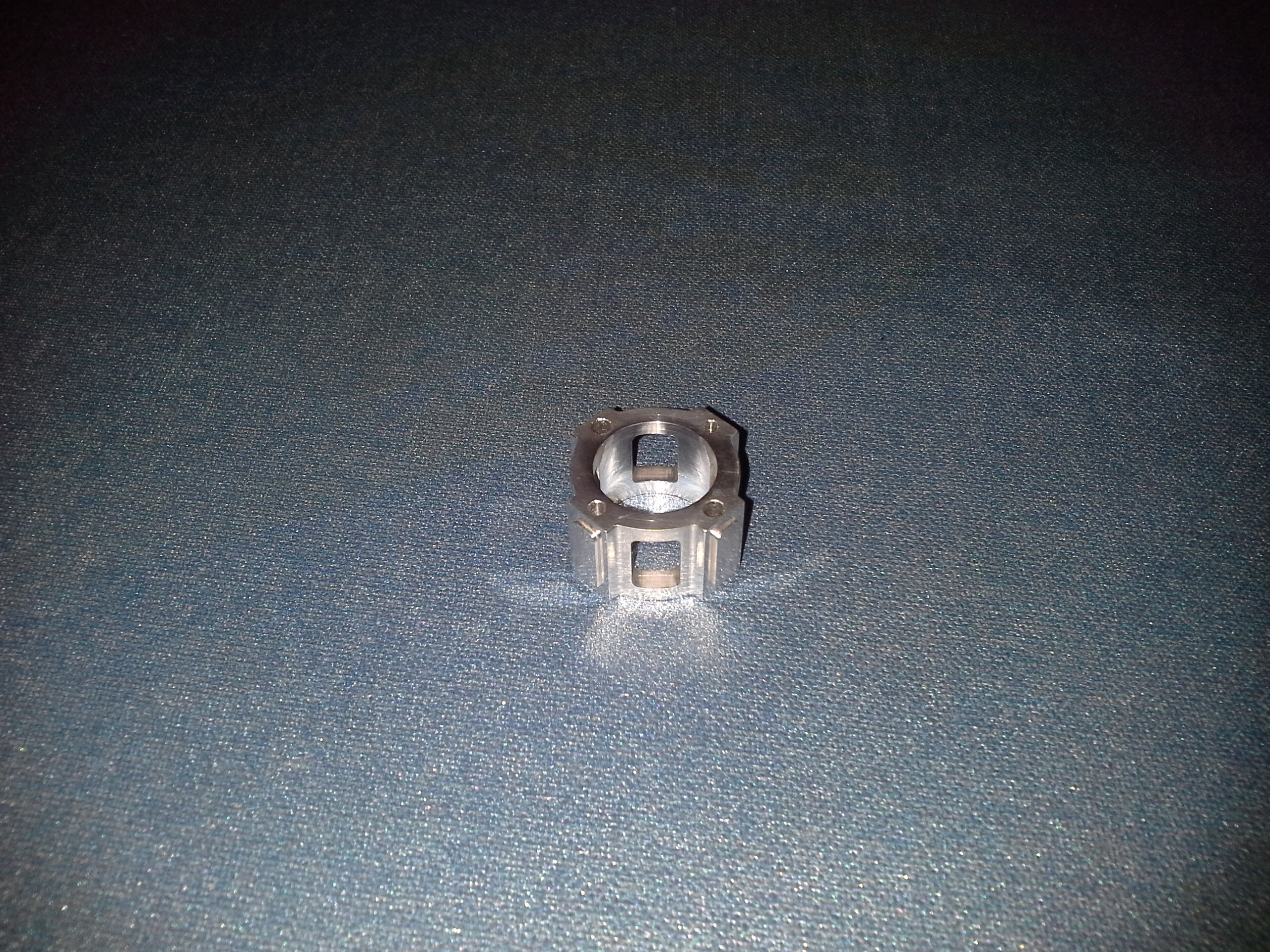

Version 2. Creating a new blank, bored to just over 15mm diameter. Just enough to clear the centre tube.

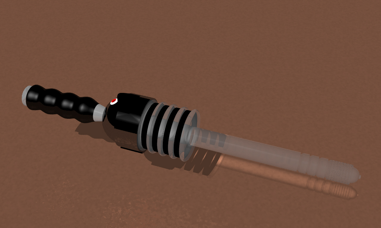

Does it look familiar.

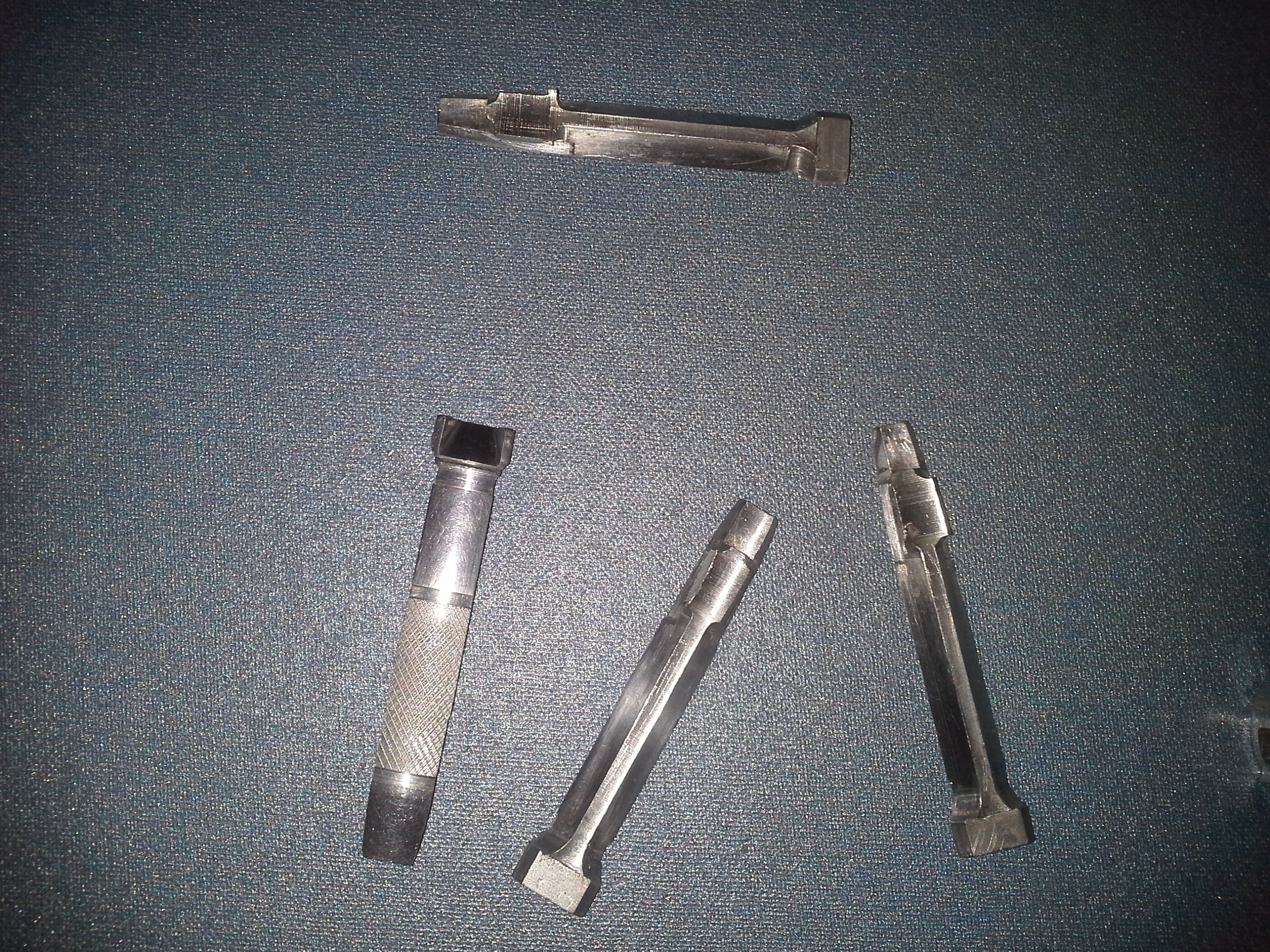

With this part fabricated, on to an act of vandalism. The original support column was sawn up, releasing the 4 arms.
Oh no, what have I done!

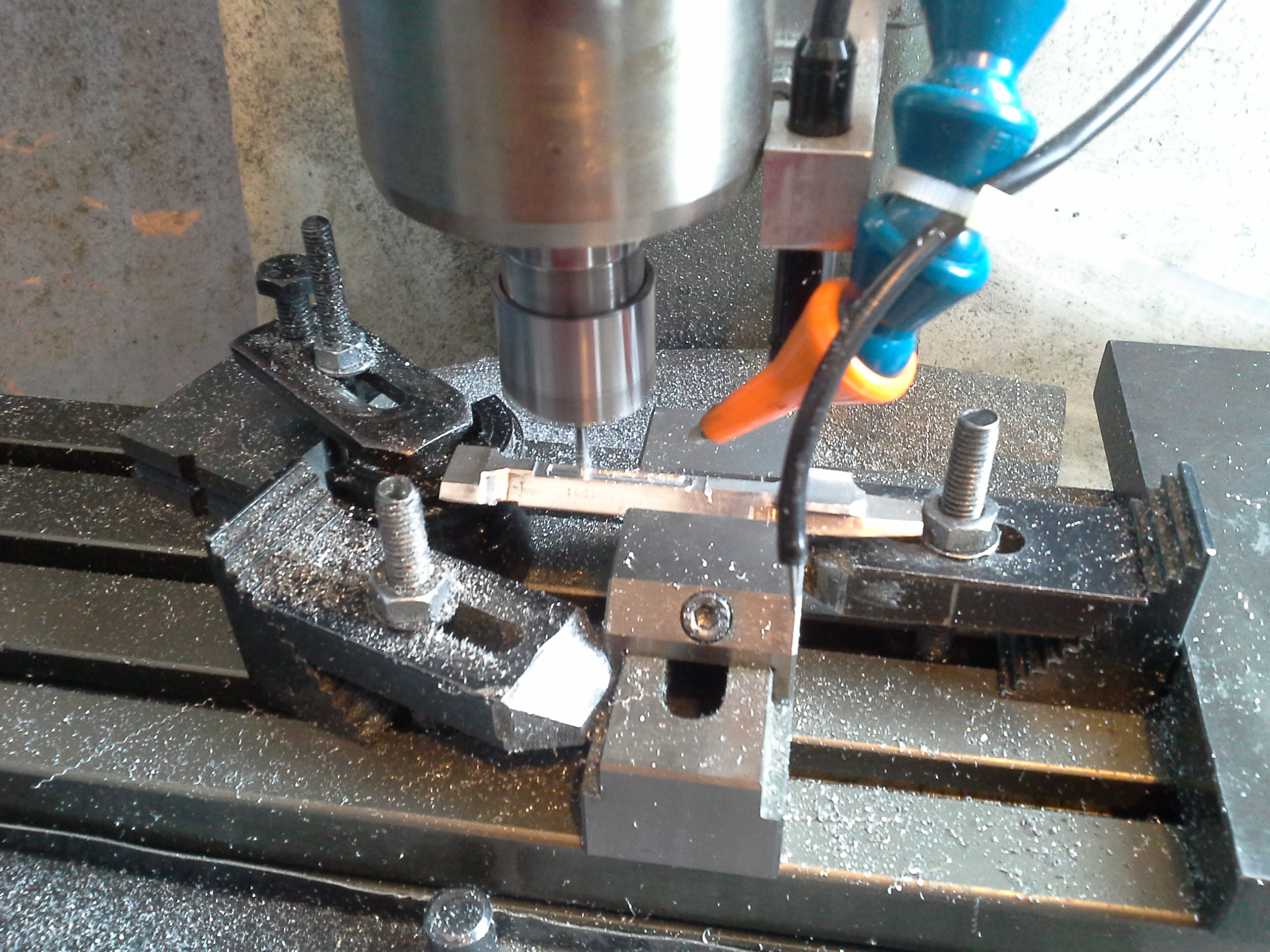

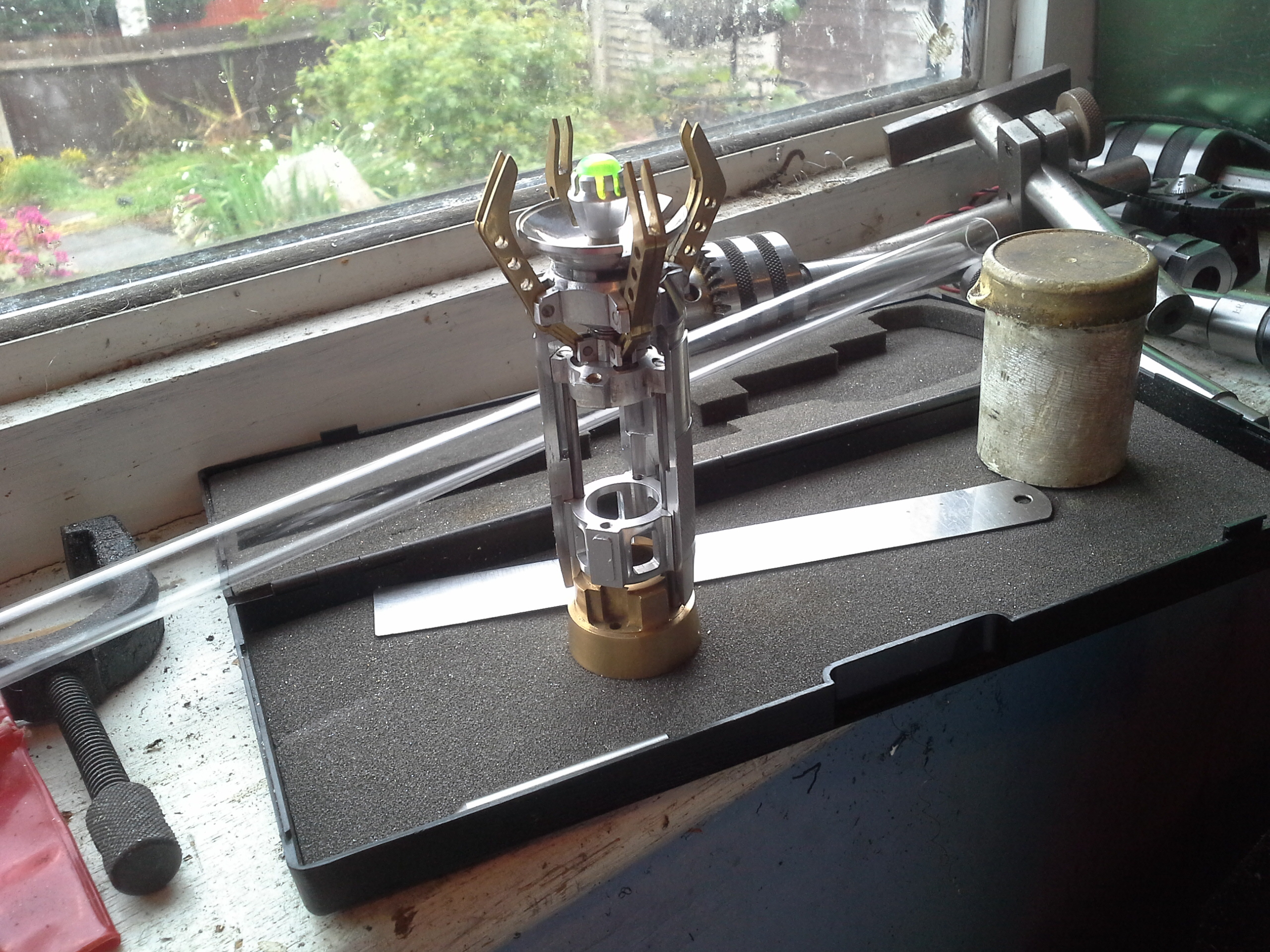

A jig was set up on the mill to machine each of the arms. Several operations were needed. In fact 4 operations for each arm. Also the dimensions were fairly critical, as the support arms held the head of the sonic, and the dimensions were already set. So over this weekend the arms were re-machined and test fitted to the new support ring.

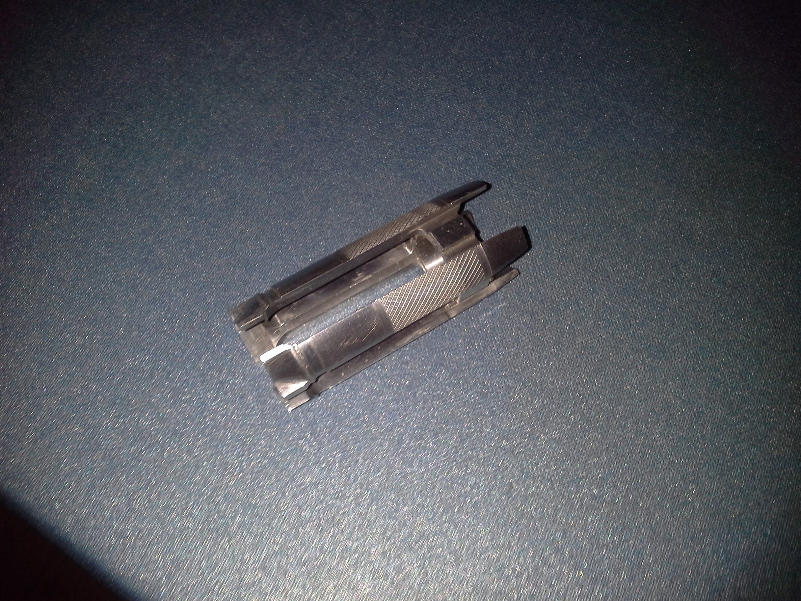

Construction of the new support structure.
After all of the arms had been completed. There was some adjustment needed for fit. After this work was done the assembly was temporarily secured using superglue including the head. There is still some work that needs to be done. The guides are still sticking and there are some paces where it jams. When assembled finally, it will be secured with epoxy for a more permanent fixture.
The Final Test assembly.

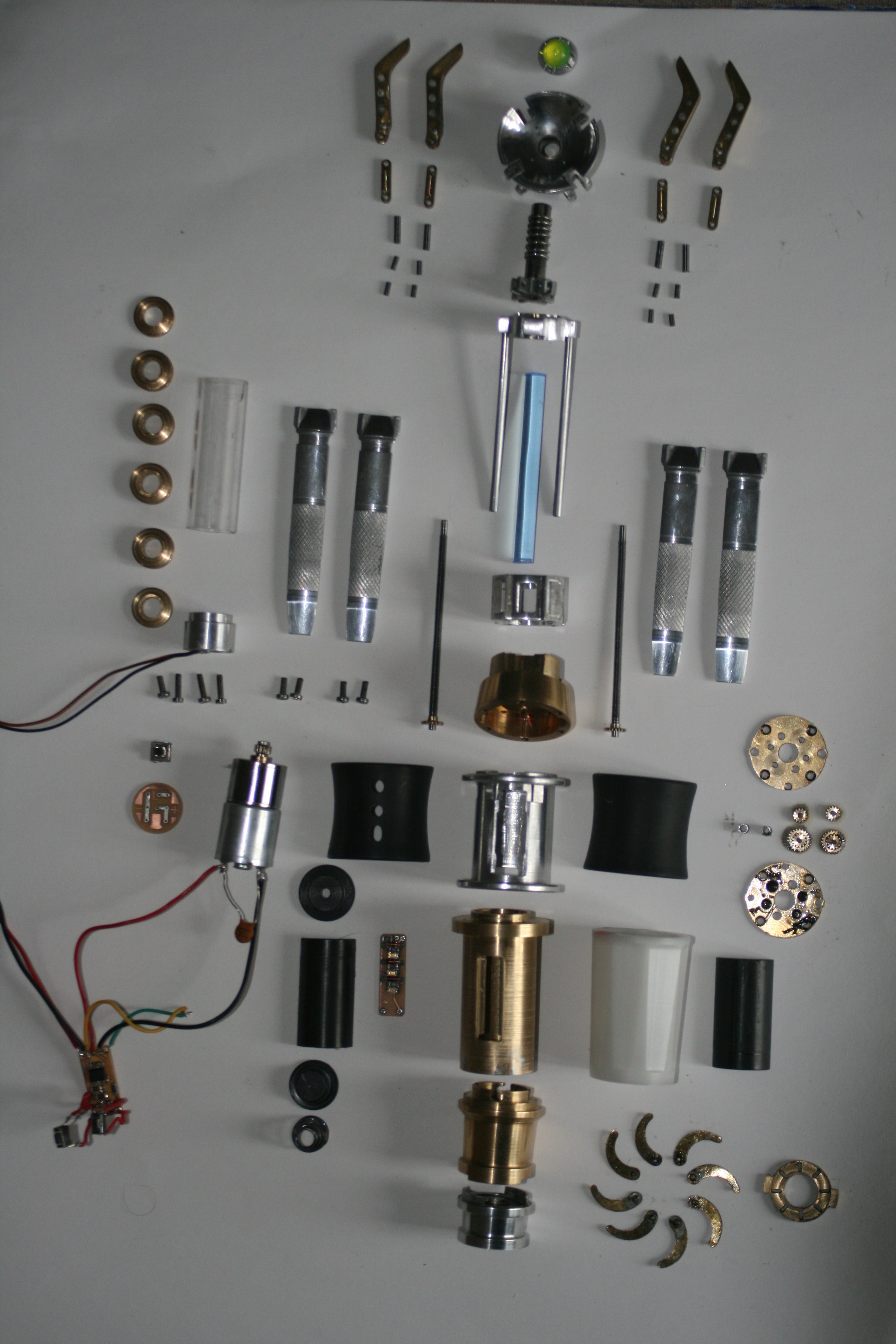

Almost all of the parts are now made. There are just a couple of circuit boards to make and test, including the switch board. Also the switch cover has to be made and then some polishing.
Here is a picture of almost all of the parts that will eventually end up as the sonic screwdriver.
You can see why I am having problems working out how to assemble it. :)

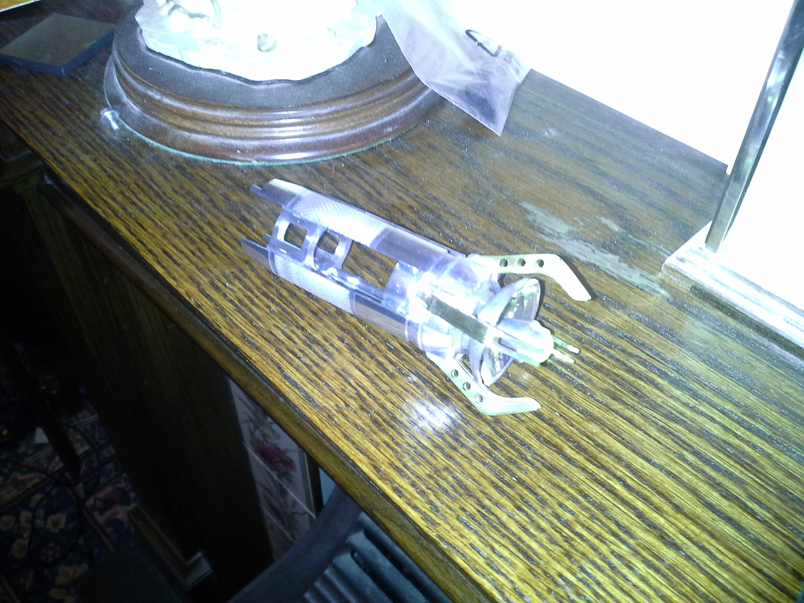

Hi there, well I have been busy, and there has been some progress. After I disassembled all of the parts for the sonic, I started the assembly process. Beginning with the very heart of the sonic. The extending mechanism. No mere spring and flick assembly, oh no. Something far more pointlessly intricate and complicated. I had to make two new gears, after one of them made a successful break for freedom. That took up quite a lot of time. But this evening, after some adjustments, the extending mechanism is complete and IT WORKS!
So without any further ado. a short video featuring my hand and the heart of the sonic...
Thank you for your time. feel free to comment, laugh, make plans for World Domination or have a nice cup of tea.
