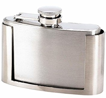

-Flask belt buckle: I ordered a plain one from Amazon (8.59 and free shipping) and am borrowing an electric engraver to put the logo in.

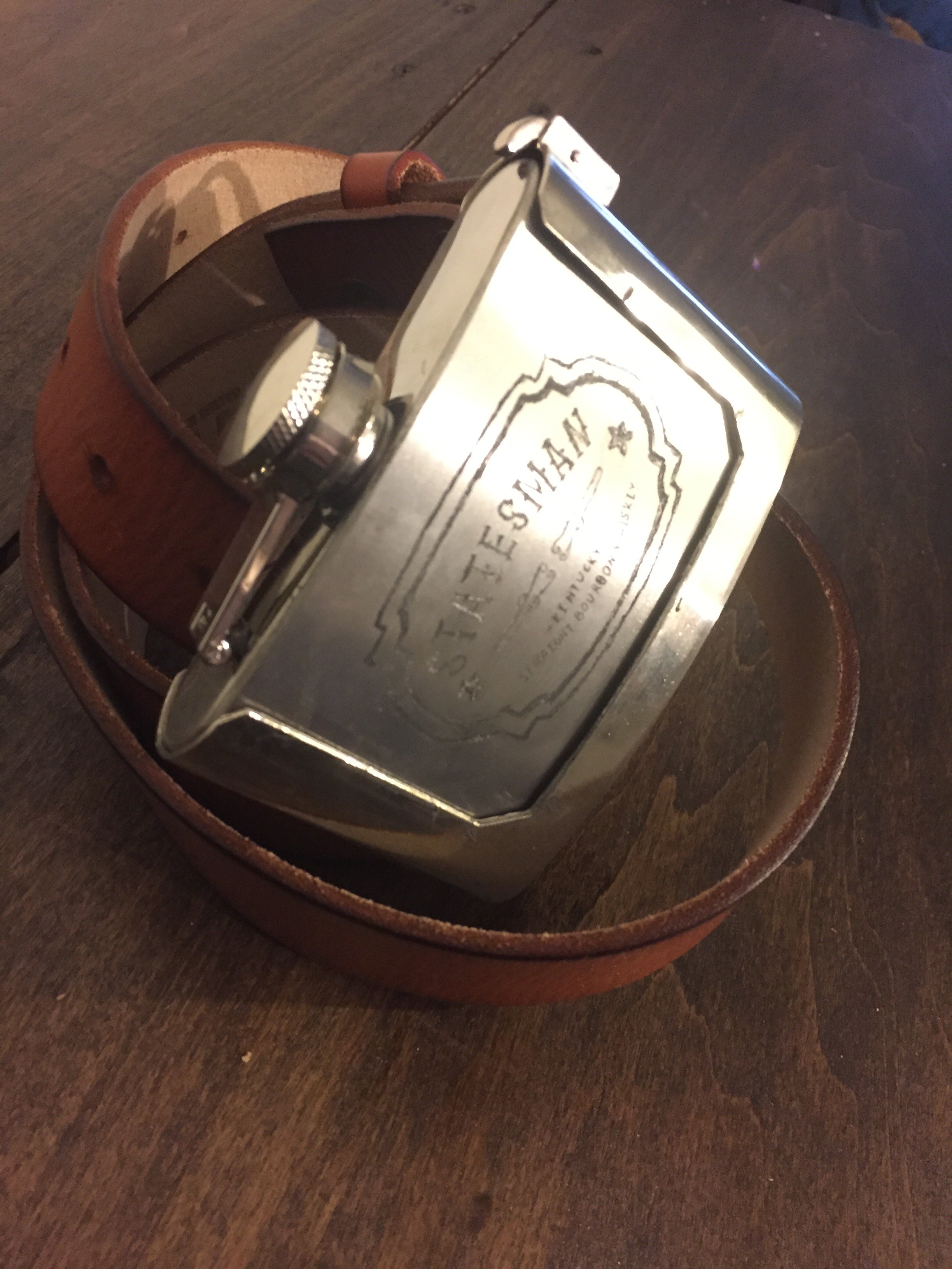

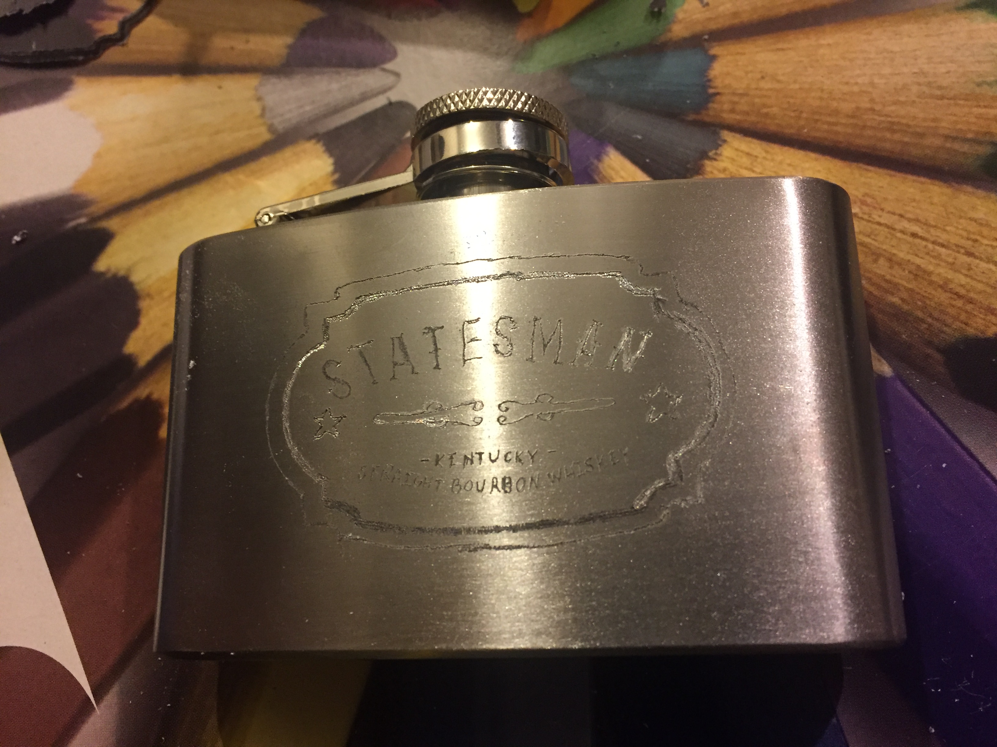

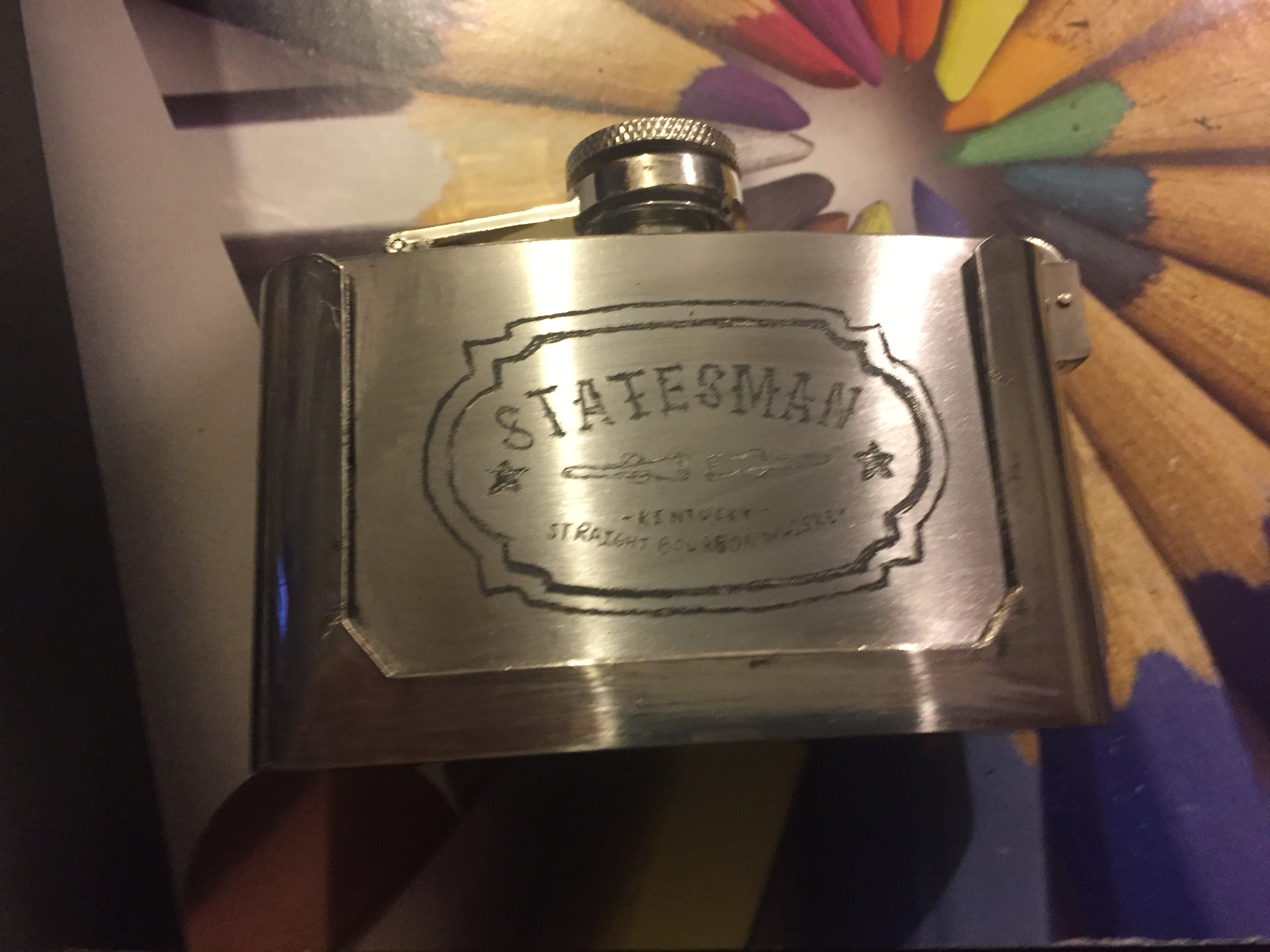

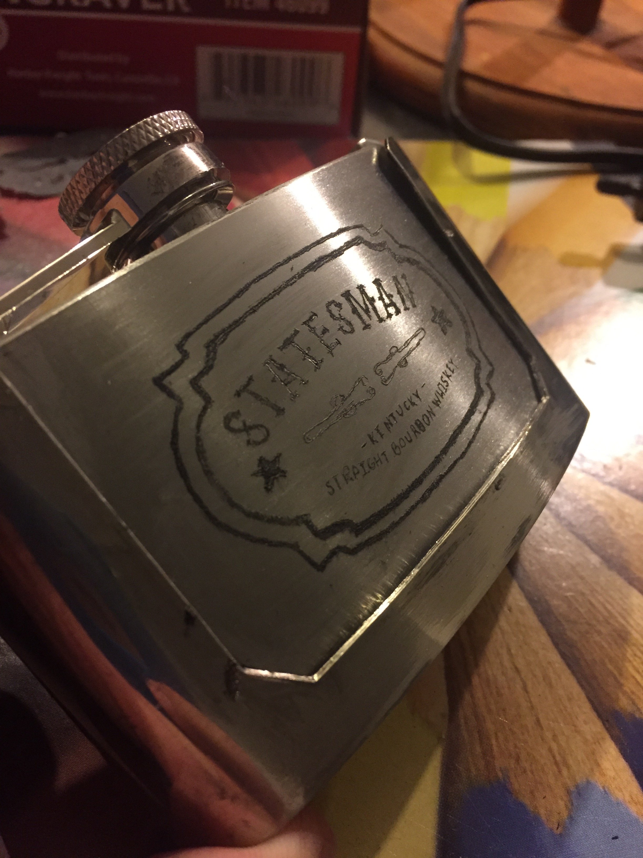

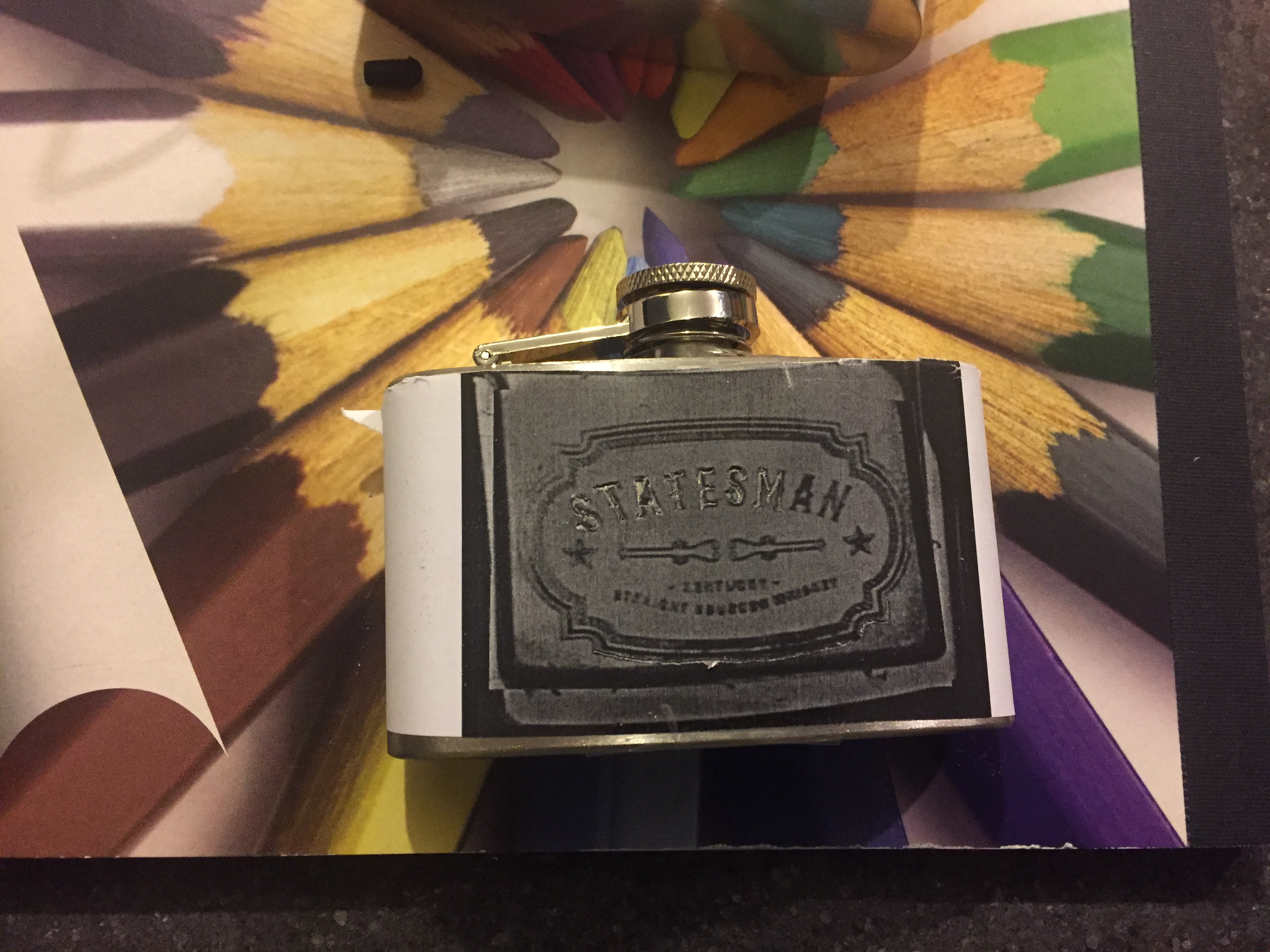

Here is the flask all finished. more soon to come with other parts as time allows!
1) Order a flask belt buckle on amazon for 9 dollars.
2) Borrow a carbide or diamond tip engraver
3) Print out a template, I had to manipulate a screenshot to make it flat. printing out on sticker paper would be best, but I don't have that luxury, so paper and tape worked perfectly for me.
4) Start engraving that sweet piece o' work. Go nice and steady, work from the inside out. laying down the fundamentals.
5) Now go back in and thicken up lines that need thickening, correcting shapes, letters, etc until you have your desired outcome, remember you CANNOT erase an engraver.
6) When I was all done I darkened up the engraving using black shoe polish and wiping off excess
Enjoy my friends, hope i have inspired people to try engraving themselves instead of paying a trophy place to do it for them.

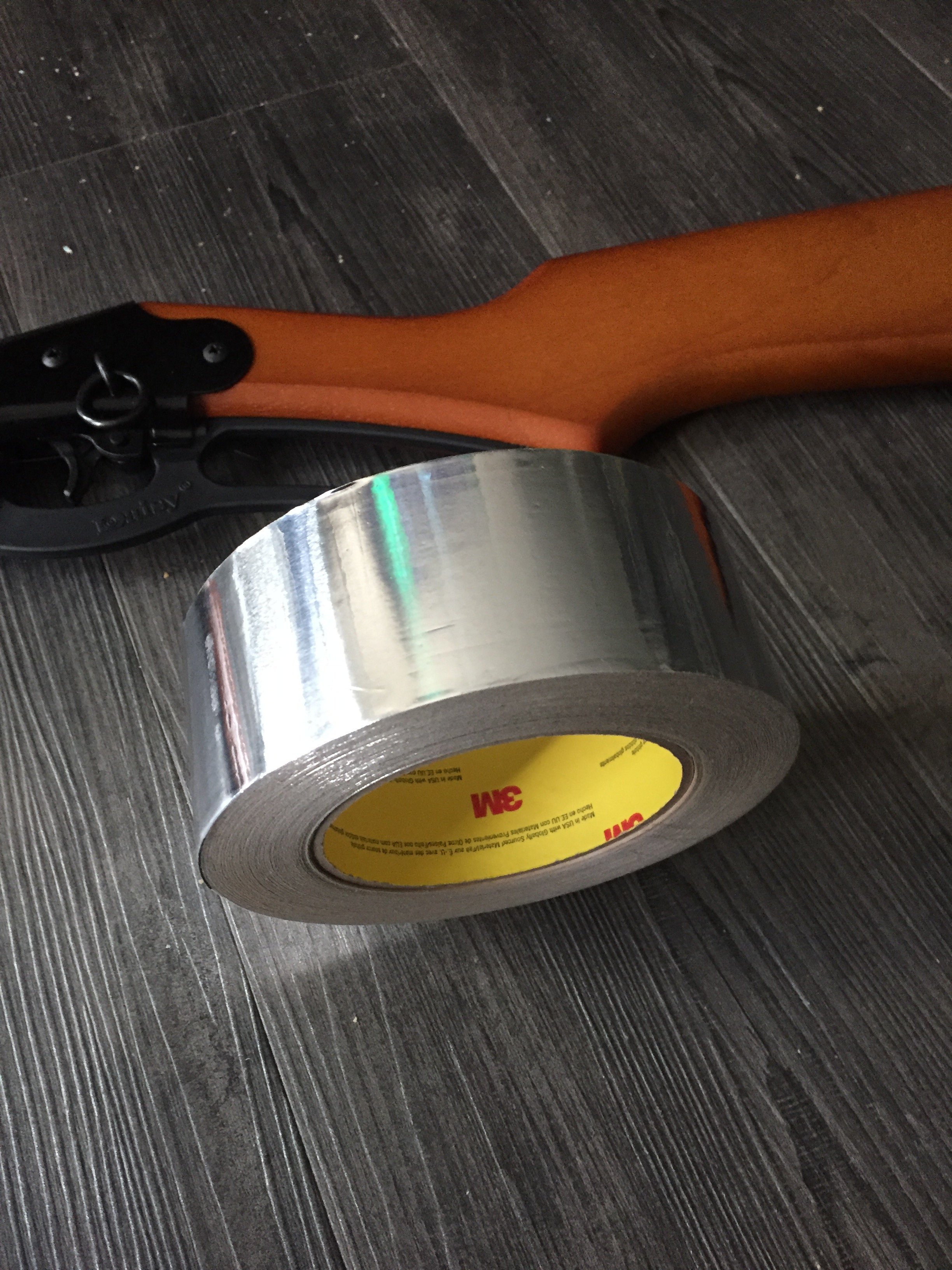

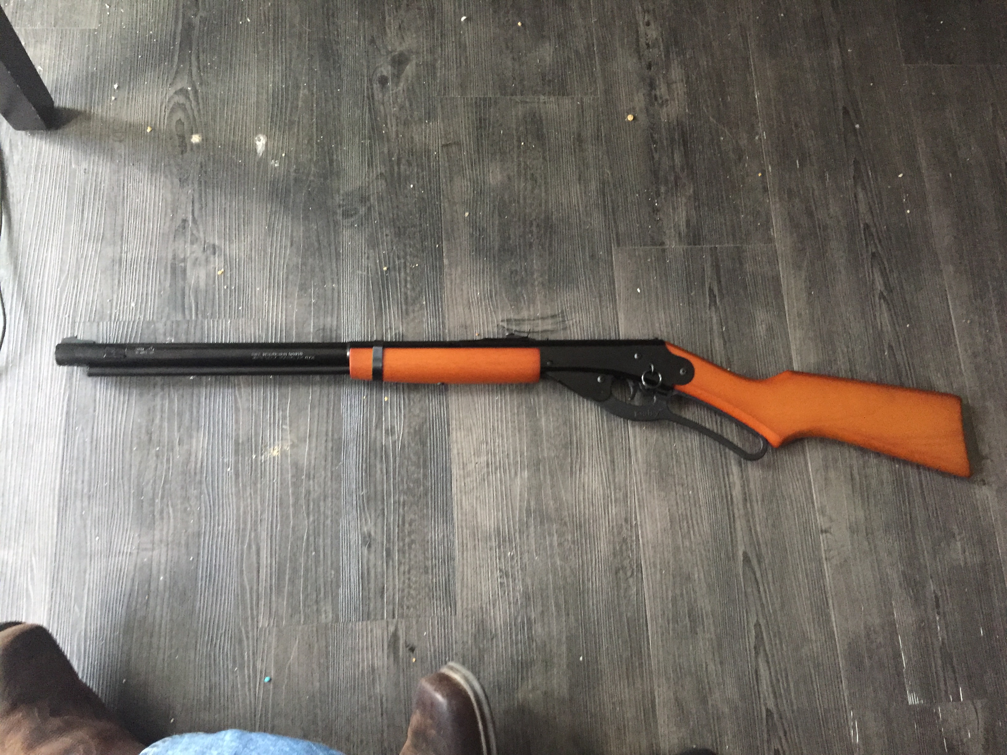

Alright my fellow makers. time for another update, today I will show how my daisy BB gun got a color change!
Materials:
- Daisy BB gun
- Foil tape
- rubbing alcohol
- SHARP blade
- steel wool
- emery board
- silver & gold rub'n'buff
- leather (optional)
I got this daisy rifle on a deal for cyber monday (idk why, it's not electrically technological), give everything a good clean with some rubbing alcohol. this will help the tape stick harder than properly prepared sushi rice.
Now get some foil tape, I used foil tape to experiment with it, since I had never used it before.
Cover that sucker where you want it to be silver. and after, take down some of the shine with steel wool, it'll look more like a silver henry lever action rifle that way. I kept the sights black to contrast. I put gold rubnbuff on the bracket to make it look brass.
NOT PICTURED: I sanded off the daisy emblem (with an emery board) in the plastic lever and rubnbuffed that sucker silver to match the barrel. I also am getting some leather/ faux leather (whatever is cheapest at the thrift store) to make a cheek rest/bullet holder to cover up the RED RYDER engraving. I will edit this reply when I get that done, just figured you all would like to see some progress made on Agent Bourbon.
