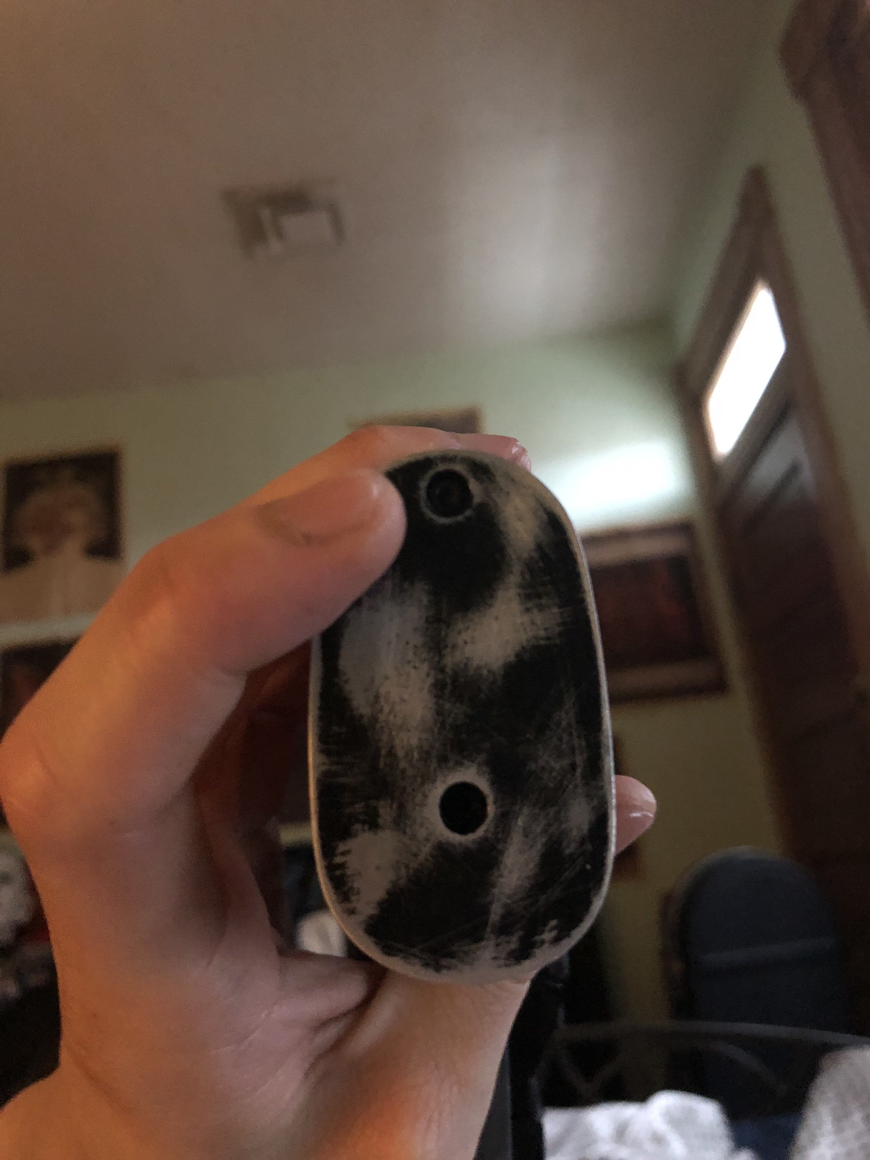

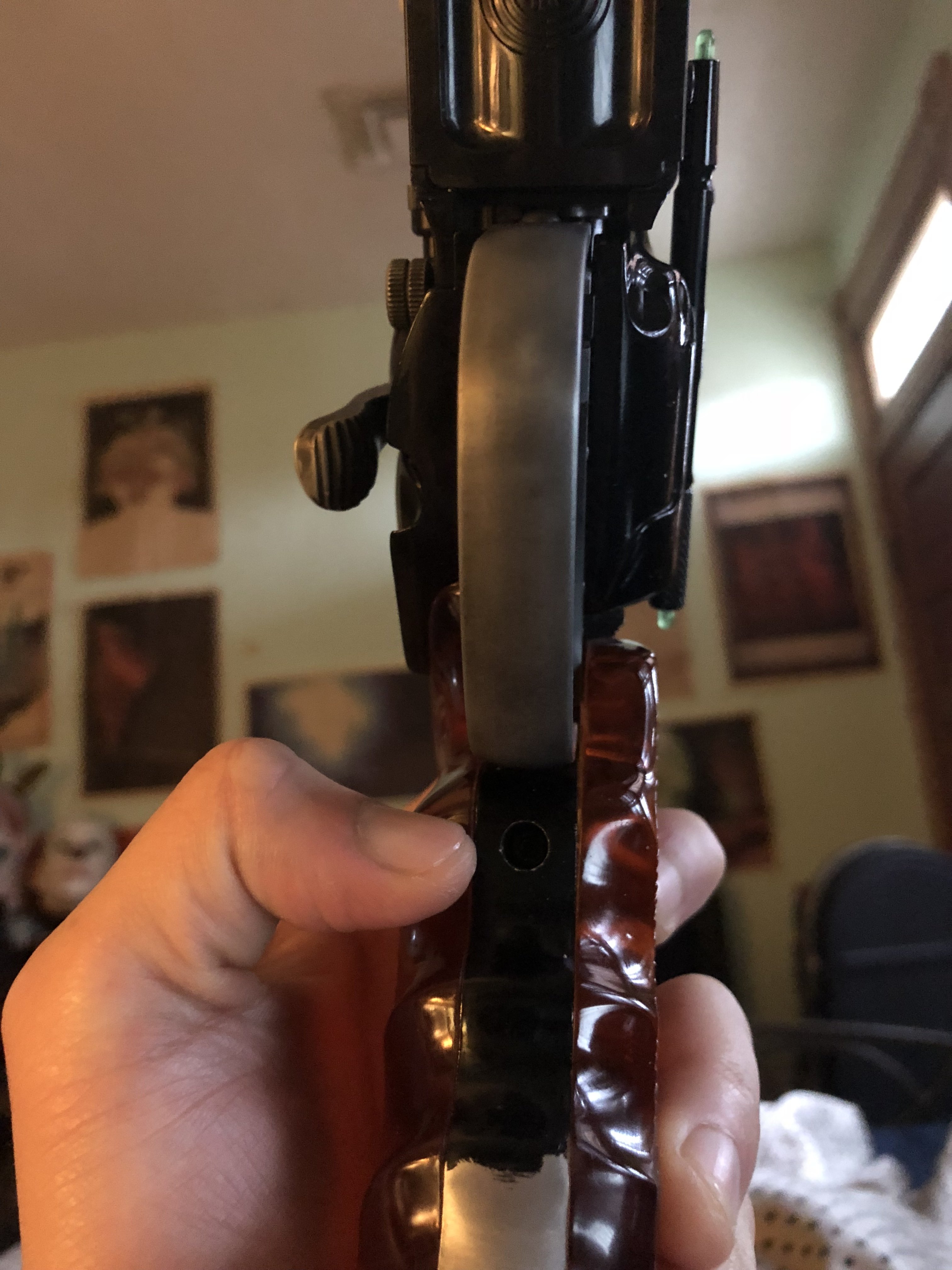

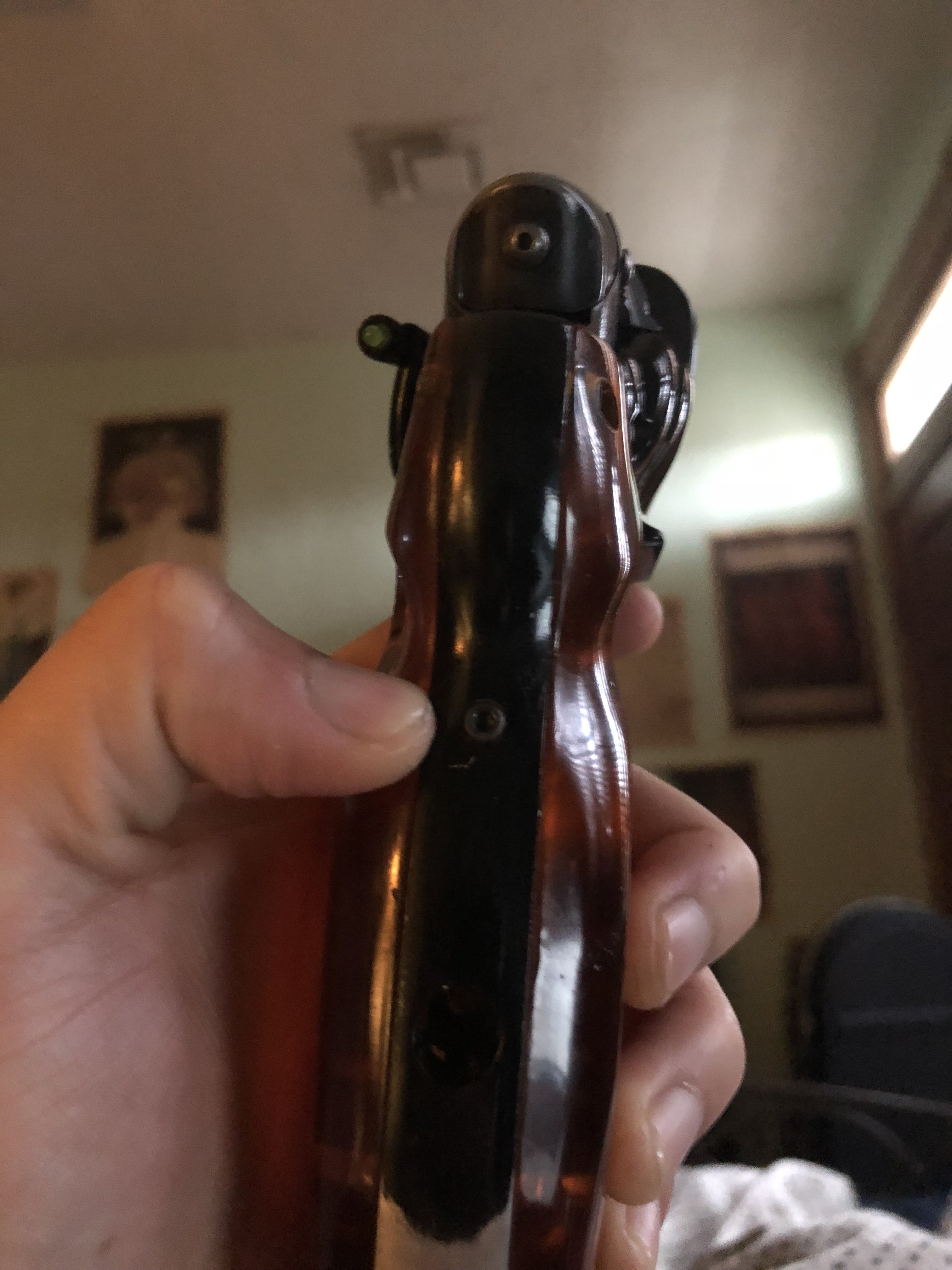

The whole of the rest of the gun seems slightly loose from the grip. If I hold the handle grip tightly and gently shake from side to side, there is a little play with the rest of the gun as if the handle isn't tightly attached to rest of the gun. Not excessive play but definitely doesn't feel solid. Hard to put into words so hope this description helps.
@Kylo1 can you be a little more specific about which part is wobbling?[/QUOTE
These are the three(indicated by my thumb) that actually make contact with the revolver grip. Tighten them and you should be fine.

Thanks for that. I’ve taken the grips off and tightened those highlighted as much as I dare. It’s still not 100% solid but certainly better thank you. I’m planning on leaving this Tomen in an “as new” condition which is why I’m being so careful with it.

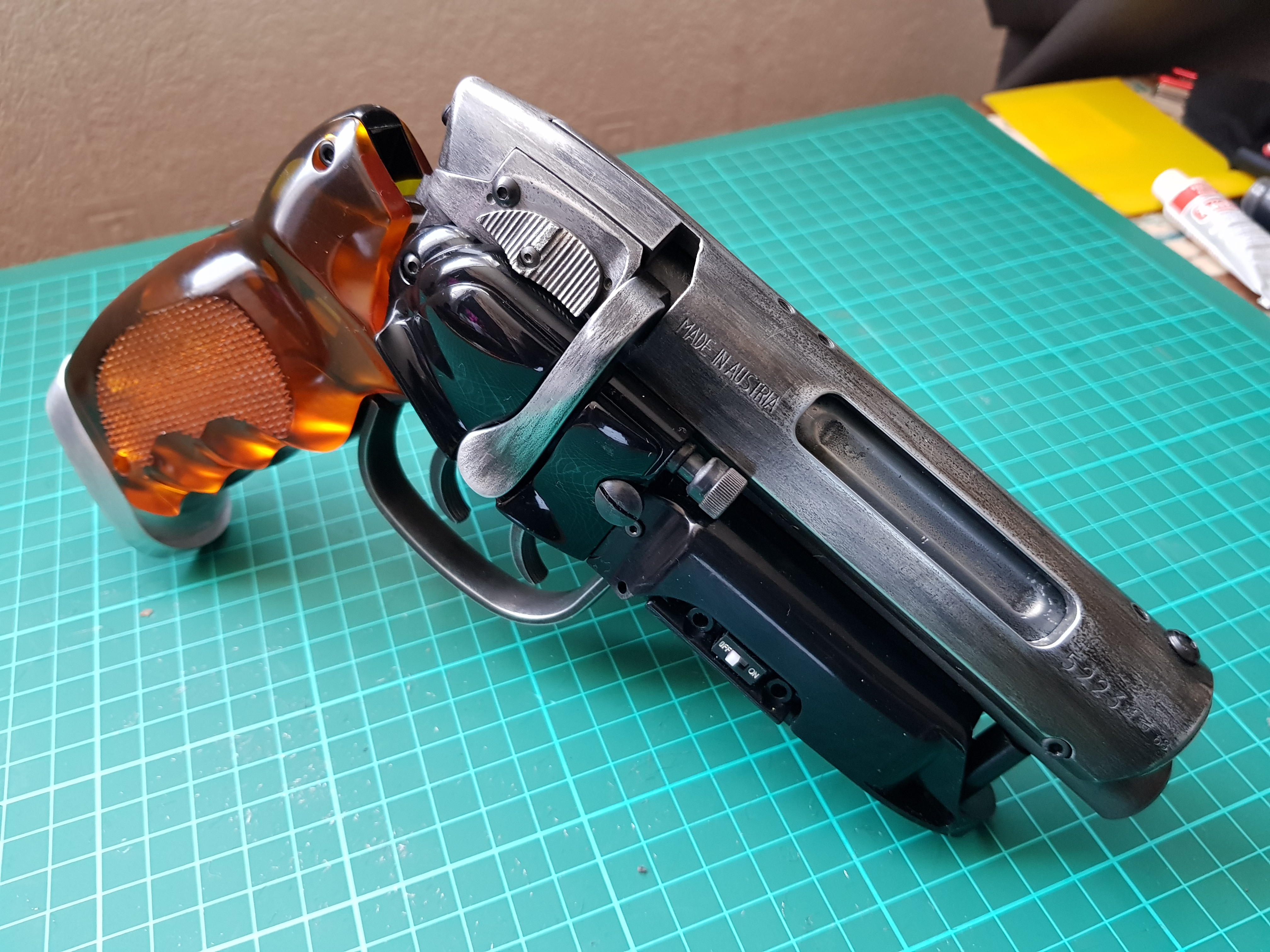

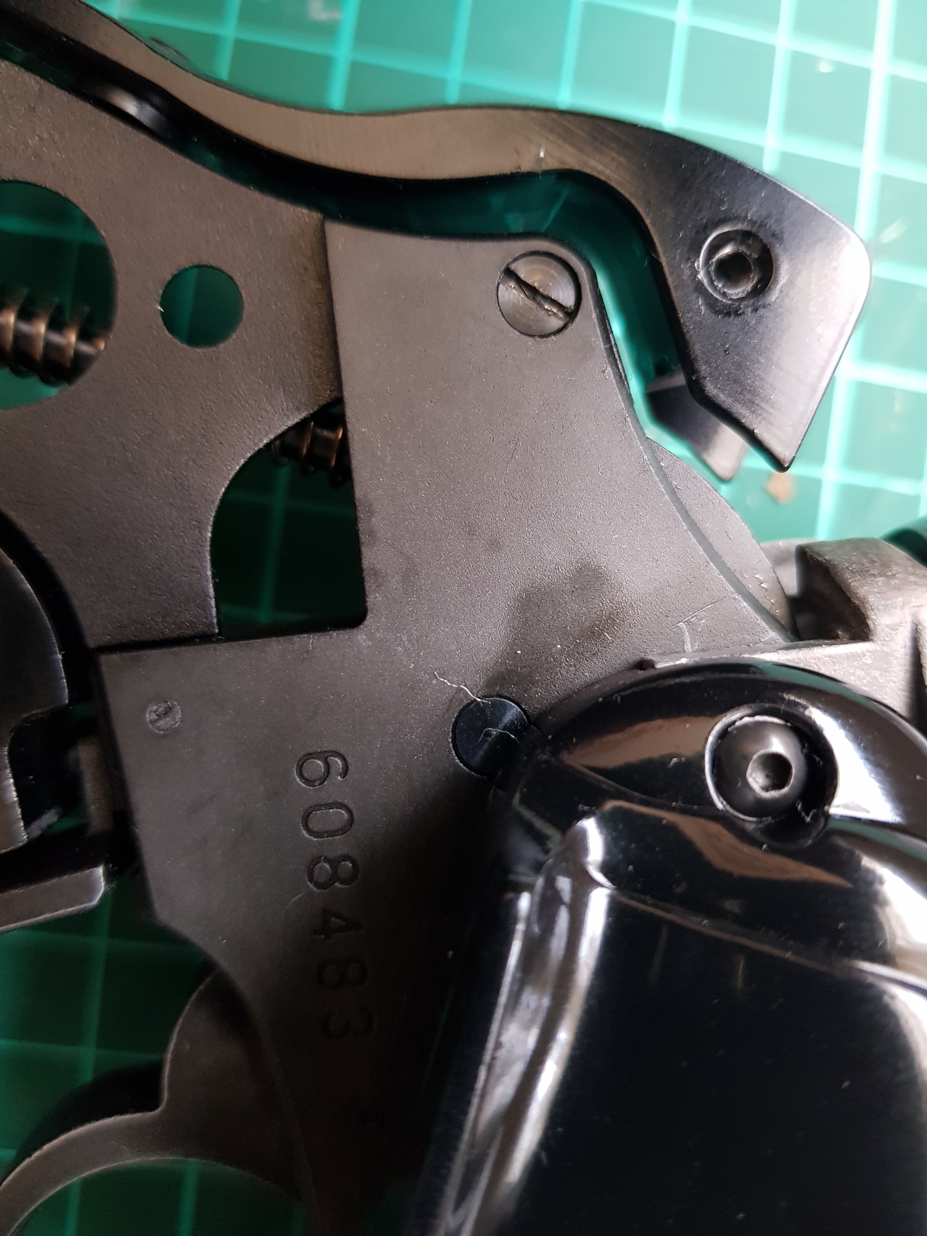

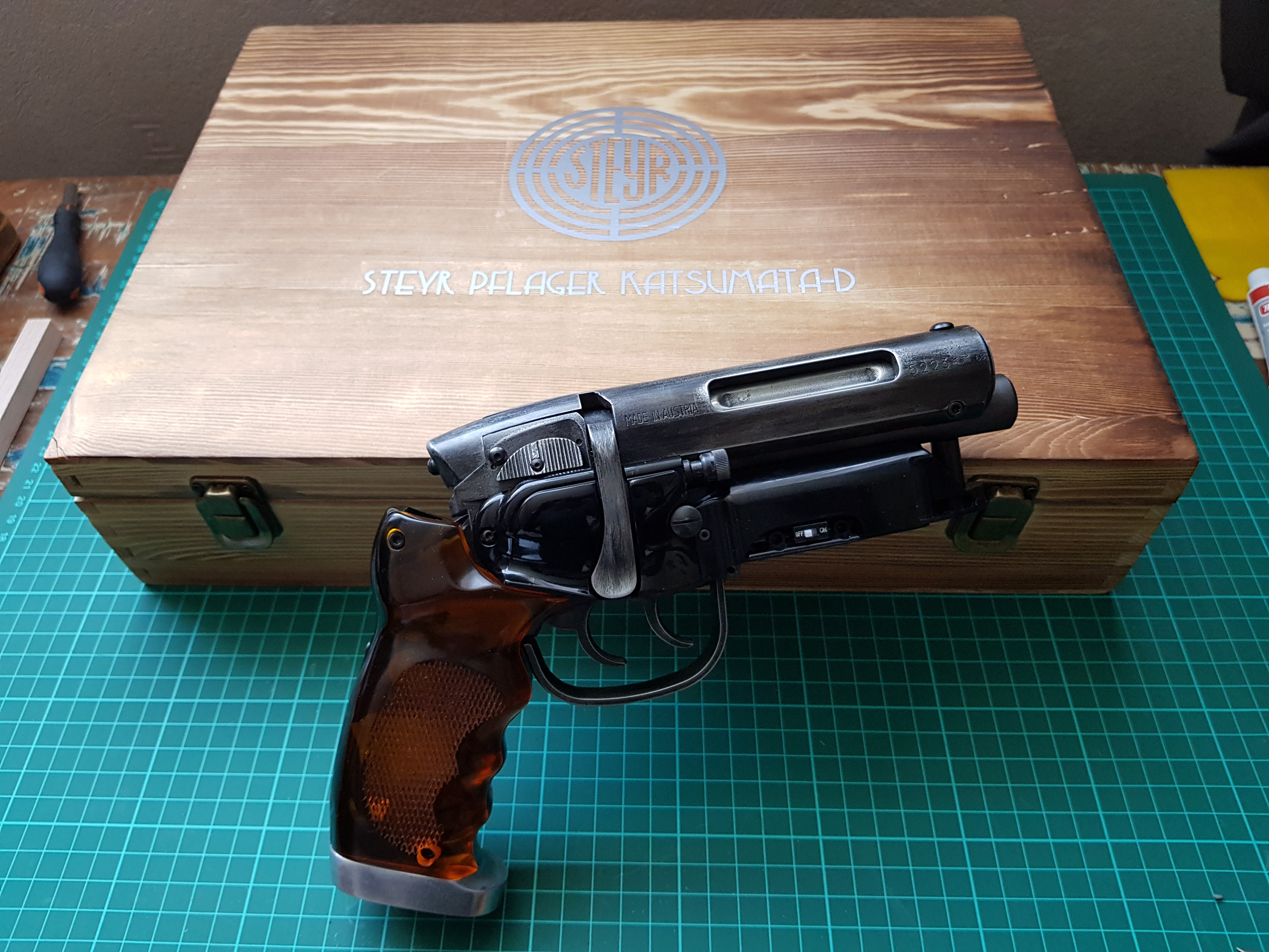

Just completed the re-finish of 2049 and came across the same problem, I tightened the two slot screws on either side of the main frame and seems to have done the trick, hope this helps.

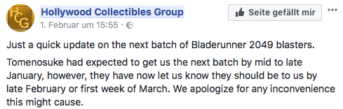

I saw it on their Facebook page

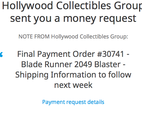

BUT!...I just got a mail from PayPal saying that I should transfer the rest (paid a deposit when I preordered)
So I guess that goes for all of the peeps that are waiting for theirs.

When I paid mine off last week or so, the gentleman at HCG said they were still on track to recive the blasters from Japan this month.
I was also told my blaster would be part of that incoming group;)
