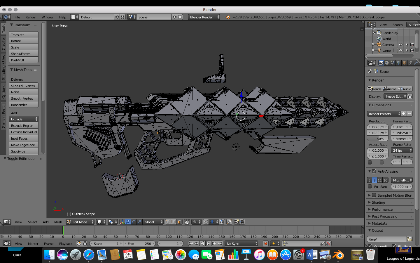

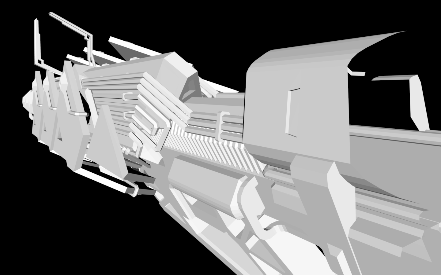

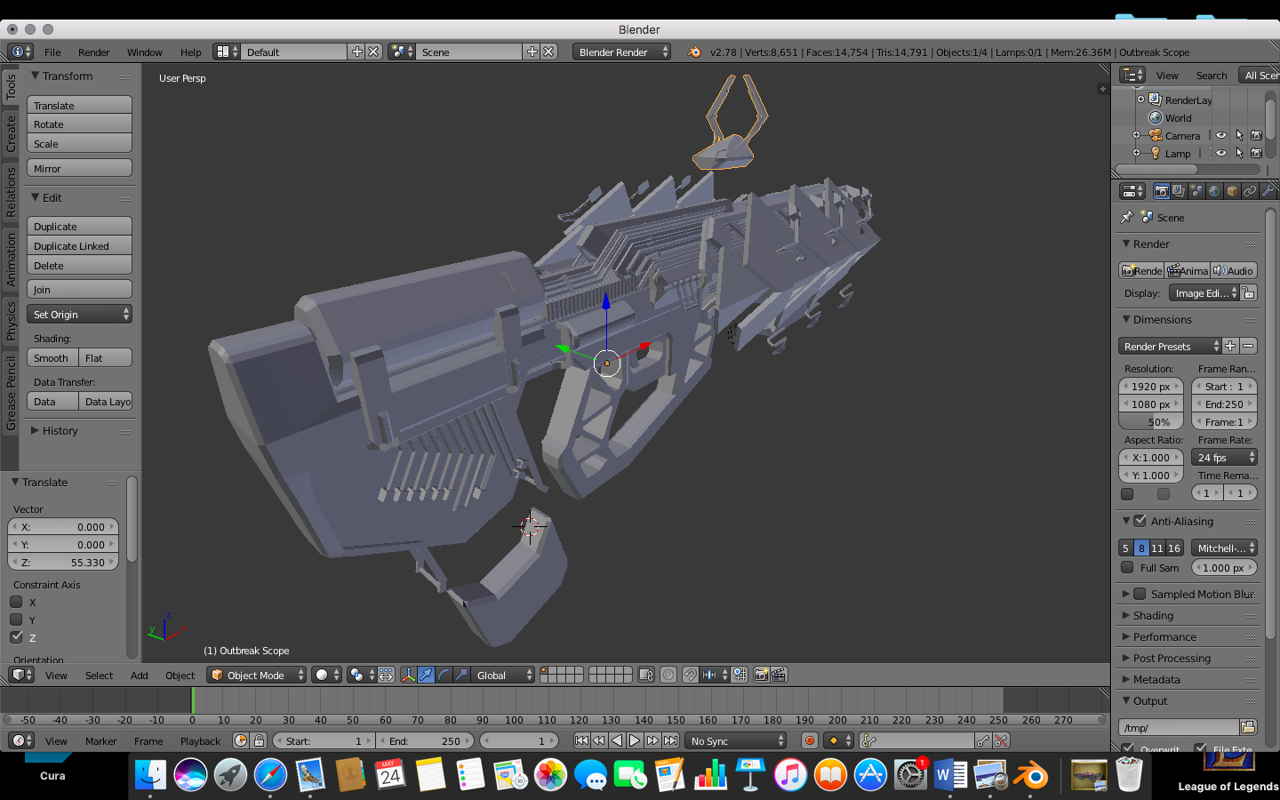

The 3d model is still a work in progress with some details still MIA; like the groove patterns on the magazine and the handle but, thus far, I am very happy with how this has turned out. Depending on how this turns out I've got some great potential plans for this bad boy. To the furthest extreme I'd like to replace the 3d printed "wires" with maybe EL wiring to make it glow with SIVA just like in the game.
Hopefully I can tidy up the model soon and have some parts of the rifle printed.

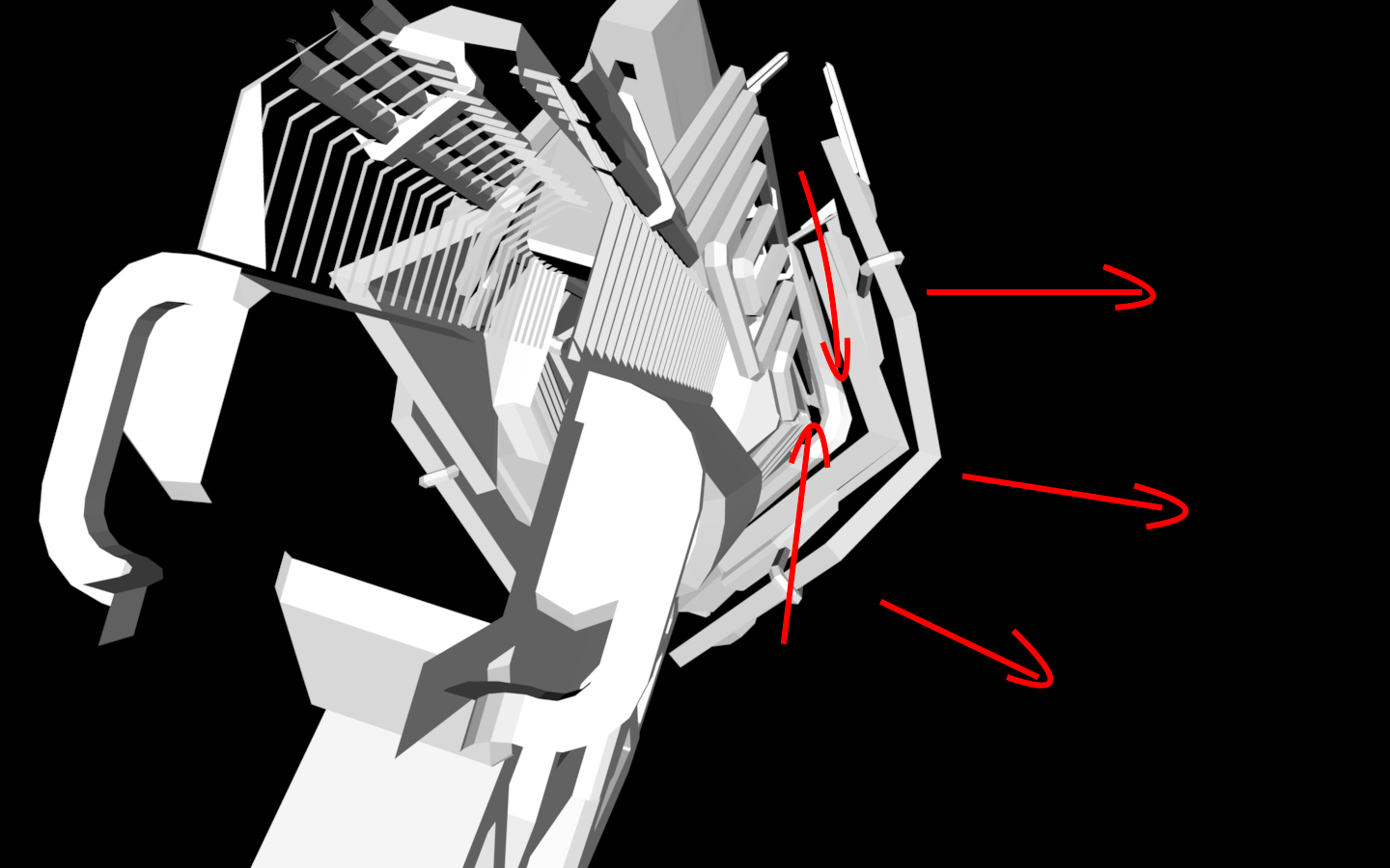

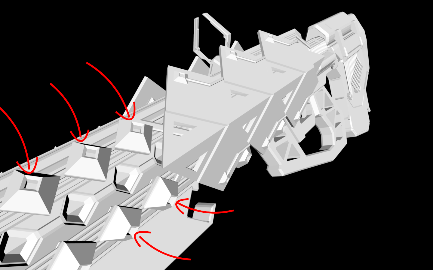

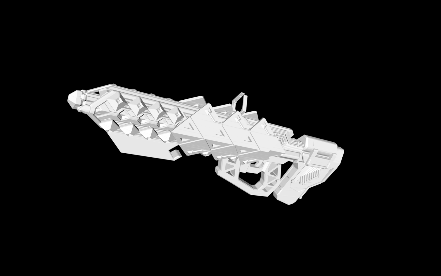

Despite the bad luck it has given me some time to work out the nitty gritty of the project and where it will go. Originally the plan was to use the 3d print to create a mold and go from there. Problem is, the model is so complex in shape that to make a mold around it may not be possible. The model would have to be broken down or may even need to be recreated to accommodate the molding step.
Some pictures to illustrated what I'm talking about:
The little SIVA pyramids on the front of the model would make mold making a challenge along with the wires that run a majority of the length of the replica. The plates on the sides would also have to removed from the core model and done separately and then later reattached as there is space between the body and the plates. Such a feature might wreak havoc with mold making. In general, the front half of the print could prove difficult but the back half seems to be free of complex shapes that may make mold making a task and a half. Another ambition I had for this project was to wire the model with EL wires to make the replica as close to the in-game weapon as possible. With the wiring, same solution of reworking the model would apply.
Ultimately, I will first print the model to make sure everything checks out, judge to size and just inspect the print to see how I can do what I want to do and then we'll go from there.

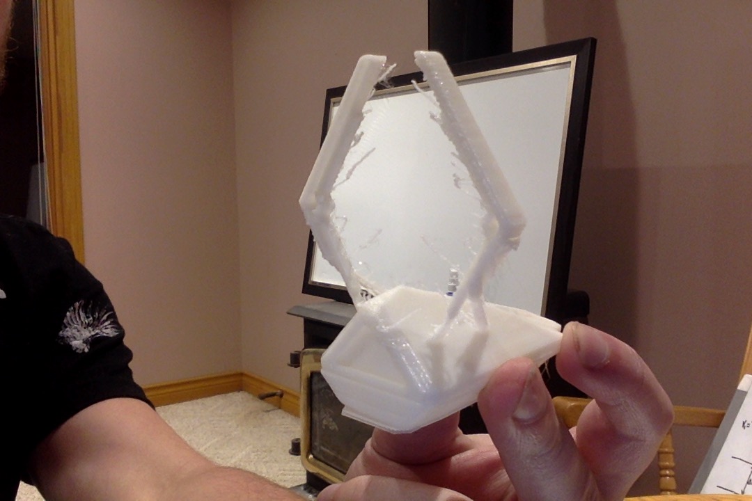

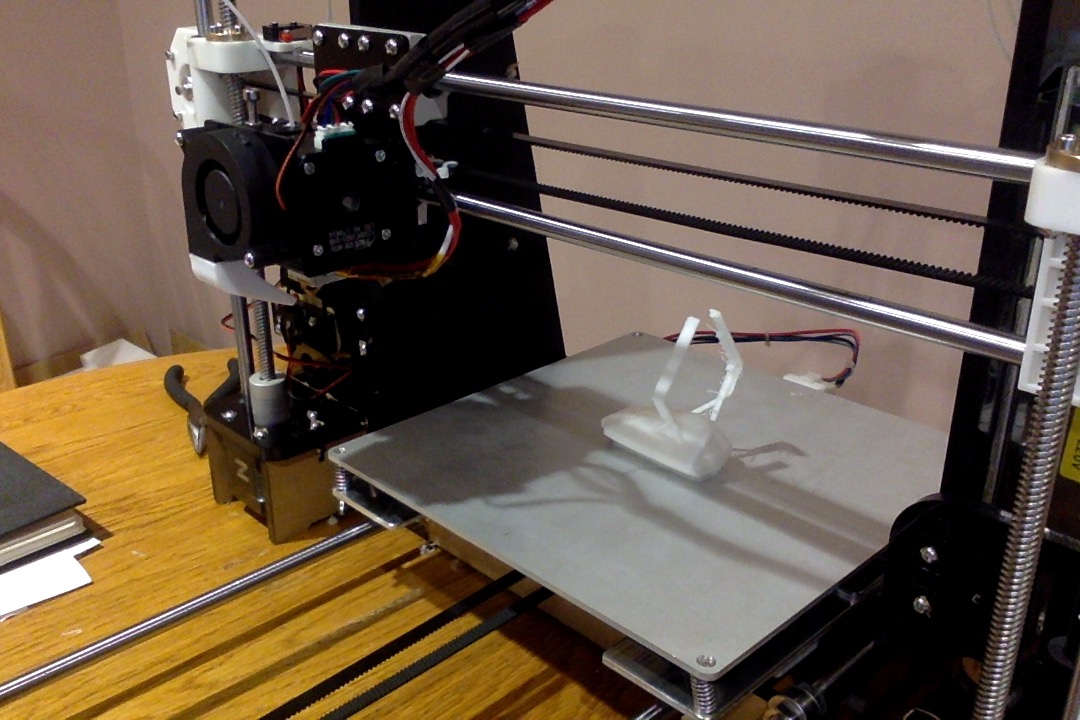

Printer is set up and ready to go. Had to tinker around with it a little bit but I've got it how I like it. Did some test prints with some of the provided files and I thin I've got it dialled in and ready to go. I took the sight off the main gun assembly and decided that it was a good piece to start, mainly because this is the most finished piece I have from the model and with it I could see how the printer would handle the model and well...
Pretty good!
I printed without supports or an adhesive base and it turned out pretty alright. The two sides have some filament sticking off them but that'll be easy to remove with some sanding later down the line. More to come!
Wow, it's a crazy model. I agree that you'll probably have to break it up for moulding.
Expect some trial and error with the 3D printing - I'd suggest printing a calibration cube or something similar to confirm dimensions in all axes.
Time to calibrate! Also, simplify3d is a good slicer if you haven't looked into that yet. It makes certain parts of prints just a tad cleaner too than almost any other slicer out there.
Some friendly advice coming from someone who makes prop guns for a living, I would print that main body, do the solar panel bits out of sheet material like styrene, and print or scratch build one of the "siva" pyramids and cast a bunch of copies. Those cables towards the back of the receiver I would delete from the file and recreate them after the print with brass rod, which will hold up well and bends sharply at those edges. leave the cable mounts on there, half "open" if that makes sense so you can easily glue your rod down. You could use wire too I suppose, it just wouldnt look as clean.
Sanding PLA cables like that doesnt look fun with the nooks and crannies it would create!
Halving the cables is an interesting idea what might work really well! I'll definitely have to try that out when I print the prototype.

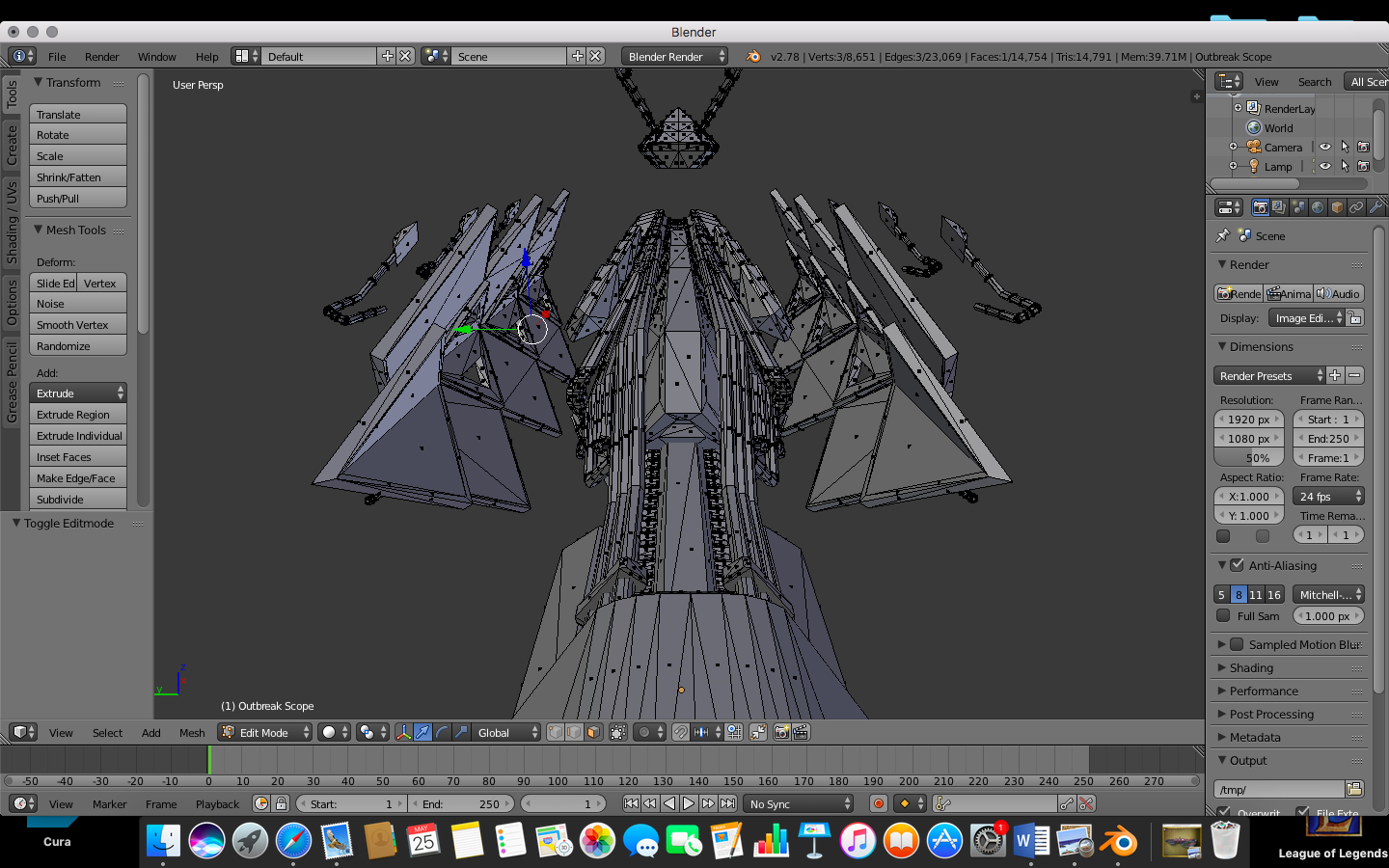

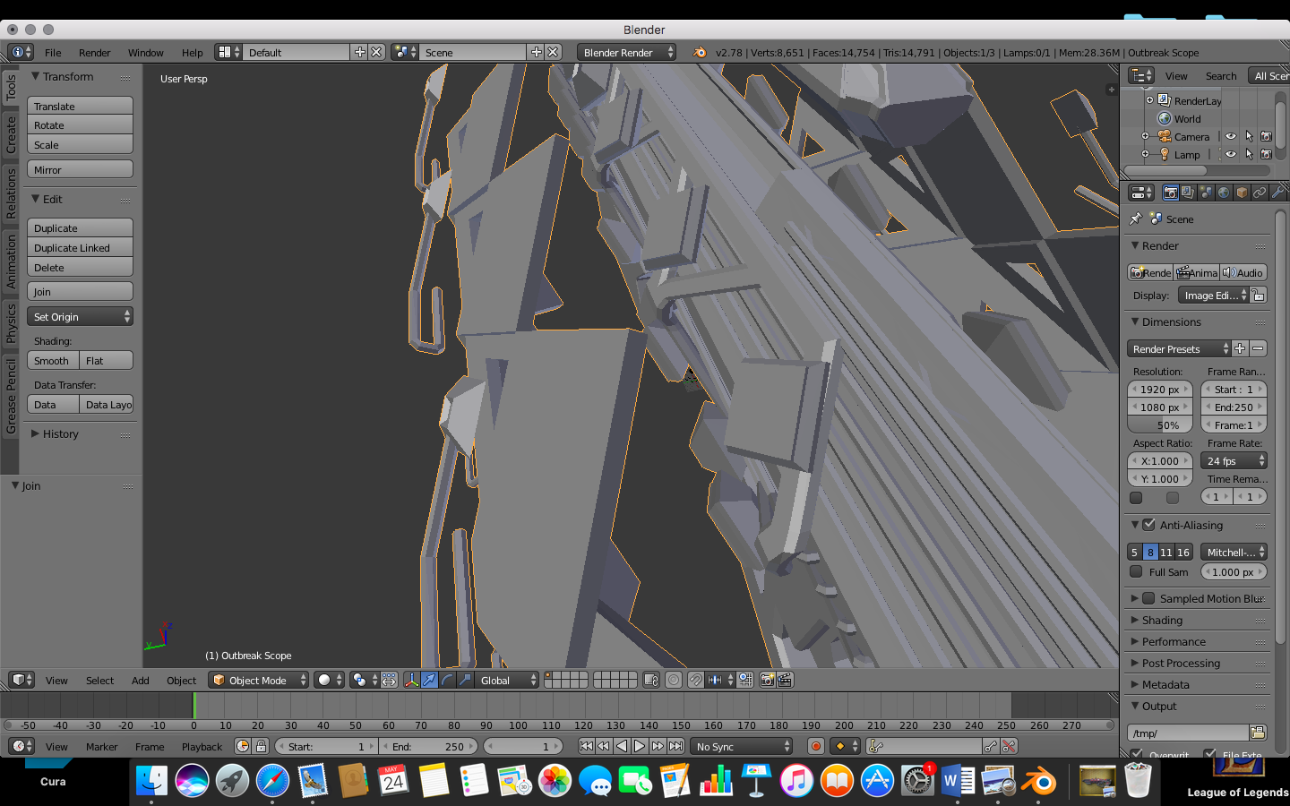

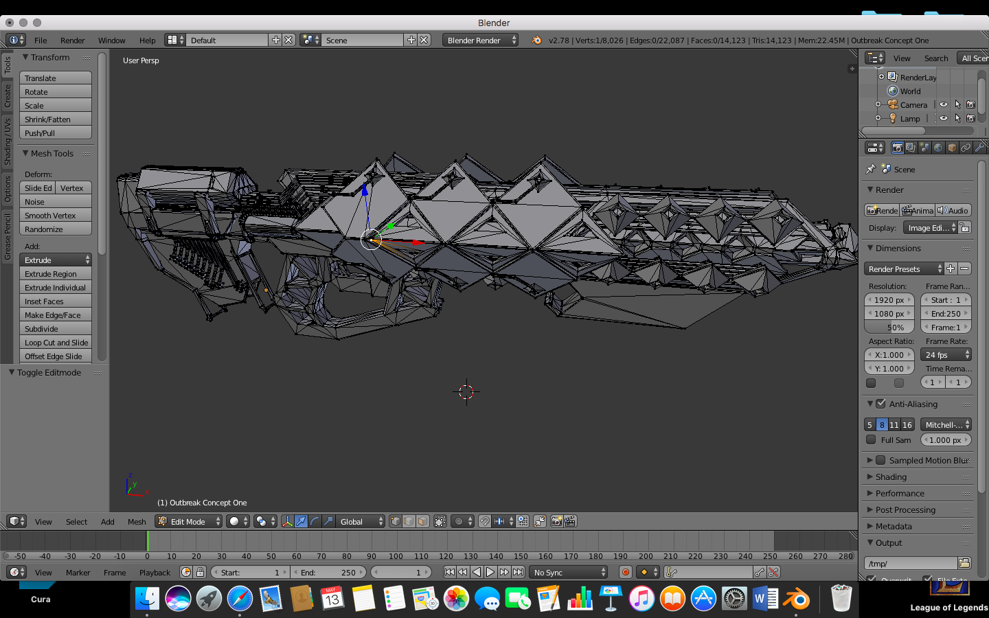

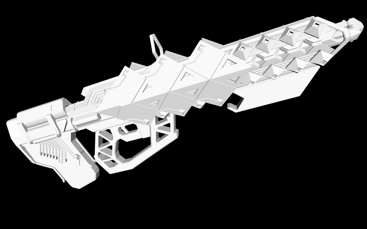

Screen Shot 2017-05-24 at 10.26.57 PM.pngScreen Shot 2017-05-25 at 12.46.28 AM.pngScreen Shot 2017-05-24 at 11.10.54 PM.pngScreen Shot 2017-05-25 at 12.46.19 AM.png
I've chopped the file into its more basest parts: main body, side paneling, sight, magazine and some smaller detailing. The side paneling now has little plates that it'll attach to that comes off of a scaffolding (best word for it I guess) that extends off of the main body. That can be seen in the third picture. The detailing that rests on the side paneling, I think, as a pretty clever design in which it's kinda like a paperclip and will attach it the panels. The groove detailing on the under barrel grip and the magazine still need to me added. Been busying with the disassembly of the model and preparing it for the prototype print. Much of the grip detailing, like the various screws I've decided will be handed in after the print to give it some authenticity. The cables, also seen in picture three, might have to be removed in order for sanding (thank goodness for 3d printing :lol :lol:lol)
