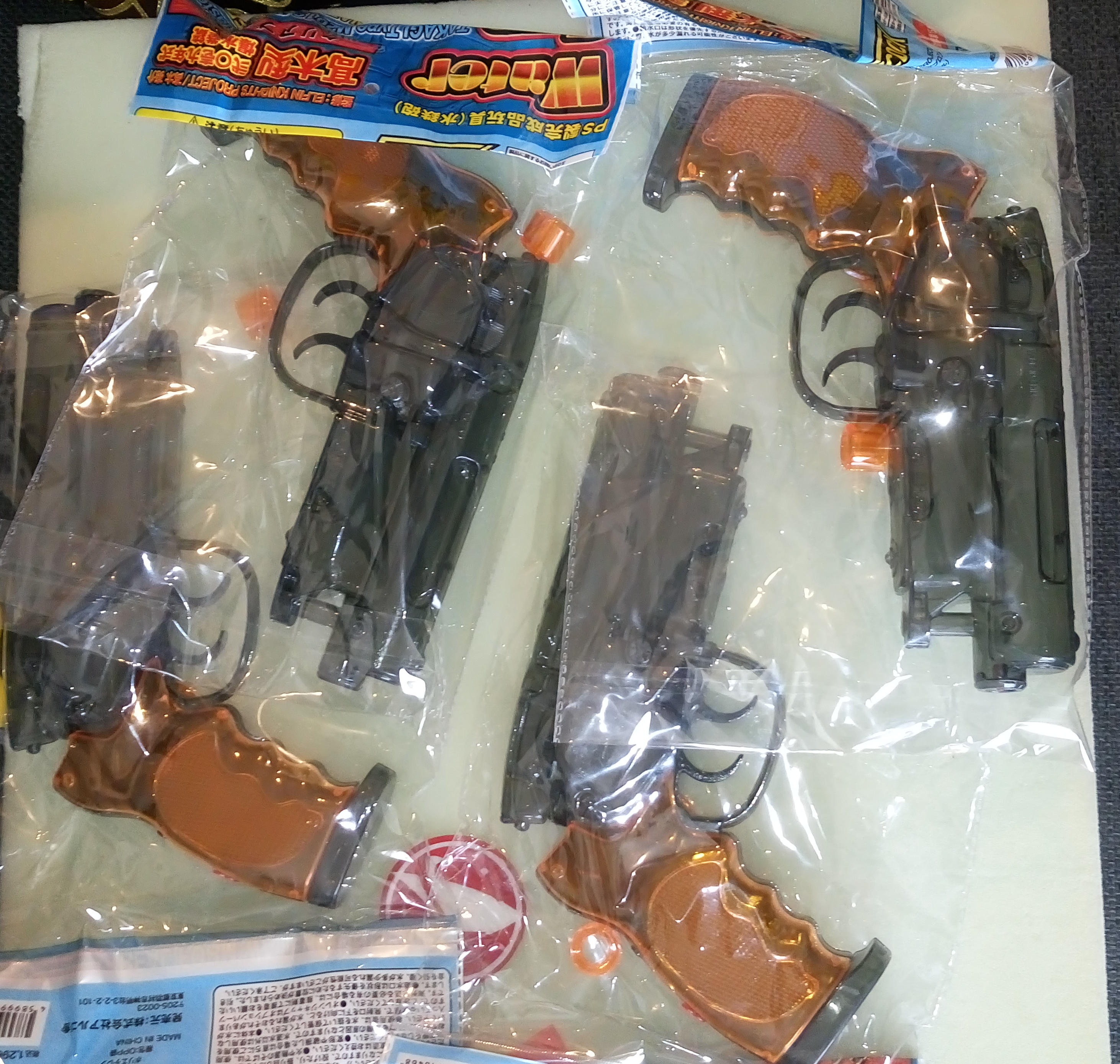

Amazon.jp seem to have them in stock at the moment for 2,479 yen (about $23) for the clear black/orange and 1,680 yen ($15) for the clear silver / blue. No idea what shipping cost would be (I'm in the UK) or indeed even if they ship to the US (they don't ship to the UK). So you might need a friend in Japan! Do a search for "Tagaki Type 2019 Blaster" or for "Fullcock".

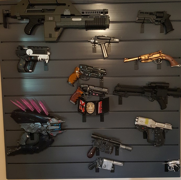

Yes. This and many other blaster replicas, I have never had a problem. If it doesn't highly resemble an actual existing firearm, you will not have an issue. It just might get tied up for a bit if they have to screen it.
Everything on this wall was imported except the airsoft pulse rifle.

i managed to get one with the amber grips earlier this morning ($73au all up to Aus)
normally anything from Amazon takes 2wks to get over here but this one won't be delivered apparently for another 4-6wks :(
worth it though if i can get it finished anything like candykillers :thumbsup
