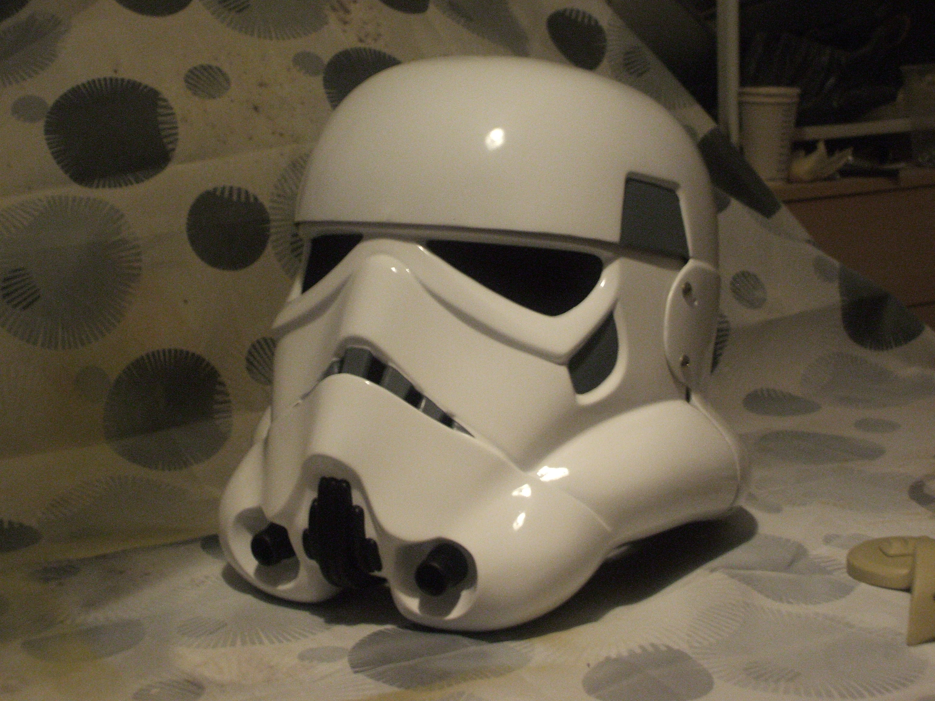

First Pep attempt, Old School Hero Stormtrooper. Casting.
Leigh
Hi, I thought I'd share this here :)

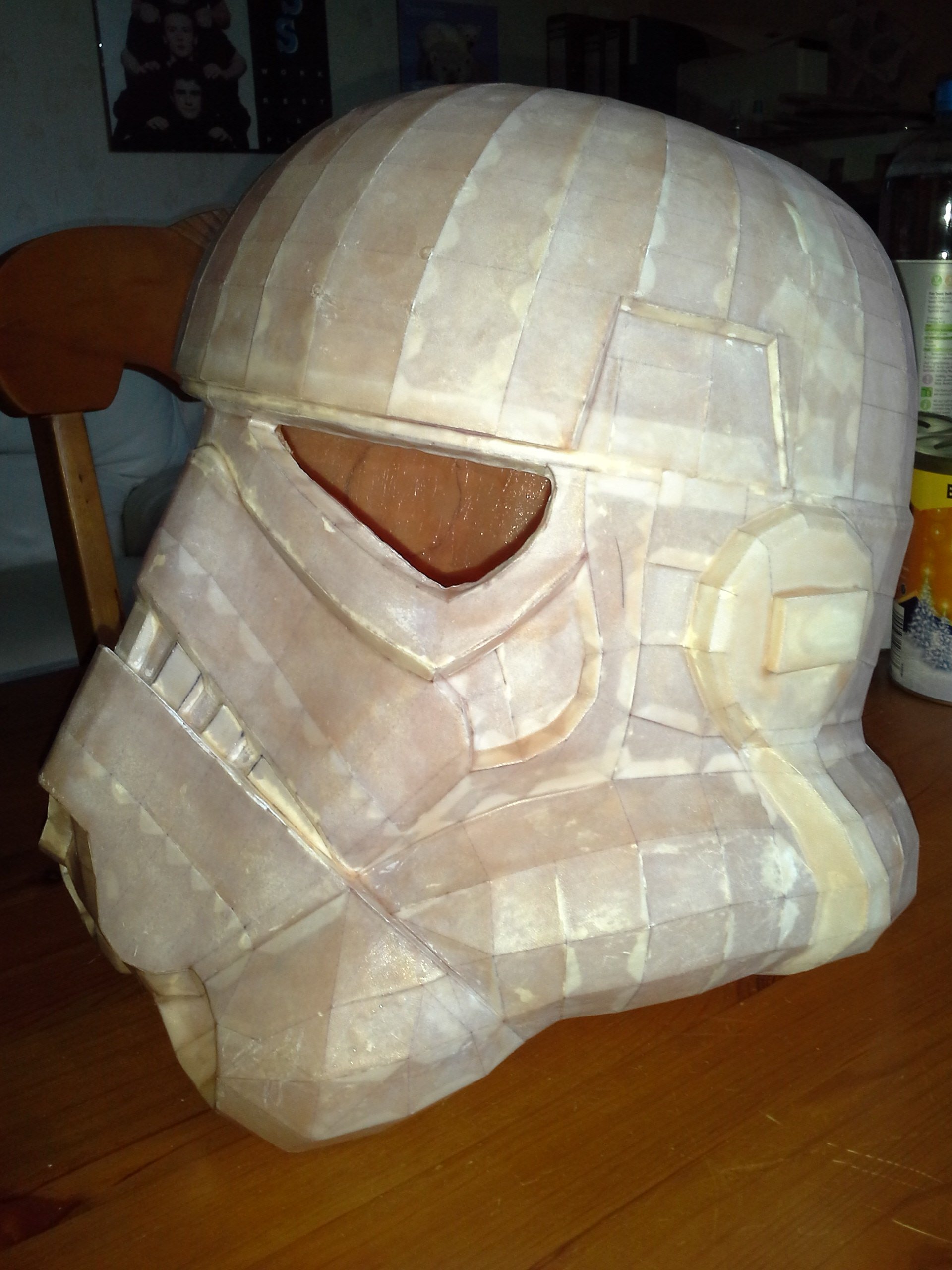

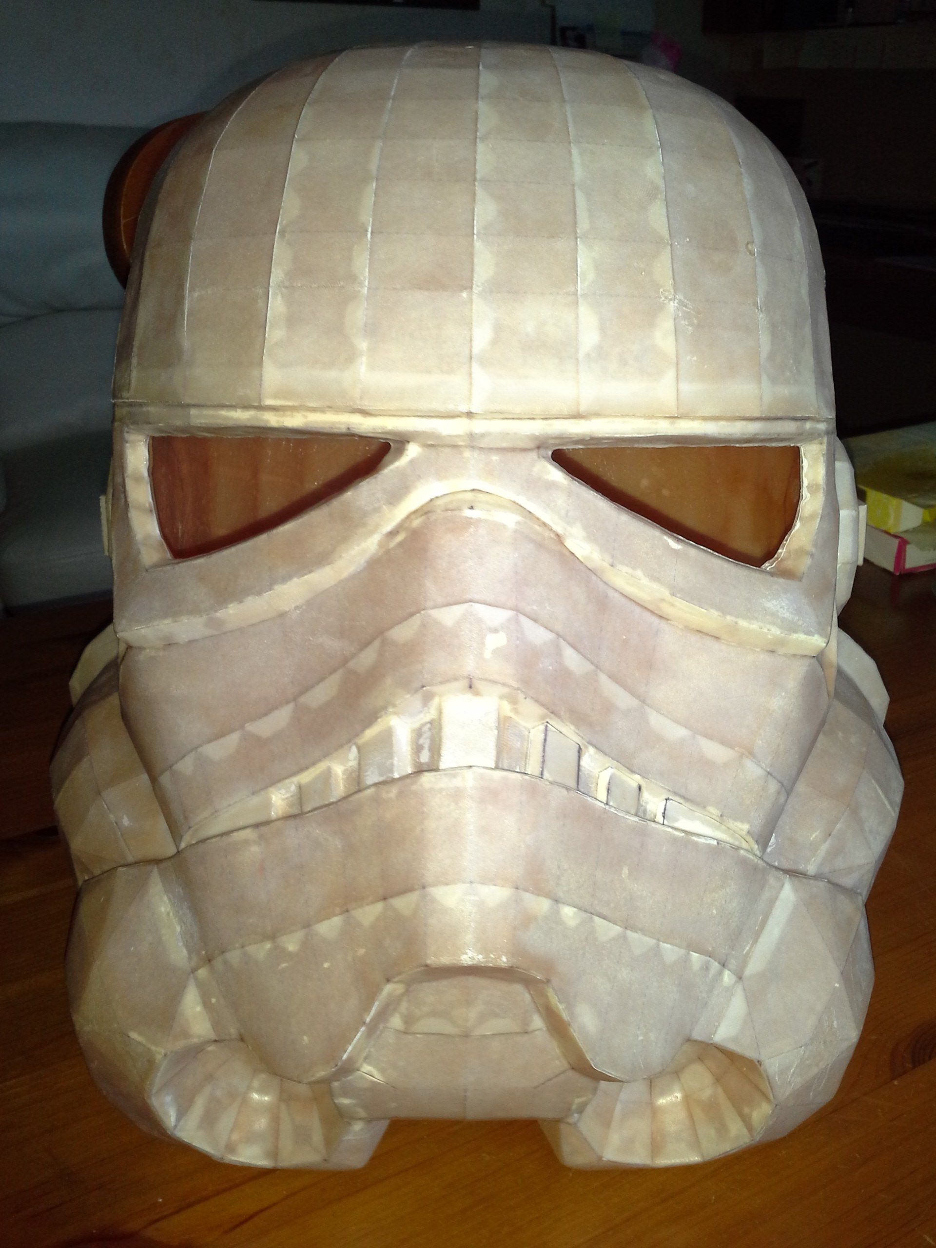

This is my first Pep attempt. I've wanted to have a go at Pepakura since I joined the RPF, I had some quiet time over Christmas so I thought I'd give it a go.
I decided a Stormtrooper would do for a first attempt, I figured if I can pull this off then maybe a Cody & Scout trooper would be nice to have a go at :)
I started searching the forum for files & found this: http://www.therpf.com/showthread.php?t=174677
Looks good so lets give it a whirl :) Found a free viewer & went ahead & printed it off on regular printer paper (thought I'd best do a test run first). Happy with that I went out & bought some 240gsm card & a couple days later I'd got an impressive looking rigid Stormtrooper lid :)
I bought some Polyester resin & painted the outside first supporting it from inside as I didn't want the top of the head to be flat. I gave that two coats & it soaked into the card nicely. I then knocked up another batch & poured it inside & sloshed it around until everything was covered.
Next I laid up some Fibreglass on the inside, just a couple of layers overlapped.
That all went well & a couple of days later I attacked it with 40 grit on a sander :devil
That got rid of all the high spots & then I skimmed the whole thing with polyester filler.

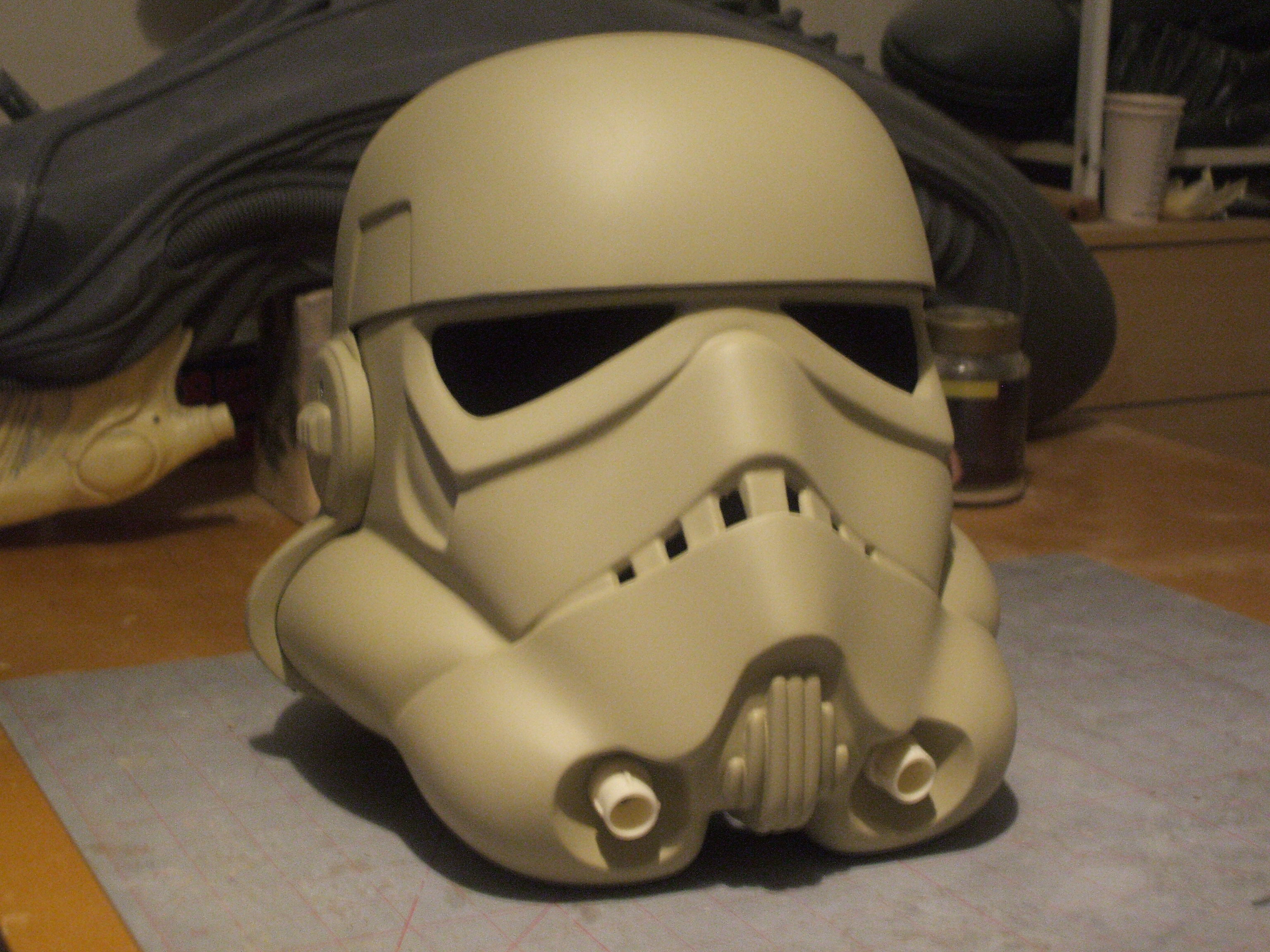

After more & more filler, some adjustments, scratch building some parts in polyurethane & a few coats of high build primer....
That's where I'm at so far :)
Is it up to scratch?

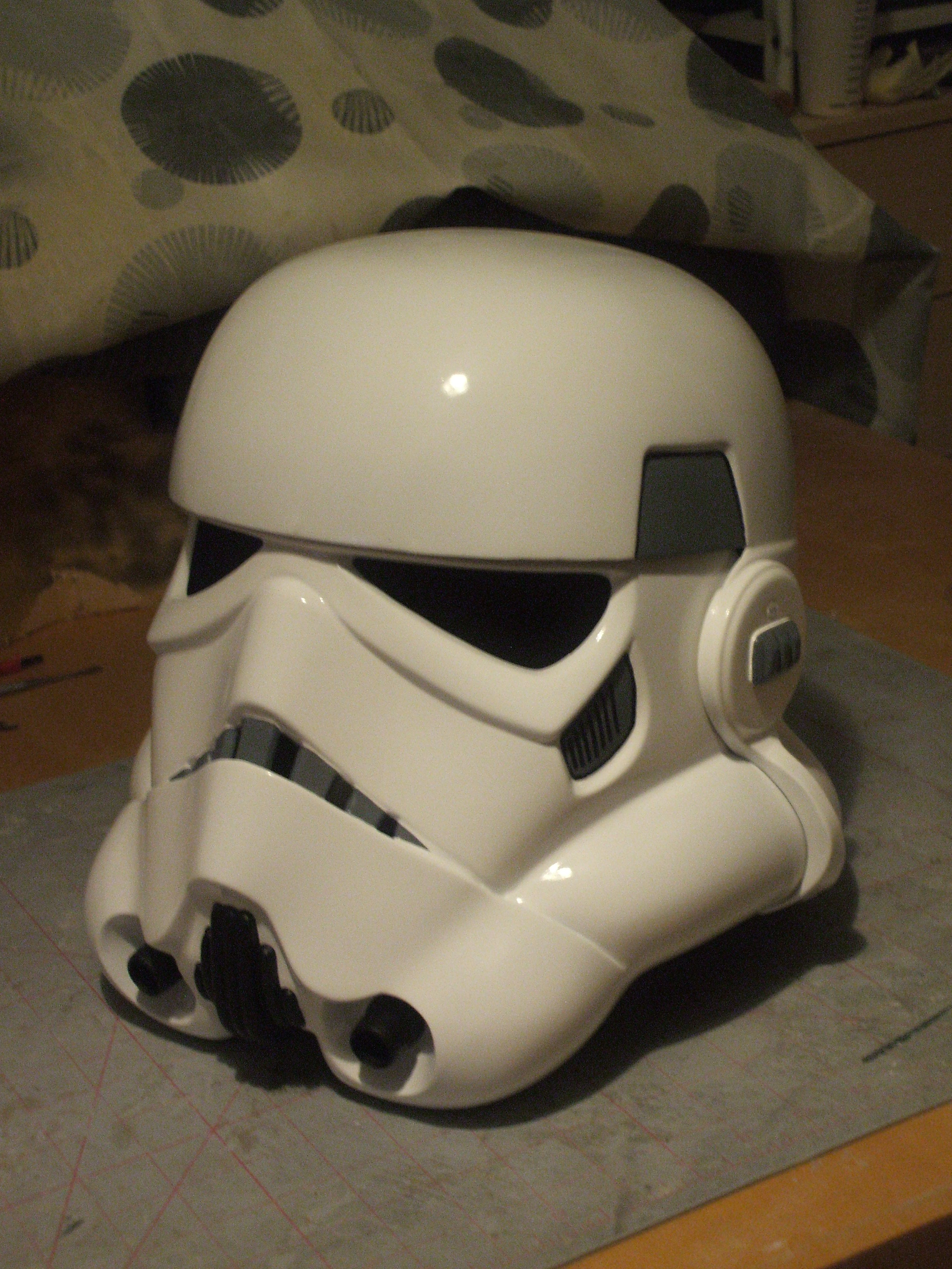

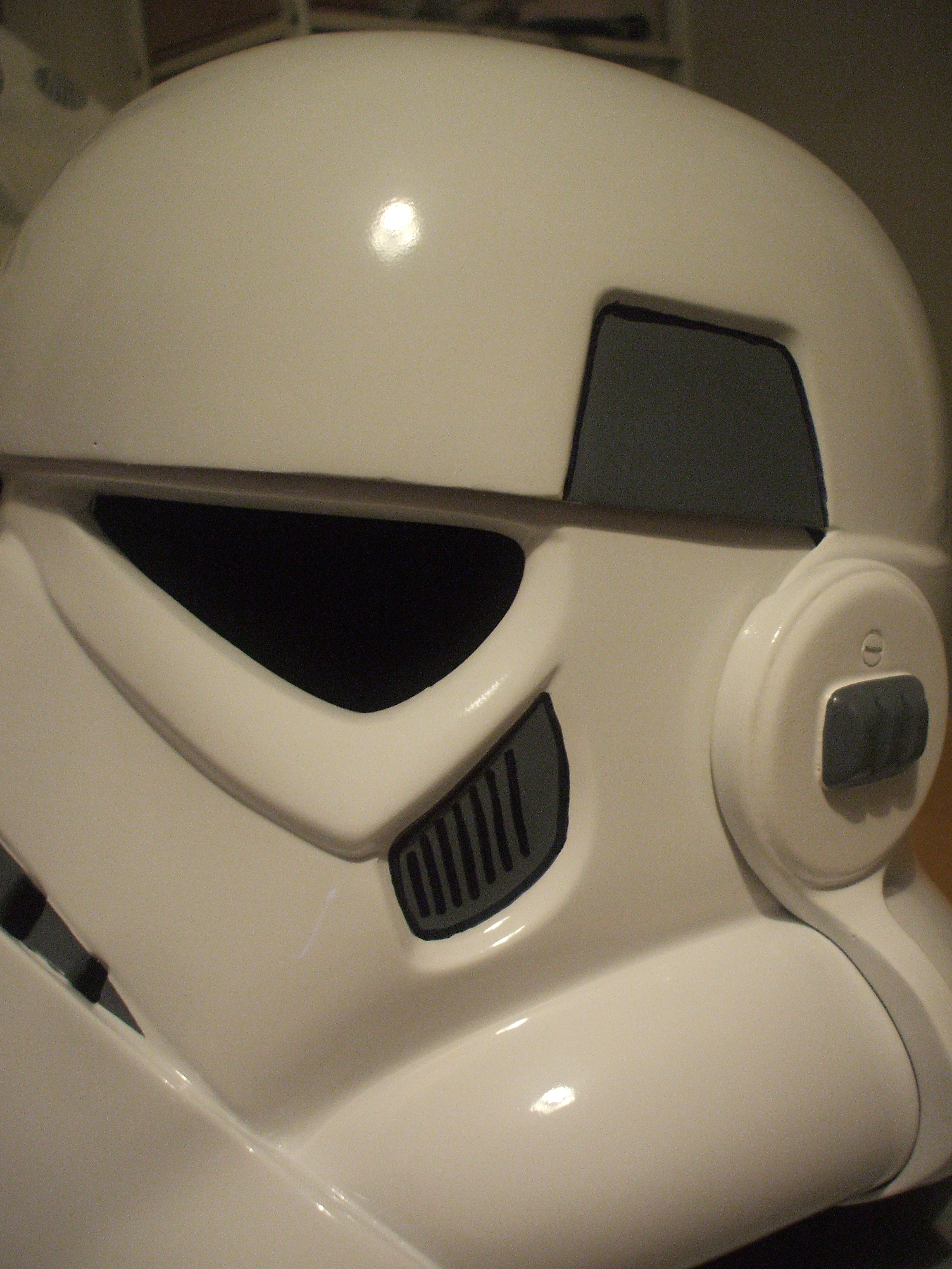

Thanks :)

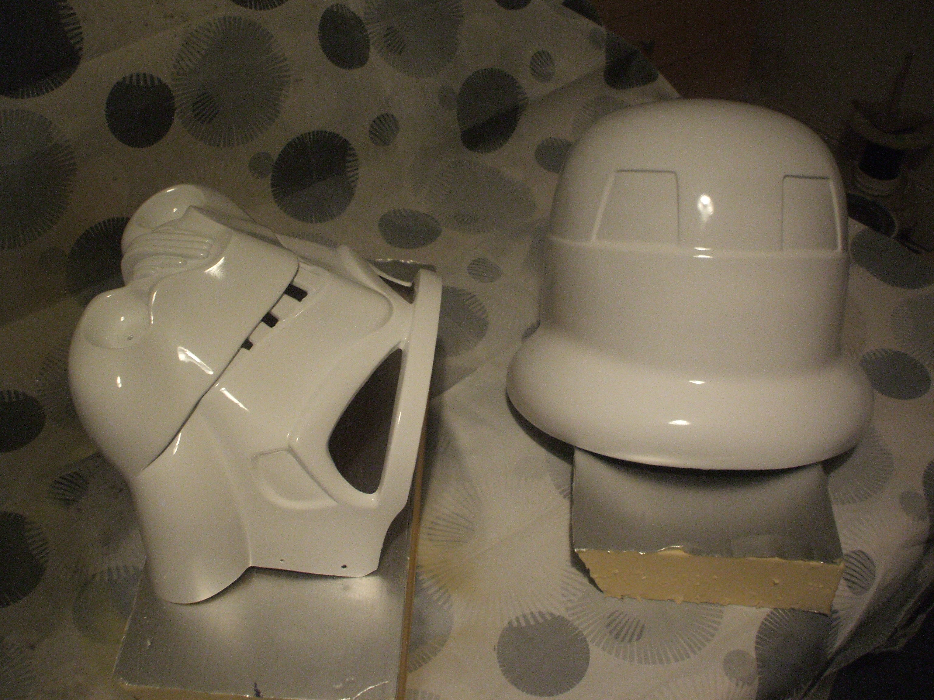

Been busy today. I guide coated it, wet flatted it & painted it :D
I haven't painted the ears yet as I needed to re-prime them, I'll paint them tomorrow & I should be able to assemble it tomorrow night :)
I've ordered a brow trim, I still need a neck trim, some mesh & I've got to make some bubble lenses.
Its all good fun :)

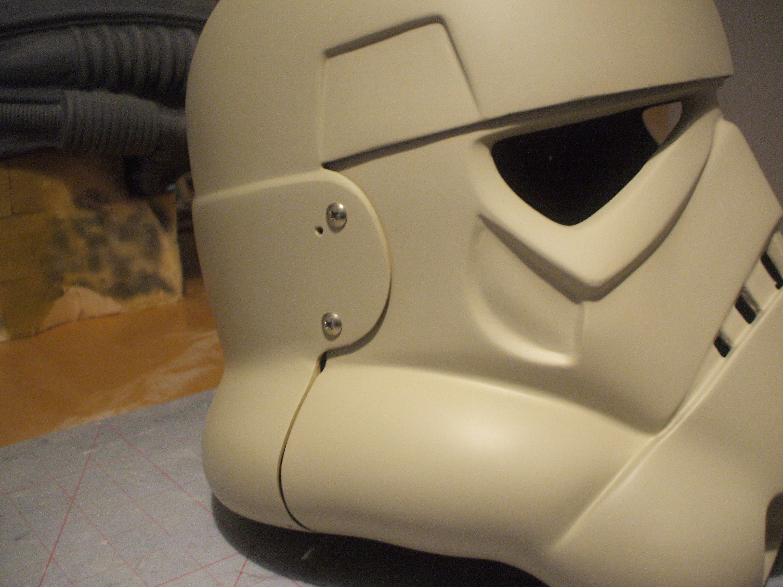

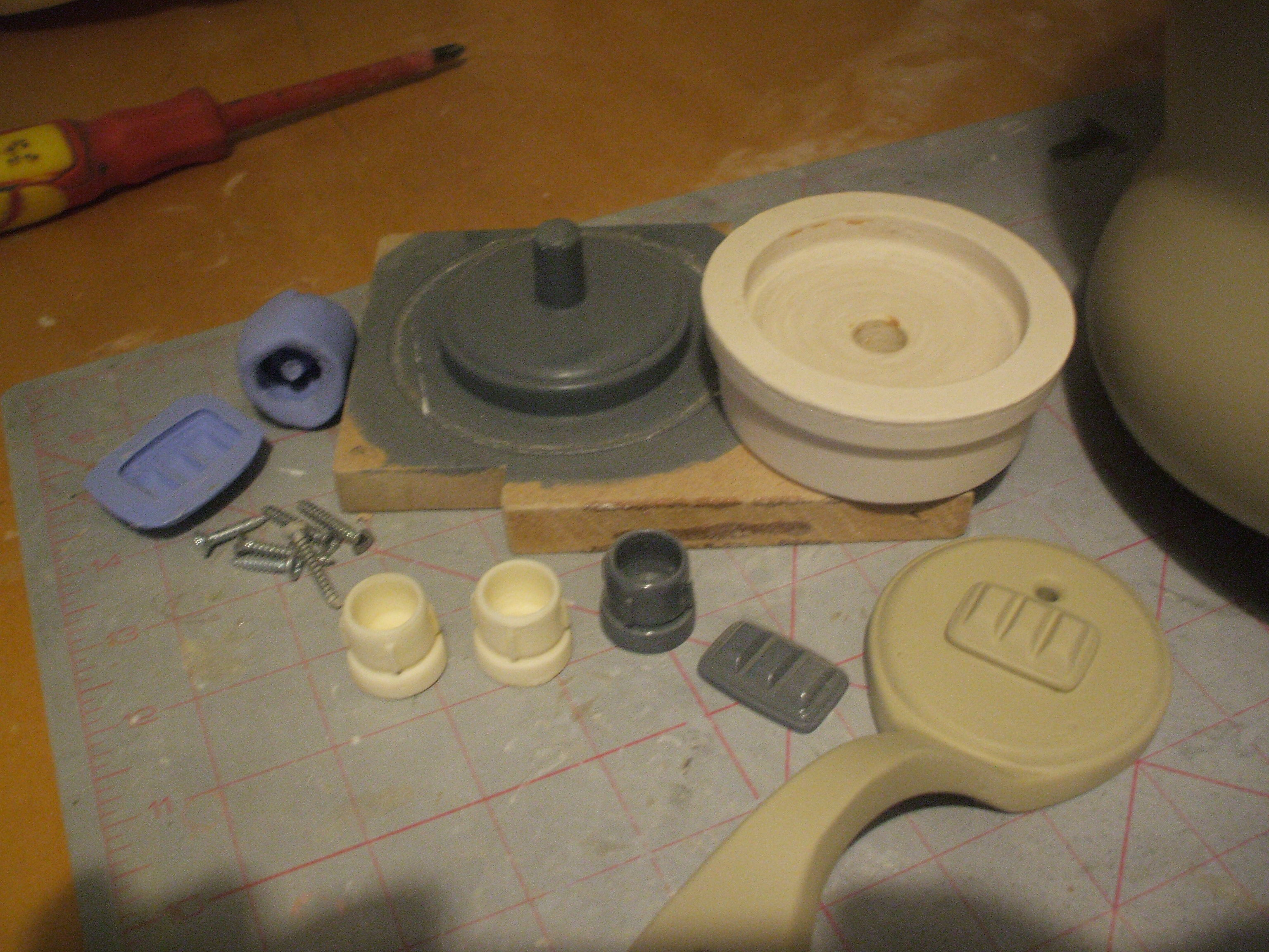

Were the ear pieces from scratch? or pep... which parts did you scratch build?
Re: My first Pep attempt, old school Hero Stormtrooper
I scratch built the disc parts of the ears, the thing-me-bob's that fit in the middle of them & the mic tips. I did use one of the pep mic tips & filled it with resin, then machined it to shape.

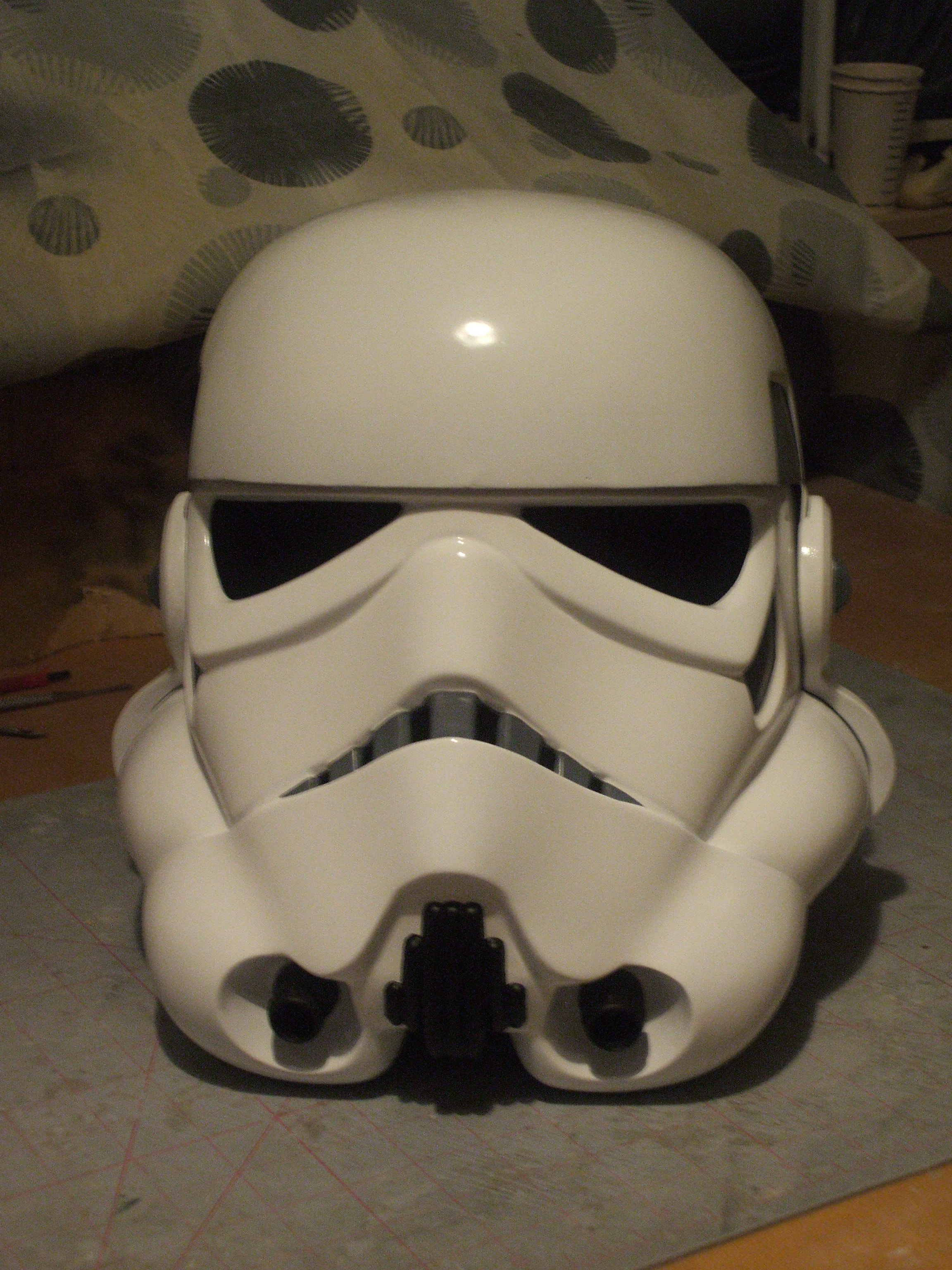

Edit: Here's a little update for this morning :)
I got a bit busy with the paint brush last night. I found a tin of Humbrol AD Grey number 5 in my collection of tins. I'm thinking about using a Sharpie to do the black outlines, I don't think my hand is steady enough to do them with a brush :$
I need to get the ears painted (today) he just looks all wrong without his ears!
I've got green acrylic ordered for the lenses & a neck trim & I need to make a template for the blue stripes.

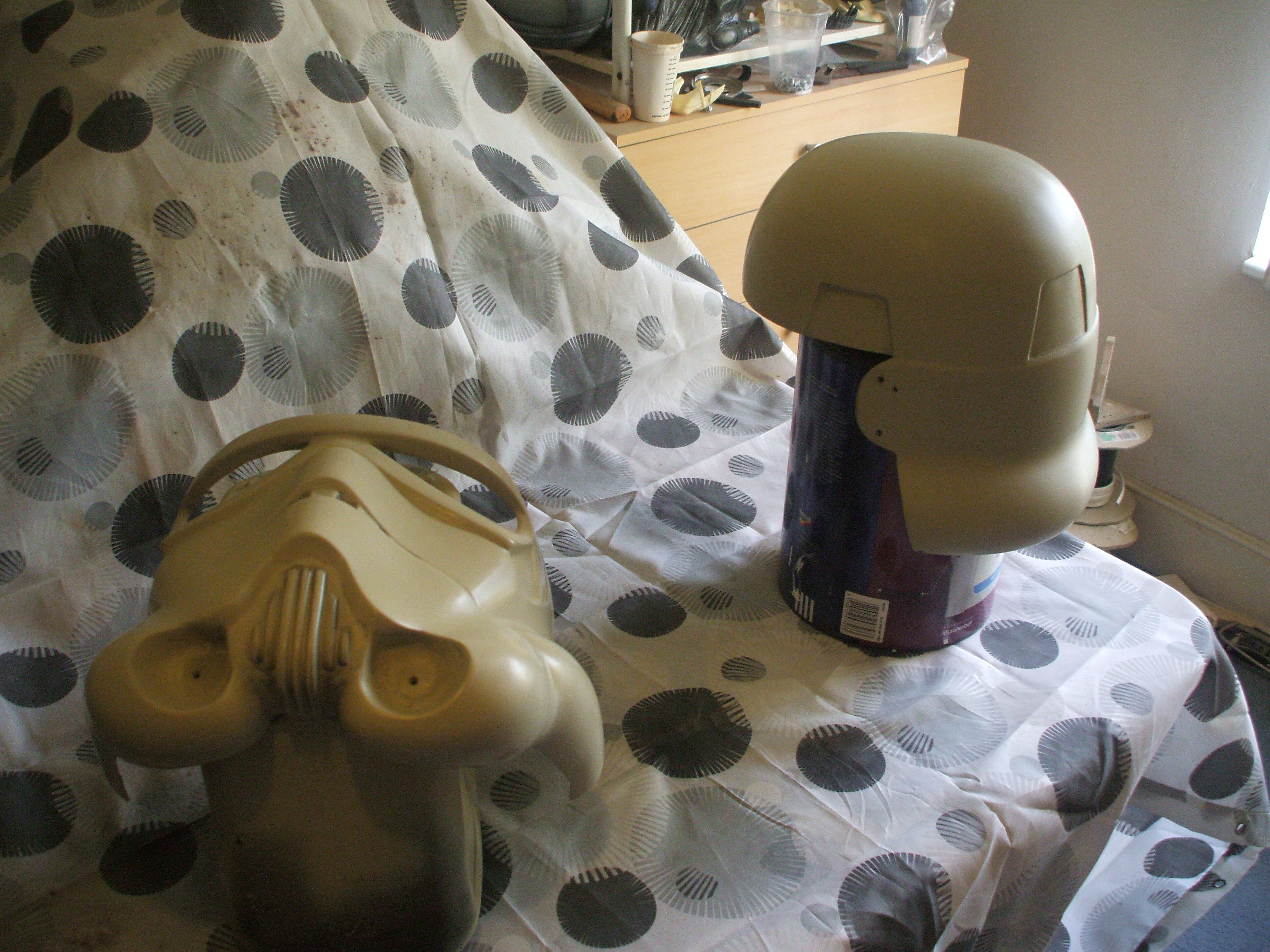

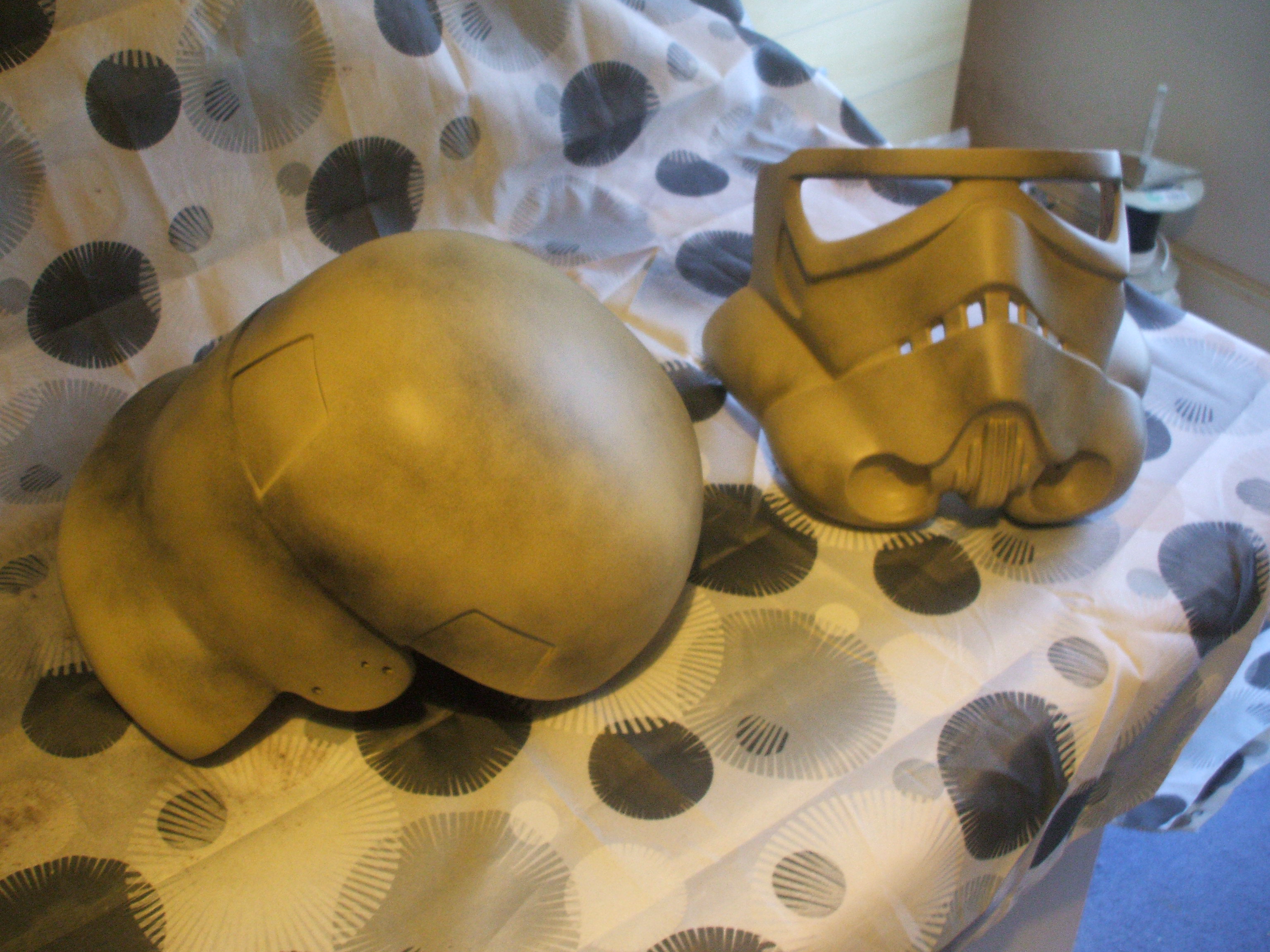

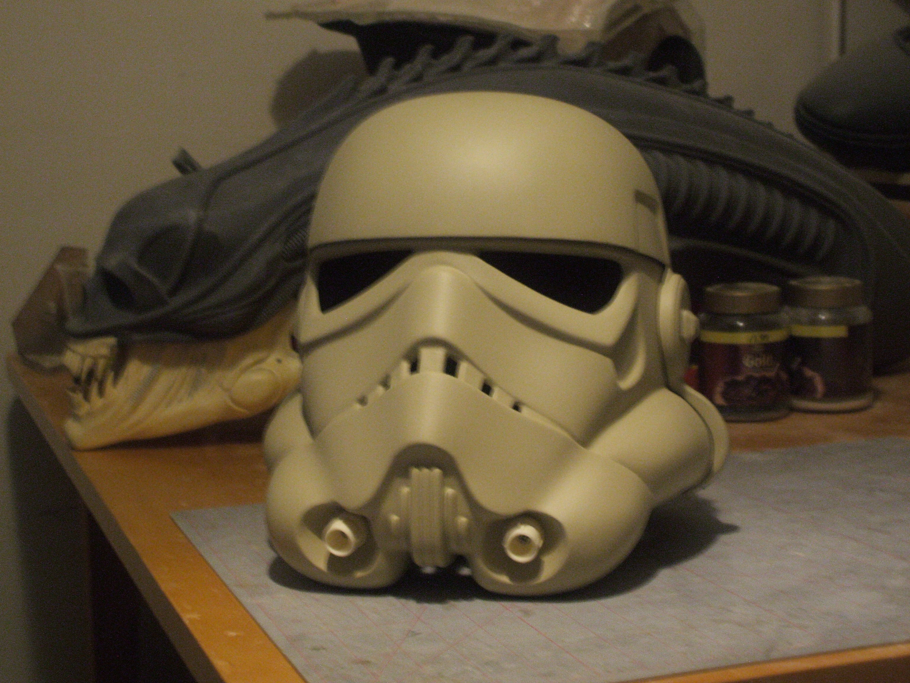

I used all car products, fillers & paints.
As I mentioned above I attacked the resin finish with 40 grid production paper (Aluminium oxide paper) on an electric flat bed sander to remove all the high spots (all the raised corners of the folds). I then knocked up a batch of David's P38 polyester filler (Bondo I believe) & coated the whole thing with enough to fill the low spots (the flat bits between the folds). I then used 40 grit again (but by hand this time) to cut that back until I could see the remains of the high spots. At this point it no longer resembles a pep build :)
From here on its a case of applying more filler but in smaller quantities & thinner layers to build up the various shapes until they're roughly smooth still using 40 grit. During this part I modified a few bits including cutting 2 inches of the top of the head & flipping it 180 degrees then re-glassing it back on. I modded the bridge of the nose, the cheeks & a few other little bits.
So I get the basic shape knocked out using 40 grit which is course but quick! Then I go over the whole thing a bit at a time with an even thinner layer of filler applying it carefully to reduce the amount of rubbing down needed. I used a regular filler spreader, & rubber spreader & a small wooden spatula which I could cut to shape for the detailed parts. That all gets rubbed down with 120 grit! At this stage I'm paying particular attention to the details.
Next step is a build up of high build primer! I used u-pol High #5 high build primer in beige! Its expensive but worth every penny!!! It sets hard, it doesn't soften with spirit based cleaners & if you use the red cap it sprays nice :) In fact all of the u-pol products I've used over the years have been good! including their fillers! Easy sand & top stop red.
This gets built up in layers & I rub down between layers with 120 grit by hand until I'm happy that everything looks good :) The primer fills the small imperfections & 40 grit scratches!!
I then give it one final coat of primer & leave that in doors to fully cure for 24 hours.
Then its the guide coat, & wet flat with 800-1200 grit wet n dry paper (800 is quicker but you need a slightly thicker top coat) then a de-grease & paint.
For UK members: Avoid Halfords own brand filler primer (amber colour) & paint products like the plague!!! their wet n dry isn't to hot either :facepalm
Having car body experience is helpful :)
HTH :)

Thanks :)

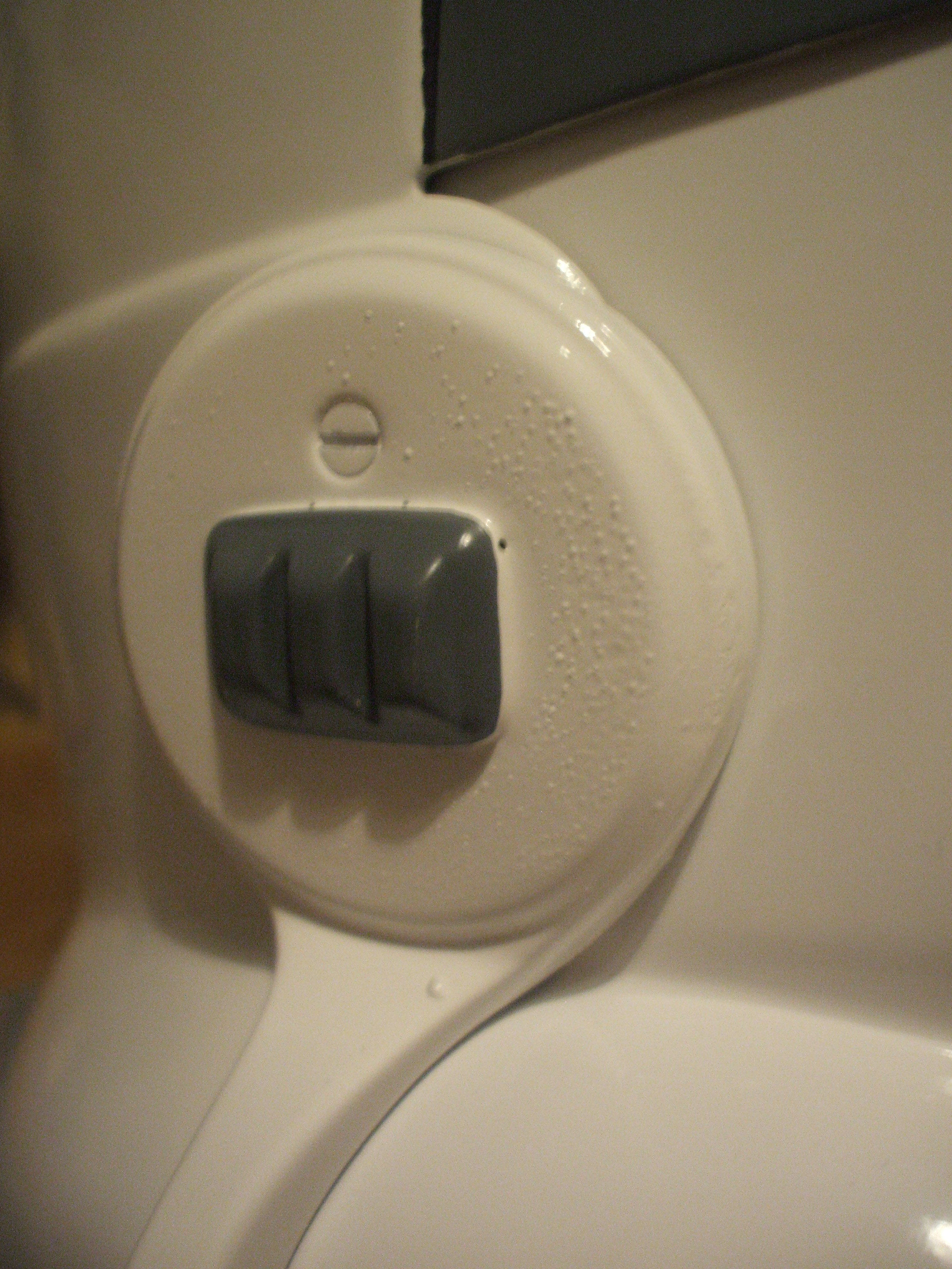

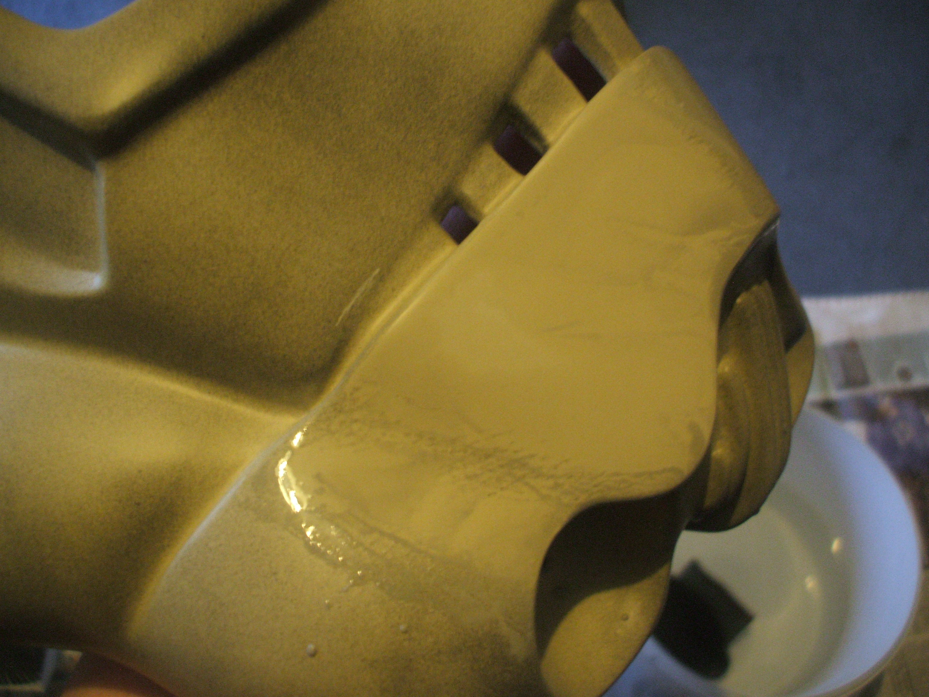

Got those ears painted but it seems I've had a little reaction in the casting of the urethane disc part of the ears. Entirely my own fault for rushing it :$
Polyurethane is sensitive to moisture during setting, the mould I made for those parts was a plaster mould. Where I went wrong was not giving the plaster enough time to fully cure & not sealing it prior to casting..... Lesson learned!! I may well re-make the ears :unsure
I also attempted to draw the black outlines on with a Sharpie, I think I might have got neater lines if I'd put them on with a bog brush at arms length! :facepalm So they'll need to be repainted :rolleyes
Sometimes things just don't quite go to plan but I'm not put off, these are just minor setbacks & IMO are part & parcel of this hobby :)
Don't laugh at my lines :$
