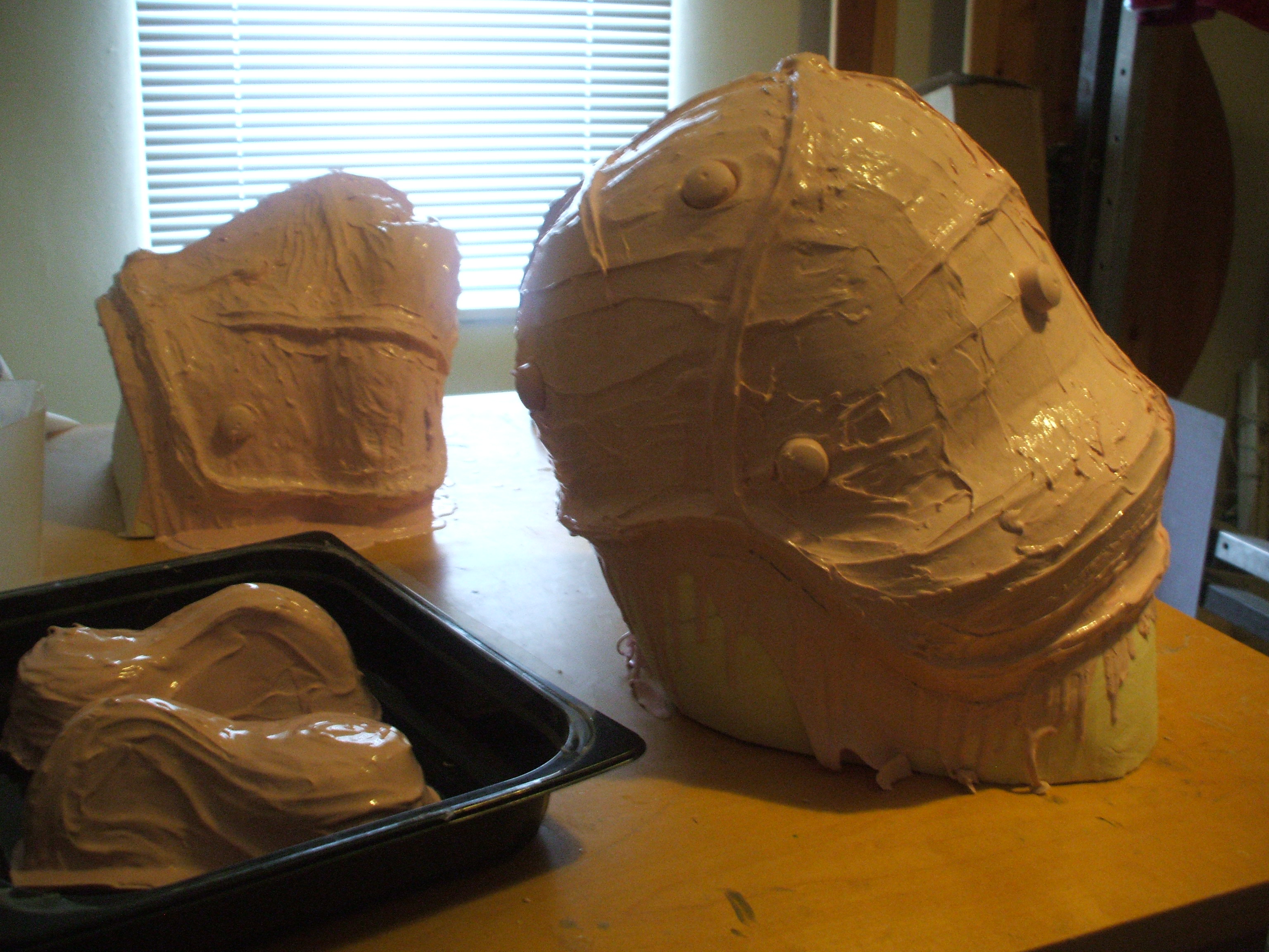

The first detail coat is on & I'm about to start the second coat. I usually do two coats prior to using the thixo additive & building up the overall thickness :)

Right, that's the rubber dealt with!
Its not pretty! In this case its function over form :)
Next is to build GRP jacket's over these.

I've got a tiny bit more work to do to the moulds before I cast out of them. I'm going to create a lip around the outside edges out of silicone with thixo that overlaps the GRP by half an inch-ish. Doing that should support the edges, effectively clipping them in place & reduce any chance of them flapping around. It also means I'm less likely to get casting resin on the jacket :)

Yeah my mold jacket has smoothcast 300 on the inside. In addition to my terrible first attempt at keys its another element giving me bumpy casts.
The overlapping sounds the one. Adding fresh silicone to set silicone? I attempted this and it worked but did delaminate in a few places. Gives me an unwanted line that needs removed on every cast.
Re: First Pep attempt, Old School Hero Stormtrooper. Moulds Made.
Ah right, this will be on the very edge, so no where near the cast.
The silicone will stick fine as long as there's nothing on it like grease or release agent. I'll clean the edge first with a bit of white spirit just in case I had something on my hands :)
I make my keys using an ice cube tray but I also build a few other bits to help support the mould & act as keys out of the thixo silicone :)
