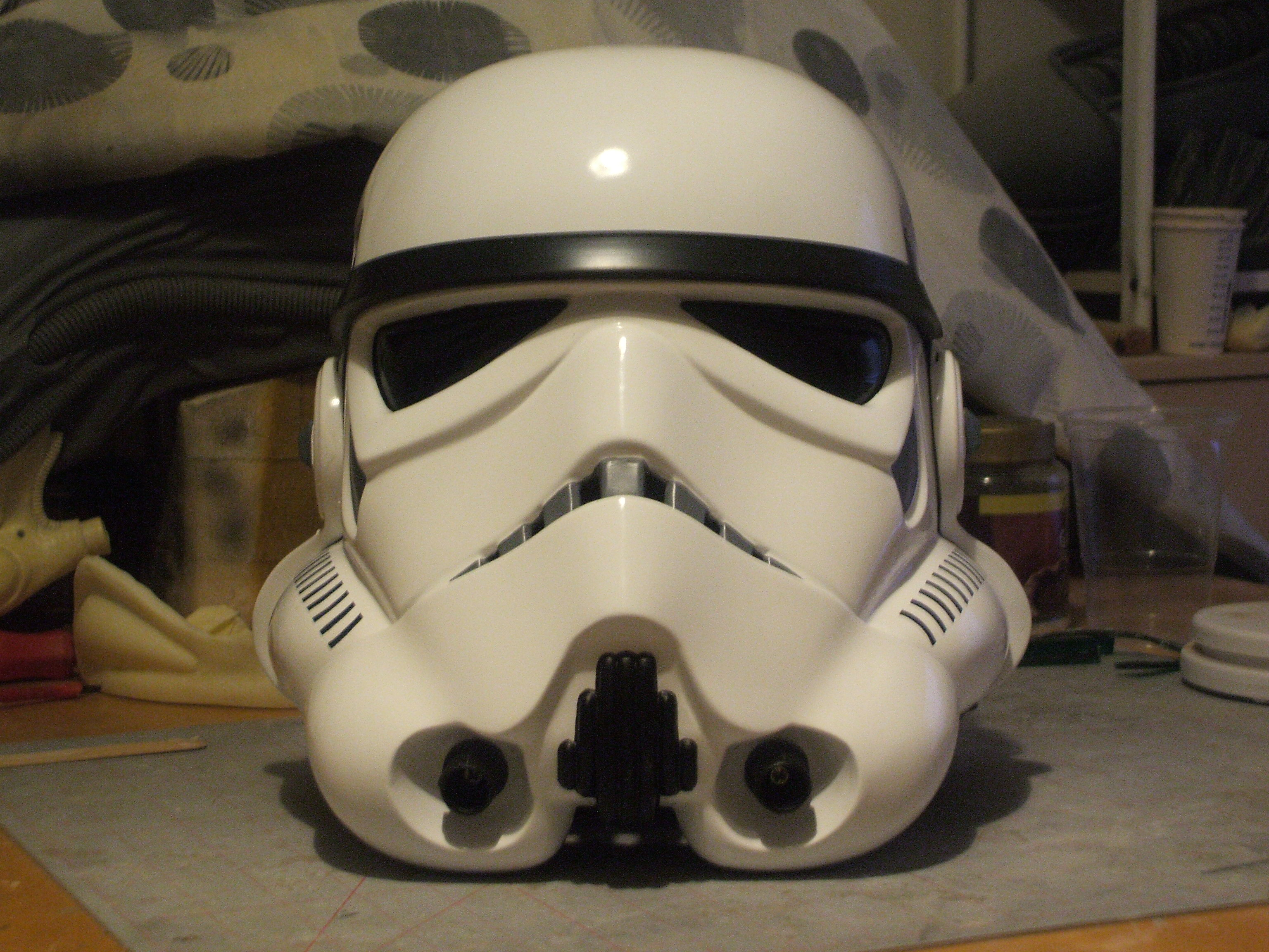

Got the lenses & neck trim fitted & other than the paint problems I'm very happy with it :)
Strip it all down now & re-paint it ready for moulding :D

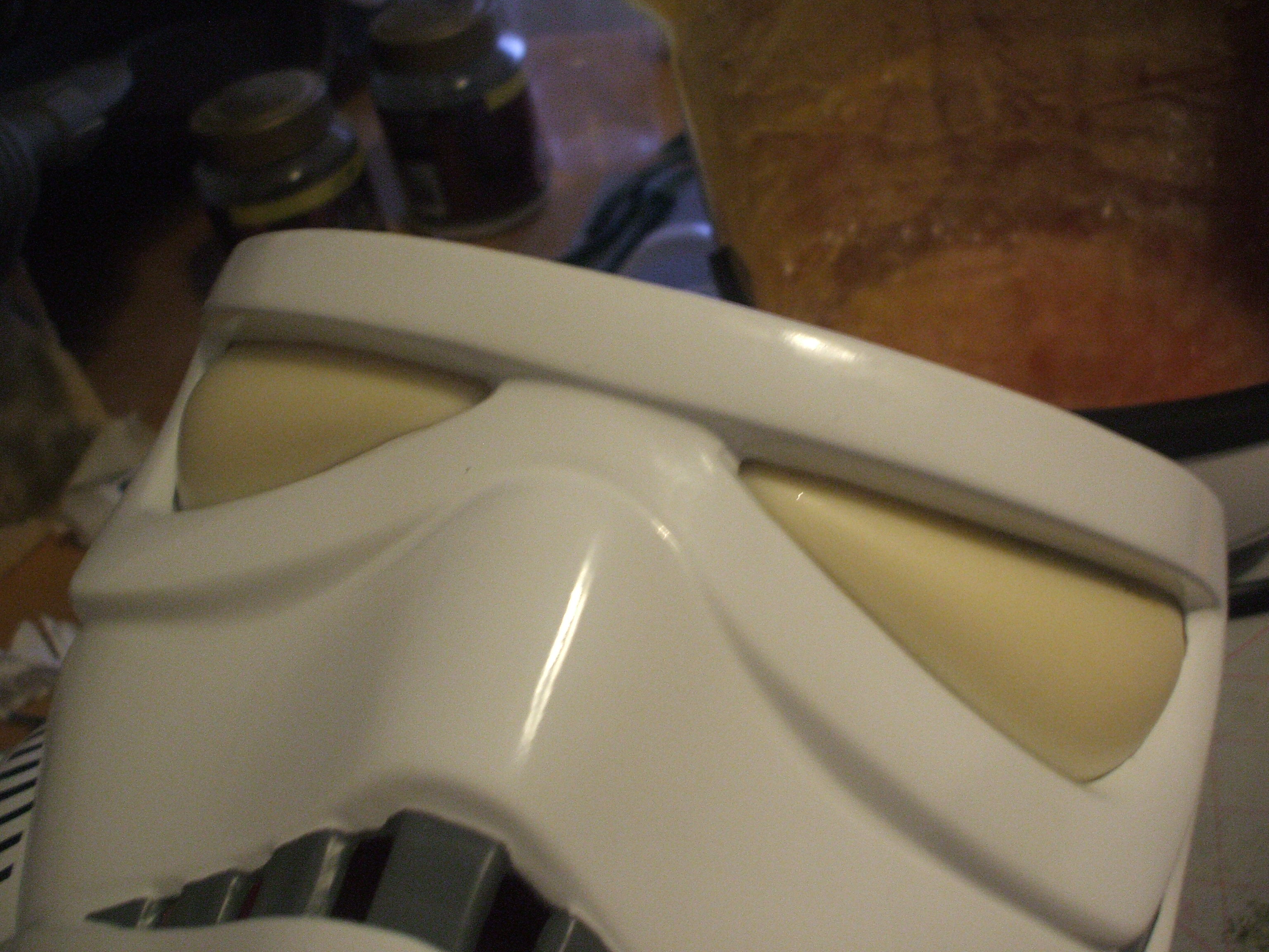

The lenses were tricky! Like a fool I bought 3mm (1/8") acrylic which is too thick! I'll re-make them with 1.5mm, it'll be much easier.
Just behind & to the left of the helmet in the pics above you can see the mould I made to shape the lenses, it'll work better with thinner acrylic & the lenses will be slightly more defined :)

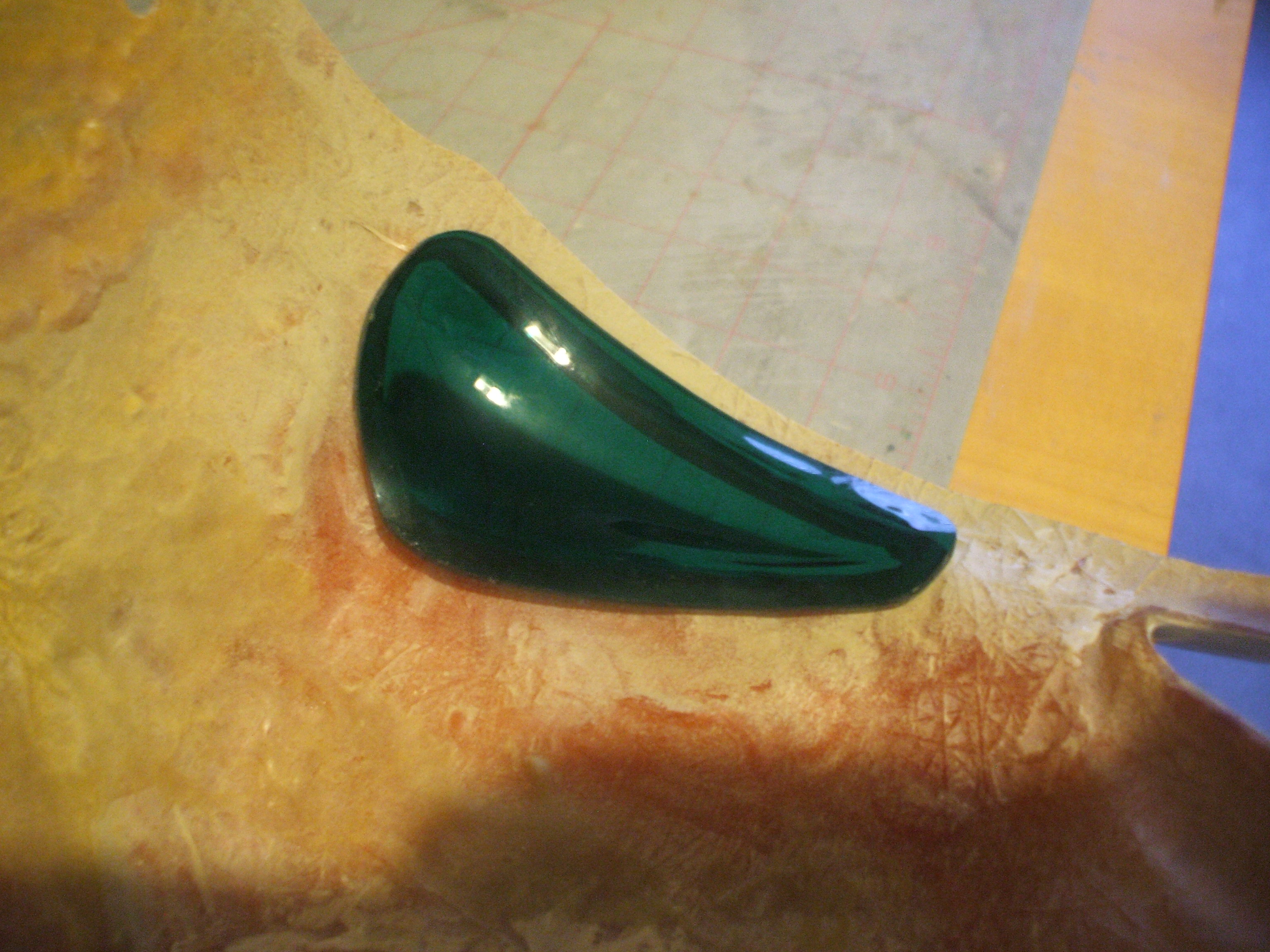

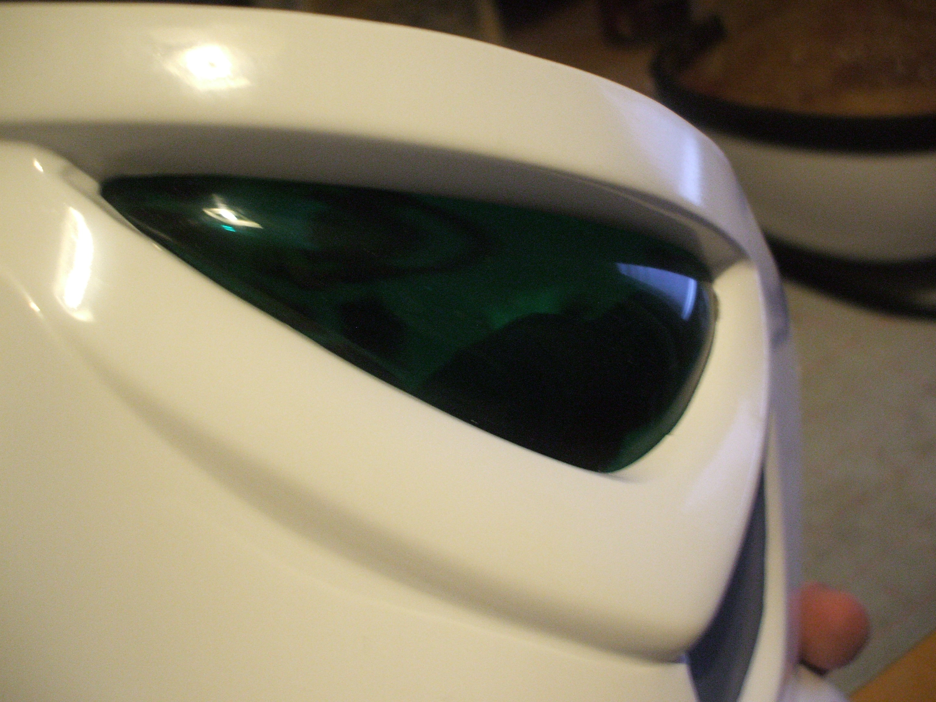

Here's a bit more on the lenses:
I made the mould out of Urethane by sculpting the shape of the lenses to the helmet out of oil based clay, I then made up the rest of the mould with making tape. After curing I removed it all from the face of the helmet & cleaned up the cast.
I heated my Acrylic in the oven on a foil lined tray at 180 deg C, times for baking was guess work. Once soft enough I quickly pushed the pieces into the eye openings of the helmet & then pushed the mould onto the Acrylic to form the bubble shape. The Acrylic cools really quickly! so if you have a go make sure you've got everything you need to hand & work fast! :)
As I've said, I used 3mm Acrylic which was too think imo. I may have to adjust the temp for a thinner 1.5mm Acrylic.
HTH :)
