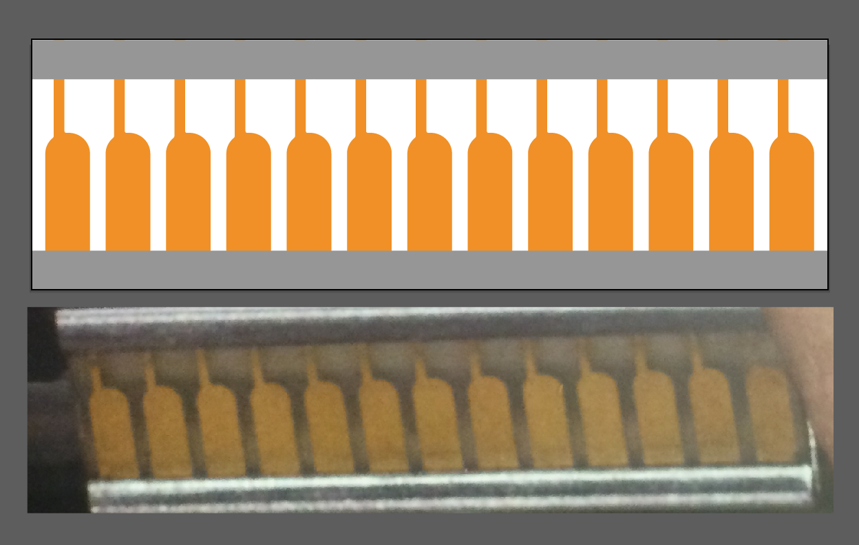

Well, I believe I have the most accurate TFA "layout" I can produce...
http://www.slothfurnace.com/images/Clampcard/sloth_tfav2_prototype_ss_clamp.jpg
I had a few of these made up to test the pattern layout, and I think it's as good as I can make it. However, it does not have a transparent / translucent base, and they silver soldered the thin traces at the factory for some reason.
http://www.slothfurnace.com/images/Clampcard/sloth_tfav2_prototype_ss.jpg
I'll be selling this short run of these on my page at www.slothfurnace.com if anyone is interested, I have about thirty on hand.
The other side of the card is blank, no traces. It allows a bit more light to bounce around in there, but it's not transparent. The gold plating on these are really nice, too.

I'm currently trying to figure out the correct thickness of the boards. I measured the "clamp-slot" of my original Graflex to be about 2 mm (0,08") deep... So that's what I'm aiming for. I suppose you can sand them down at the edges and create a tight fit without ruining the finish, but that's something I will test. :)
Is there a universally accepted thickness that is considered "screen accurate"?
This is the layout I threw together in Illustrator:

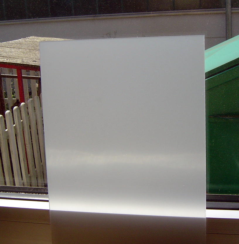

And this is the milky acrylic that I ordered from eBay... Haven't received anything yet, but the material looks close.
I think Slothfurnace got it pretty close, too bad he can't do the translucent card.
I bought one of these and must say it looks great! I almost regret not buying a second one to play around with. Hard to explain but the light does come through more in this version than the originals.

Also, speaking of the circuit boards, we've got a bunch of clear acrylic here. I can try experimenting with sanding the backside or applying frosted vinyl to advise anyone wanting to try a DIY solution for the translucent board.
