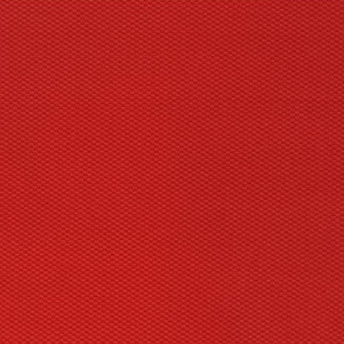

Honestly the fabric is most probably a custom print on spandex (maybe even a neoprene), but something a little bit thicker than found in morphs, this might be a good option http://www.ebay.com/itm/301886402390 Robert Kaufman Bisou Stretch Pique Apparel Christmas Fabric B159 Red
I'm gonna try a test suit in it, see how it comes out.
I initially had a concern with this pattern because the seller never identifies the size of it. I was thinking I could order it and then it shows up with like 3 diamonds per inch kinda thing. The Robert Kaufman site didn't have this red anymore, but the white was similar and it had a ruler on the picture.
So not bad :thumbsup.

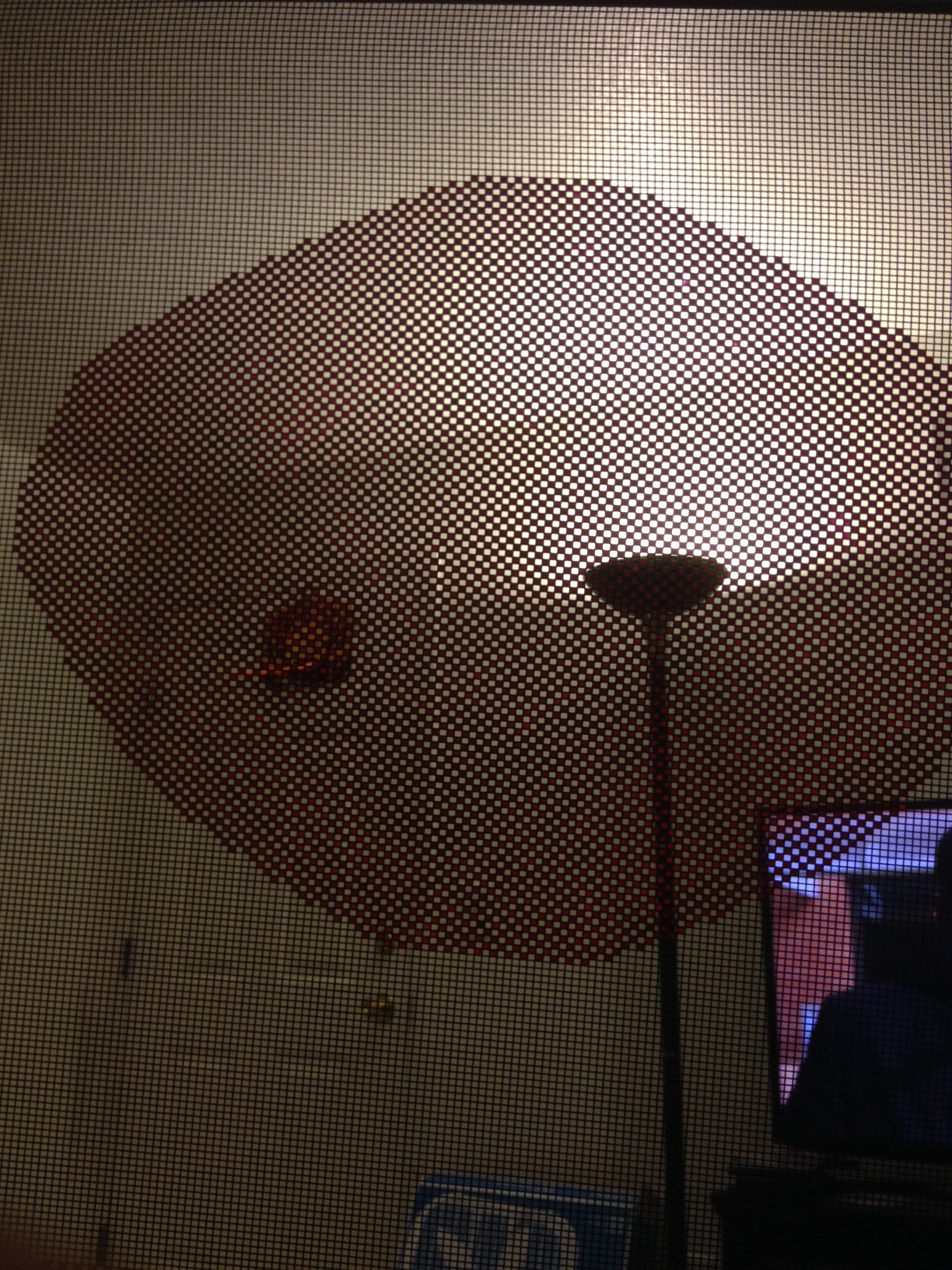

This may end up being a waste of time, but I was thinking about the fabric and screen printing. Without going ahead and buying a bunch of screen printing stuff, I decided to try something a little outside the box and see if there was a cheaper solution
Regular window screen has small squares that may work for a stencil.
I think most people have some of this already or can find it in the garbage somewhere. If not, rolls of screen are in the 5-10 dollar range at hardware or home improvement stores.
I had some screen already and also had some puff paint, so I just filled every other square with the paint and let it dry. I finally understand what the Spiderman guys go through with the puff paint.

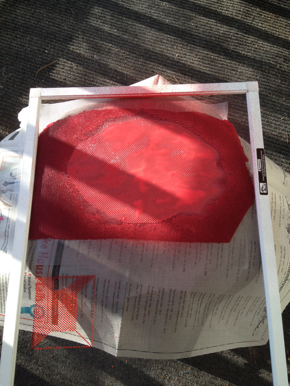

With a sufficient area that has the checker pattern finally, I can move forward with testing a few methods to do some poor man's screen printing. With the screen over the fabric as a stencil, I'm going to try out covering it with some fabric paint from a spray can, try just using spray paint to tint the fabric with the checker pattern, and lastly, use a brush to spread puff paint over it. Hopefully, at least one of these methods work, but I'm also fairly prepared for none to work. :D

Okay, so here's the update to the few methods I tried.

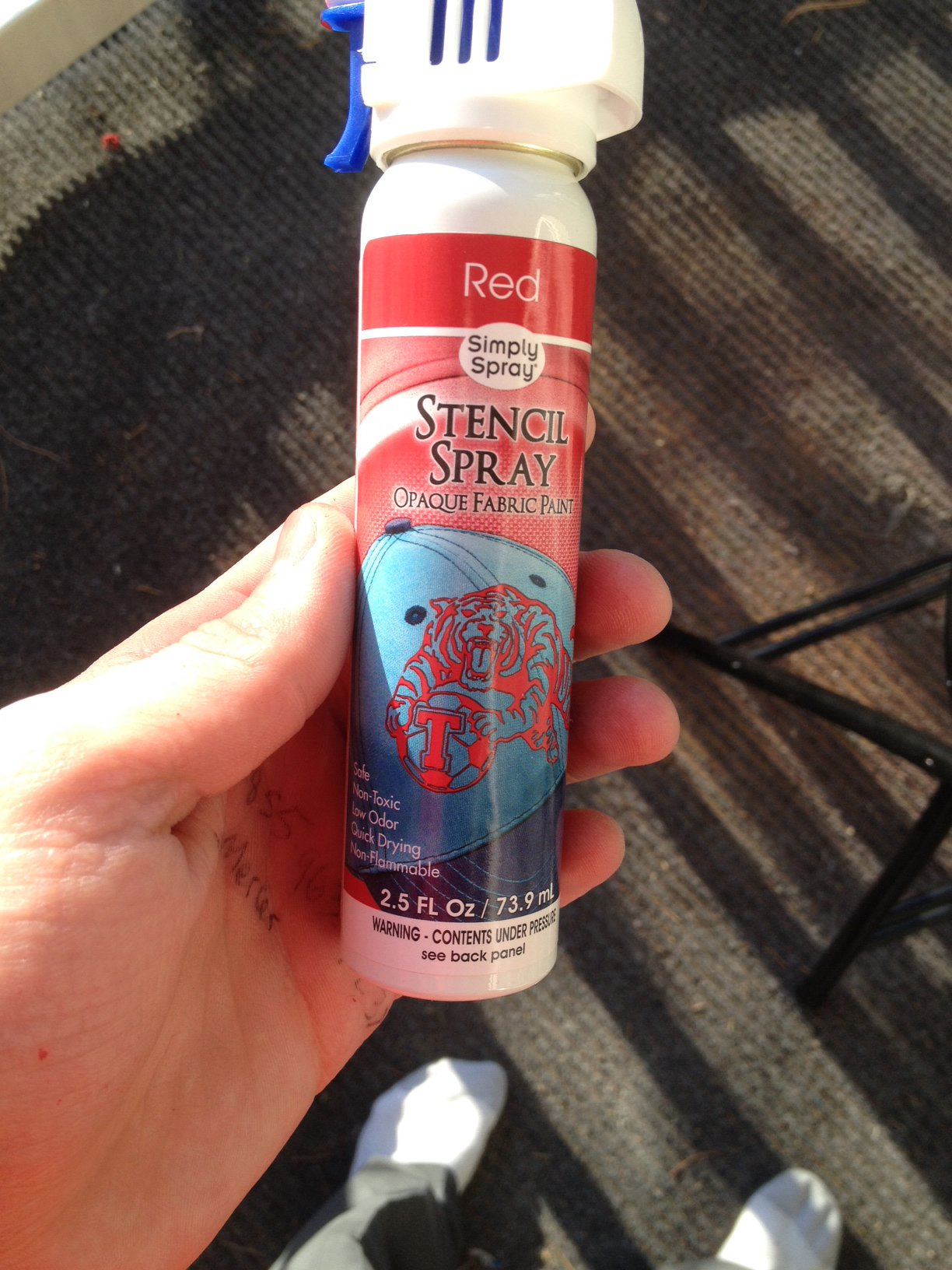

First is the sprayable fabric paint.
I don't even want to talk about it, but I will. It was the worst. I got this paint from Walmart and it doesn't even work right. It constantly goes from spray, to stream, back to spray. I couldn't get a consistent spread and it was super liquidy. It ended up being a red puddle, and as soon as I got the screen cleaned off, I threw everything away and washed my hands. Don't use this method.

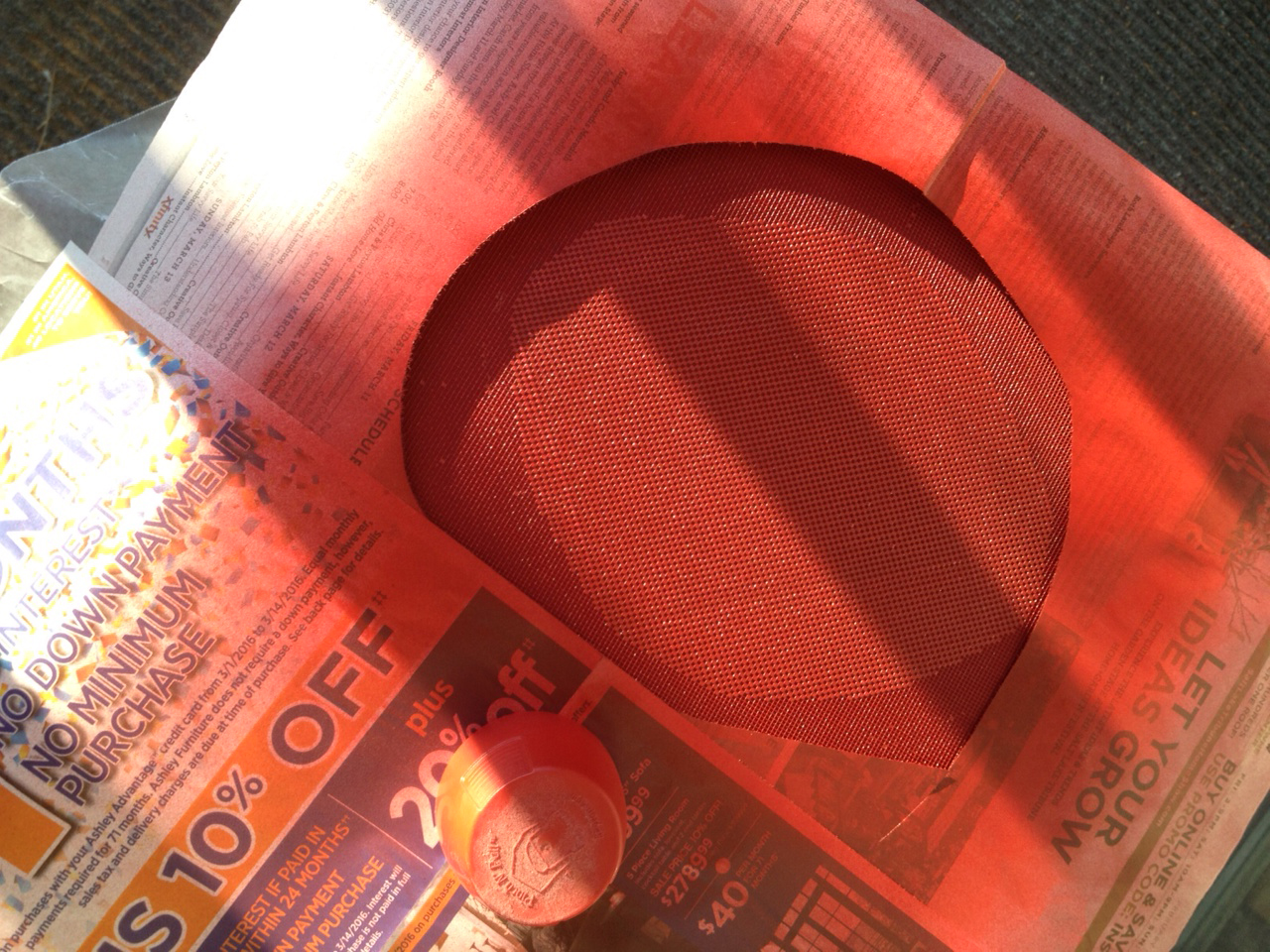

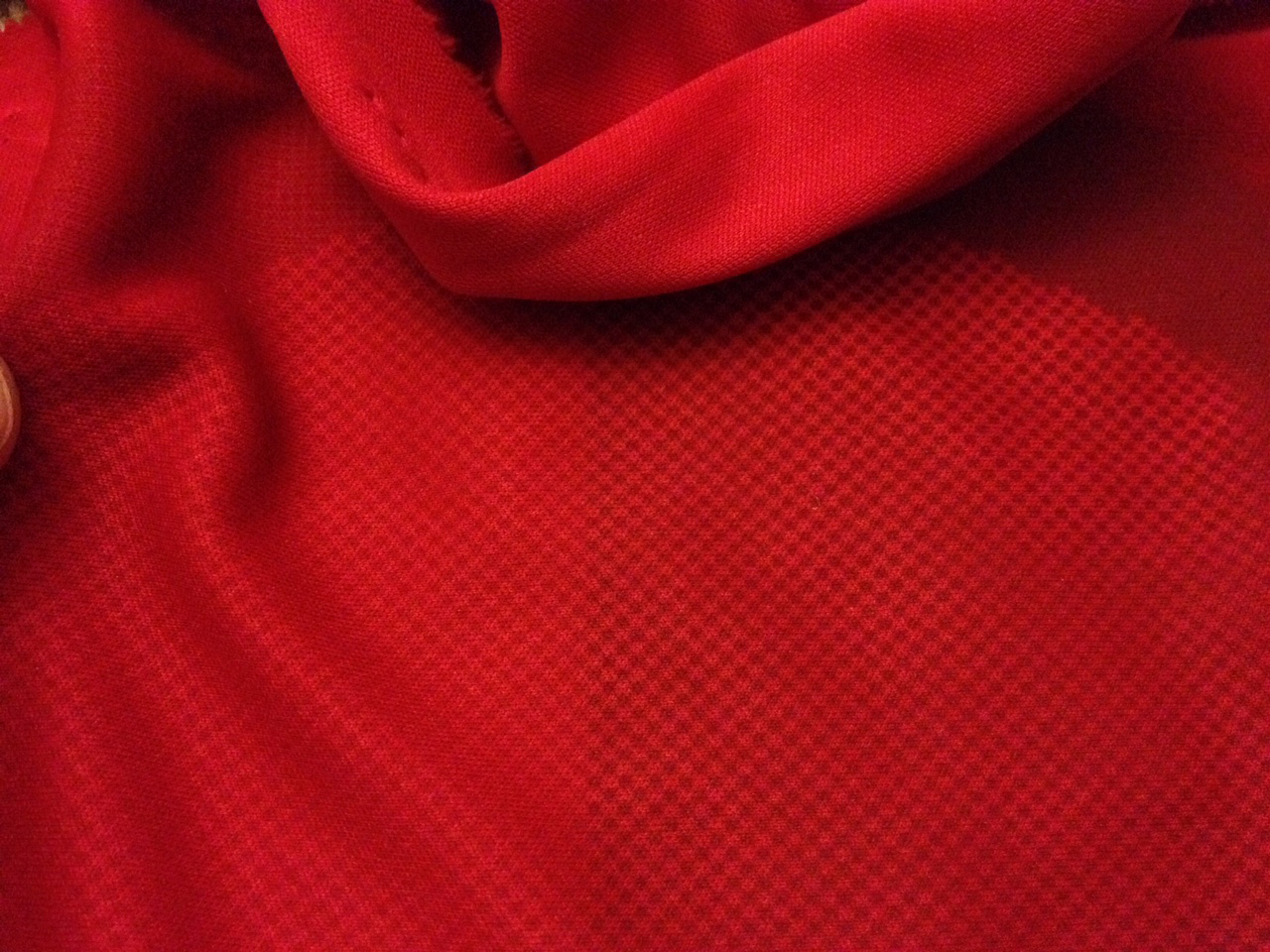

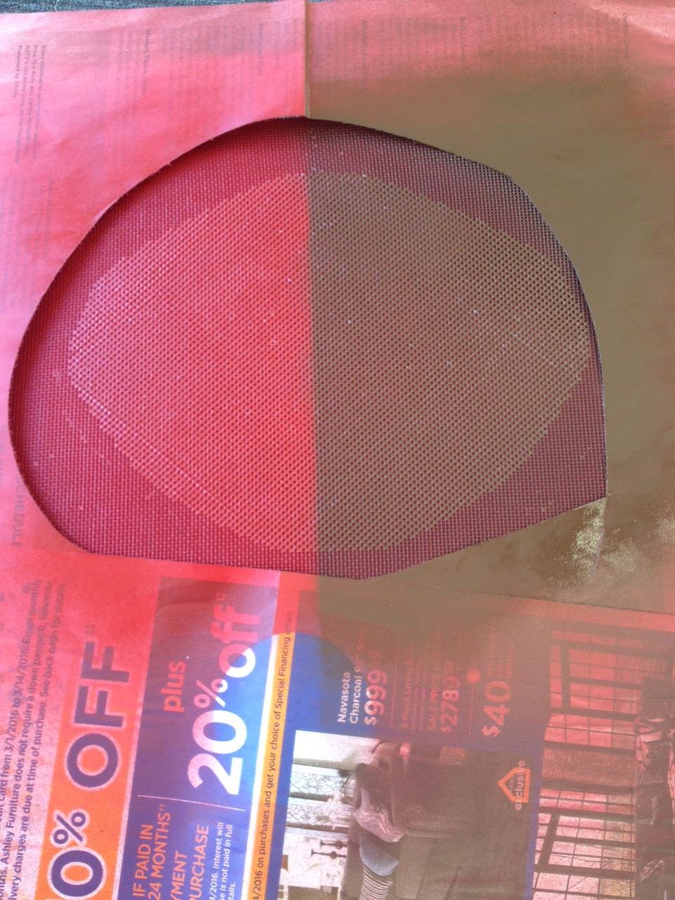

The third, and actually the best looking, was the spray paint. I just used some Krylon Fusion I had.
I did about 3-4 coats of red, which just disappeared into the spandex. When I was done with the red, I tried out the brown Krylon I had for fun. Interesting to see the shading. I liked that the paint wasn't super wet, so I could wait a couple minutes between layers and know it would stay put with no bleeding. When all was said and done, the spandex lost a little flex, but for the most part, unaffected. The pattern is nice, too, for a subtle change to plain red. But once you get close to the fabric, there's no texture. That would be enough to turn some people off.
All in all, I'd say to spend the money for some of the nice textured fabrics that are posted in any of the Deadpool threads. The spandex was $2 for 1x2 yards, the spray paint is about $5, and the screen is $0-$10. It's a lot cheaper, but only if your time is worthless. The amount of time that goes into filling the screen takes a while, for sure.
