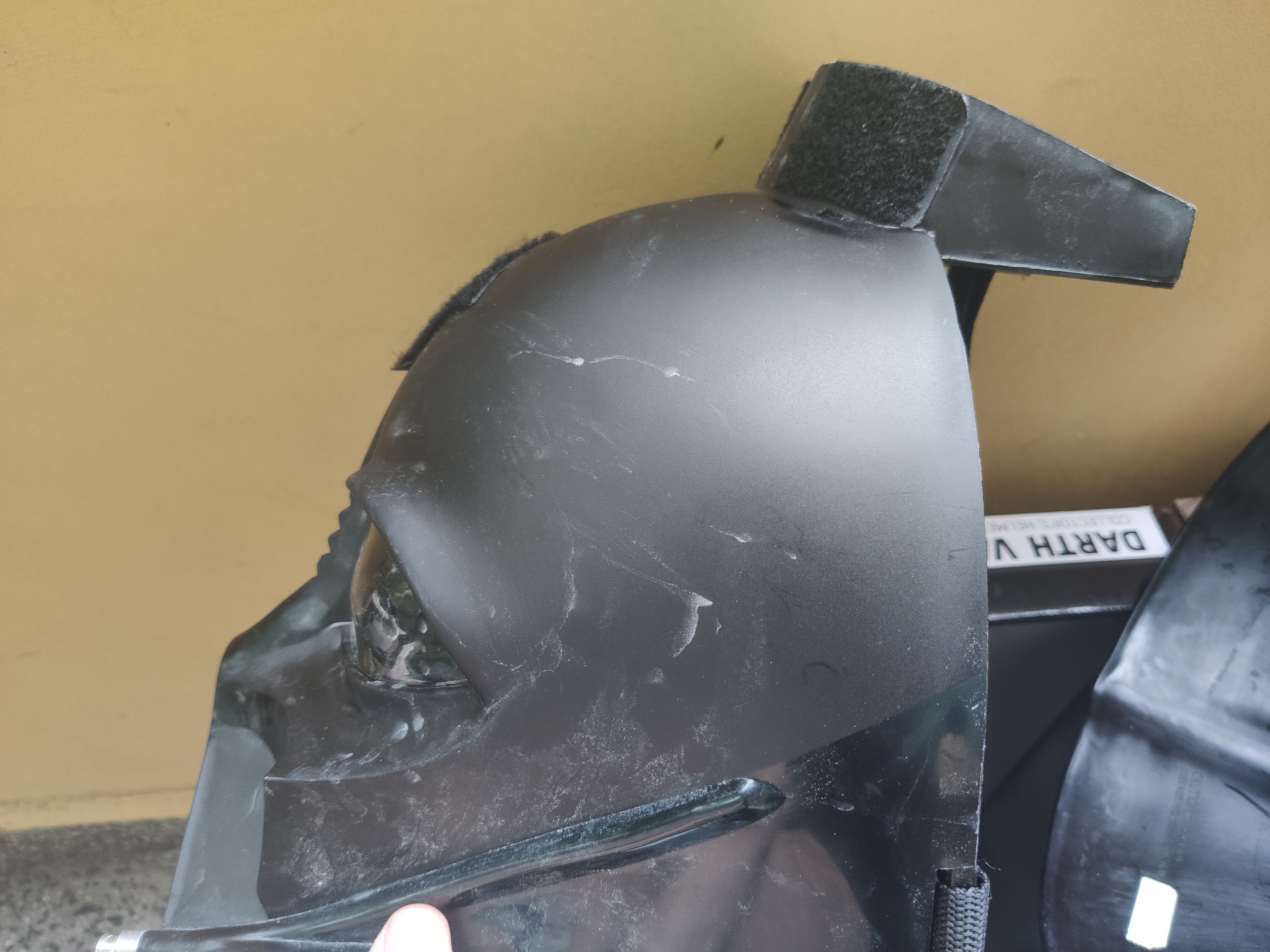

Onto the helmet issues I'm currently facing. As most of you know the angle of the helmet mount must be changed in order to have better dome position. From all topics related I understand that the male mount on the helmet should be bent down or pushed backwards? However as my helmet won't be only on display, but used from time to time how does one attach best the dome, do you still use the original two vekcros or there's something more to it. I tried with EVA foam to adjust the first time my positioning, but feels strange when I remove the dome. Any help would be much appreciated.

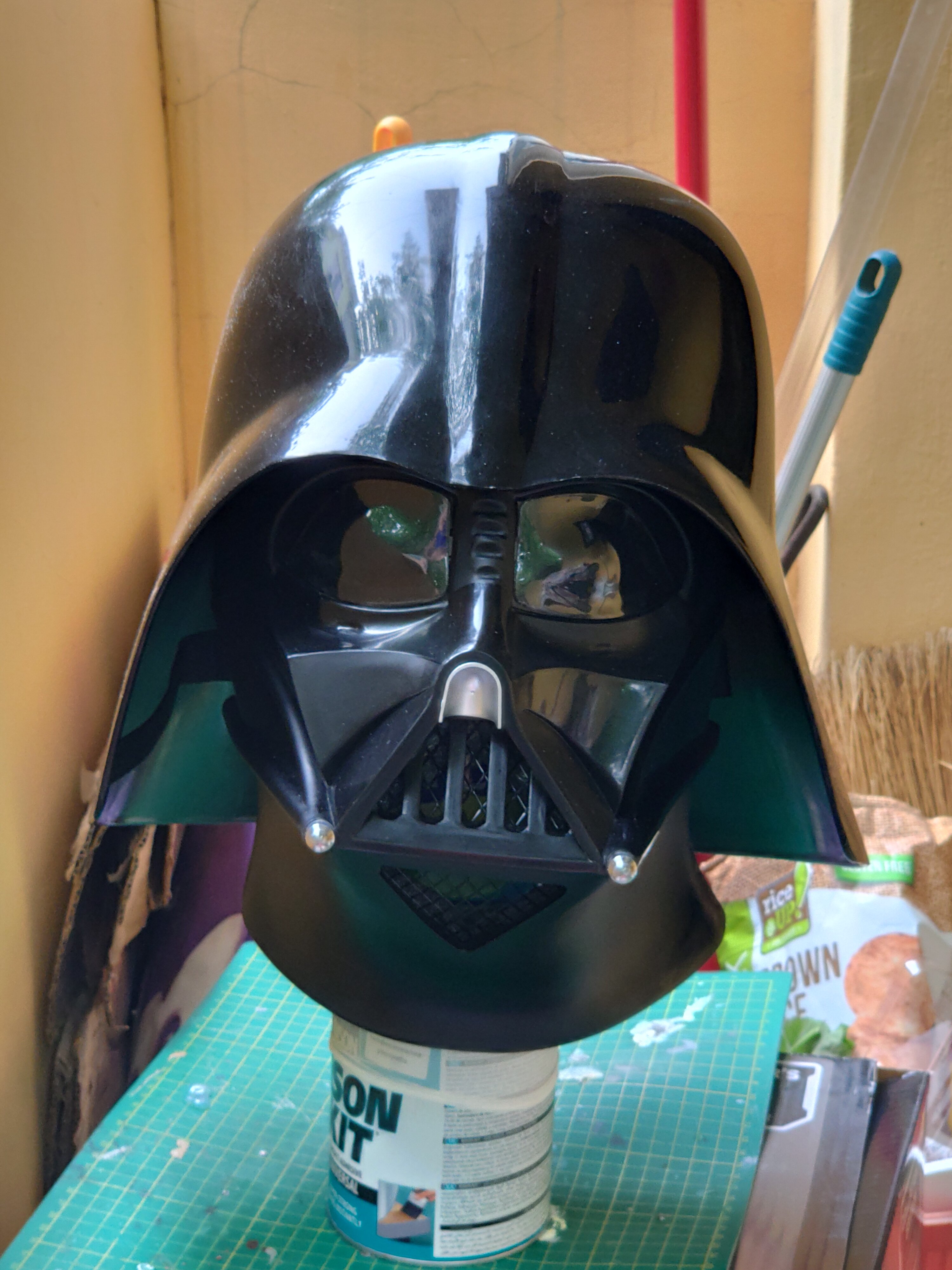

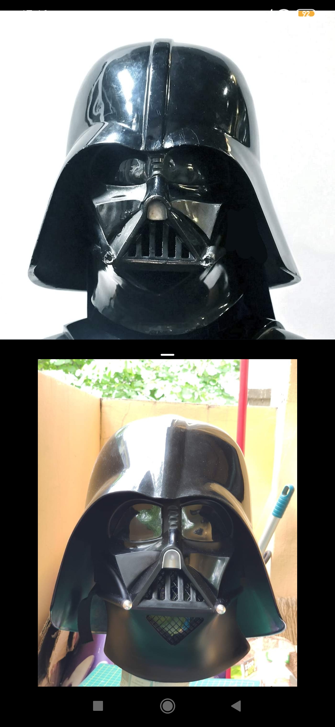

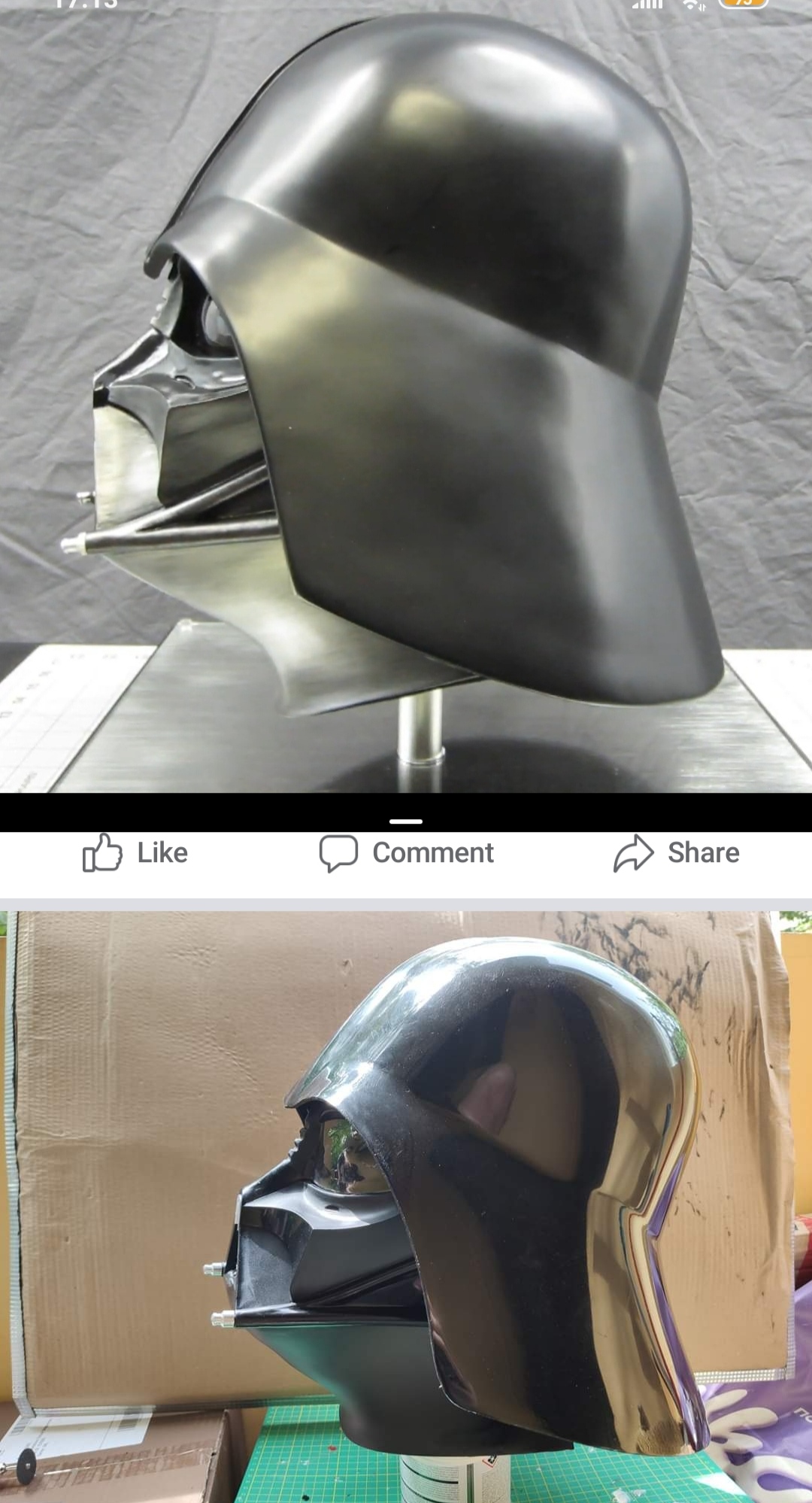

As in most of the other topics of Rubies mods I noticed people usually focus after the dome, to fix the nose the mouth area and sculpting better eyes. However am not that much into such detailing and also am afraid of risking any damages I can't fix on my own. So I followed the method described in both topics (links shared in first post here). I feel satisfied with the new dome angle. For now it's still using the original Velcro to keep the dome stable on the helmet, will see how durable it is when wearing it around. Will try to share images of my progress in a moment or bit later. Today working on smaller vent at the chin area to bring that ANH /R1 feeling on it.

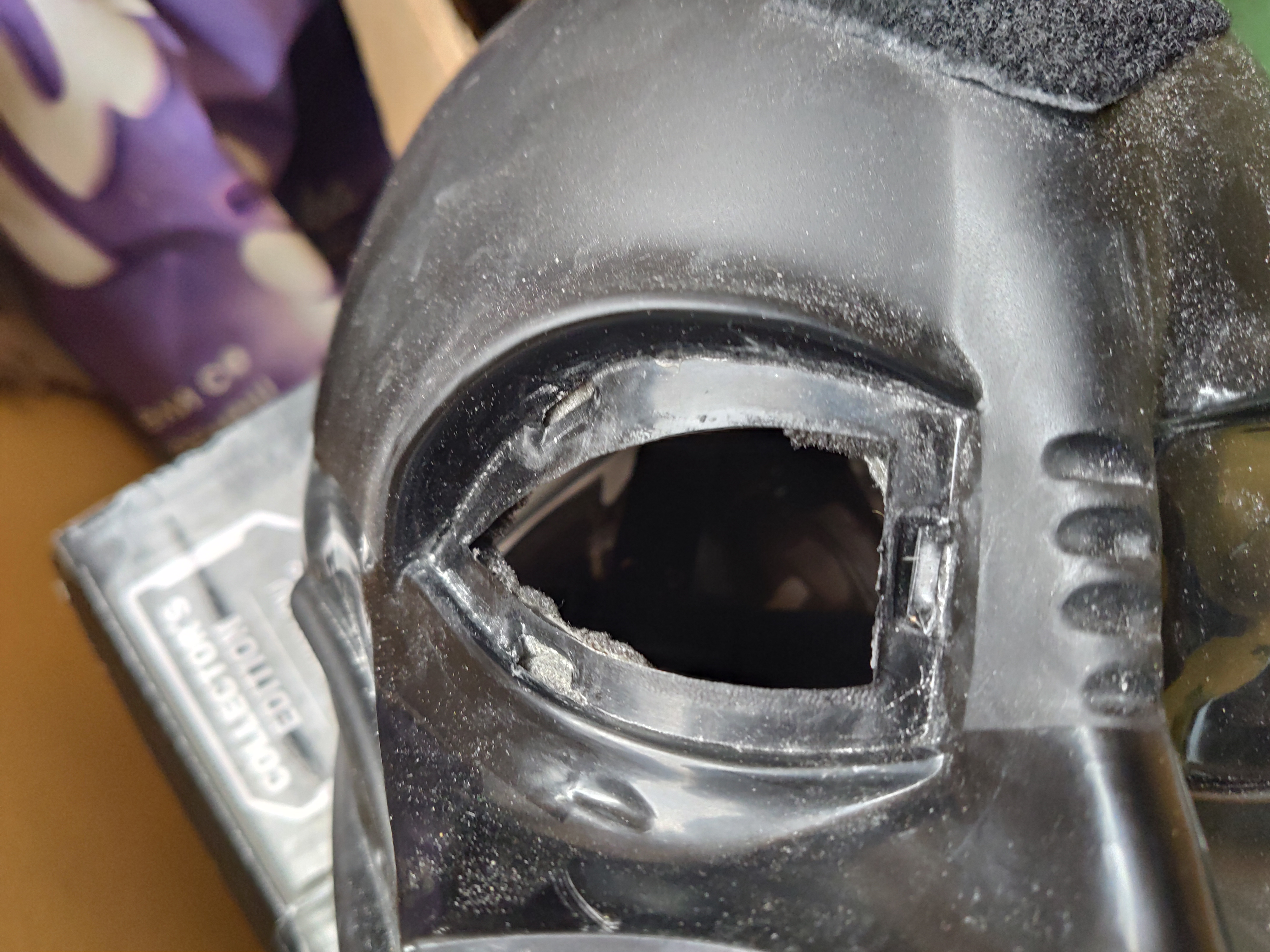

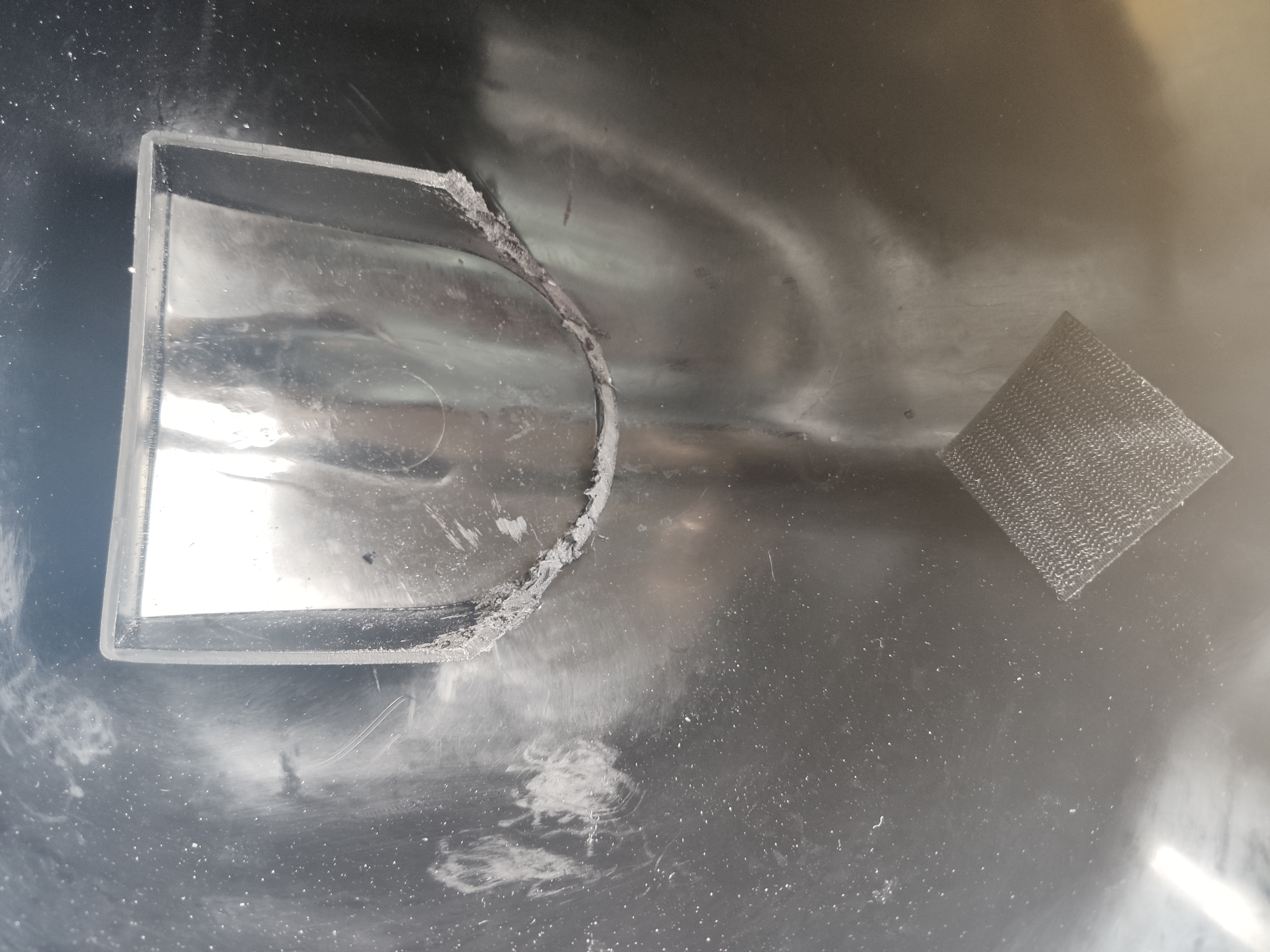

Here are some photos from yesterday correcting the angle of the dome and cutting the front mount inside the dome with dremel. Today is the small vent. Later will go with two colour scheme, sadly can't find any gun metal spray paint in Bulgaria, so I'm going perhaps with a dark grey. Tried a test shot with dark chrome and applying matt gloss after the chrome was drayed in order to make it more like matt darker gray, didn't worked well it turned too light in shade. Will test couple more before I start the paint job of the helmet.
