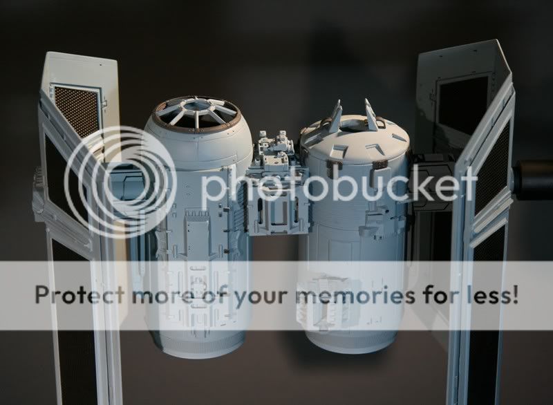

I know it's not perfect but I'm pretty happy with it.

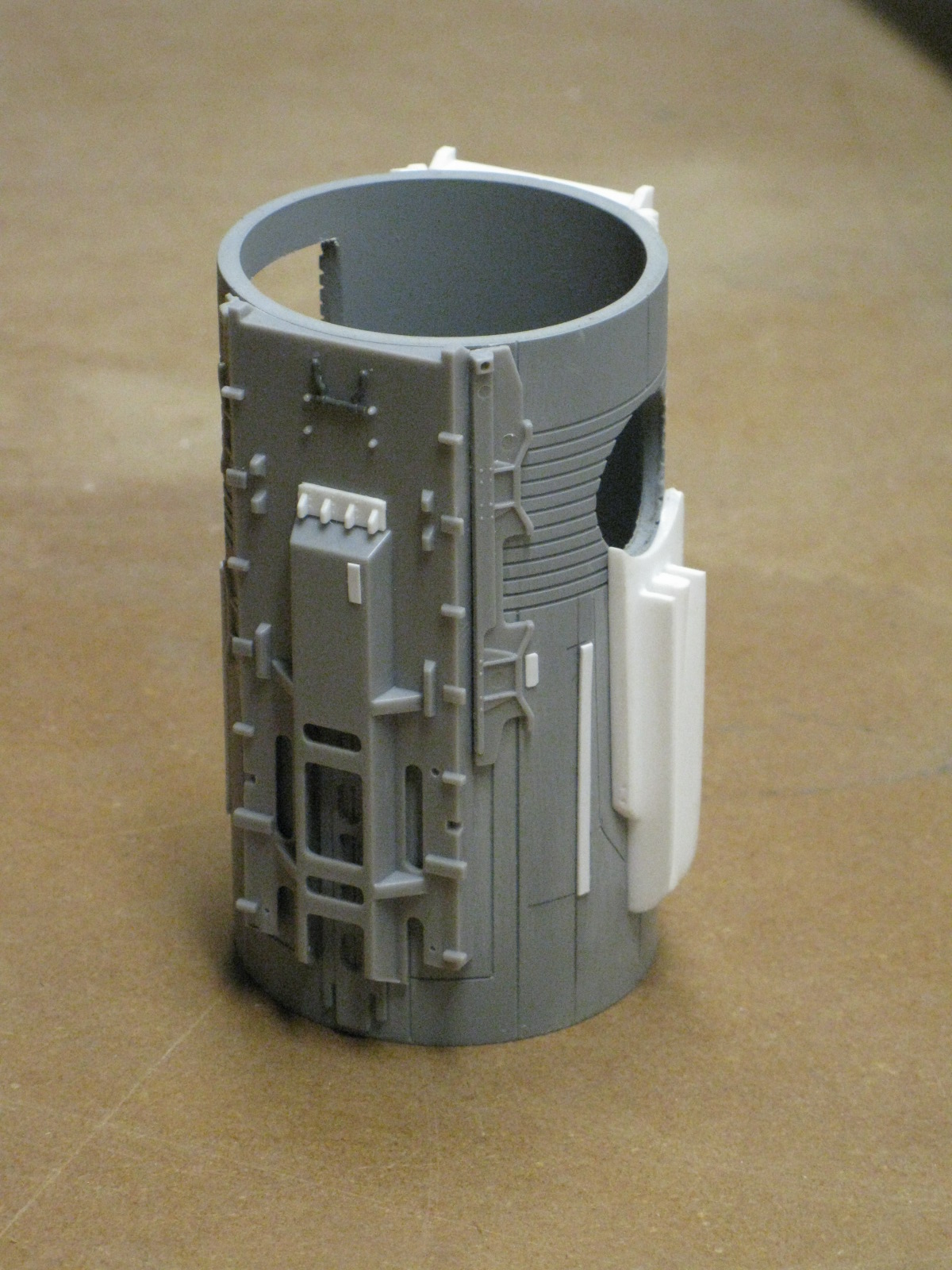

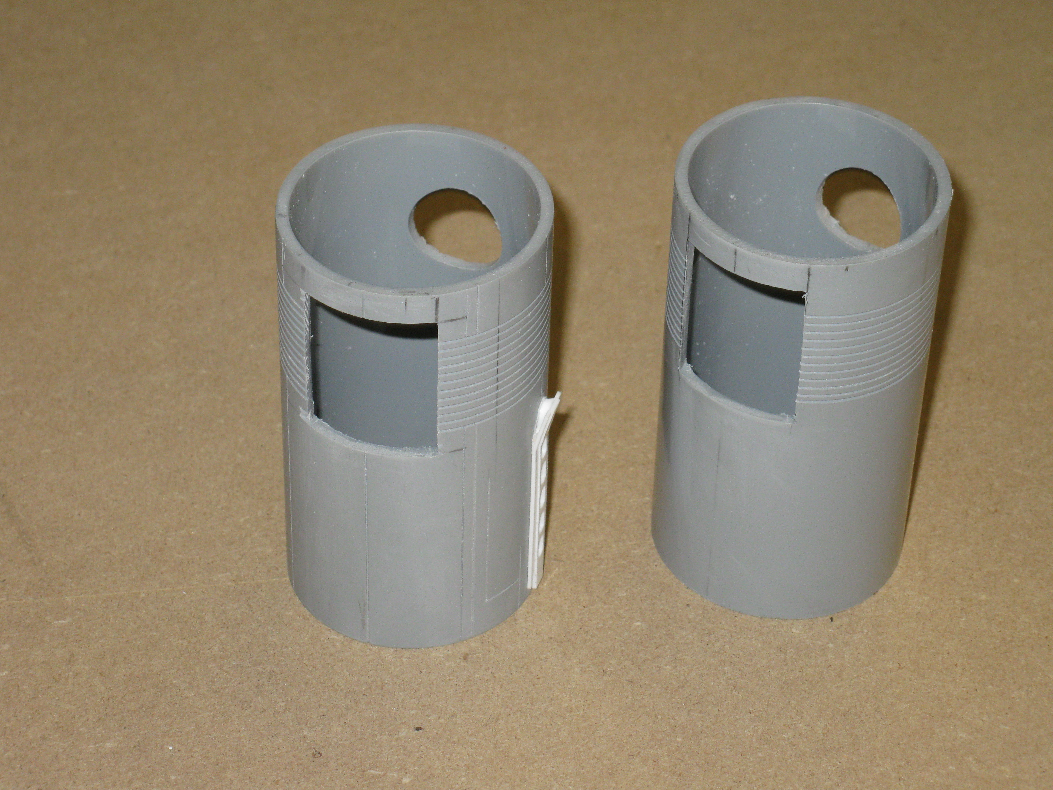

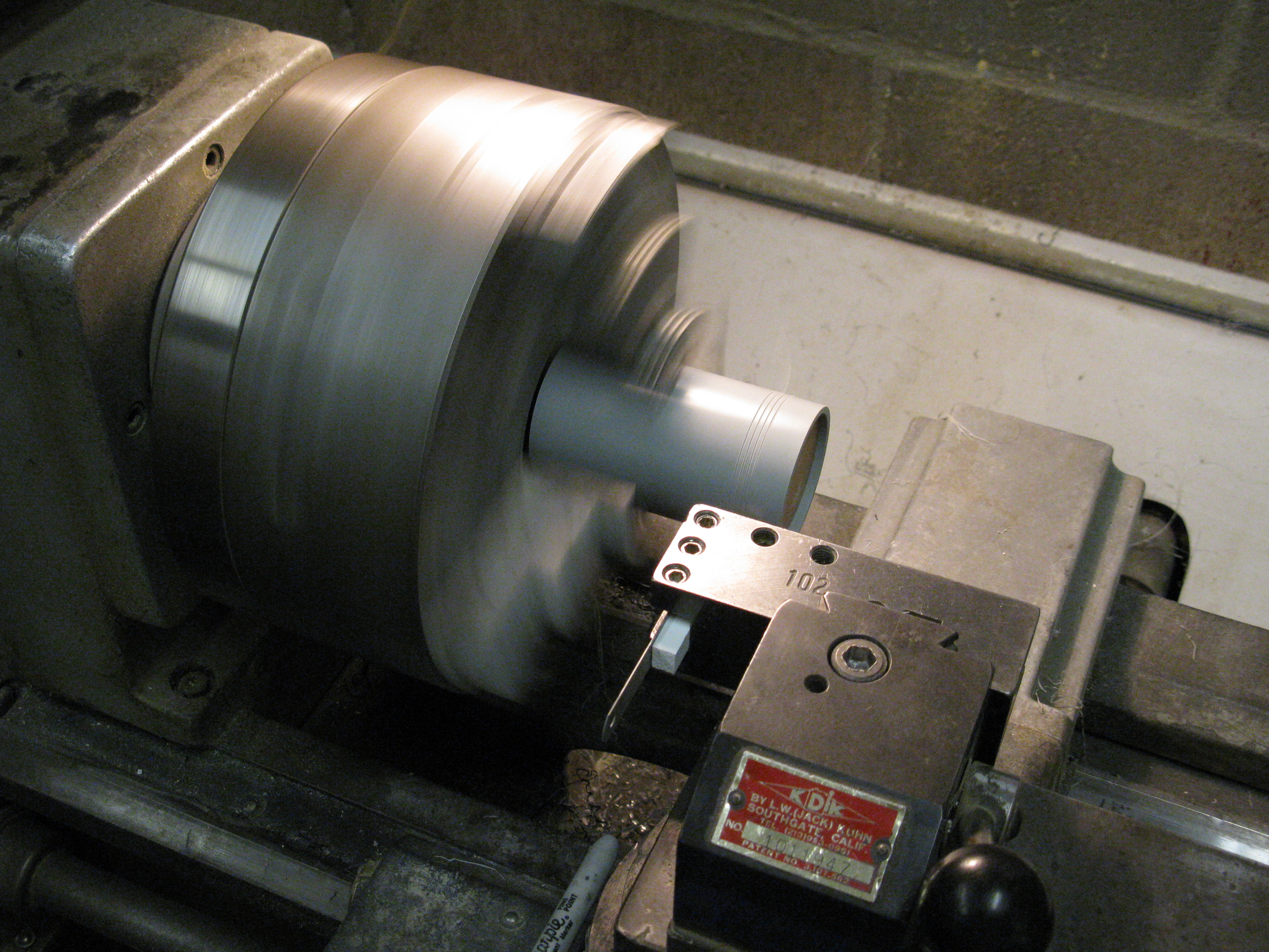

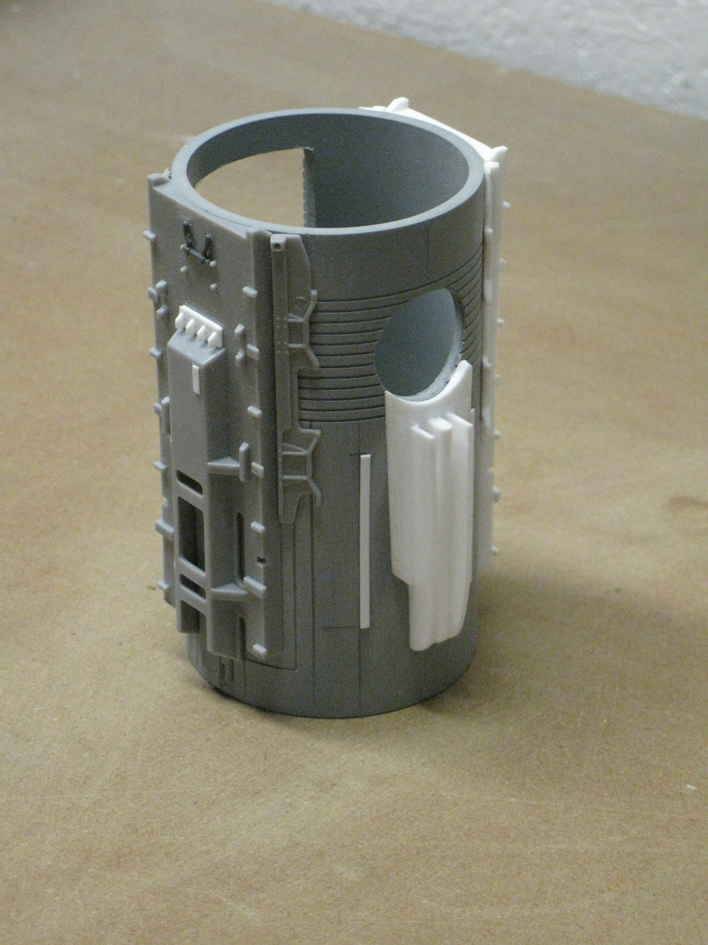

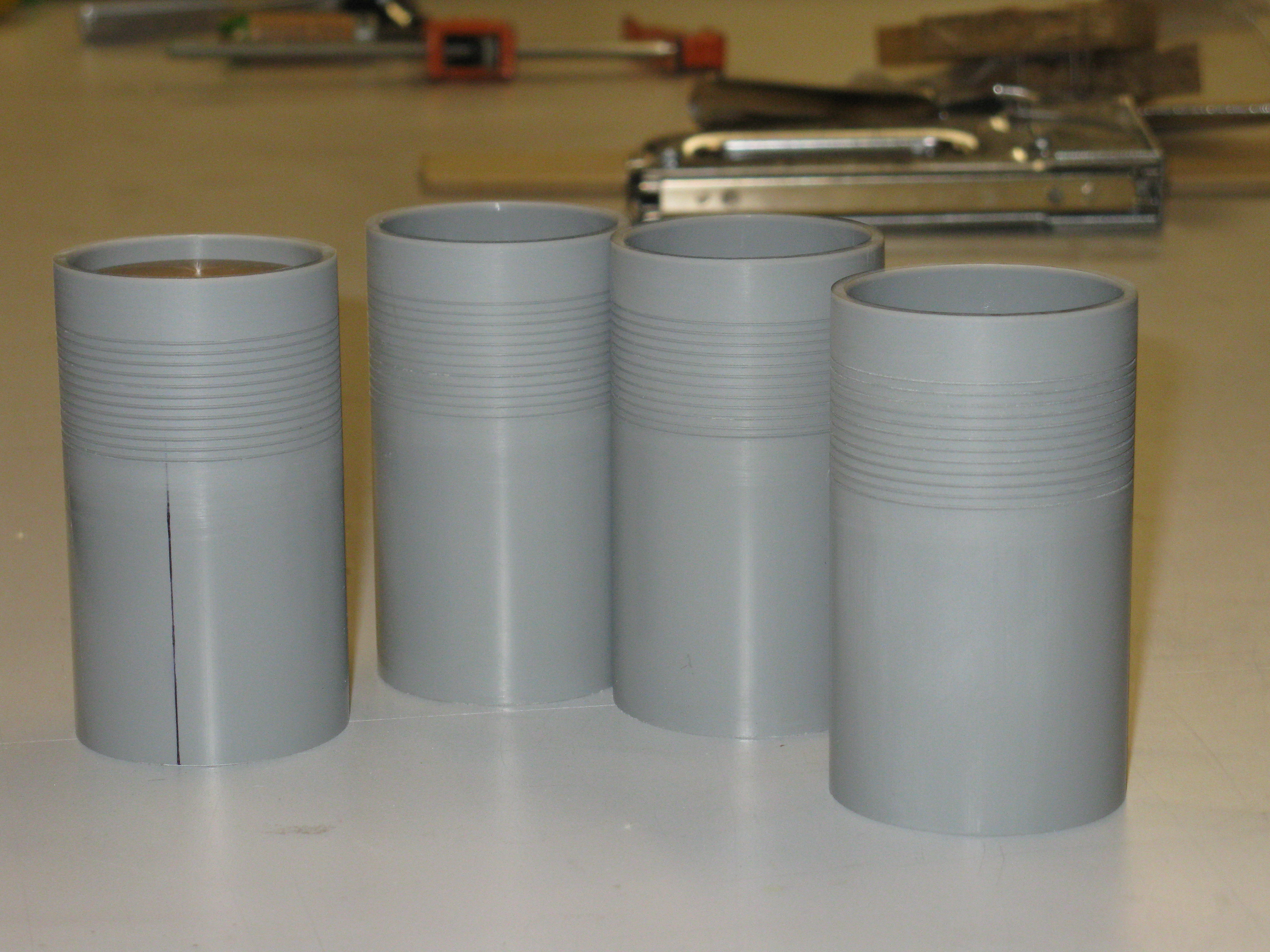

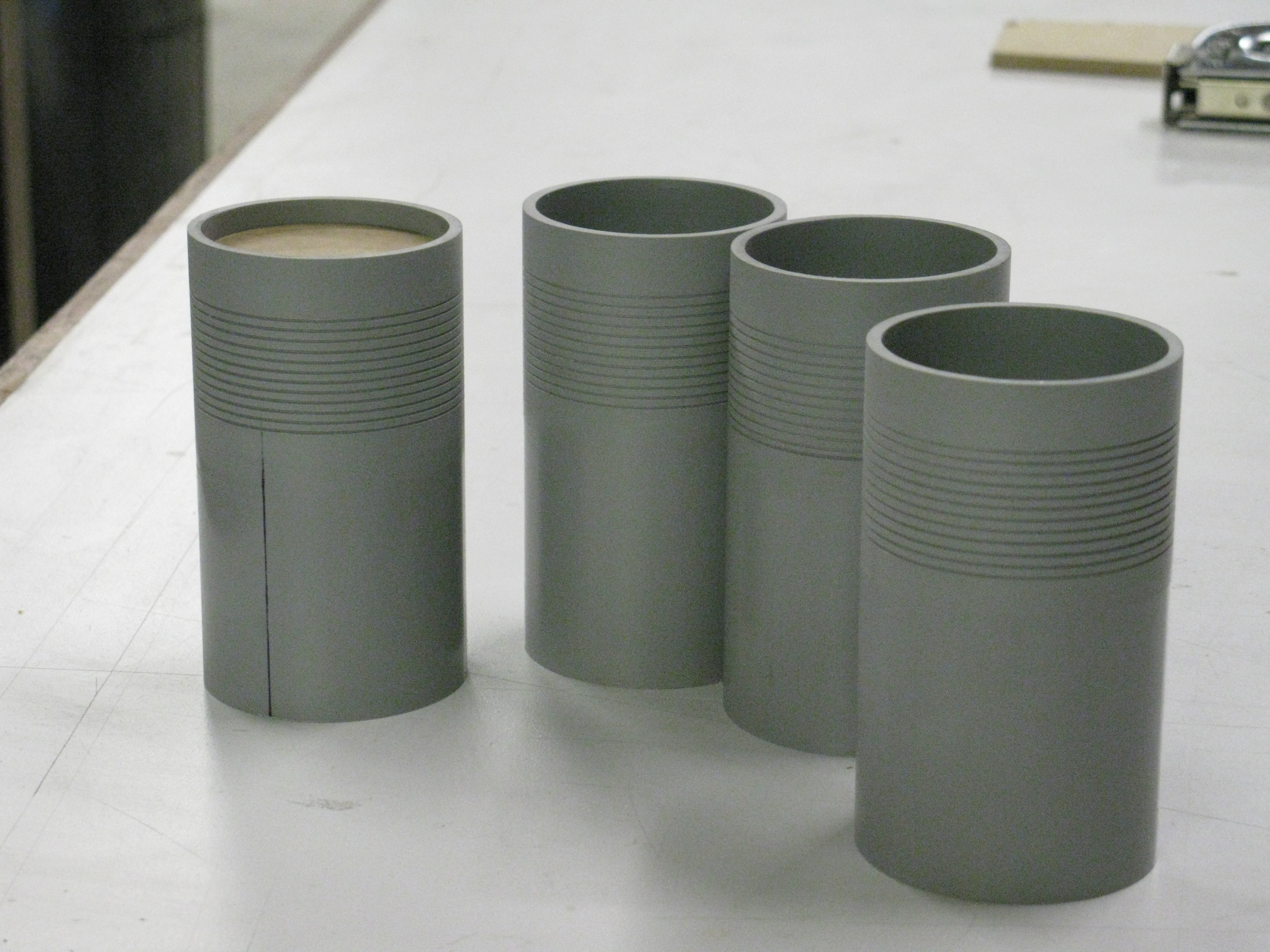

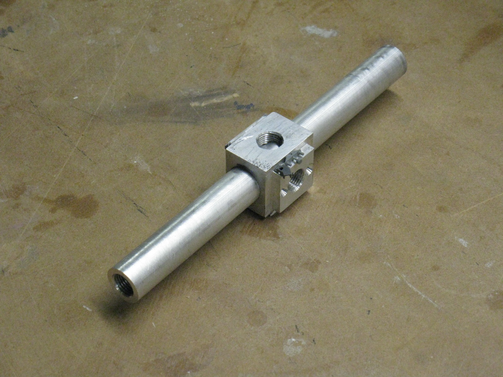

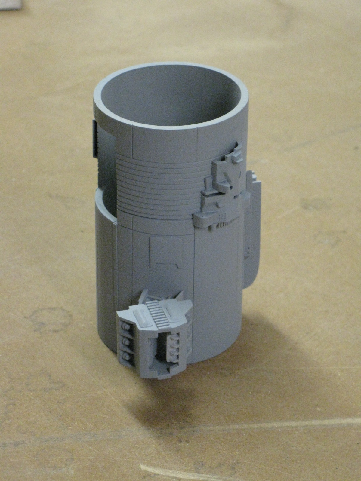

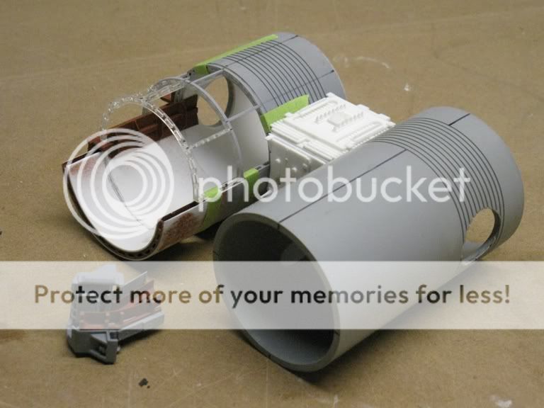

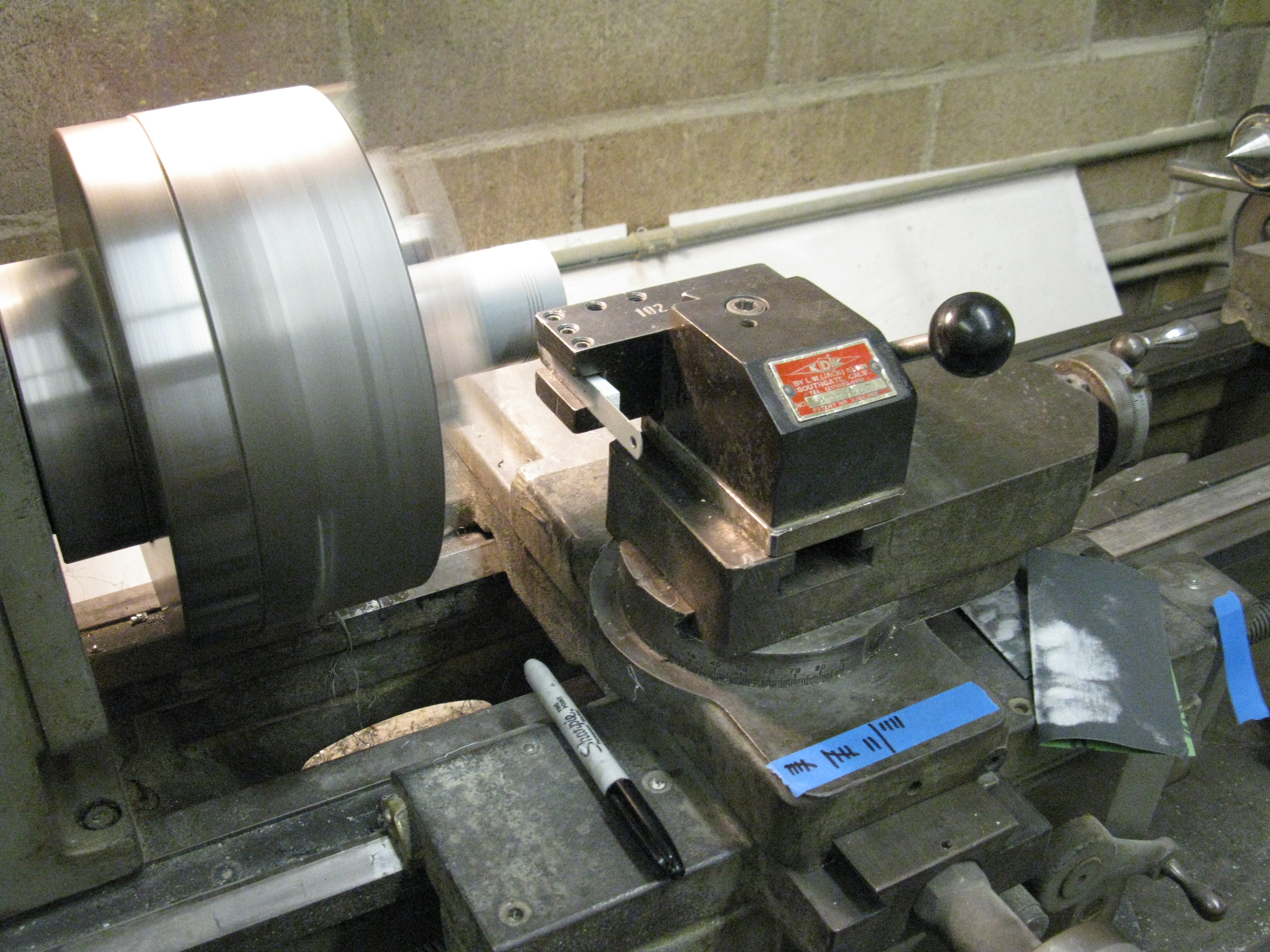

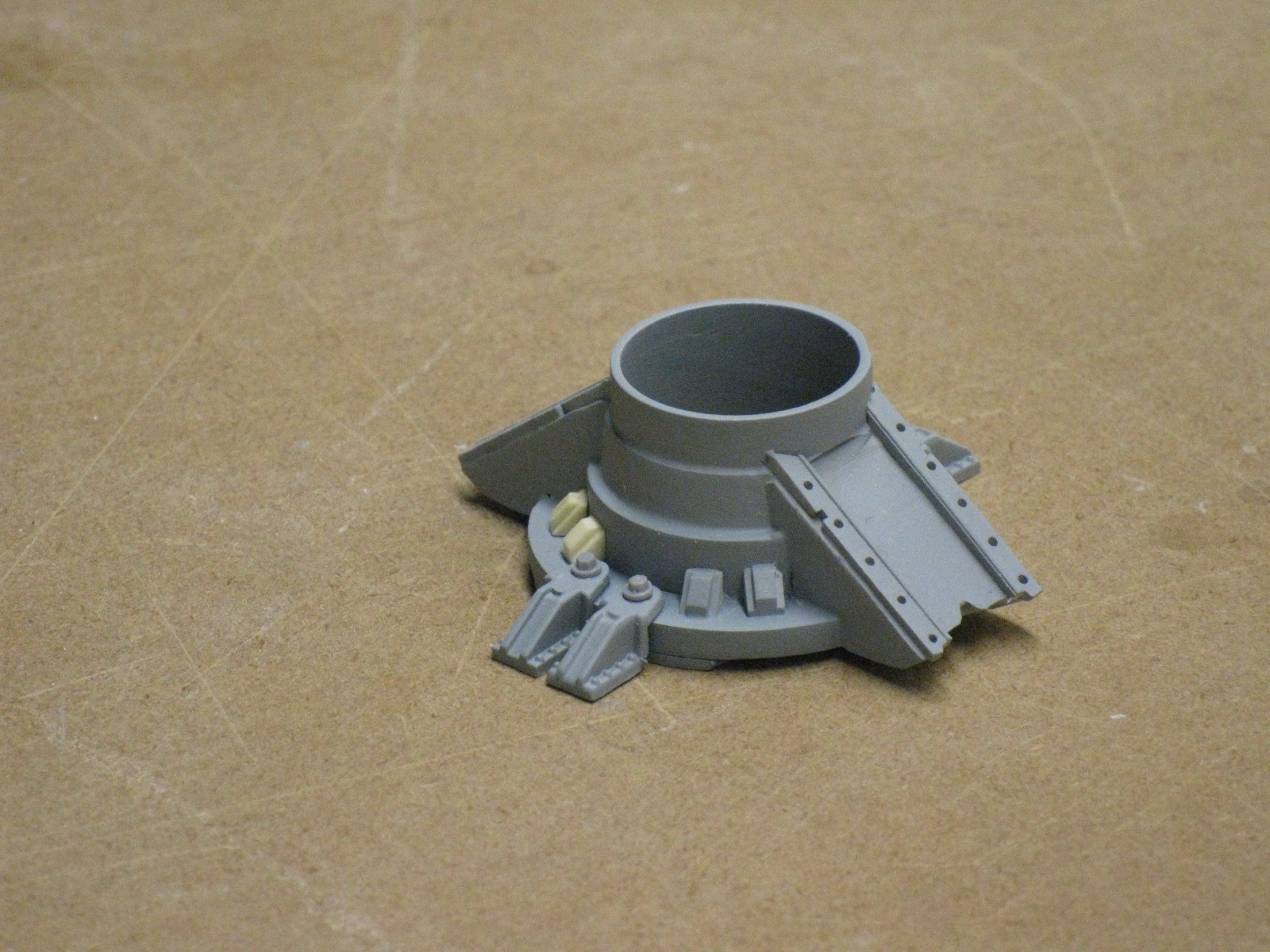

The start of construction: the main bodies on the lathe.

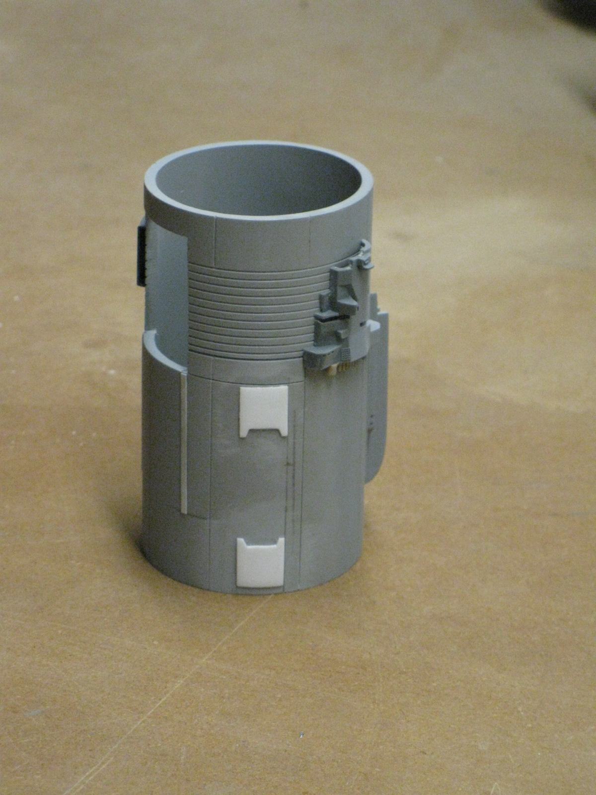

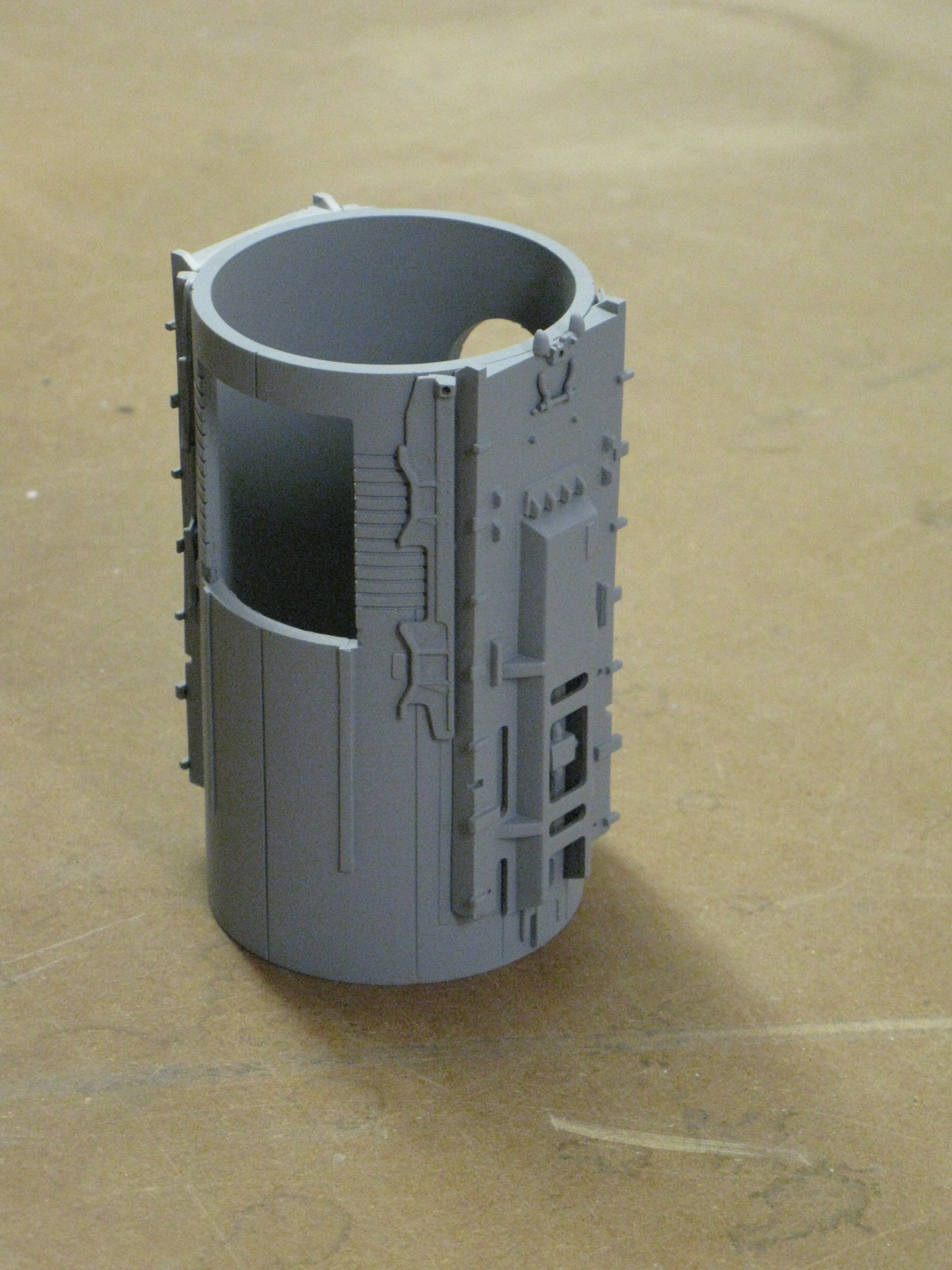

Anything that's white is either a cast part, styrene (or an Apollo) part.

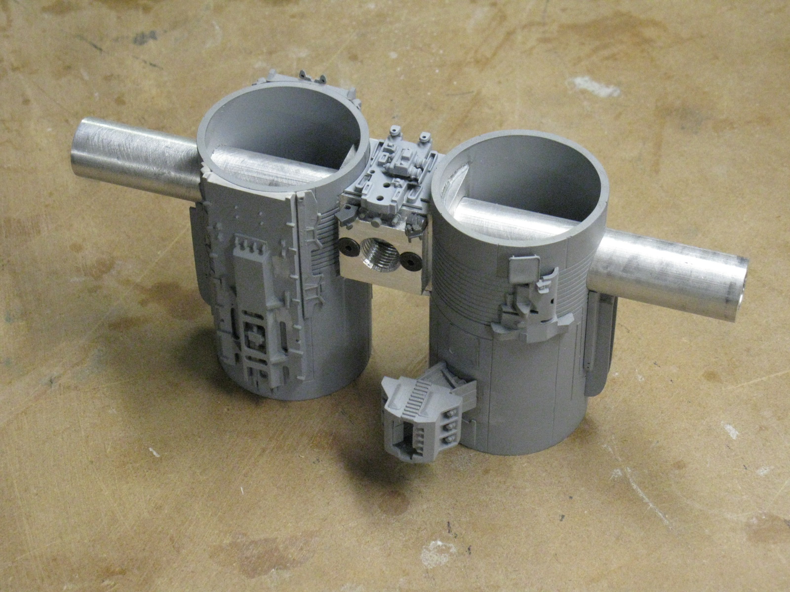

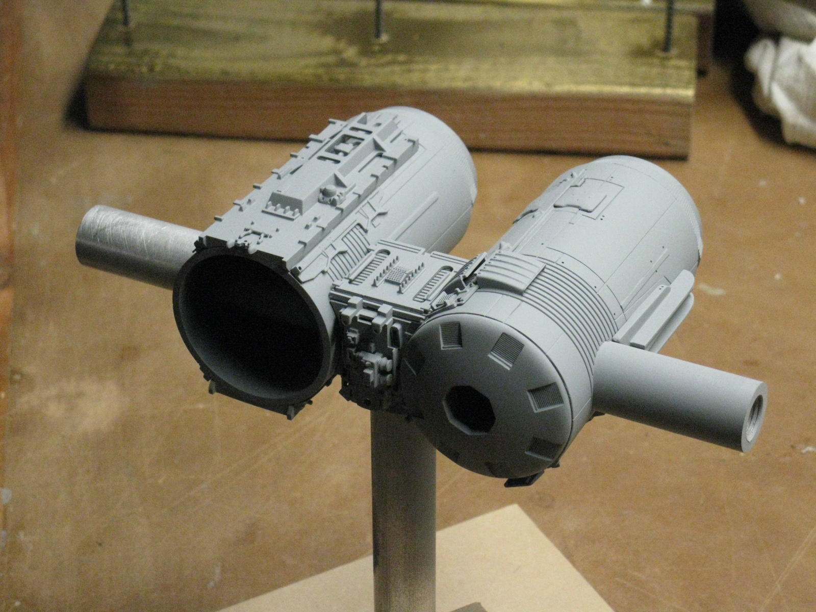

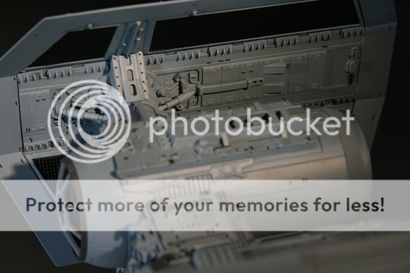

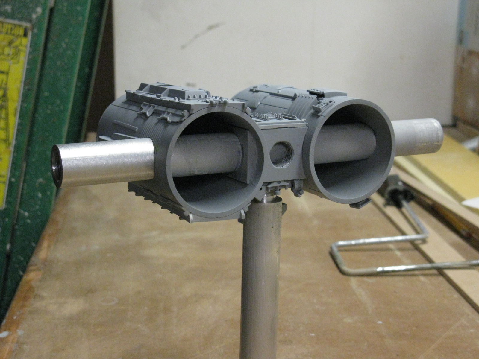

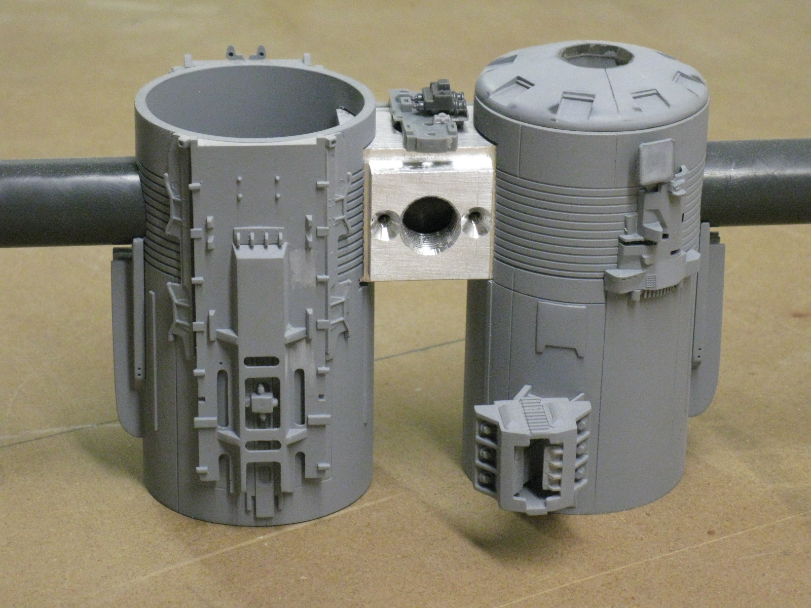

The first test fit

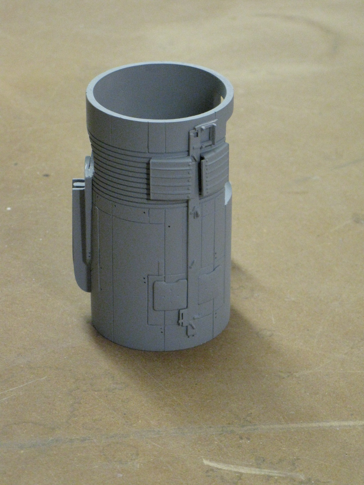

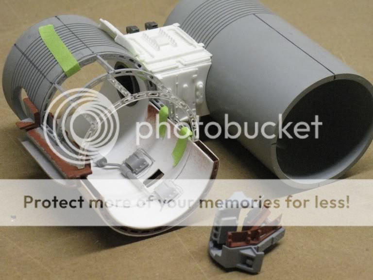

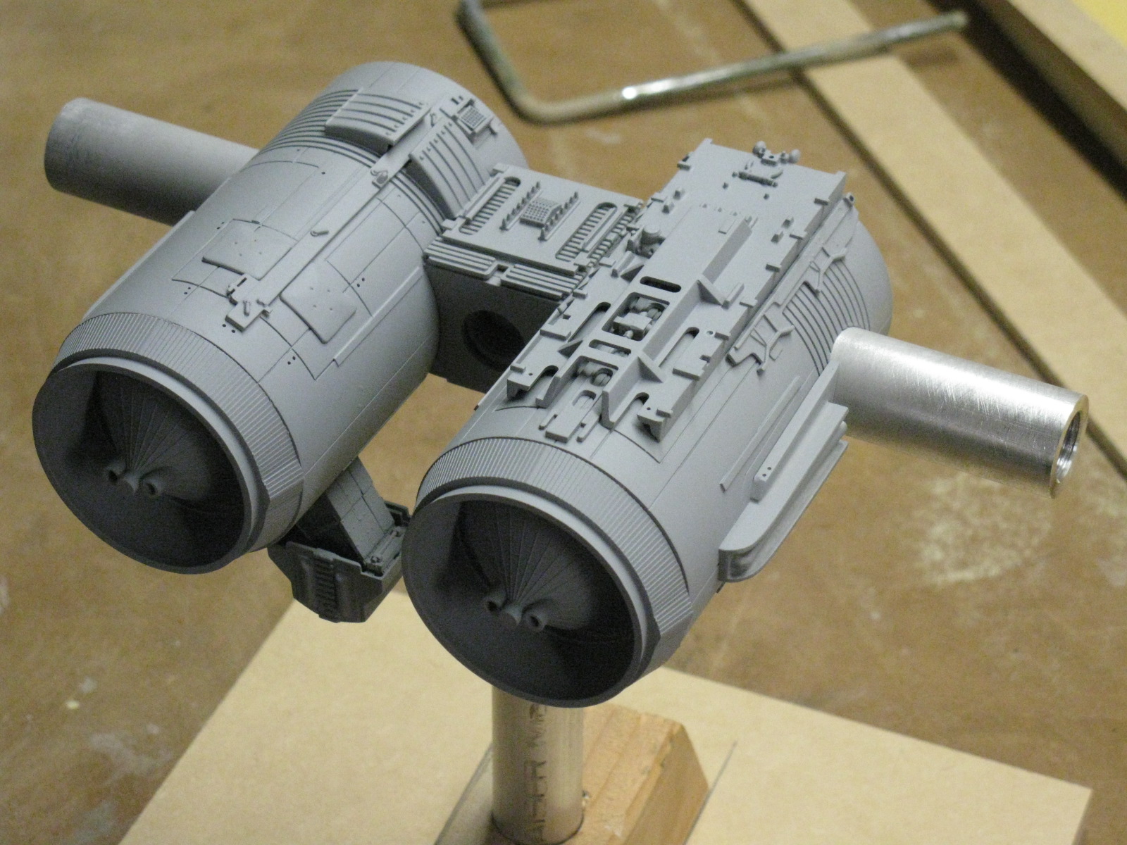

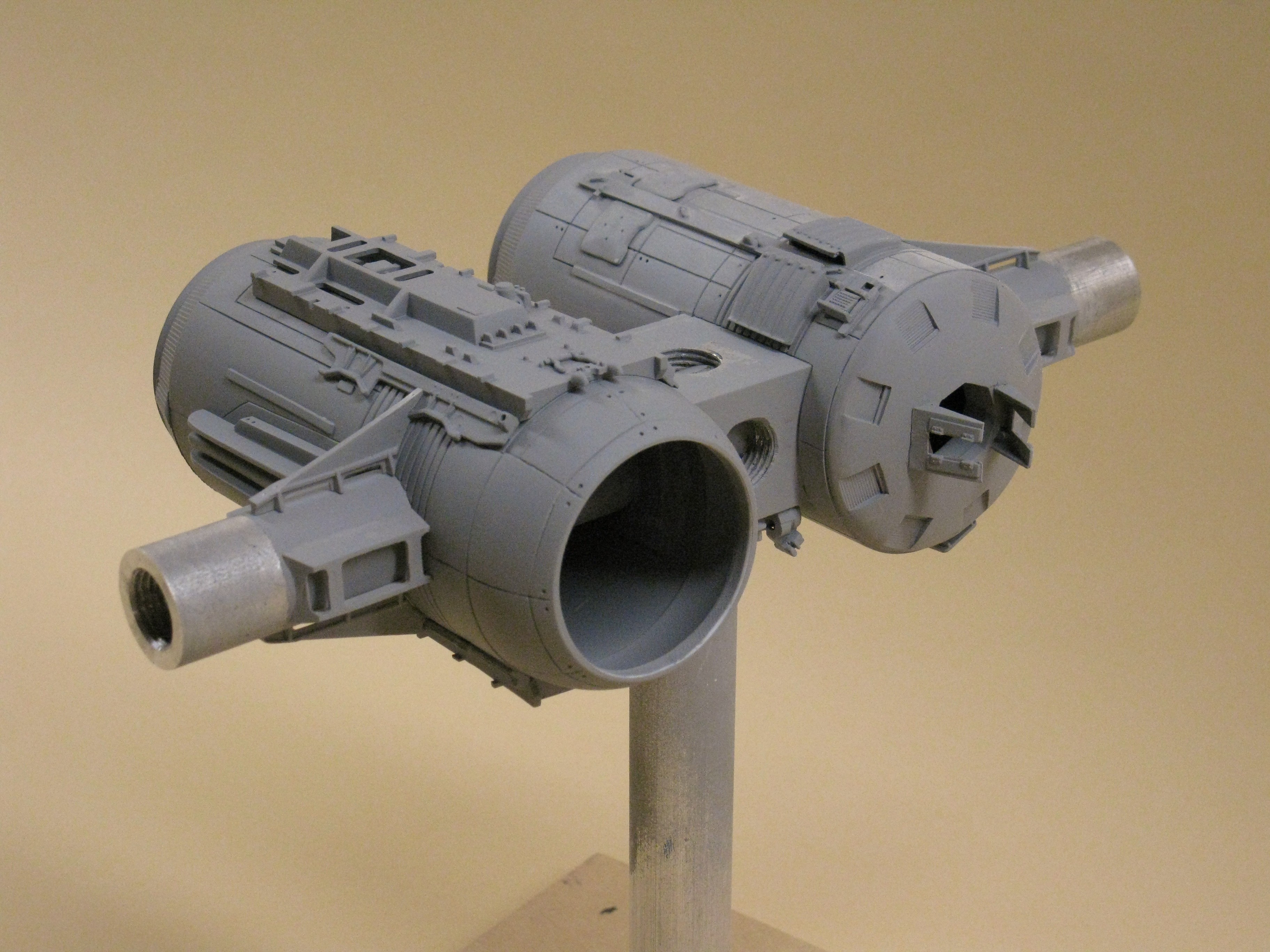

The armature completed

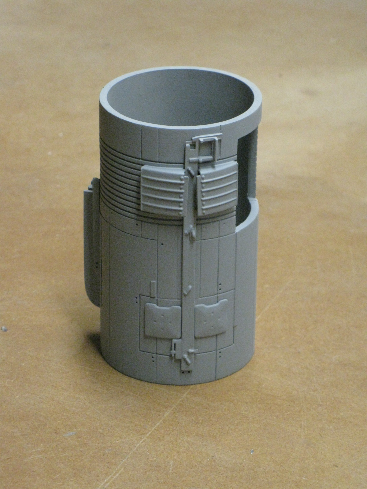

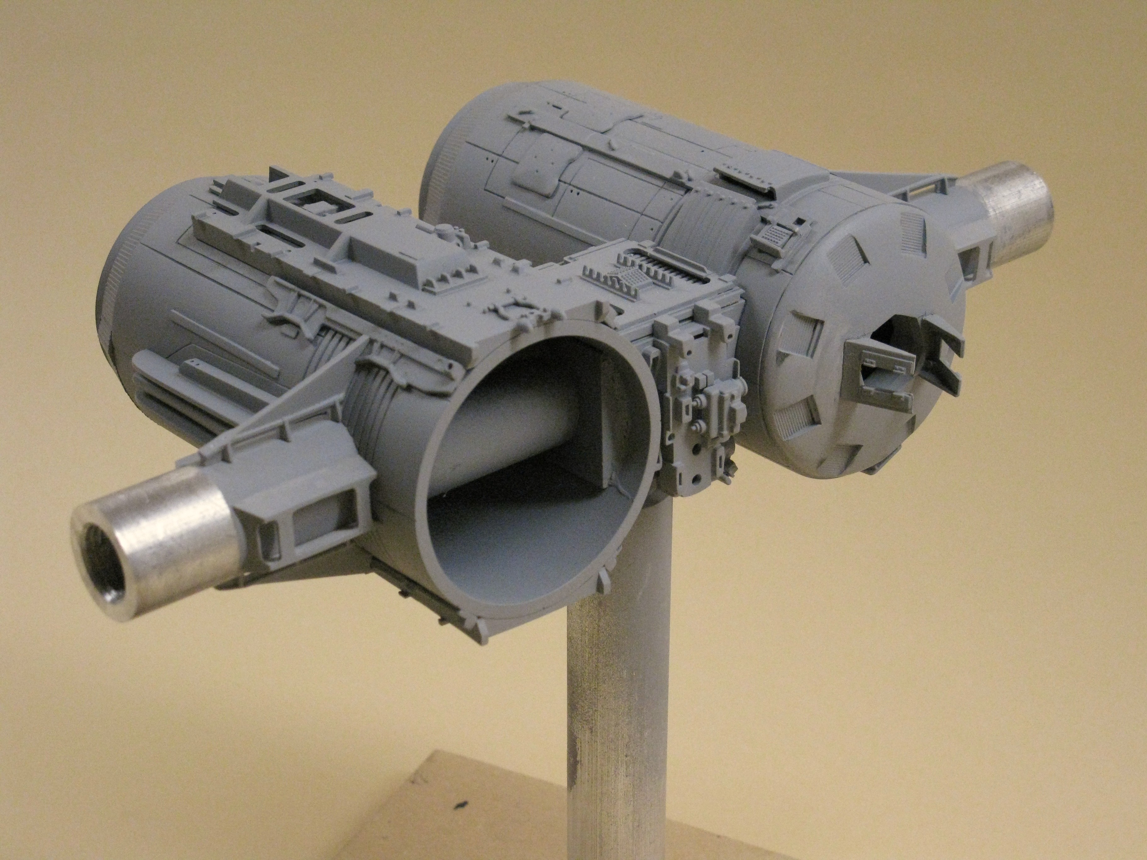

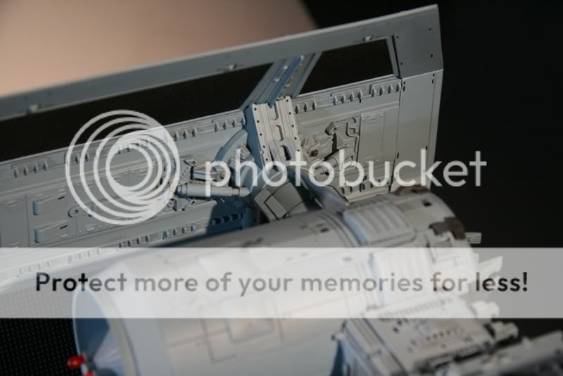

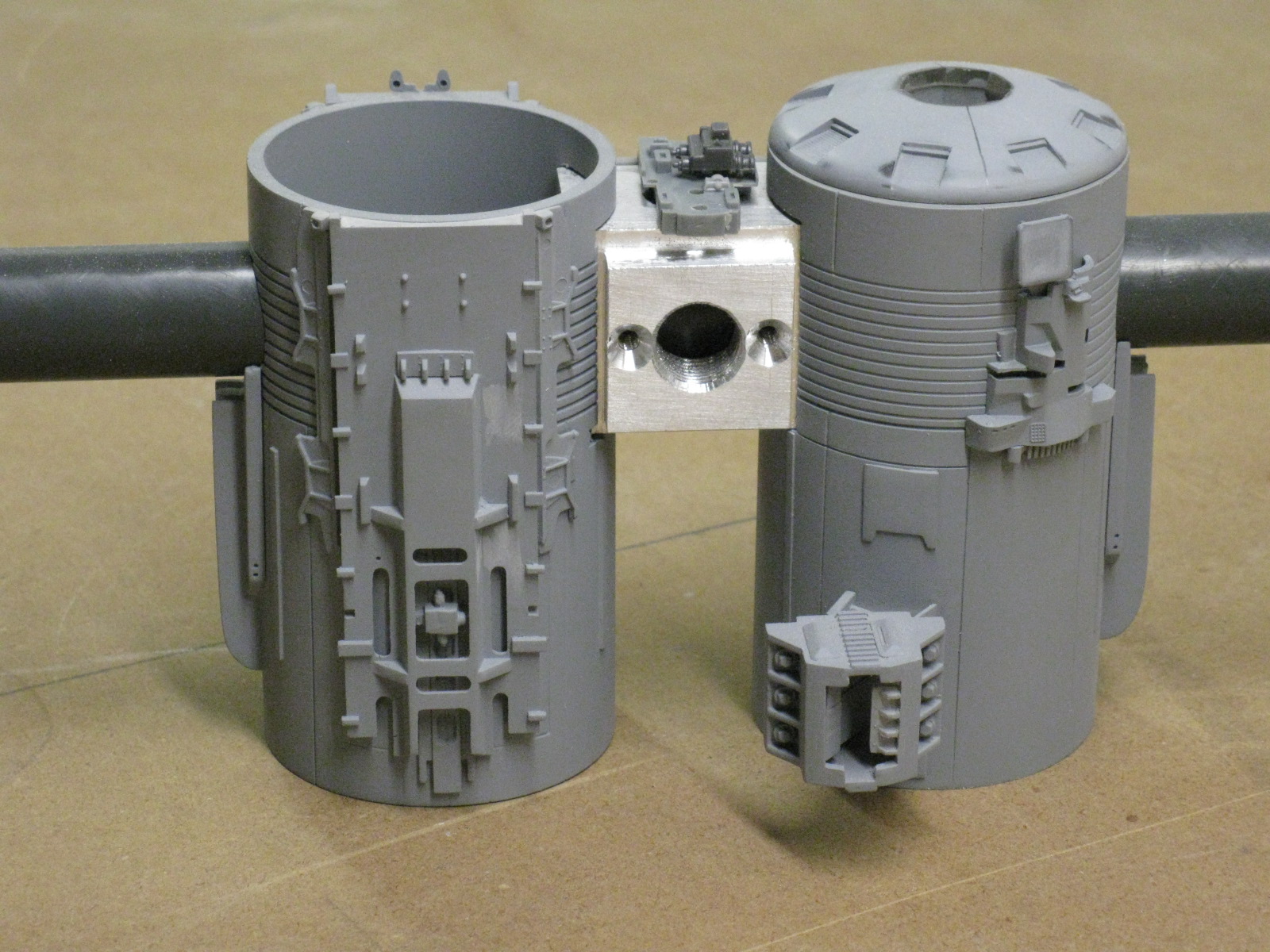

Final assembly begins

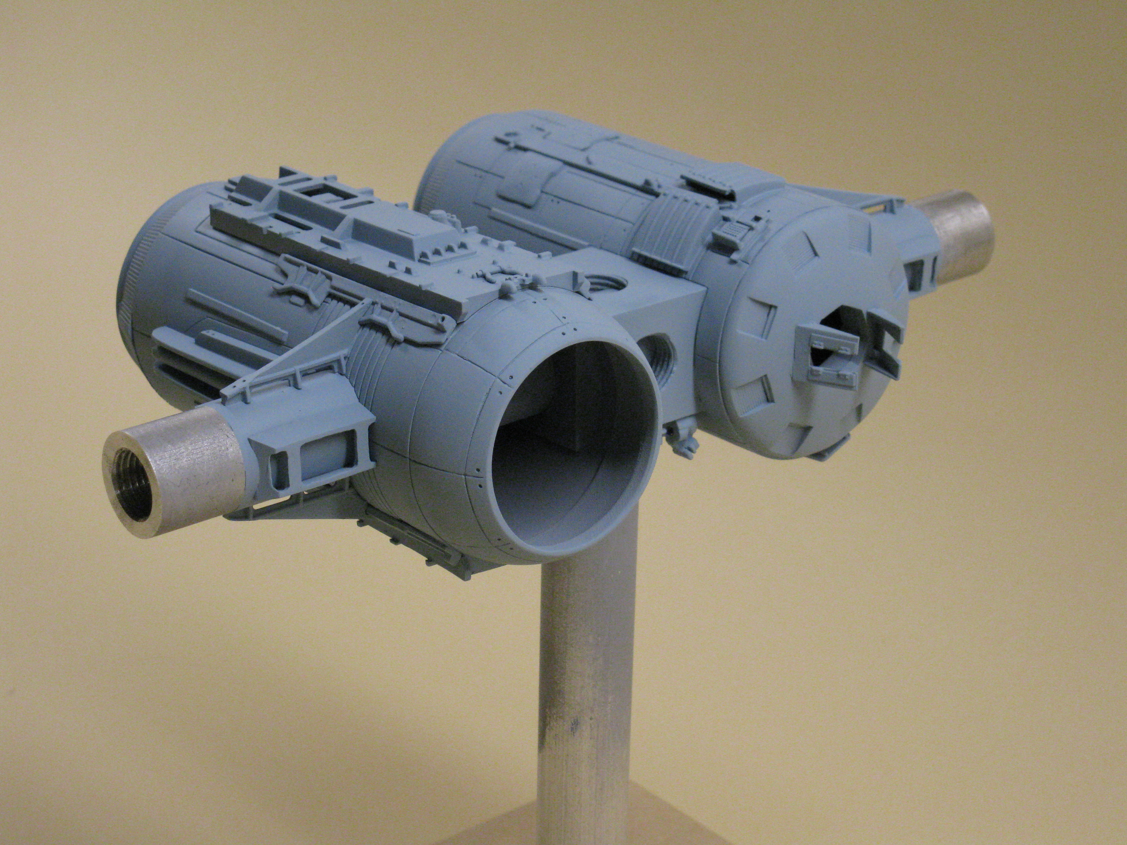

Done and ready for paint

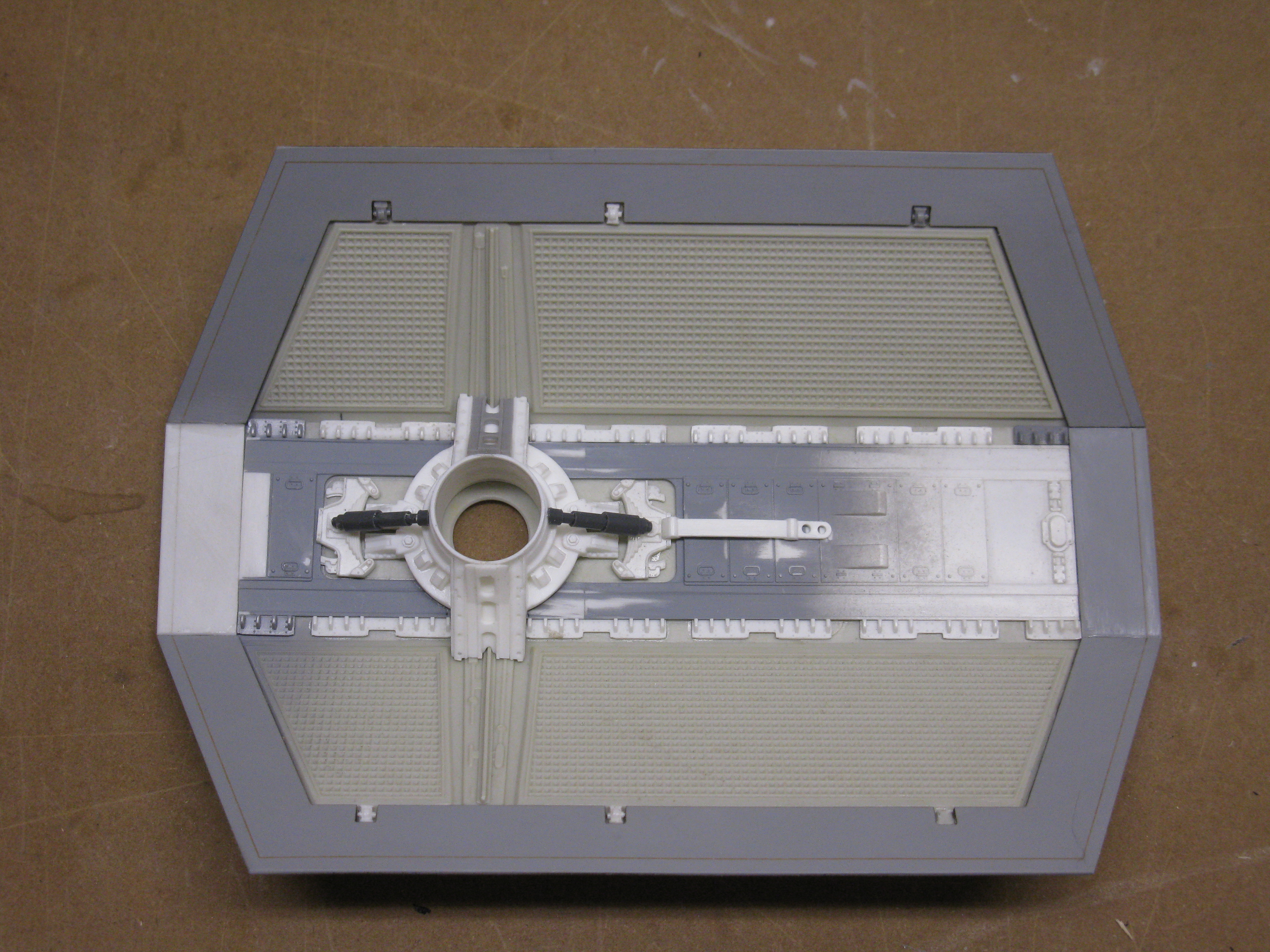

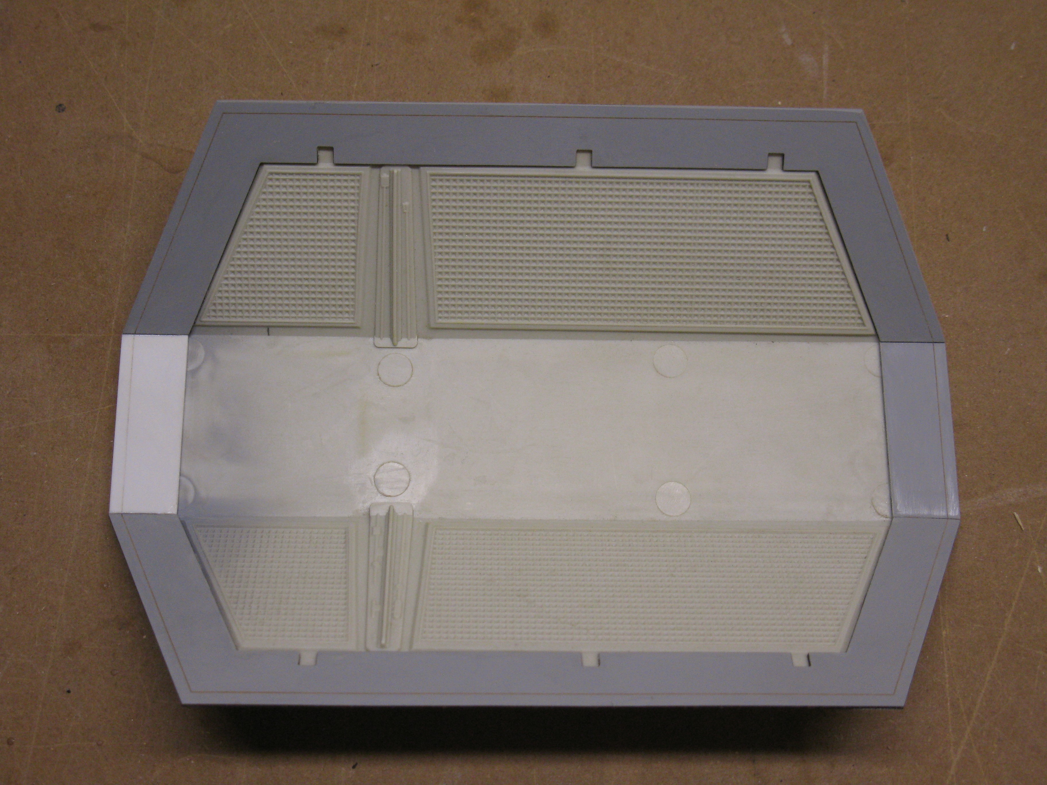

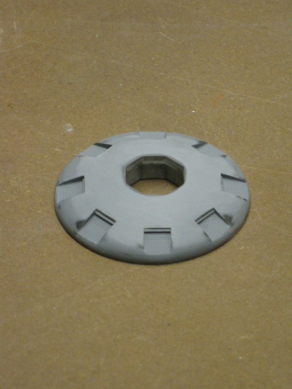

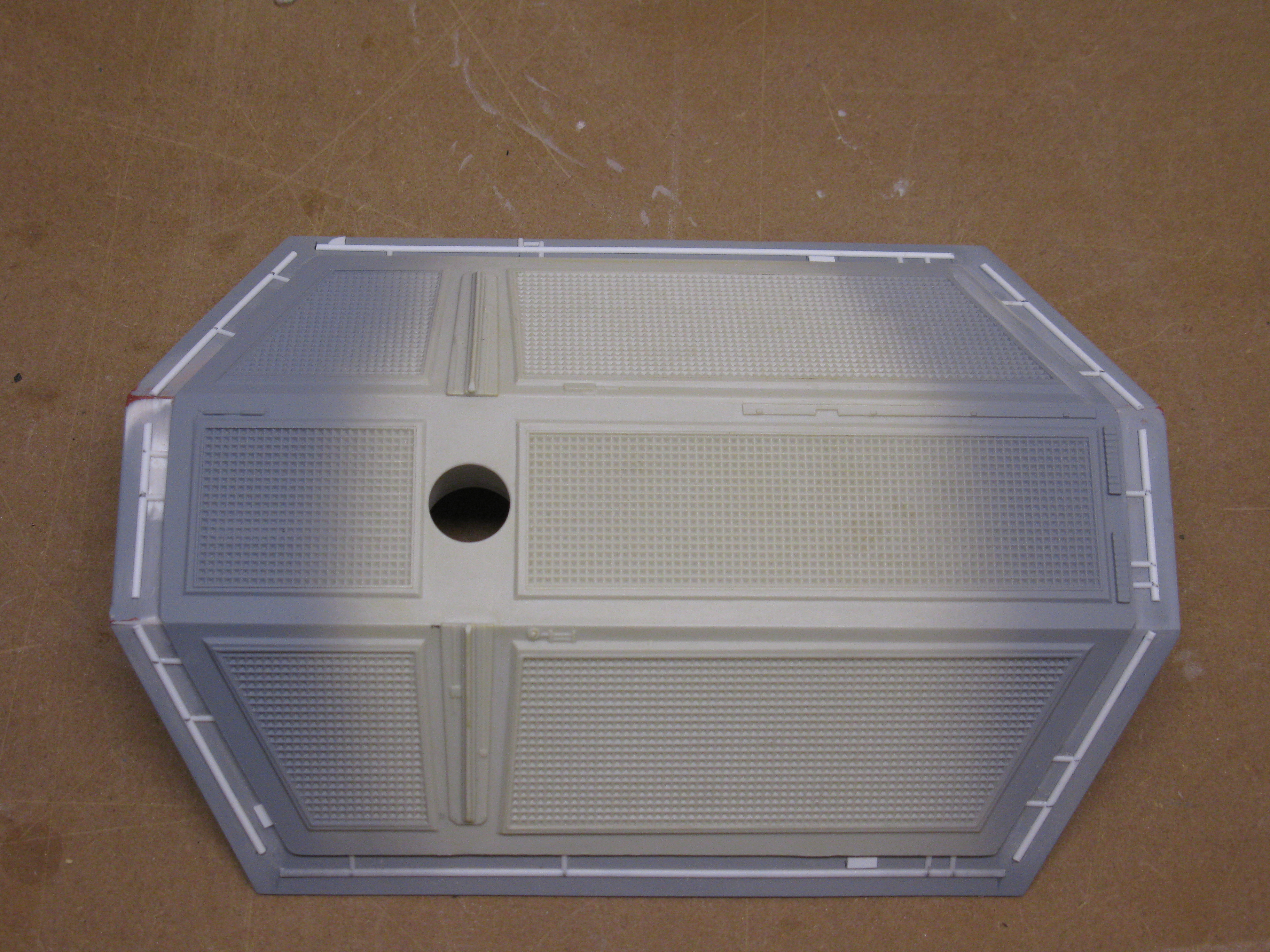

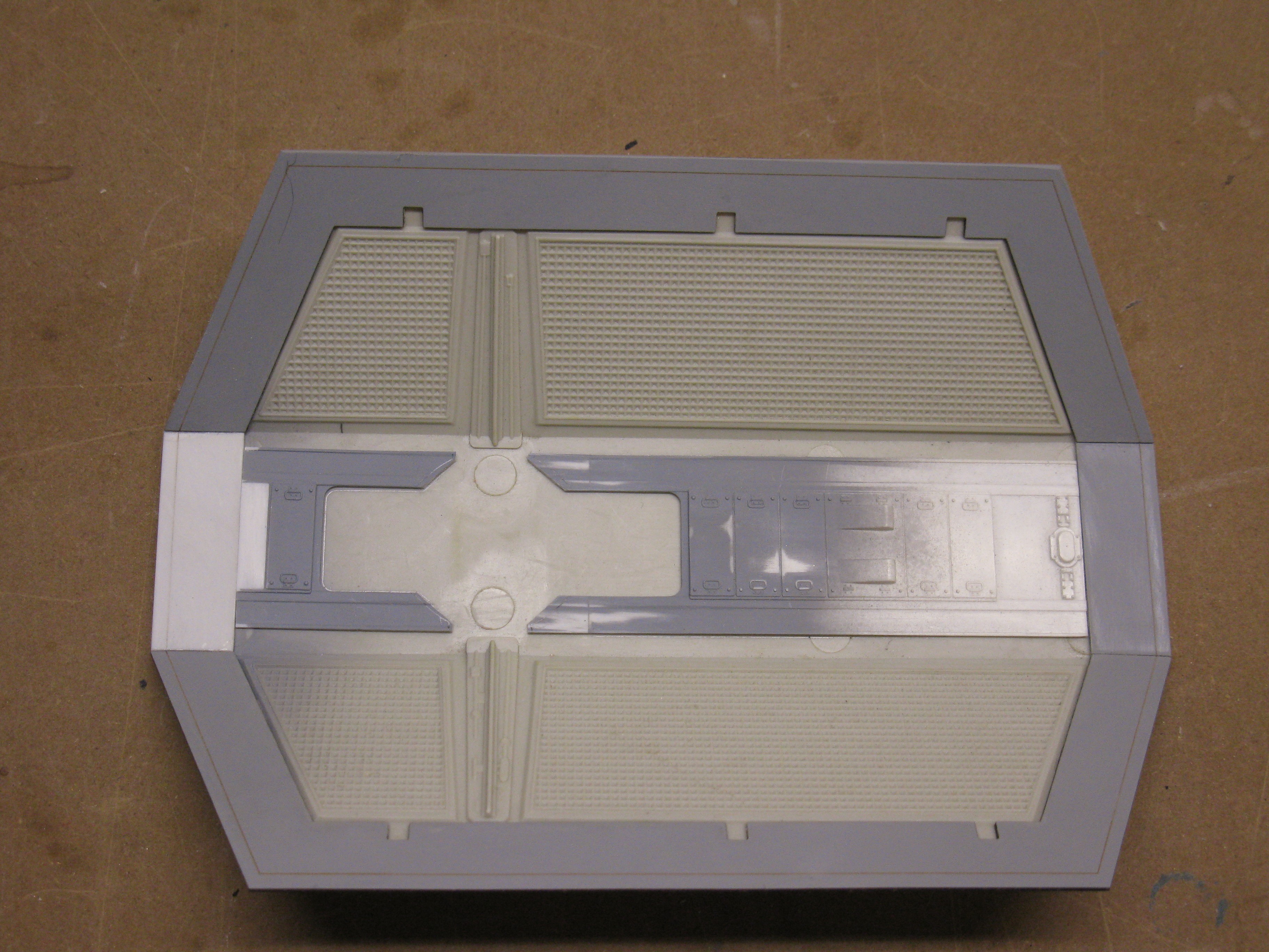

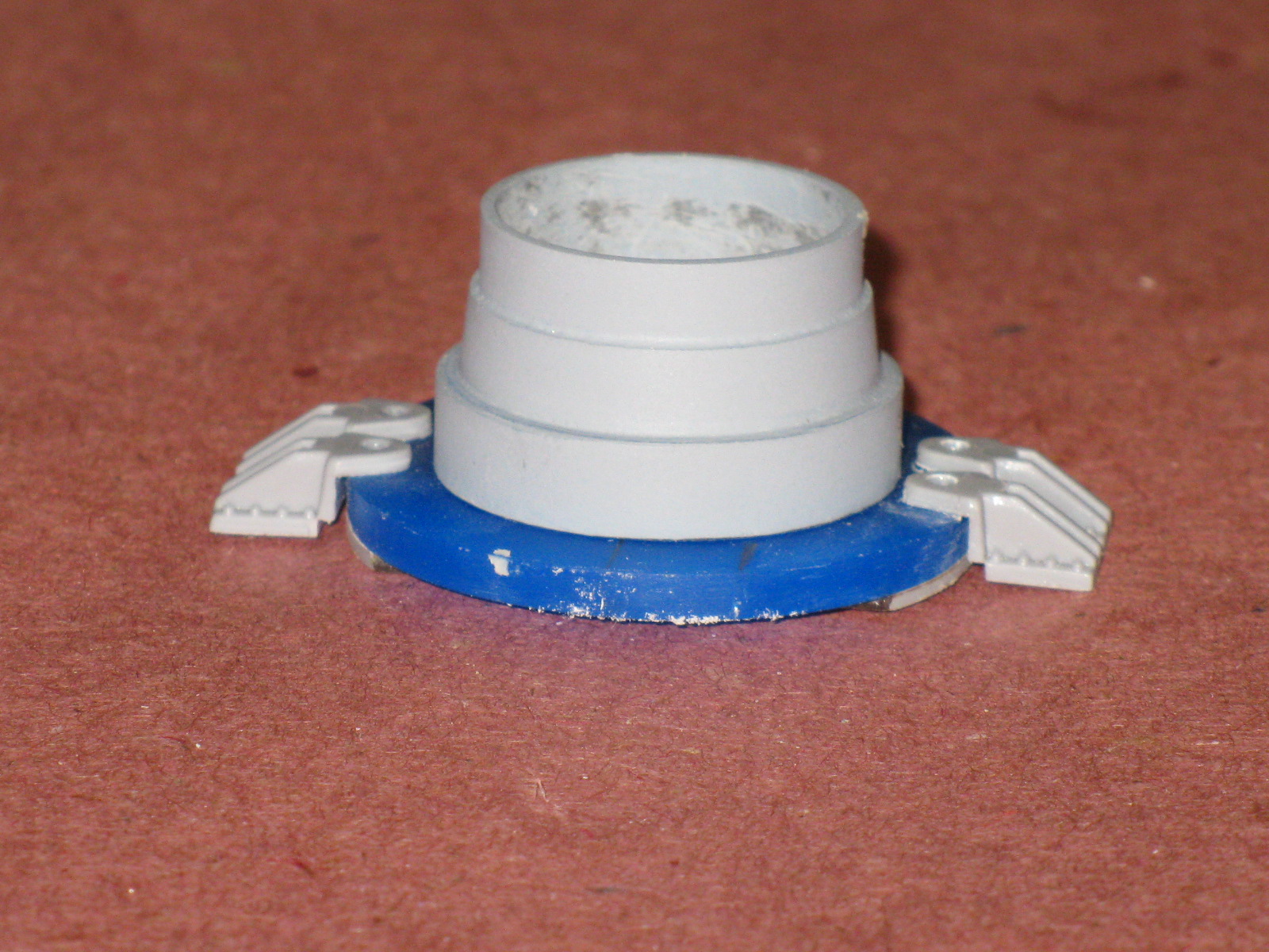

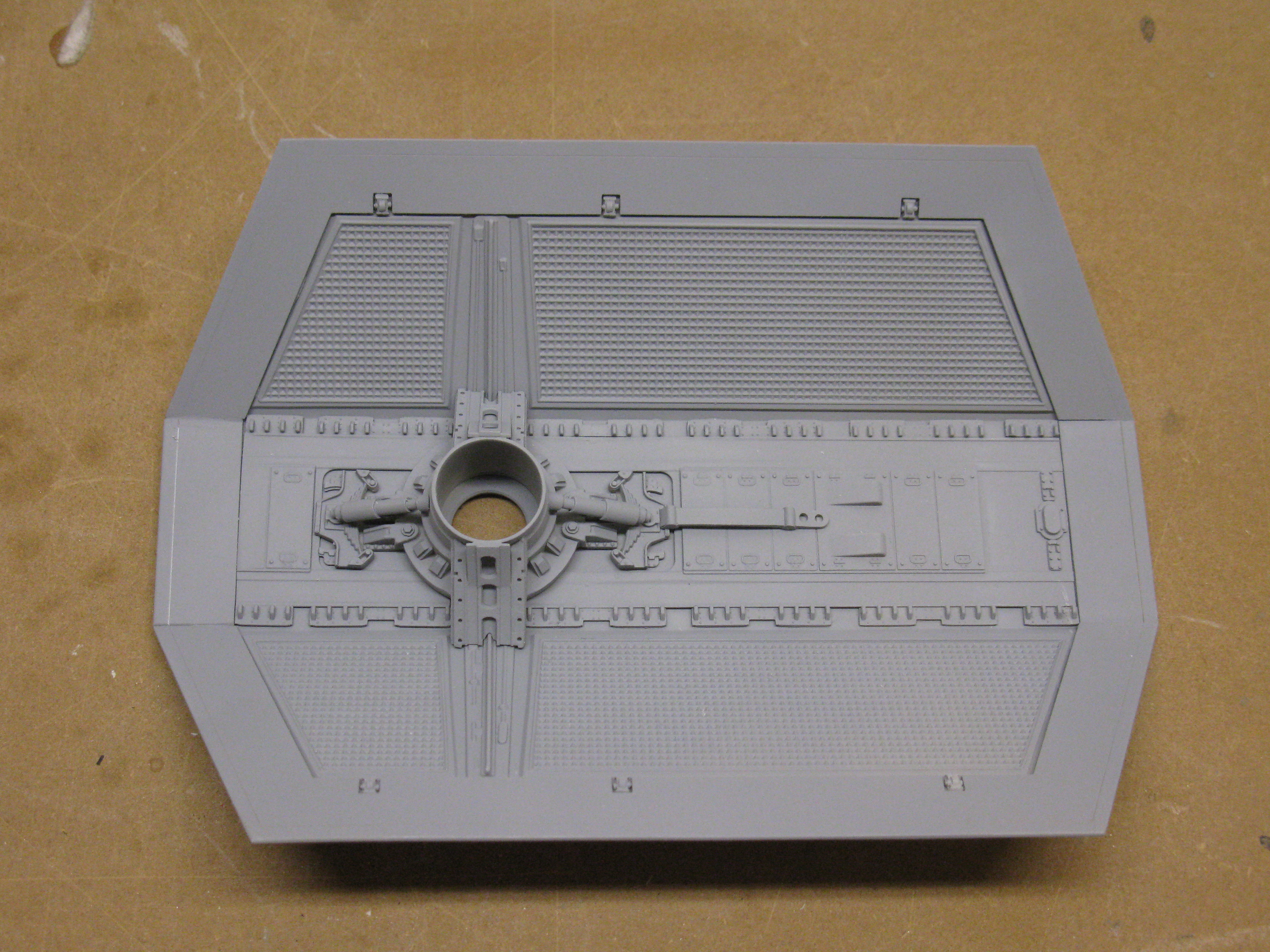

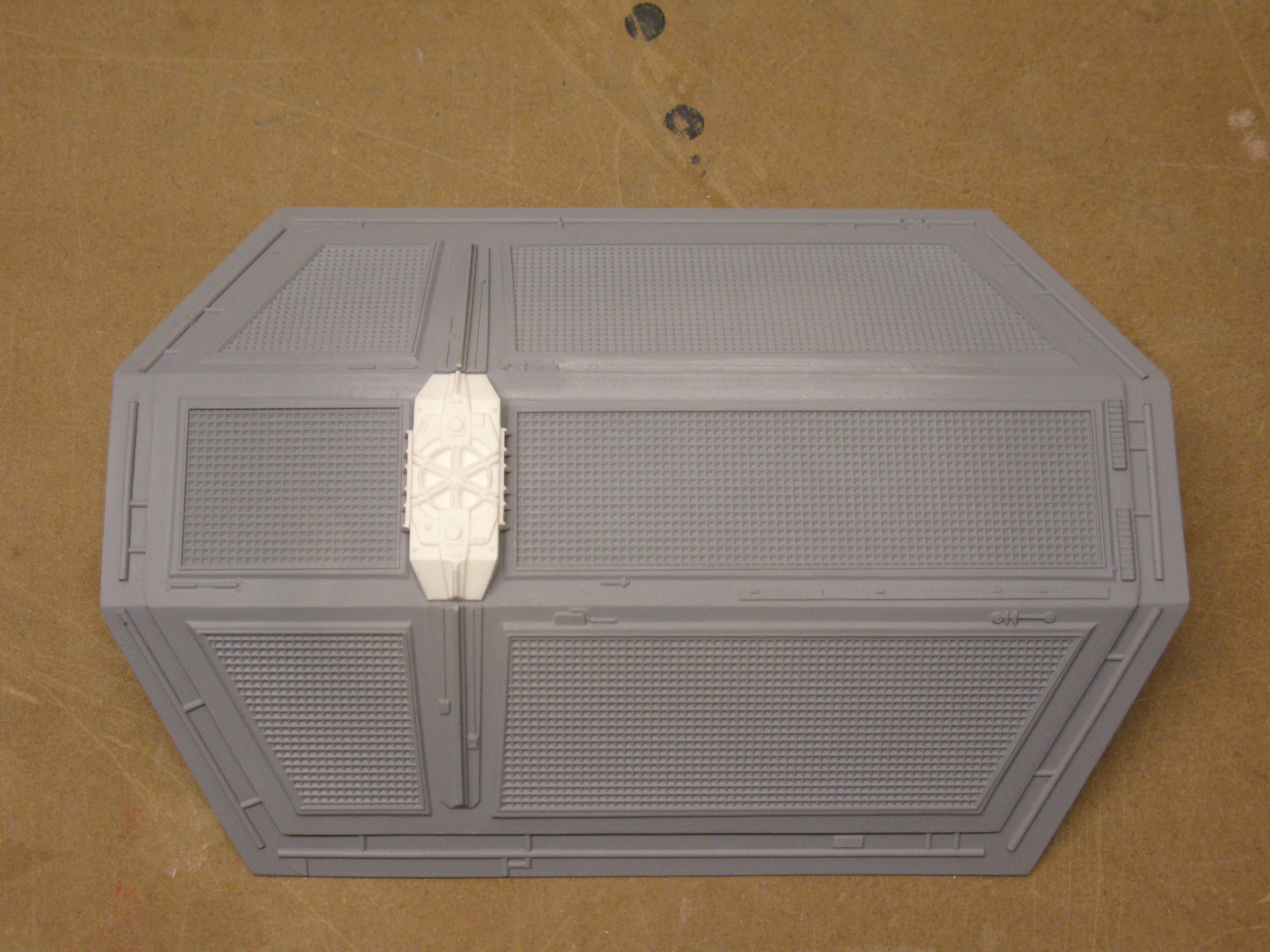

And now on to the wings. Since I was building two Tie Bombers at the same time, I decided to make one wing support (?) and mold and cast four. The blue piece is acrylic as well as the triple stepped center section, which I turned on the lathe.
Finished and ready to mold. I know the bolt heads aren't correct but I couldn't find good enough reference to figure out what really went there.
It was at this point I realized I had put the wing extensions on backwards:cry
Ahh that's better
Done and primed

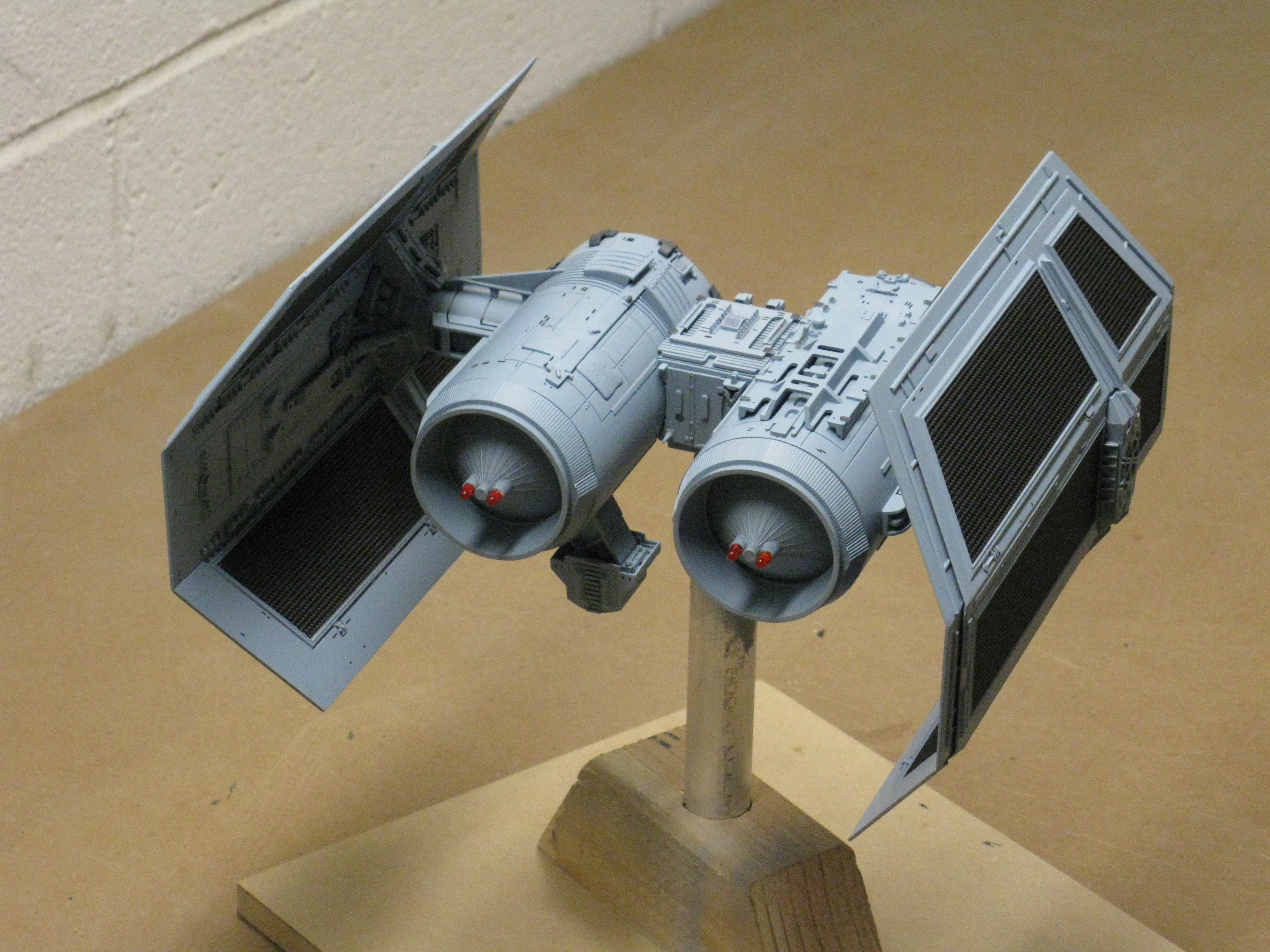

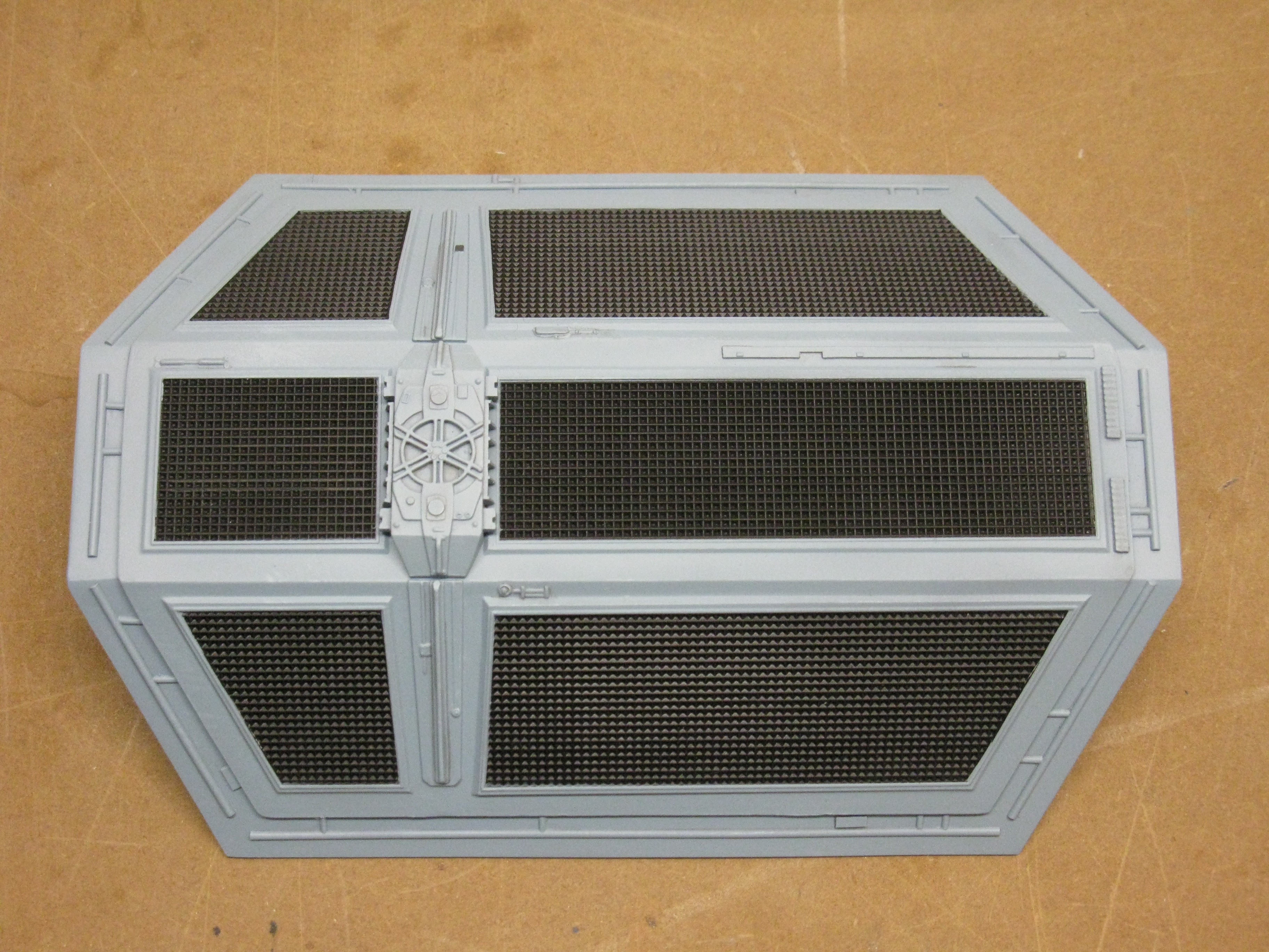

Since I was making a TB with six mounting points, I attached the wing caps with small magnets.

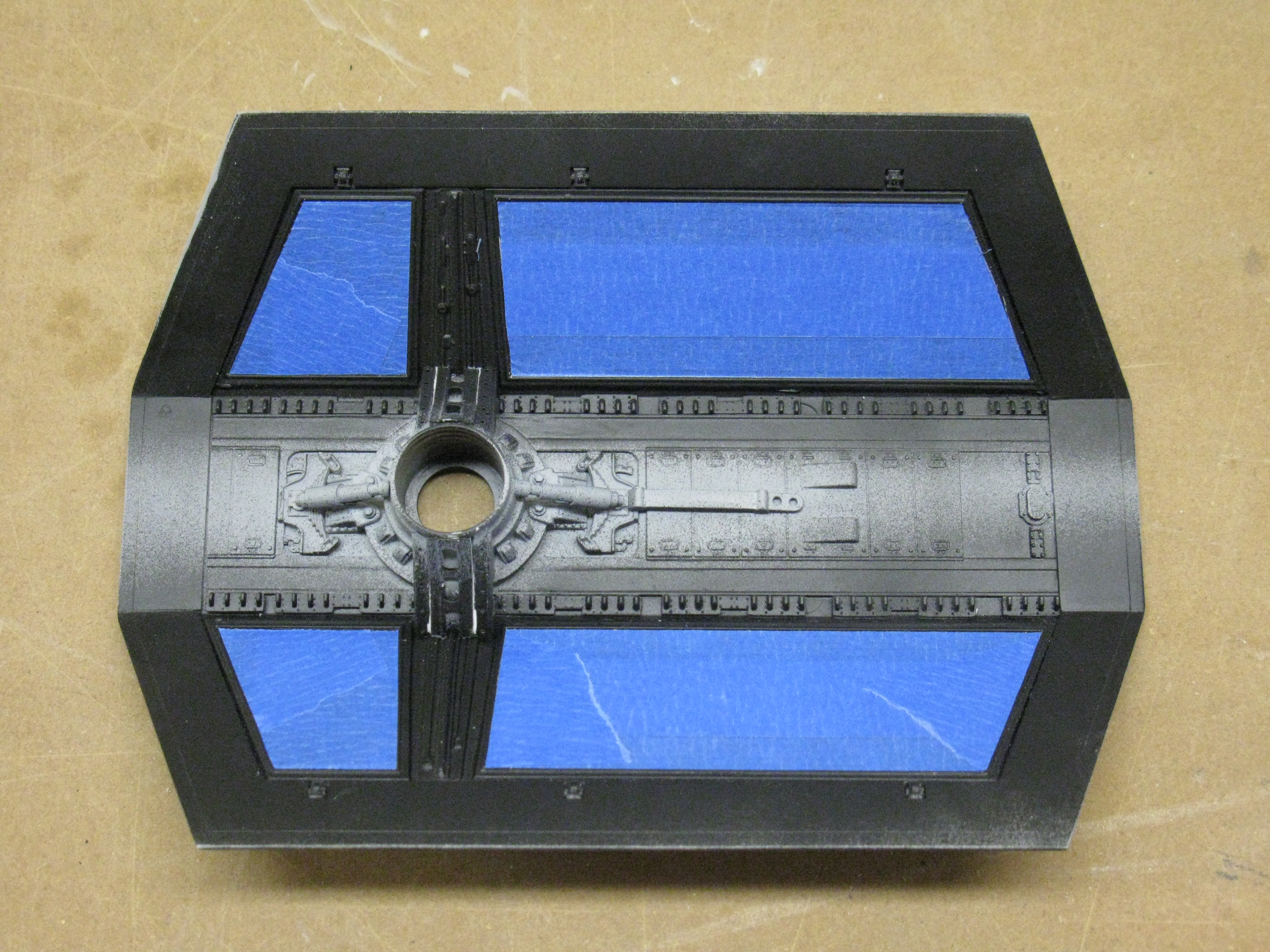

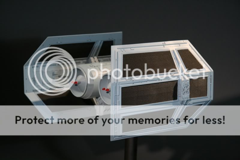

Solar panels painted black and masked

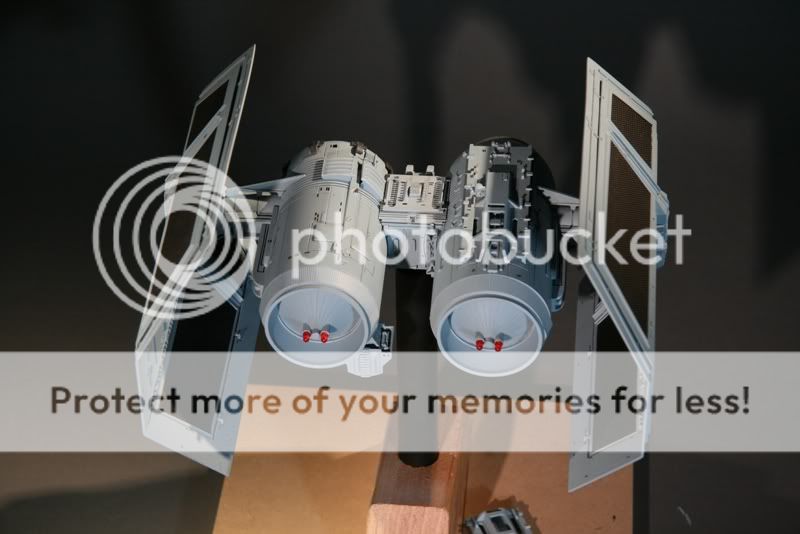

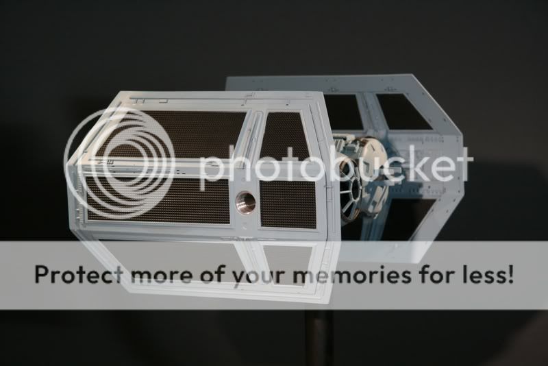

Wings painted and ready for final assembly

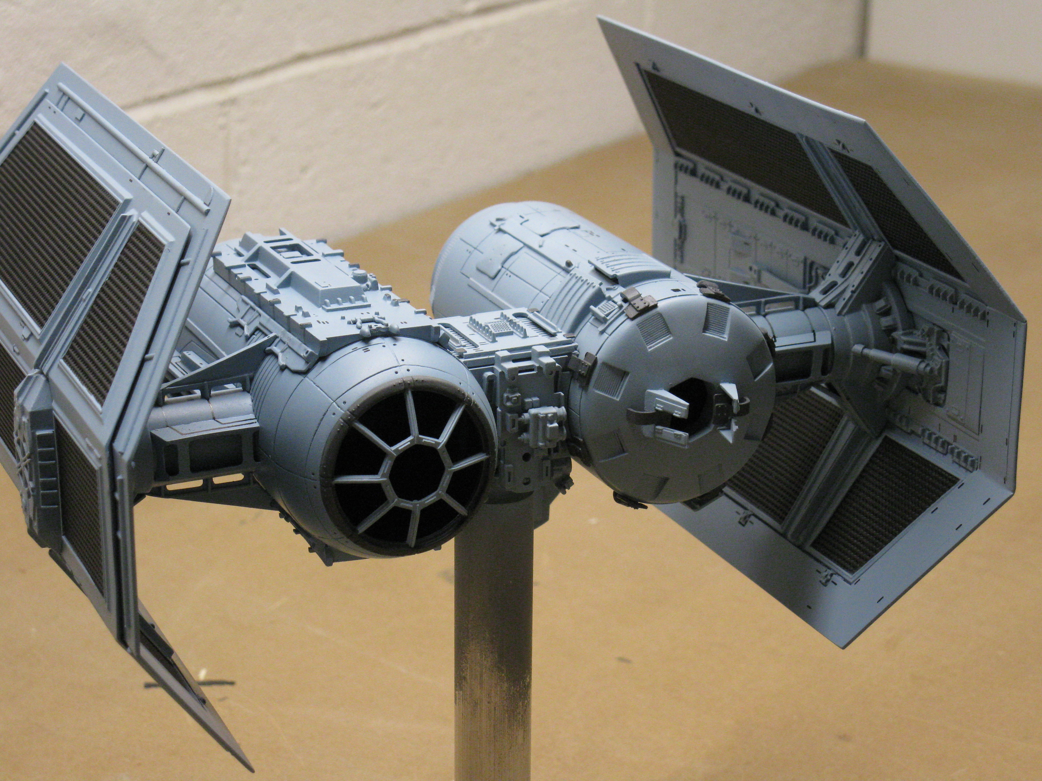

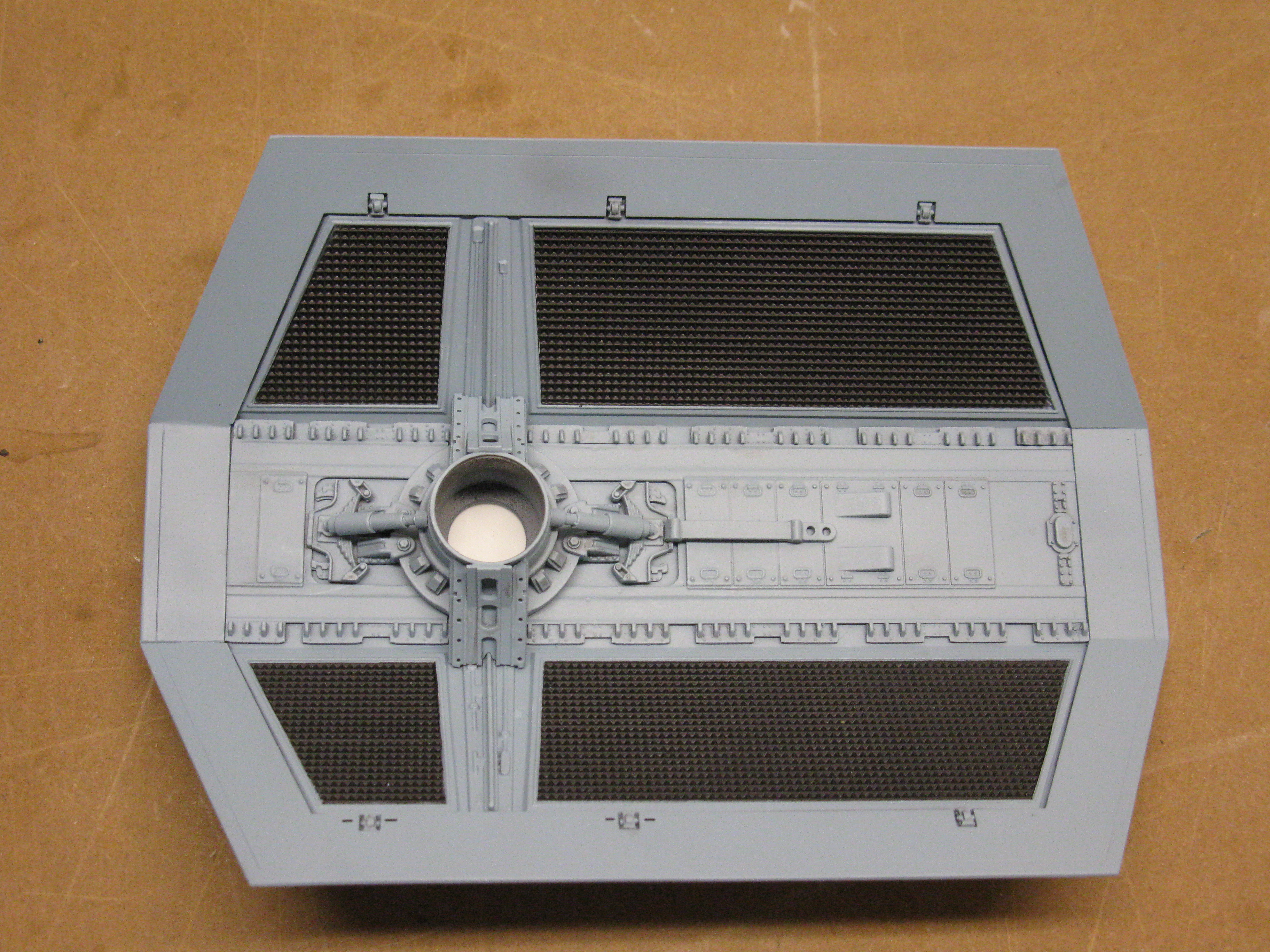

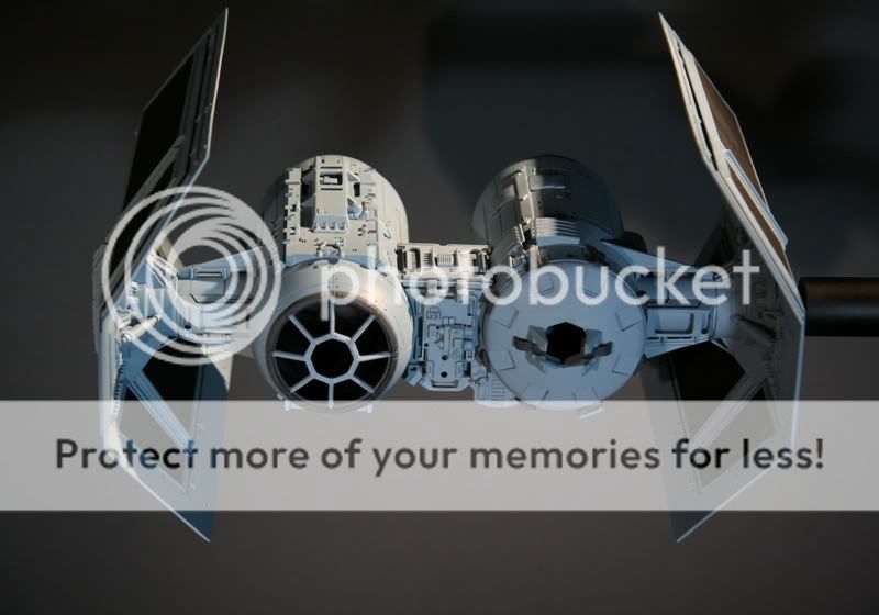

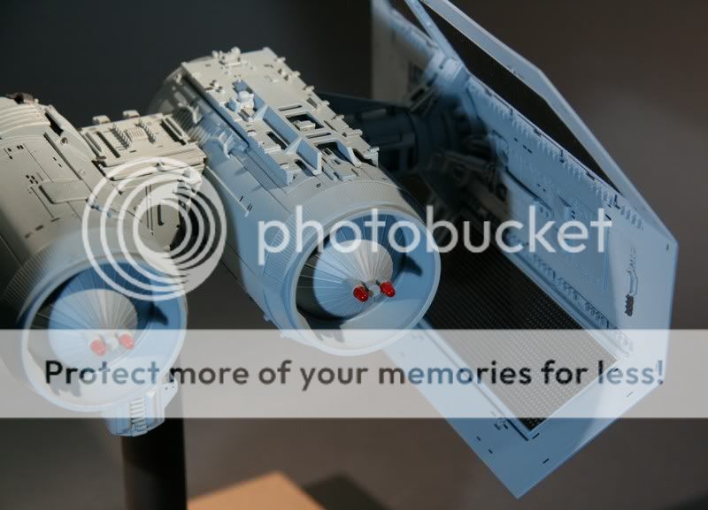

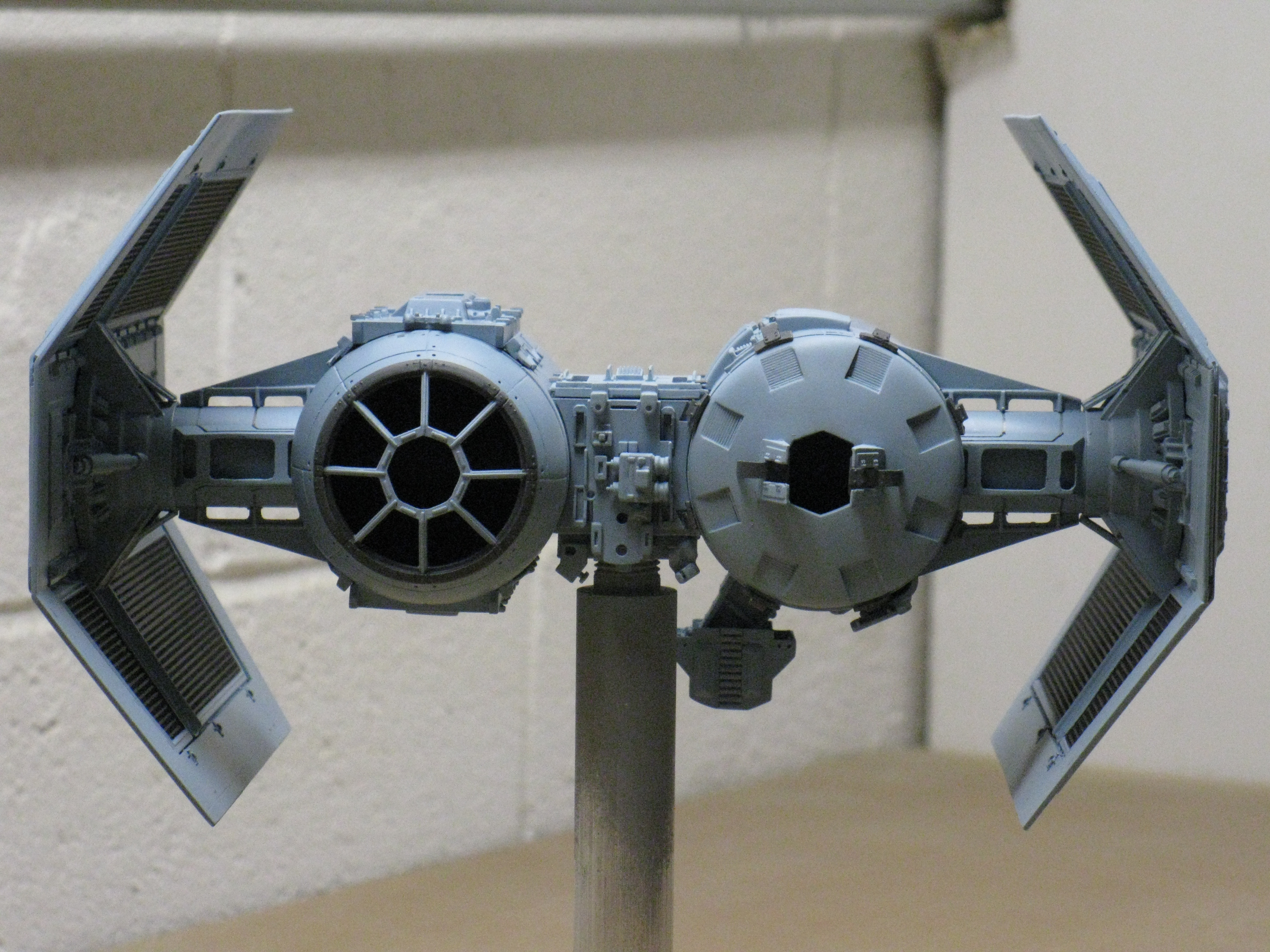

AHH finally DONE.
Thanks for looking
