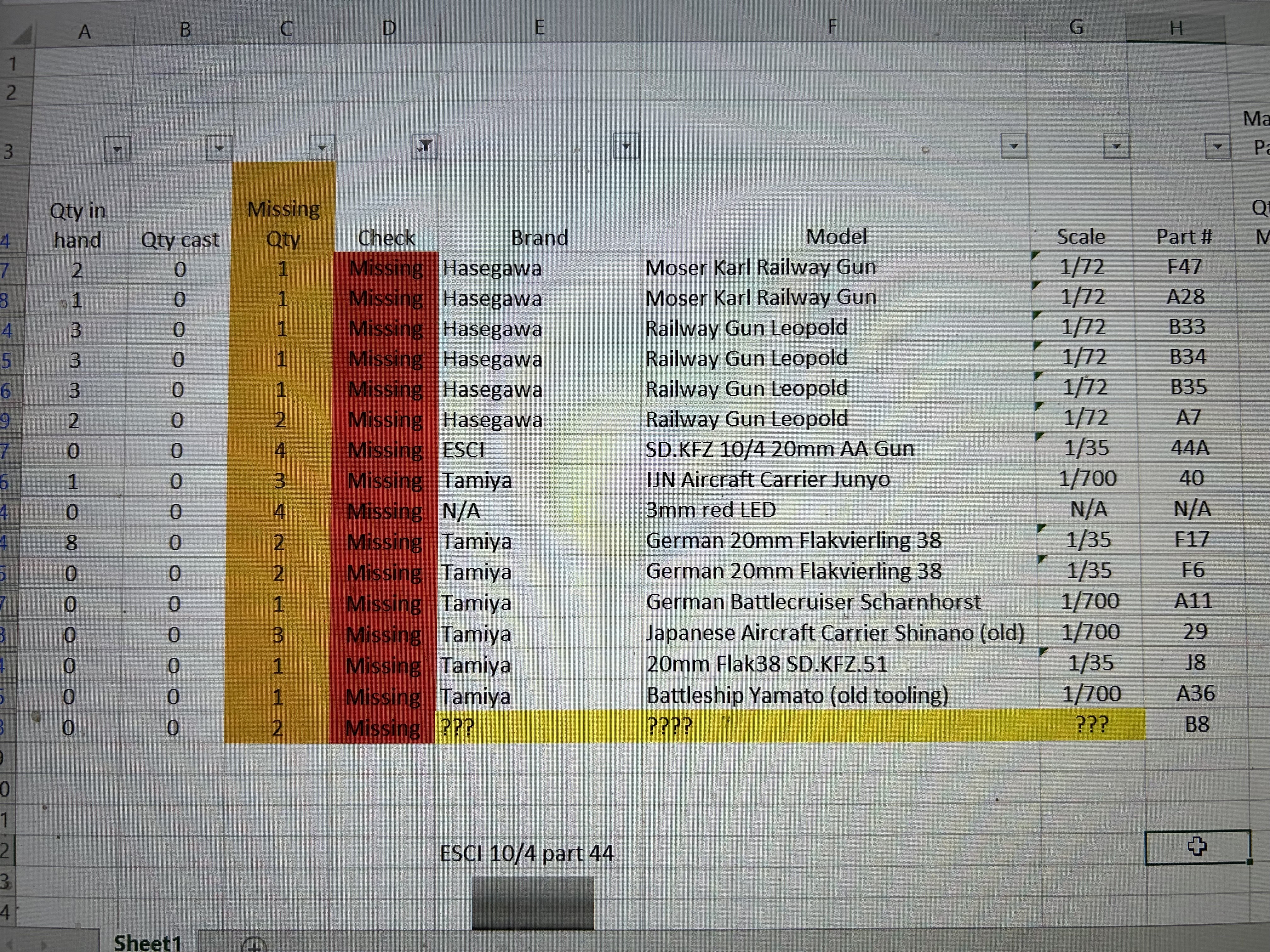

I finished my eye chart of parts that make up this model. The maps are great but not so great for tracking what parts you have in hand and how many of each you need.
So for my own sanity.
A little bigger.
If it is yellow then there is something unsure like part number or qty.
The blank column is to try and accommodate parts that are made from one part. Looks I know the Leopold A7 is cut up all over the place. I have it used 7 places but you may only need 6 parts. Things like that.
Anyways…
Now to go check things off.

I created a very similar-looking list for myself to see what parts I had and what I needed.
For the Plastruct parts, you should get VHD-200VG instead of VHE-200VG. Check out my build and you'll see I started with the VHE and it was just too high on the front of the kit -- didn't look right at all! Got confirmation from a few people that it's actually VHD-200VG, a much shallower dish, which fits the profile correctly:
Also, that Morser Karl A28 part, you only need two of them. They're cut in half to make the bomb chute/dropper, one cut slightly wider than the other, as it's not completely symmetrical.
Just two halves like this:
Good preparation, though! Certainly makes the build go smoother and know you've got everything covered!

That’s how I roll. The Engineer in me states that I cannot proceed until I have a plan…

I have my need list finished.
Anyone know what B8 is on the top of the bomb shoot?
My hit list if anyone is interested. I have other parts to trade if you have any spares of these before I go shopping.

Wow this is in depth, I use excell for kits in hand and kits needed. Then list in anotes section what parts are used. or if some ome donated parts. So I can return the favor.

B8 is off the Mörser Karl. It’s a small box.
Thank you thibkaji for the ID. Add a part to my needed list.

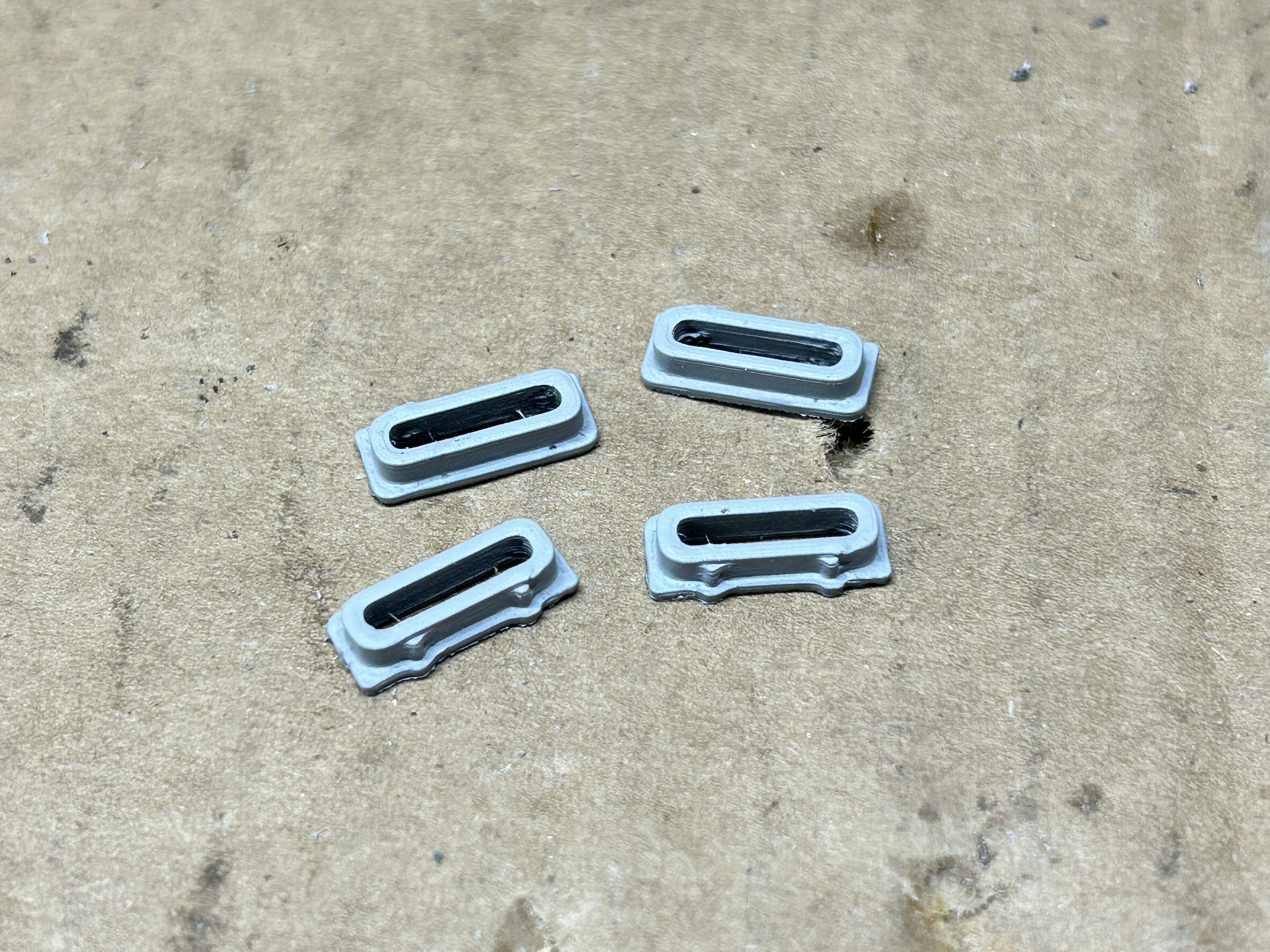

Last bit was me being cheap. I do t have Moser Karl B8 bits for some reason. Let’s make them.
