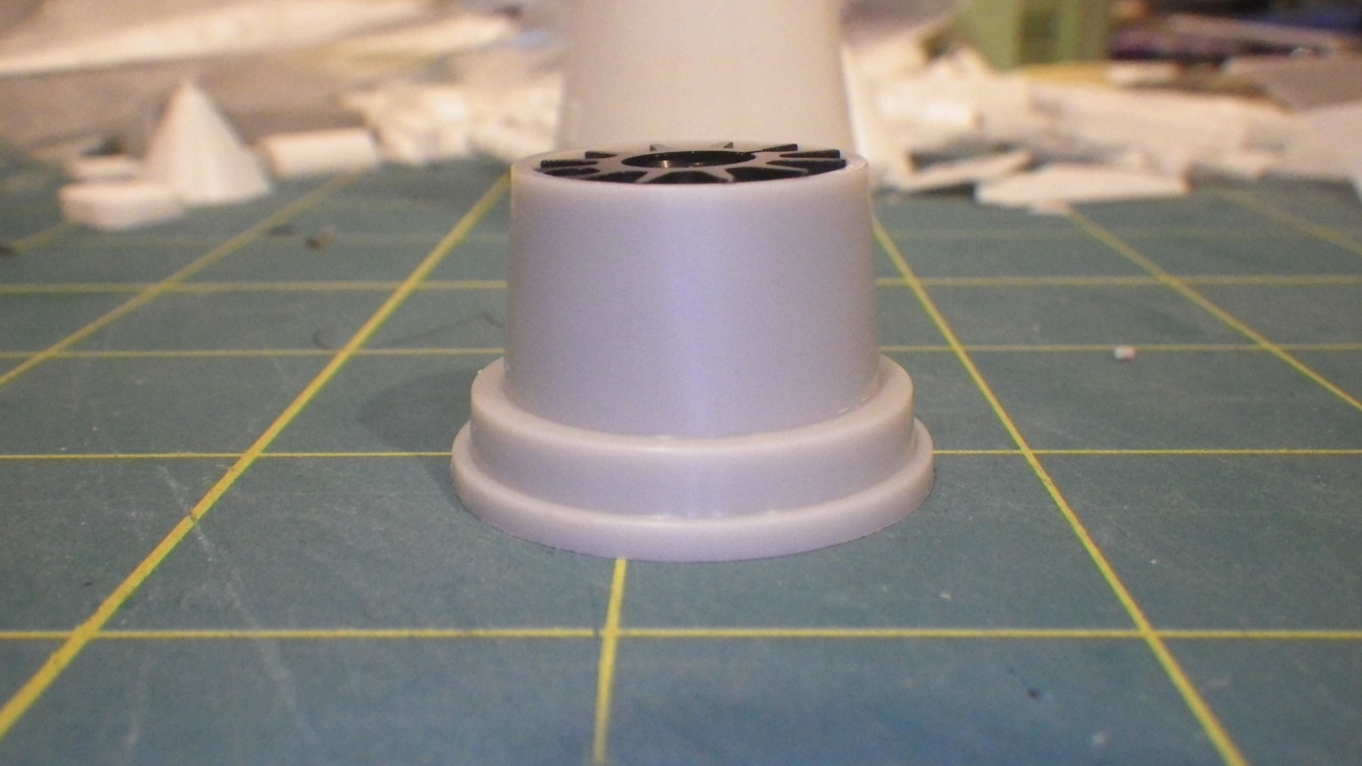

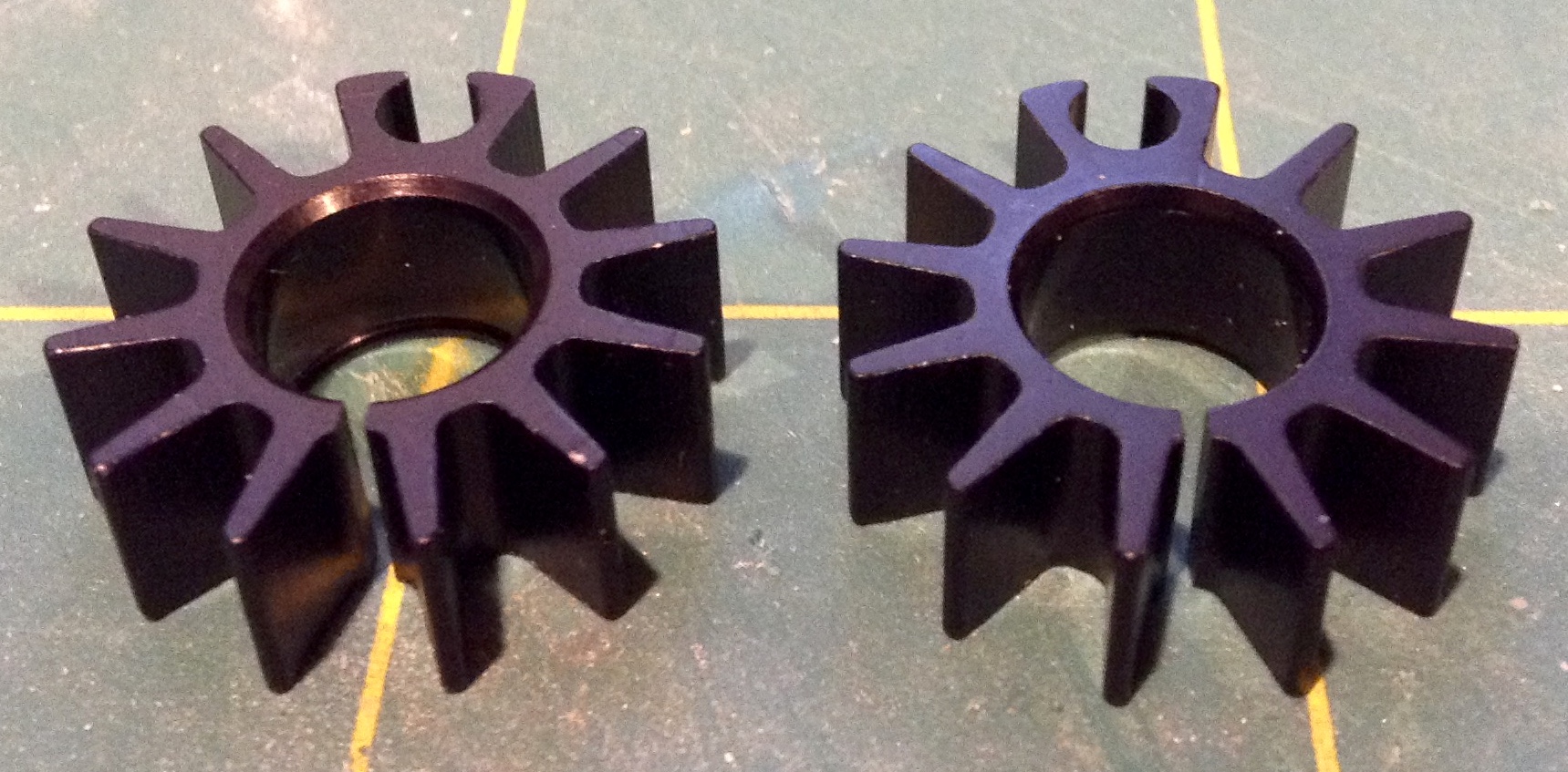

A discovery: The AMT 1/25 Payhauler inner rims fit PERFECTLY around the Aavid Thermalloy heatsinks. Also, some of the heatsinks I received have a chamfered inner circle lip only on one side, not both, so be sure you have that side pointing out -- the eye likes more "candy", or IMG_3326.JPGIMG_3331.jpg complex geometry, not less, all the way around (in art, culture, history, and Y-Wings)
Not sure if that's how they did it in 1975, but that's the way I'm rolling forward with mine. DaveG's 1-1/4 Plastruct Tubing assembly should connect up with this nicely if you're using his method.
Re: Y-Wing Parts Map for the "Green Leader" Project
A discovery: The AMT 1/25 Payhauler inner rims fit PERFECTLY around the Aavid Thermalloy heatsinks. Also, some of the heatsinks I received have a chamfered inner circle lip only on one side, not both, so be sure you have that side pointing out -- the eye likes more "candy", orView attachment 663329View attachment 663330 complex geometry, not less, all the way around (in art, culture, history, and Y-Wings)
Thanks for that, can you put a calliper on them and tell us the external diameter size, looks like 10mm if you can confirm , thank you

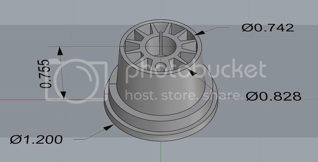

Not to jump in on SK but he sent me the PayHauler rims to mold and just last night I had 3D modeled the part. Here's a screen shot with some dimensions. Sorry, they're in inches. Long live the empire!

thanks Dave, I was talking about the heat sink, if they are a tight fit to the rim, what thickness is the rim , that will give me what I'm after.

I've updated the screen shot with the ID of the rim. The heatsink is nominally .750" in diameter so it friction holds it in place, but only just barely. The rim is tapered so it's only in contact with the heatsink at the outermost edge.

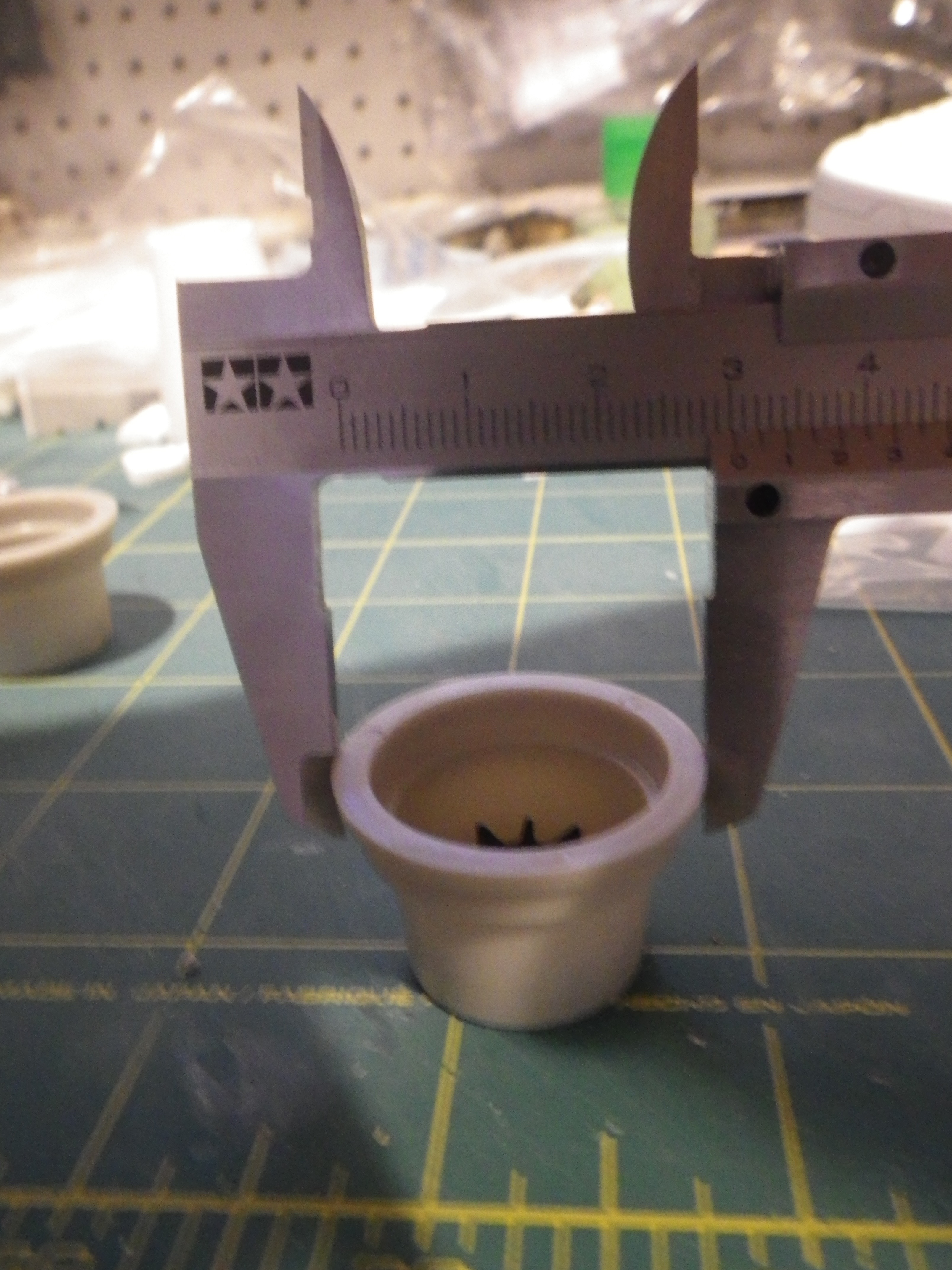

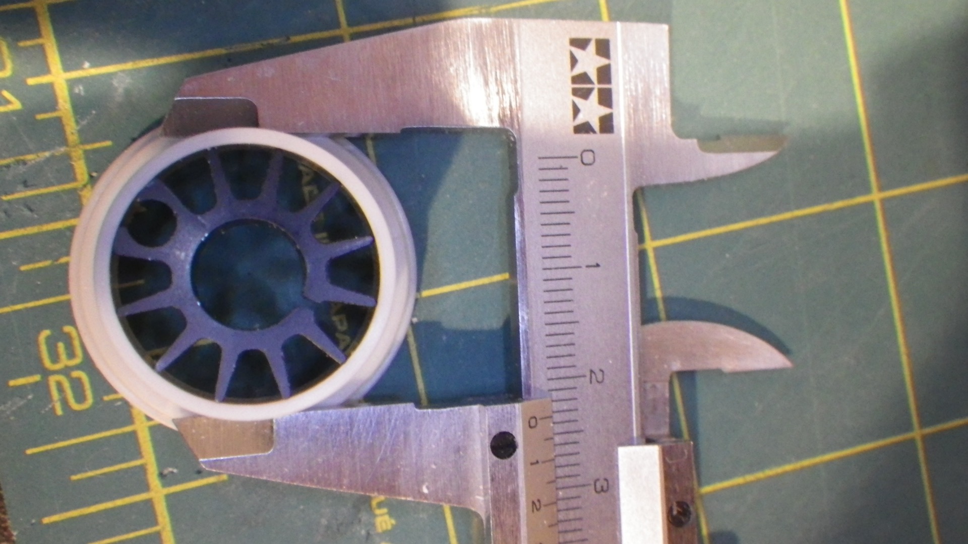

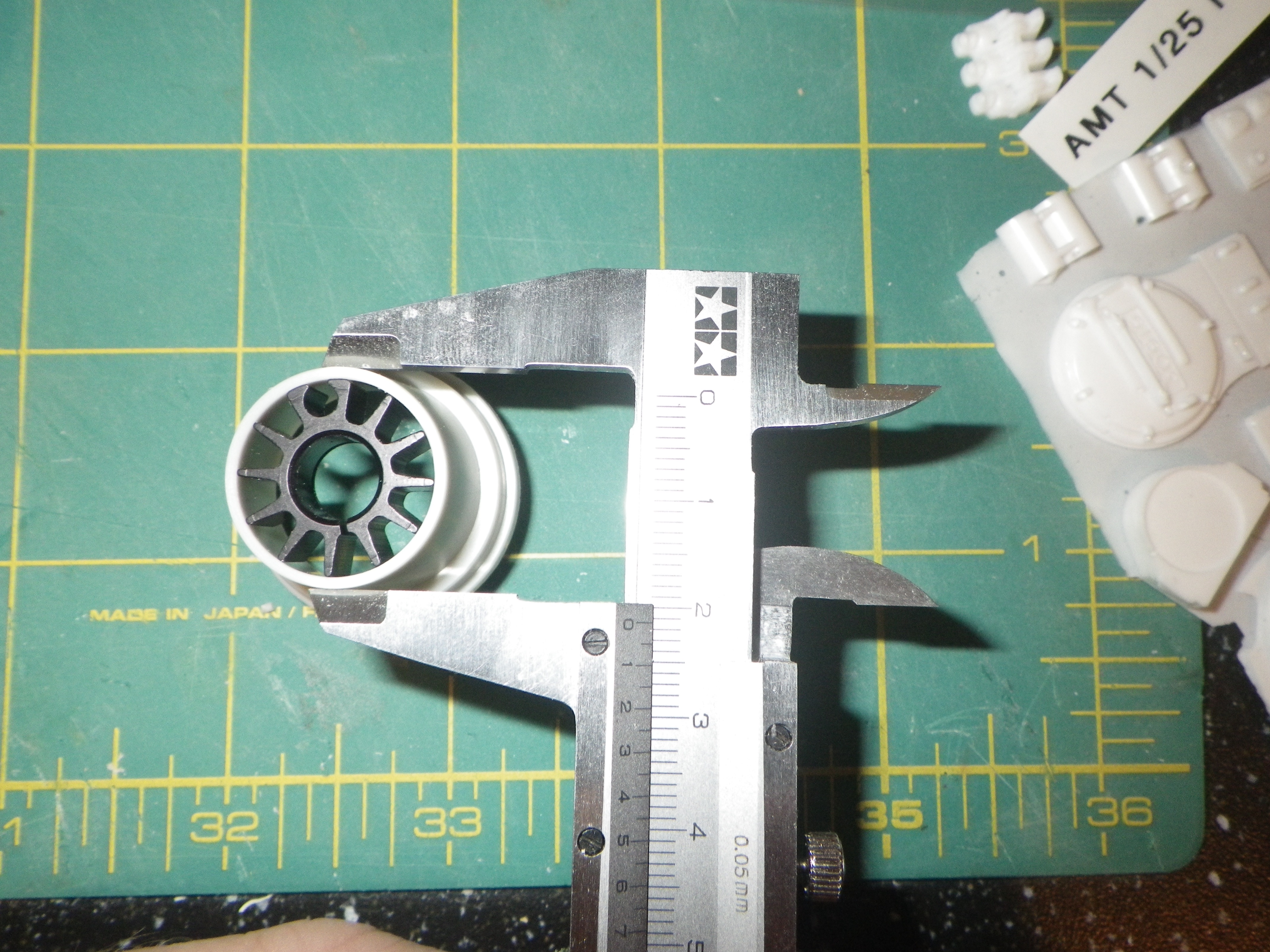

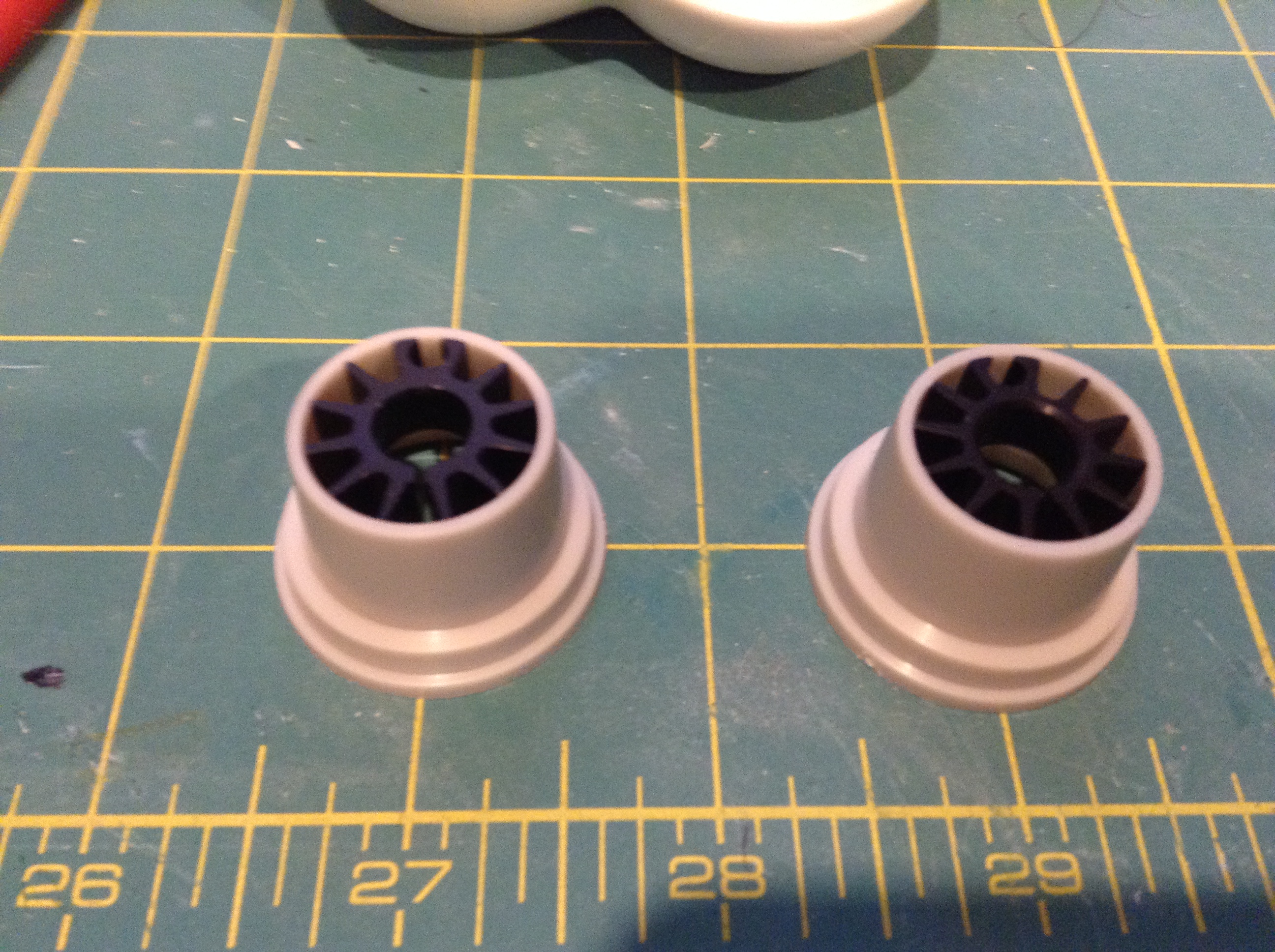

Here are some pictures with the Tamiya cm/mm calipers on them. The lower base of the rim is 2.8cm on the outer edge. The lower rim is just shy of 2.2cm, and then it tapers off as it goes up to just under 2cm. It isn't totally obvious to the naked eye, but the rim rises in a conical shape that gets thinner as it goes up. So Dave G's comment is exactly right: the heatsink only touches the rim on the very upper lip, and you'll probably need a bit of glue to keep things in place permanently.
Thanks for that, is this the same diameter heat sink that are used on the y-wing ?

These are Aavid Thermaloy (manufacturer) heatsinks, available from Digi-Key for rear-engine exhausts, item no. HS101-ND. These are, as far as I know, the "official" Y-Wing Studio Scale heatsinks.

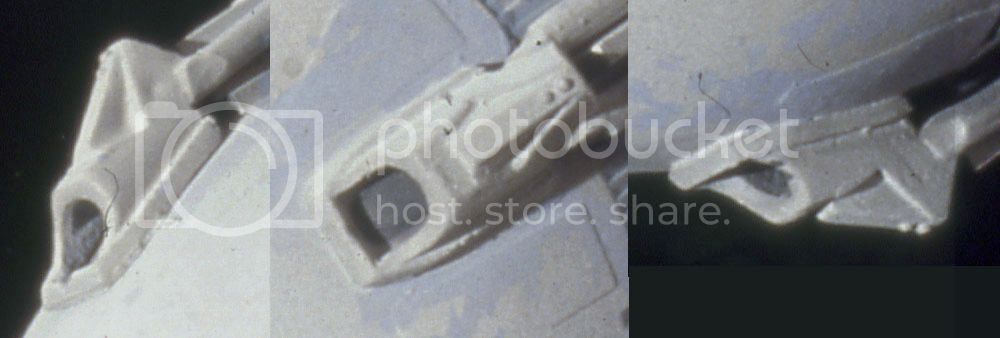

The more I look at the "clips" on the engine nose cones the more convinced I am that they are a hybrid of two kits parts, not just a scratch modification to the Kettingad hook. Aside from the two little rivet bumps, if you look at the image on the left you'll see what appears to be an indentation consistent with what happens sometimes in less well made kits. Does anyone have any clues as to what the little triangular section may have come from?
I don't know where that triangular part might be, but I think AMT truck kit when I look at it with the dent in the side. I've seen many of their kits with that dimple defect.
By the way, if anyone can make this part in 3D (or the whole assembly) like the actual kit parts, I'd be interested in them. This is one of the more difficult to mold pieces left on the Y. And I'm not sure if my skills are up to making a mold for it.

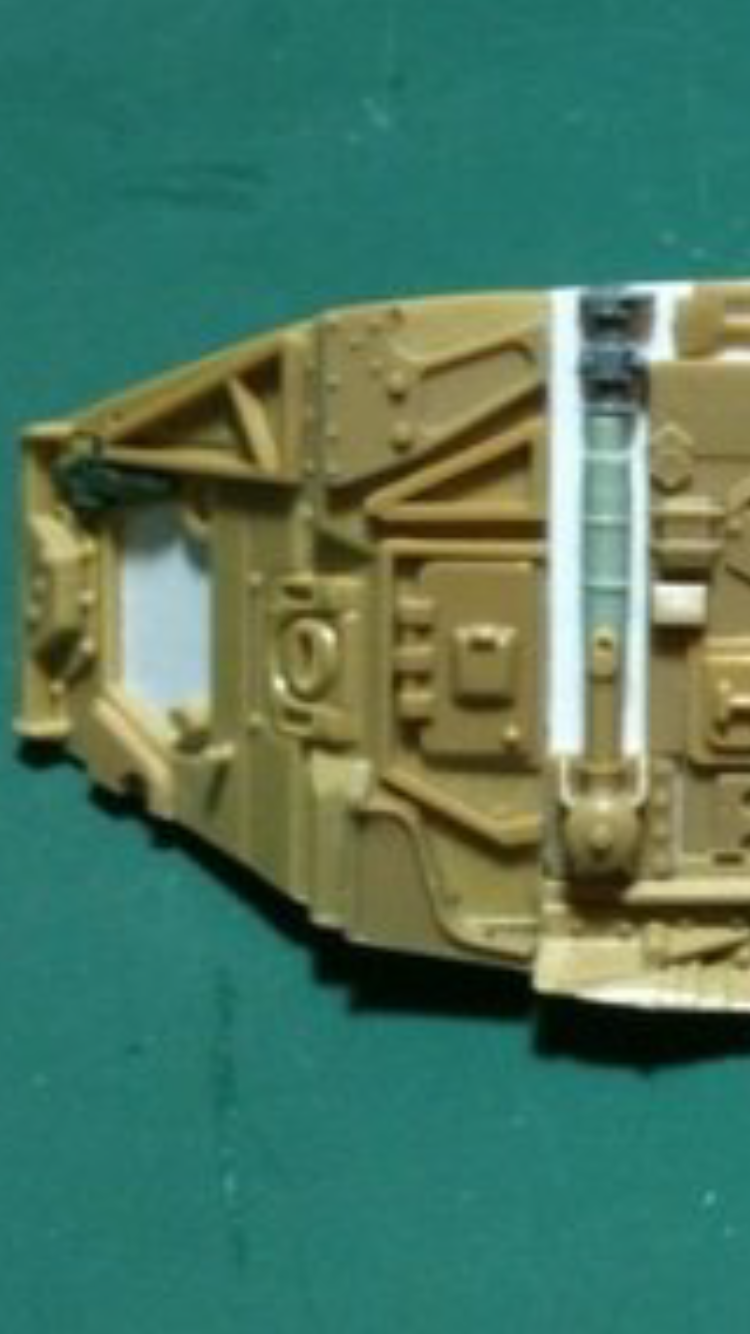

Can anyone here please help with an id. This is on the Back plate of the forward fuselage.
Many thanks.
