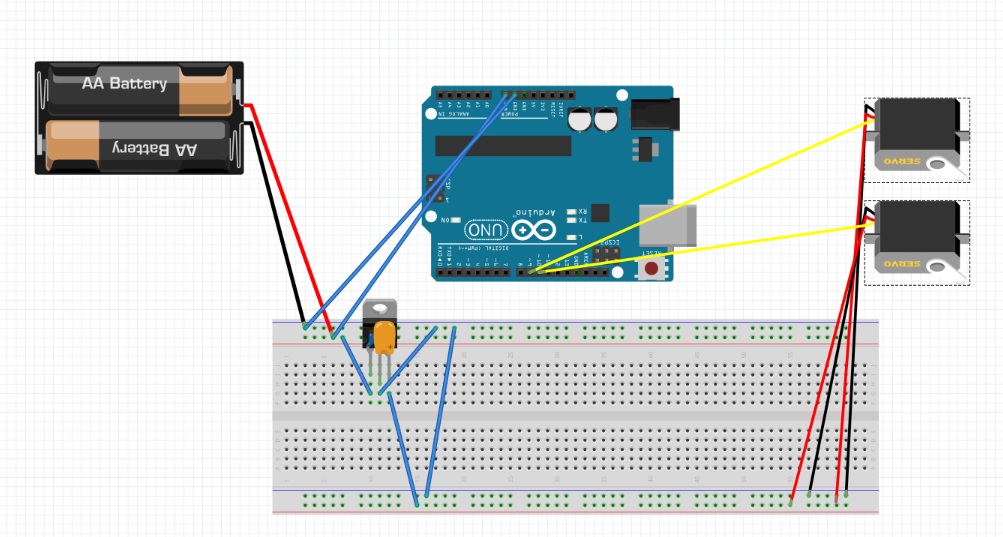

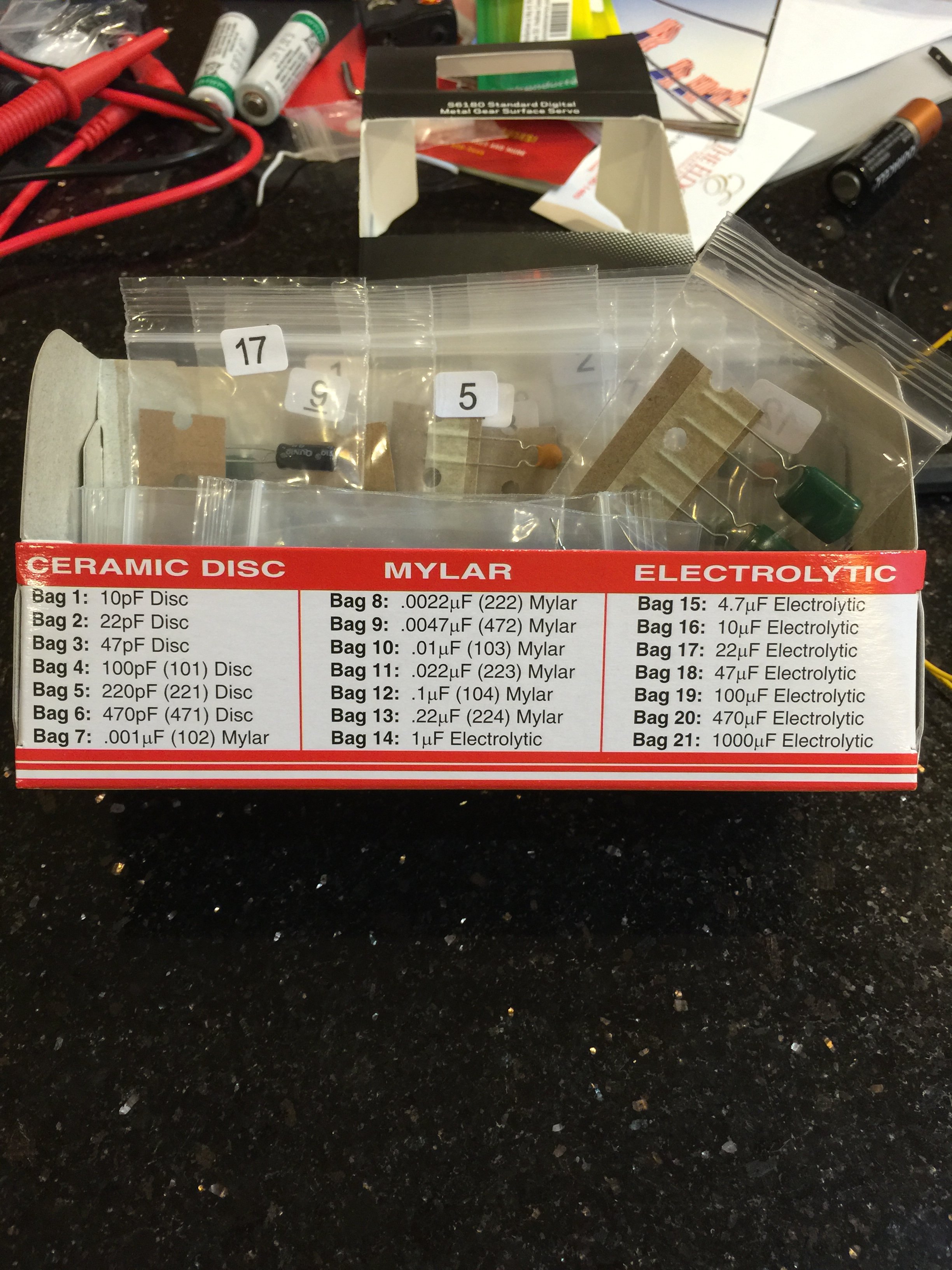

I'm trying to use the exact setting as your diagram. Since I don't have 0.33uf cap, is there a alternative way for the caps? This is what I have:
I want to see if the result is different than my 5v regulator module.

For the cap, they are not polarized cap. The 0.33 uf cap that I find is Ceramic capacitor (The first on the list below). The 0.1 uf cap is either Silver Mica Capacitor or Polyester Film Capacitor (4th or 6th on the list below).
http://www.vbotix.com/capacitors/
