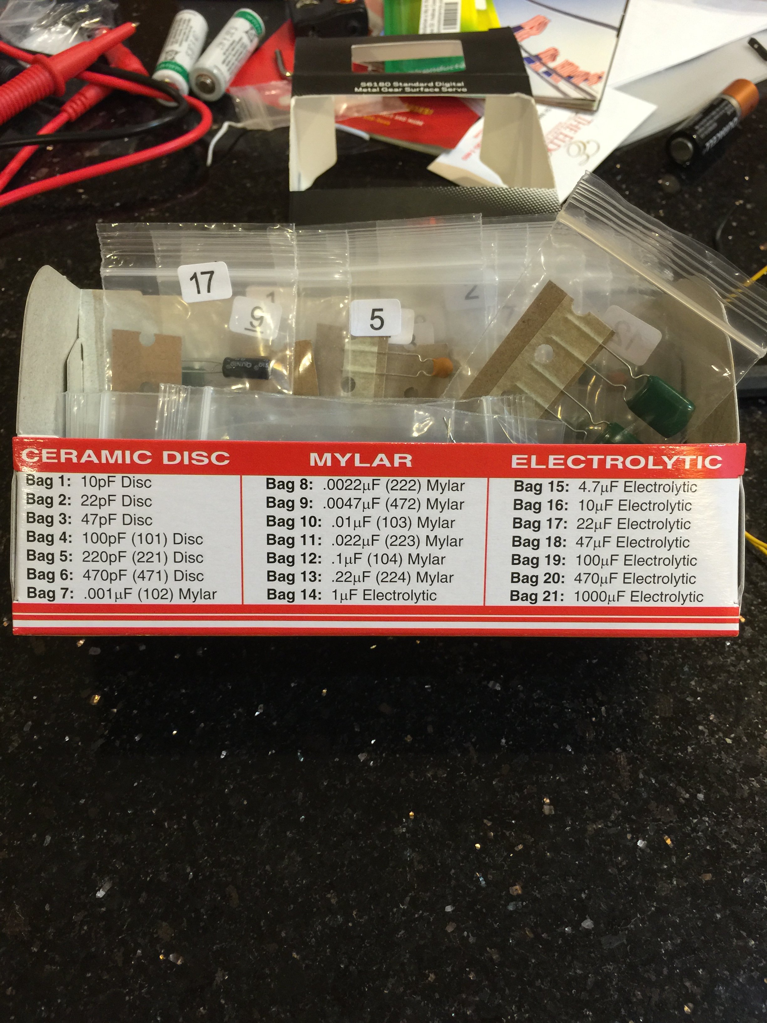

I have a problem here. I was trying to do as exact as what you did on your diagram. However, here is what I get for the caps:
as you can see there is 0.1uf but no 0.33uf. Is there an alternative way of doing it with what I have?

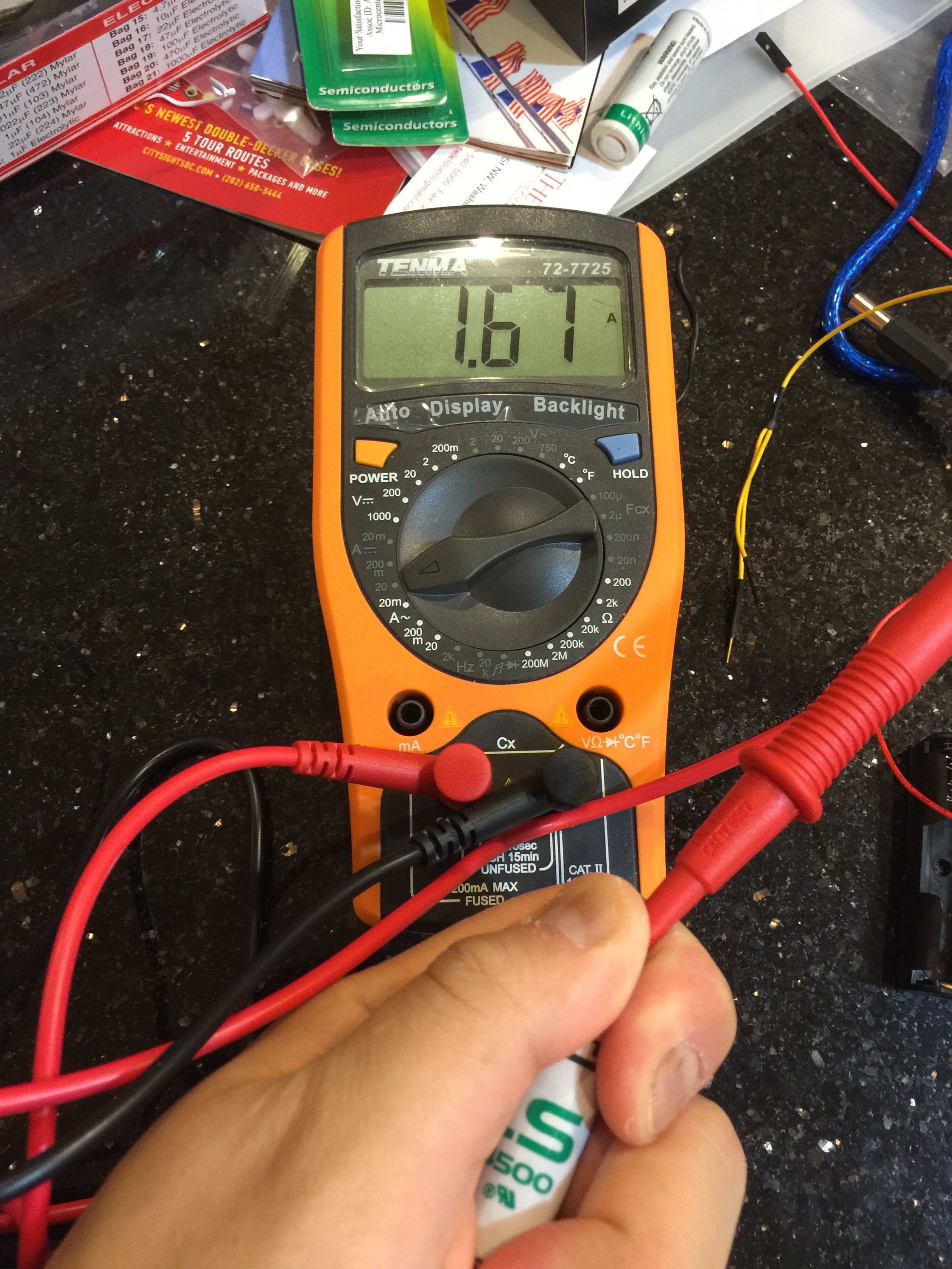

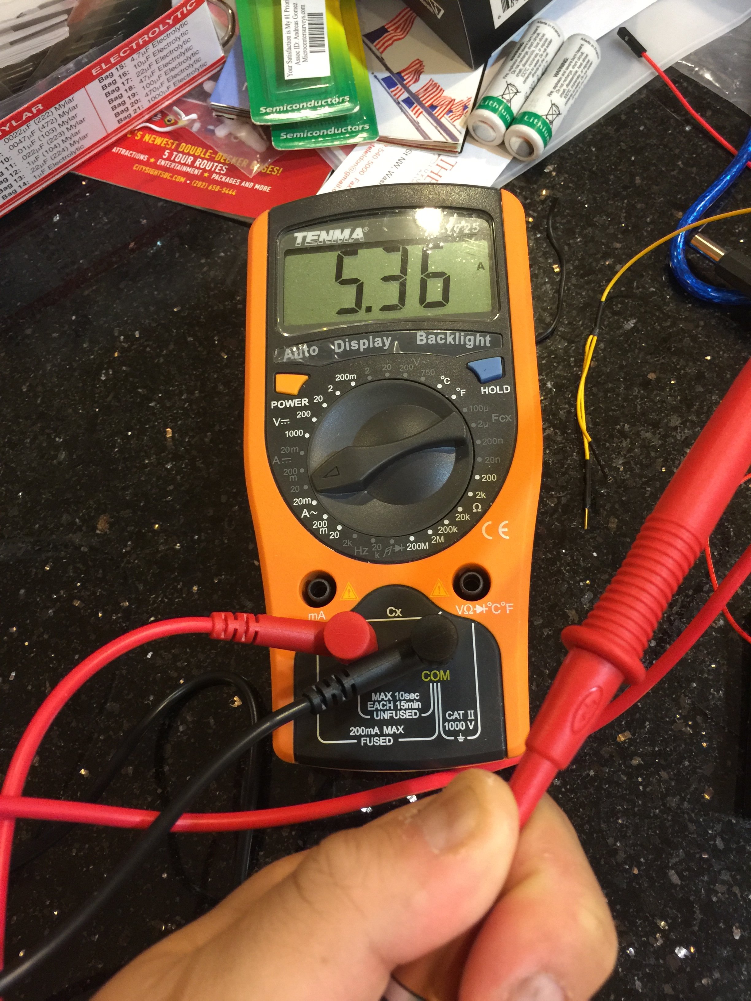

I did some measurement for the battery here is what I got:
AA battery, voltage is 1.5v. However, when I change to DC(A - with ... under the dash) section at 20. it shows the following:
as you can see it showing 5.36 A. Is that means this AA battery contain 5,360 mah?
I also did a test on the 14500
It shows only 1.67 A
My original goal is to test what's their mah looks like. Is there anything wrong with my setting when I measure the battery? Or this is the correct number?
