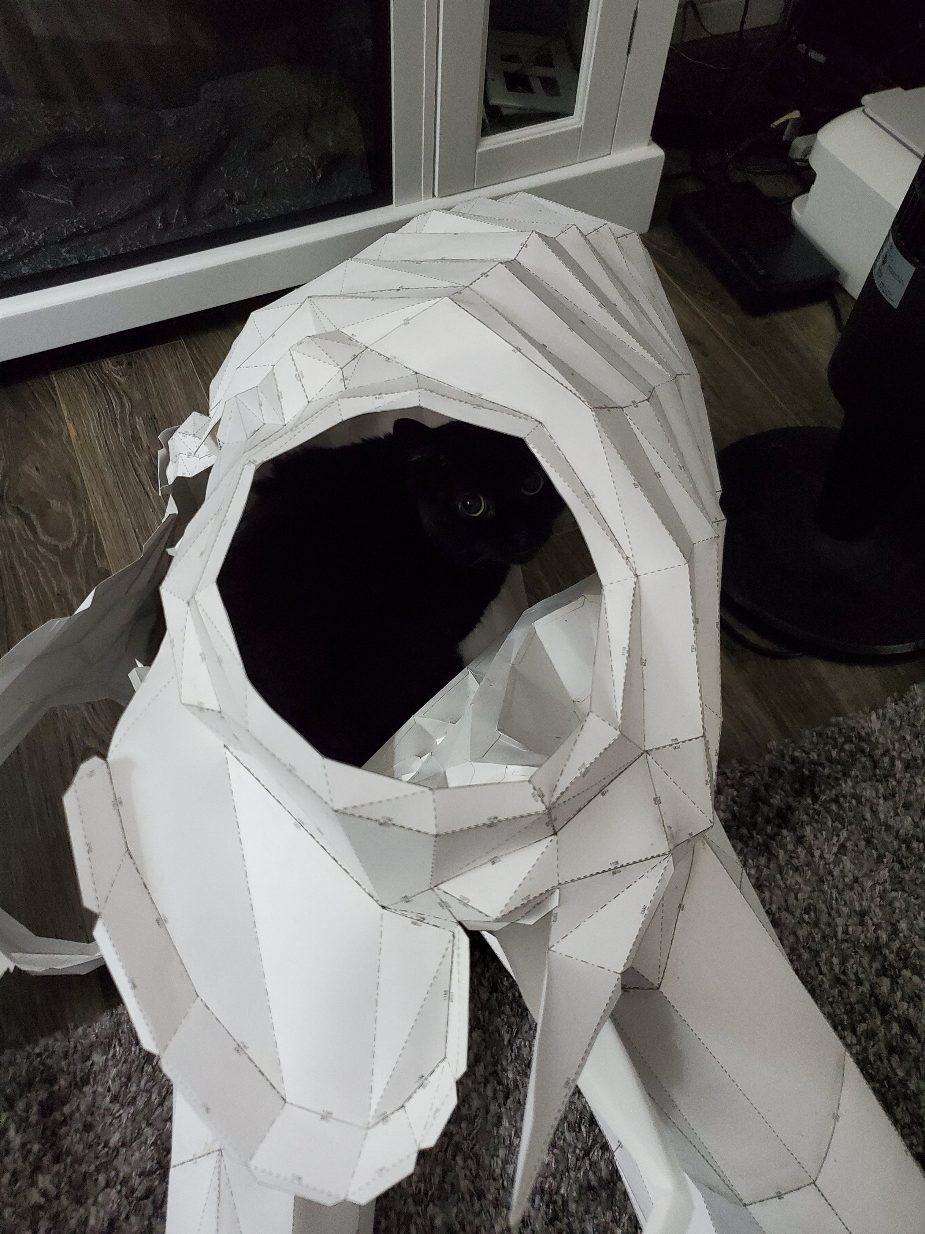

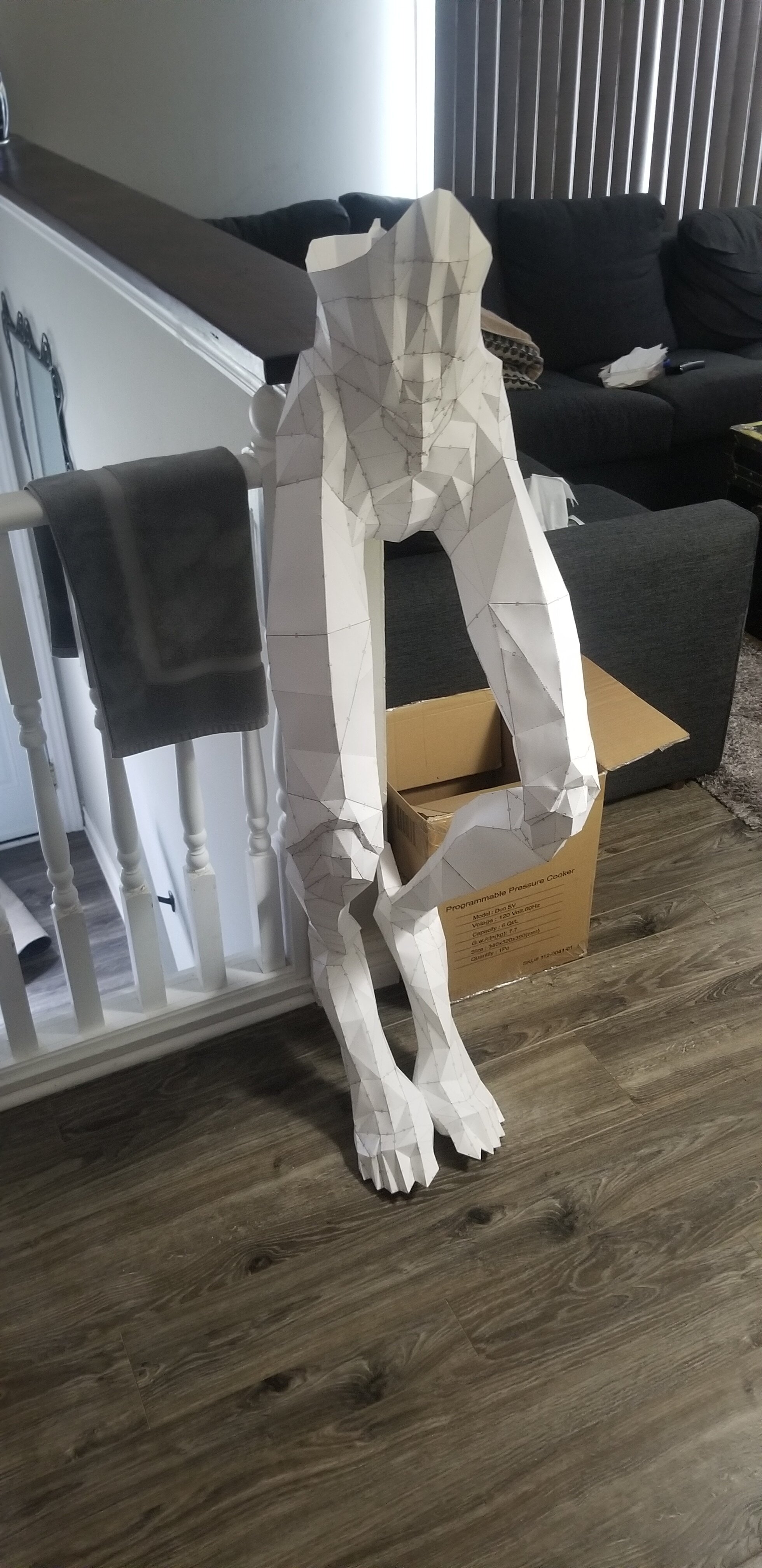

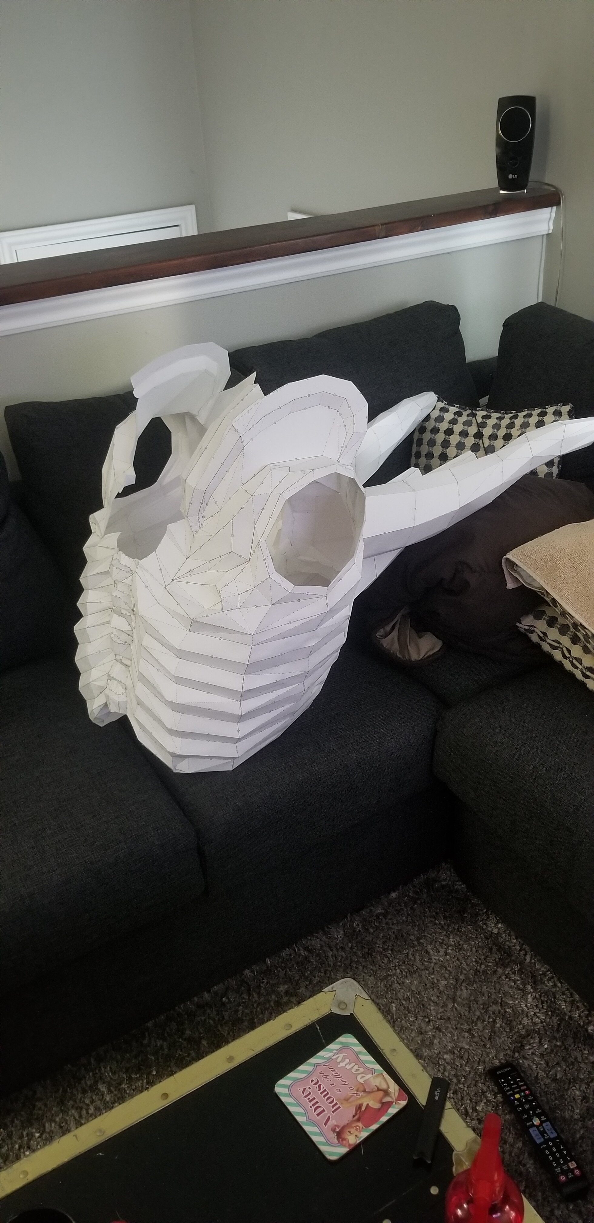

New to the forum, and need some advice on a build I am working on. Making an xenomorph that stands about 8 feet tall. Working on a pvc skeleton to insert. I'm using pep files and cardstock to make it. I would like to display it but am puzzled as to how to support the inside of the creature? Can I resin exterior then use expanding foam around the pvc skeleton? Should I cut in half and fiberglass the inside? Any ideas?
brent1336
Two of the pieces so far... head is put away so cat doesnt destroy it trying to hide inside.

I've fiberglass many projects before, my concern was the torso and arms, being enclosed and unsure what to do to support the inside of them, as I cant get in there to fiberglass. I think I have decided to resin the exterior to a point where foam can be added inside with a pvc skeleton to connect the limbs. Will update with progress if the weather ever cooperates to get the resin done. Thank you all for your advice.
