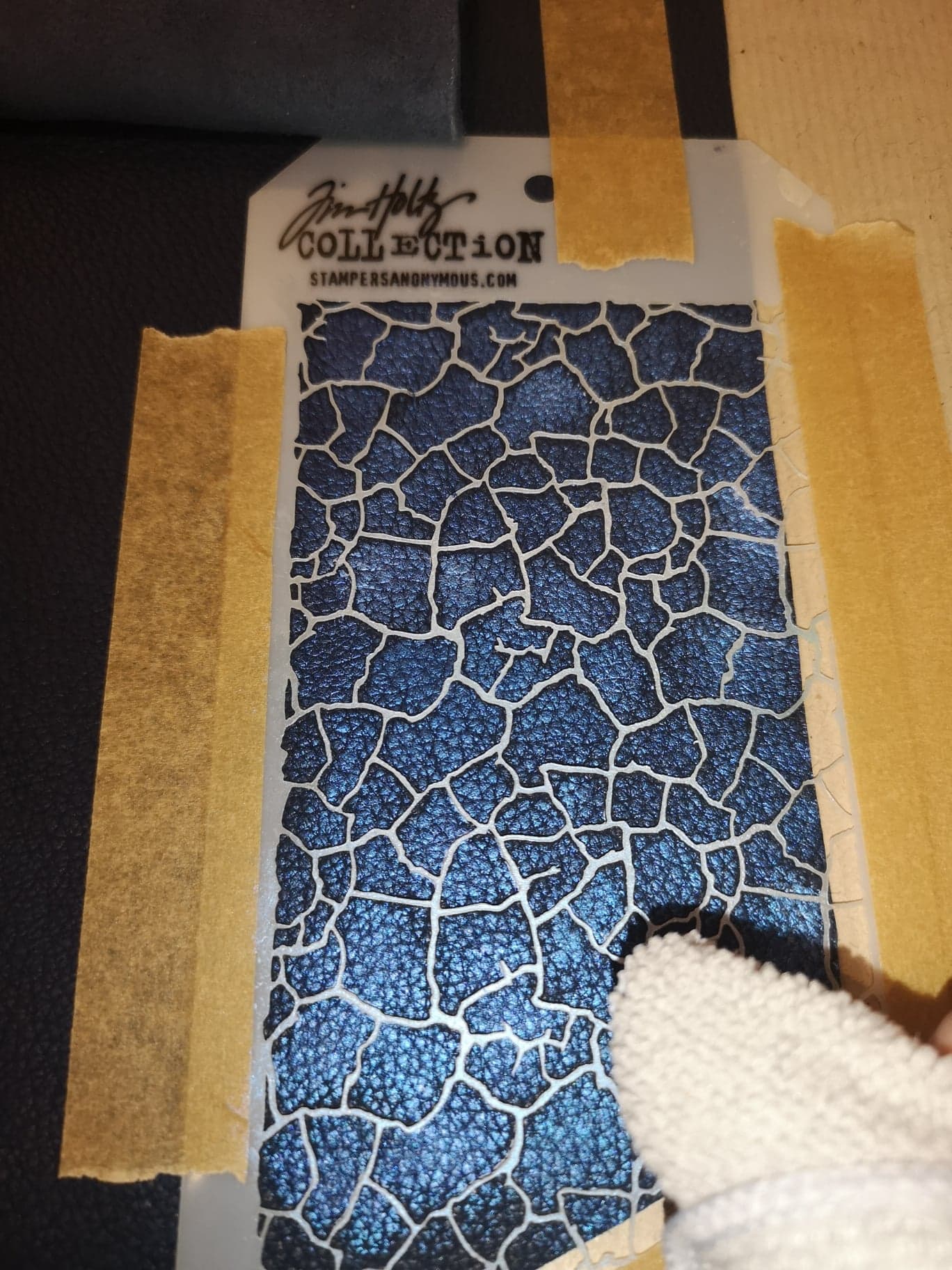

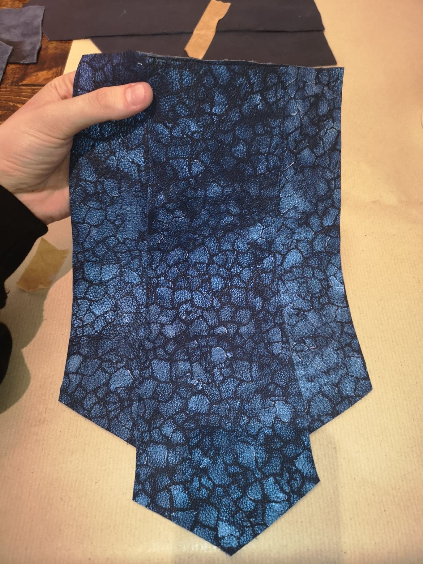

Starting with the skirt! I found a really nice navy leather (got the whole hide for £60!!! a steal) and got to work. To get the crackle texture her skirt has, I stencilled over a iridescent blue paint from Daler Rowney, and I glued the skirt pieces together with pva wood glue. I'll be weathering and adding the gold details and battle damage soon!

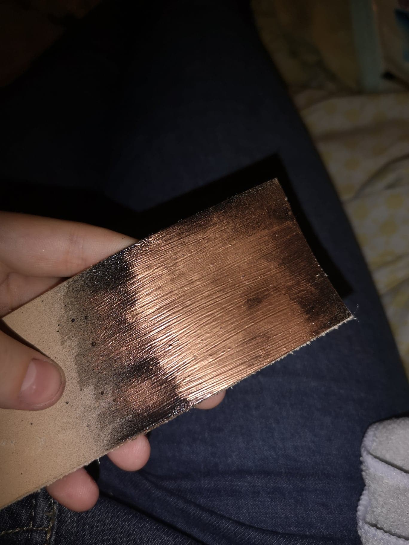

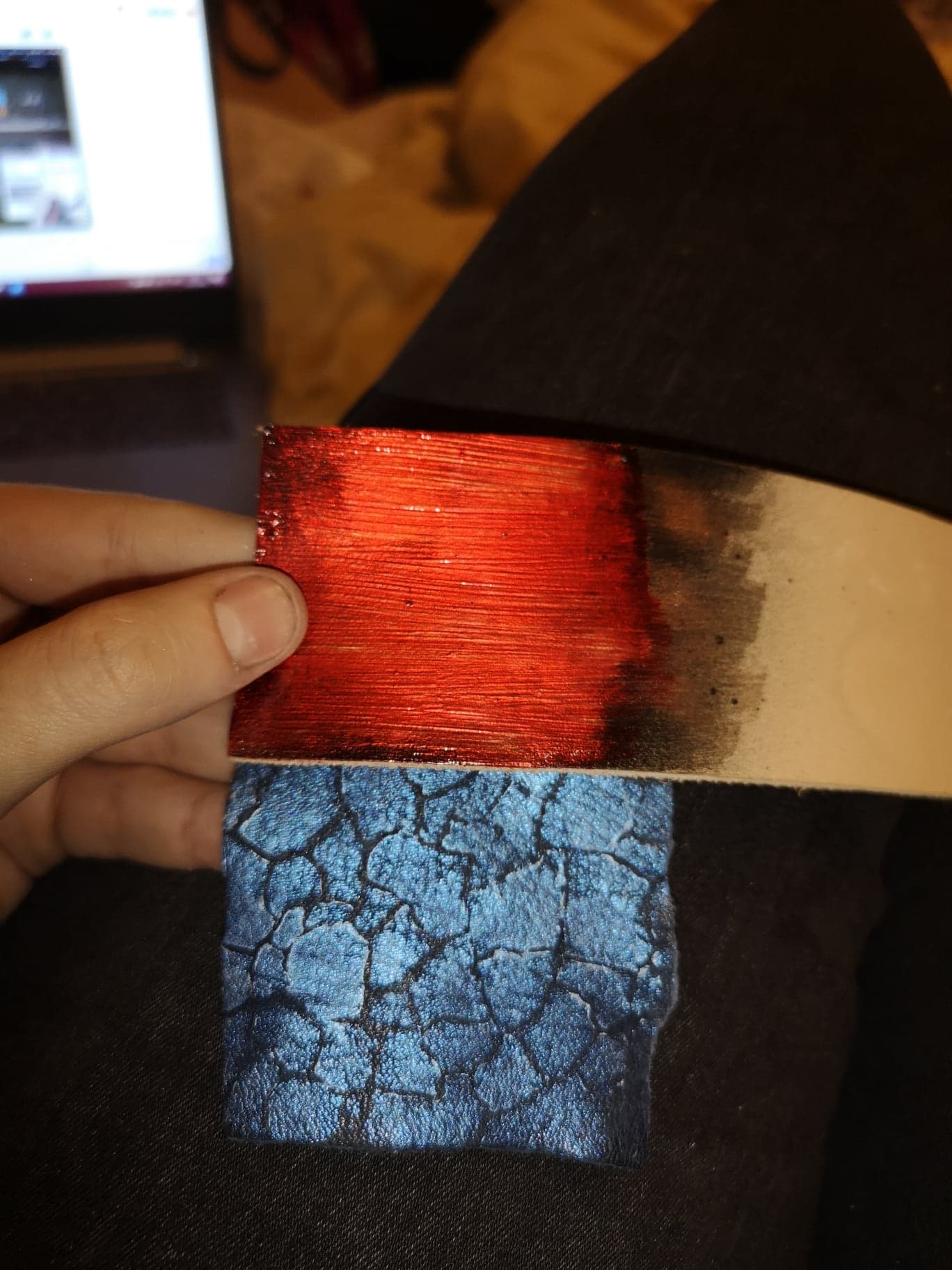

Next is testing the red paint job for the armour! I was never happy with how HARD it is to get a true metallic red paint job, until i stumbled across Arboreal Key's method! Primed surface with wood glue (deliberately leaving brush strokes as Wondy's armour has), glossy black paint, copper gilding wax, then finally Tamiya Clear Red paint! I'm so happy with the finish its perfect! Super shiny~

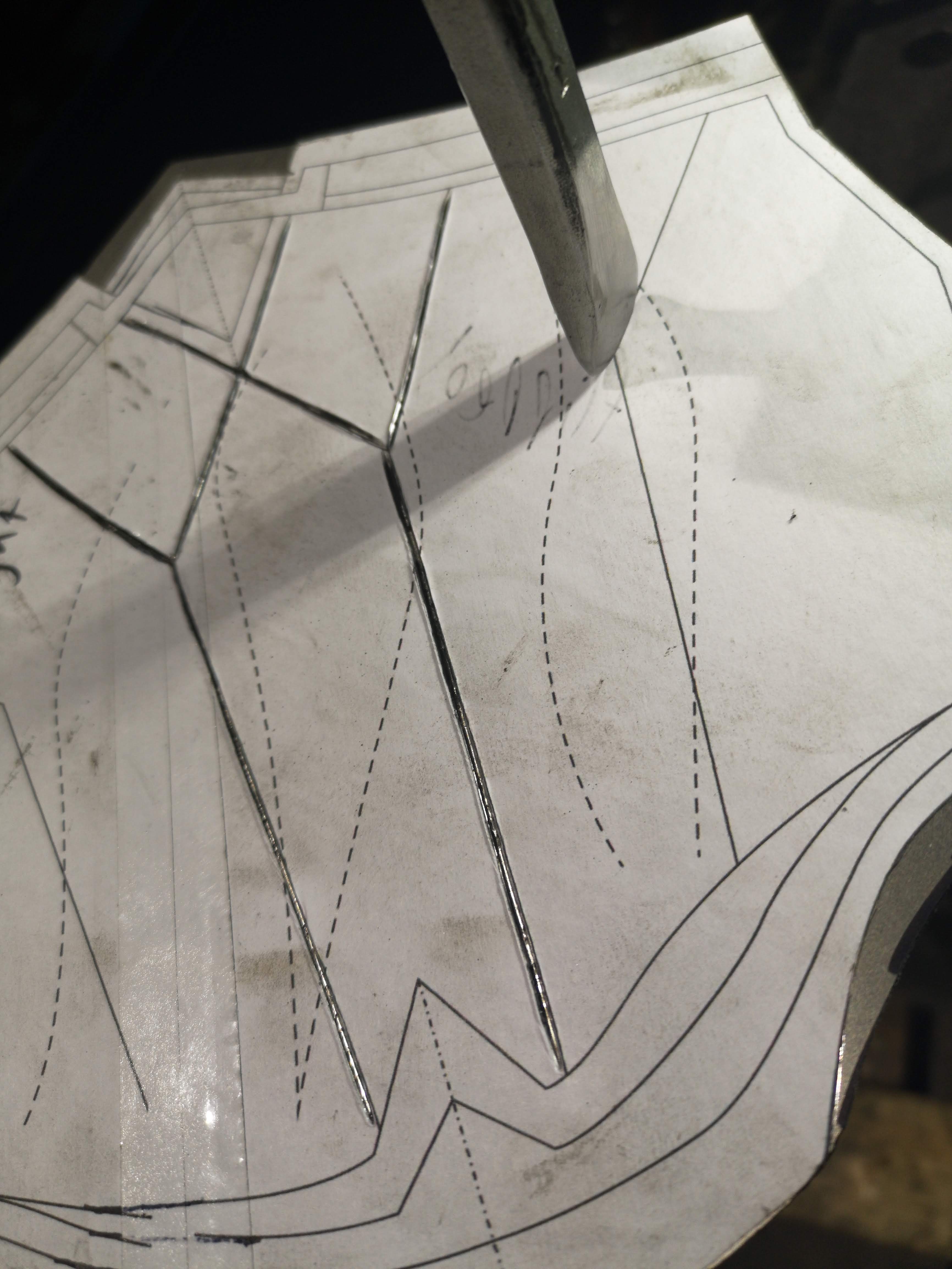

Onto the bracers! I was successful with crafting them from steel yay!
So i got a sheet of 1.5mm steel, cut out the pattern with a band saw and got to work.
I first used a pneumatic chisel to hammer in all the indented lines, and then a smaller bit to do battle damage.
Then muscles! The bracers were carefully hammered around into a large tube, so most of the work curving was done, before embossing the muscle detail in by hand
Then the shaping was VERY carefully completed to fit my arm (will look a lil larger right now as ill be lining it with felt for comfort.) Then final polishing, filing and battle scratches were completed!
The battle damage was the only bit i didnt do myself as the angle grinder terrified me hahah!
aaaand we're done! I just need to add some gold paint and then shading on that using enamels and theyre finished!
