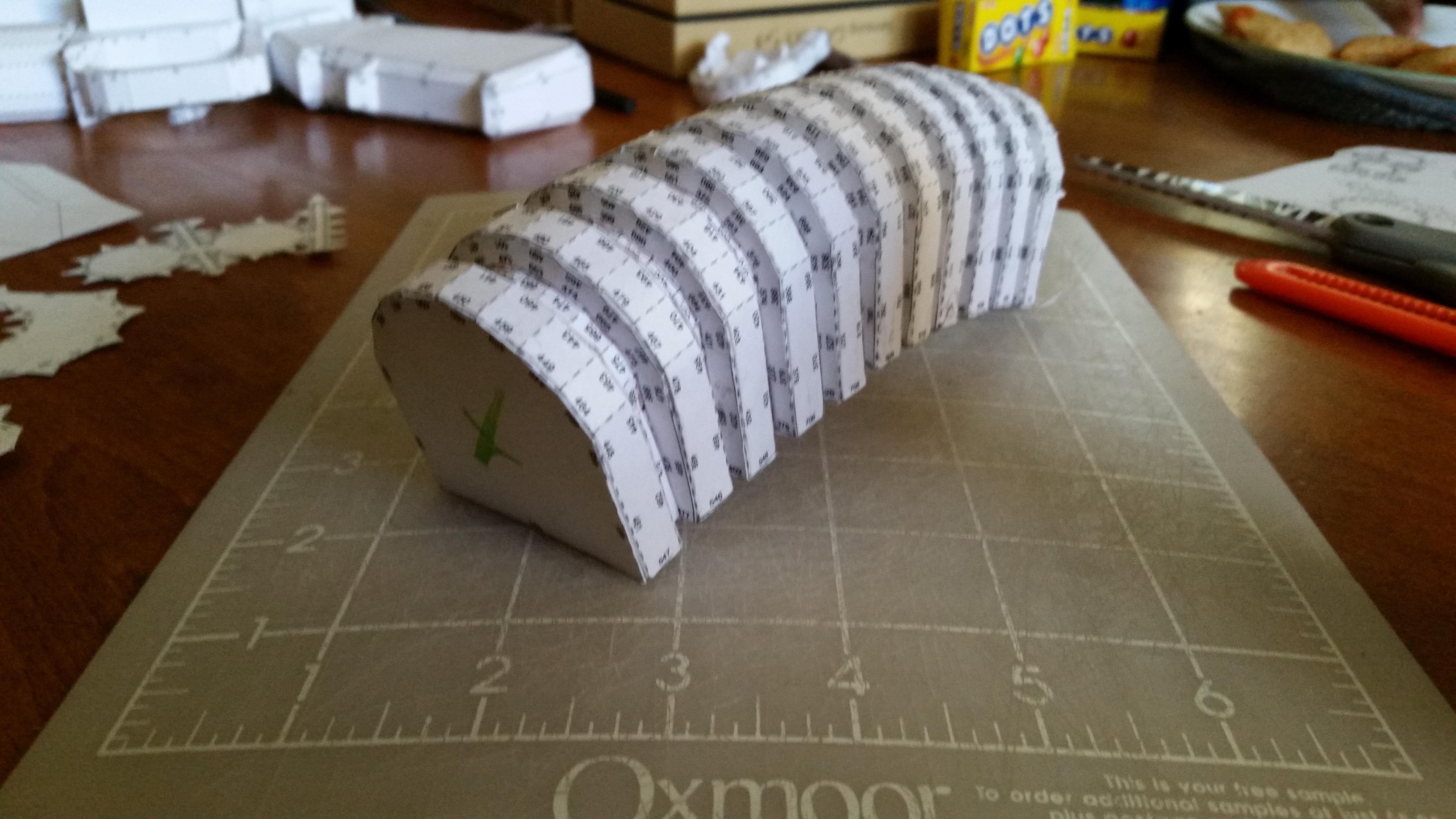

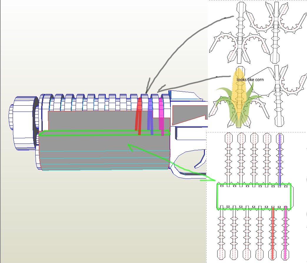

Each section of the blaster was fairly simple (mostly boxes or other common shapes in pep) but the kicker was the barrel area of the gun.
0oh3CJd.jpgwow that's a complicated looking picture... bare with me.

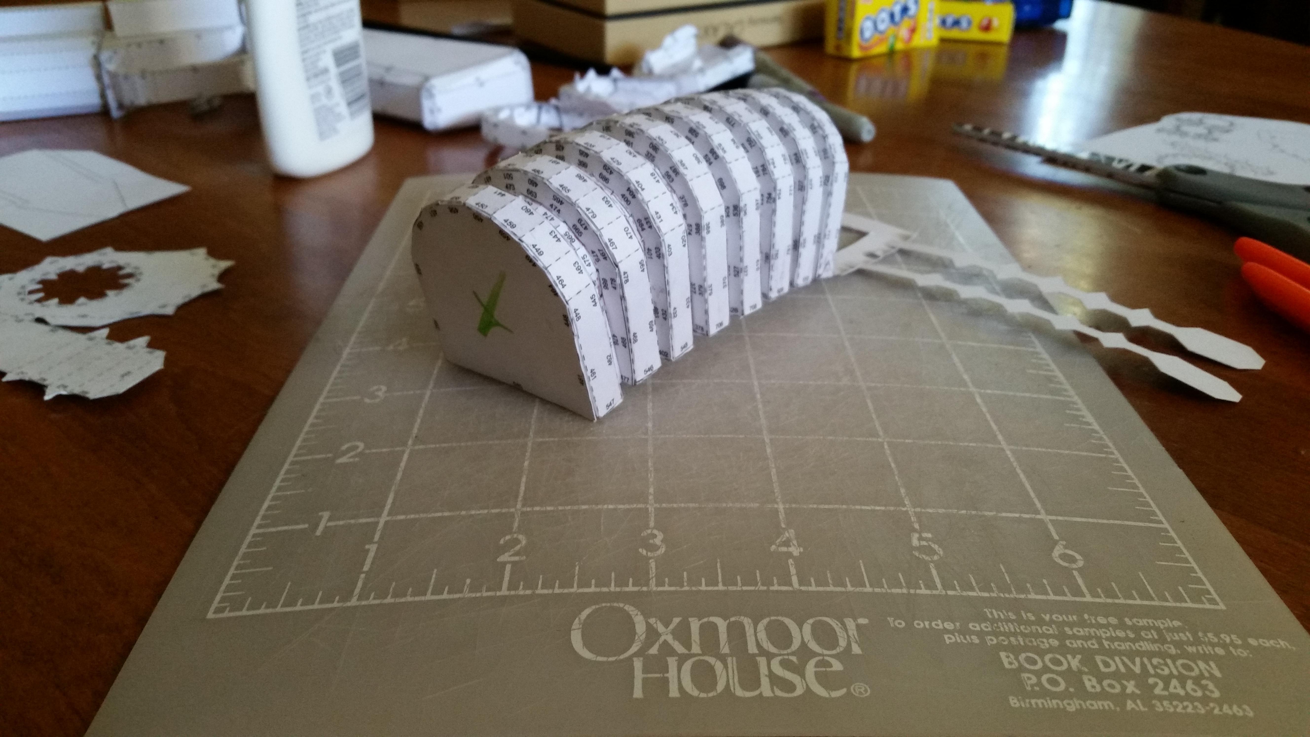

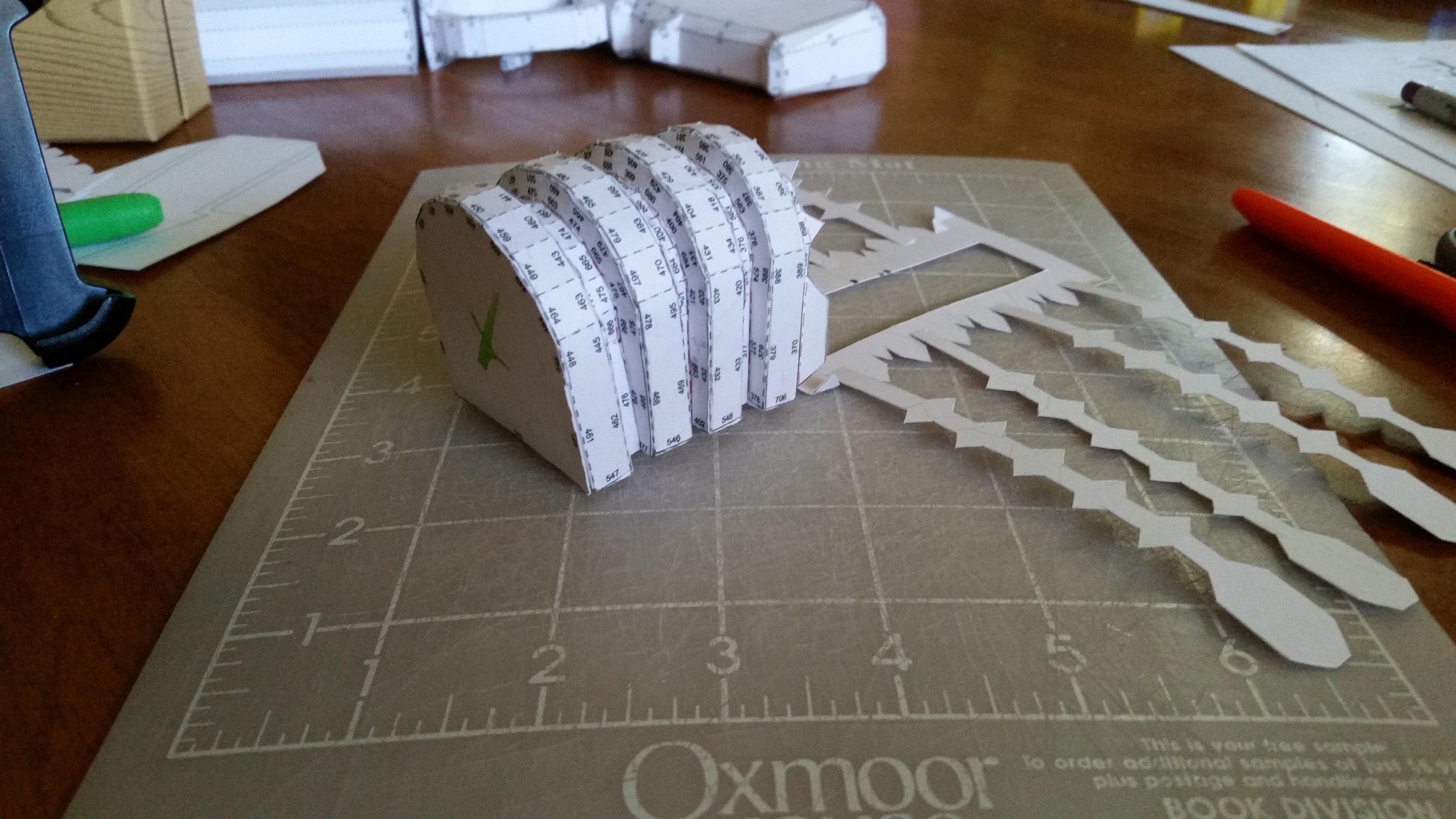

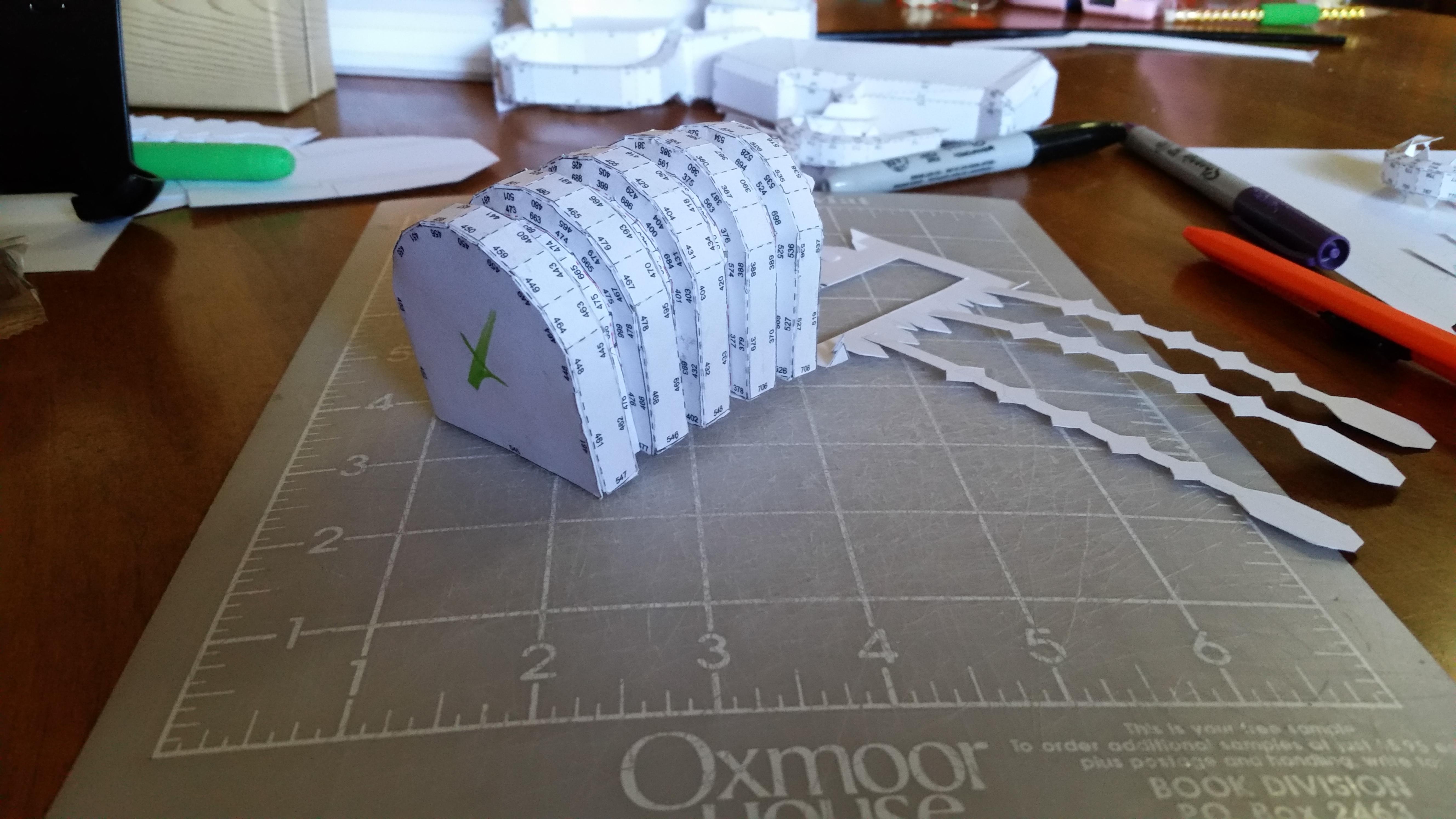

I set up the barrel so that there would be a base (green) and fingers(red, blue and pink) would extend out and back to the other side of he base. The corn-looking pieces are the bumps in the barrel.
This interlocking pattern was to give it strength and while it did that, it was also a pain in the butt to put together.
Each hump took almost 20 minutes to cut out, glue together and glue onto the base. And note that the entire thing curled with each hump. I plan on fixing that by spacing the humps out and gluing the entire thing to a flat hard surface before rondo-ing the inside.

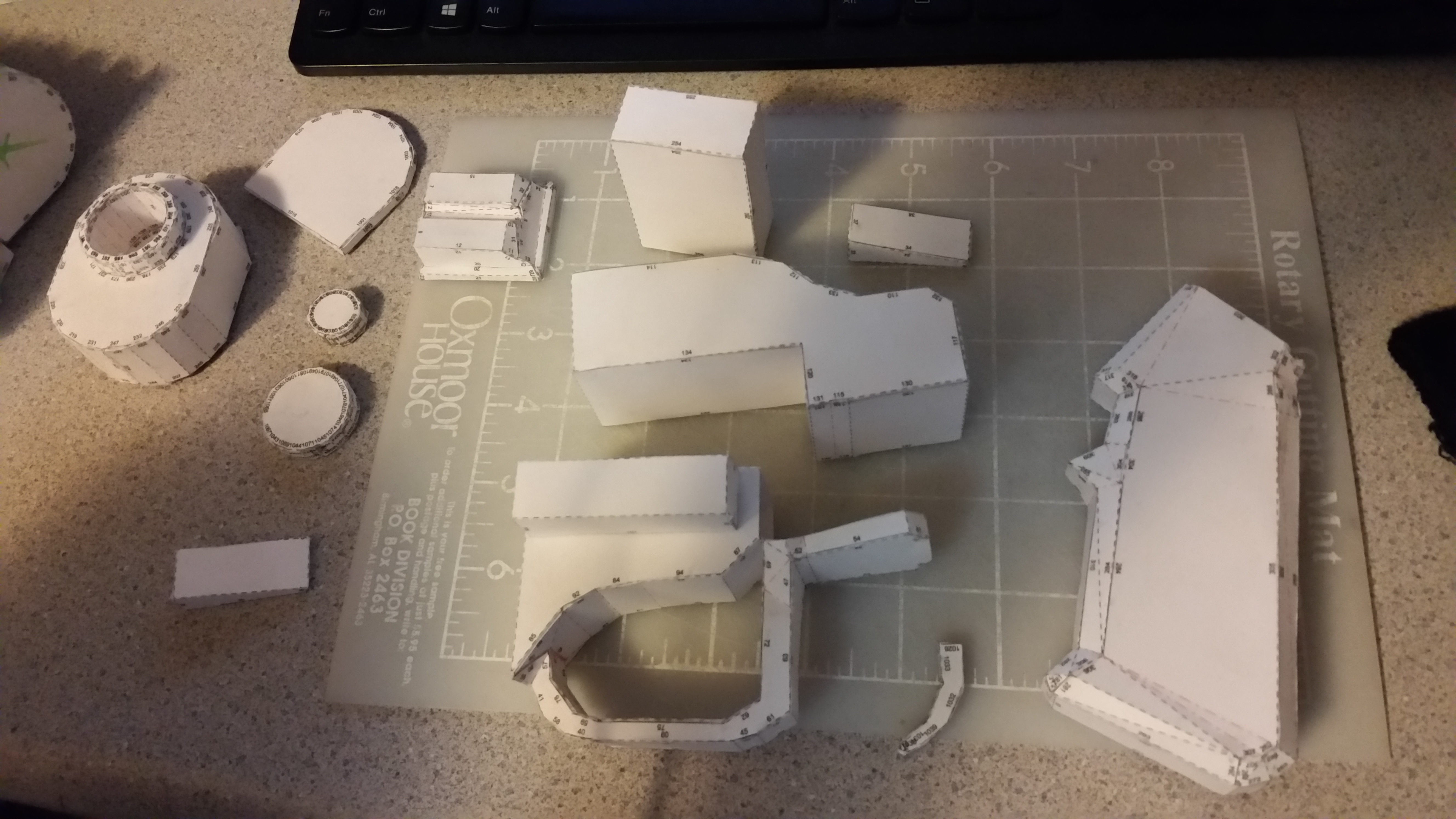

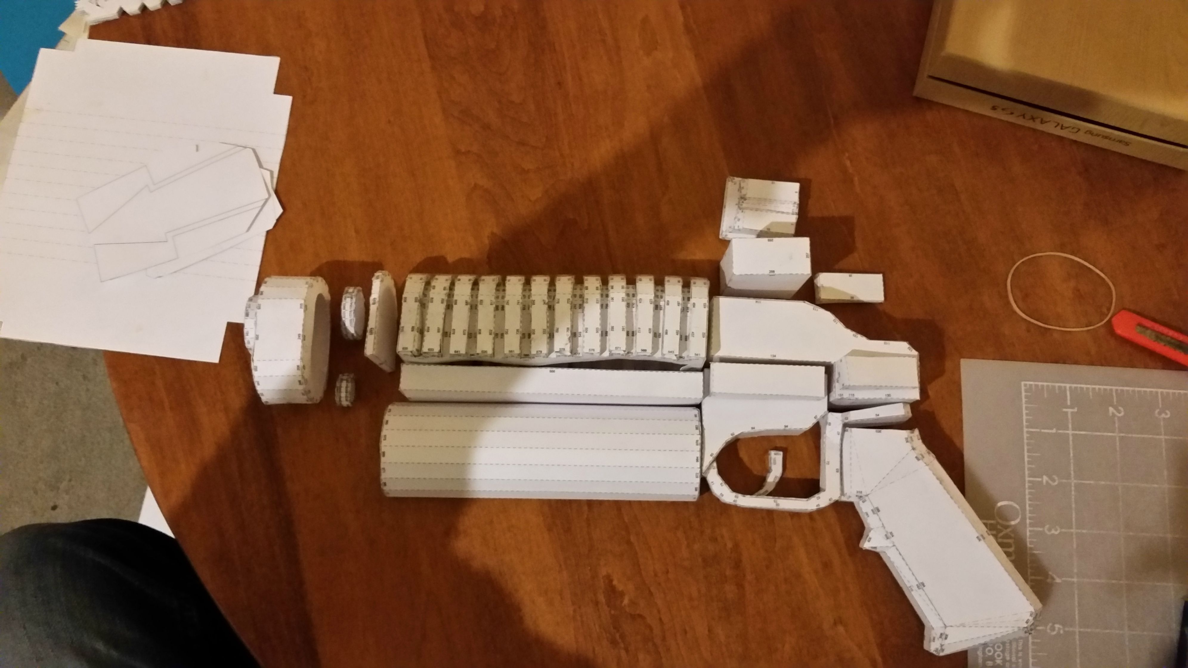

Here are all the finished pieces laid out.
MQNAayM.jpgthe barrel has a piece of tape stuck to the top of it to straighten it out for the shot.

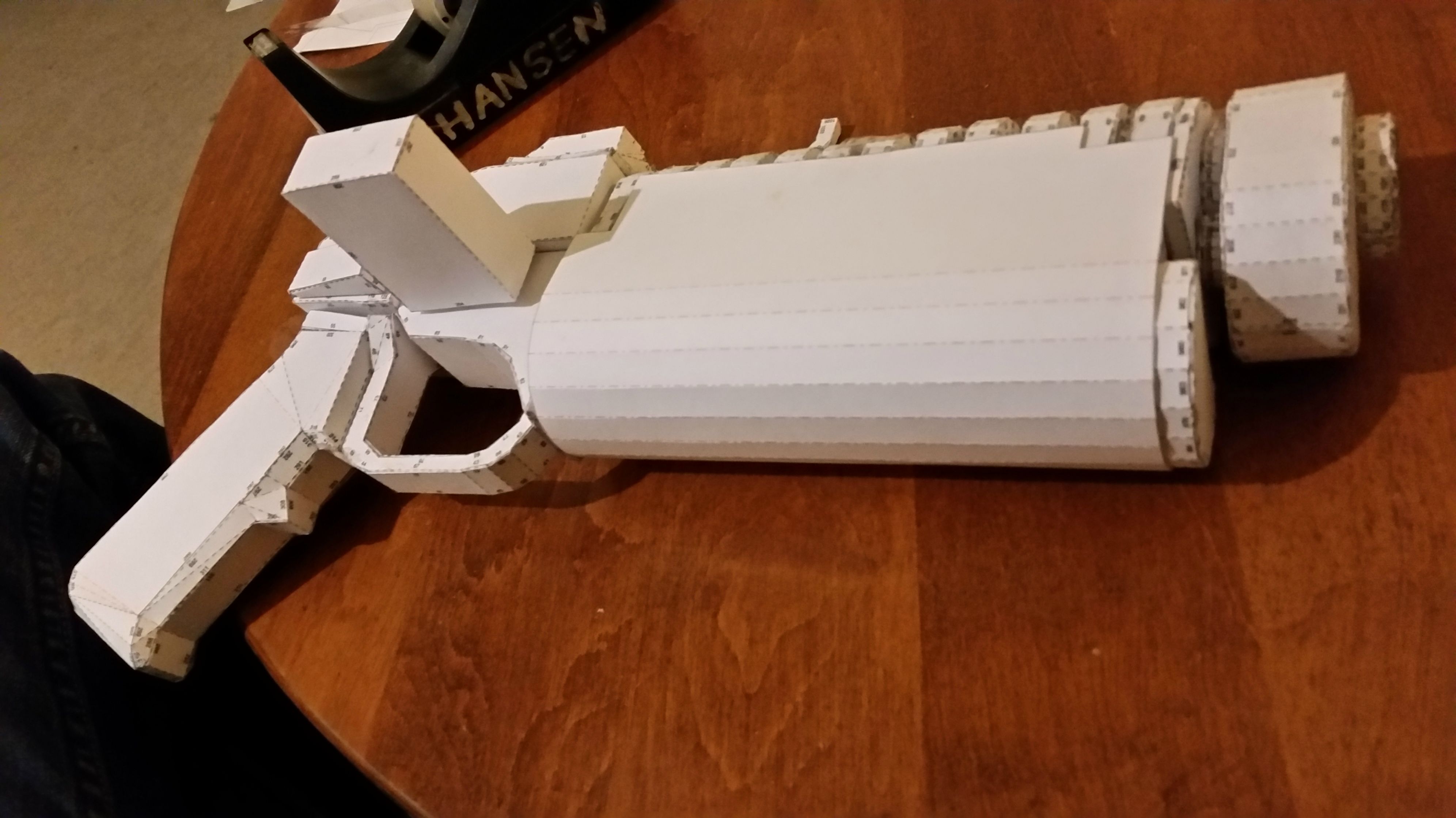

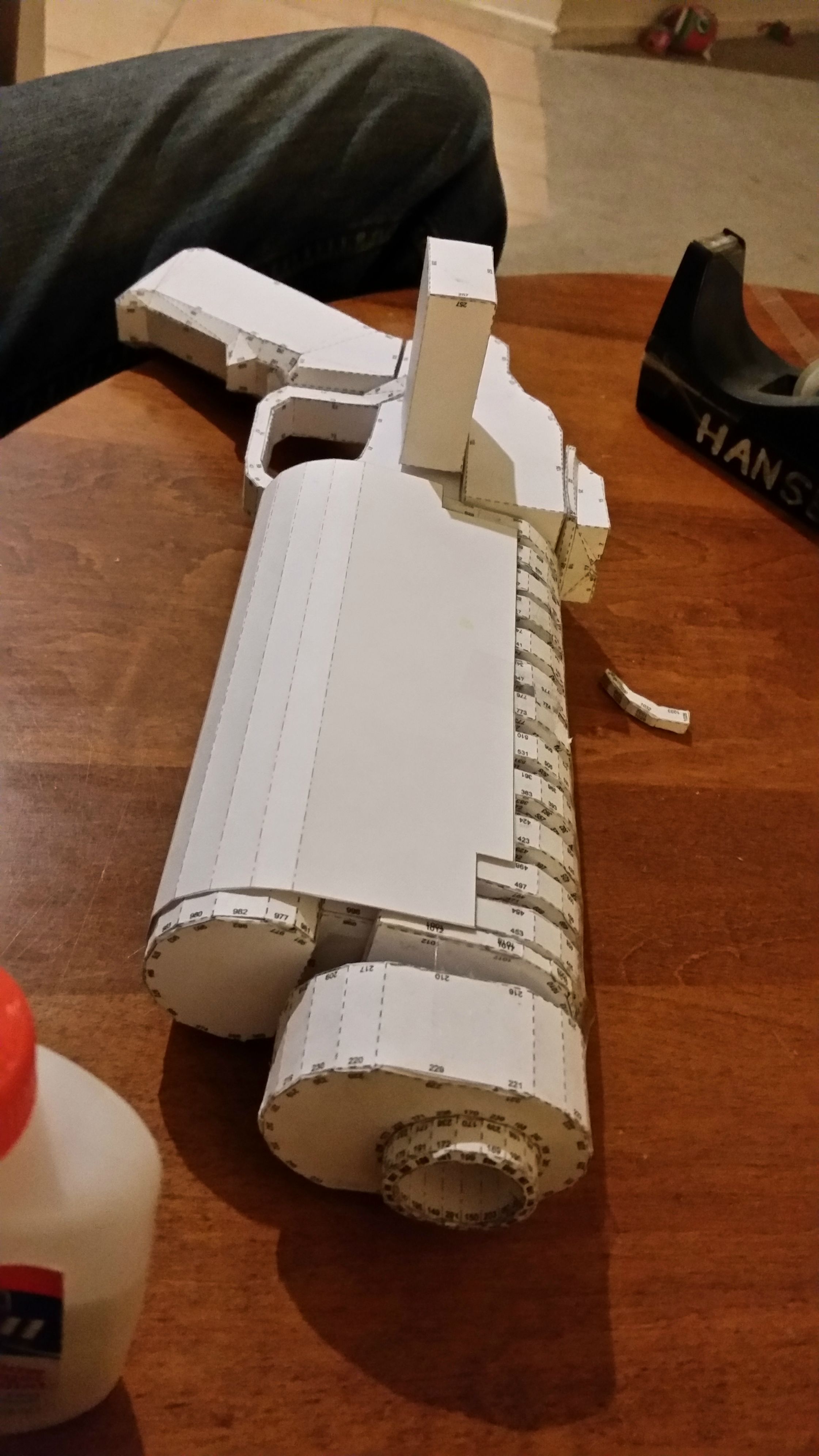

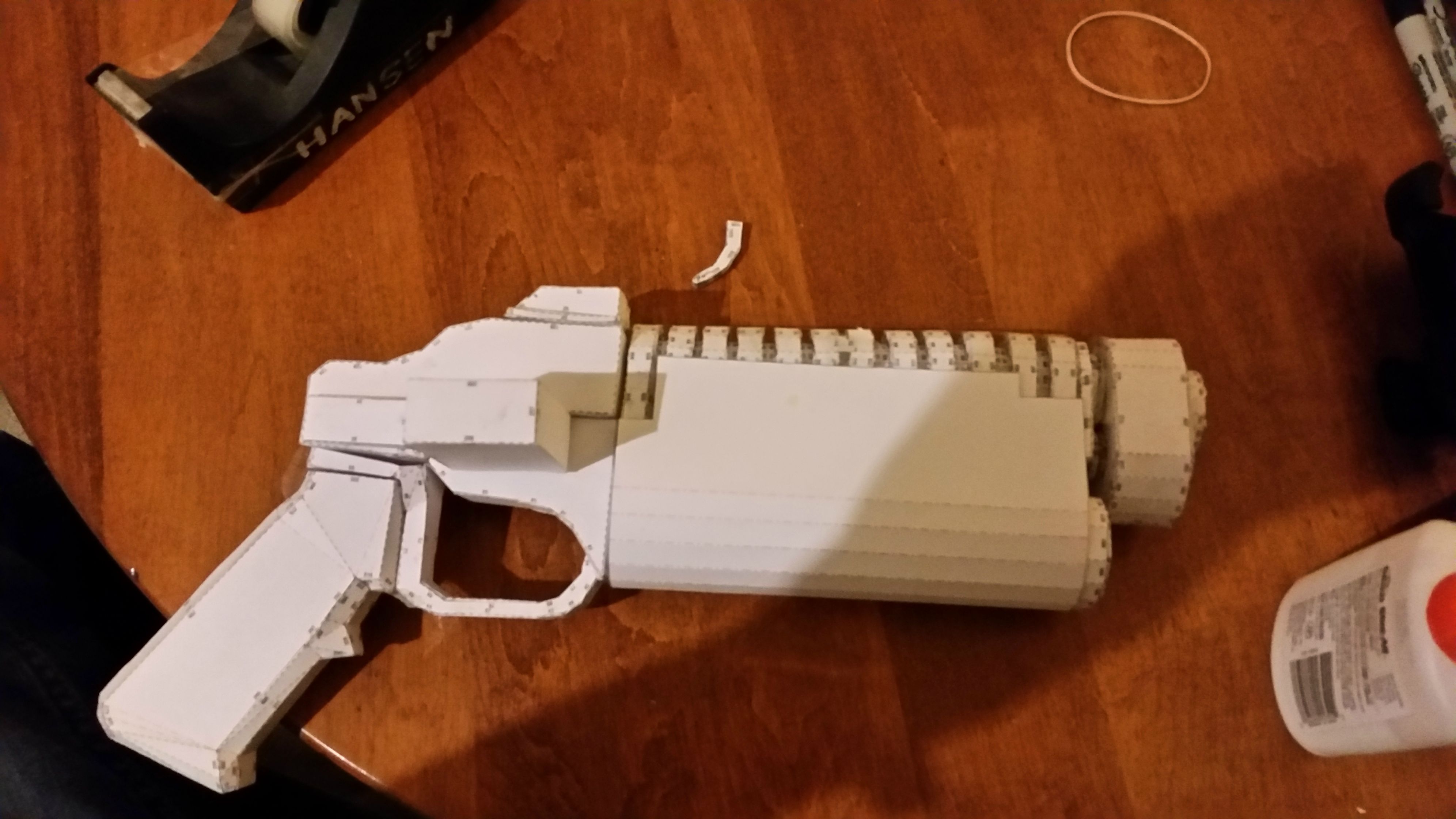

And here they are taped together for a temporary feel of the finished product.
I will update more, tomorrow possibly, when i start the hardening process.

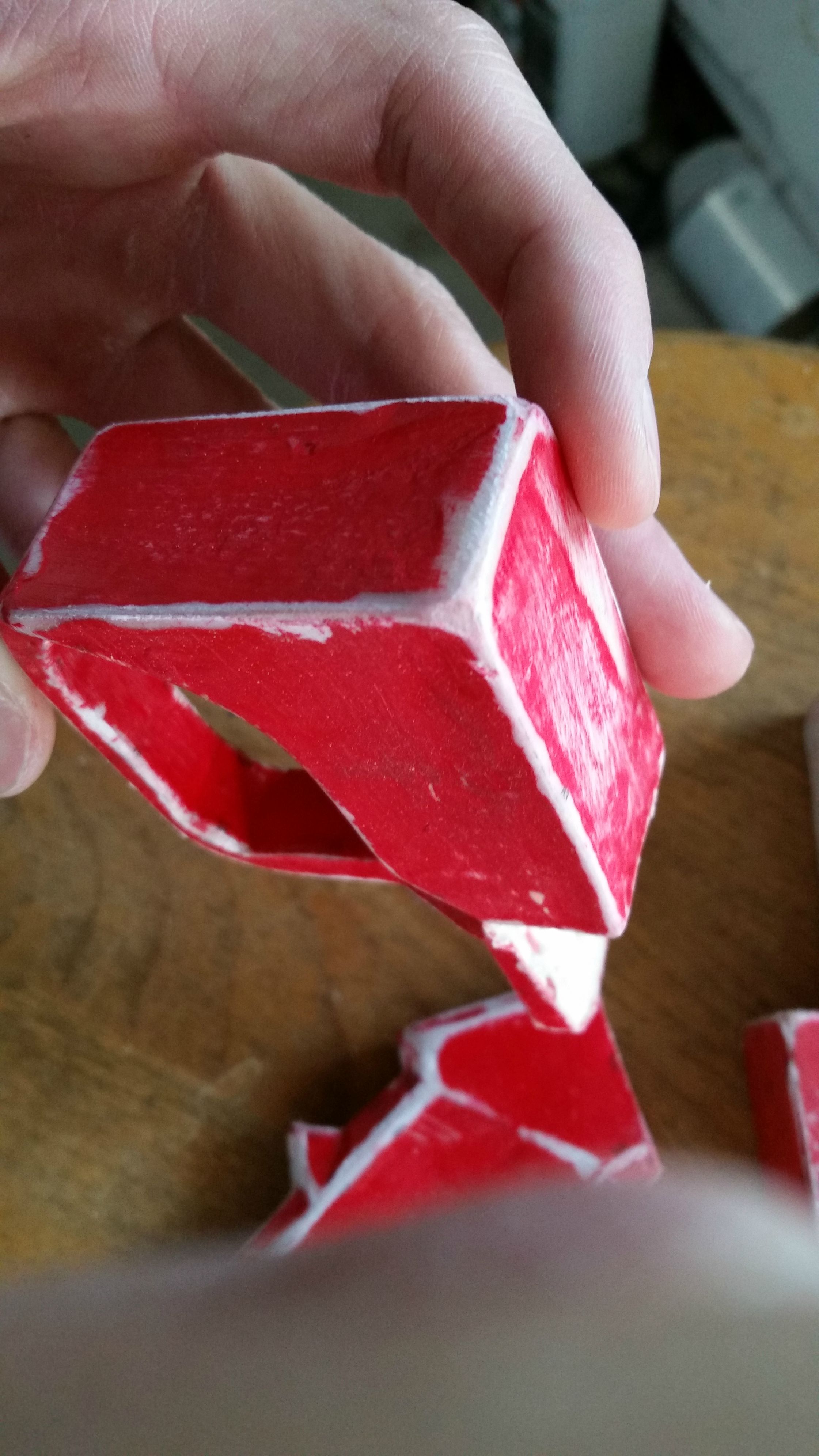

So it took a little thought but i've (roughly) figured out what I'll be doing to strengthen and affix the pieces together

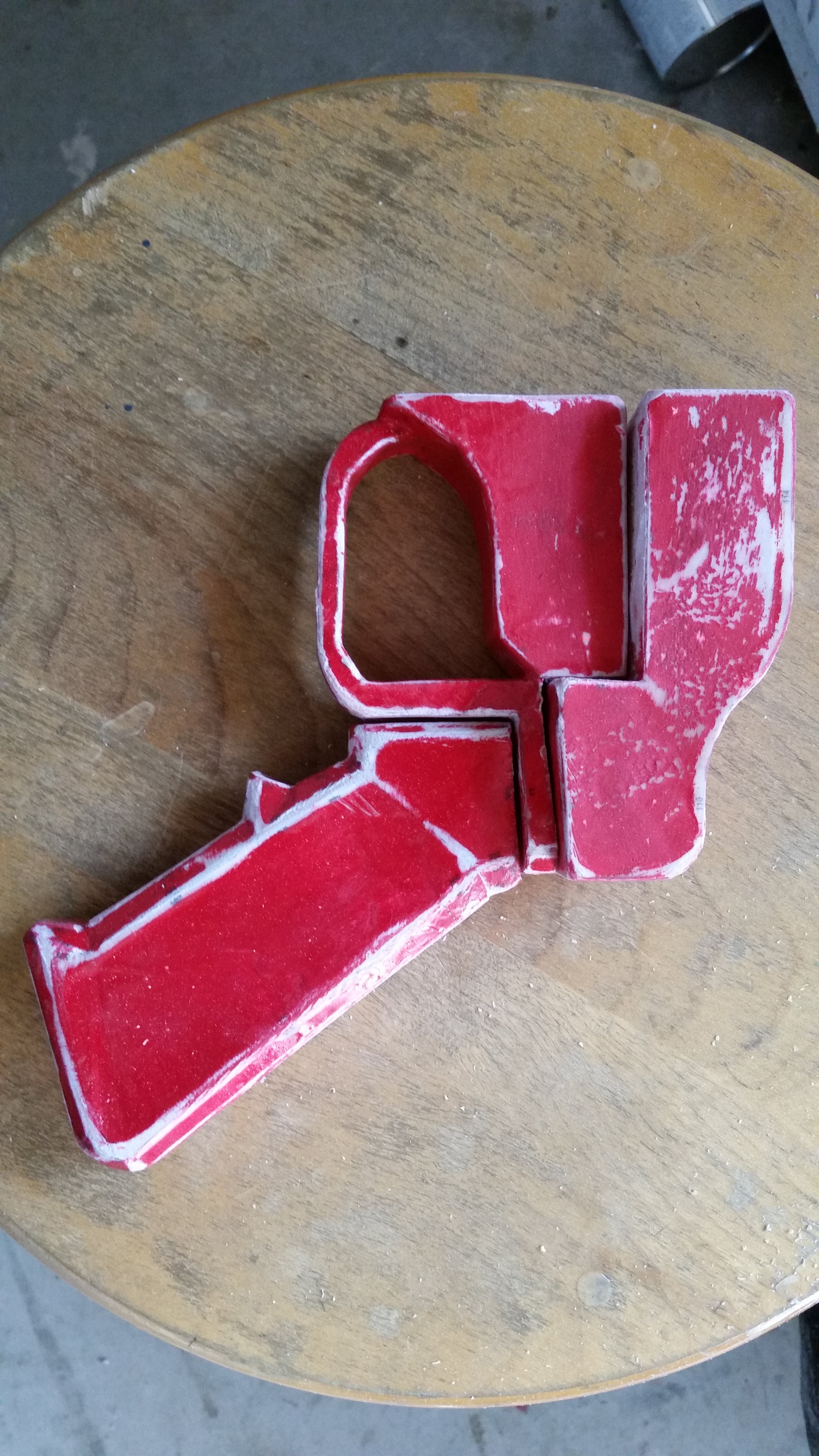

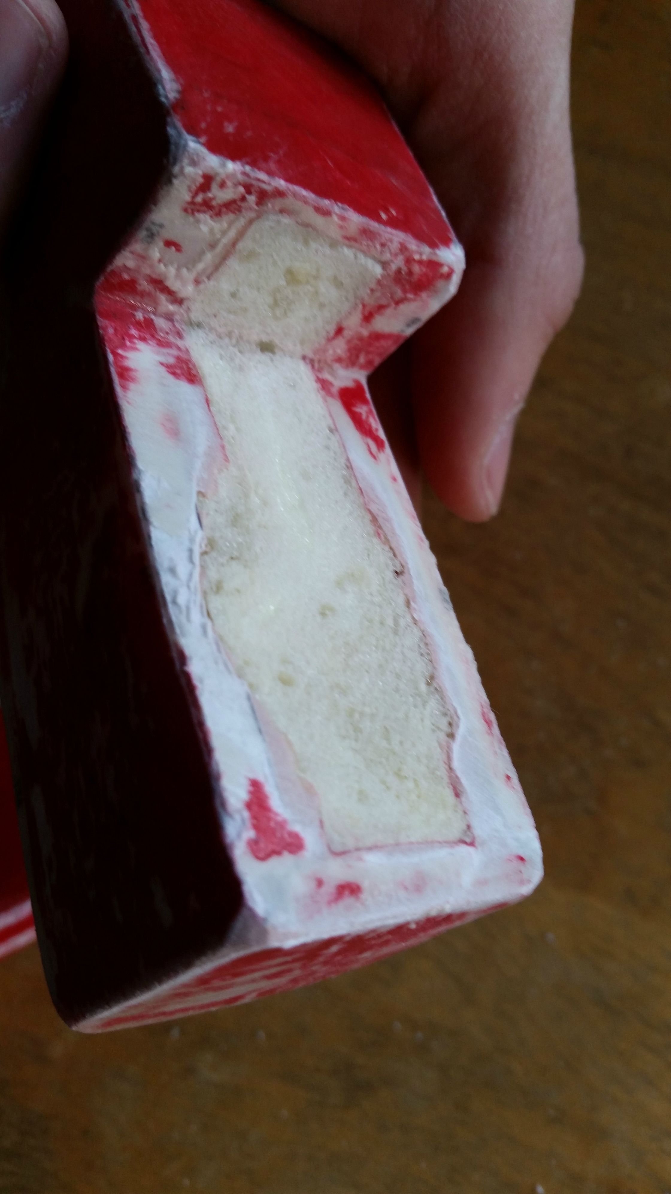

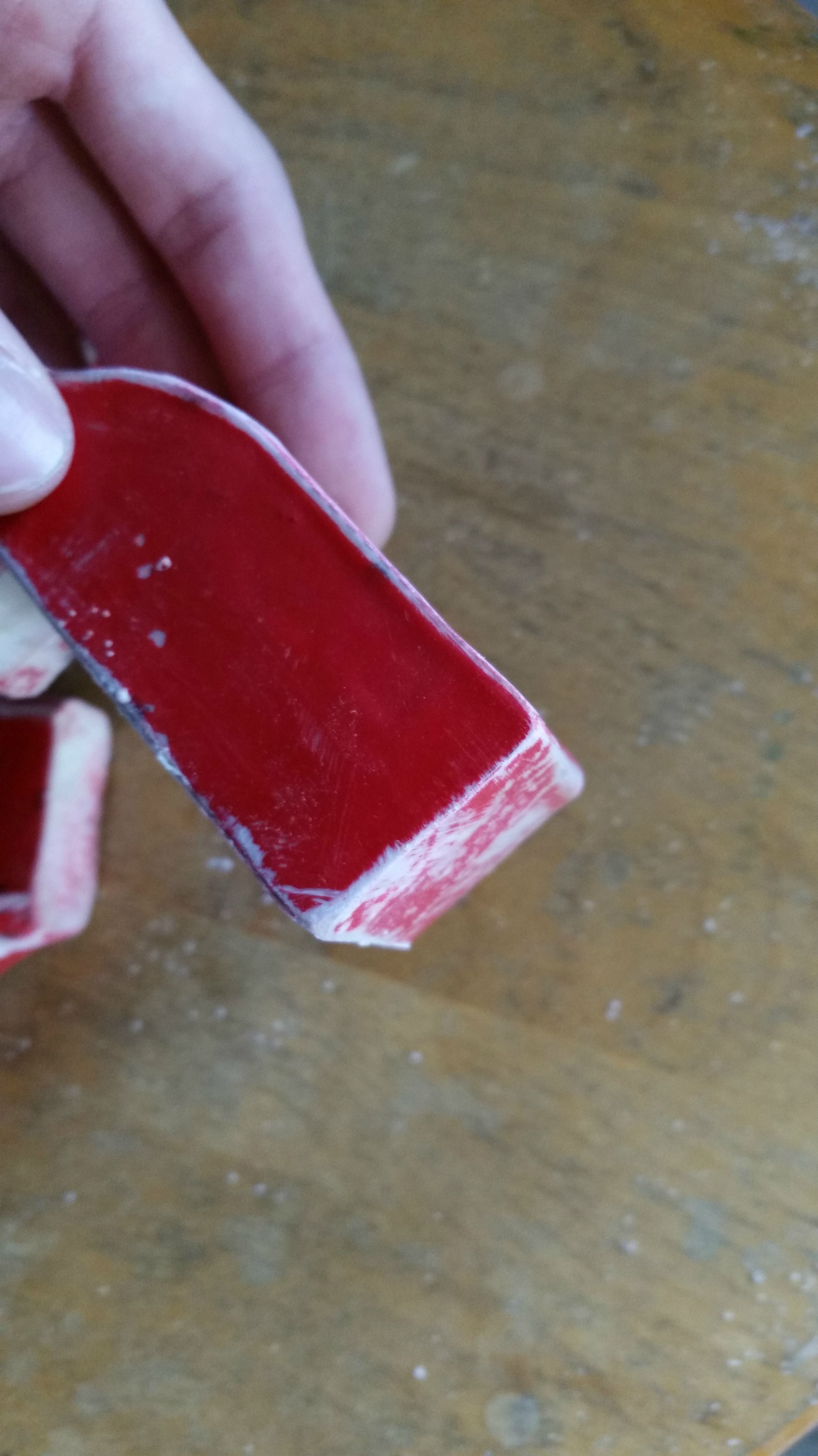

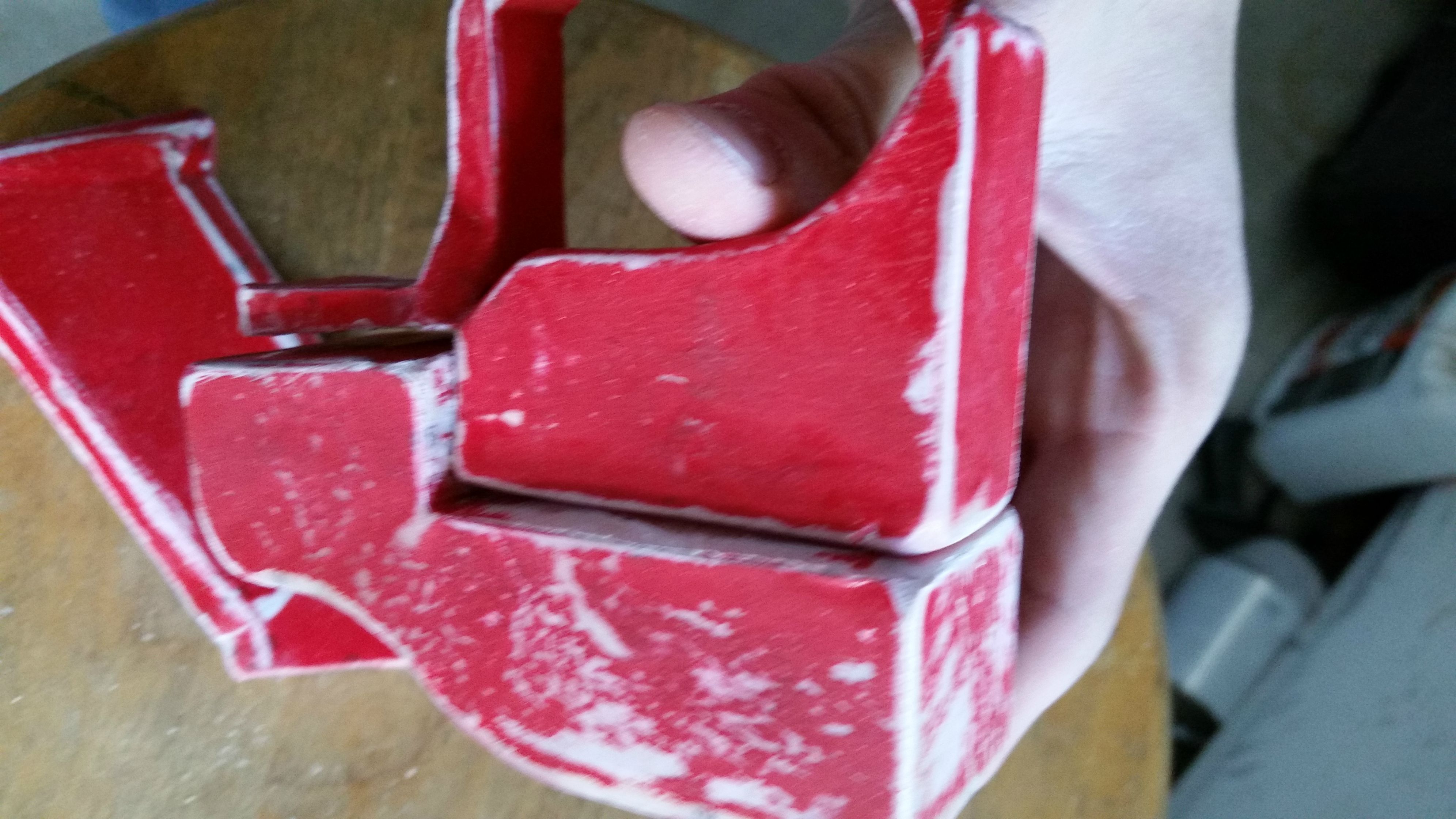

I hardened each of these pieces with a coat or two of rondo inside and resin on the outside. When it's dried, I rounded off the edges with a file. I also added red spray paint just to see what it would look like
Im....not stop sure why foam was needed.... :s
It had the strength I wanted, plus if I need to repair a break through, it's now impossible.
Here are some more pics of what I've done so far. I will probably use apoxy (if it doesn't melt instant foam) and bonds to fix pieces together and smooth out seems, but that won't be done until I've finished most or all of the pieces.

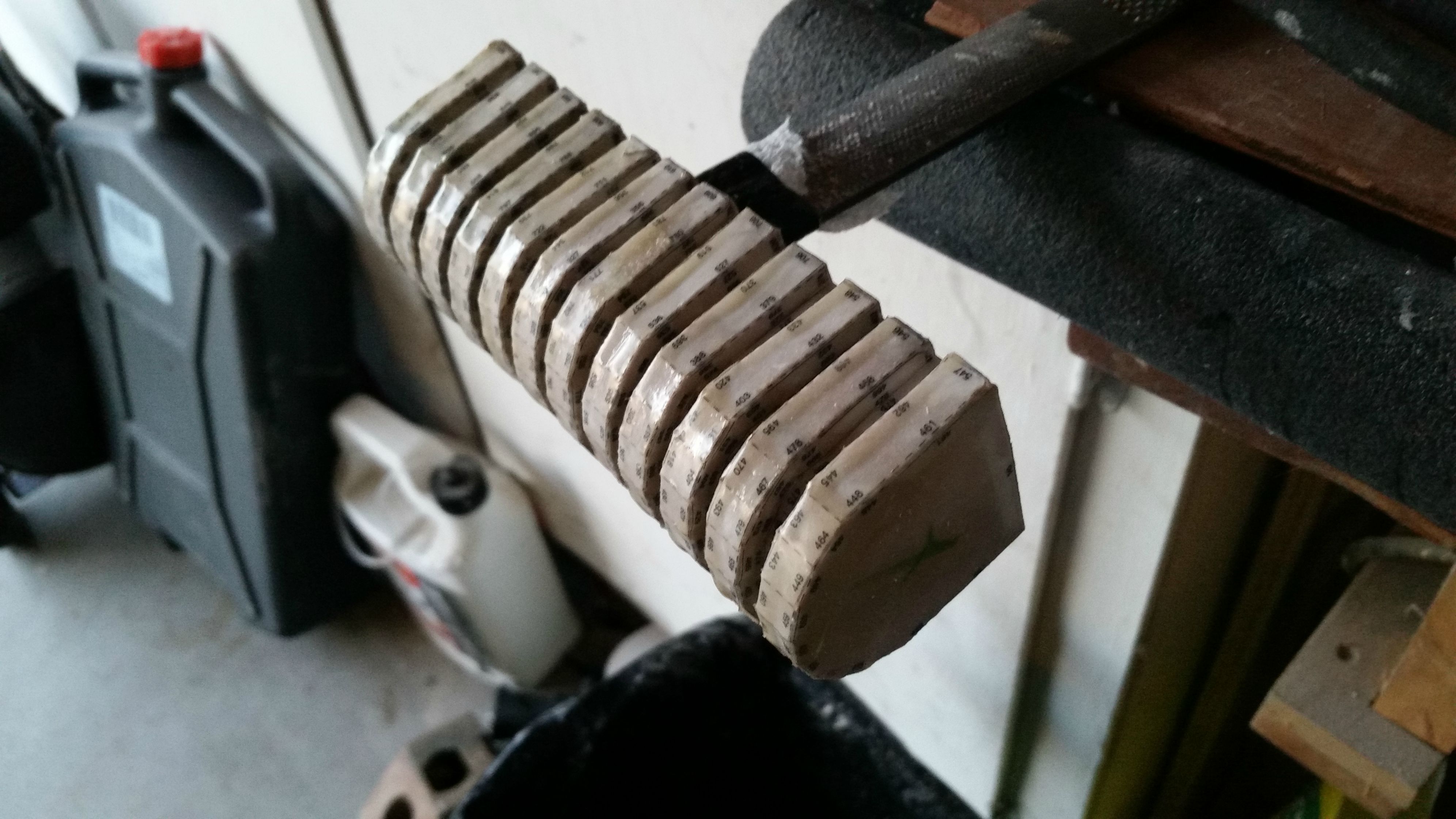

New Progress. I've hardened all the pieces and have glued some together

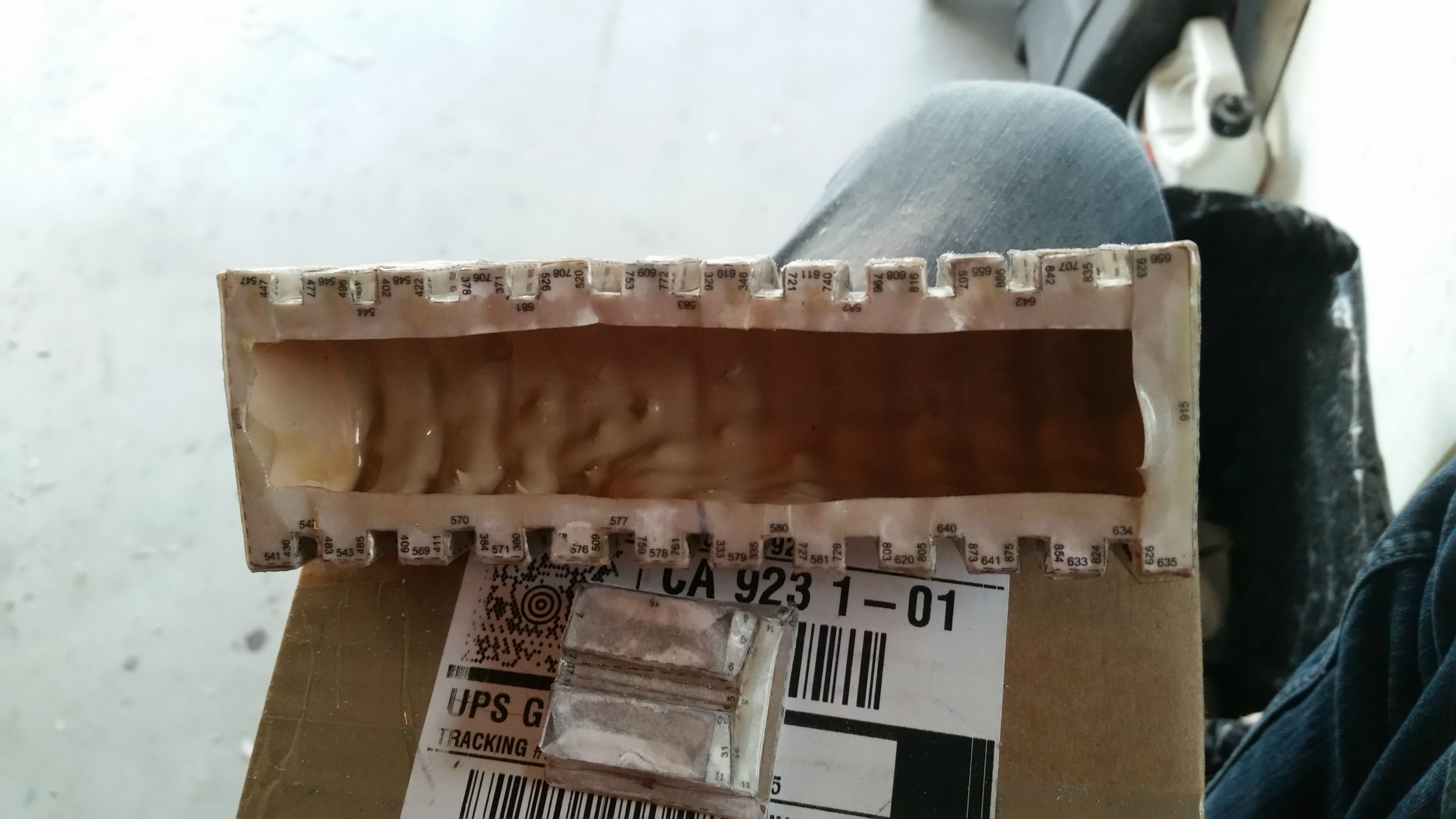

The ribbed pieced had to be filed quite a bit and I even had to add resin to one end to make it even.
