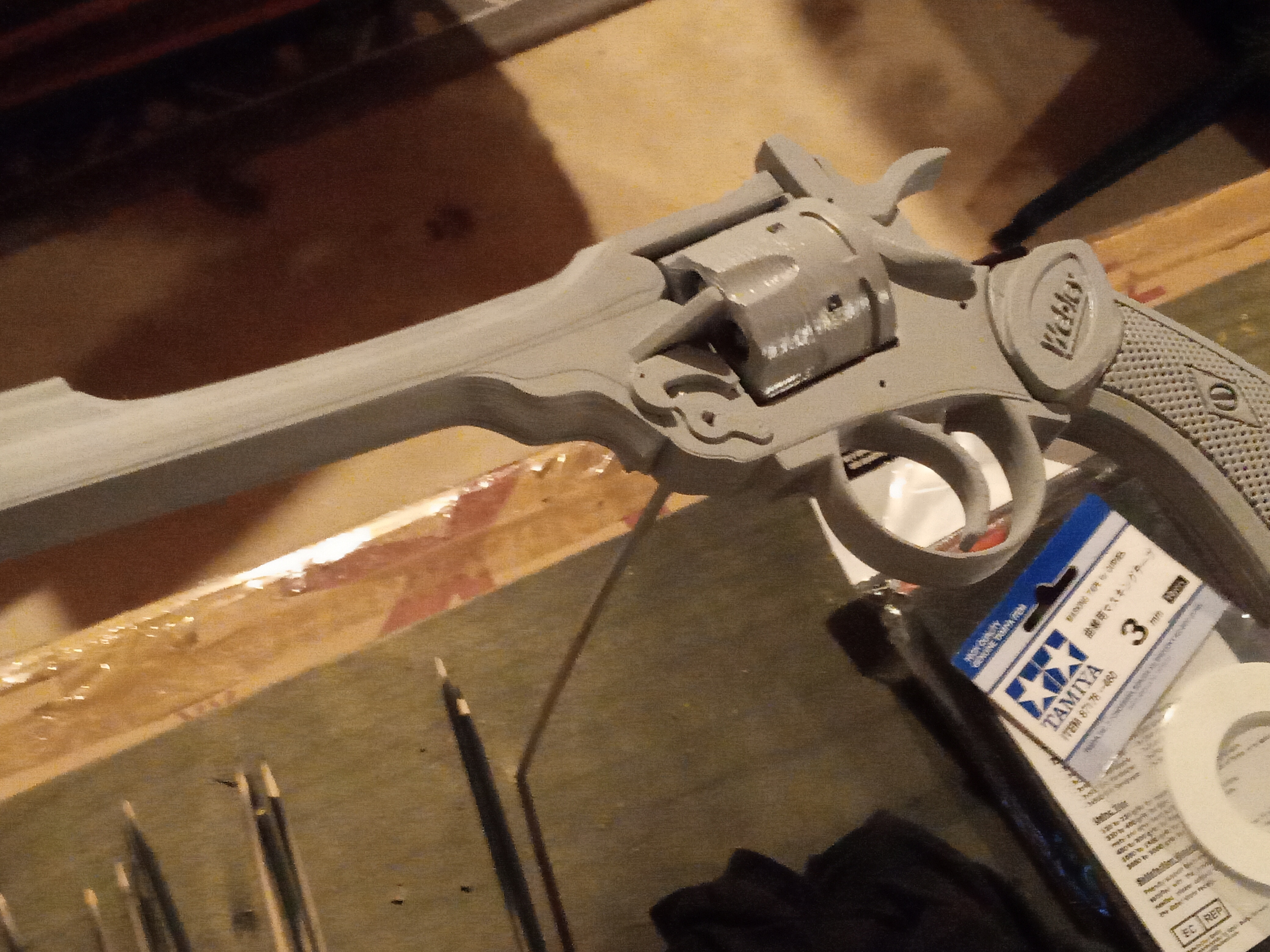

First thing, I did a lot of research and found that the best way to handle PLA such as this is to hit it with a few coats of filler primer, and then wet sanding once it's fully dried, which apparently takes about 24 hours.
The model drying precariously on its post after three coats of filler primer. Already looking much smoother!
Tomorrow once I'm home from work, I'll begin the wet sanding process and will update you guys when I'm all done with that. I'm waiting for a Humbrol steel spray paint that should give the model a realistic metallic finish.

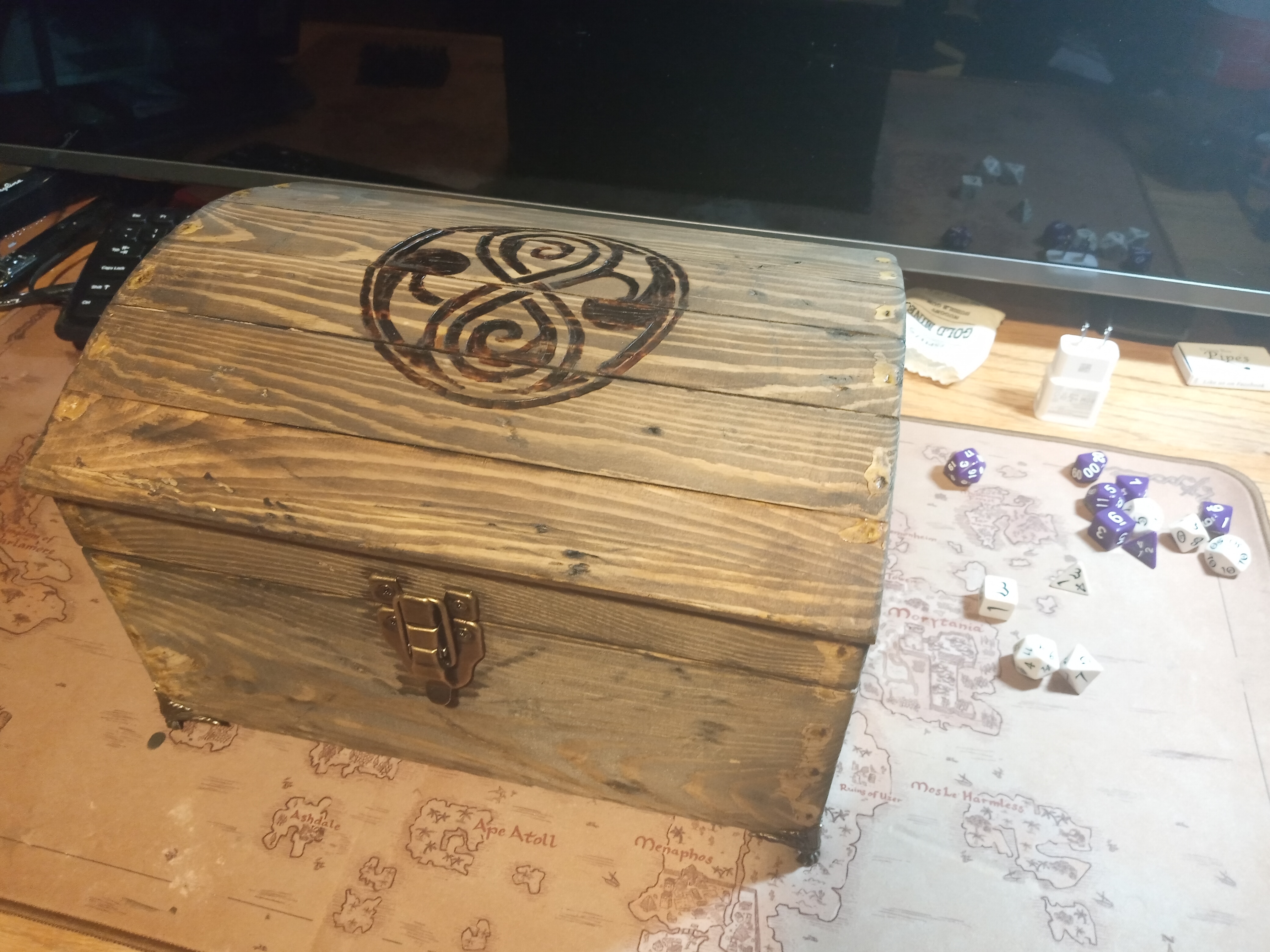

In the mean time, as I was waiting for all this stuff to come in, I was greatly inspired by SchubroProductions's Timelord Toolbox, and wanted to give a similar container for my screwdrivers a try too. Since moving a bunch of stuff off my desktop space in my home office to make room for retro computers, the sonic screwdriver collection was spending its time crammed inside a file cabinet.

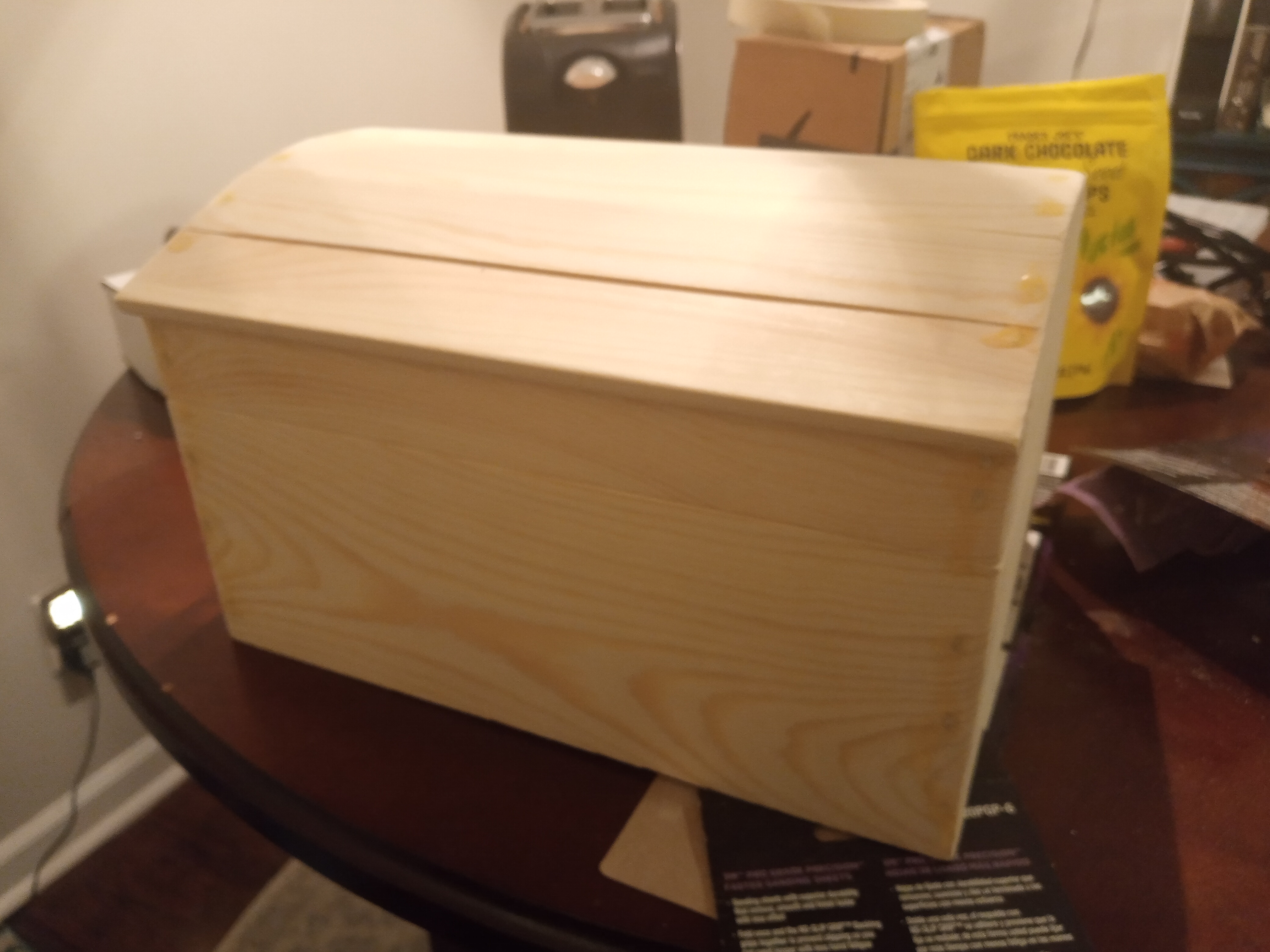

I didn't have the budget for wood to assemble the box from scratch, but I did find a pre-made thing from a craft store which I figured would look pretty great once I got my hands on it.
Pictured: a mess.
First step was attempting to fill in some of the holes left by large staples in the box, and then sanding down those glue spots so they'd be flush with the box. After that, I used my laser printer to print out the Seal of Rassilon and used the transfer bit of a wood burner to transfer that to the wood box. After transferring the design, I went back with the wood burner to properly burn the design into the wood. As it turns out, it was a bit harder than I anticipated - I'd burned designs into wood before, but trying to get one that wasn't my own work to burn in accurately was a challenge!
Overall, it came out lumpy, but I figured because I'd be beating the hell out of the box shortly it should even itself out sooner than later.
The next steps, I regrettably did not take progress pictures for. First was a couple of passes of wood stain, followed by a black acrylic wash, wiped off with paper towels. Then I attached brass closures and feet to the box to give it the appearance of something that was at one time fancy, but has been bouncing around the TARDIS for years and years. To weather it, I used just about every tool I own to beat the hell out of the thing. It looks much brighter in this photo than it truly is. The end result was a dark, aged finish I am really happy with. It helped to hide some of the crimes of the lumpy wood burning job as well.
The final step for this box, of course, is filling it with my Sonic Screwdrivers!

I think at this point I'm quite satisfied with the filler primer/sanding method! After I waited 24h for the primer to dry, I wet sanded using 150 up to 3000 grit sandpaper. It feels amazingly smooth!
Tomorrow I'll mask off all the "metal" bits and spray on the black for the grips. My Humbrol paint is still floating in the aether. Neither DHL nor USPS can identify who actually has my package or why it managed to end up in the next town over, and then fly back to Colorado inexplicably. Ah well! I've got some blade runner stuff I can work on.

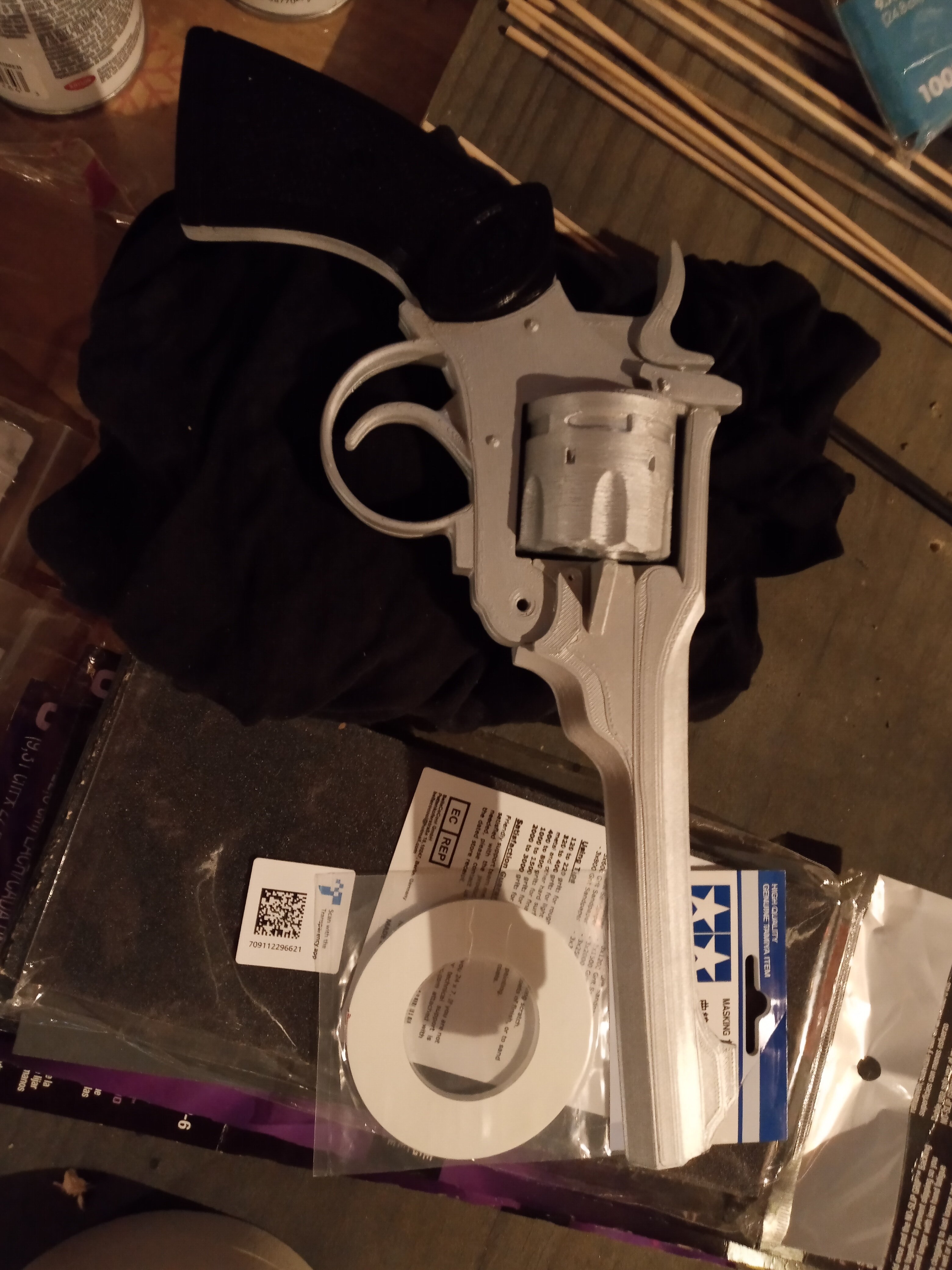

In the mean time, here's a base gloss black coat to bring out the shininess of the upcoming grey.
Painting done! Well... spray painting. Couldn't find any graphite powder, but the Tamiya gunmetal paint turned out great! Gave it a clear coat, and now I'm ready for an acrylic wash of black, and then a follow up of burnt umber. The lanyard ring has been glued since I took this picture, and is drying now.
