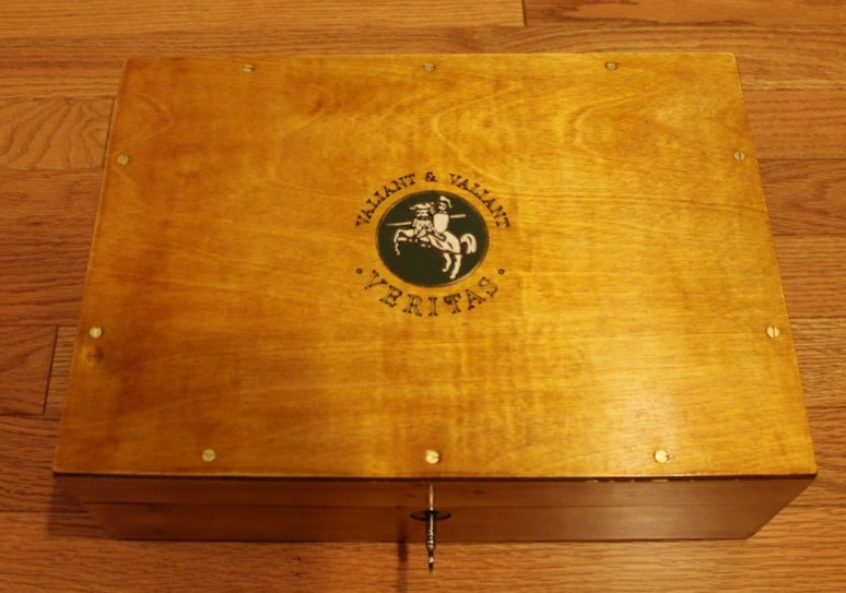

I believe I'm ready to call this one done. Finished up the box this afternoon, like I mentioned, it is rather straight forward for the most part, but a lot of time involved.
I'm happy with how the top turned out, though if I had it to do over again, would make the letters slightly wider. The original wasn't engraved, but I prefer the added depth.
What I expected to be the easiest, the plaque from Yosemite, turned out to give me the most trouble. Tried painting the plaque after engraving, but couldn't get a smooth finish and keep the letters black. Finally applied Rub N Buff to a stock piece, then engraved afterwards.
Cut the insert from insulation foam using a hot wire cutter, then covered in dark red velvet (the lid compartment is the same color, the light is giving it a different shade in the pic).
Got some shellac flakes and alcohol and mixed my own, color turned out to be just right IMO, even though the shellac wasn't even intended for this project. Also learned how to french polish shellac, which is what I did on the top.
Got all the wood at Lowes and ordered all the hardware & star from Amazon.
So with that said, if Mark offers the box, GET IT!!!

your wood case looks very good, well done buddy :thumbsup
