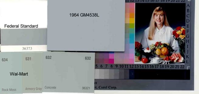

Here are the much anticipated paint specs for the “The Original Series” Enterprise, based on research provided by Richard C. Datin, the original builder of the 3′ (33in) and 11ft. (4x) filming miniatures, in late 1964.
These samples, and subsequent paint formulas are based on the only known remaining sample, which is an overspray “splatter” on the backside of one of the original Enterprise drawings.

With all that discussion behind us now, we used color samples from WalMart house paint, since it would be easier for most modellers to go to a local store and pick up these as swatch samples to match their model paints to (besides–it’s free). For those not able to go to a local WalMart (like those overseas), we have provided you with a scan of the samples, along with a background AMT logo for monitor/printer color correction, since I know you all must have some sort of AMT/ERTL kit laying around to compare to (this one is from the 22″ TOS Enterprise cut-away kit). CMYB, and Pantone PMS book pages were not used for the scan, since most modelers do not have these books.
The WalMart samples (“ColorPlace” paint) are as follows, and are prioritized by Richard Datin, and a friend of his which is a professional artist (these are the scanned samples on the Exclusives page) :
• # 1 choice — “Concrete”, set # 632, # 96321
(note: ACE Hardware # 193-D “Shady Cove” sample added below )
• # 2 choice — “Armory Gray”, set # 631, #96311
(note: ACE Hardware # 194-D “Summer Song” sample added below )
• # 3 choice — “Rock Moss”, set # 634, # 96341 (no ACE sample)
# 1 was the closest, with # 2 a close second, in Richard’s opinion. “Concrete” is an olive drab based color, with a lightening of a neutral, cold grey, and white. #2, “Armory Grey” is close, but has the slight influence of a warmer grey. #3, “Rock Moss” is similar to “Concrete”, but with the influence of a neutral (neither cold or warm) grey–and was not really a strong candidate, but I included it anyway.
