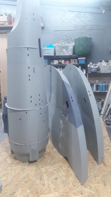

OK so I have finished printing all the parts...it didn't actually take that long but I had to wait to clear my workshop before laying this puppy out. I too am waiting on the Elegoo Giga...should get mine in April, apparently.
The Saucer is cut into 16 parts. 4 per quarter, to fit on my Neptune 4 Max...on the Giga it could be printed in 4 quarters! I have welded the saucer in 2 halves and will add the lighting, window glass etc and install the armature before joining them together. There is a tiny bit of warping and a few filament run-outs during the printing, but it went together pretty smoothly

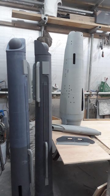

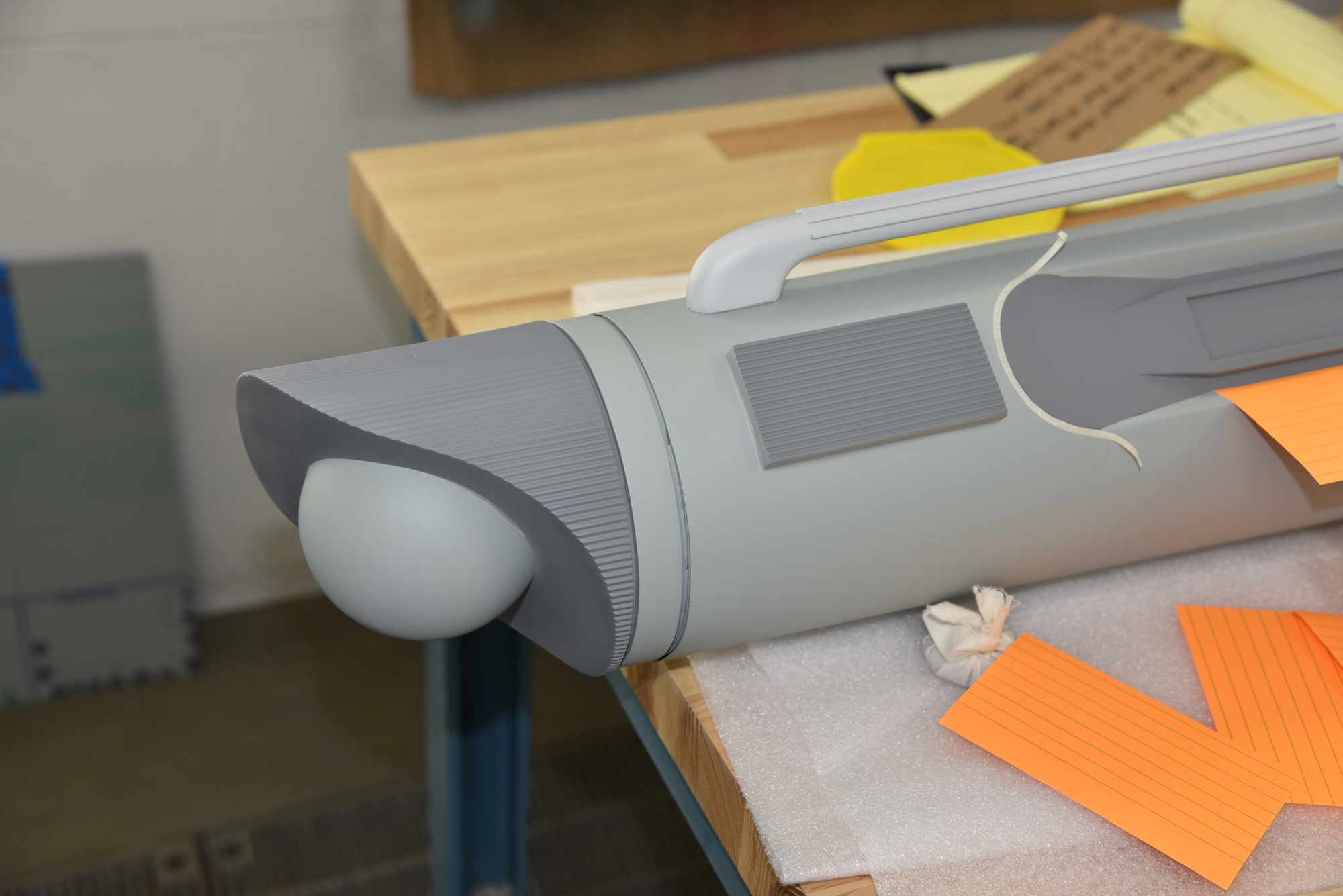

Got the Nacelles and secondary hull glued up and added the diffuse acetate for the windows
Were the balls on the back end of the warp engines that far out? I may have gotten a little to used to injection molded plastic model kits. I just looked and you got them very close.

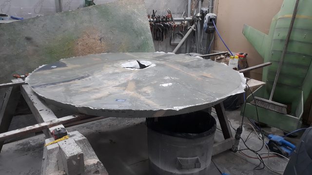

OK found a bit of time to play with this...I've decided to glass the outside of the saucer, which will make it heavier but needs doing, I think. At 100% infill, the plastic tends to curl a little at the edges, as it cools, off the bed...probably warp factor 1 :p so I'm resigned to making it strong and durable. At least the saucer is now in one piece and I can think about inserting the armature...I'm gonna use aluminium extrusion mostly...I have a load from old Creality printers that have died so it should be light and rigid enough to do the job
