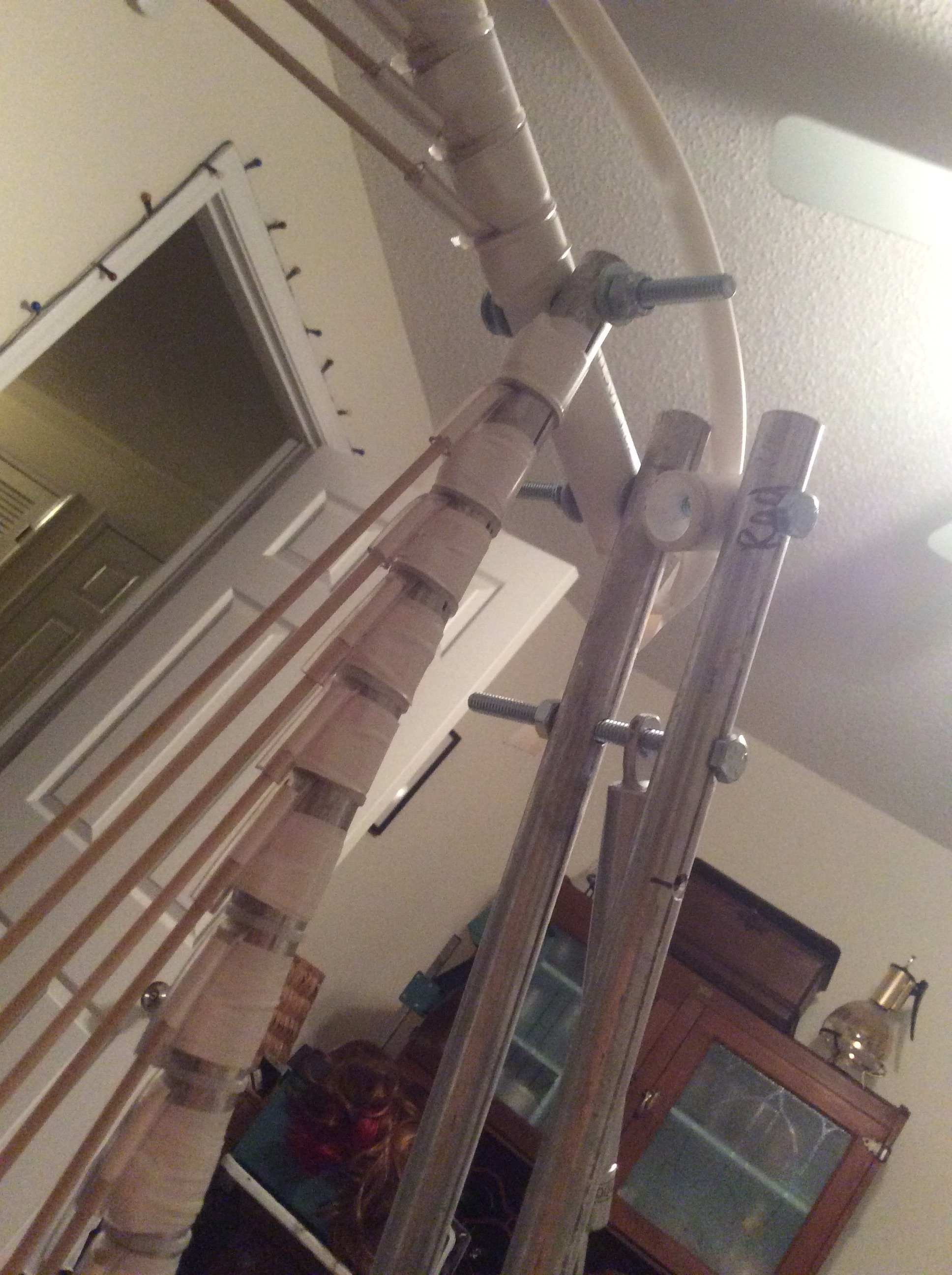

So the concept behind these is that the wings will remain folded for mobility and to keep them safe, but when I manually lift them, the gas struts will hold them up hands-free. This is made possible through the action of two little levers; when the wings move through the motion to open or close, the strut compresses, the lever switches over, and and the strut re-expands, holding the wings in shape.
They're a little noisy, but I'm surprised that they finally work, so no complaints here. I wish I could have something more automatic and hands-free (w/o cables), but this will work for now.
