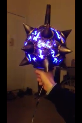

Here's a video of the mace lit up. That LED is spectacular. It's even this bright in complete daylight, outside. I am SO excited for this mace!

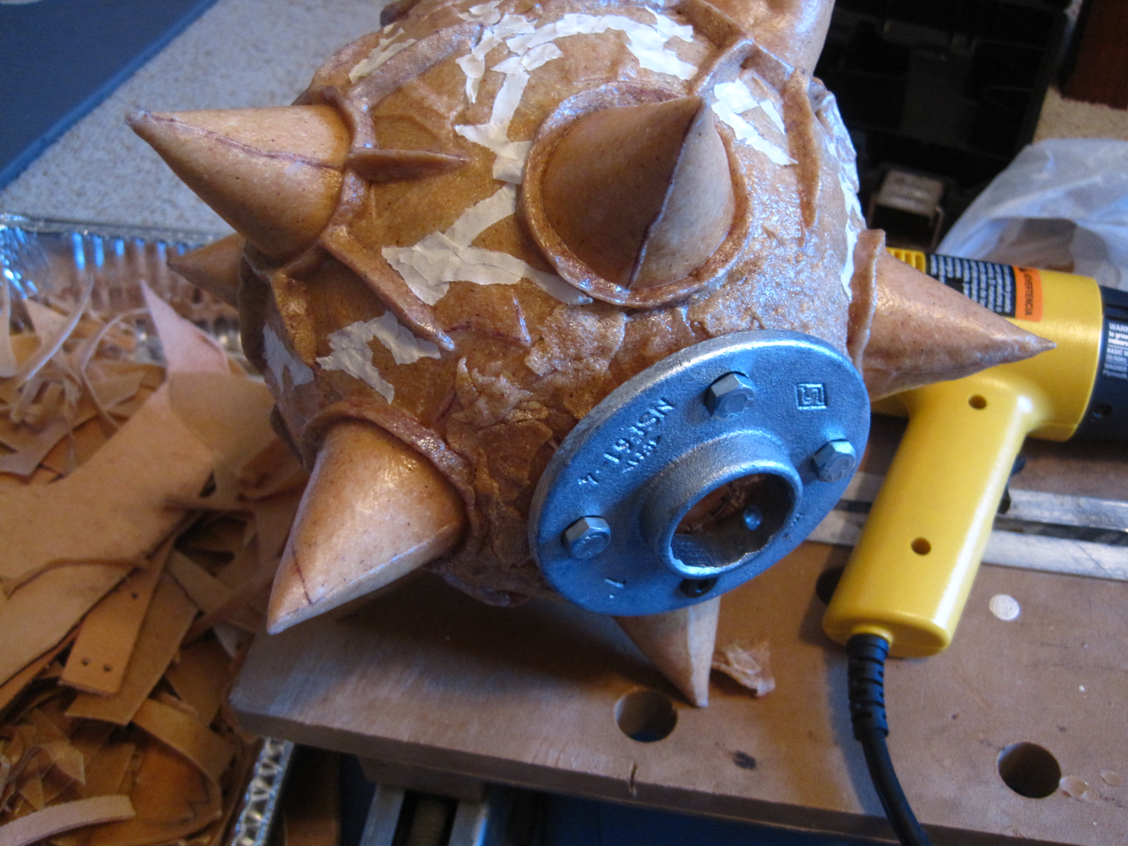

So, a few progress photos below. Earlier I painted the inside of the mace with a cornstarch/glue mixture to help diffuse the light (it works perfectly) and masked off the cracks and fissures in the Worbla so the light could shine through once it was painted. I also added a galvanized floor flange on to the bottom to attach it to the handle. The diameter was a tad too small with the threading, so I filed it off to open it up a bit.

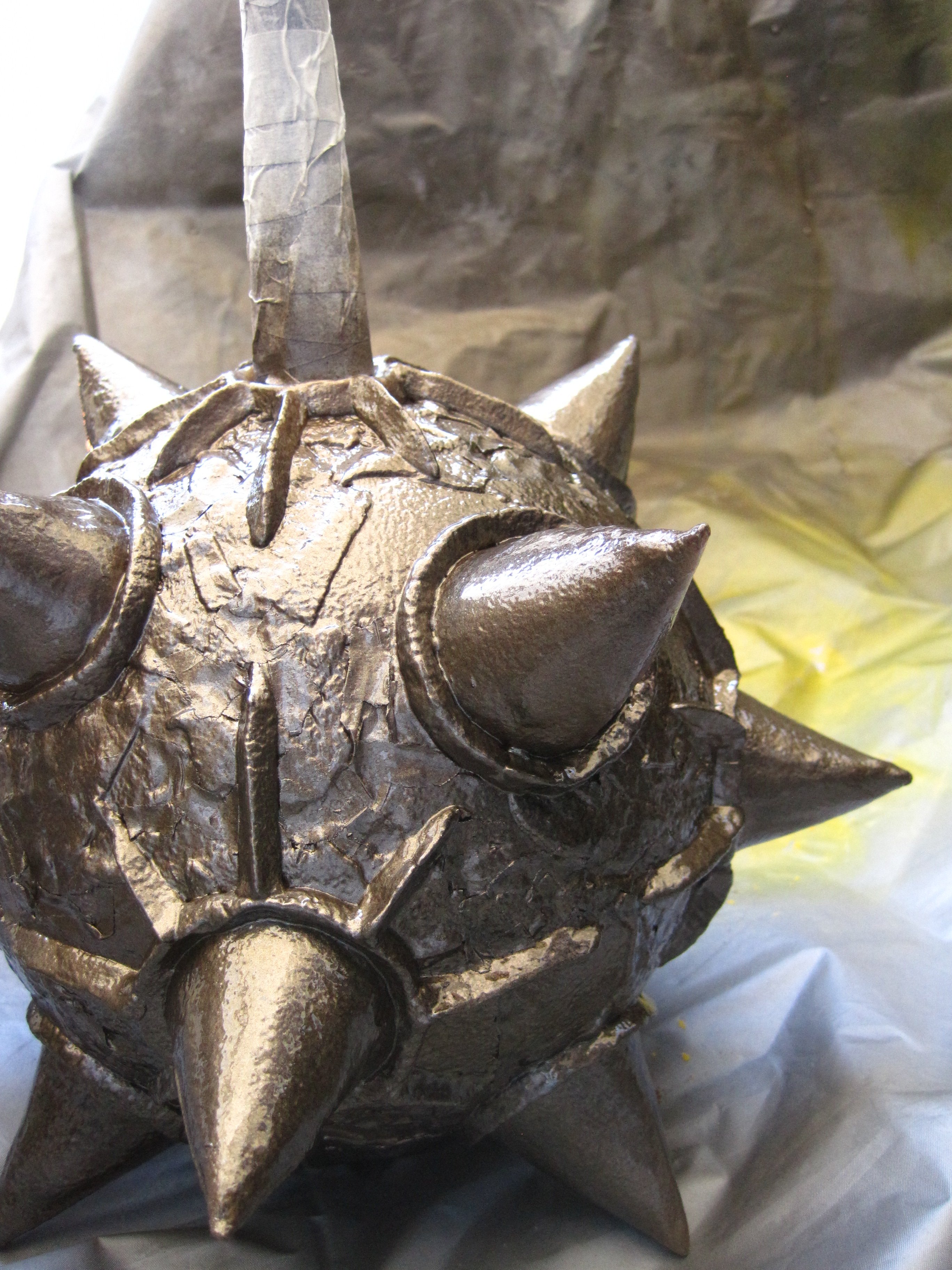

I then gave it a coat of Rustoleum's hammered chestnut...
...and painted highlights and lowlights with acrylic. I edged all of the cracks in silver to help diffuse the contrast. It's hard to tell they're there at a glance.
But oh my gosh, when it's lit up? That light is amazing! Kudo's to @Canobi! This really makes me want to learn more about lighting and circuitry!
