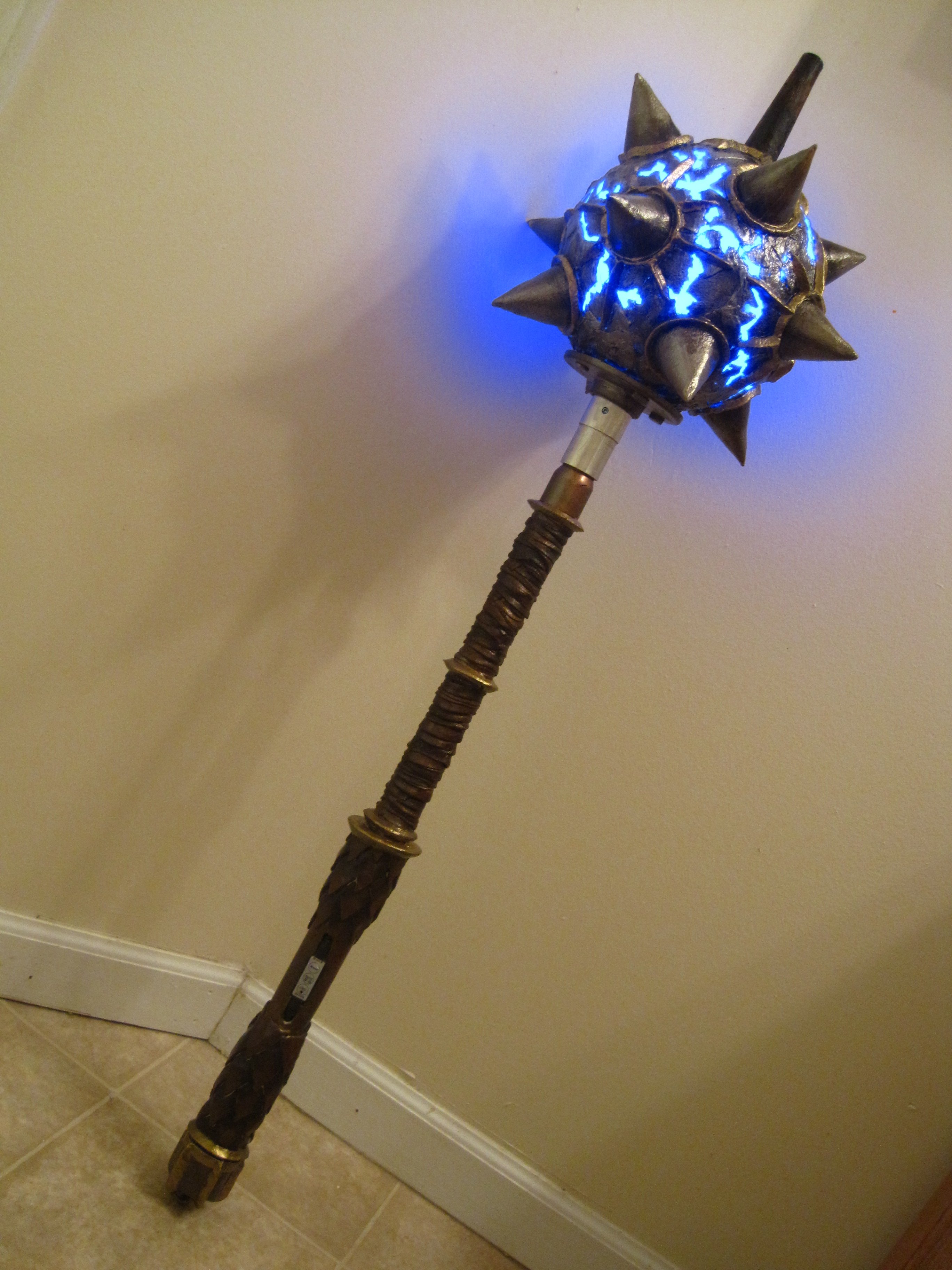

I worked on the mace, and it lights up now. I melted cracks into the mace with a hot iron with a fine tip, so it looks like lightning cracks, and I installed a strobe LED light. I will take a video once I get it all back together and update my thread. Too soon for that now, but maybe I will get to it this weekend.

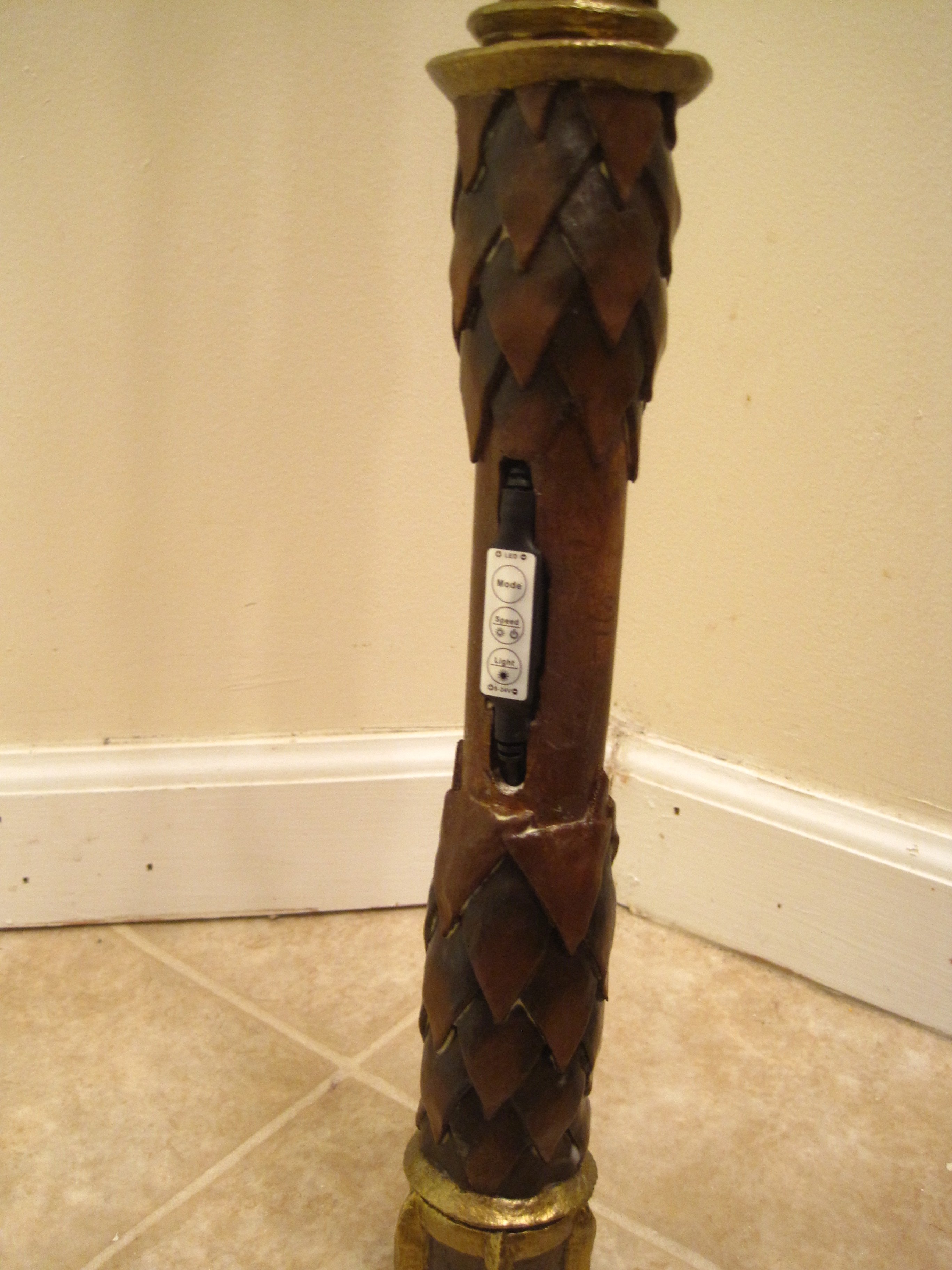

I haven't been super productive this past week, but I did manage to knock out most of the mace handle. It's just two diameters of PVC covered in Worbla. 1" and 1.25"? I forget, but it worked well enough and allowed me to make a small window for the control to sit in. This will be partially wrapped in leather, with only the switch exposed.
I didn't have many ideas for a design, other than scales, so I covered the rest in stringy worbla scraps for a wrapped-leather look.

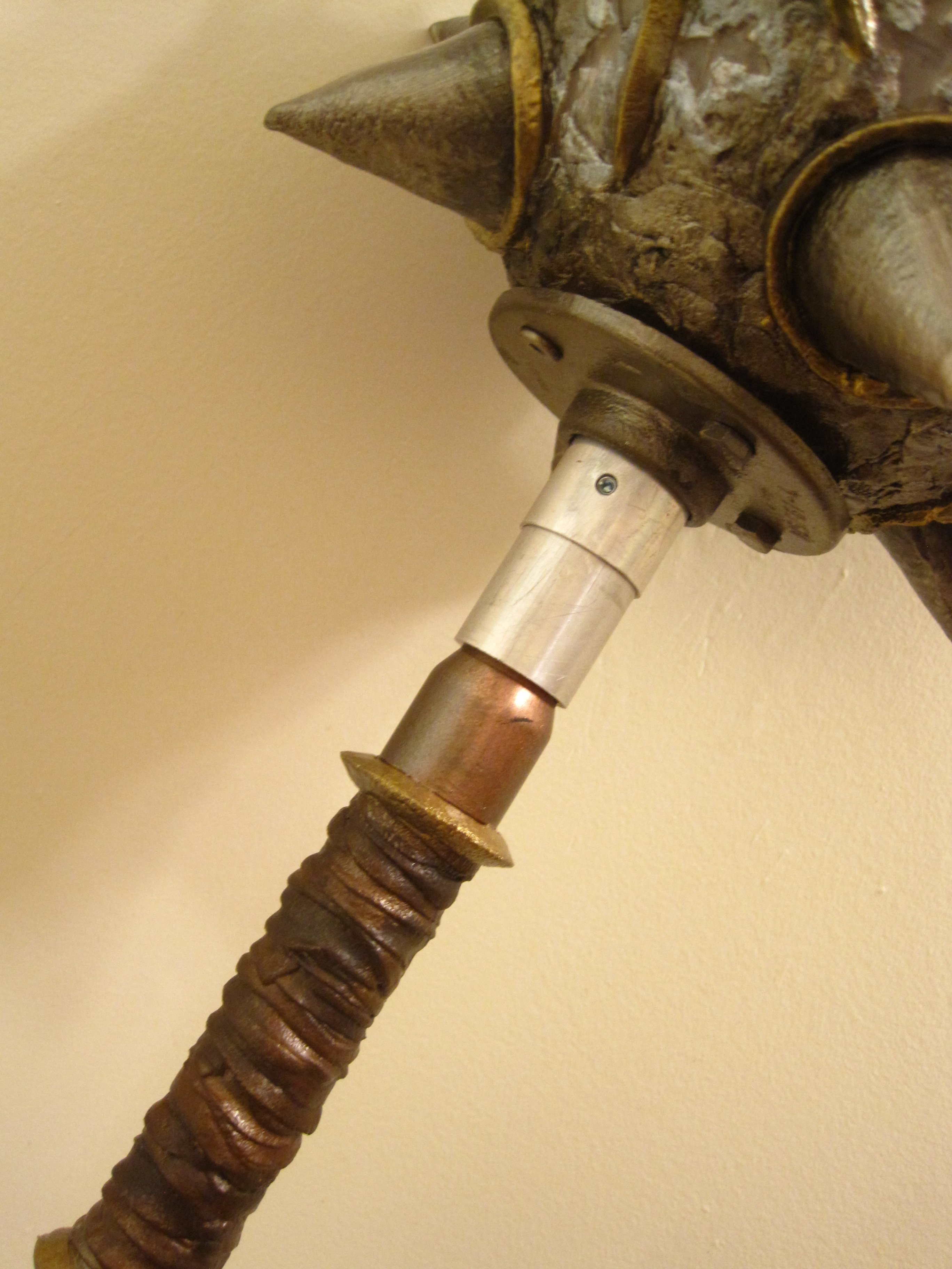

I'm also having some trouble attaching the globe to the light (the aluminum housing). I want to use a threaded insert, or something of the like (set/grub screw?), so I can easily take it apart when needed. Has anyone ever used any of those for metal? Canobi provided me with some nice little grub screws, but I have nothing to tap in threading with, and I have back luck mixing US and metric sizes. I'm currently planning on gluing in a threaded insert to serve the same purpose, but I keep thinking there's a better option out there.
(the aluminum housing will sit further up in the globe and be less prominent when finished)
And finally, what the ******* looks like, all lit up!
attachment.php
I'd honestly love to stick it in the corner as a novelty lamp :D

Hey Spring, did the flange not come with a set/grub screw?
There's always a simple solution, got one forming, I just need to think it out a mo, I'll get back to you :thumbsup

That looks awesome, @Iggy! The strobe looks great with the small lightning crackles, and I love the button on the bottom of the handle; super handy. Can't wait to see it all finished!!

@Canobi: No grub screws with the flange. I bought it locally without giving much thought to how I was going to attach it to the LED (I tend to get impulsive when excited). I did ask around on who could thread a hole, but apparently our local metal shops no longer exist, and that particular hardware store didn't have a tap. Even so, the mace globe is already fully attached to the flange, so I'm not about to bring in the entire assembly even if they could thread it!!

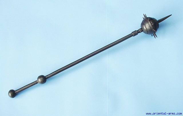

spydrwebz: The spike on the end is a remnant of when the handle went straight through the mace head and out the other side. I had already built the globe before deciding to have a hollow handle, and didn't really feel like cutting off the top design to add another spike. As well, it makes a good "foot" to rest the mace on upside down without damaging it, which is one of the reasons I ran the spike through in the first place. It looks a little out of place, but I saw it first on some historical maces, and thought it looked kinda cool.

OK, so how about drilling a 5mm hole in the side wall of the flange and use a 6-7mm length M5 hex head screw. That way you could attach the handle and flange with the same retention hole.
Aaaand now is where I begin to wonder if you meant to add a threaded hole into the lower end of the aluminum housing on the LED... Because that would make a lot of sense! Unfortunately, there is no threaded hole, so I might check around town and see who has a tap for such things - LOVE the idea of a single retention hole. That would definitely simplify things.
So, I was hoping to get this costume "finished" (mostly wearable) in time to try it out for Kansas City's Planet Comicon, but my wings are still a struggle. I did manage to turn out most of a comfy "backpack" this weekend, made from some gutted backpack straps, a camping pad, and some previously-wasted worbla/wonderflex bits. BUT, my computer is experiencing a bit of difficulty uploading photos, so those will have to wait...
Ahh, I think there's been a miss identification. The grub screw that can be seen is for securing the handle, there's a second, hidden grub screw underneath the outermost tube holding the LED assembly in place ;)
The idea for the flange is to drill a hole the same size as the hex head screw (measure screw head diameter and choose the corresponding drill bit size) which will hold everything securely once screwed down, no need to tap threads.
Here's a pic of my current saber project to show you what I mean. The tube underneath is tapped, but the tube you can see isnt, the screw head is just sitting in a hole:
Yes!!! I feel so foolish now!! I thought that screw held the assembly together, but I see now you installed it for the handle. Stupid moment. Please ignore.
Thanks, Canobi.
Just realised I may not have mentioned it, but the handle retention hole has been tapped for an M5 screw/bolt.
Yes! Thank you! Turns out my hardware store has a large metric section and I ended up finding a bolt that works perfectly. The mace looks spectacular!
