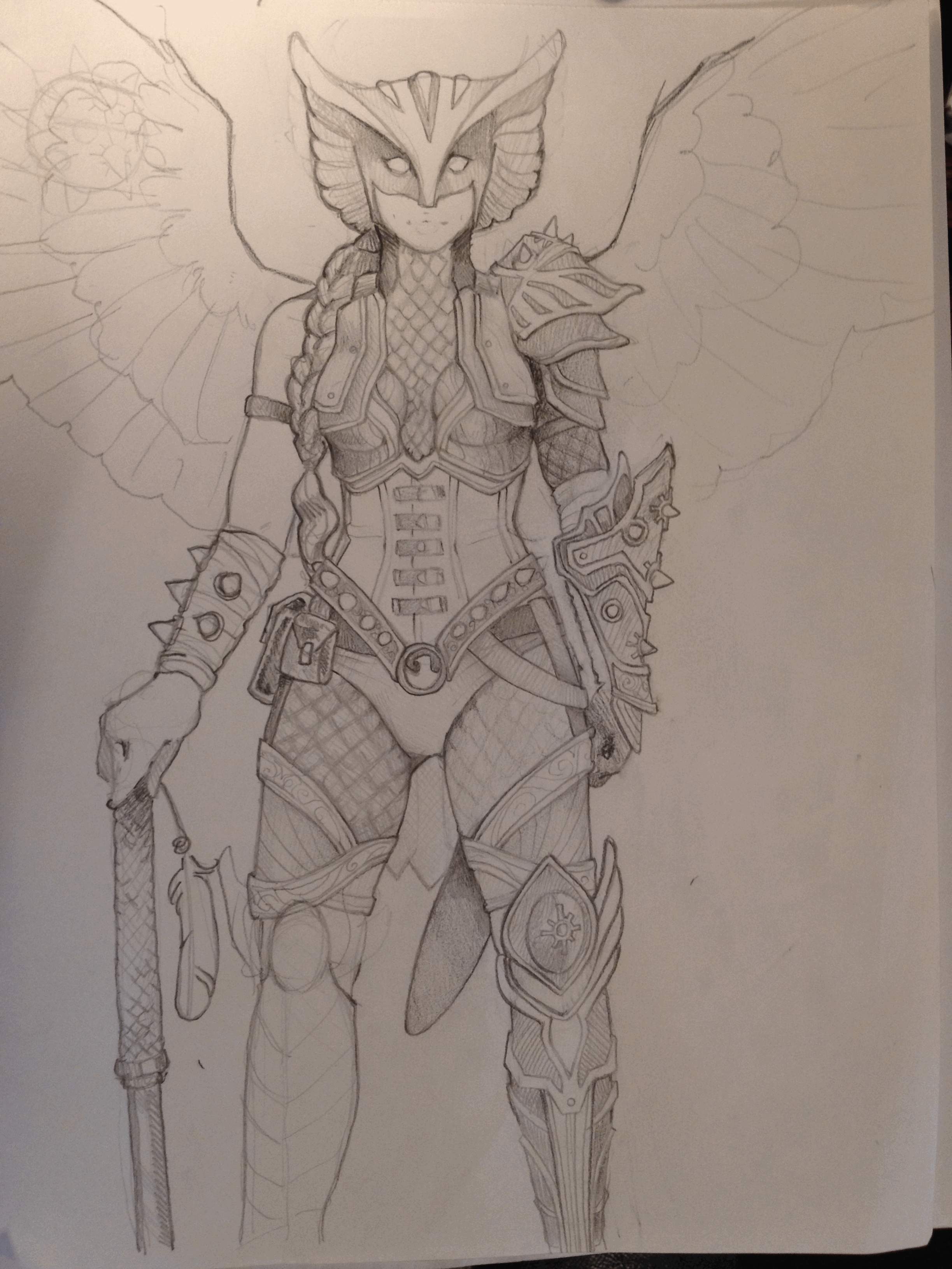

This is the design I'm going for, though I'll likely rework the bracers and leg armor. Materials for the armor will be the standard Worbla + craft foam, and I have some aluminum tent poles to use for the base of the wings. I'm planning to make the feathers out of fabric and glue, likely with a wire shaft. The wings are going to be a challenge!

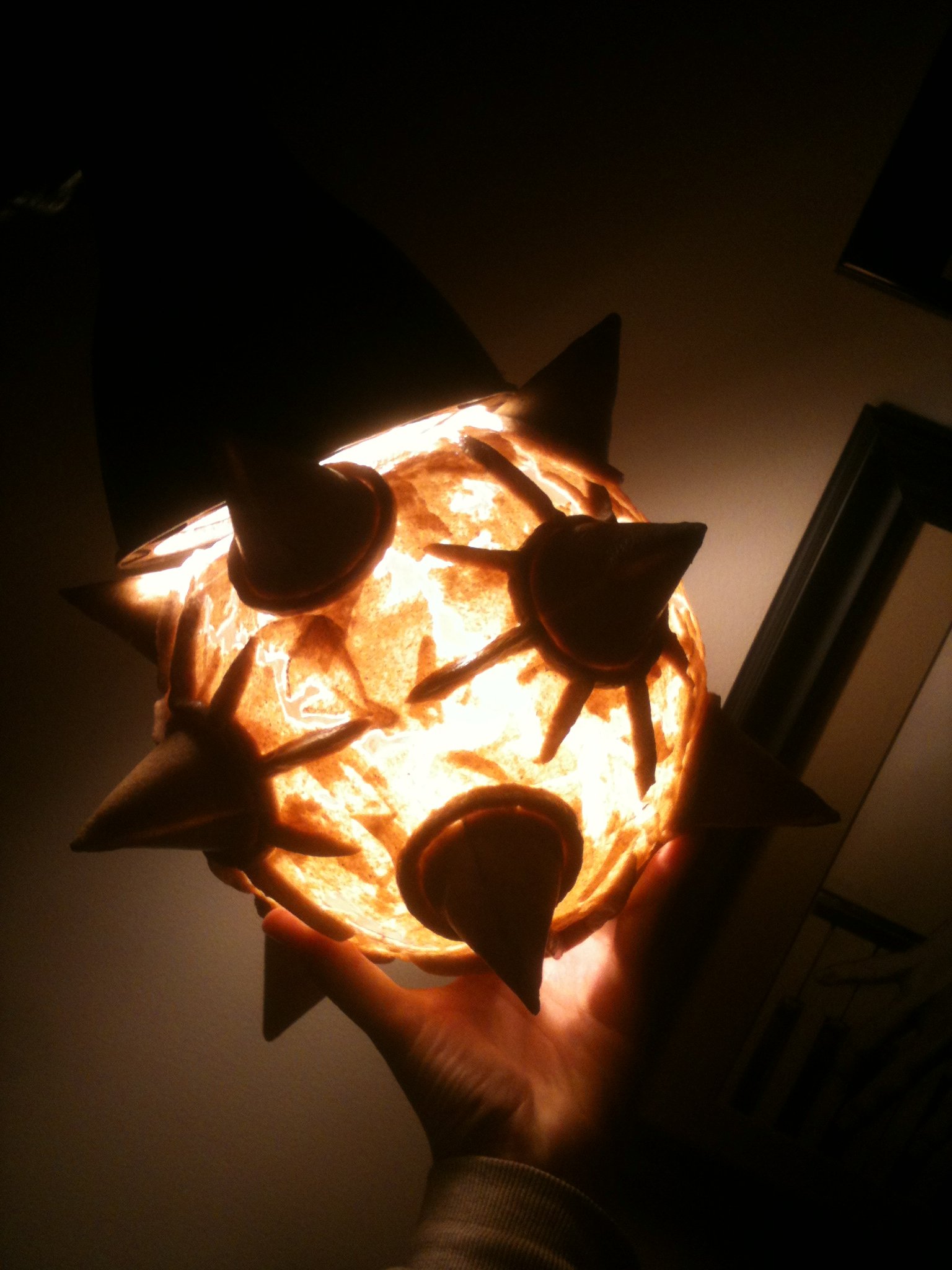

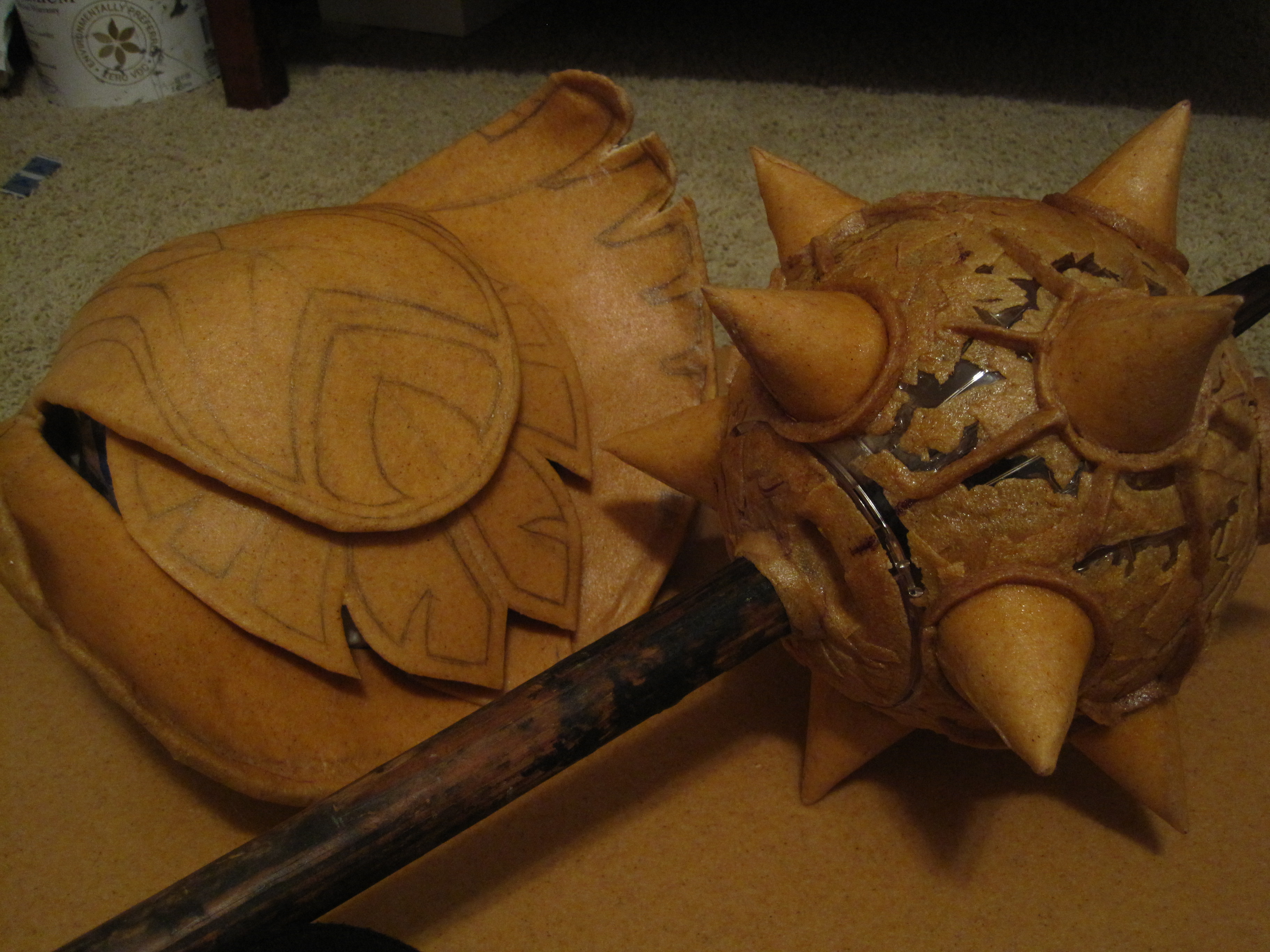

For the mace, I really wanted something lightning-like to reflect the magical properties of the Nth metal, so the idea was to cover an acrylic orb with Worbla, and light it from the inside to shine out through the cracks. However, plastic balls of any and all kinds ONLY come in 6" and 8" diameters. Only. And for whatever reason I just HAD to have a 7" orb, so that's a hamster ball with the air slits filled in with hot glue, and skewered with a rake handle. (What's extra nice about the hamster ball, is that the bottom screws off, making it quite handy for LED installation.)
Then, I covered the ball in bits of Worbla that I stretched and tore to give it a nice crackly edge. The spikes are just cones of craft foam covered in Worbla.

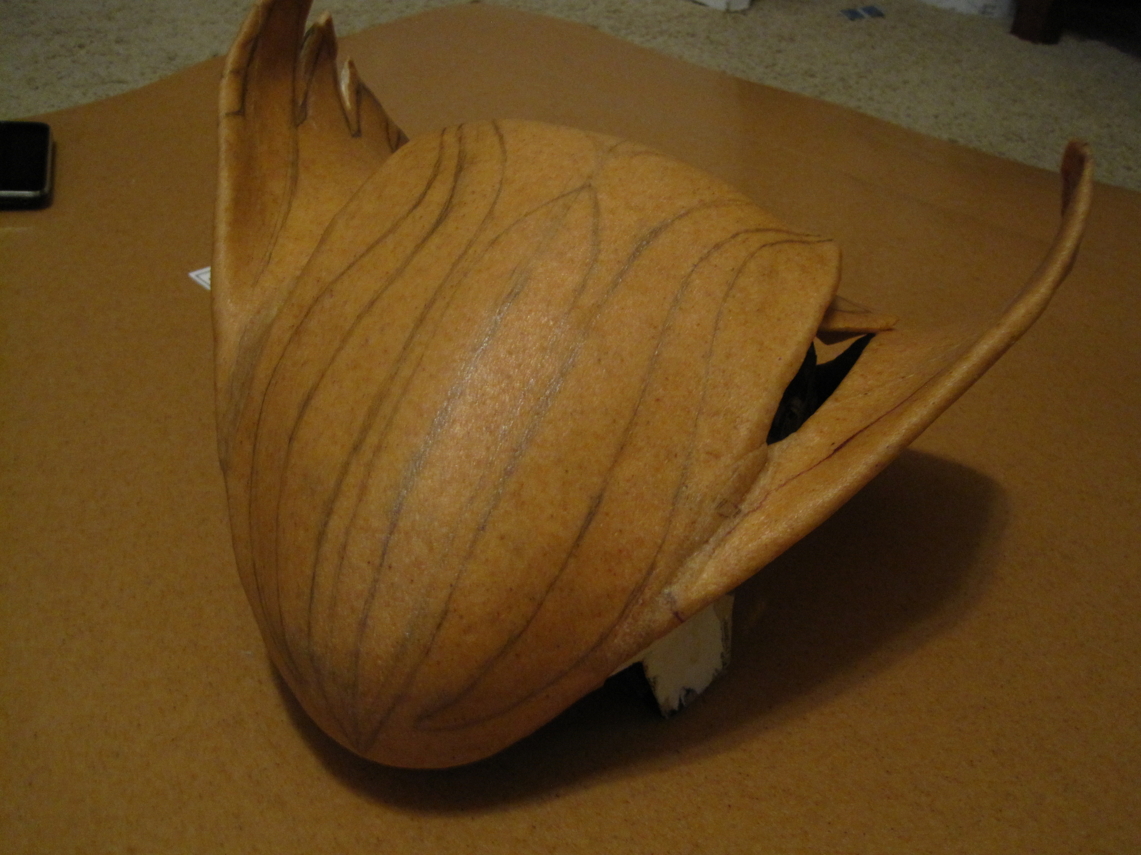

The helmet I'm having trouble with. I started out with this little paper mache number, but really wasn't satisfied with the shape, so instead of scrapping it and starting over, I got hasty and over-zealous and covered the whole thing in 10 bucks worth of Paperclay. Having now wasted $10 worth of Paperclay on a lousy shape, I decided cut it apart and cover it in Worbla. While it's an improvement, I'm still struggling with the front and mask portion.

Also, a little preview of the mace, against a lamp and over an iphone flashlight:

I'm really excited that it glowed that bright with the lights on. I think I might paint the inside with glue/cornstarch mix to diffuse the light a bit (I imagine that might work?). Had I been thinking, I would have buffed it up to reduce the surface shine. Too late now.

Thanks! It's coming along slowly, but surely. A little progress with the breastplate, part of the pauldron, and the bracer:
