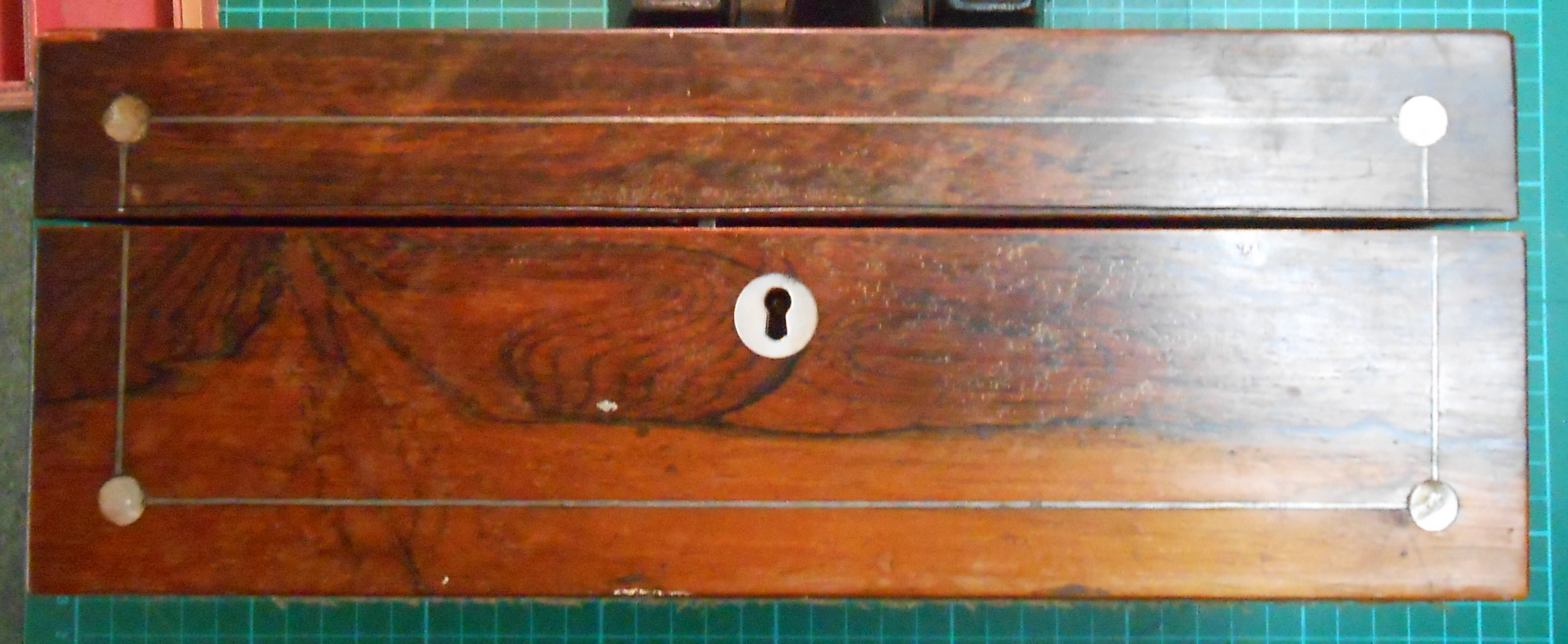

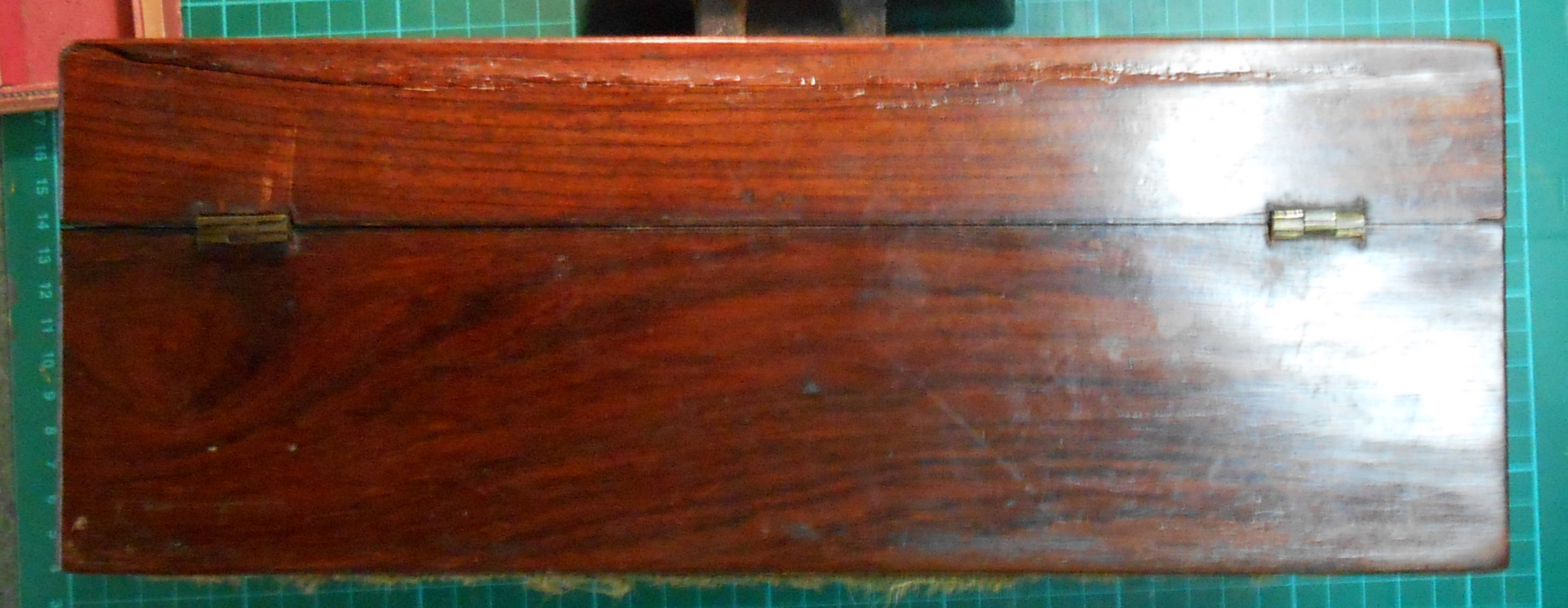

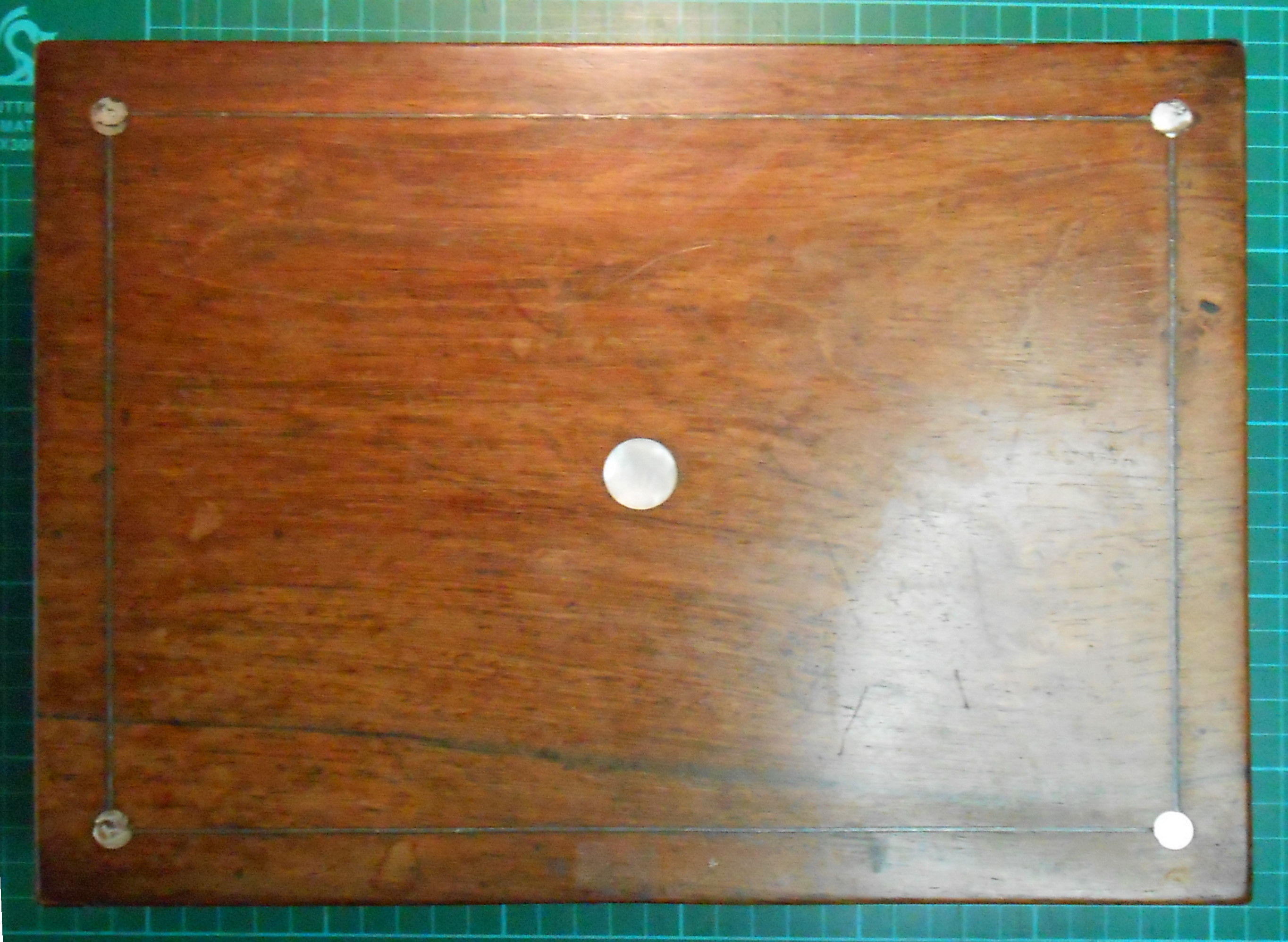

I managed to find the exact vintage box (yes Kenny, we know you made yours from scratch, but this is the type of original that I assume you took your measurements from) without too much effort on the Ebay searching, as the seem to have been a common mass-produced Victorian item (at least here in the U.K.). What was more fortuitous was that the seller was only 4 miles away, and he has at least two more (at the time of writing) that he's willing to part with, in similar condition.
View attachment 492295View attachment 492296View attachment 492297View attachment 492299
As you can see, it requires some restoration work, but at least all of the beading and MOP is intact. It has suffered the common fault of a huge crack in the rear strap of the lid (that's going to take the most work!), but a little fresh shellac and t.l.c. will soon have it in tip top condition again. I'll keep you posted on the progress. The replica lining is no problem - I've done that before on another project.
Now to the measurements I promised. I will quote Imperial fractional inches (and millimetre approximations in brackets):
10 and 7/8 " (276) by 8" (203) by 4 and 1/8" (104). The bottom/lid sizes are 2 and 11/16" (68) high for the bottom and 1 and 7/16" (36) high for the lid. The walls seem to have been made from two thicknesses of wood: sides are 29/64" (11.5) thick and the front/back are 1/2" (13) thick. The lid plate is 13/32" (10.3) thick and the base plate is 7/32" (5.55) thick.

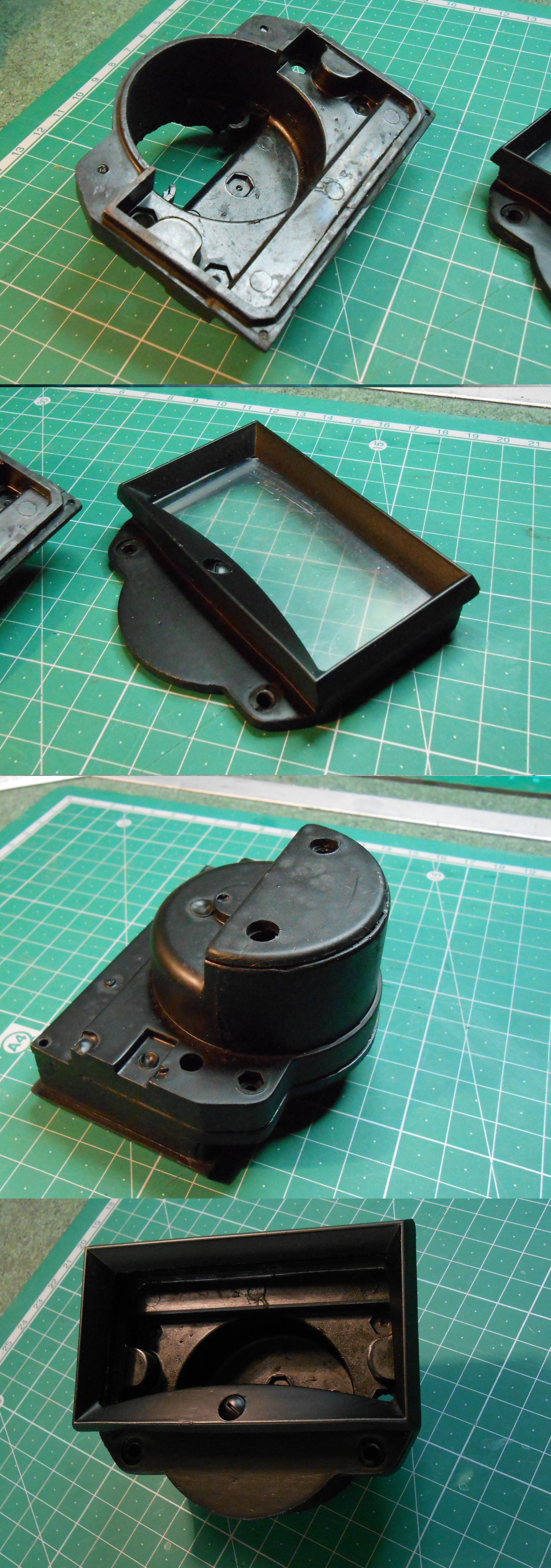

I've been doing bits and pieces toward finishing my pistol, and most of my progress is on Tumblr (see a few posts up from here, if you want to go and have a look at it). I've been trying to master the art of resin casting amongst other things, and thought I'd share here the results of my casting the API meter casing.
I'd already hacked apart the original old one (non-functioning, before people cry 'heretic'!) and retro-fitted a contemporary volt meter inside it, so I could see how charged the LiPo cell in my pistol was. Then it occurred to me to take a set of master moulds from it before I fitted it once-and-for-all in the presentation case. So I ripped it all apart again and set about pouring some silicone.
Here are the resulting resin castings.

What is the outside dimensions of the front on this meter? I've noticed a number of VU meters out there with different (larger) dimensions.
Thanks.
David
The oblong bezel is 88mm x 50mm (72 including the semi circular part at the bottom) That's roughly 3.5in x 2in (2.85) in imperial.
Whoa! Those are pics of the castings? They look like original parts. Nice job.
They are indeed the copy castings. I can now keep the original meter for future use.

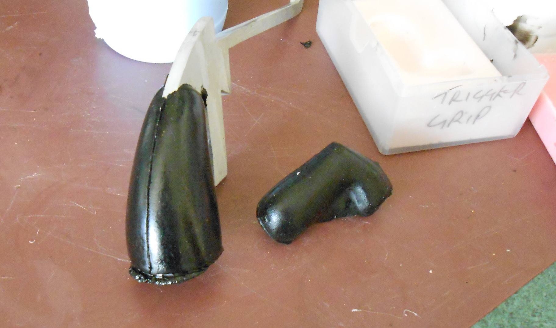

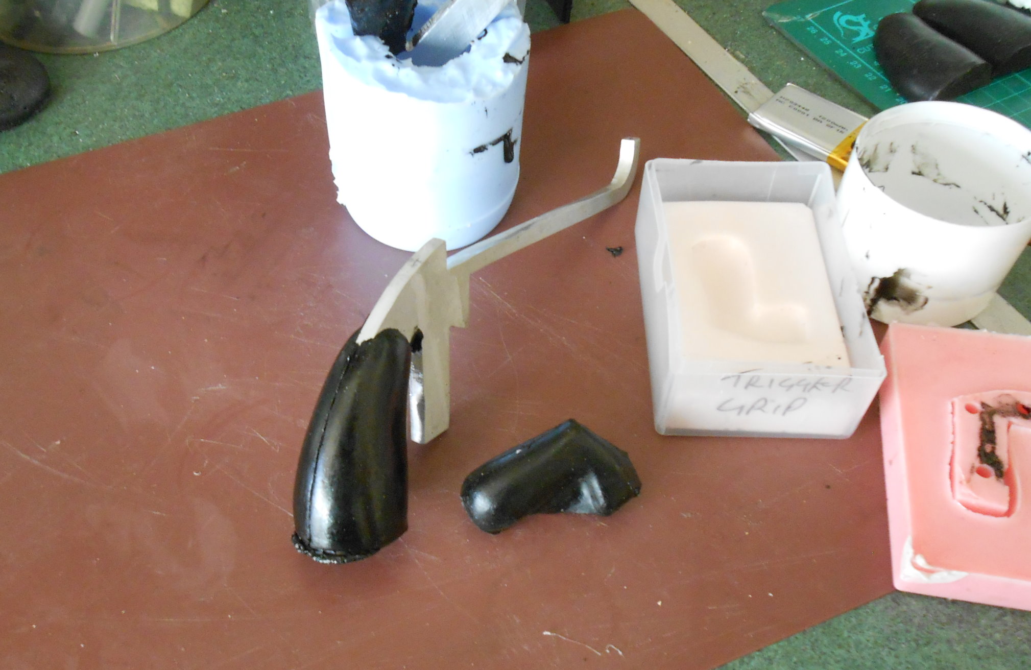

I've also been having fun with some P.U. foams. I made clay masters directly onto the alu frame, then made silicone moulds from them. You can see the jig I made from an old plastic bottle, to hold the frame (minus the clay parts) inside the silicone mould, and cast the foam directly onto that. The trigger guard I could cast in a simple two part mould. I've created recesses in it to house a proximity switch and a micro push button, so I can later use these to power up the pistol and activate the firing sequence of the main tube. You can see the whole pictorial progress of how I did this, and all the other parts of this Tesla pistol project, on my 'Tumblr' page.
