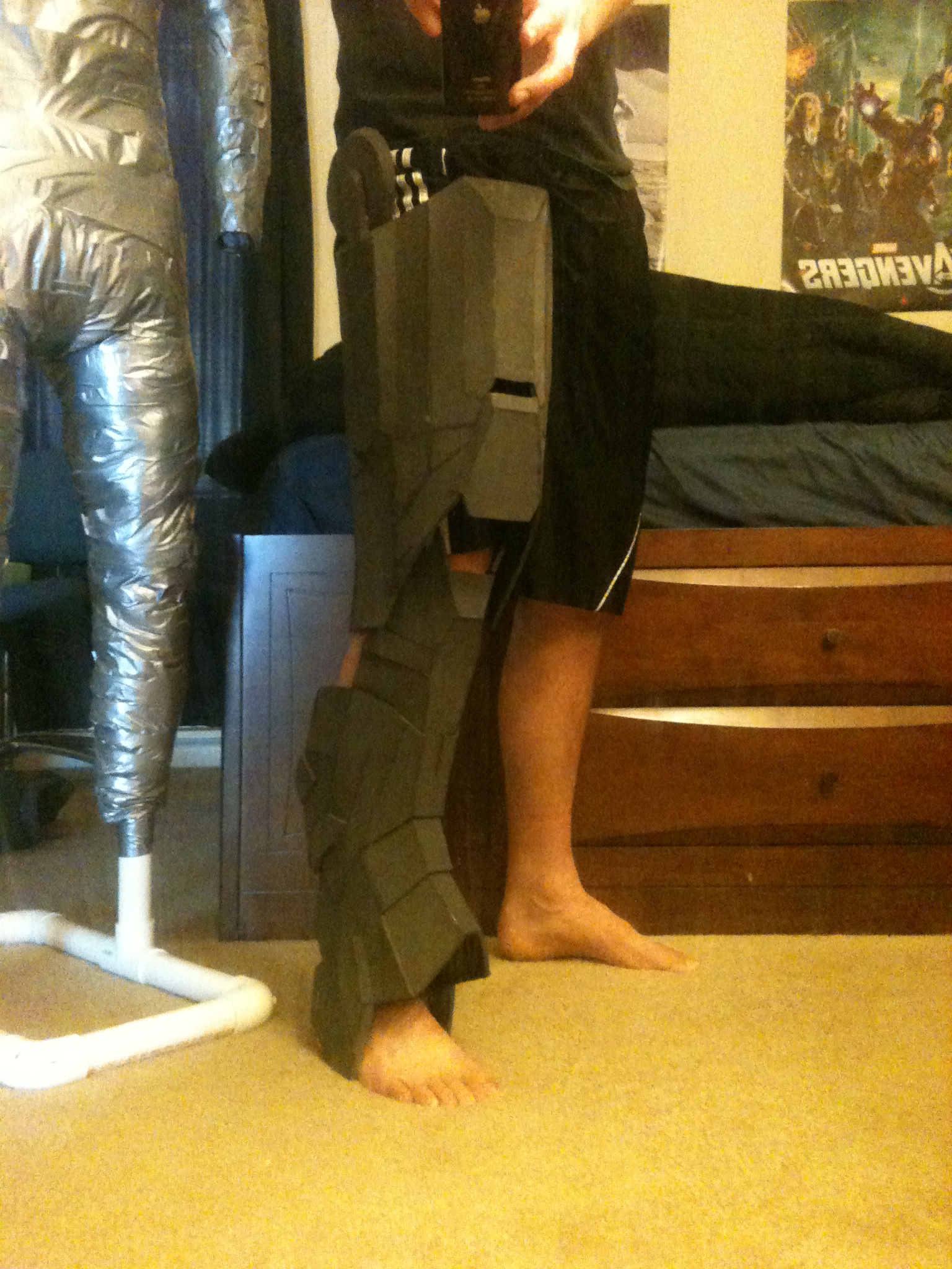

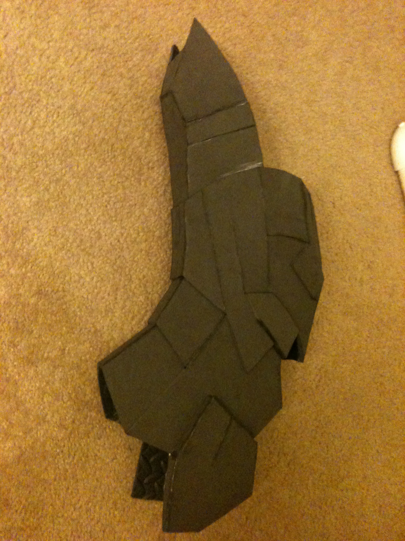

Another set of progress pics. I'm not completely done with my suit at the time of this post, but like I said I wanted to segment my progress pics until where I am at currently :p
Posting updates and getting closer to where I'm actually at in my stage of suit development. Below was a update photo from a few weeks back. Leg pieces are kinda low in this pic because I'm just wearing them with friction. I hadn't made any strapping system for them yet. Also pictured was a fail War Machine Helmet I made from an HD paper pepakura 100 lb card stock setup. It ended up being BARELY too small, so I decided to make the foam version after that slight mistake, to kinda make it match the rest of my setup anyway. Also pictured temporarily, because I didn't want to "look" gloveless for the photo, I'm wearing my Burton snowboarding gloves here lol. Actually doesn't look too bad for the photo, but obviously will not be using them for the finished product haha.
Here are a few more progress pics:
