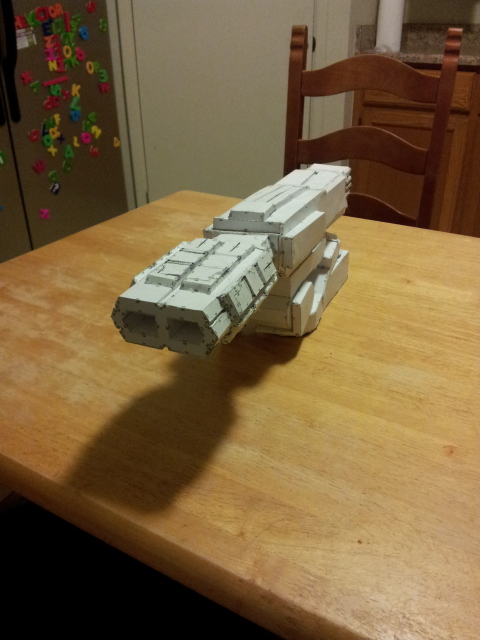

here half of the cannon....maybe ill finish the other half tomorrow...
You are truly a master pepper. That barrel is a nightmare to do too, because of all the fine details. Seriously, master pepper. :thumbsup

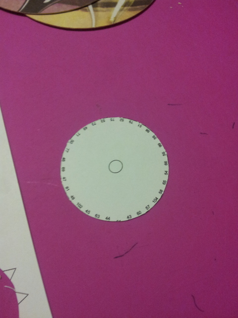

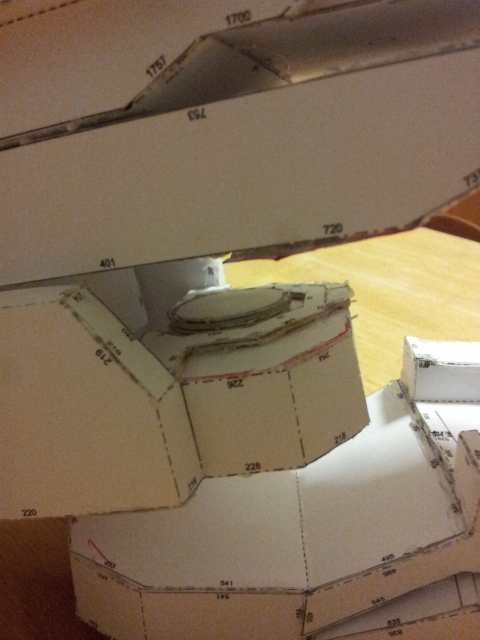

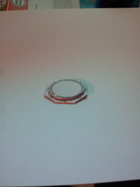

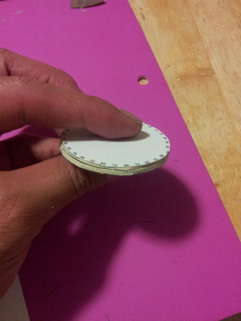

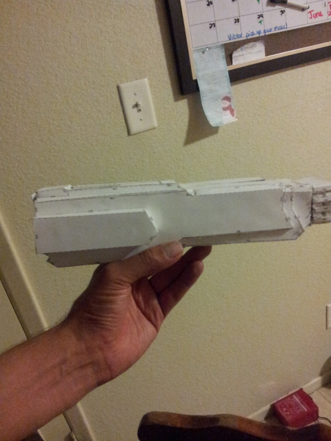

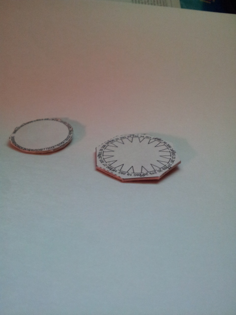

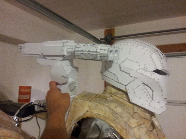

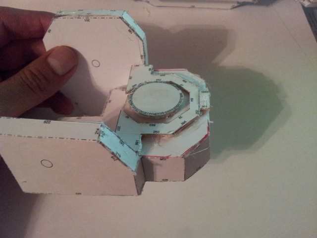

ok now I'm almost done with pepping my IP cannon but i noticed its not inverted..like in many or all pictures..so i suggest you invert it..i might do that one part only to get it tight..here are some pictures..i also cheated a little..in some spots the pep its close to impossible..i didn't want to mess with it so i got some coasters that i had from my work and made some parts with it..well here are some pictures hopefully they talk for themselves..I'm not an expert on thus but it sure help and reduced some time..is not deformed either..well kinda..lmao..but its more solid..lol..

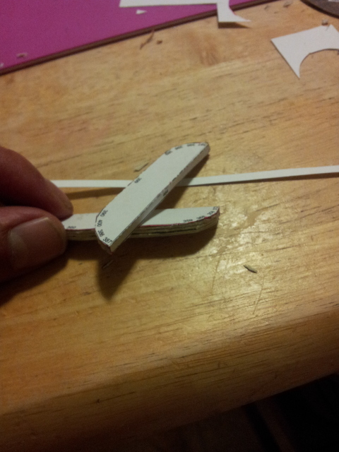

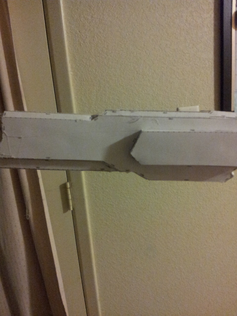

here is another piece i made instead of pepping..lazy me..lol ..

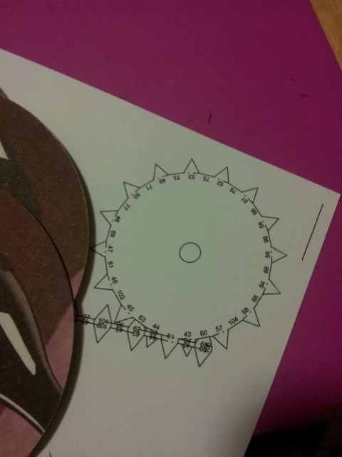

sorry forgot to post these..herei s how i cheated a little..lol

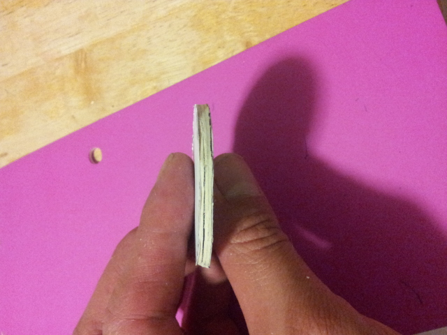

first i cut out the part..then glue it to coaster..glue the right amount of coasters together depending on thickness you want then cut and clean up edges..

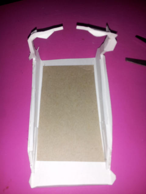

first picture i put some reinforcement inside
Now that's a cannon. Just amazing work Don. This build is going to be right up there with the masters, where it belongs...GM
Beautiful work Don. I'll be the first to say that the pep is EXTREMELY difficult to follow spot on, some of those gaps are only millimeters. You have by far done the best pep I've seen. (y)thumbsup
As for the inverted file, I'll take a look at it. Facing the cannon from the front, the millenium falcon-shaped side plate should be on the right side.

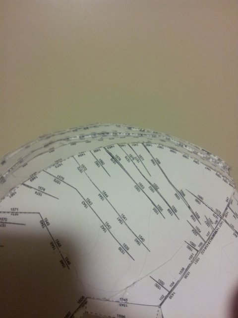

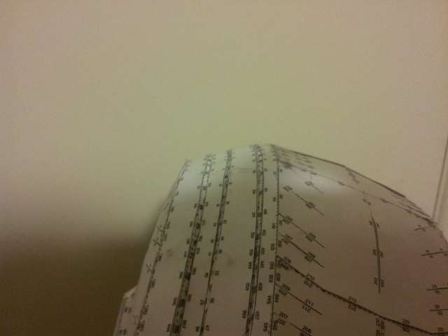

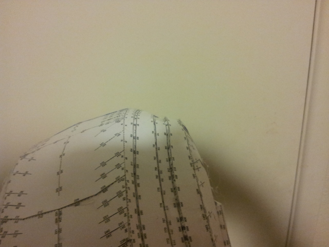

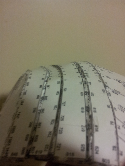

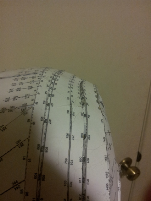

here's a little tip for those who arerockies at pepping like myself...sometimes when you glues it doesn't come out right three first time sometimes you don't have to start all over.the good thing about hot glue is that you can fix it..hers some examples..i pepped my helmet and some parts out didn't look right..so i went ahead and reprinted those parts and glued them over thin cardboard..i used a shoe box..i recut it then used lots of glue to melt the old glue and you fix it and Arty the same time it makes it harder so resin won't make it sag..
here's some pictures before..
now after you cant tell much by pictures but it rounded up the helmet..
cannon almost ready
