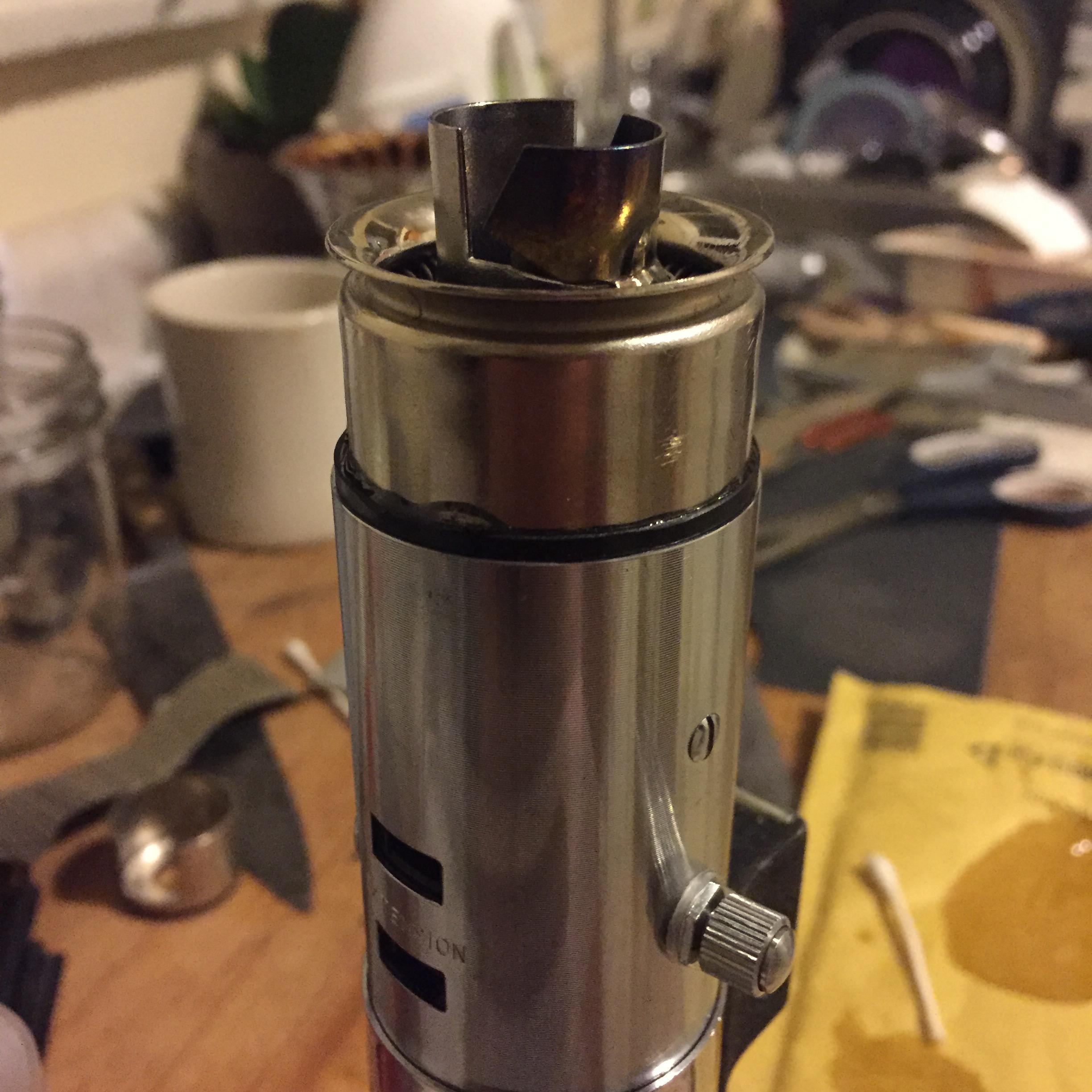

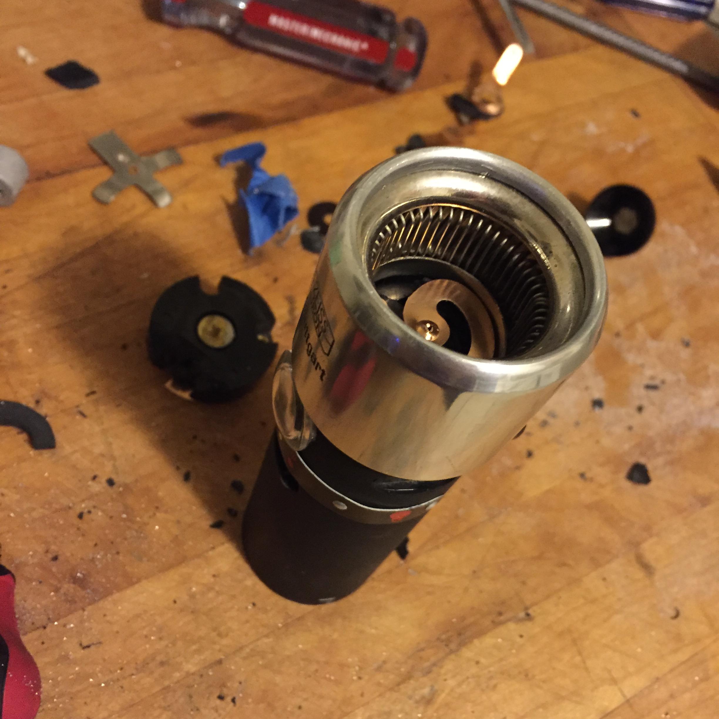

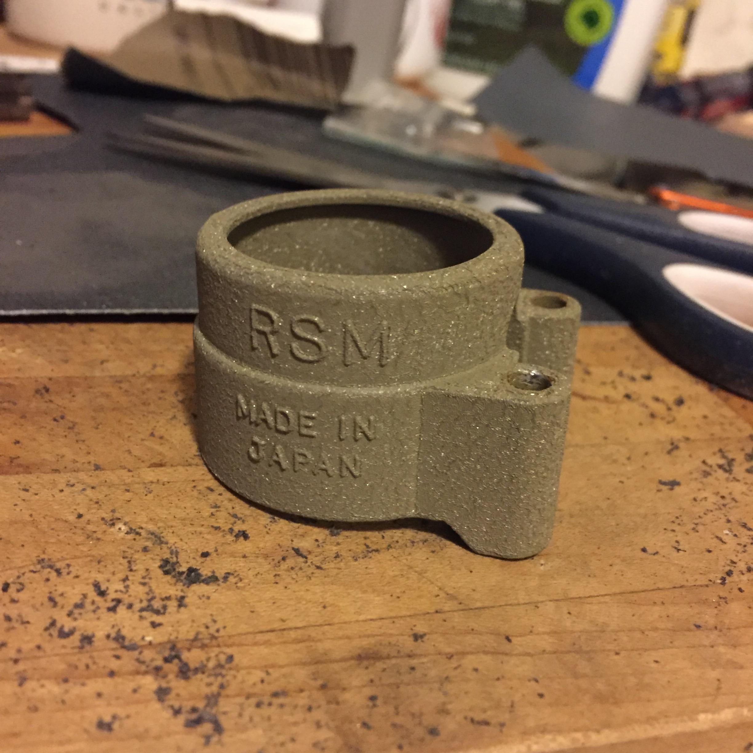

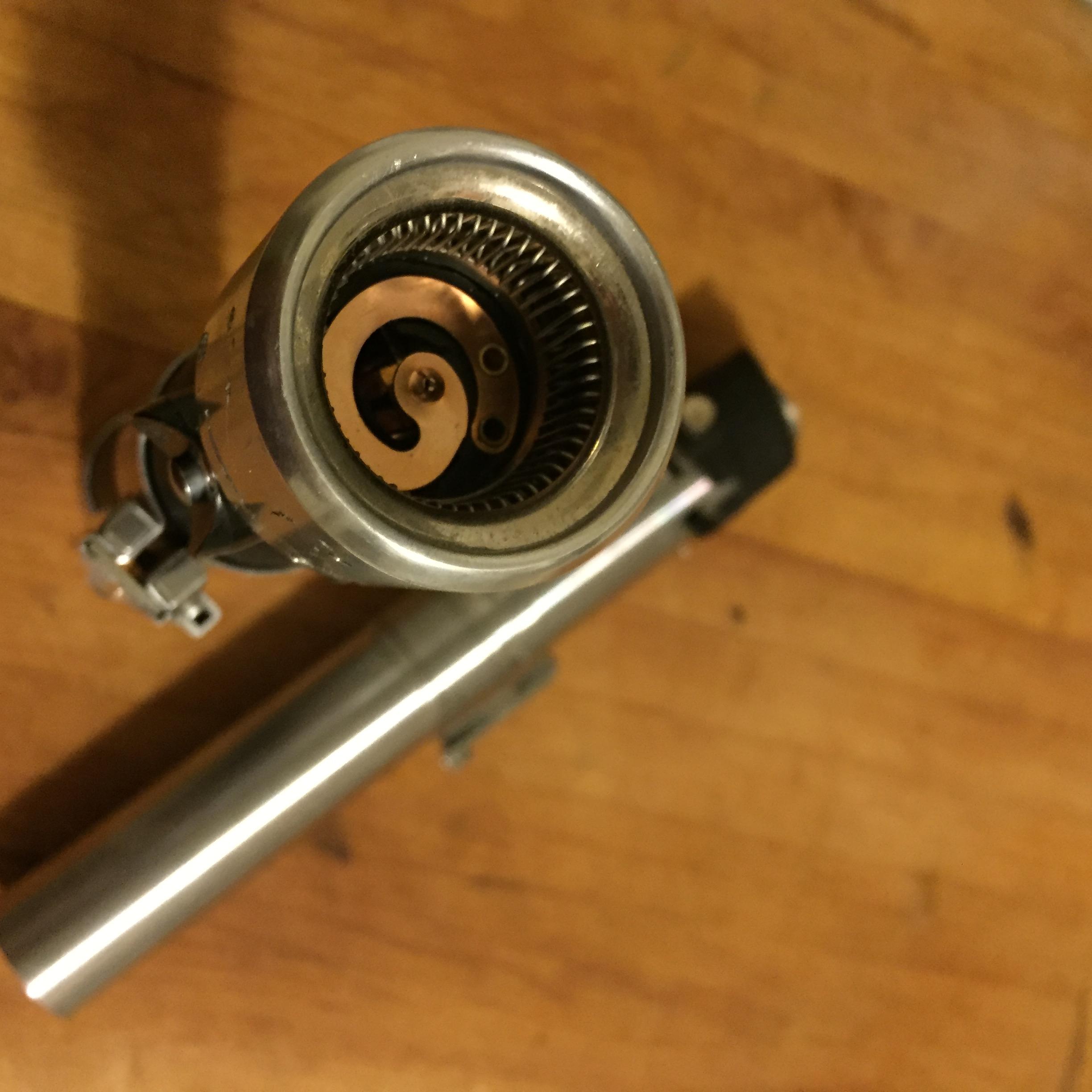

Then I turned my eye to the Zeiss Ikon. It's really light and made of aluminum which is kind of a bummer. It doesn't have the heft that I think really helps sell the feel of a saber. Nonetheless it has some cool features, and I've seen some great builds with them. I started by trying some of the leftover bits from the abandoned Canon shroud, and while I eventually came up with something that was okay... I decided to go another direction. So I made a mess and knocked the guts out of the Ikon. Unfortunately the way I did this mean that I lost that horizontal switch. Buuuut once I got the internals out I chopped them up and stuffed them along with the guts of the Heiland (well, half of the guts - I had to hacksaw them in half to make everything fit right) back inside
Oh yeah, I also had to cut the thing in half because I didn't have a punch long enough to drive it the whole way out of the normal flash. So I said welp since I've done it anyway, I guess I'll notch it for a GRAFLEX flash. Now, I only have a hacksaw and hand files so have mercy on me for the next photo:

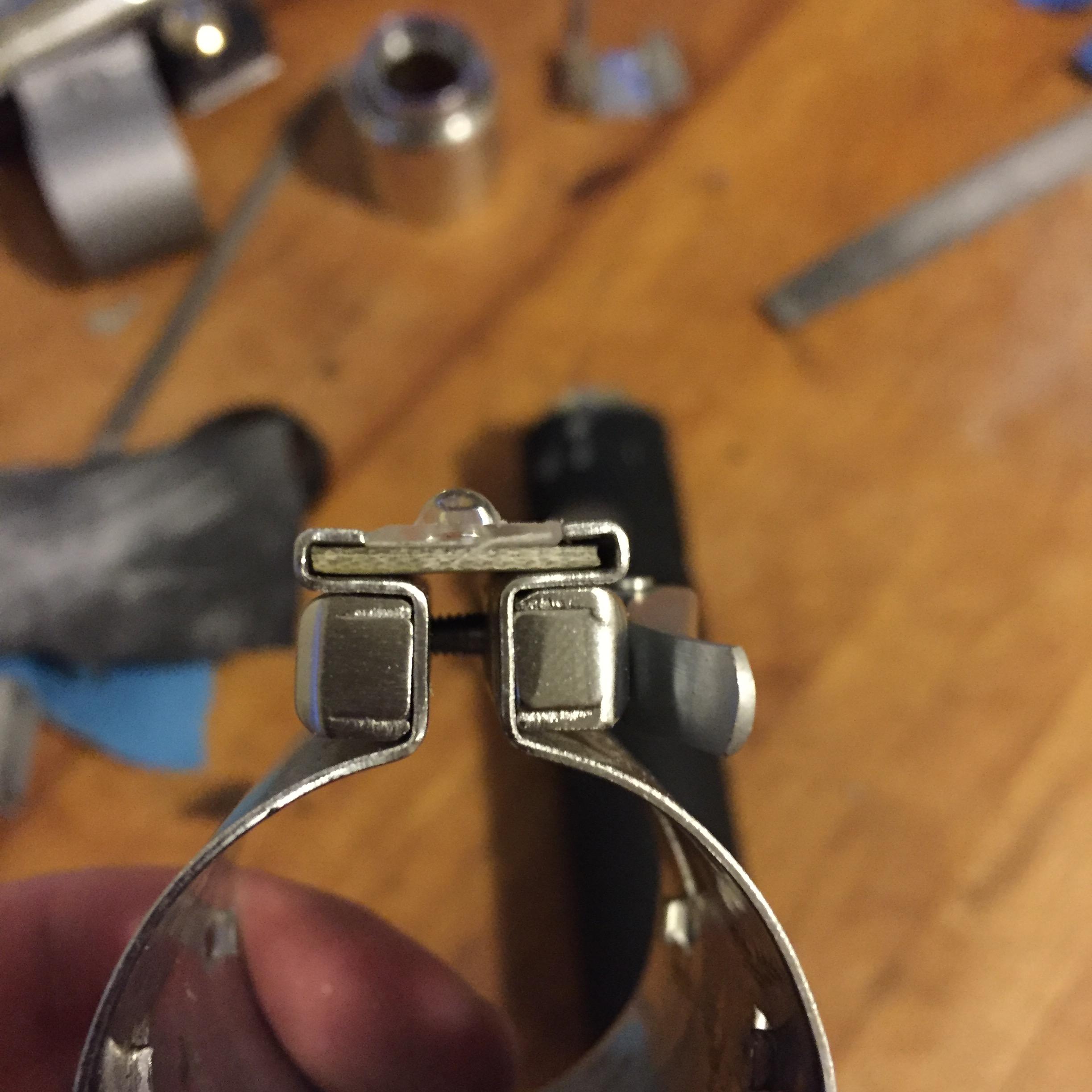

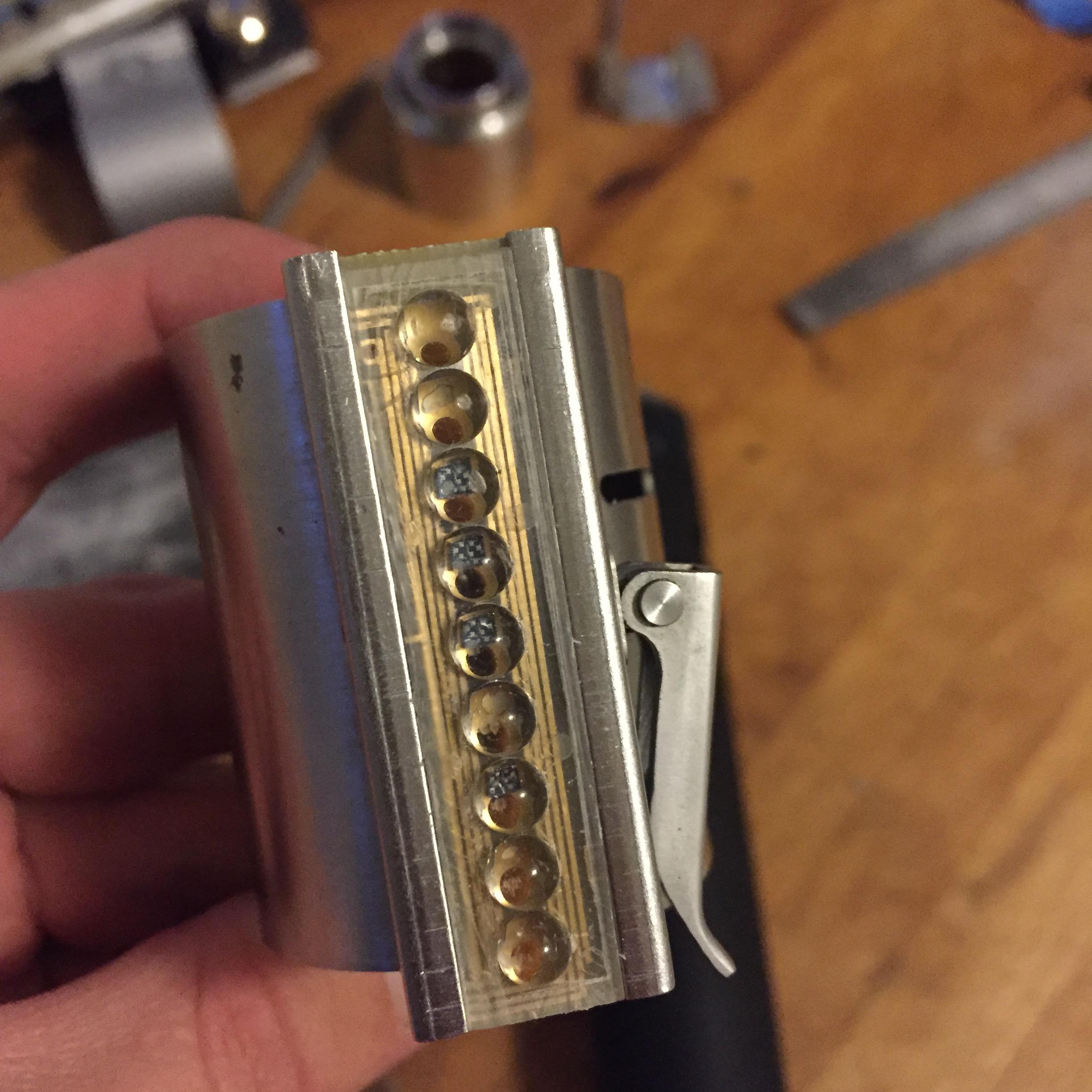

They're hideous but they work! I took the bubbles and underlying circuit from a calculator I had lying around (I think it was a Novus). It's the right length for a GRAFLEX clamp, but the bubbles are small. Still looks cool, though. With a little work I got it fitted, although I lost a couple of the diodes from rough-handling.
After that I decide to call it quits. That ended up being way more involved that I thought it was going to be. here are some photos summing up everything from today.The Canon is making me really happy right now. The Zeiss... I don't know it still has kind of a Home-Depot vibe to me. I know I'll sort it out, but damn if that Canon does sit right at home with the GRAFLEX sabers. I think seeing it like that I'm going to throw some T-tracks on it add a d-ring, maybe some wires and call it a day. The Zeiss I'm going to have to brainstorm a little more. Still, I think it's showing promise.

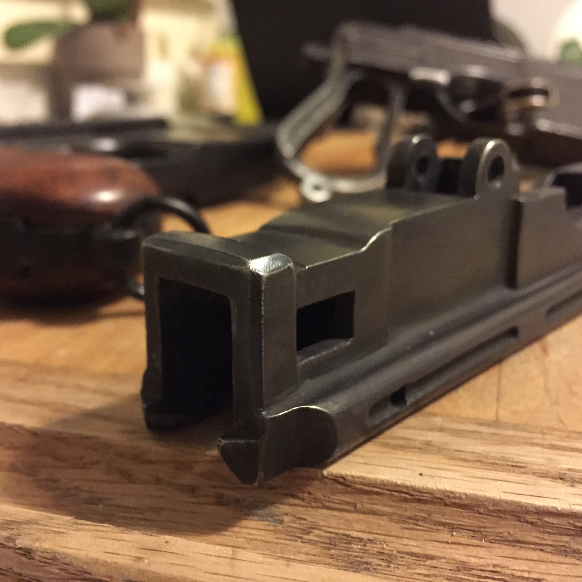

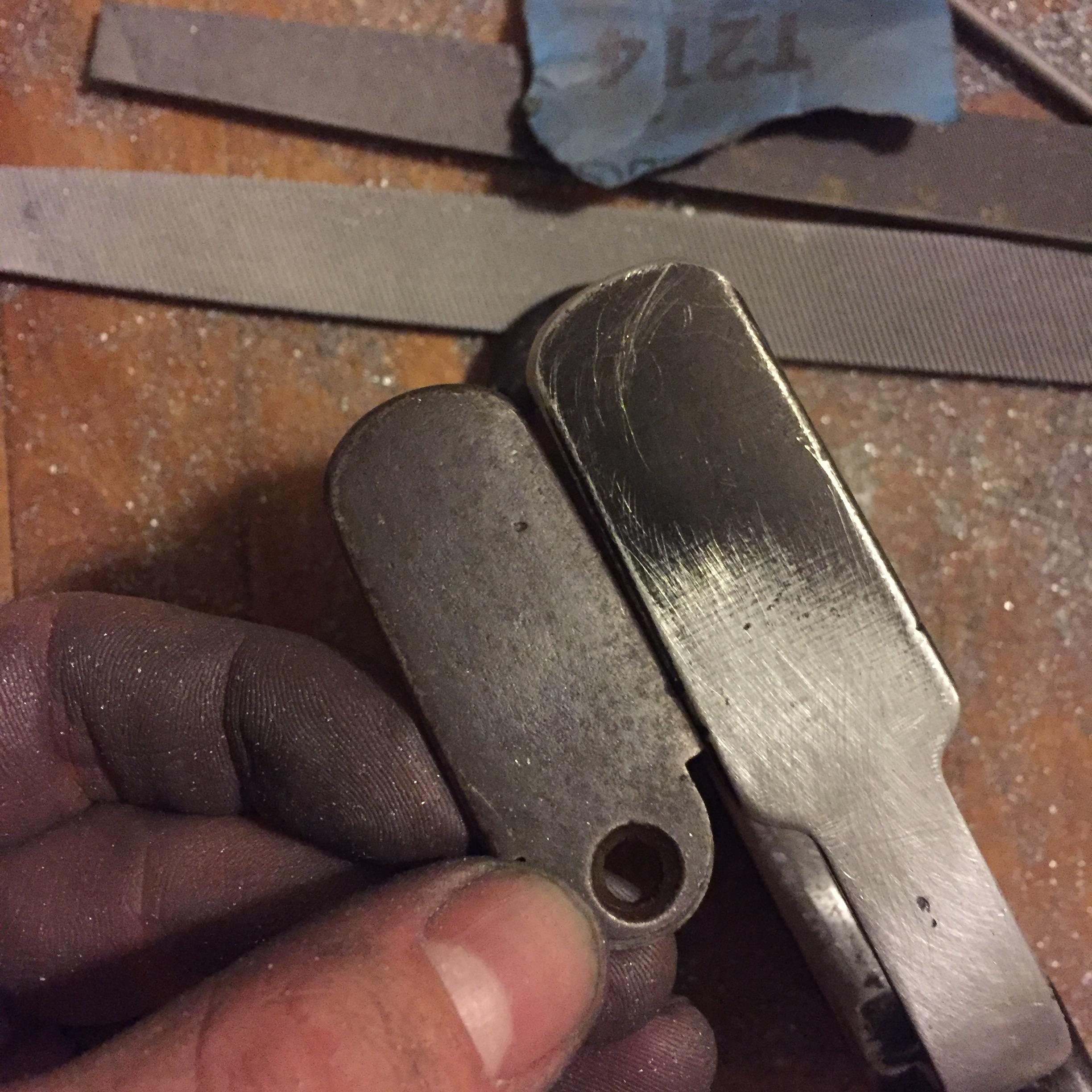

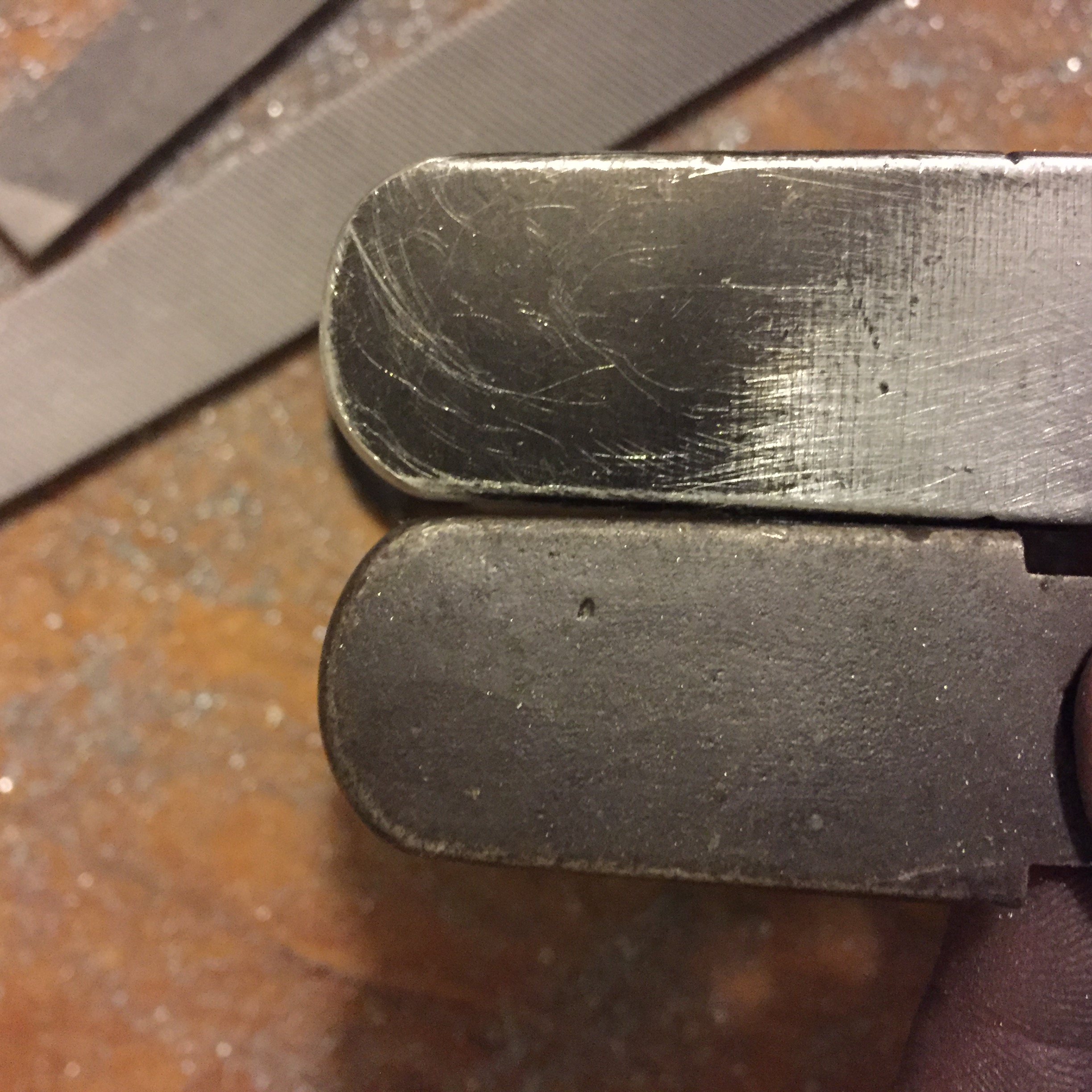

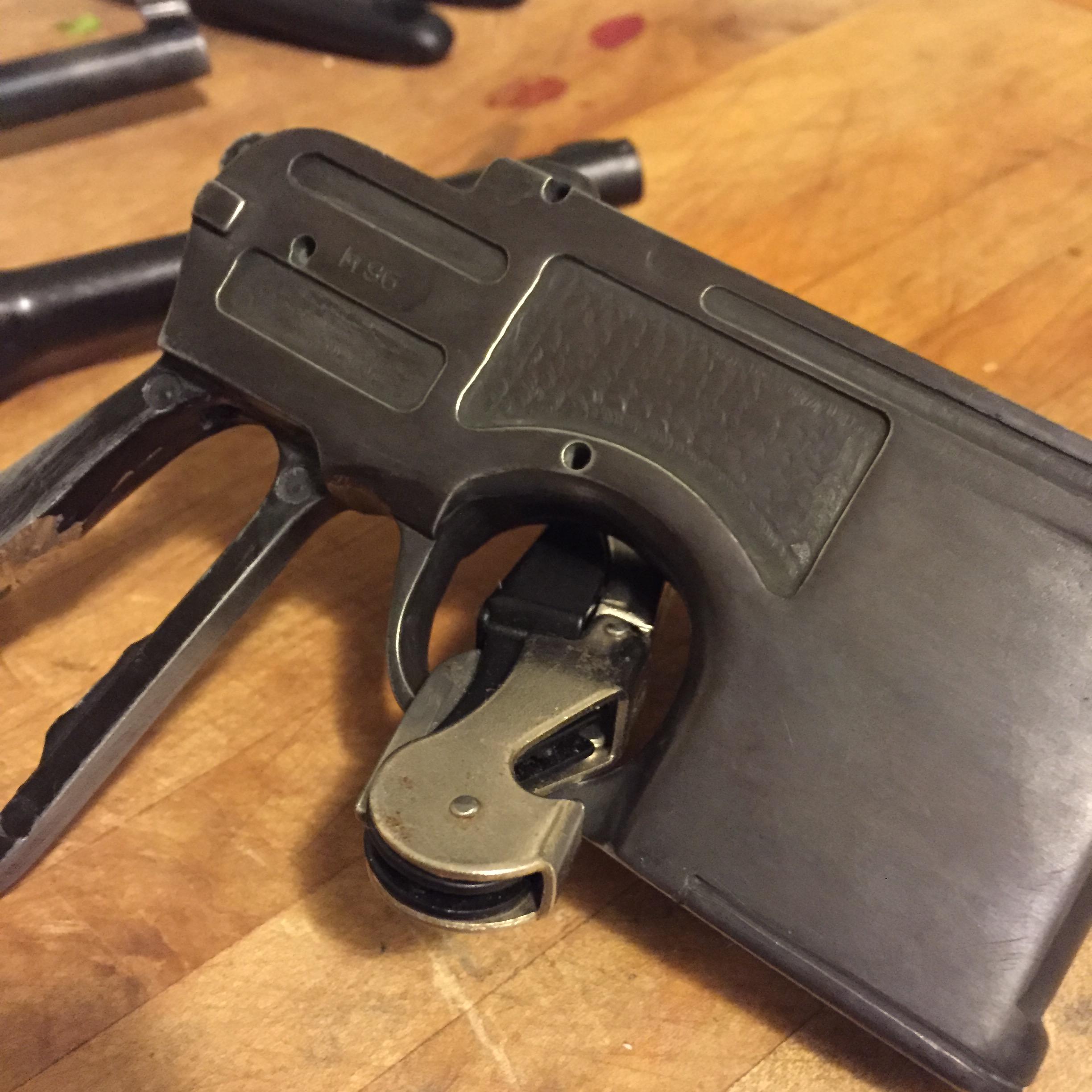

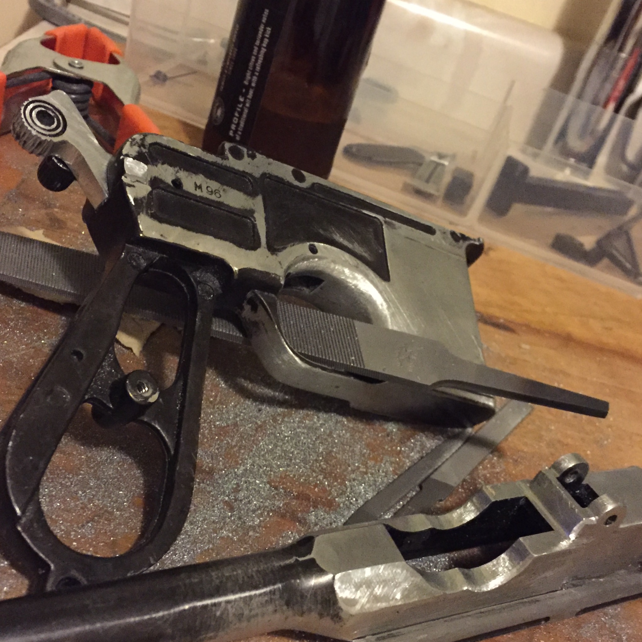

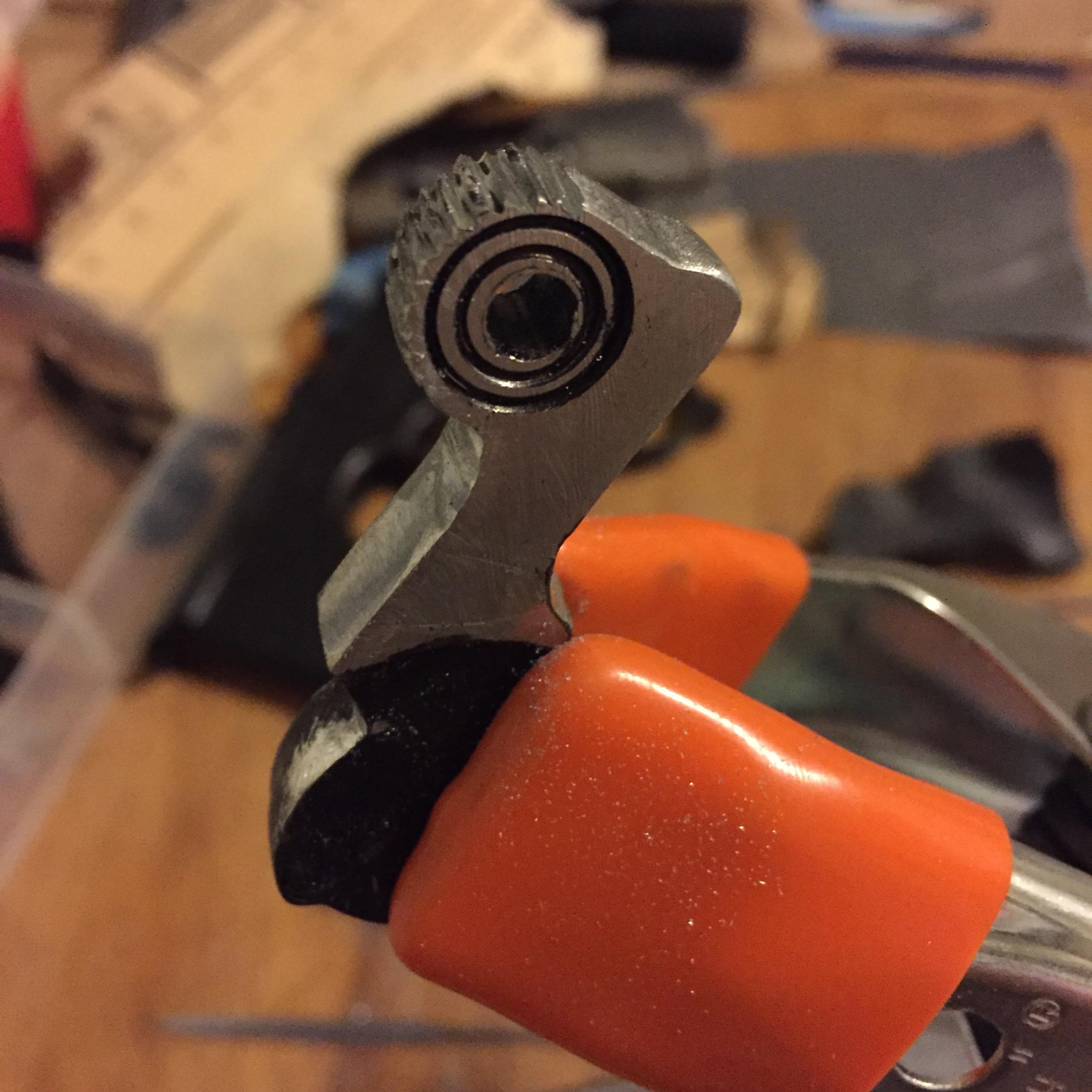

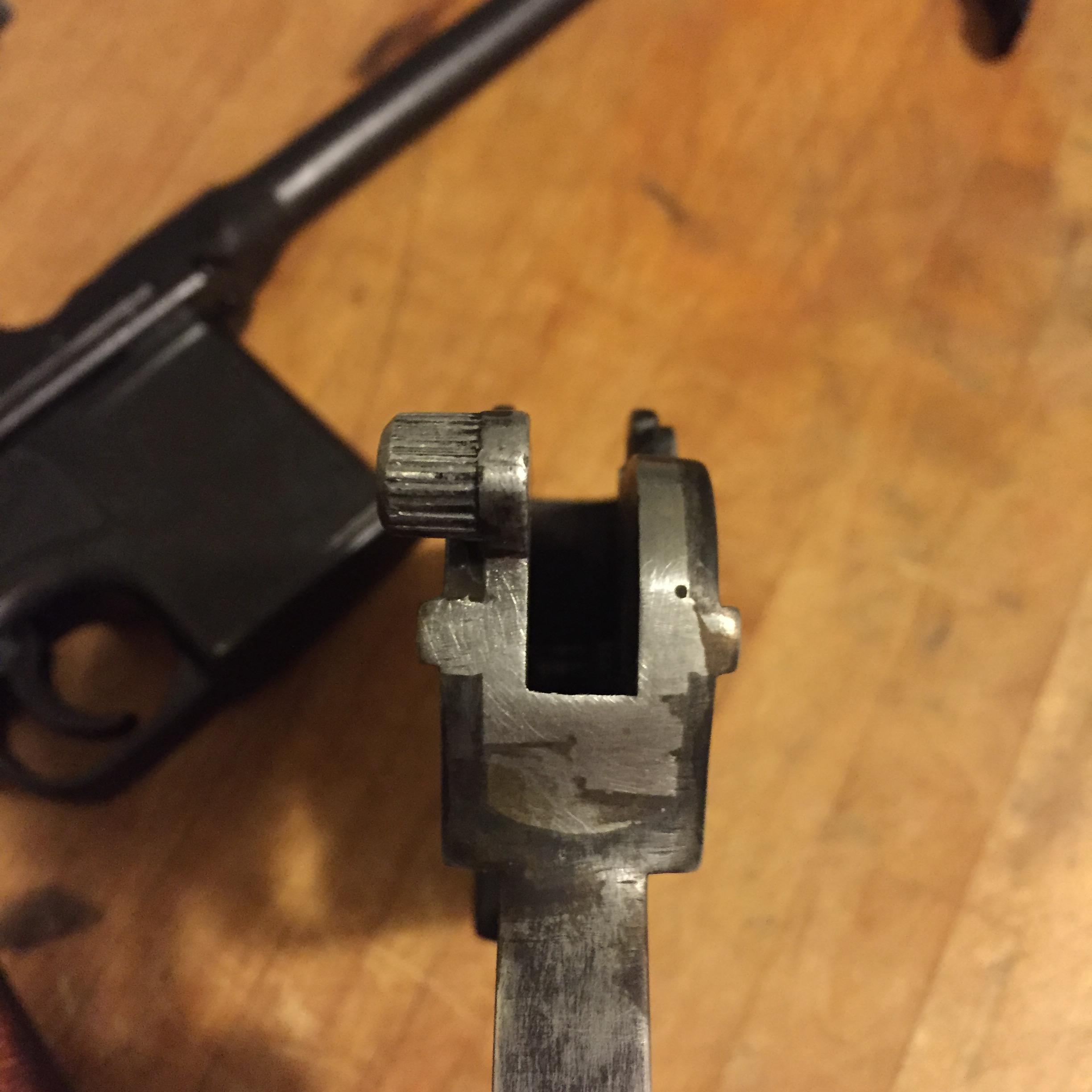

Alright, more Denix. I did some cleanup on the upper today and then decided to reshape the hammer because, like, how hard could that be?

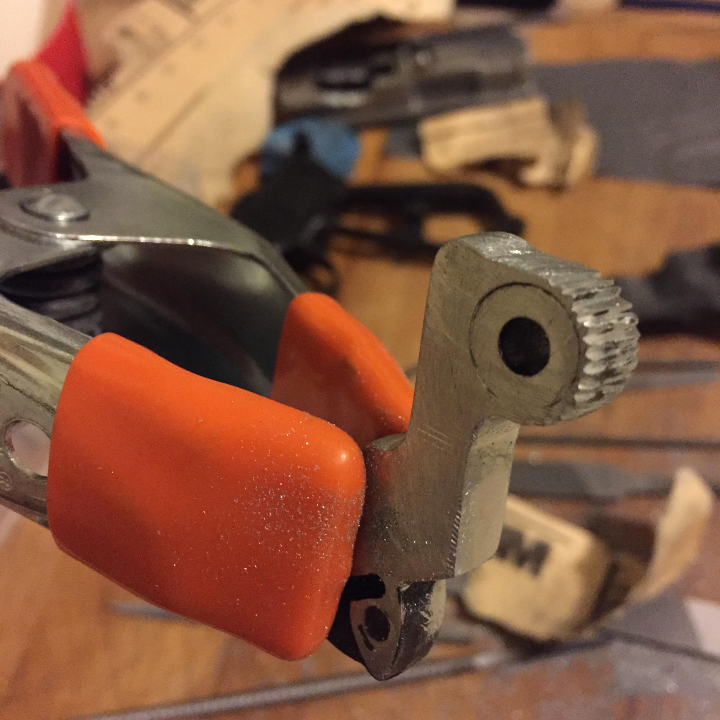

Pretty effing hard. It's like impossible to hold onto, so I had two orange spring clamps on it trying to prop it up while I scraped away. Also: there is SO MUCH crap to get off this thing. It's just completely the wrong shape. Like with a lot of things in life, it started looking reallllllly bad until it finally started shaping up.
Ran into a problem when facing the other side, though, because the little rings around the bulls-eye so-to-speak weren't deep enough. I'll have to re scribe those, or maybe use drill bits for boring holes to do them. That's probably the easiest way.
Also: that knurling is really hard to do with a triangle file. They're definitely not all straight, but hopefully they'll look alright once it's blued back up. Fingers crossed! Anyhow, I opened a beer and moved on to the trigger guard and the lower. Got rid of the seam line. Still need to clean up some of the filing marks, though.

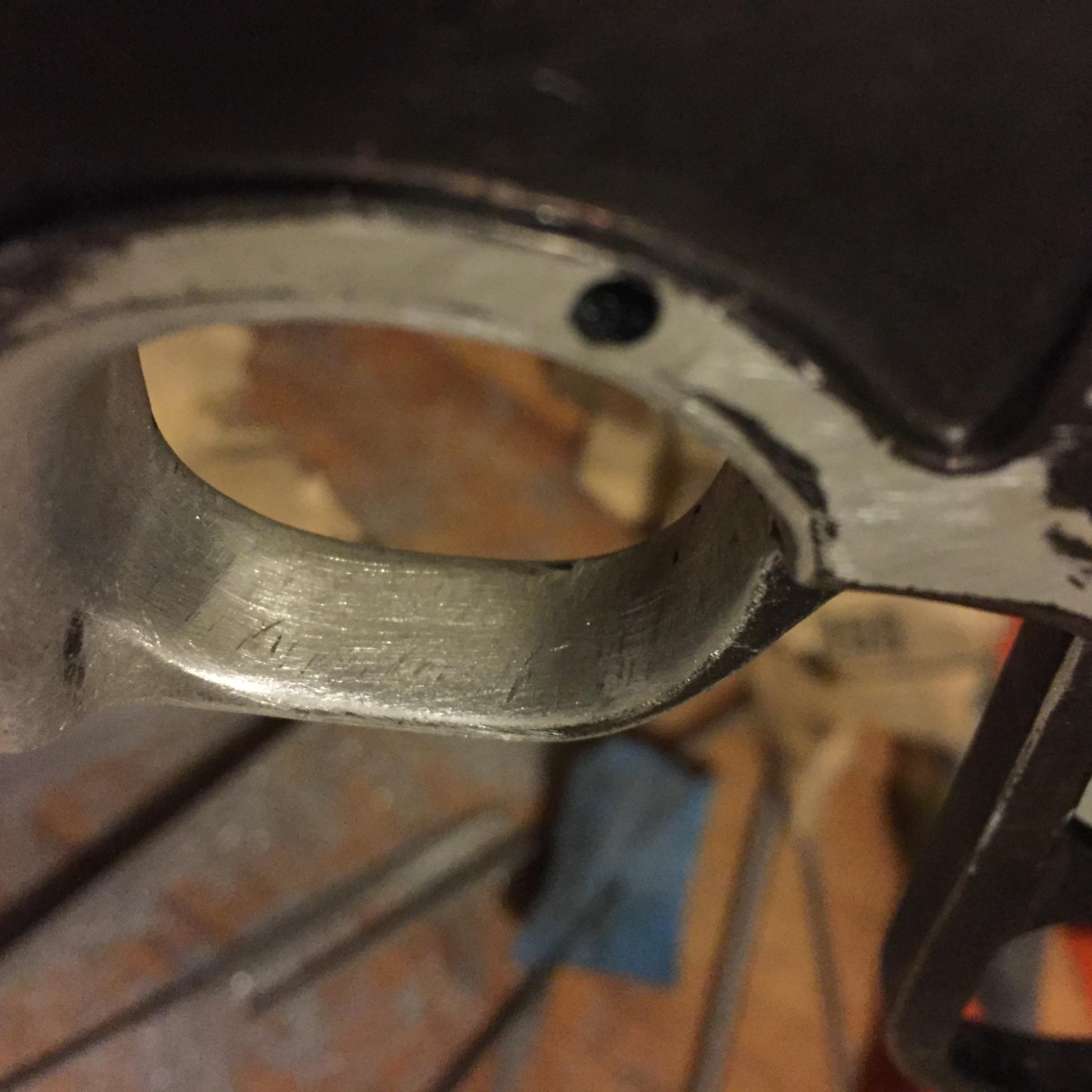

I have a real bottom plate that I picked up for some reason, and I noticed that the profile of the Denix is way too boxy compared to the real thing. Here they are after a little filing and you can see that it's still too squared off.
Getting closer...
Finally I just tried to sand away some of the pitting, but by then I was tired and my back hurt from hunching over everything for a few hours. If I was teaching a class on prop-building this would definitely be a project in it. It's so detail oriented and you really have to pay attention and think of how you can solve a problem with rudimentary tools. That said, I'm gonna get a Dremel so that I can dig into some of the more complicated stuff soon. Until then:

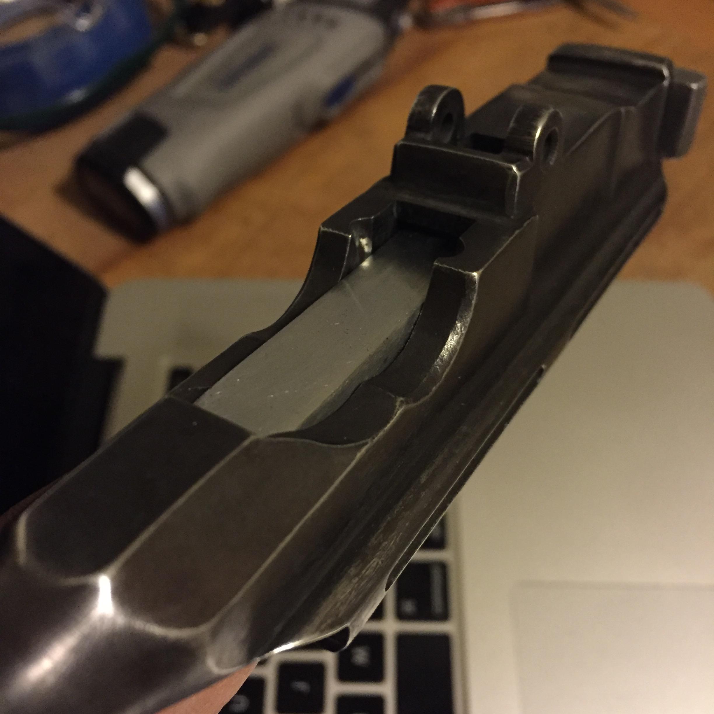

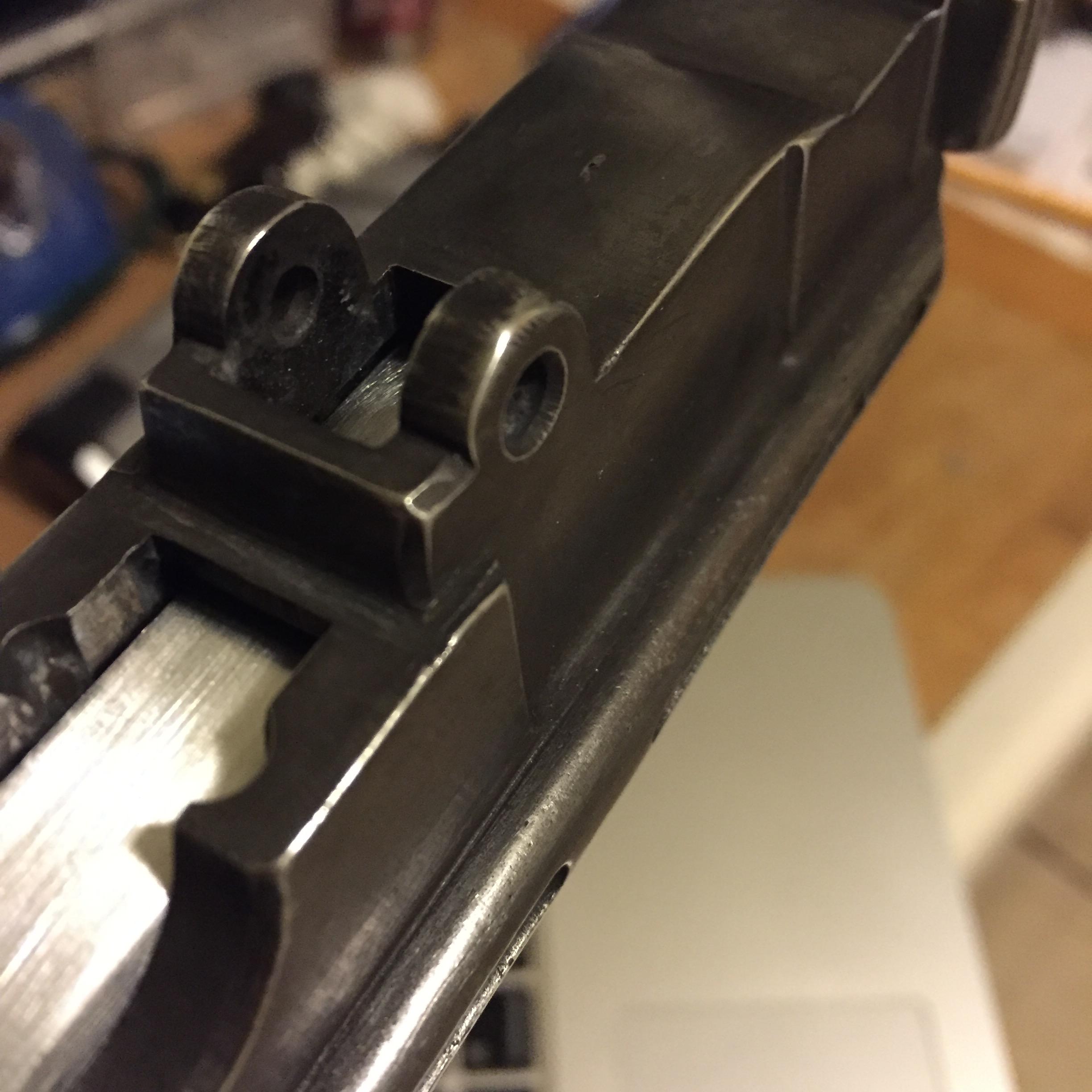

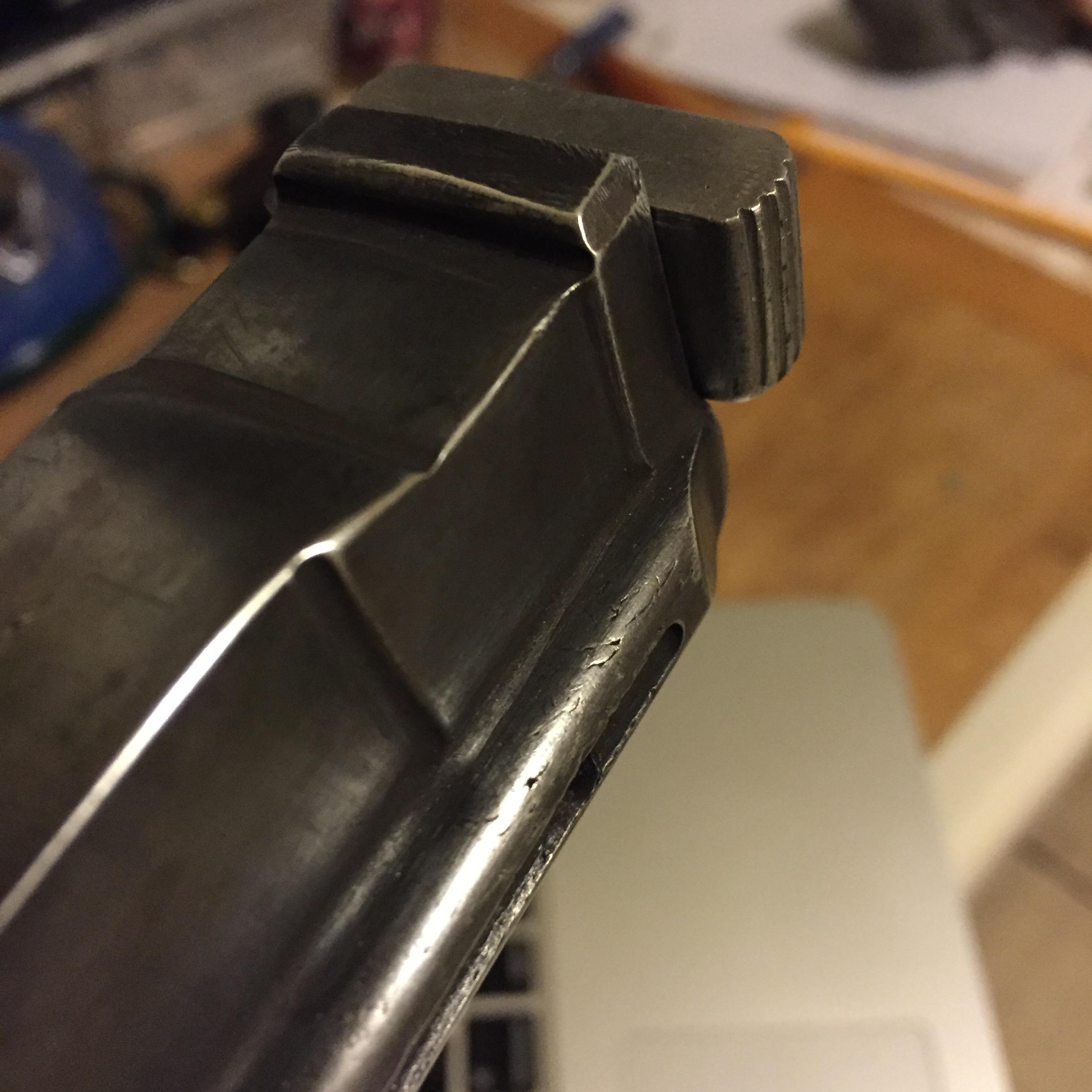

Quick little aluminum black test today. I've done some more work on the lower, but most of it I've ground back out because it looked so bad :wacko
There are some details that I really want to include that I'll have to brainstorm a better way to do. I'm starting to get kind of obsessed... maybe I'll have to buy a real Mauser to help with the process.
Anyhow, this is about four passes with the Al Black. I cleaned it all up with rubbing alcohol first, and then heated the upper up before each pass (roasted it like a marshmallow on my stove - don't worry I ventilated everything very well). Did a rinse and steel wool pass in between. It doesn't look factory fresh, but for a beat up ol' blaster I think it'll do just fine. I'll tinker with it more, but I'm really happy with out it helps bring out the details that I added back into the Denix.

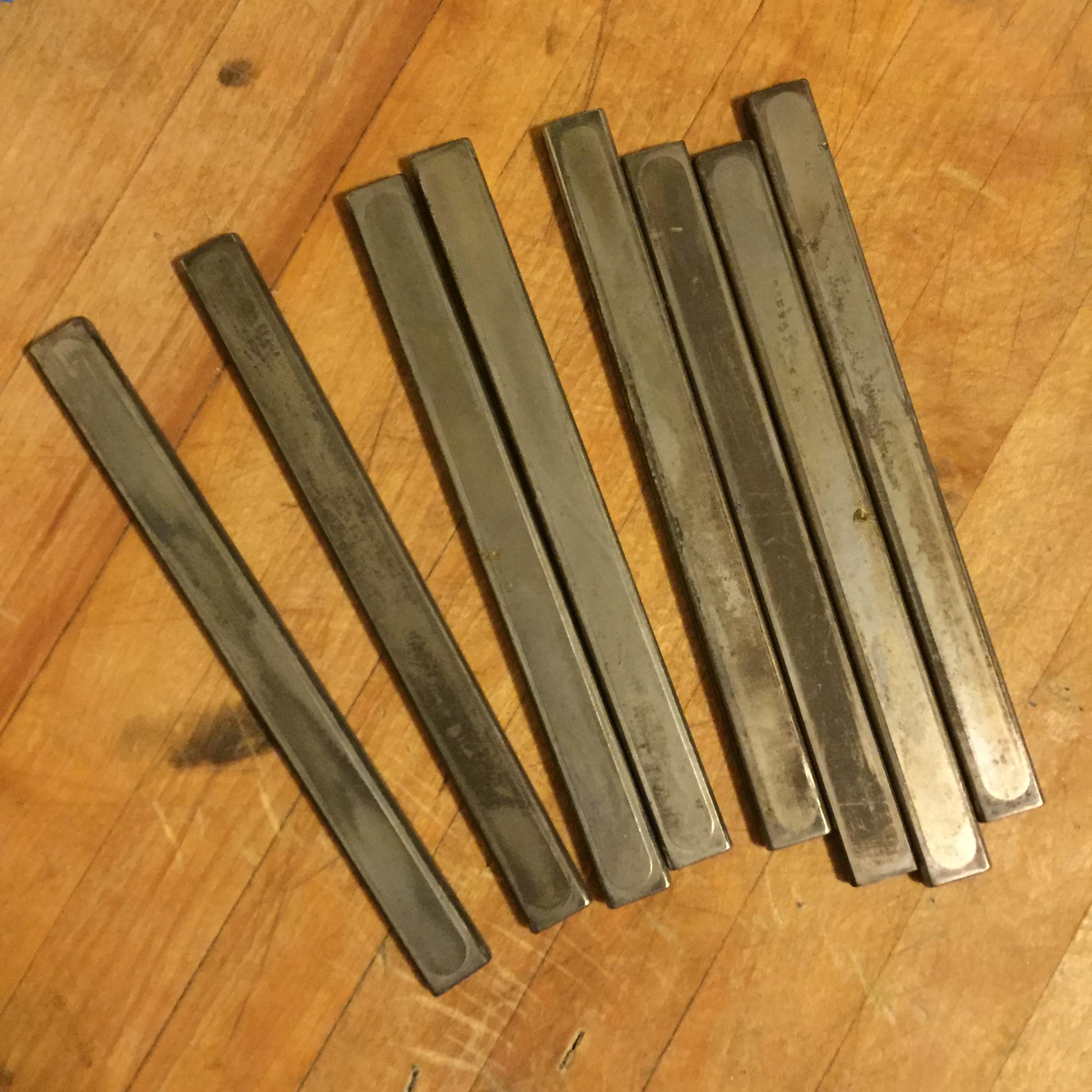

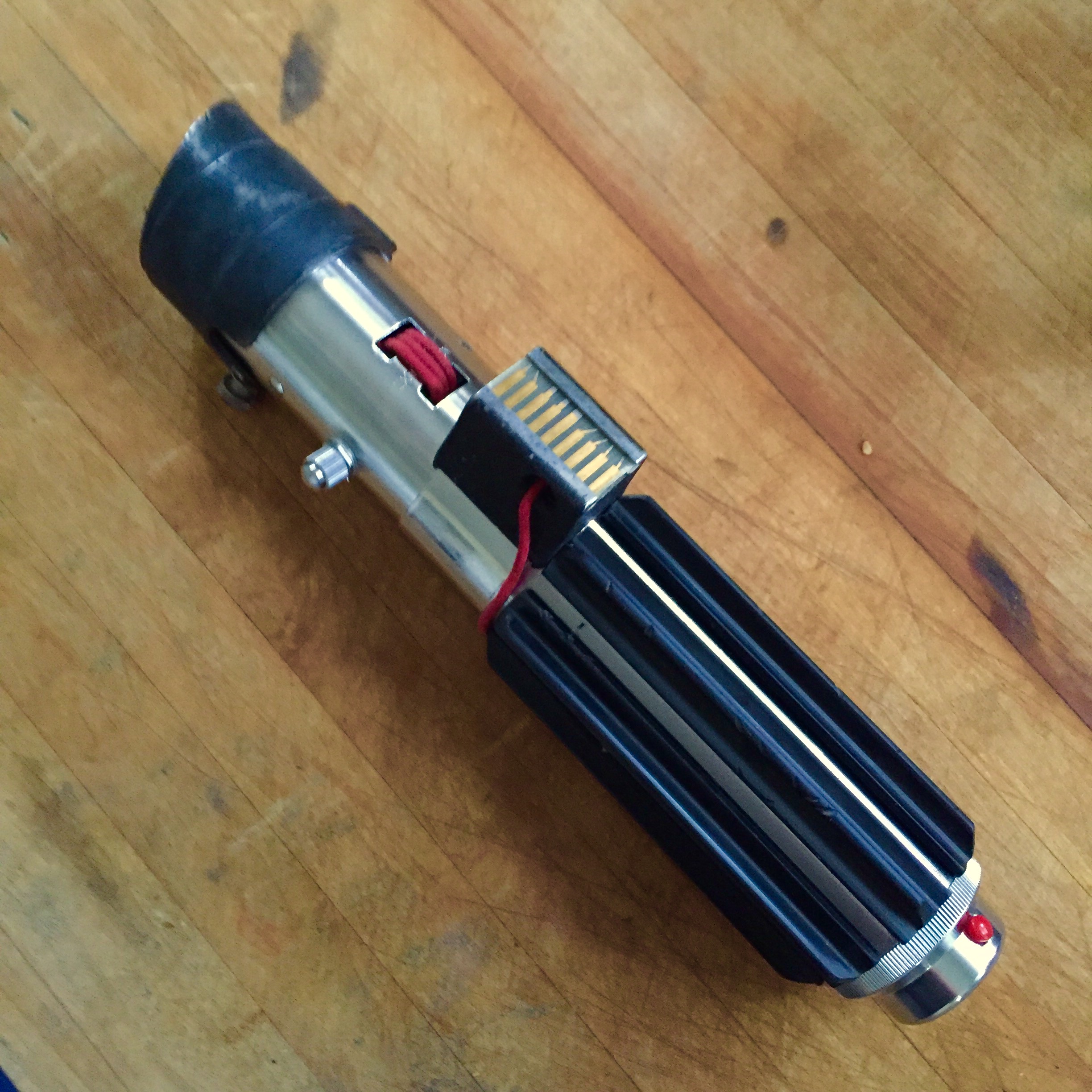

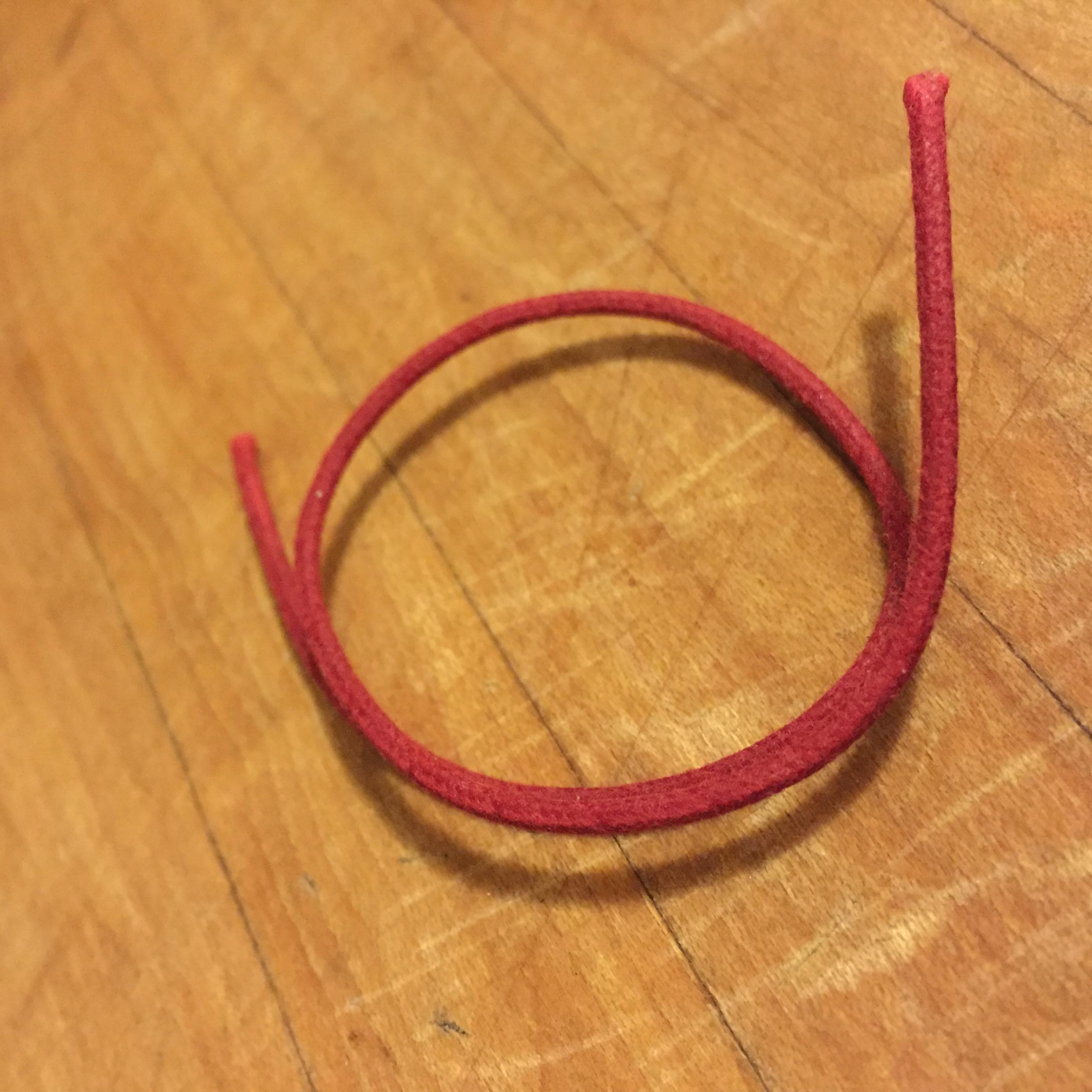

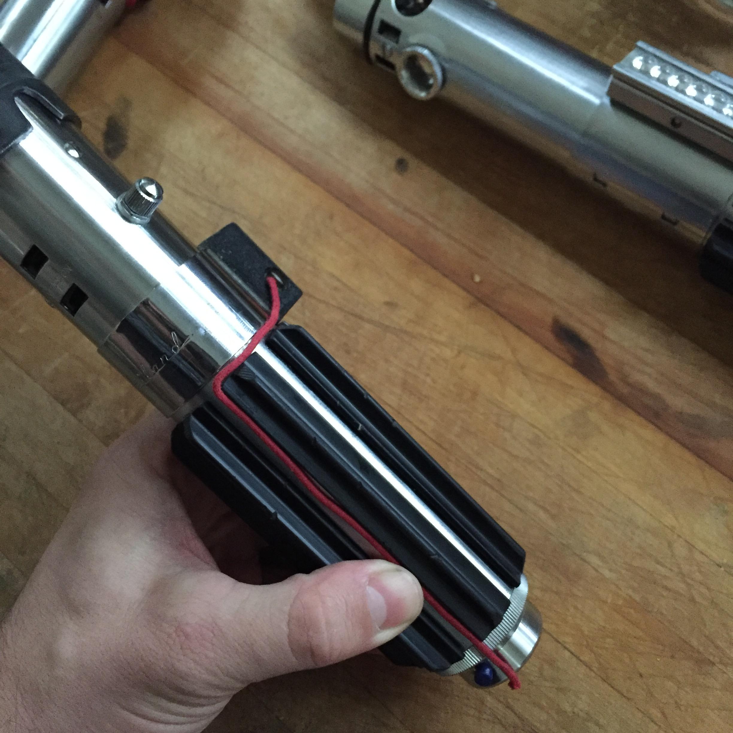

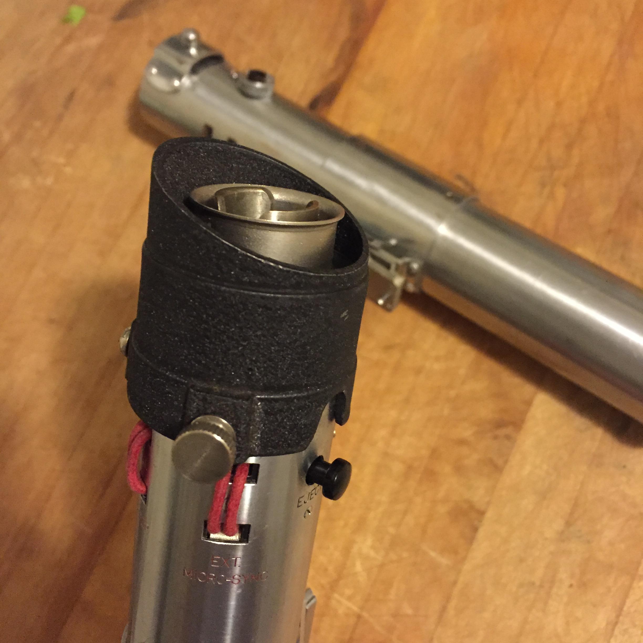

Not much on the saber front. I got some great waxed linen wire like they used on the power cylinders of the E-11, and cut some bits off to slot into the Canon... oh and I found a Peak!
I need to get some new screws for the Canon shroud still, and maybe add an extra wire per slot. Then I just have to flip a coin between t-tracks or these awesome grips ScottD was kind enough to trade me.

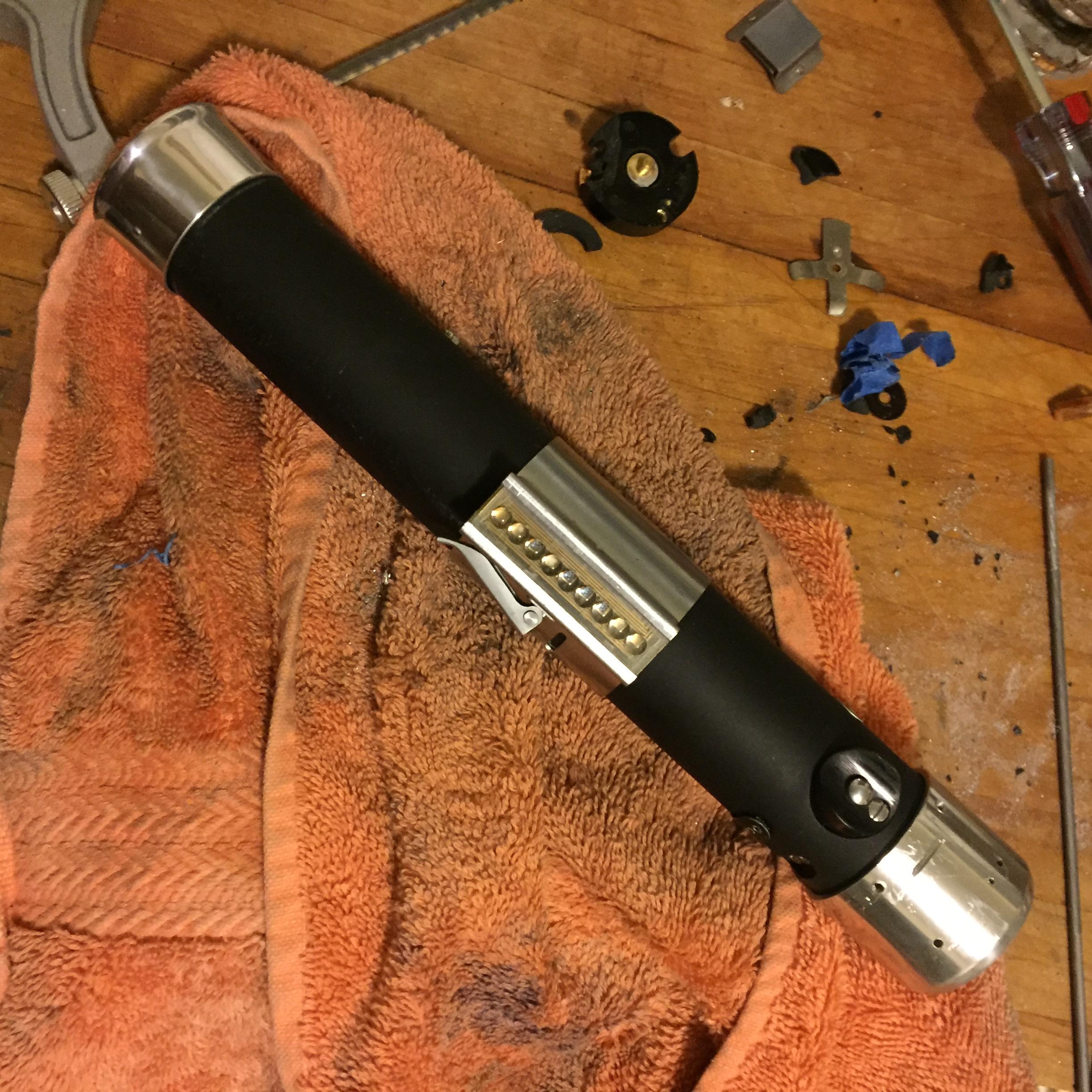

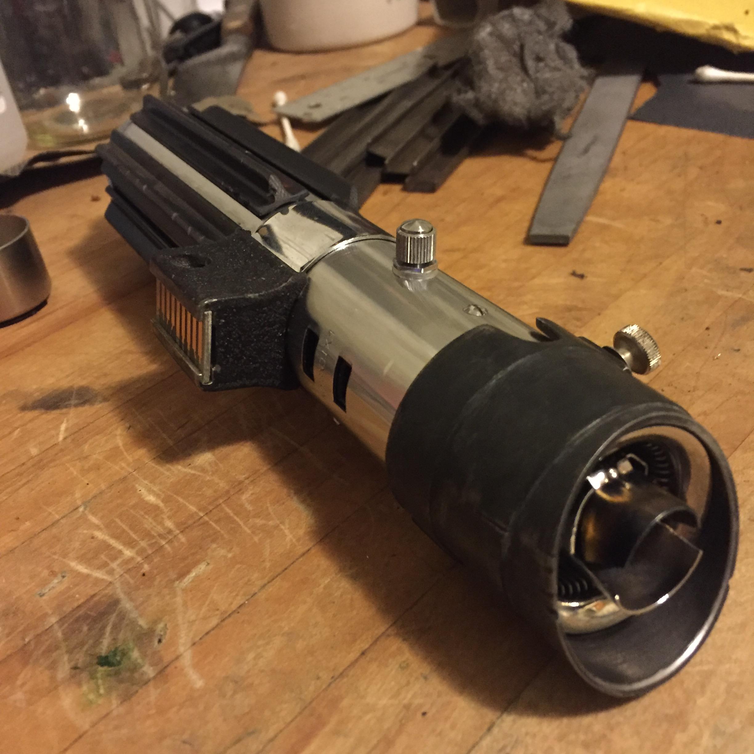

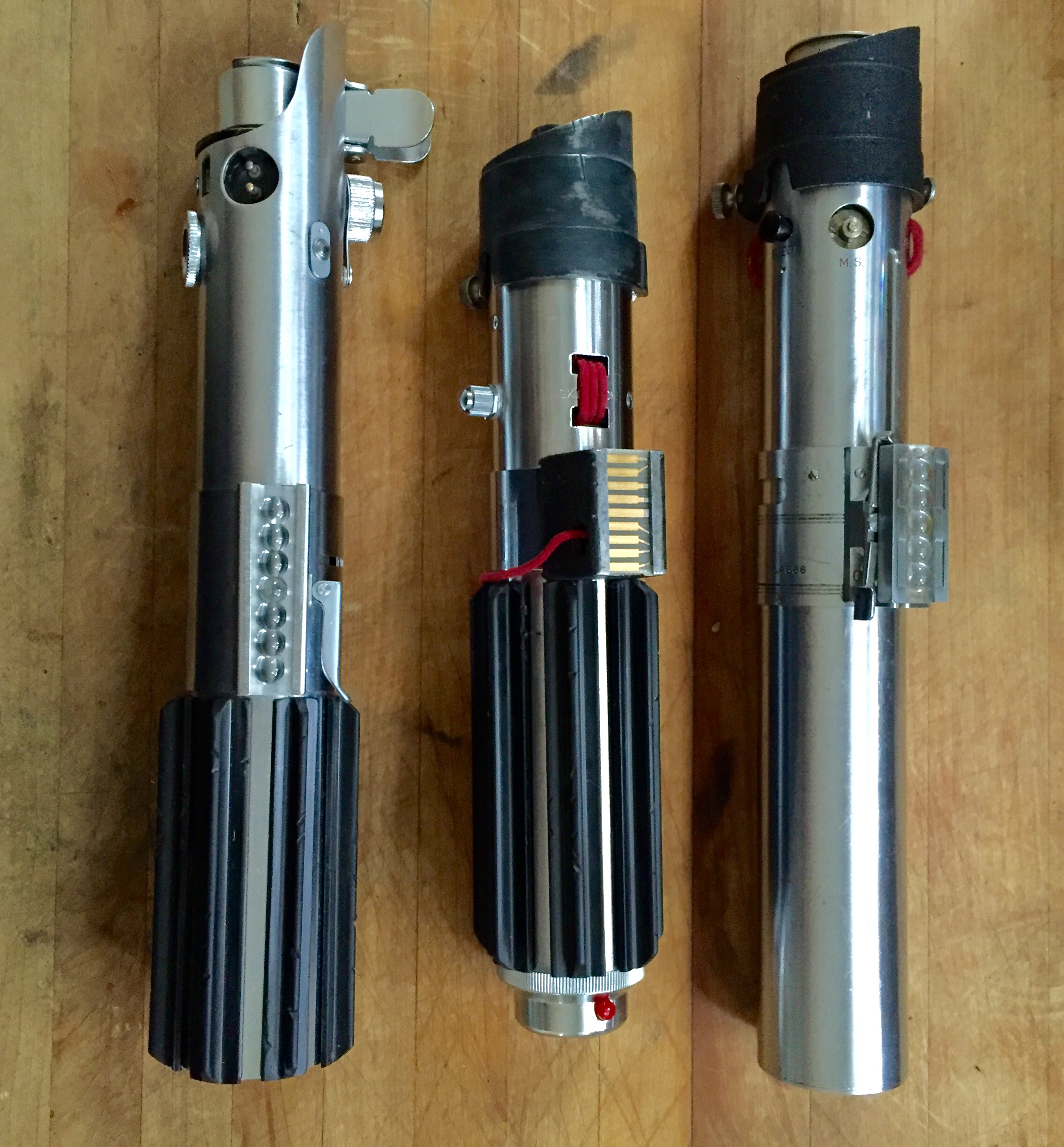

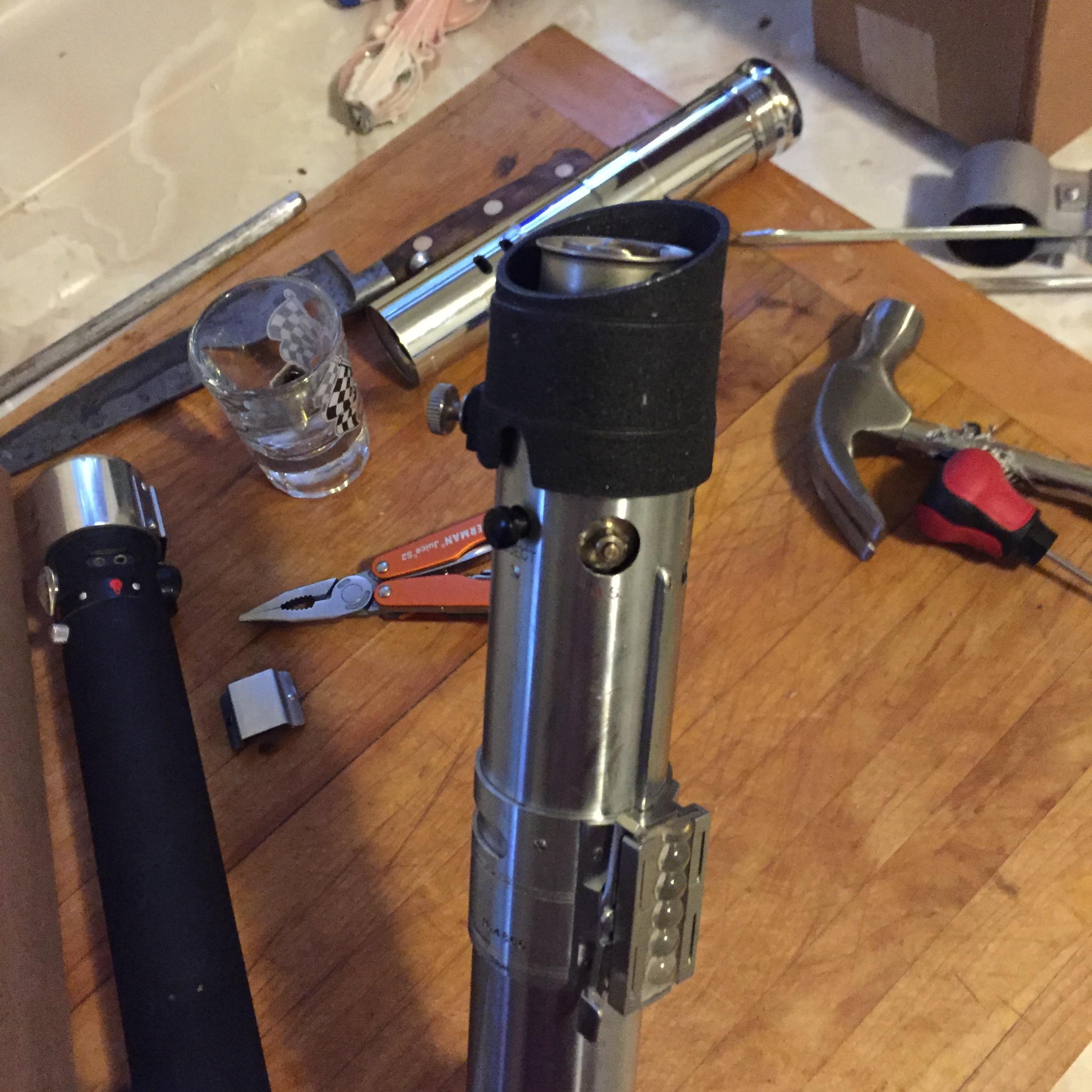

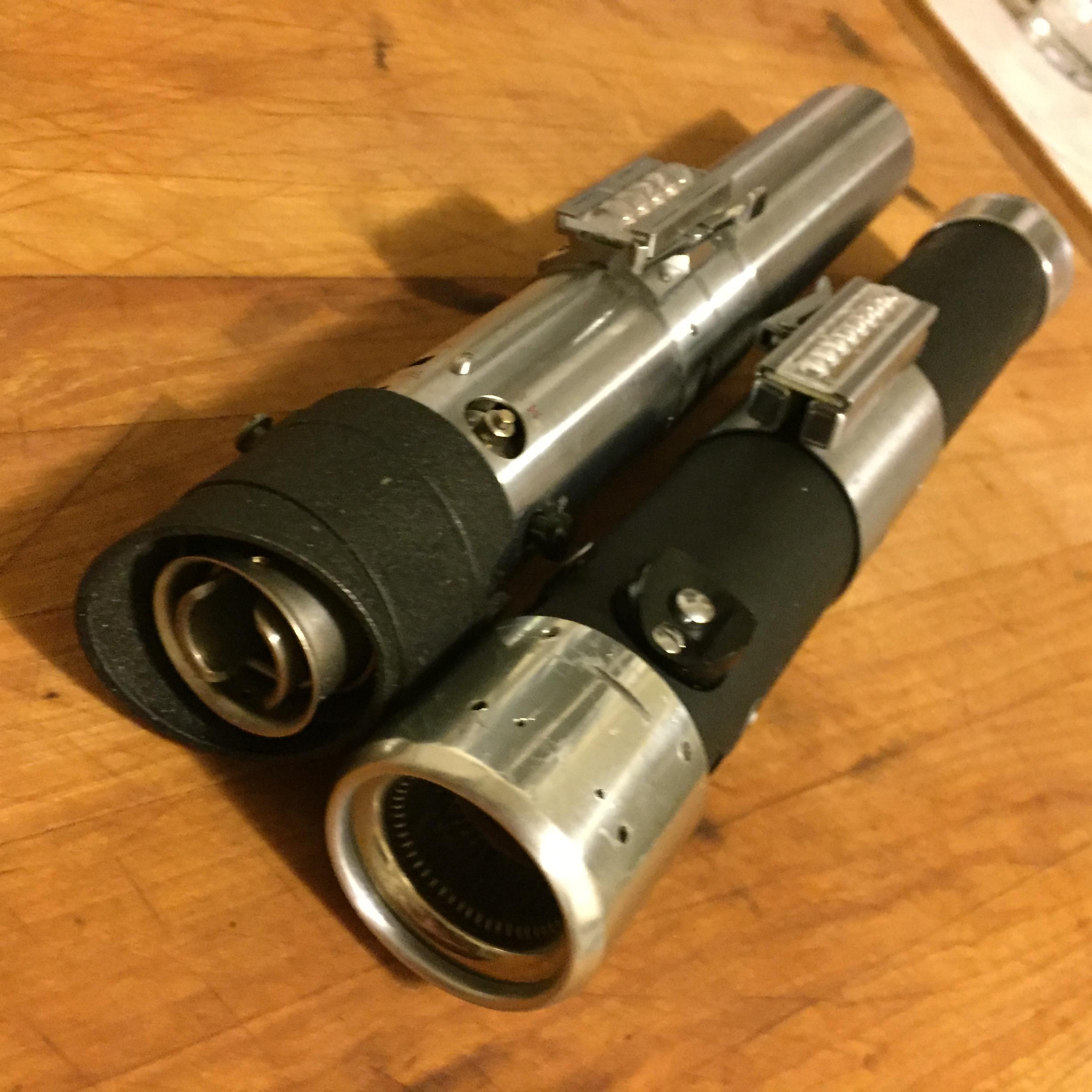

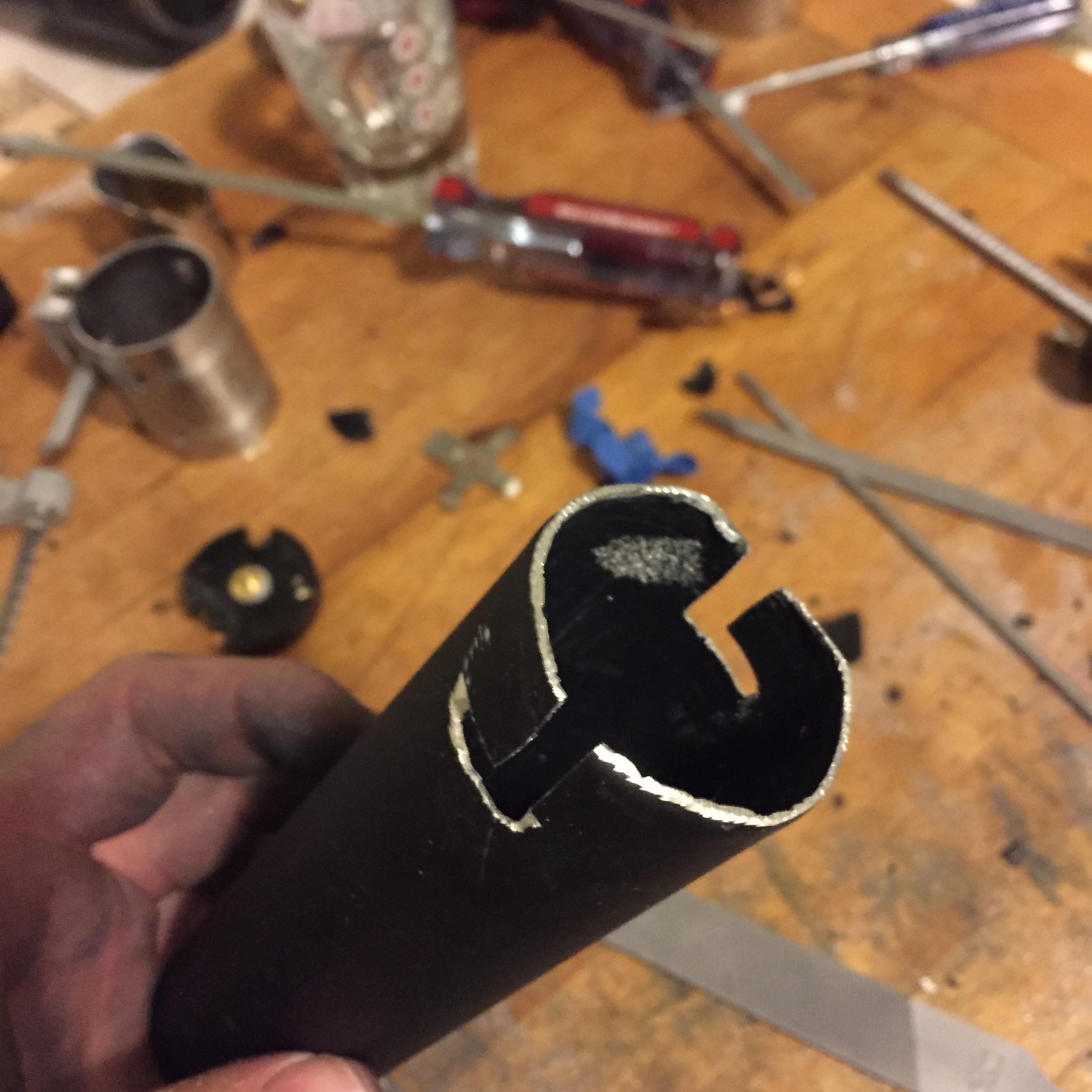

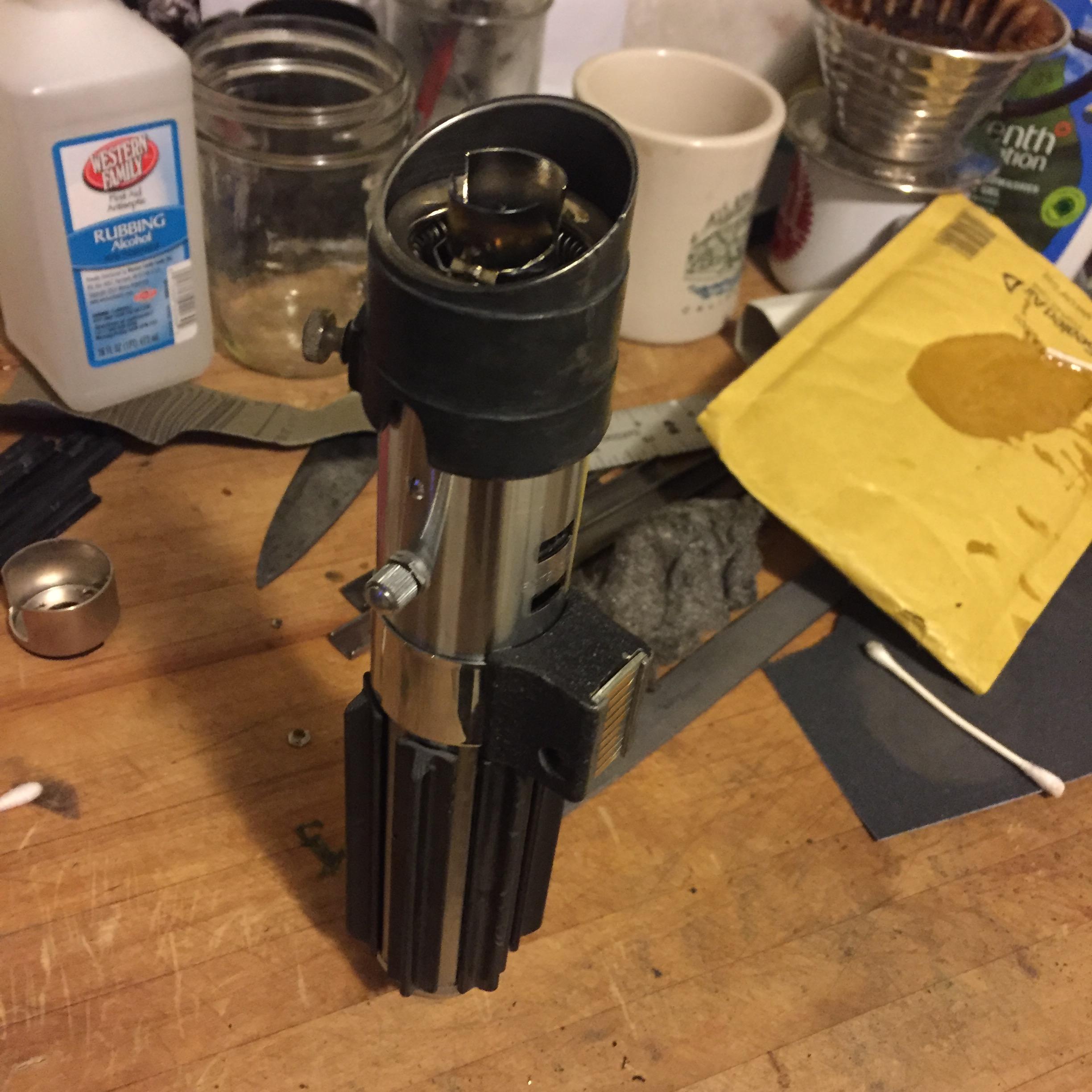

Bashed this saber together today. Wasn't planning on it, but it just wanted to be made. I've had this Minicam flash that I got specifically for this cool little chubby shroud:
But once I had it removed I kind of just kept playing with the flash because it had this really cool bulb-holder / emitter. It was a little short. Longer than your average two cell, but not quite a three cell. I decided to see what I could do with it, though. I had some pieces from a Heiland 2-cell that I broke down. I stole the clamp, shroud, and part of the bulb socket from it. I chopped the socket and added it to the Minicam. This gave me a little extra length to work with as well. I also torched the Minicam's bulb socket to get some blue on there.
Then I attacked the shroud with some sand paper, files, and steel wool to try and get the boring grey finish off as much as possible. It was actually really hard to get off. A little aluminum black later, and it was looking pretty good for a junky saber shroud. I positioned the clamp and tightened it down before cramming the PCB in there. You can't adjust these clamps once it's in there, so you need to make sure it's all where you want it.
Then I just added some of Roy's t-tracks. I went ANH style, because it's my fav.
I'm really happy with it! I'll probably add a d-ring and maybe some wires eventually, but this thing came together so easy - probably because it's very Vader-ish. It looks like the little baby brother of my Canon X... which I still need to finish. I'll probably throw Scott's steel grips on it in a few days and put it to bed.

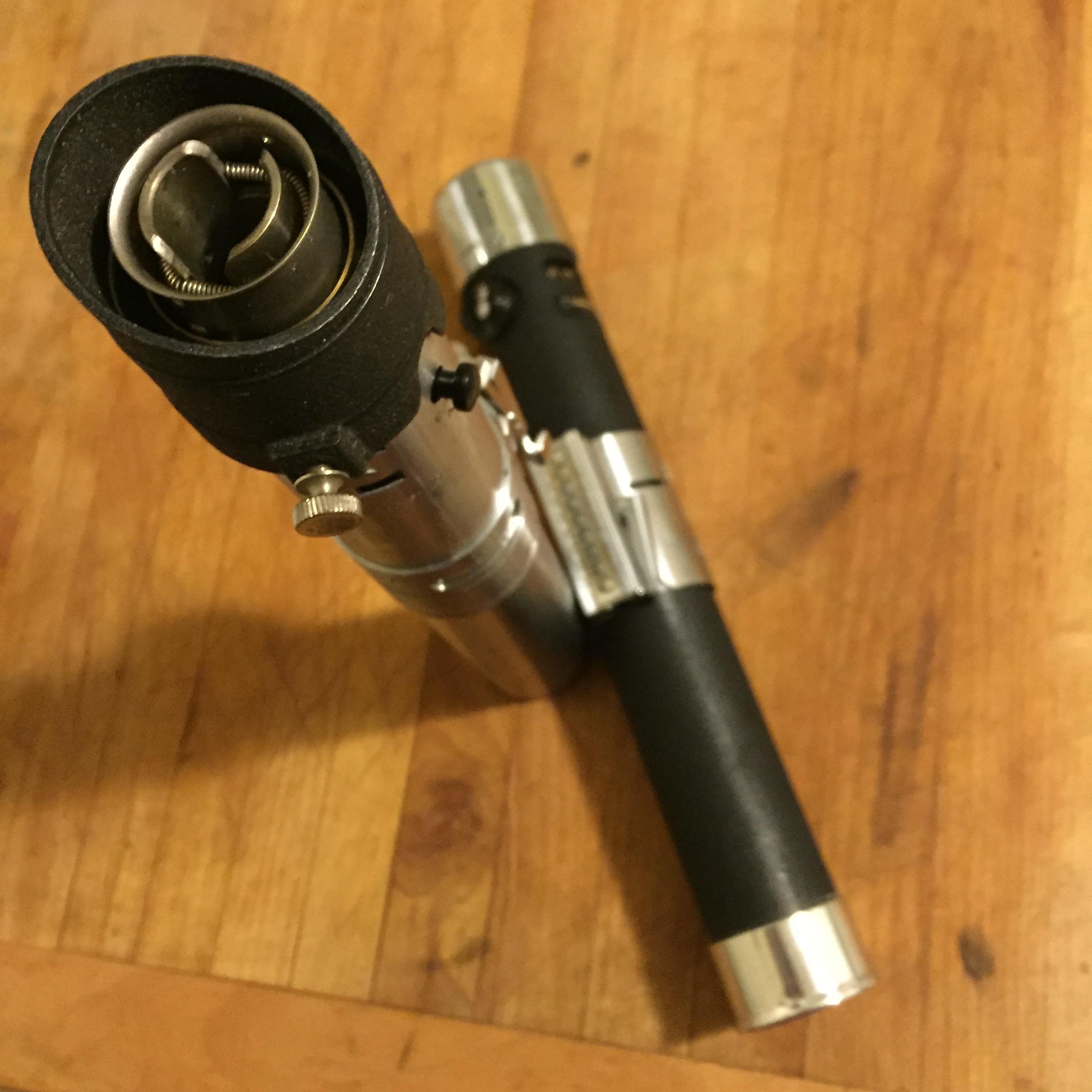

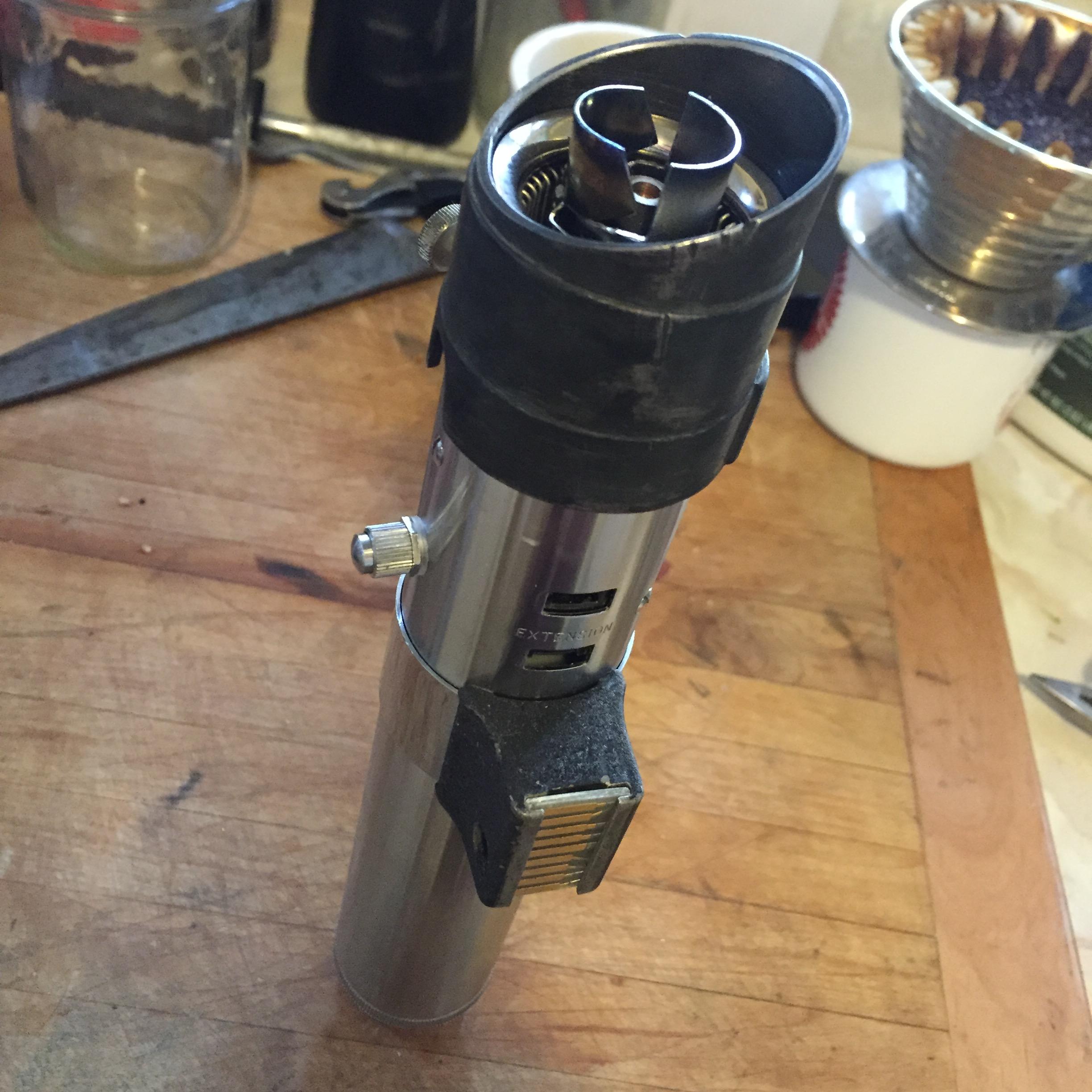

I decided to Kylo up the new addition. Haven't fully committed, but I kind of like this direction. Maybe drill out one of the colored buttons on the bottom to connect the other side? That's originally where I'd intended to add the d-ring... decisions...
and of course, a family photo :)

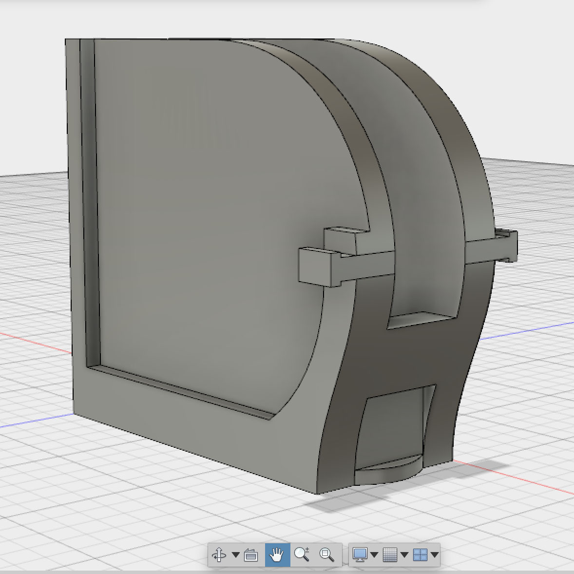

Been home sick with a cold, so I thought I'd teach myself some Fusion 360 and have a go at modeling that lock-frame insert for the Denix. Not accurate yet, but I have literally zero experience with this stuff. I think once I make it past that learning curve, this idea could actually work. Maybe a working safety / hammer / lock frame upgrade kit or something. Just thinking out loud.
