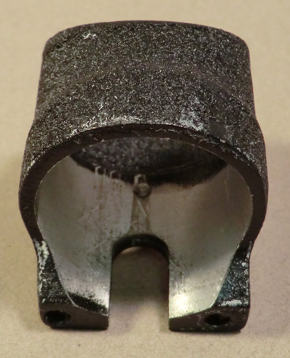

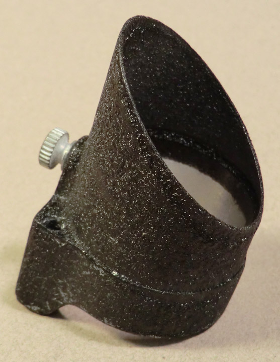

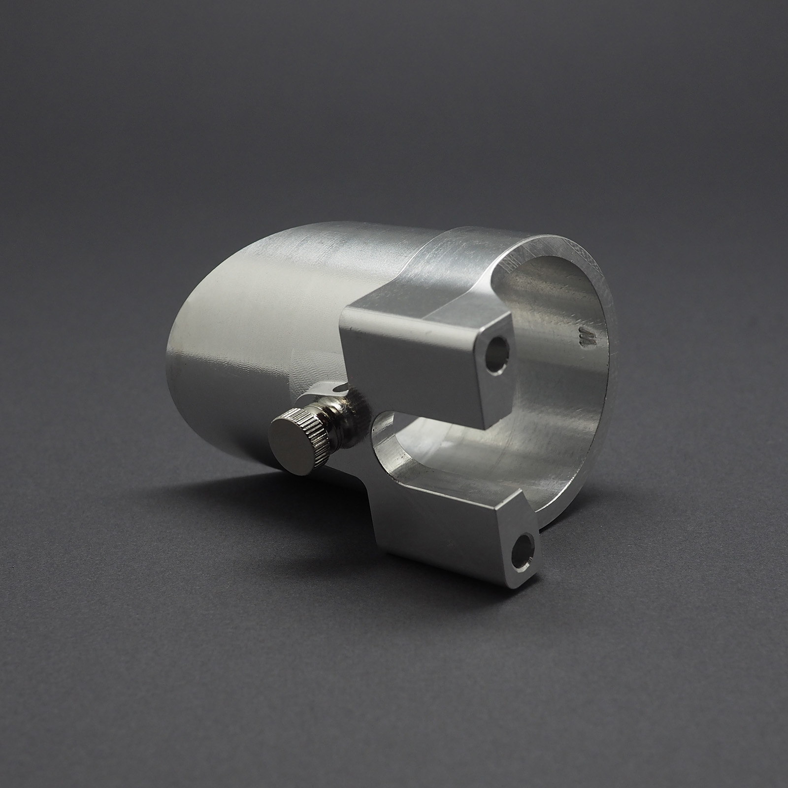

Not all, but on some single-step shrouds, that area has over spray.
So, it wouldn't be out of the norm to see that part covered with paint on some shrouds.
This is why I'm concerned about the idea of only using inside engraving. It can be covered with paint, and we won't be able to tell the difference.
I think it's the best solution for everyone to add a larger recessed area similar to vintage 2-step shroud interior

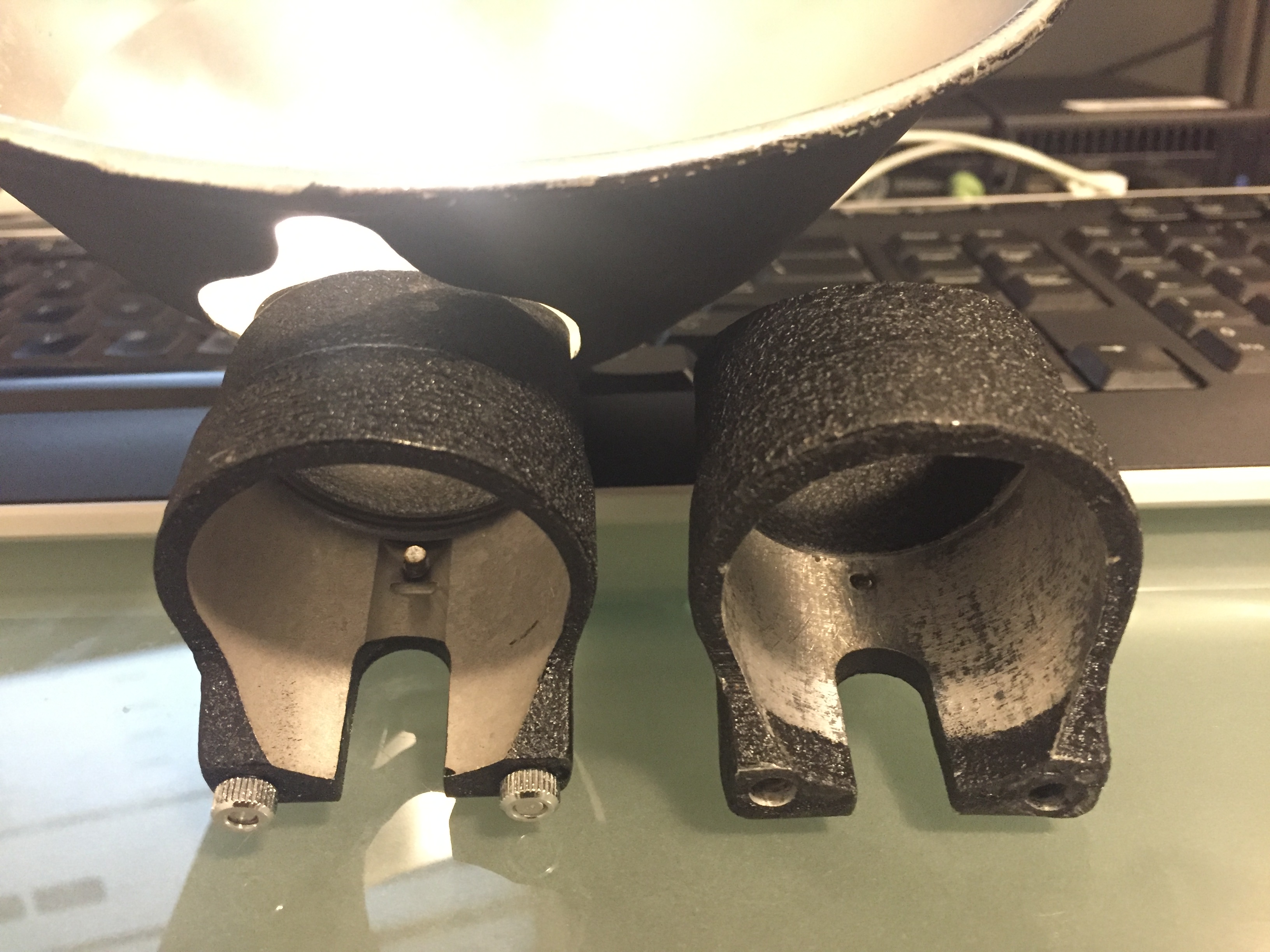

Sure, they have overspray, but if the whole inside surface is painted that would be a definite red flag in my opinion. Granted, I've only ever had two original MPP shrouds - here was the other one, which I sold to Nick Cline a while ago:
If that lower section had a coating of wrinkle paint, I don't believe the shroud would fit on the flash tube. Just put a large, deeply incised mark in the middle of that area - so deep that you couldn't sand it out without it being obvious/destroying the shroud and so large that any attempts at filling it would also be obvious.
I just checked, and one of my authentic single-step shroud is completely covered with paint inside.
So, let's not jump to conclusion that all vintage single-steps are unpainted inside.
Again, no matter how large/deep the engraving is, once it's covered with paint, it would be indistinguishable.
That's why I'm suggesting more tells inside (or outside, which many people seem to hate)
You'r might be the rarity though; I just check my two and neither of them are painted on the interior. Over-spray, yes, fully painted, no.
I'll send you a picture of mine through PM.
I found it odd when I received it, but it's fully painted inside.
One of teecrooz's might also have plenty of paint inside.

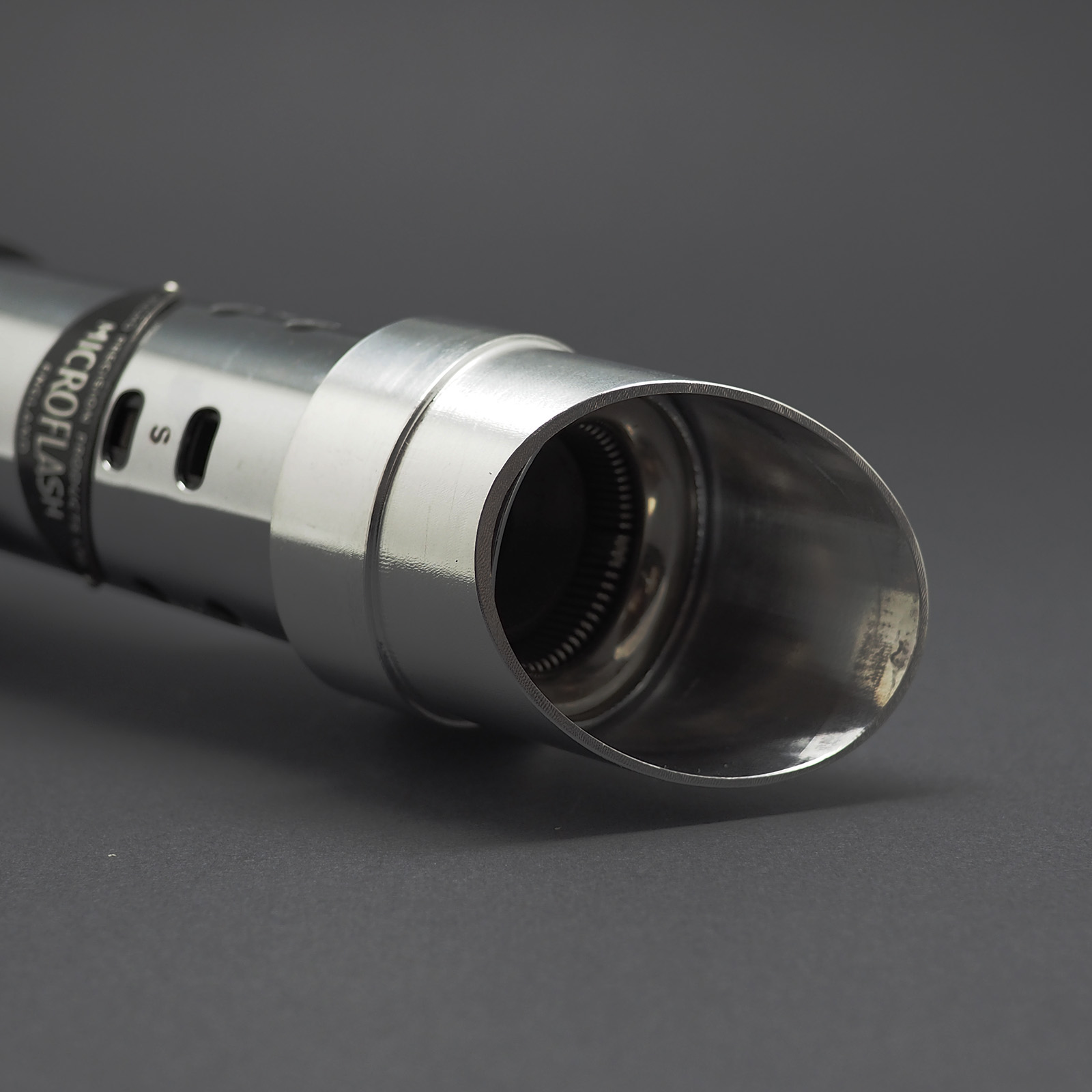

Make it out of zinc or steel, you can get it as accurate as possible, and people won't confuse between replicas vs. real deals.
If you can see it/test it in person, yes. If Roy does do this, I would like them to be as accurate as possible on the outside and in weight. For me, the inside can look however he chooses to make it as long as it doesn't interfere with the exterior appearance.

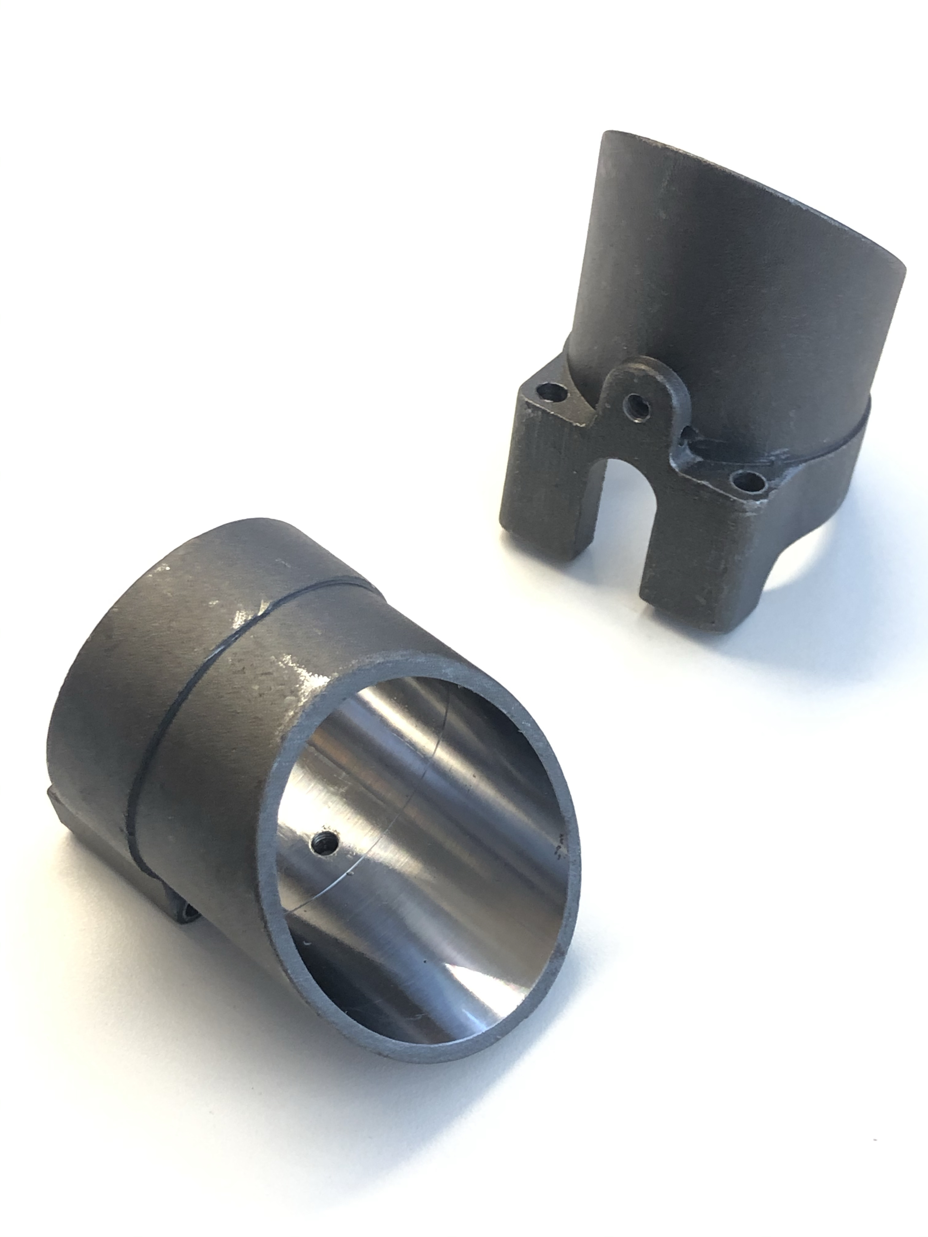

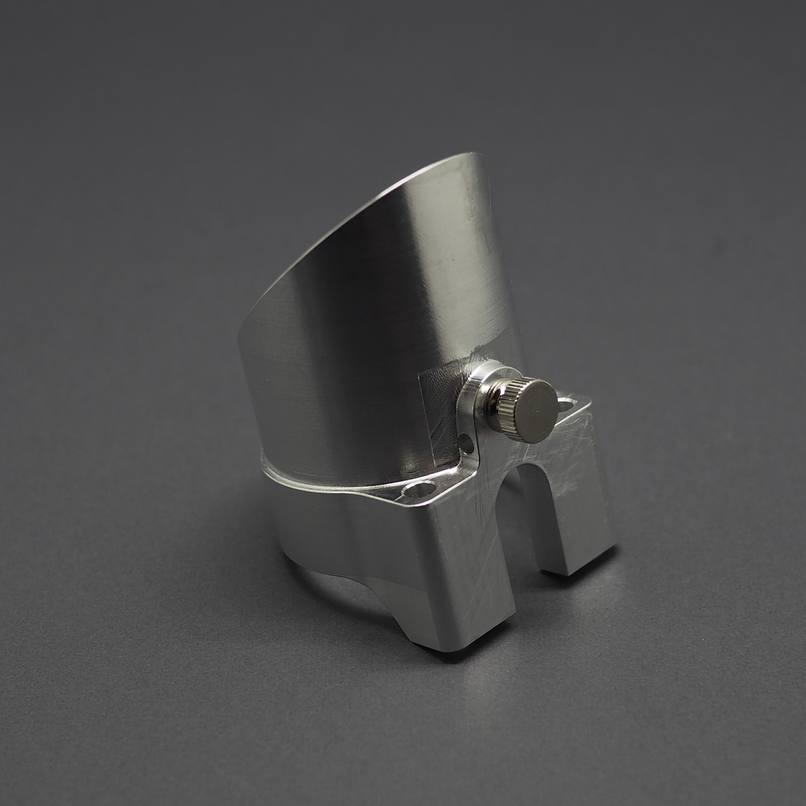

IF I do another batch of aluminium shrouds I will not compromise the accuracy of the visible parts, because that would defeat the whole purpose of the effort. I would consider an internal tell, but one that is obvious and clear and can't be sanded or painted away just like that.
But first I'm focusing on the steel shrouds, (which still have not been found on vintage MPP'S yet). The new samples are looking excellent and it won't be long till I can offer them.
Roy
Your steel shrouds are good.
I got two in hand one I finished as it, was nice, another I finished with complete re-shape on outside, was nicer, even not necessary to make the file work.
My idea is the steel shroud doesn't exist, far too heavy, and I think the original shroud was custom made, from a tube and a welded square shape.
Also that thick walled shroud, I never saw it anywhere.
All the originl I got in hand were aluminum, all were painted everywhere except the tube covering inner section.
Steps were like your picture, for accurate version, and smaller diameter for 2 steps shroud version.
All thin walled, but two steps shrouds have a very bit thicker wall.
