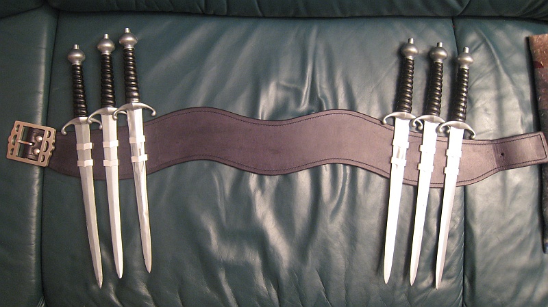

hello to you! If you have any advice on the blade holders that would be really good! But thank you so much for all the work you did with J. I'd never have got this far and be happy with it if it wasn't for the things you'd previously attempted.

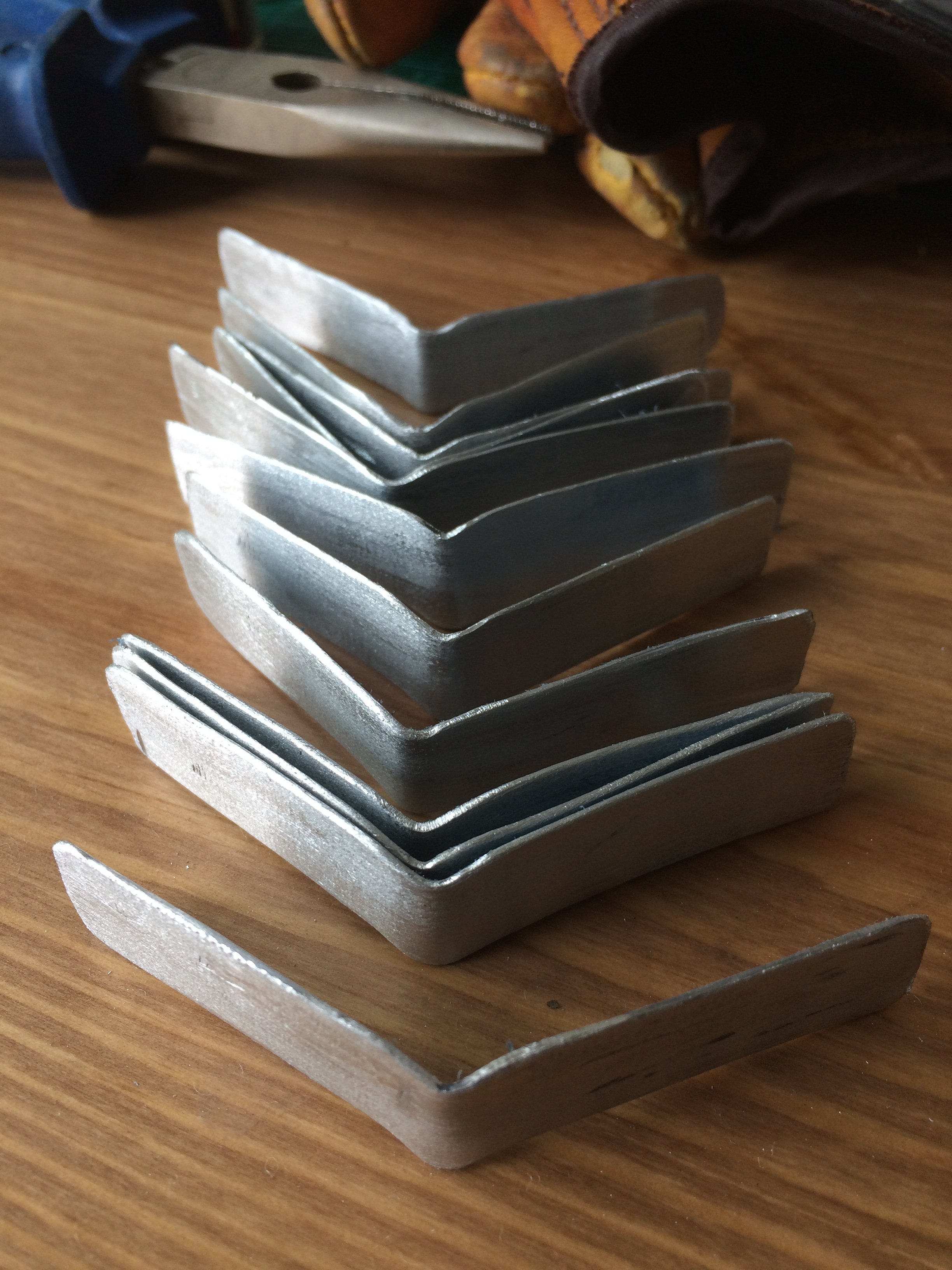

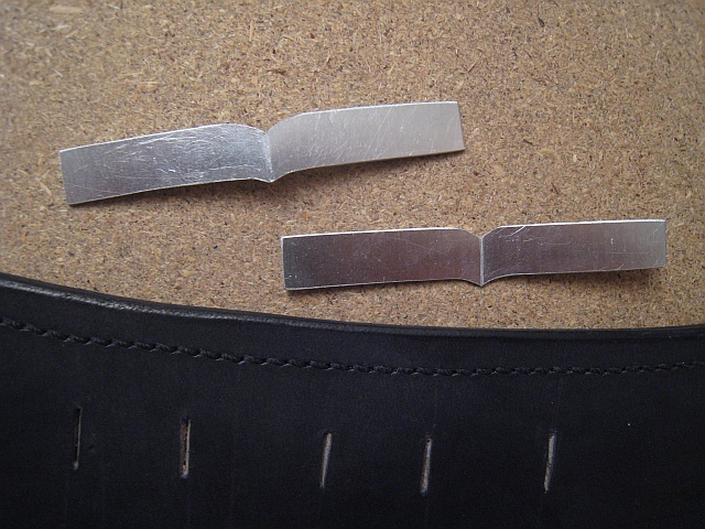

I don't know what to add to the pictures of the holders on the first two pages of this thread. I cut them out of a thin alu sheet like yours with a fret saw, needed a lot of time and saw blades for that step :D Then I smoothed out the edges with sand paper, folded the holders and pushed them thru the belt slits, folding the holders' ends on the inner side of the belt. I buffed the surfaces with a few nail buffers (you know, these soft strips to make nails look shiny).
I drew the original "pattern" for the holders on a scrap of paper, eyeballing the length and folding the paper around my daggers to see how it looks... No magic was involved there at all :eek:

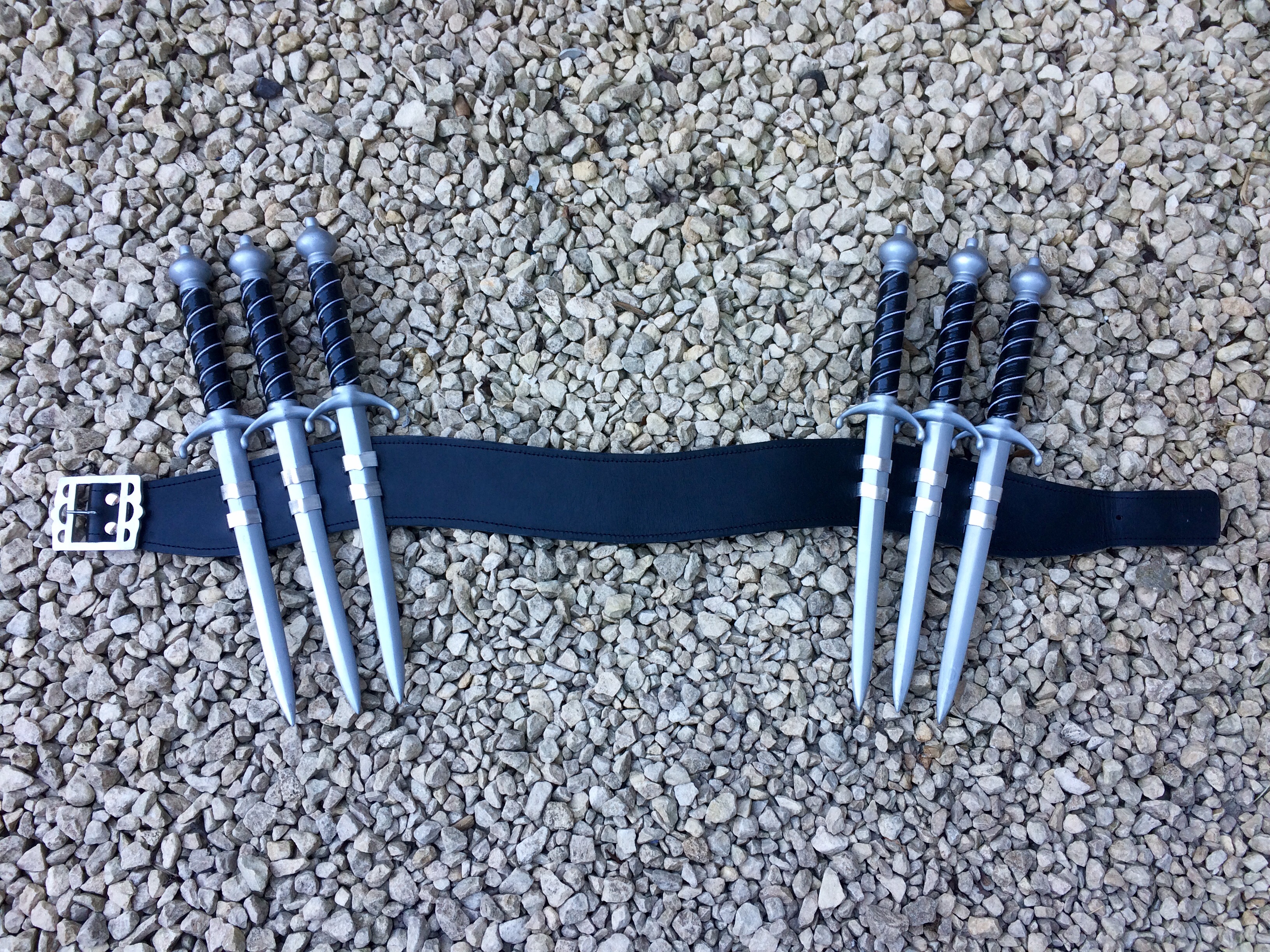

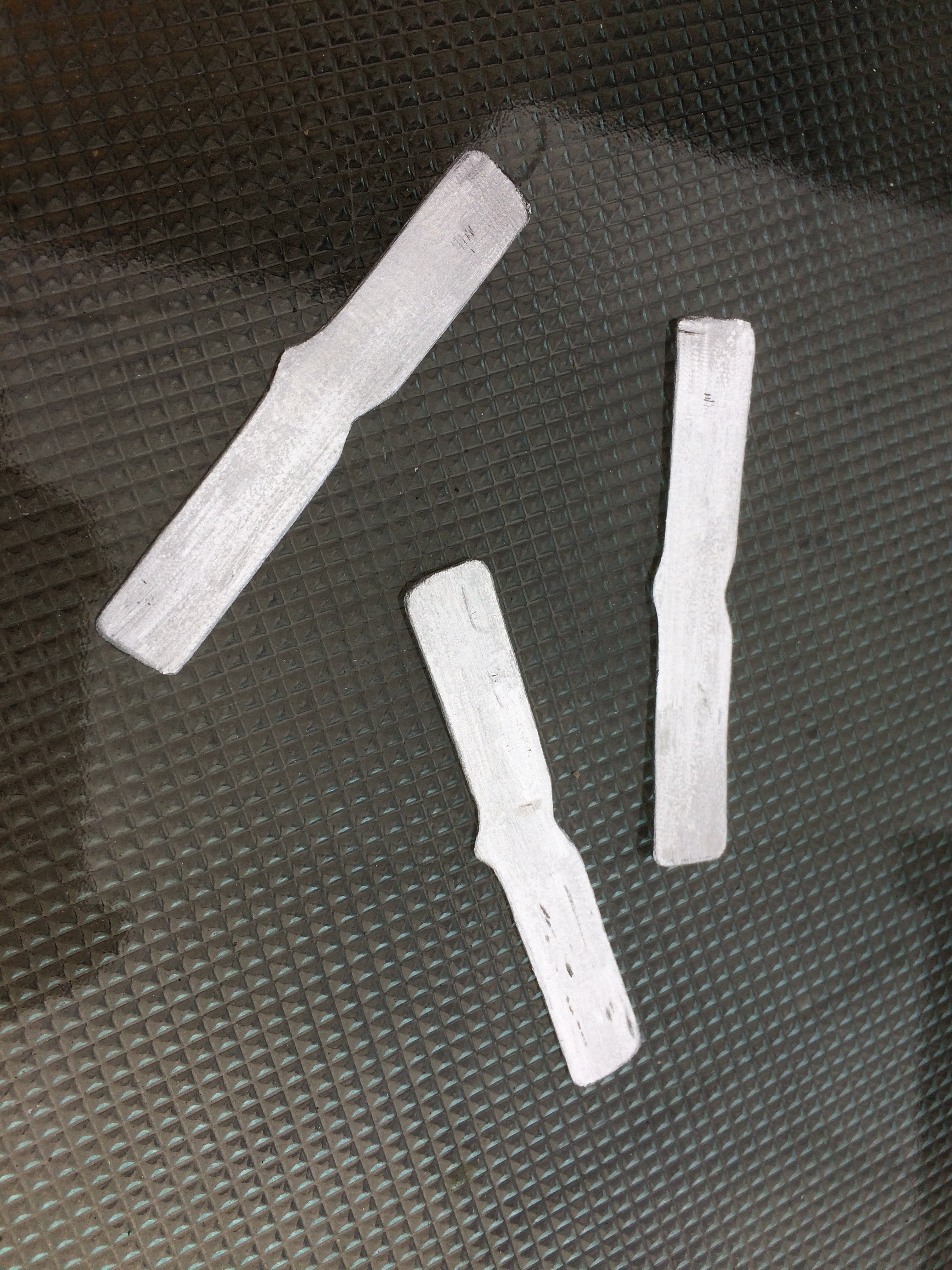

I inserted the holders into my belt yesterday :)
I bent the alu holders in the middle first, then cut the holes in the belt with a scalpel.
The thick leather keeps the holders in place nicely so I didn't need rivets.
You can see that I couldn't get the holders to be neat and flat on the inside but it doesn't really matter in my case.
I also buffed the holders in the end to make alu look shiny.
So I guess this project isn't a WIP anymore :)

your belt came out really nice :)

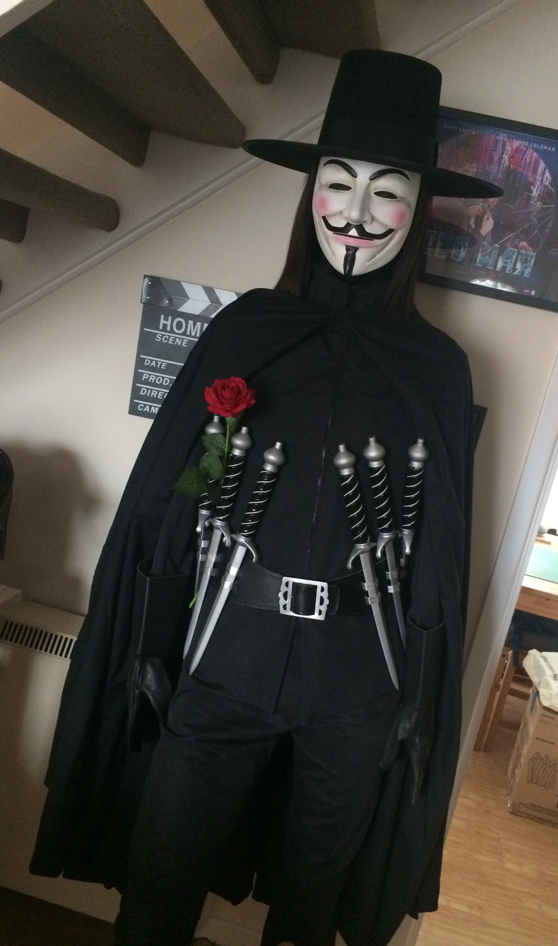

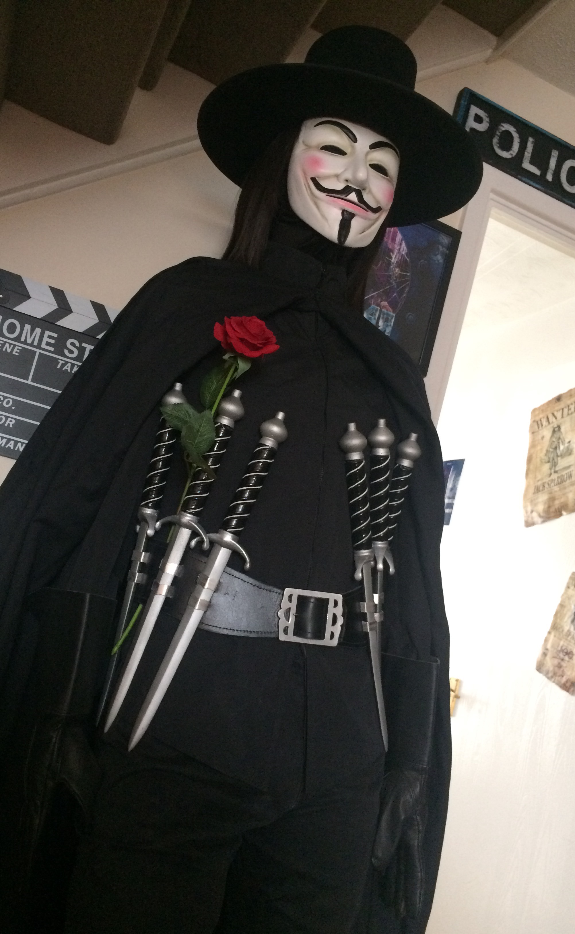

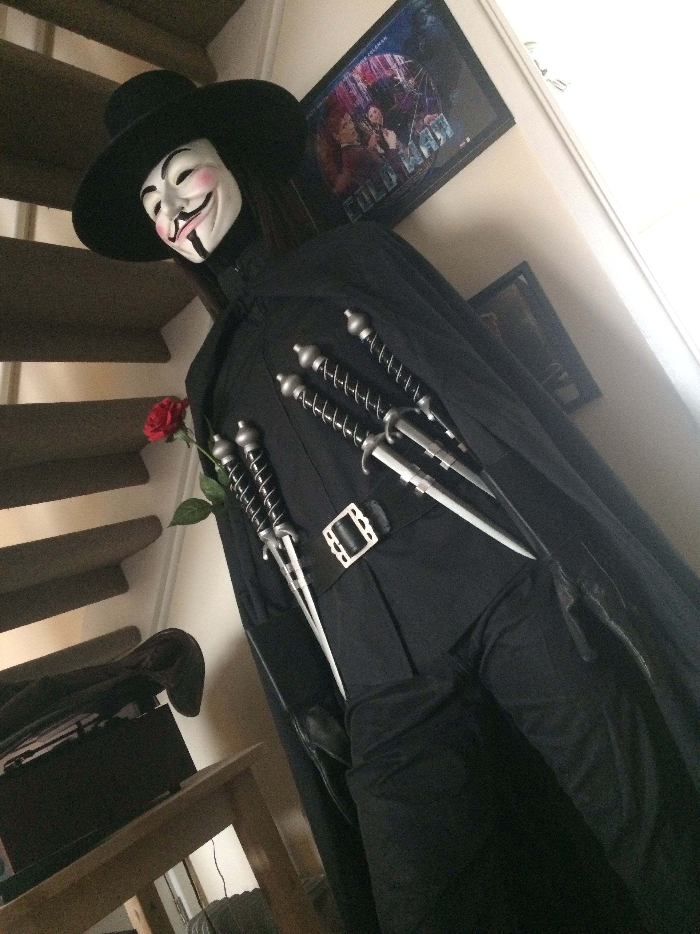

Hello all! So here is my V in all its glory. It's not 100% finished or 100% accurate but thought I'd post on here in case anyone still follows this or finds this thread in the future. Thanks for all your help to everyone that messaged or posted. I've just finished my cloak. Had it made based on a A shape batman cloak. It could be about 6" longer but I'm ok with it for a first go. Lined it so it's nice and heavy and made some clips for the neck so it holds like V's. Anyway. I'm pretty happy with it. Hopefully I'll get to wear it at an convention next month in london.

I think it's excellent. I'd love to hear more about the belt, the buckle, and the top.

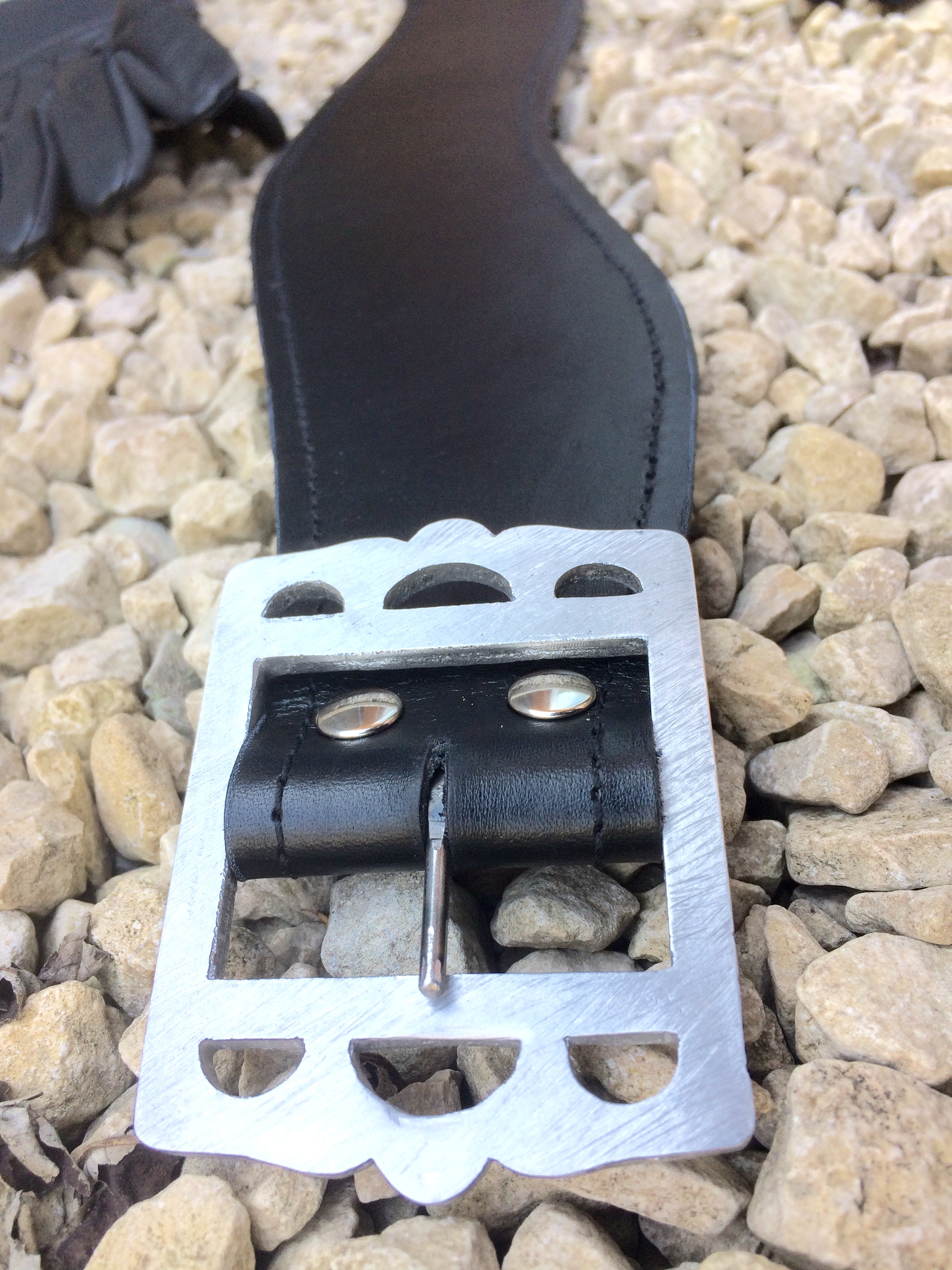

Thanks Ray. The buckle was made by The Iron Ring on etsy after a post on this very thread =)
The doublet was from fan-store.net as it was the easiest option at the time. It's not bad. It's just plain though, no pattern or texture but it does the job for the price and the fit is rather nice so that helps. The material is a bit rubbish. I'd say it's like a polyester blended "suede" but it's not soft. Reminds me of an old 90s shell suit if you know what that is.

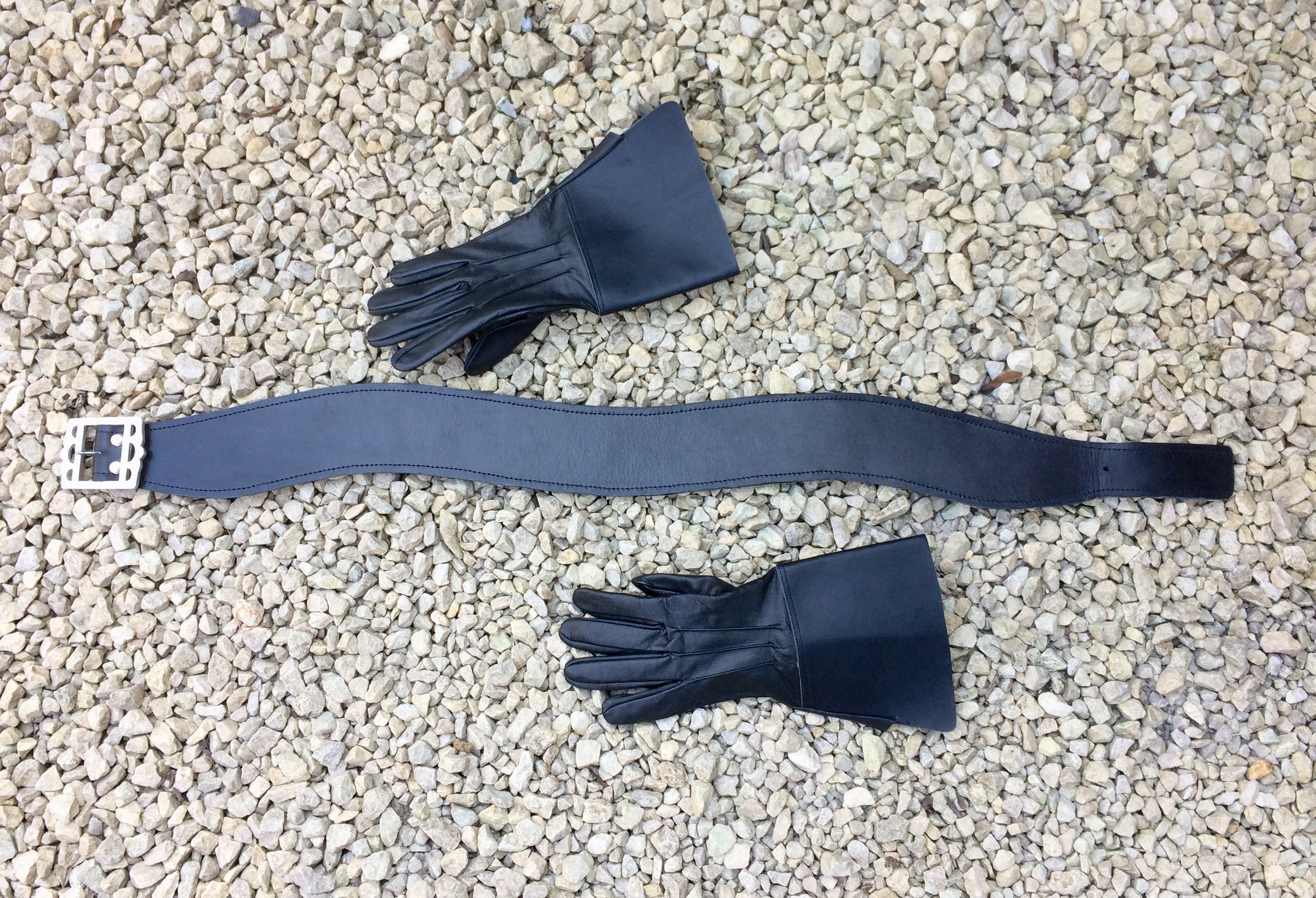

The belt I made myself from people's help here. We've actually spoken on Facebook about the belt to which I apologise for not being very quick on information. I'm actually still looking for a new leather supplier for lengths as if I remember rightly we decided on a length that I could get right now but we can talk about that on fb!
Your costume looks great! And I'm not being bias when I say that it looks as well as it does because you went the extra mile to make a really nice belt. The belt, the daggers...it's impressive! Good job :)

View attachment 721130View attachment 721131
Thanks for sharing this detailed and close-up look. Well done!
